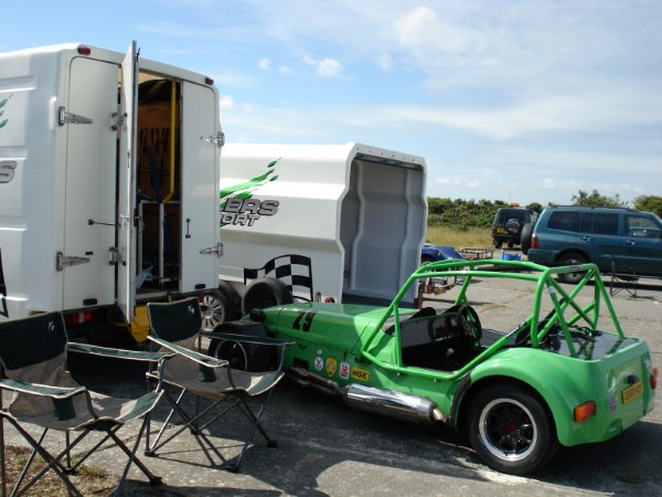

biggest issue with the S2000 lump is the gearbox ratios arn't great ...... bellhousing and type 9 or sequential and your away .
there is a mould for the rear arches but westfield got lawyers involved to stop them being made and succeeded as the rear arches are not generic like front wings for example , twas the only thing they stopped production of from a 3rd party .
making those rear arches yourself is a b**ch and don't forget they are not a mirror of each other either as a westfield is different on the left side to the right .
  Mk1 MX-5 (x3), Westy
Yeah he isn't using the standard gearbox. Great engine for this sort of car though.
Weird about the rear arches, but makes sense. Not hard to make your own tooling if you really really wanted some I guess.
There does seem to be a lot of people willing to put a lot of money into cars! Nowt wrong with a manual box though, especially when you are driving for fun rather than competition.
Ours is probably at £40-50k now, not including the tow car/truck, trailer, tools and spares lol.
i counted my reciepts after 10 years ........
it was not a small number :)
then again its been to most of the old and new GP circuits in europe and every track in the uk , so i am not surprised .... it did a huge amount of track work and never missed a beat .
Sadly I fix rather than drive, but compared to the funness of the Cobra replica and the downright brutal speed of the single seater it's a nice balance.
Oooh pauls car .... before that owned by john arnolds brother steve ..... that was one of the cars in the original batch of cages we had made
Its a caged cage with full msa cert ... circa 2006 ... should have a silver homologation sticker on somewhere
