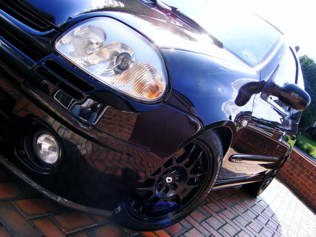

Indeed - anyone remember the pics of a Black 182 on here after it was clayed !!!!!
Marred and swirled to fvck IIRC...paint goes rather flat too after claying..i miss 'black beauty' but then i realise how much easier red is to keep i don't think i'd go back..tho that said a carbon black M3 would be awesome..
Indeed but when it got to the point where you cringe every time you did a basic wash and 'pat-dry' it got a bit tiresome..
Like this ? ...:
:D
