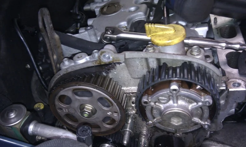

So as some of you will know. My engine went bang in august and so was sent off to Dan at 519 Automotive for some fixing....
Seriously if you are wondering about whether to have a cambelt change... JUST DO IT!!!!

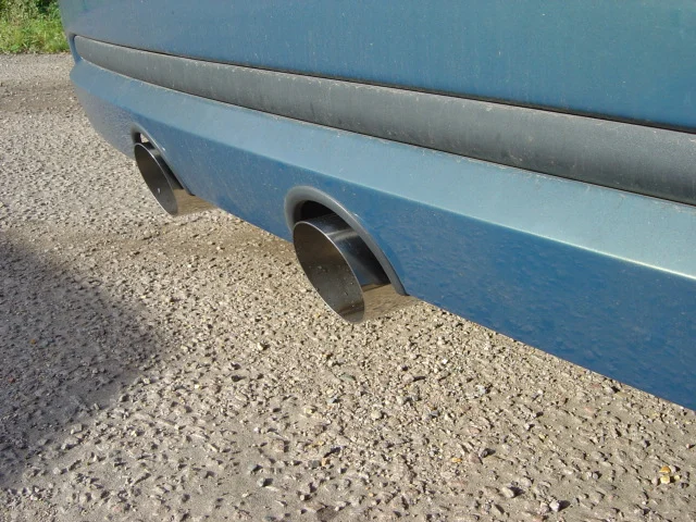

The car came back from 519 Automotive running lovely. However with the upgrades, it was in desperate need of a remap. So instead of having it mapped with a resrictive cat and standard system I called Dan again to get me a Piper system, however I wanted different tips: Slash cut.

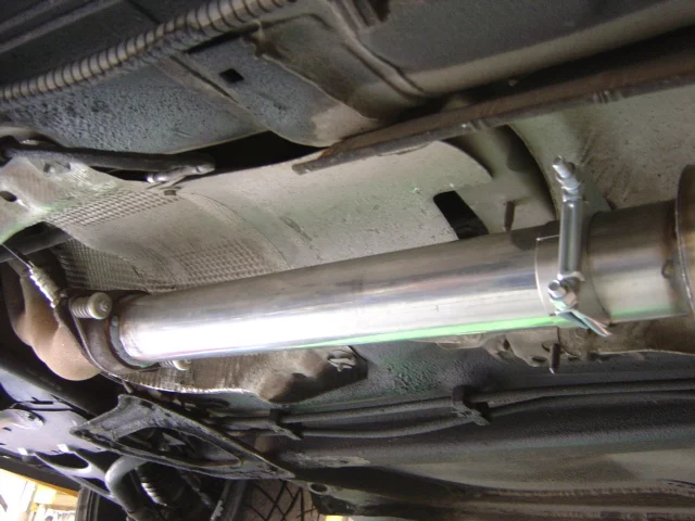

The new piper system was built along with a custom decat for a full 2.5" manifold back system.
Decat:

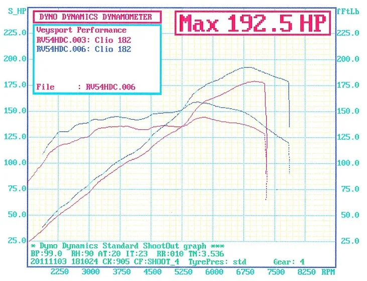

So the car was strapped onto the rollers and all of the past 2 months money spending was finally going to be realised! I had a number in my head that I was going to be happy with. 185bhp - happy, 190 bhp - very happy, 195bhp - extremely happy.
And so as we watched the readout, the number kept rising and finally rested at 192.5bhp and 162 lb/ft torque. I was very happy!

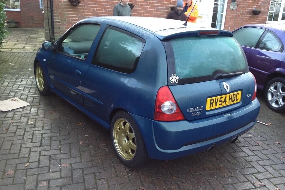

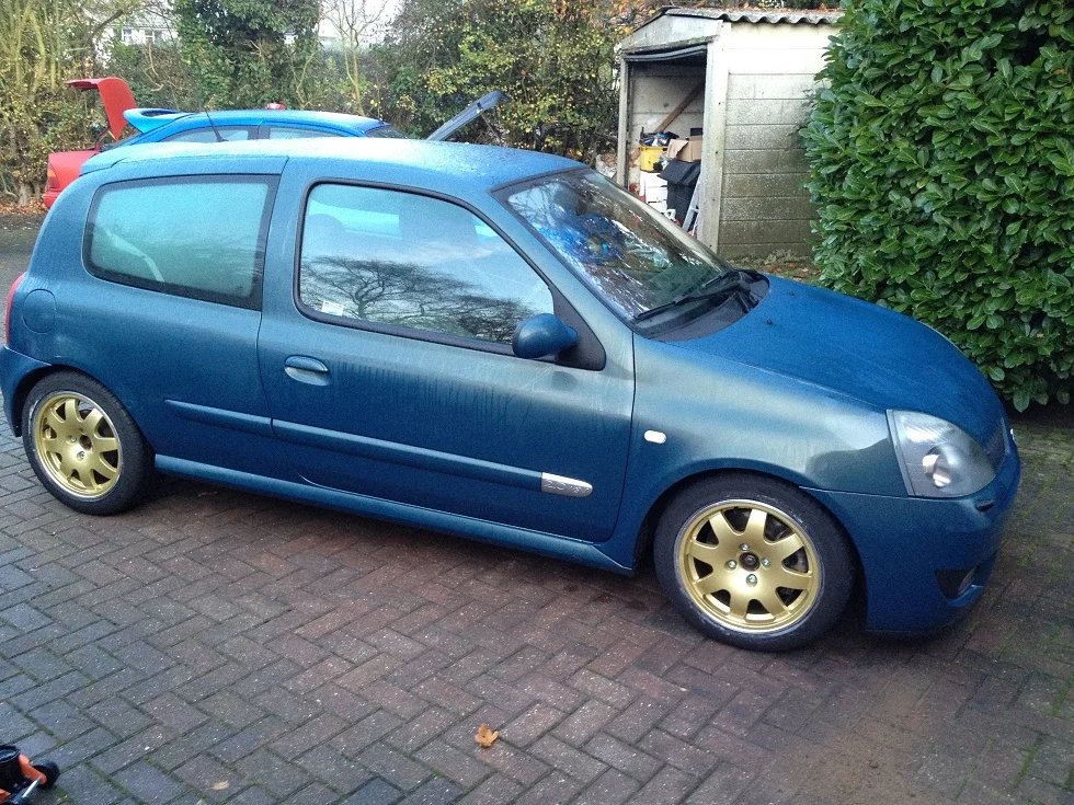

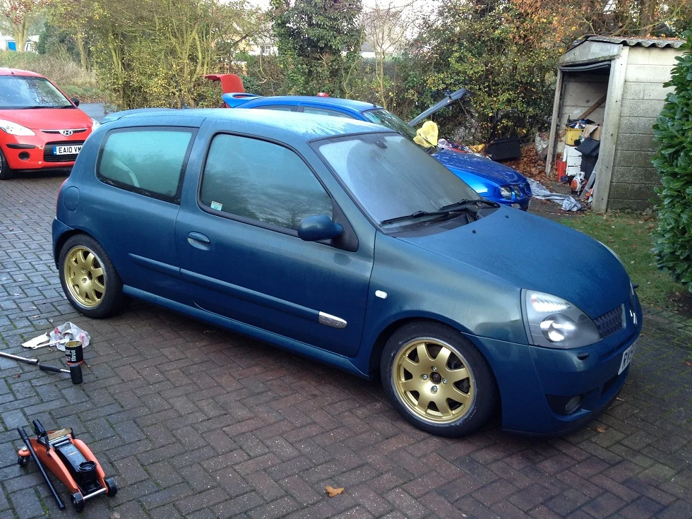

I've wanted some 15" wheels for quite some time and been tempted by some Williams Wheels. About a month and a half ago I managed to get hold of some, but they were in quite a bad way :( They were sitting in my room for quite a few weeks while I tried to find somewhere close enough and someone I would trust to get them back to original mint condition. Finally i got a recommendation to use Pristine Wheels and all I can say is that it was the easiest process ever. They picked them up, called me once they had checked them over with a price then delivered them back to my door. To say they were perfect when they returned would be an understatement, they had gone from destroyed (kerbing with chunks missing from the face and damage to the inside lip) to absolutely perfect. Better than I could ever have expected (not too sure what i was expecting :p)
So today I put them on. I was a bit aprehensive as to whether they would look good but in my opinion they look superb on the car and even better than I was expecting. VERY pleased.
So here are some pics of it as of today :)

Saw this a couple of times when I went down. That dephaser pulley was a mess, god knows who fitted it in the first place!

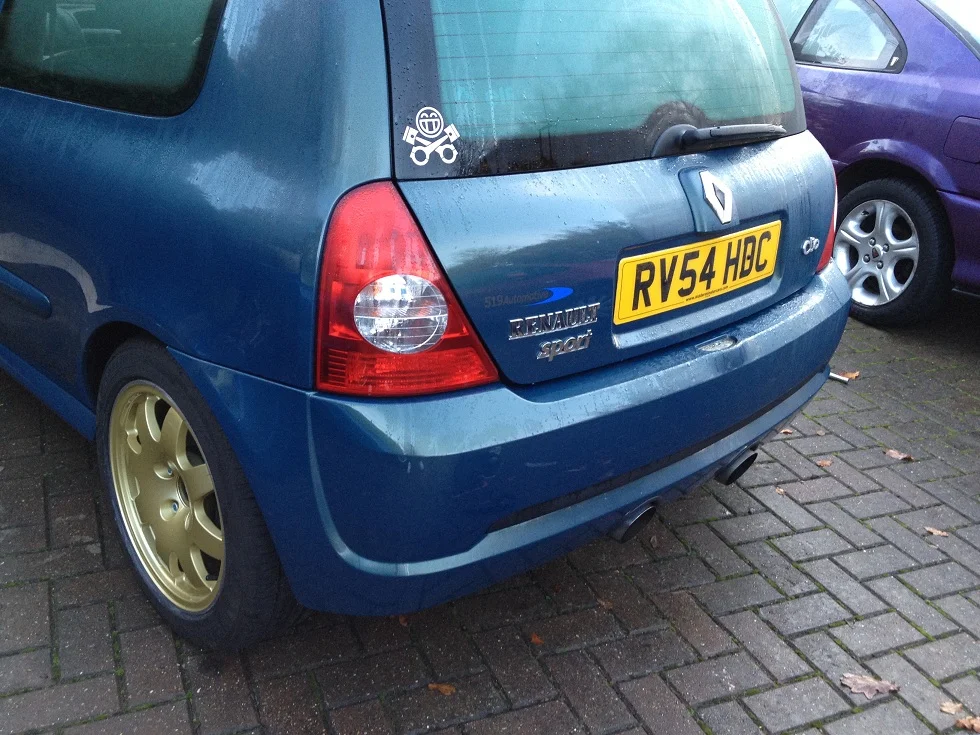

I did have the spax coilovers fitted along with solid top mounts and they are amazing compared to the lowering springs I had on there before.
I just wish it was easier to keep clean :p
