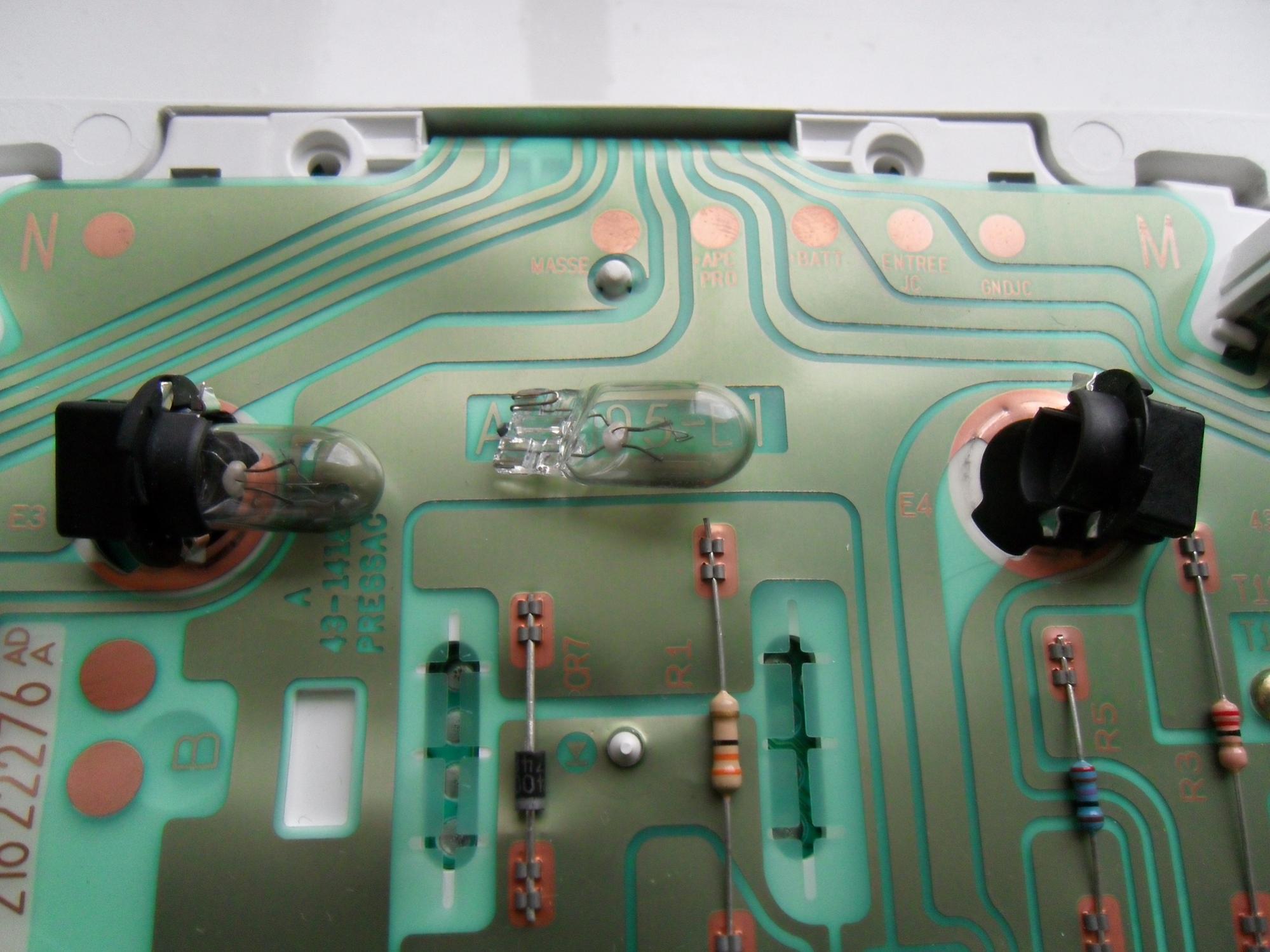

Mine looks like this:
Rob
I think, I'm not certain, that changing the bulbs over will be exactly the same as is is in the guides, you may just have a slightly different amount of bulbs/bulb layout.

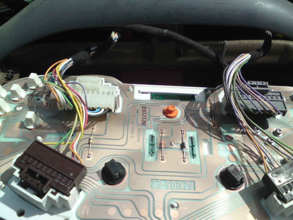

Just to confirm, back of yours look like this too:
  Jap Box
Yeah the big ones are the same size and shape as a sidelight.
Nope their bigger than that, a lot wider than a sidelight, possibly the same height though. Maybe the same fitment? Ill remove it again tomorrow when I can be arsed and try find out.
