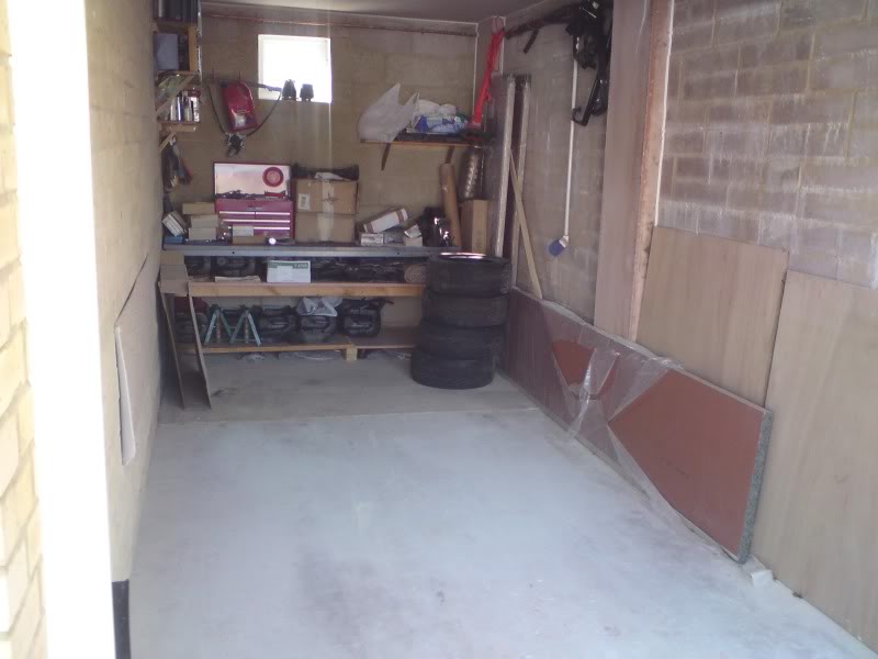

Well to start the work on the Clio i spent 4 hours on Saturday cleaning out my garage.
I pulled everything out and sorted through all my stuff, sorted out the useable from the rubbish, and made myself throw away a lot of bits and pieces I keep thinking that I may need.
The outcome is I now have a fully useable garage, and a workbench I can now use, where as before I couldnt even see it! I also brushed out about 5kg's of dust and dirt!
Here is the finished product:

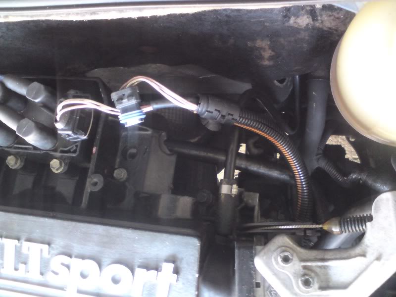

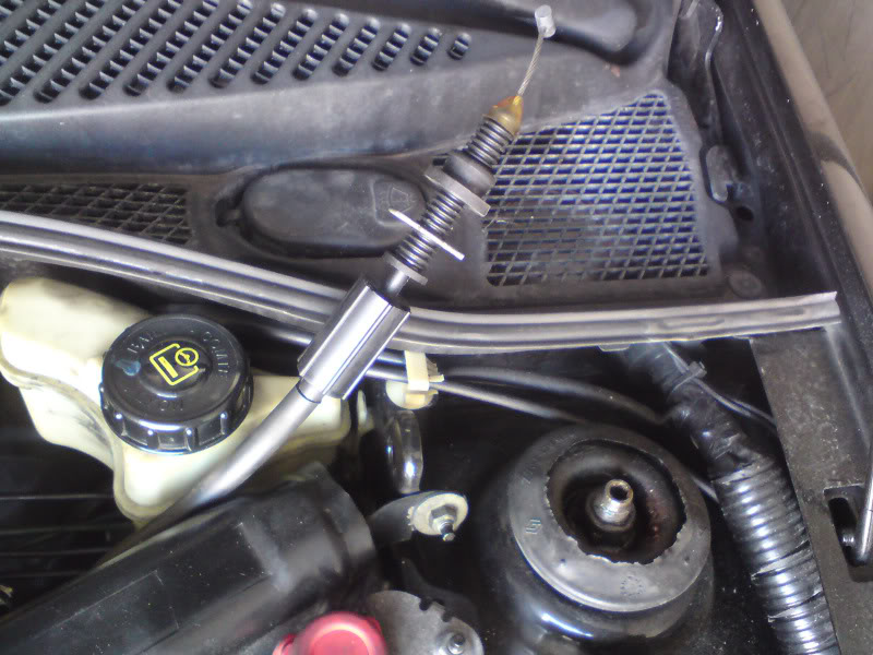

Once that was off, I moved onto the throttle cable and set about unplugging the air temp sensor, throttle position sensor, coil pack, map sensor and idle control valve:

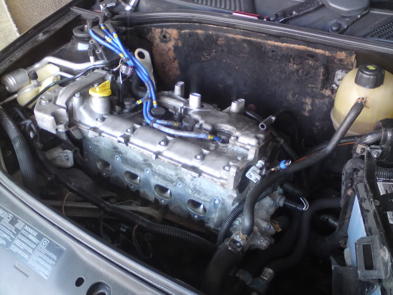

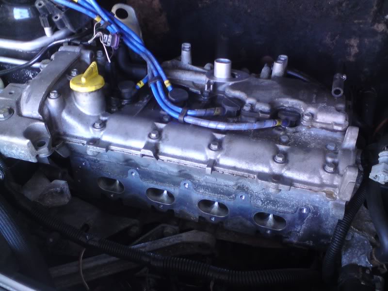

But after a little fiddling, the lower mainfold came off leaving this:
By this time I was running out of hours, so I used some degreaser and had a quick go at cleaning up the rocker cover and cylinder head. I will have another go a few more times this week to see if I can get it a bit cleaner, I have no pics of it after my cleaning session but I will grab some this week.

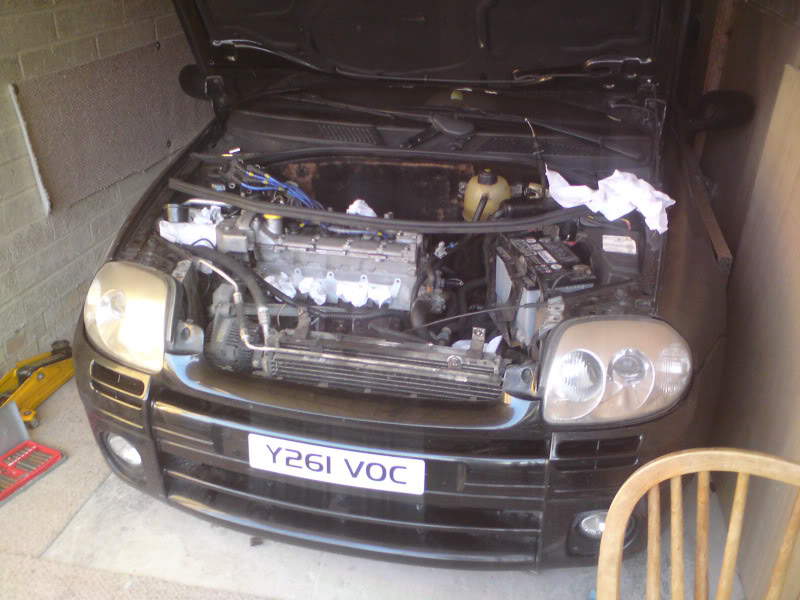

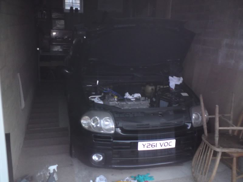

Here is the workspace i have, quite chuffed I managed to clear up the garage as much as I have, with the Clio in it I have about 2ft in front and behind it which means I can use my work bench too:

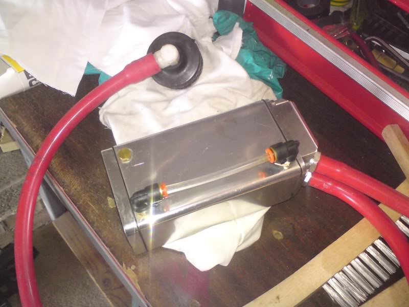

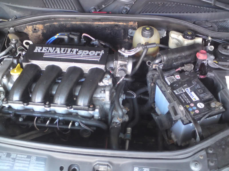

Didnt have too long on it today, managed to find my catch tank so gave that a quick clean and im having a think of where to mount it:

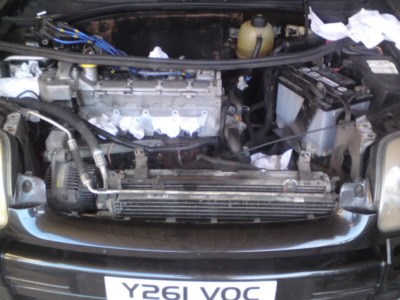

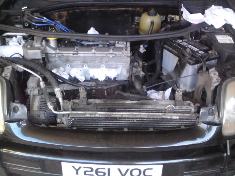

Also continued with cleaning the engine, managed to give the top of the radiator,condensor and gearbox a good clean down, but I didnt think you would want to see pics of that.

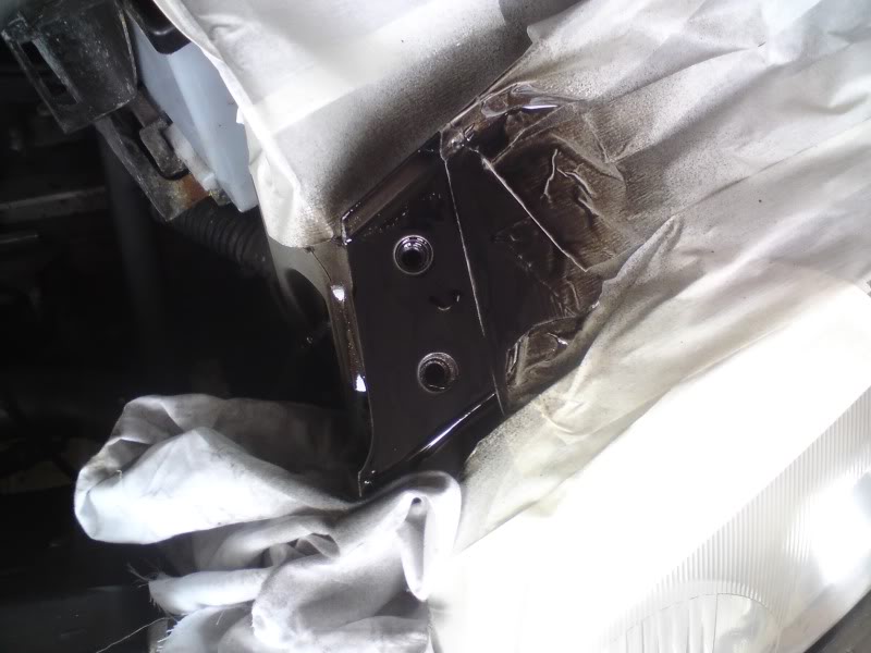

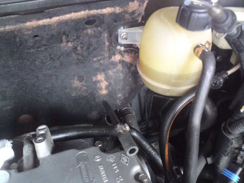

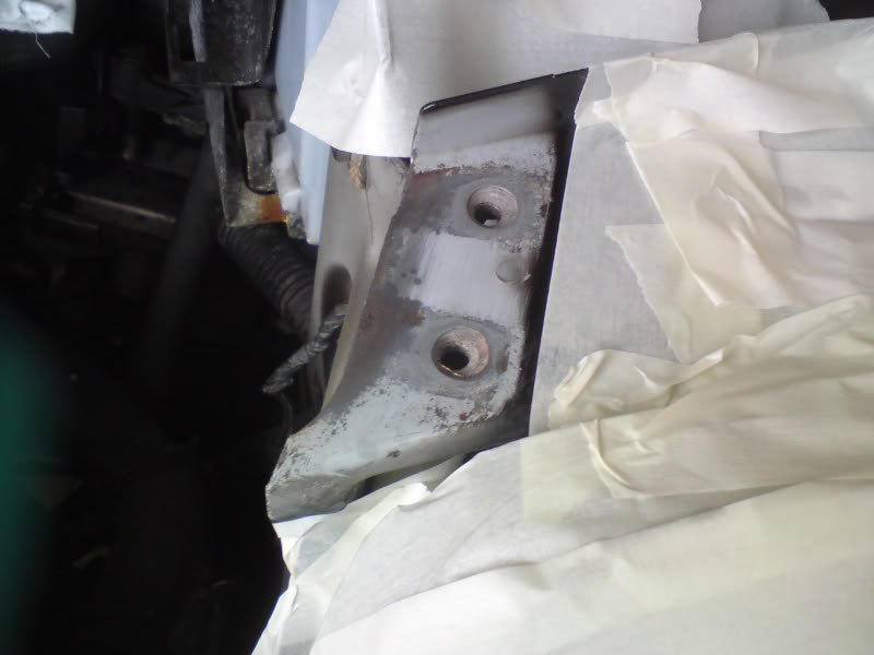

Well there isnt a huge amount I can do at the moment as im waiting for some more bits to arrive, so i had a quick clean up of the engine bay and when I removed the slam panel i noticed a bit of surface rust:
So that had a sand down and the hammerite treatment!

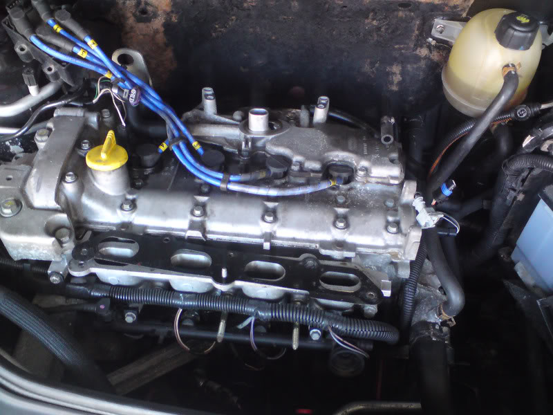

Im also thinking of mounting my catch tank here to the left of the coolant bottle?

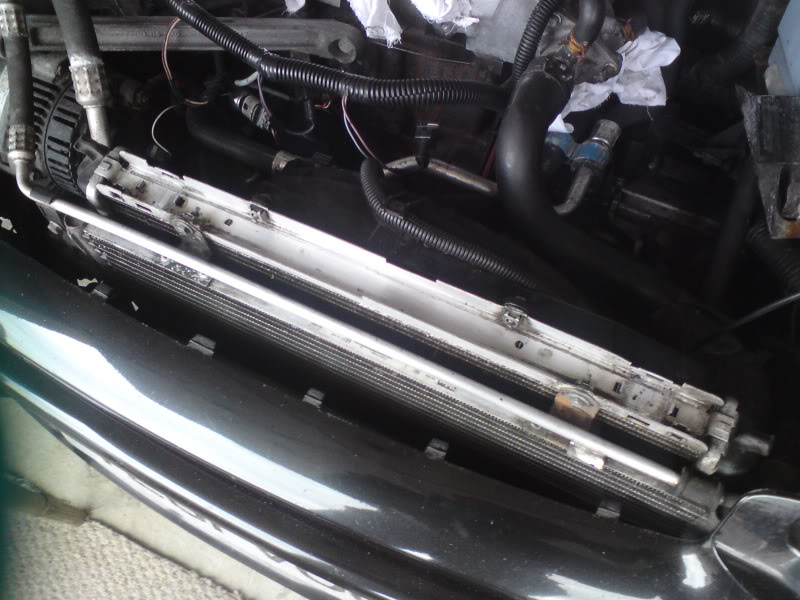

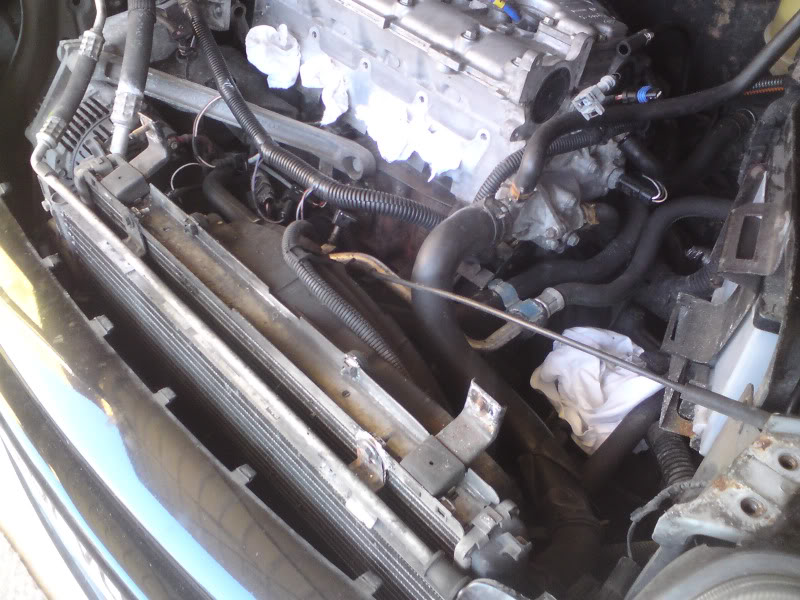

Oh and a quick shot of my radiator that I cant get bloody clean! lol
Seems to be the usual place to mount them
