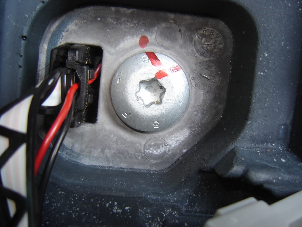

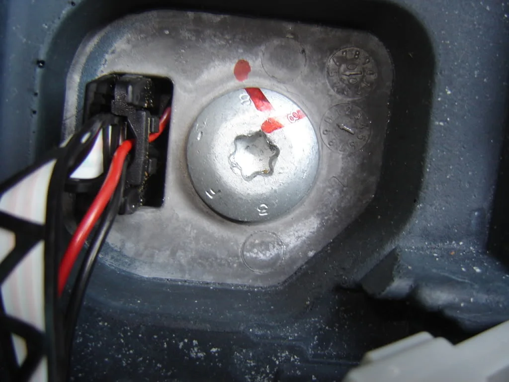

Just a little update for you guys and girls, Started stripping the dash today while i had a spare hour, But was stopped by the mother of all torque bolts, so will have to wait for kev with his magic tools to put in an apperance lol.
Affending bolt :mad:, oh well

good work johnson!!!! if i knew you were doing some today i would have come down.... thought you were out all day.....:S
  Sore Subject
good work!!!!
not sure if he will have a star head that big... hasn't he lost the 50? huston.....we could have a problem! :dapprove:

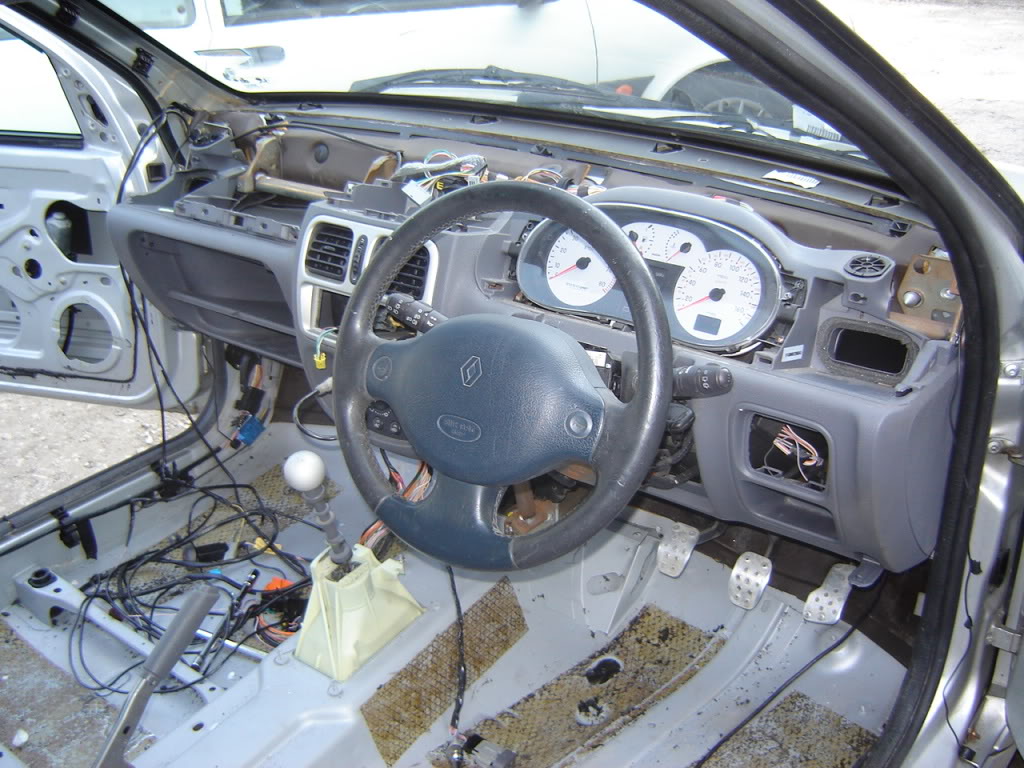

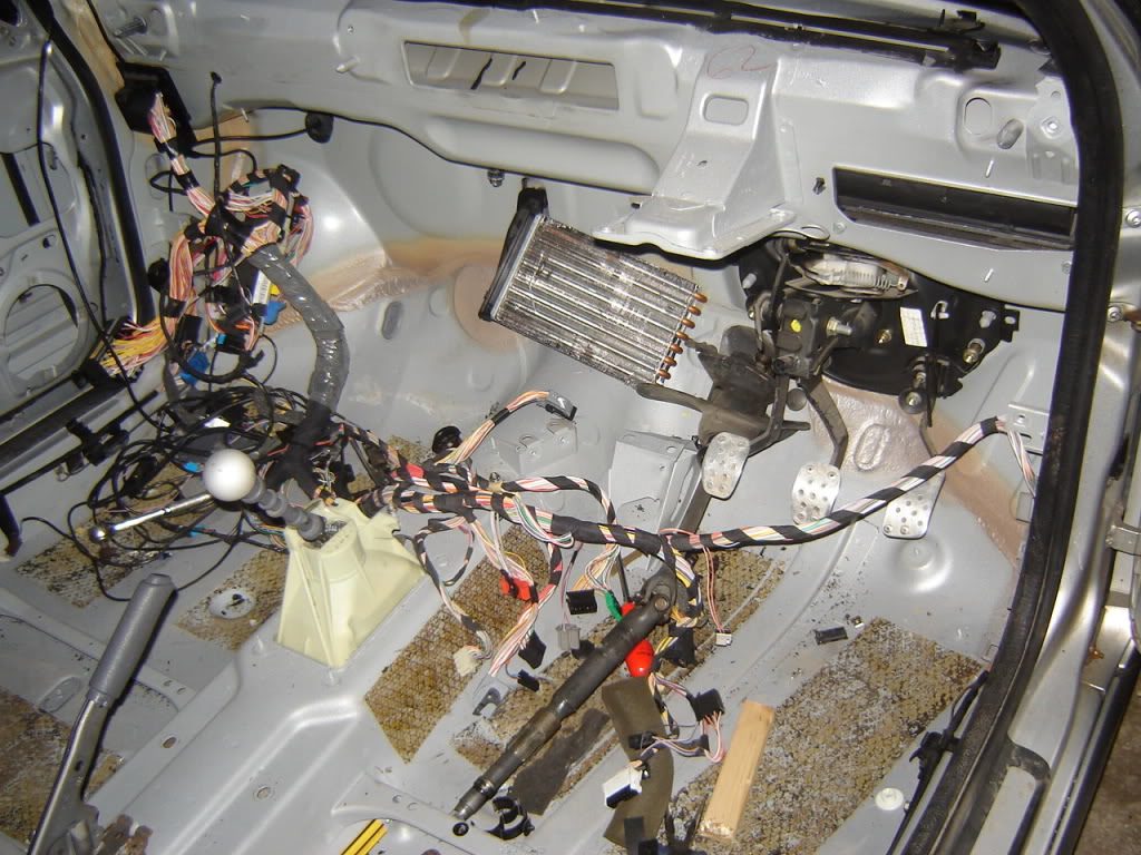

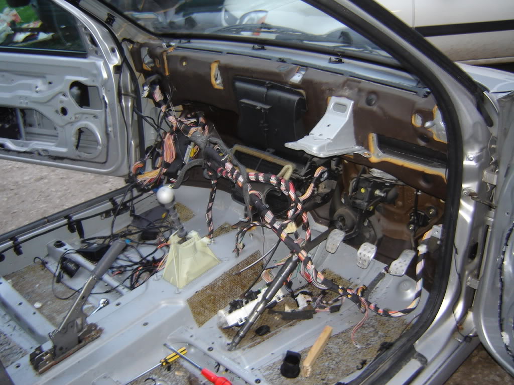

Done a bit more this evening, Whipped the rest of the dash out, and all of the sound deadning, then me and the heater matrix had a falling out so that came out aswel:evil:
Just need a U bend to blank off the heater rad thing then we're set for re-assemblage. Plenty of wiring to sort through and lighten first though boys ;) lol

tar sound deadening..... took all mine out yesterday.
Not 10kg as some members say lol about 4 :p

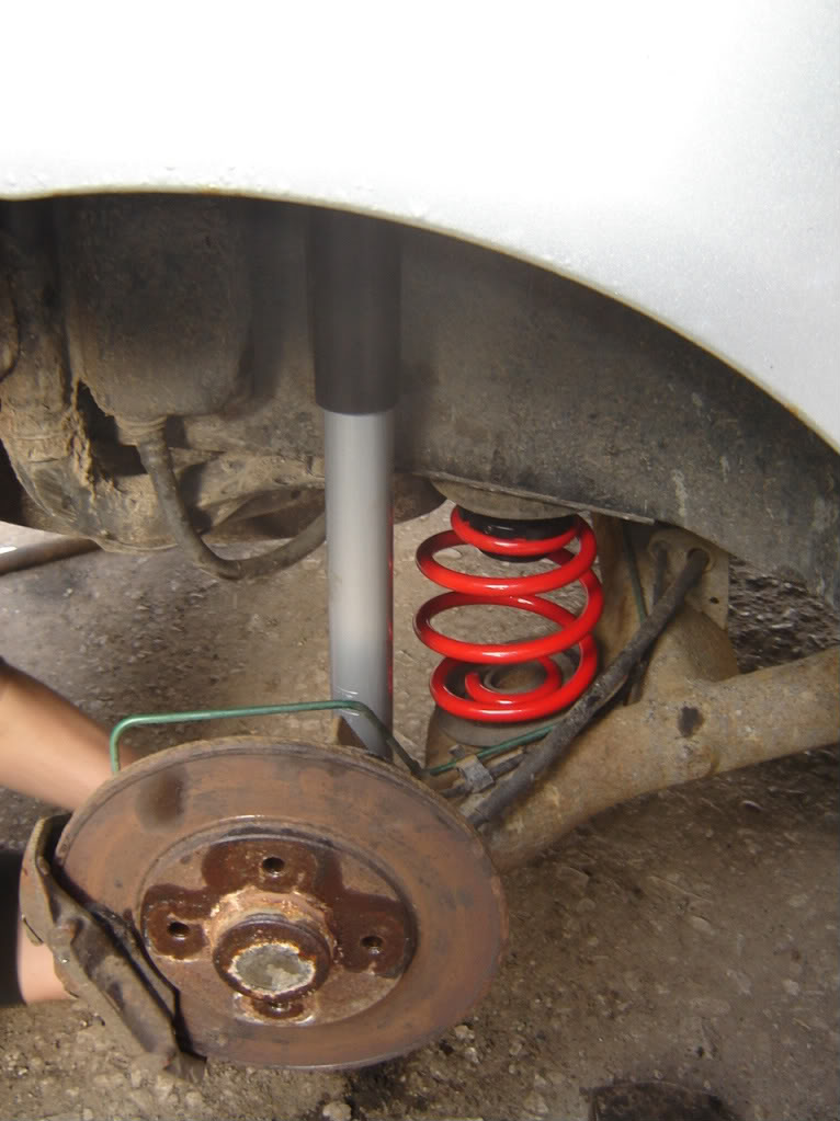

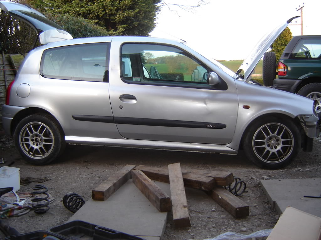

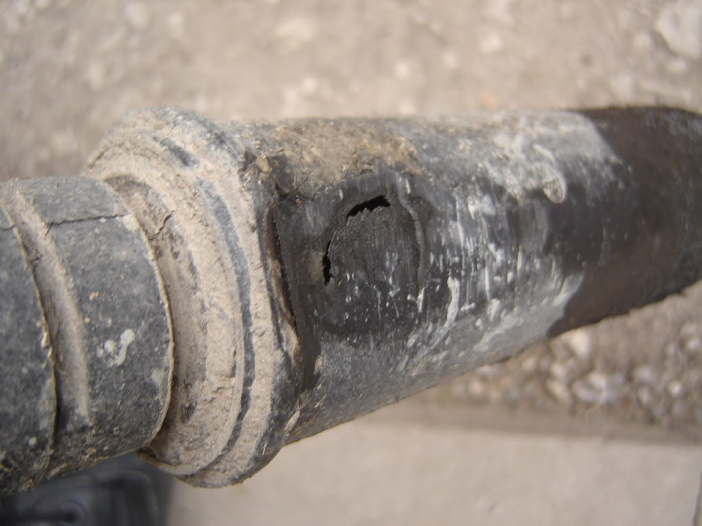

Me and Kev got the new coilovers on this afternoon, Was a bit of a pain gettin some of the 10yr old bolts off :mad:

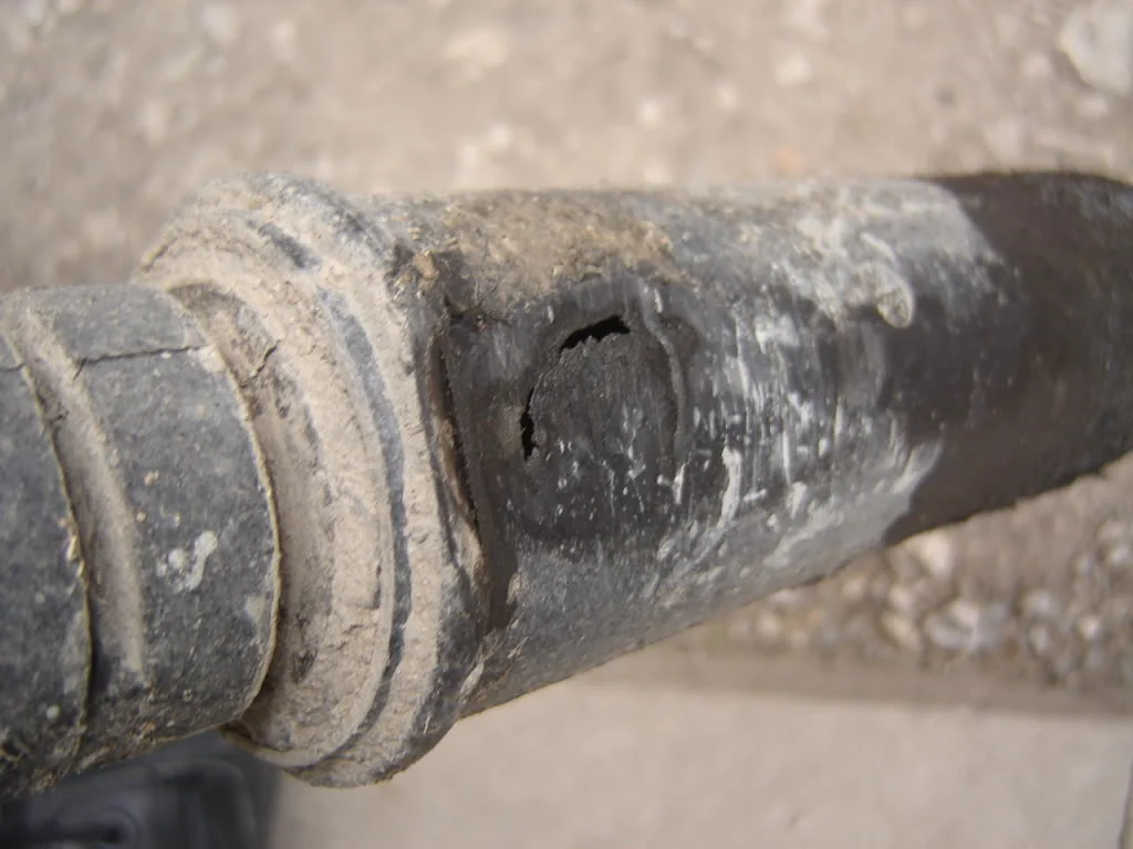

The leaking old back shock
New shock and spring fitted

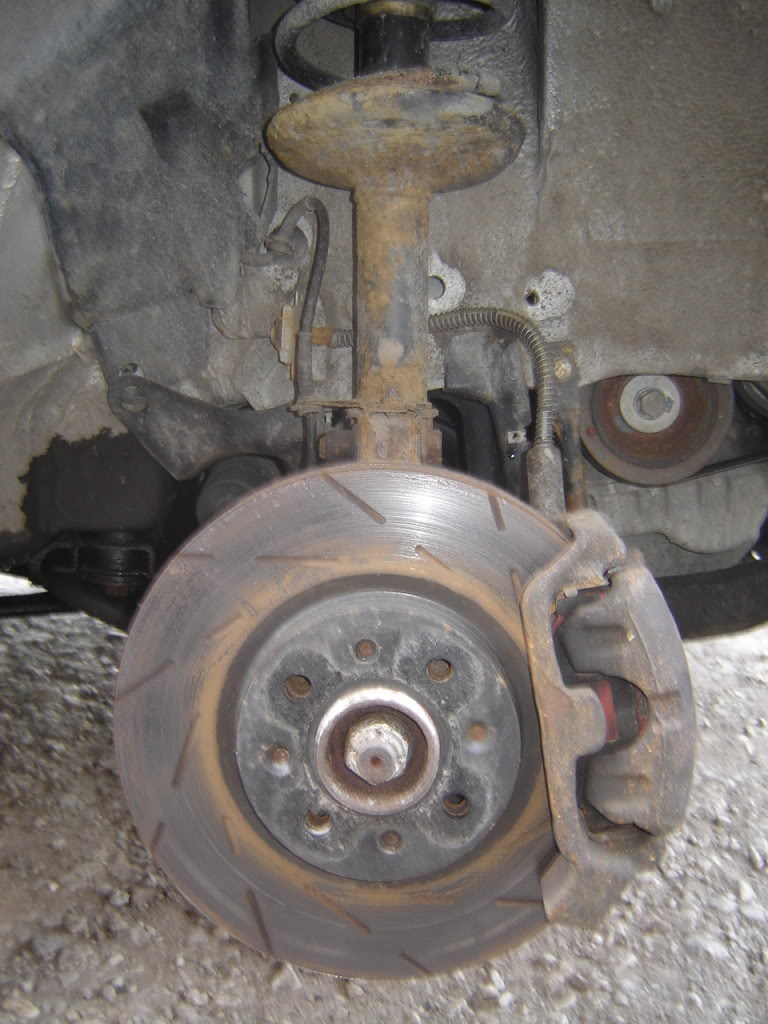

Tired looking front suspension
All new off roader stance,:rasp: Obviously needs adjusting yet, but the main aim was to get it fitted and then fine tune the ideal ride height.

Never seen the back spring fitted that way before :) Its upside down compred to normal :)
Looking good though!
Lol, well the cut price kut from KTEC had no destructions?! So the adjuster is meant to go at the bottom? All the ABS lines etc seemed to be in the way that way round??? Can always swap it but would have thought it makes no odds?
  172 5HED
just makes adj easier.
I thought it would be easier this way so not to have to work round the pipes? WIll see how we get on when adjusting the back, both front and back set to half but as you can see, alot lower on the front :eek:

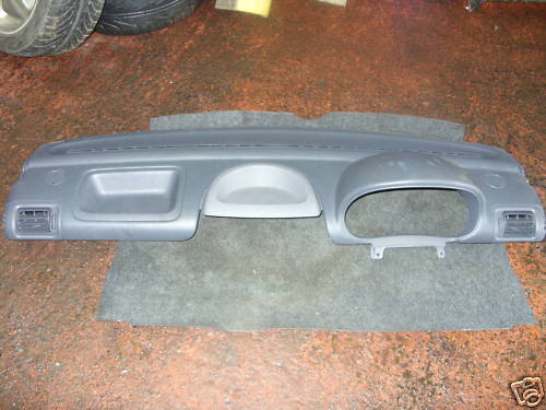

More pics later, colies adjusted, loom stipped right back (2 carrier bags full) and non sport dash in!
