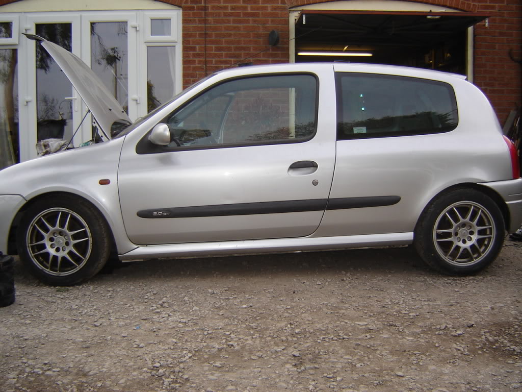

Ph1 172 track shed
  Zetec s
Pic's will be up later ppl sorry bout the delay but this rate of work is knackering you know lol.

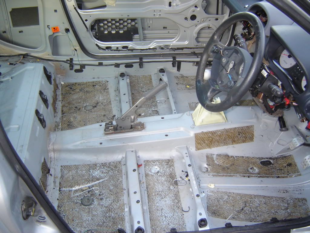

Will be cleaning up the glue from the sound deadening later and possibly give it a quick lick of paint inside.

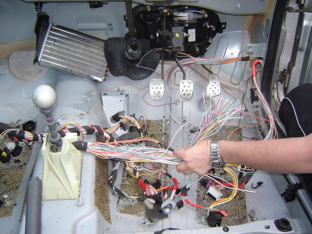

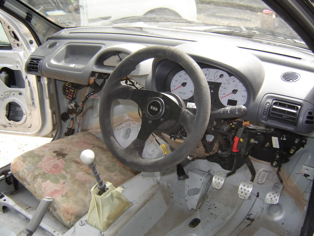

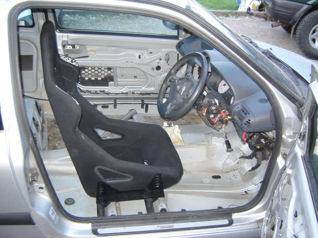

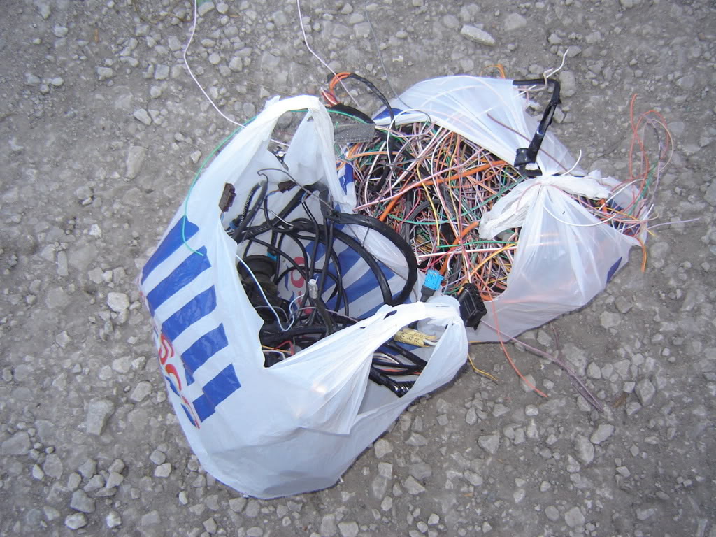

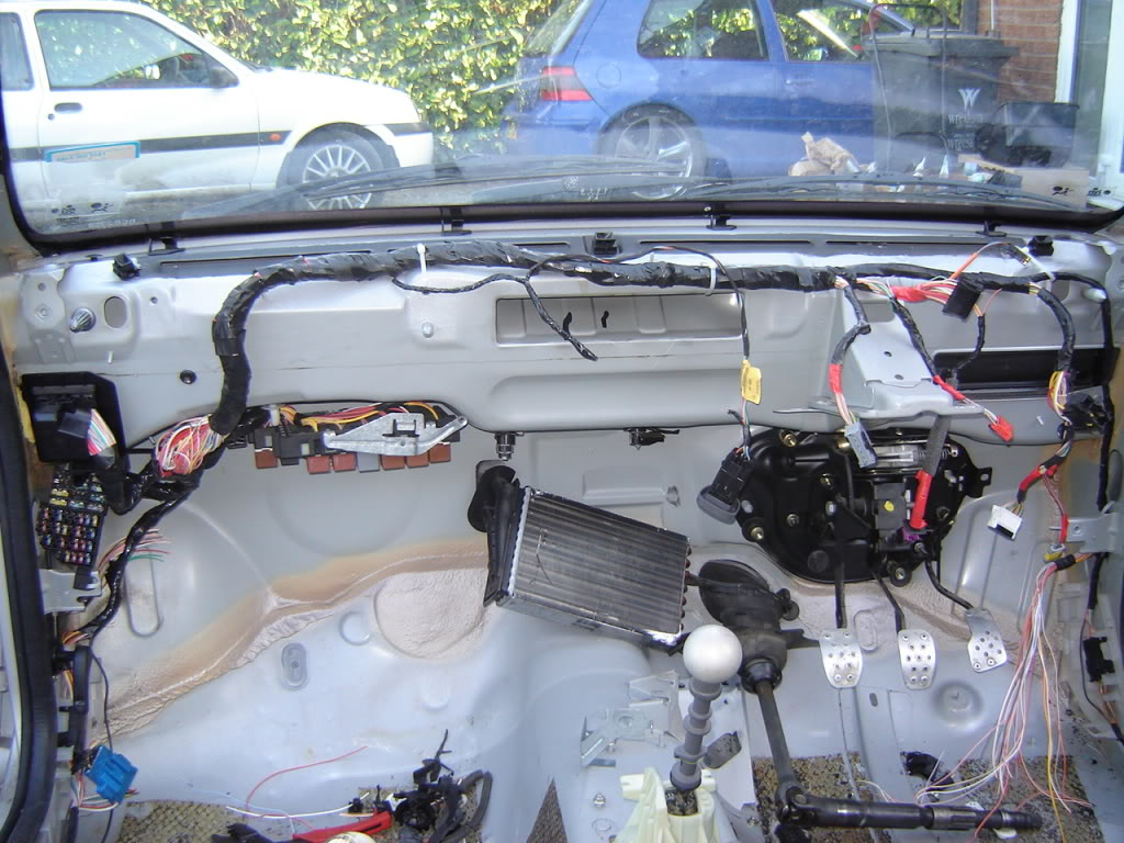

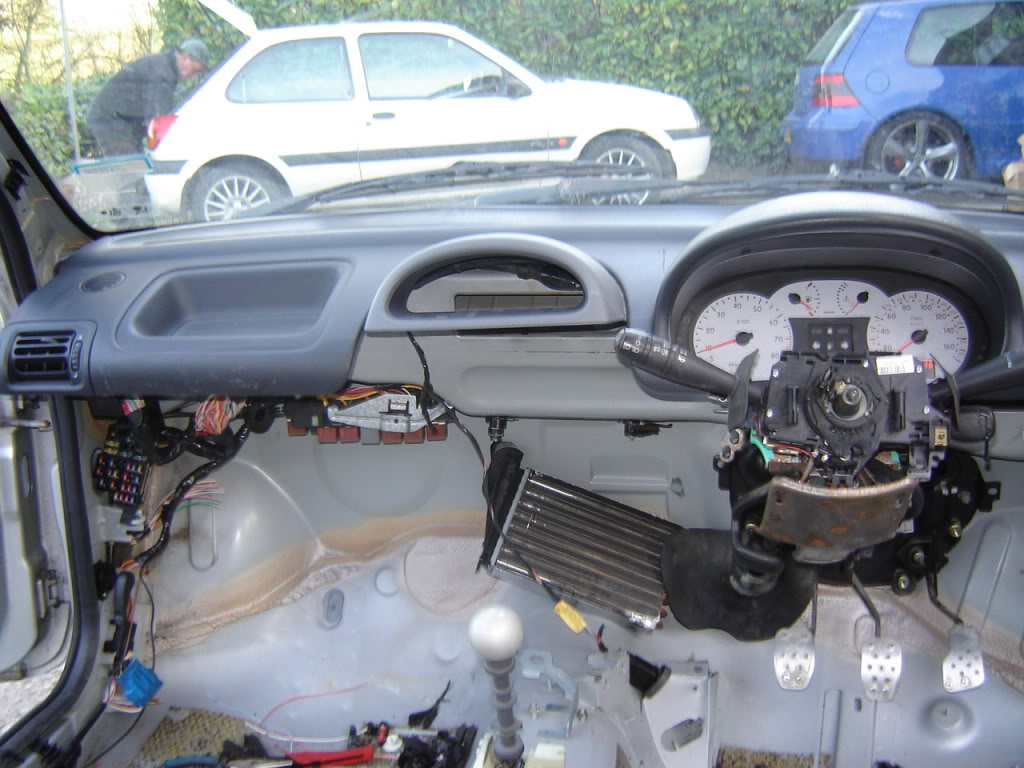

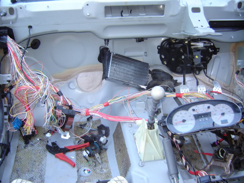

Right finished off lightening and tidying the loom and then fitted the dash so pics of that,
And the amount of wiring removed

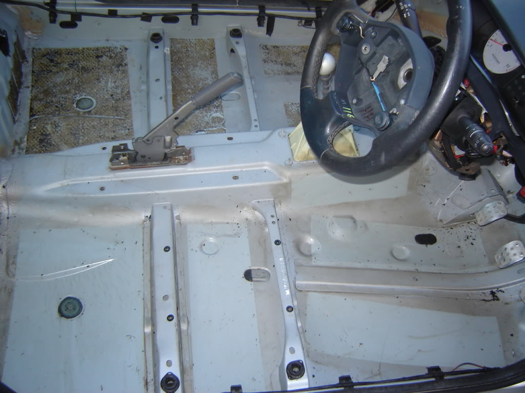

Then tidyed the inside, Kev and ash get a turn at the sound deadning next because its a bugger to clean :rasp:

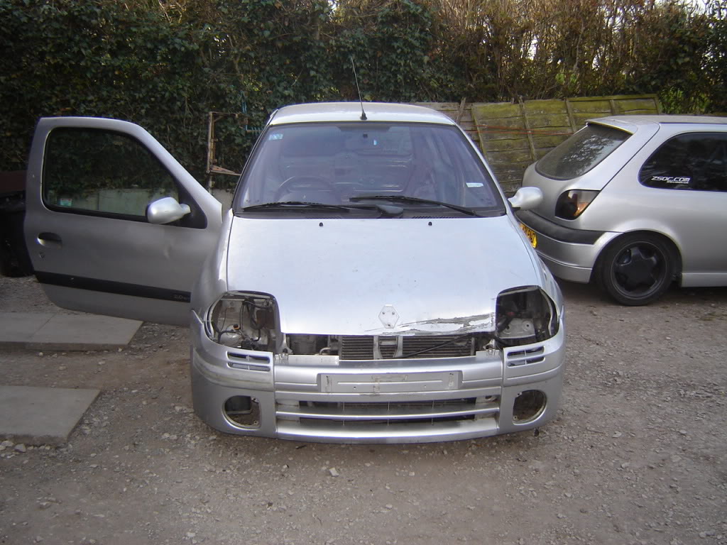

And front bumper fitted Just need a grill and some headlights now

MINT!!!!!!!!!! Cant wait now! good work Ali!!!! :clap:I do believe that it is Mr Walker's turn to scrub the sound deadning out, seen as i am going to be building his car back up for him to sell......:evil::rasp:

Cheers boys, its just time after work where we would normaly be monging about / drinking beer etc....

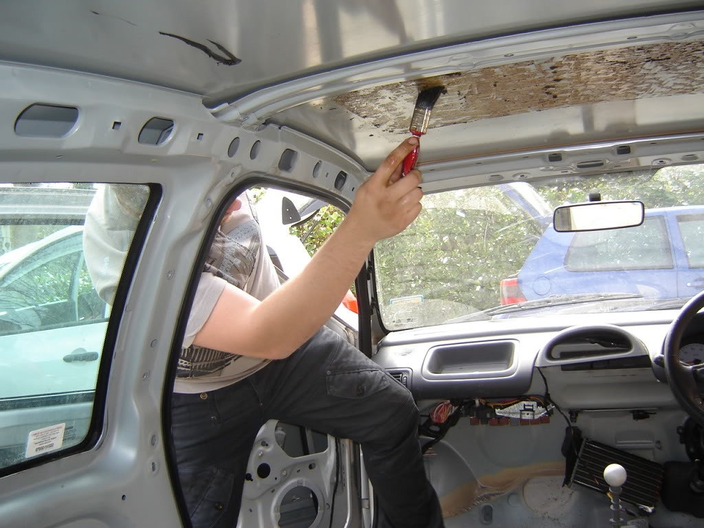

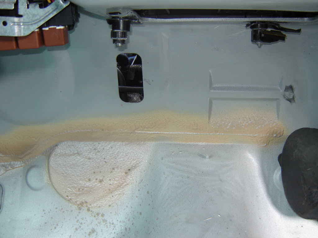

You can still see the marks on our roof where I got carried away with a scraper:dapprove:
Lol, the roof tar is a b**ch!! Nasty stuff:(
Got it off like but need the residue off!

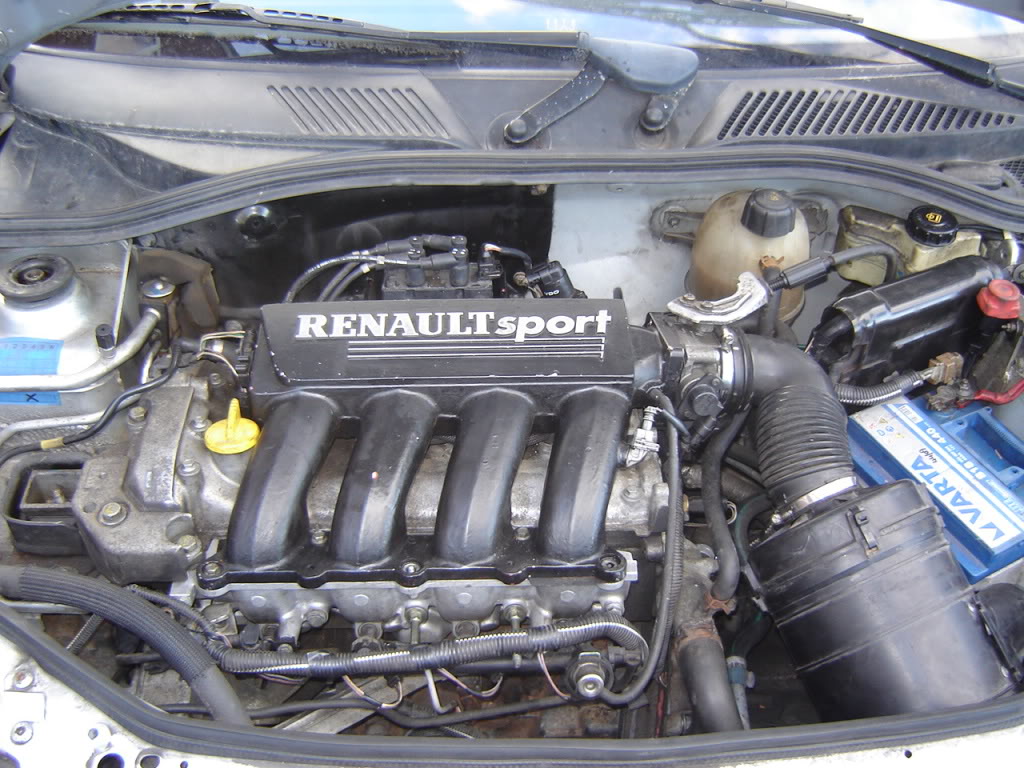

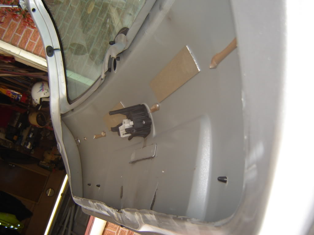

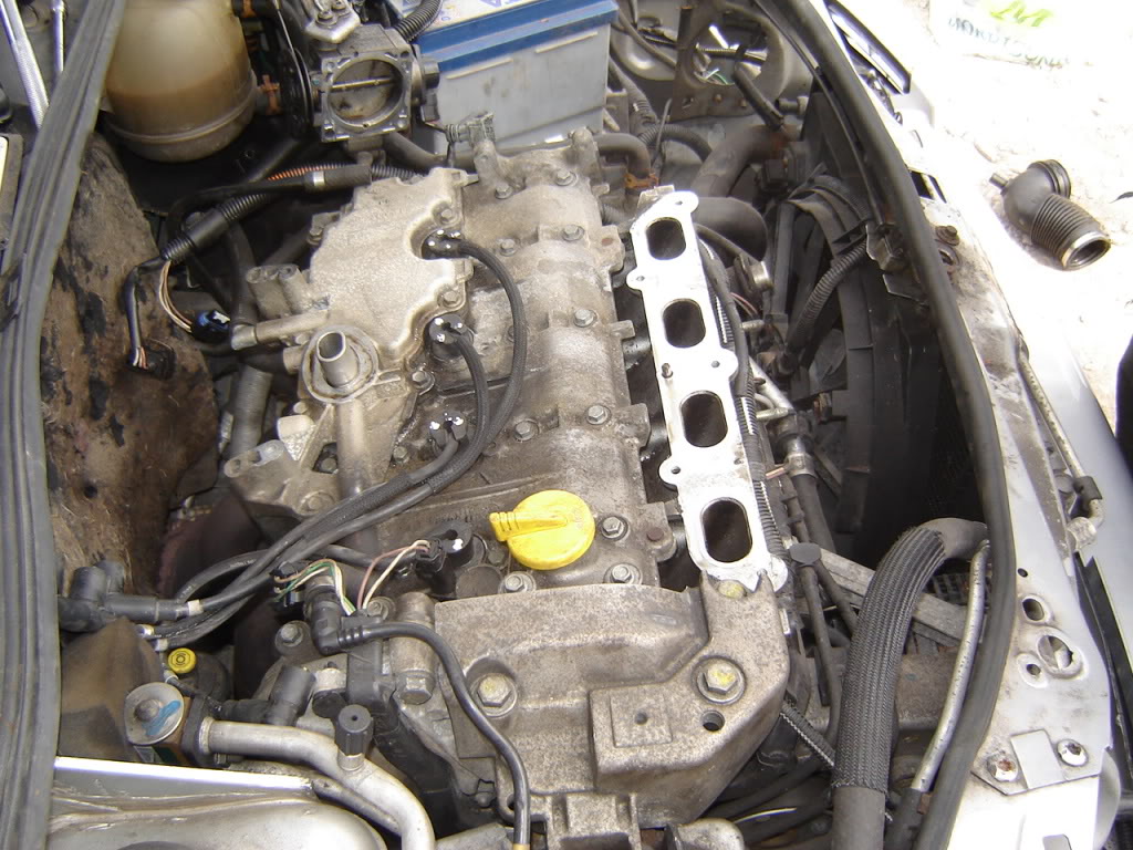

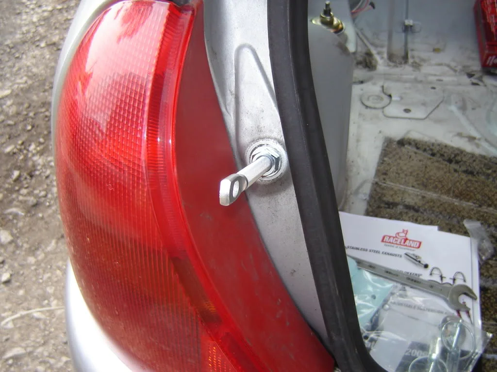

Well ash spent all saturday puttin kev's 197 back together, and kev put all his heart and soul into removing the sound deadning tar stuff, so i started stripping and pinning the boot, Then we made a start on fitting the matched inlets, Also fitted new pads, and ajusted the coilovers to improve the stance.
Next job is measure up for cage making/fitting,
Finish off inlets (had to get some new gaskets),
Fit braided brake lines,

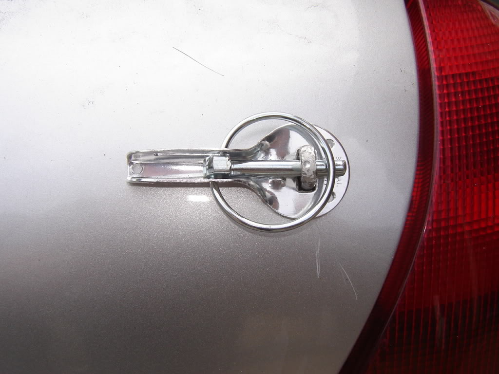

Airocatches for the bonnet,
Move battery and ecu
Then wait for parcels to arrive with headlights, grill and seat rails.

Dash pretty much finished
Top inlet removed

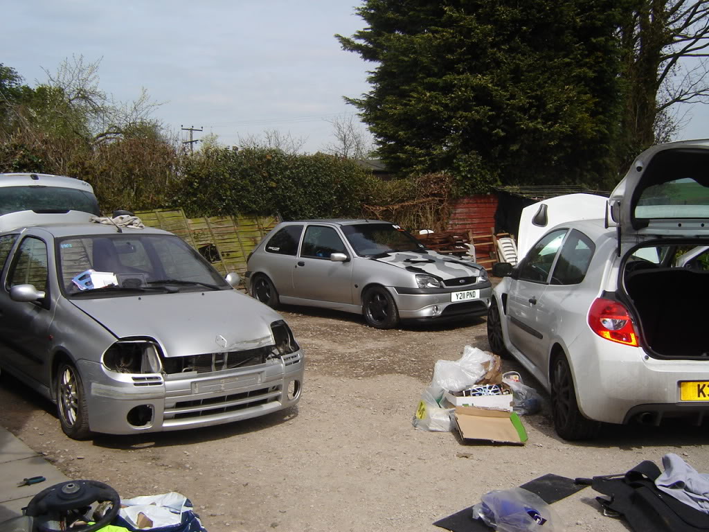

Group picture :rasp:

Lowering the steering coloumn?
  172 5HED
Im here now, read it all so I can help if needed. Done a cracking job so far.
Cheers matey, a long way off yours in terms of quality (both engineering and in general) but its just a cheap fun car!
Not planning on lowering the column mate. Should I? :cool:
  172 Race Car
Its more like my old one (thread still on here) That was done cheap and cherfull. Was a great little car and was the base/test/learning mule for the race car
If you lower the seeting position then yea, I would

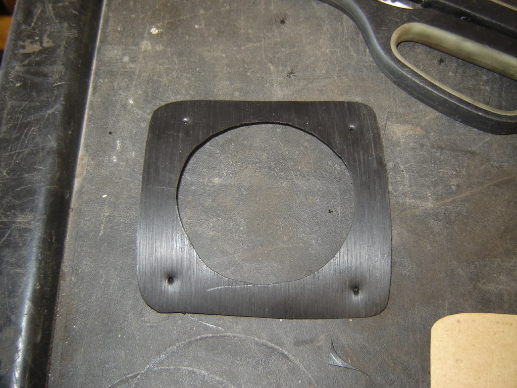

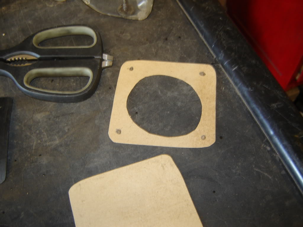

Just done a bit more fiddling, The gasket paper i got was poo and didn't seal at all so i had a brain wave :dapprove: and used some damp proofing, cut it to shape, and voila it now ticks over at 1k with no mad air leaks like before when it had no gasket :eek:.

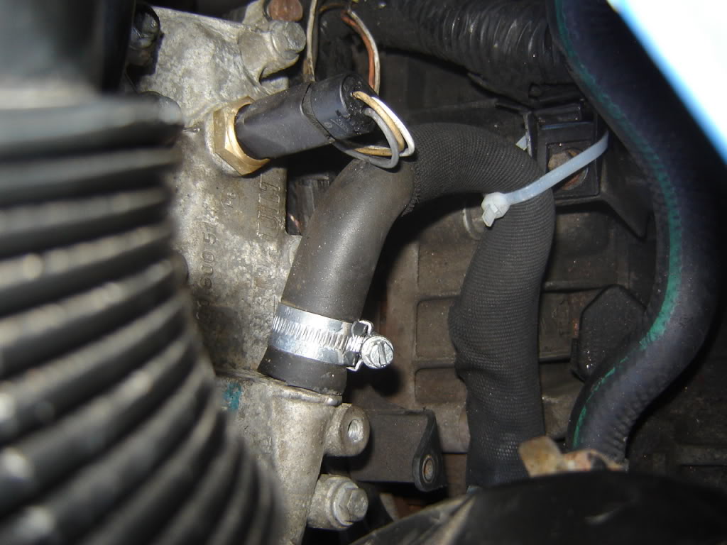

Also just a quick pick of the heater matrix totally removed and bypassed, Don't know whether this is the approved method of doing it but it works so who knows:S

i notice you have removed the heat proofing behind the mani, will you be replacing it with any thing or just leave it like that ? it the not brake lines, fuel line, behind there??
I'm still not liking the ghetto seal TBH mate, will sort something for that!:rasp:
