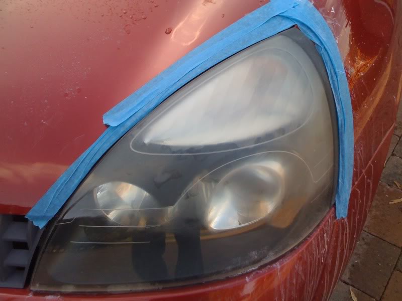

Mask up & attack with 1000 grit (all I had in the garage, ideally, say 800 then maybe 1200);

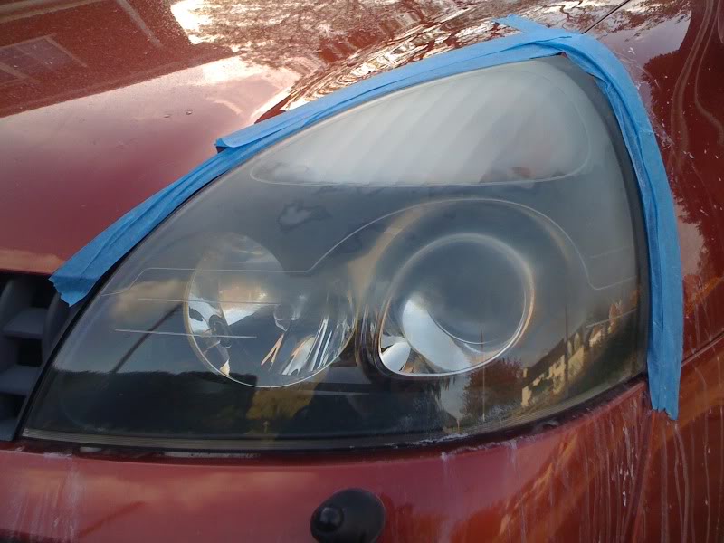

Then I used Halfrauds own brand rubbing compound, G3 or similar would be equally as good, probably better;

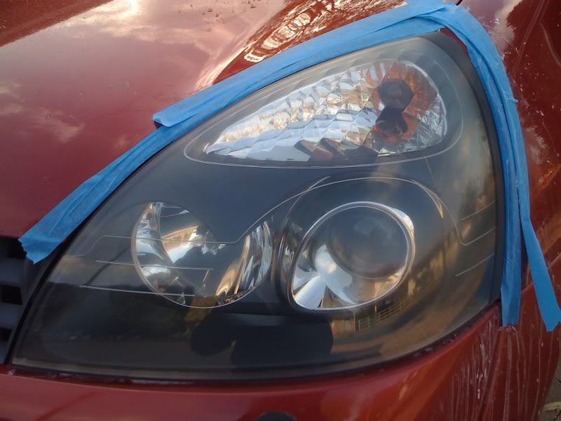

Next up, I used Mequiars ScratchX2 on the buffer;

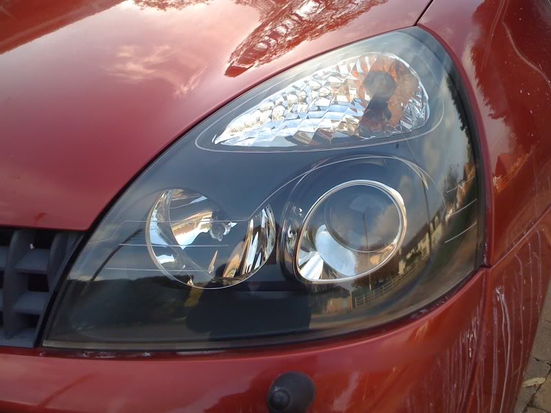

Then finally after a few passes;

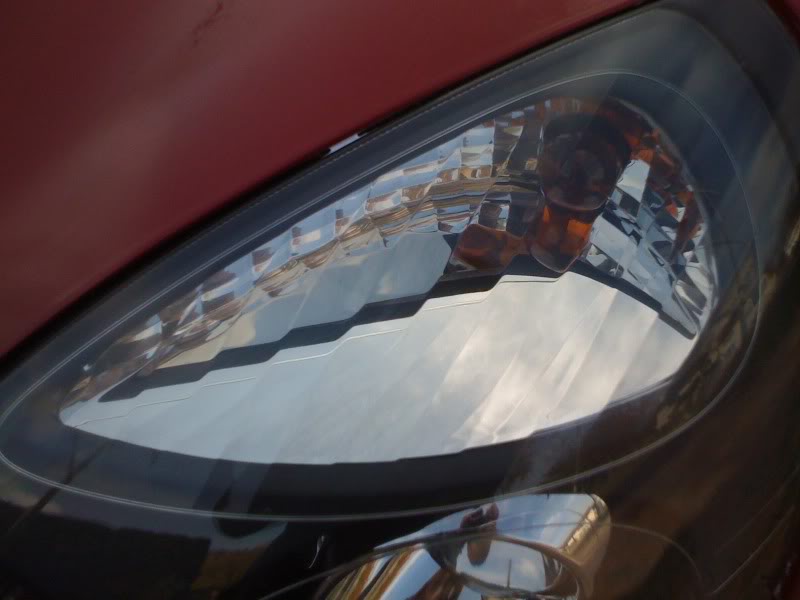

Close up of what was the worst bit;
That is all, was more a confdence thing really, now I know it works will probably do it all over again & spend a bit more time with the wet'n'dry to get it 100% scratch free :)
