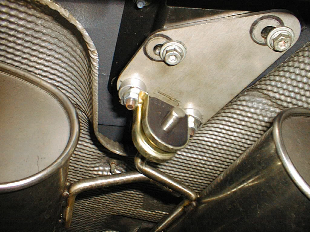

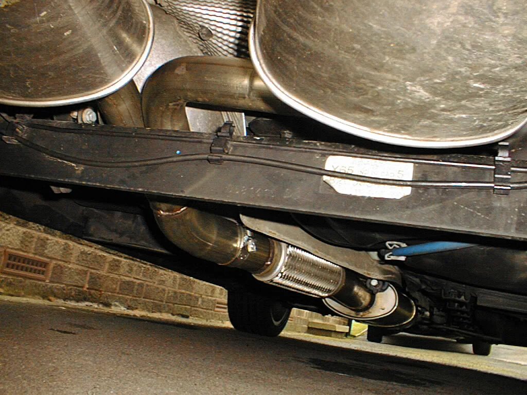

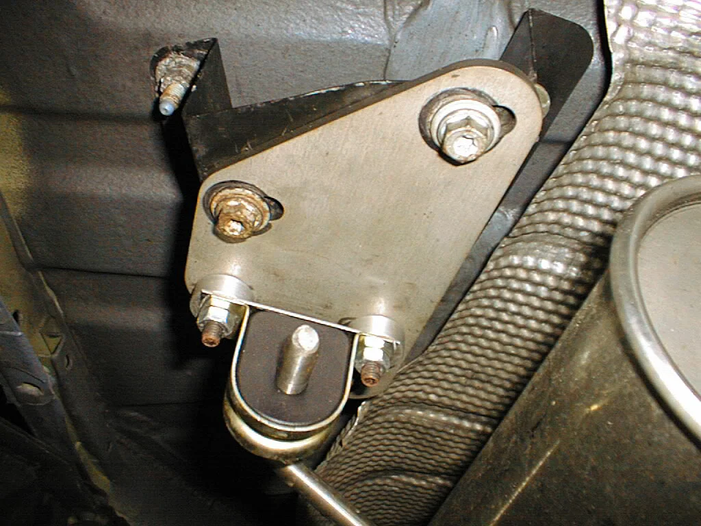

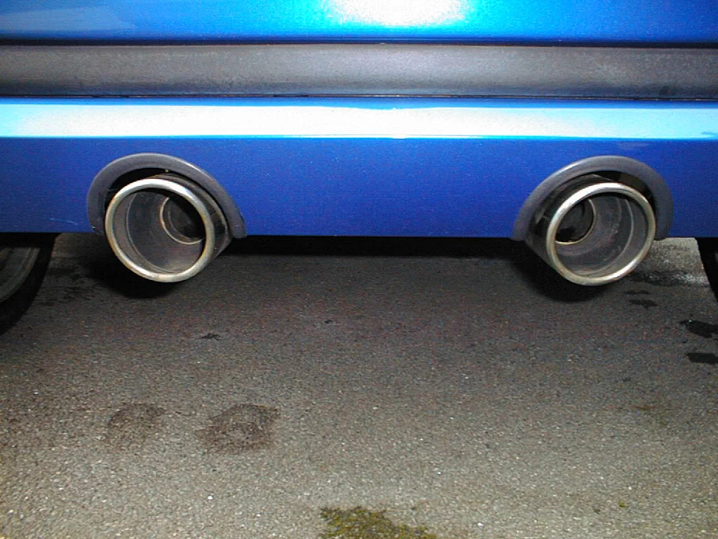

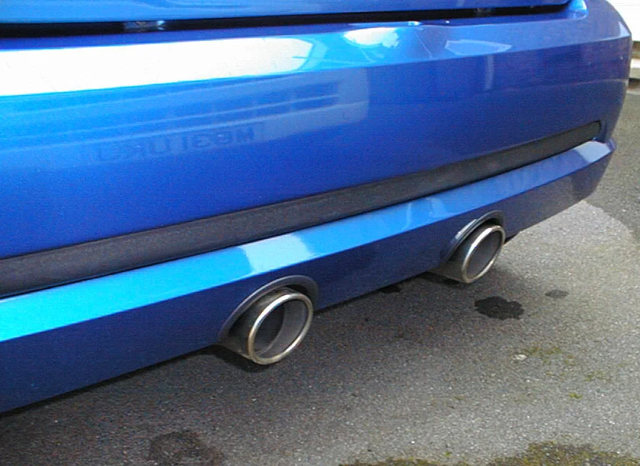

Hi All, i have managed to take some pics of the rear mounts which Magnex made at their factory, the rubber U shaped bushes are available from Magnex should they ever need replacing in the future, you can also see the 5mm spacers where the U bolt clamps on, these are also available from them so the height of the tailpipes can be alterd where they come through the bumper. I have also got a piccy of the flexible coupling which they installed between the centre box and the rear axle, this was added because when the exhaust got hot it tended to grow slightly in length, only a few mm, the coupling is designd to take this amount of growth.
With these mods the exhaust is spot on with no knocking or rattling etc etc.
