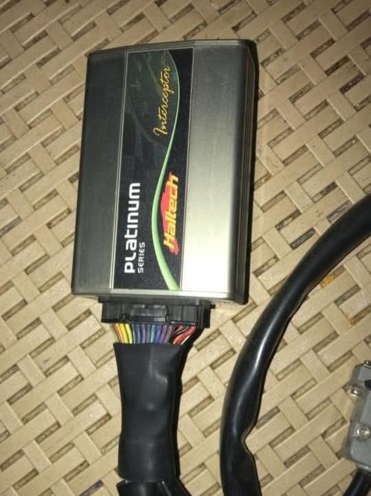

I am going to use haltech piggyback its old but it will done a work just I am building f4r engine with 197 pistons and non sport f4r cams so I ll need to play with the ignition deg but I am honstly ve a problem with a basemap I am f4r engine running on 1.6 immo off ecu file some one saying you cant puts 172/182 file on a ems3134 do I should to get 1*2 ecu kit or there is any solution for the present ecu

Fit a decent standalone ecu instead of piggyback, its much better overall. Ecumaster black, maxxecu, link all support the clio2 canbus so oem dash works ok
