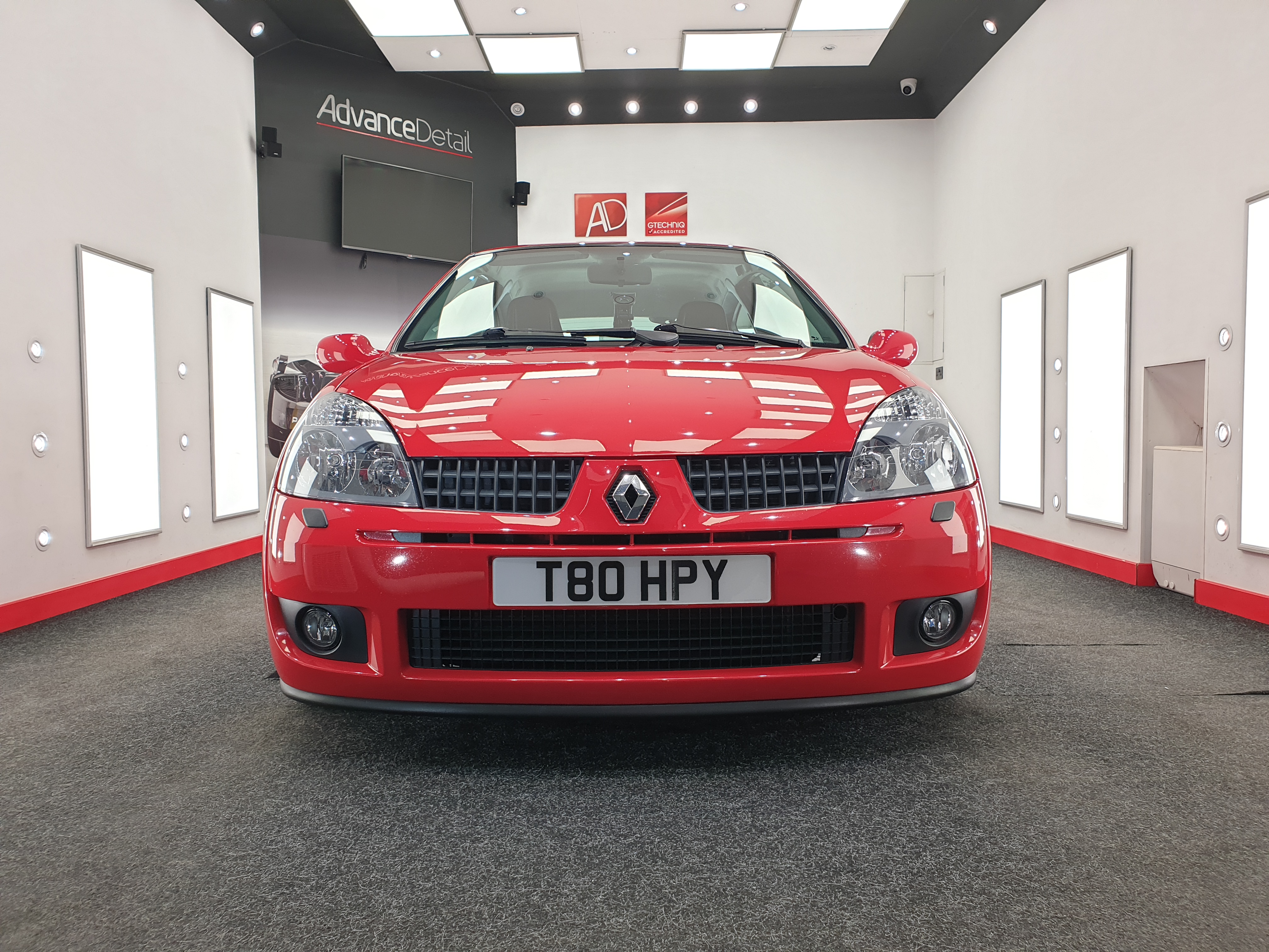

  T.Turbo

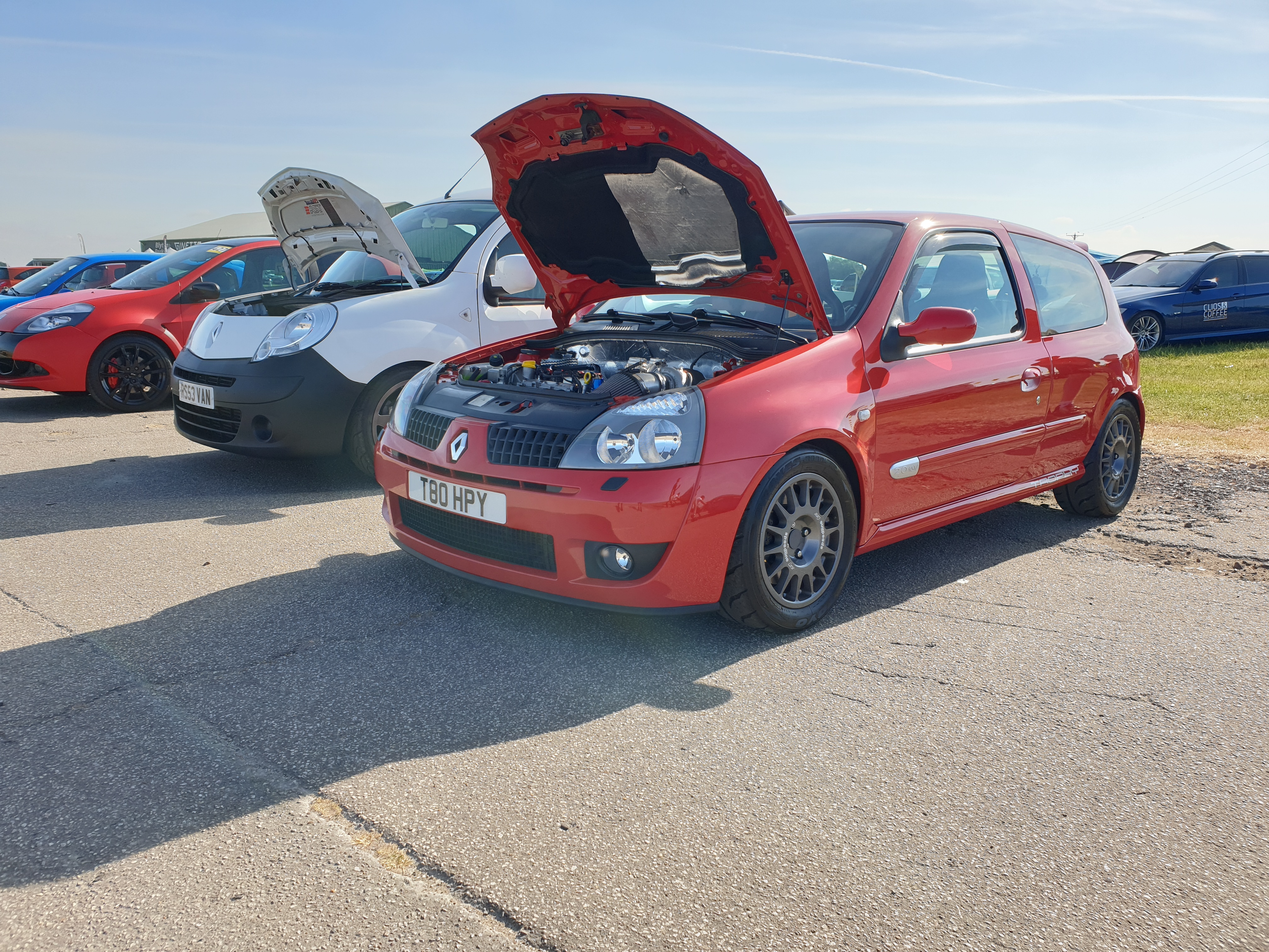

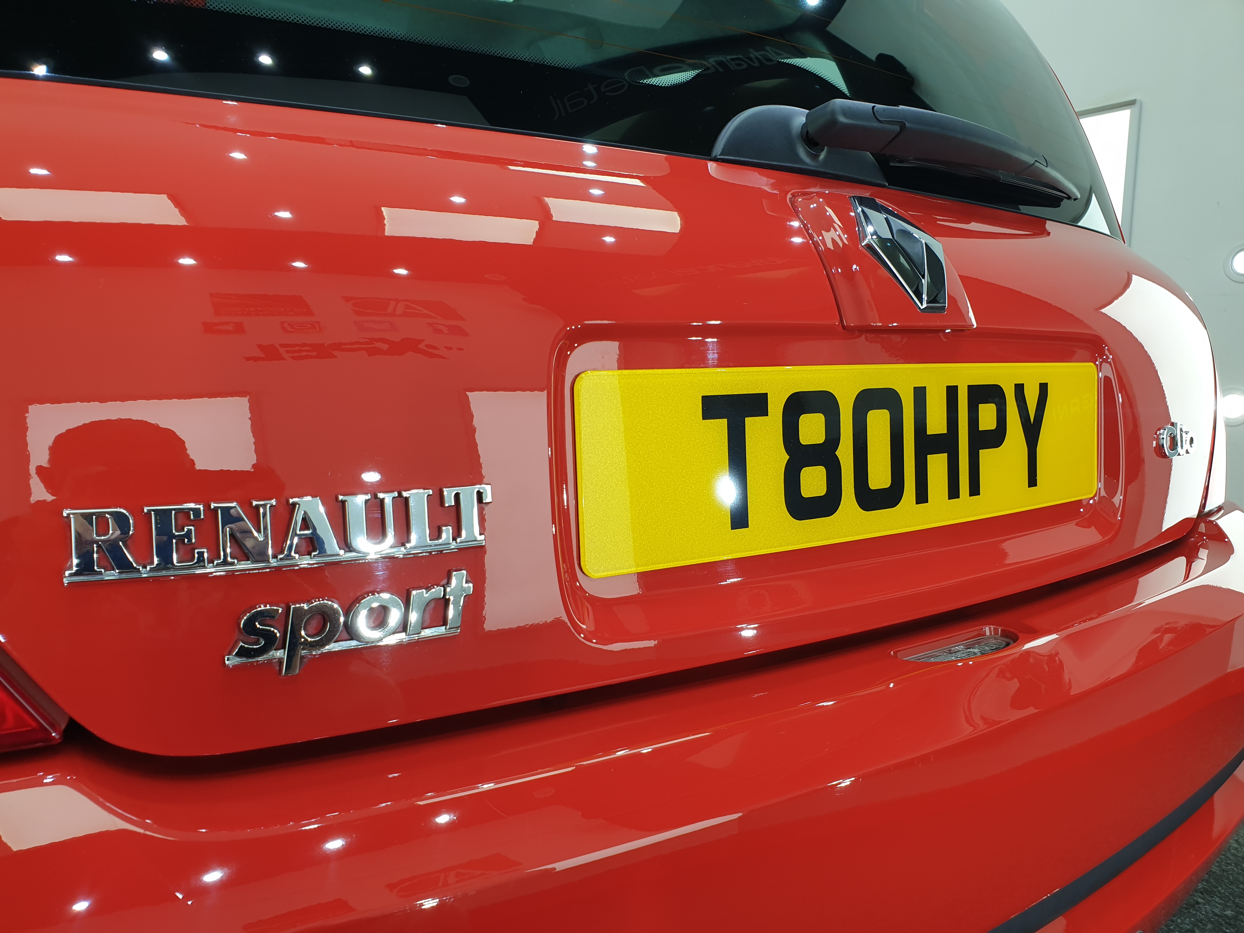

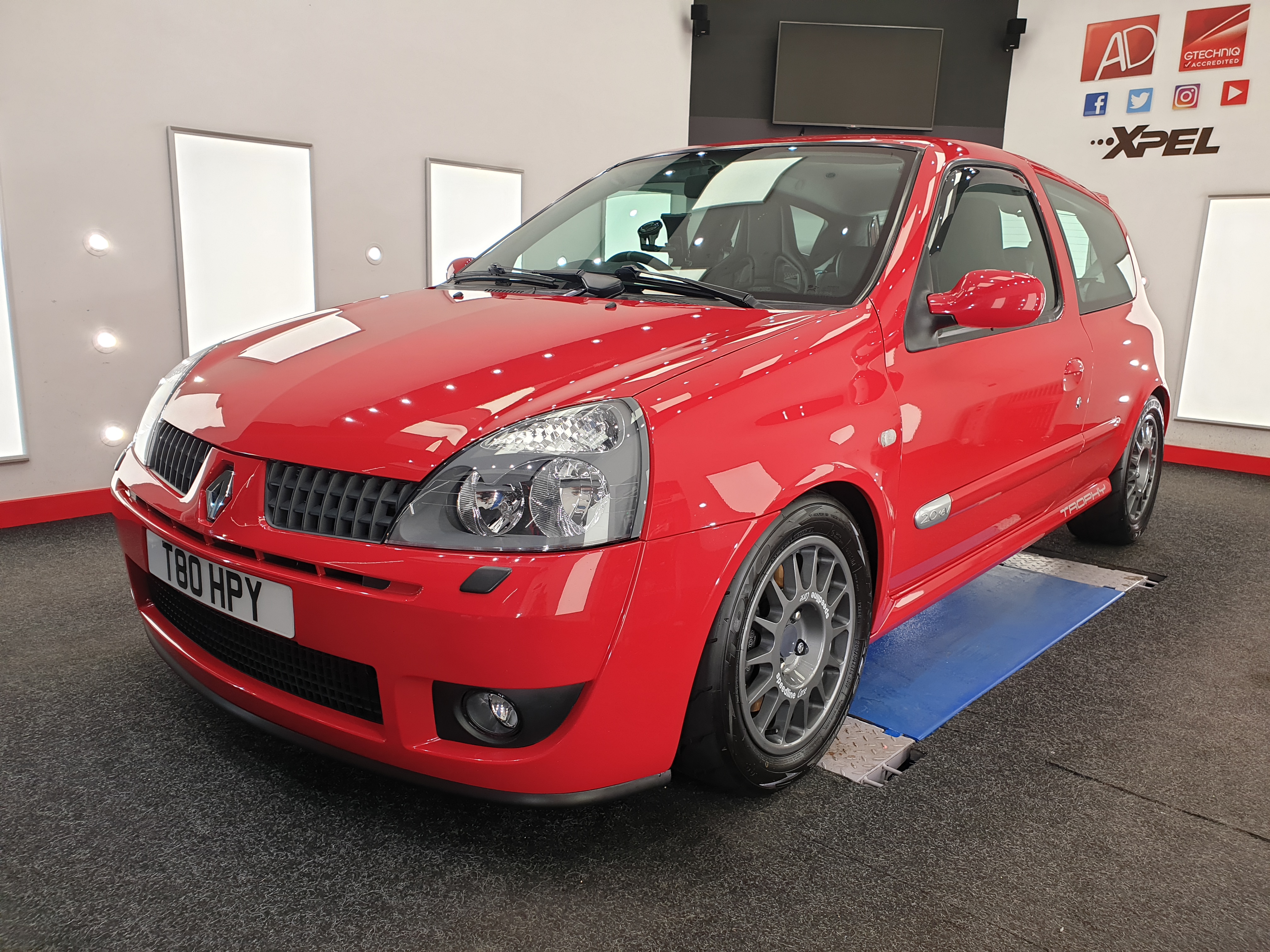

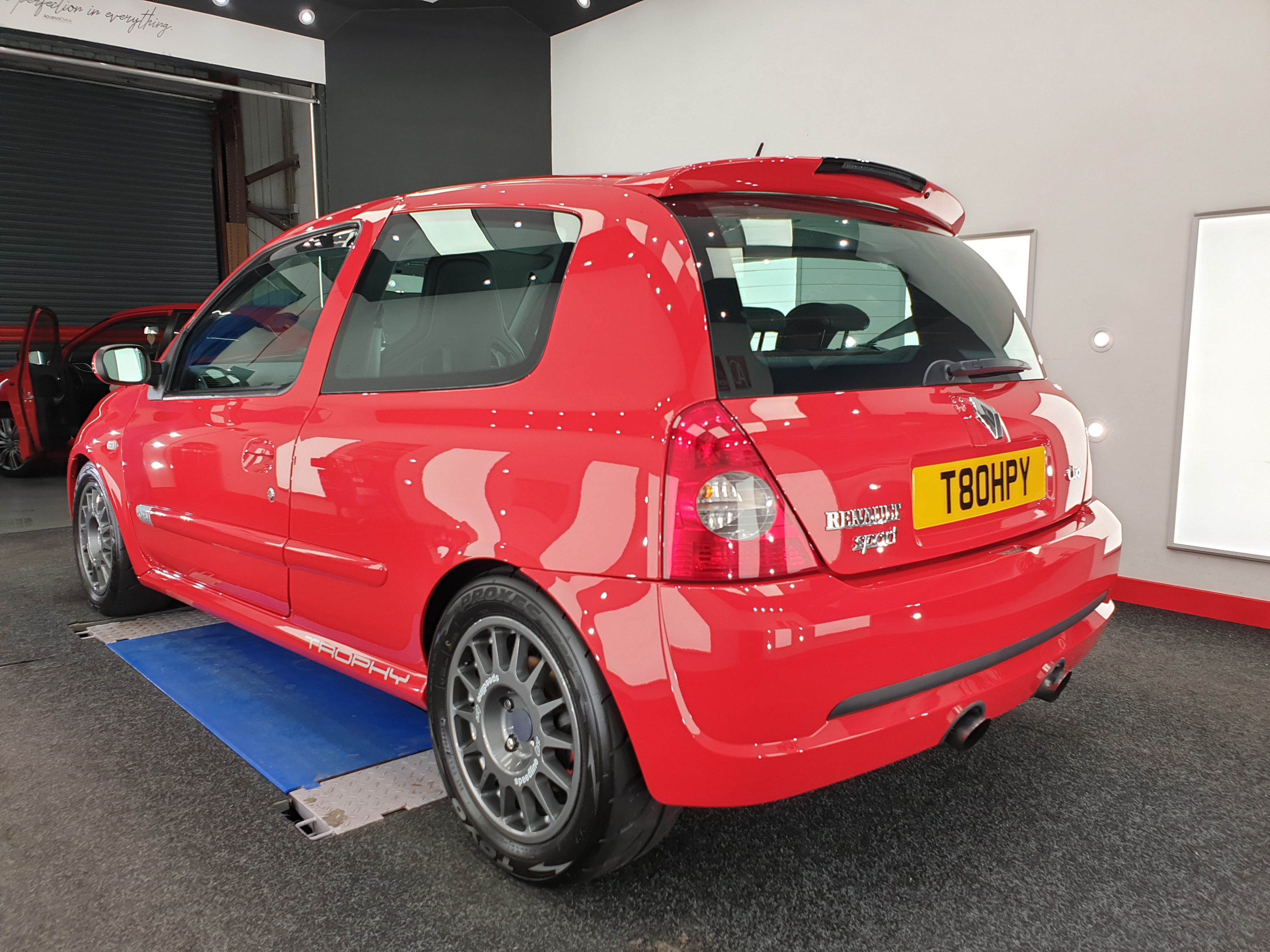

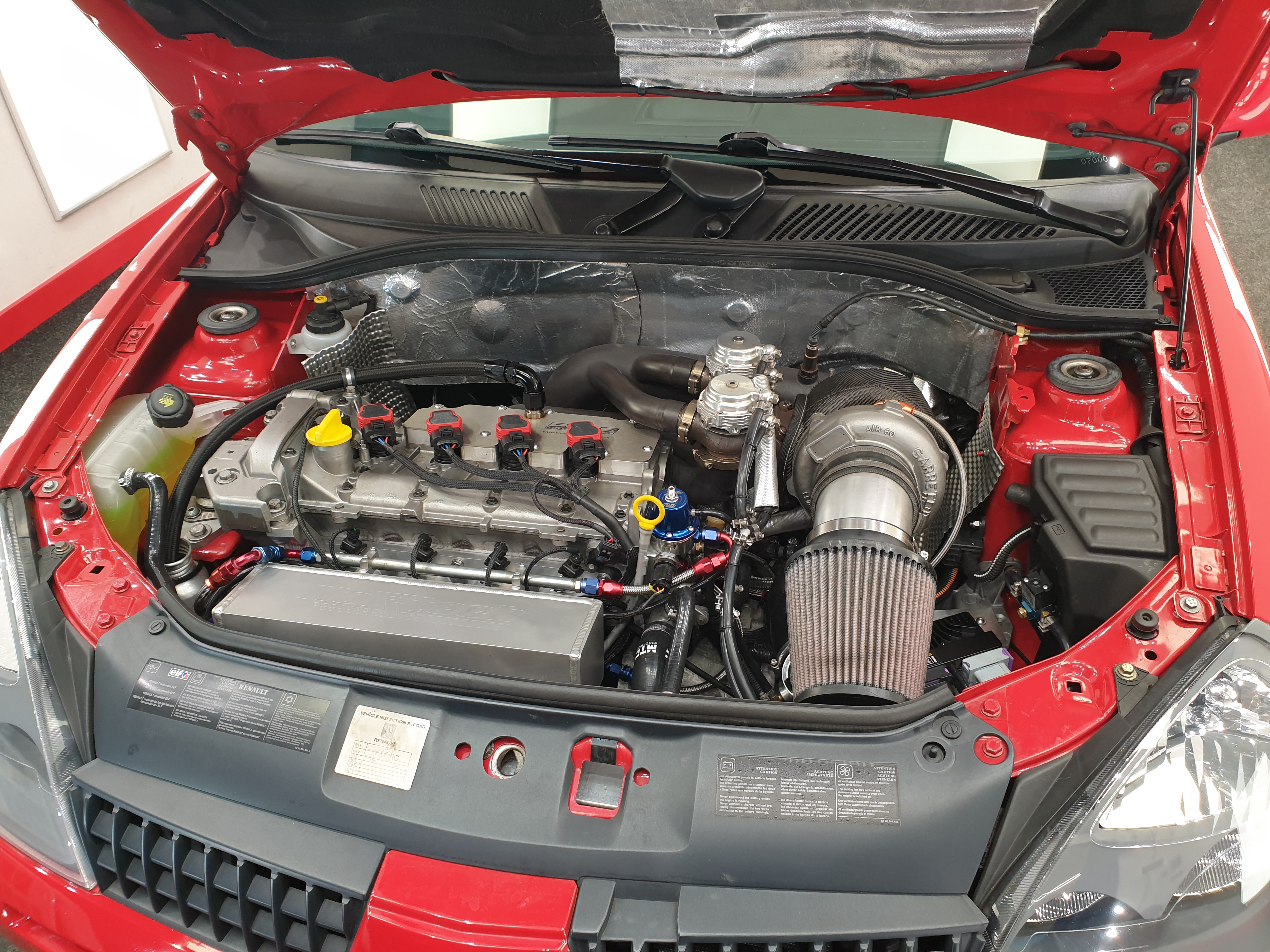

To update - We have purchased number 54 off Steve H back in December 2020.
After several months of rebuilding and furthur modifications its now road legal again and a few of you might have seen it at CS Festival yesterday.
Sneak preview, have approx 200 hours of updates to come in due course ;)
More to come soon!
Brigsy
  T.Turbo
What power is that running?😍
Currently 270ish hp @ 8psi wastegate prsssure. On high boost its 349hp @ 14psi, had to stop at that as issues with the fuel system so need to fix and revisit. 28psi should see some good hp mid to high 400s.
looks slow.....
Wanted to see if the kangoo could keep with it on way back from csf. Shez said no and next thing shes off like f**k in it. Oldskool racer tricks :LOL:
