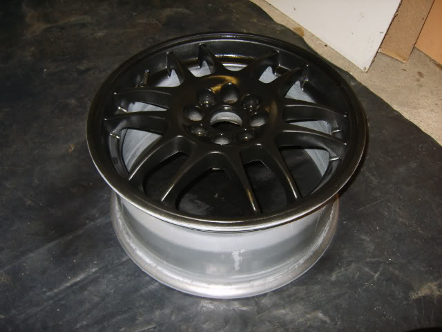

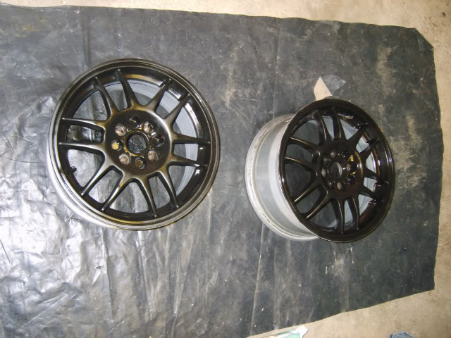

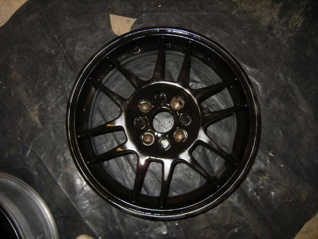

Yeah, think I need another. It doesn't fill in scratch holes very well though! I sanded my wheels all over first to get good adhesion without using their primer. It doesn't seem to rub or scratch off after one coat, but coarse sandpaper removes it.
Its a matt finish and I'm tempted to use the plastidip as a baselayer, then spray filler primer on top. Then a gloss black and lacquer like normal.
If you want to peel it off, it seems like you have to do a fair few layers. If you do one or two layers, your more than likely going to have to sand it off, hence me thinking of using it instead of an etch primer.

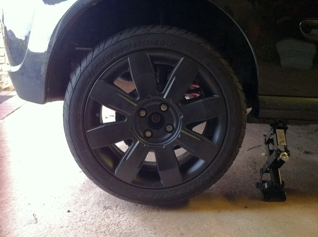

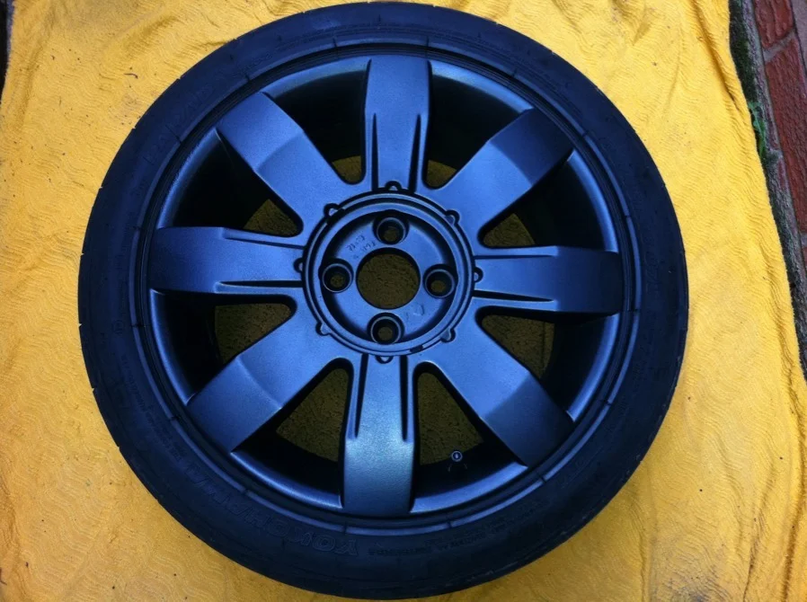

Just a couple here, only one coat on the face of the alloy. Gives a textured rubber kind of feel, which is different.
  2014 Clio 200t edc
They look really good!!! Depending on how long it lasts, might give it a go. Looks foolproof... Lol
  BG 182
Its even easier to spray than normal spray paint. Its thicker and you need to apply it a little thicker and doesnt run as easily either. Really is worth a go guys, seems like good stuff. Although i dont know if its ideal for wheels... Ive decided to just use it as a basecoat.

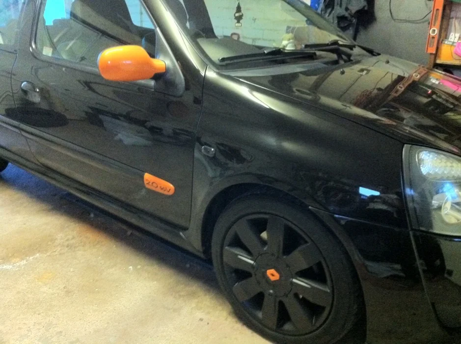

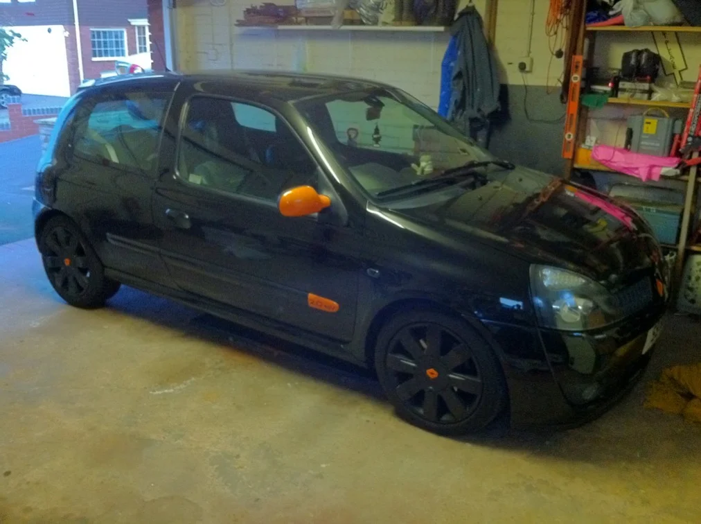

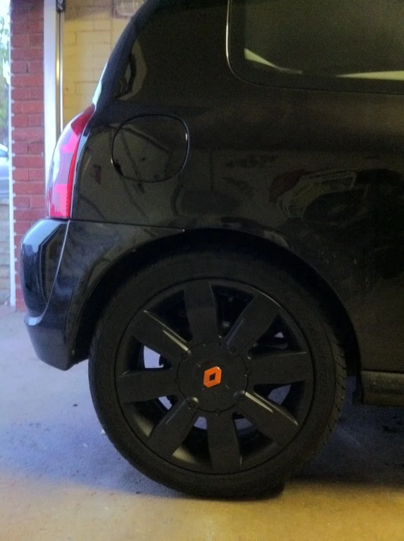

Quick update with my progress so far...
Two wheels done today, last two to be done tomorrow if all goes to plan.
They were never going to be perfect but for the price I can't grumble, they look a damn sight better than before as all the paint was chipped and peeling!
Looks decent mate :)
DaveDreads
They look really good, I like the contrast between the textured matte black and the gloss orange.
Is the orange Plastidip with the clear coat, or it is normal paint?

Cheers, I think they've come out alright tbh. The orange is real paint, sprayshack on here did them for me. The plastidip is just matte, haven't decided whether to lacquer yet but think the matte looks a bit more aggressive tbh...

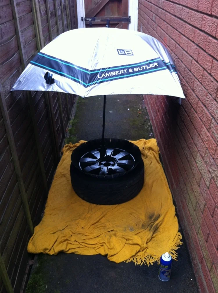

Here's a couple more, crappy iPhone pics with my makeshift spray shelter lol

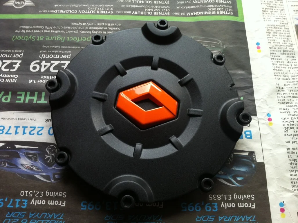

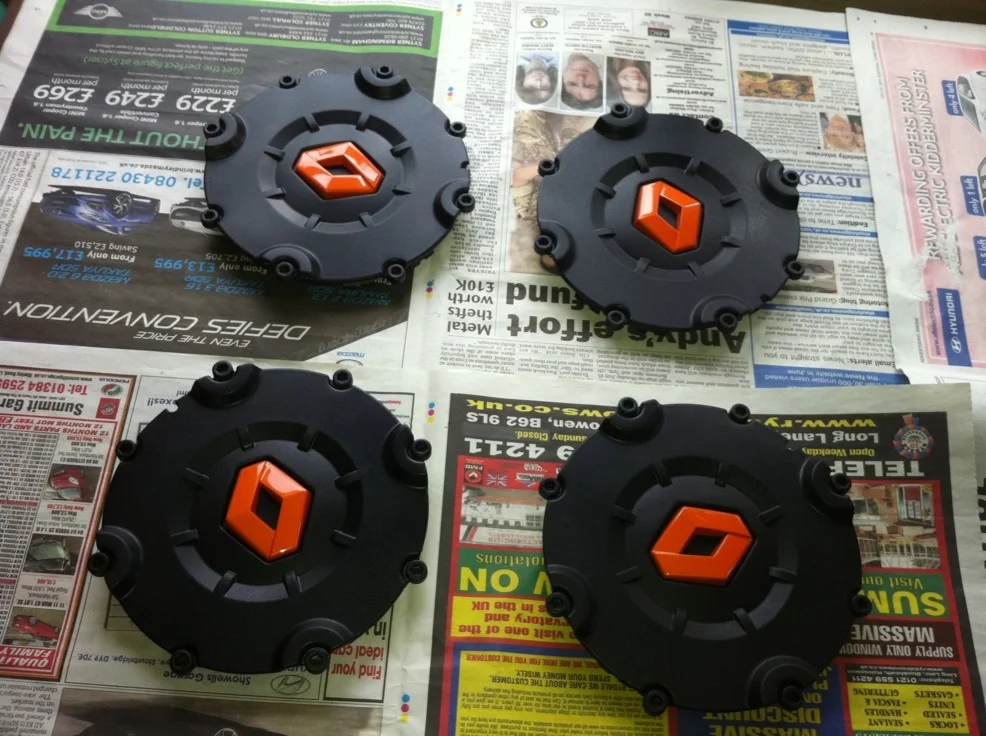

  Dynamique S TCE
I really like how those look, Im guessing you did the centre cap in PlastiDip too? (Excluding the Diamond ofcourse)
