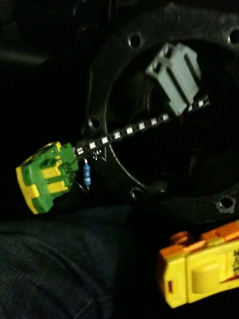

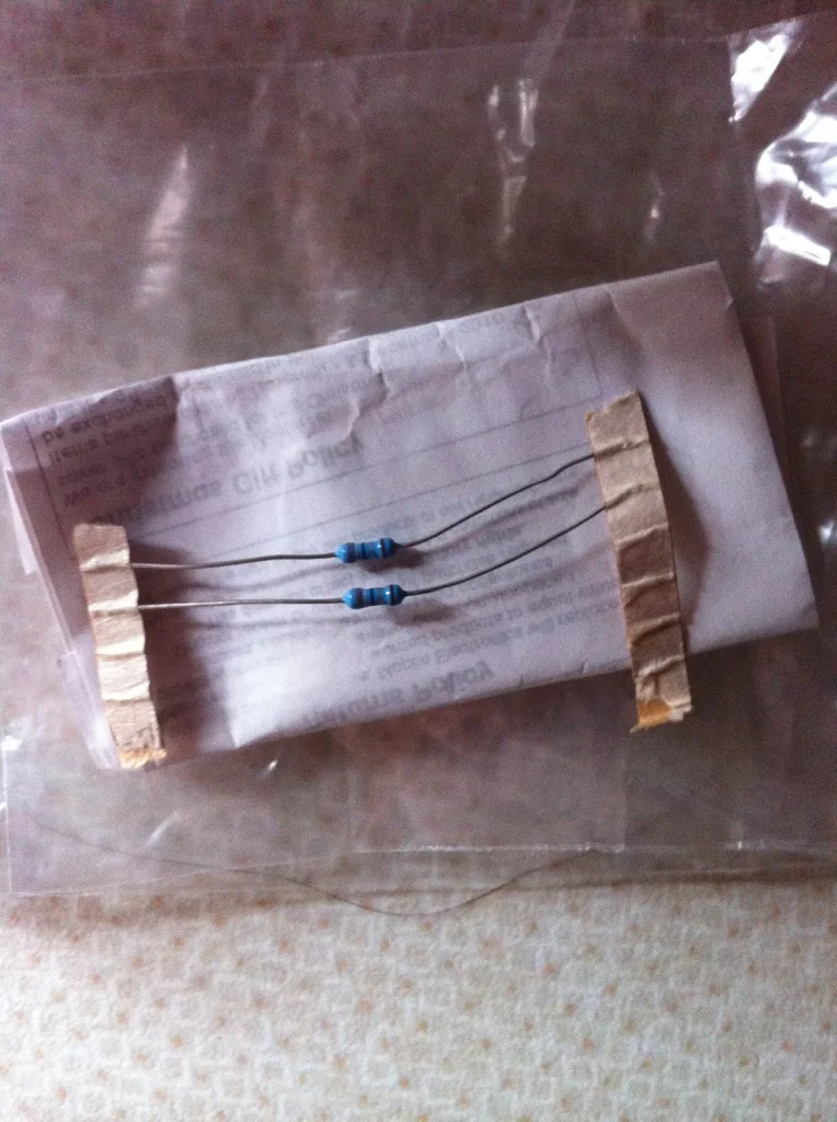

It is very simple, all you need is:
2x (thats two) 3.9 ohm resistors. They look like this
The code for these are: M3R9 = 3.9 ohm and you can get them from Maplins (the electric store) they cost around 28p each. REMEMBER you need 2 of them as the steering wheel has 2 airbag conectors.
When conecting them to the airbag conector block double up the end of the resistor. Simply fold the end over, this is to ensure a good conection is achieved as the wire is very thin. I think i actually may have trippled the end of mine.
P.S. im sure you can use between 3.2ohm to 5.2 ohm or something like that but i am advising you to use 3.9ohm, its in the middle of the range and i can gaurantee you they work. They are what i used and 2 years on the dash lights are still never to be seen.
