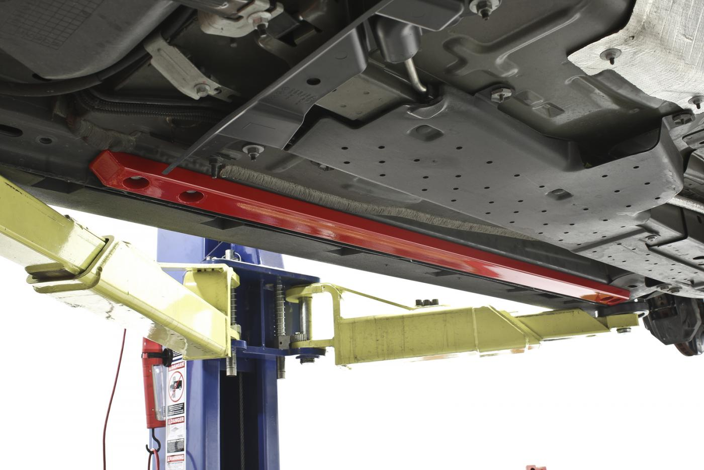

Thats not a bad shout, but I've never had much success with things which trap moisture/dirt like a seal. I even consider welding plates across each end of the beam with a hole in to accept a BMW puck style jacking cover.
But lifes too short. However Im still keen to make up some jacking bars this summer. Basically a 1x1" box section running down the full length of each sill, on the inside of the seam. So you could jack the car up at will anywhere on either sill without hurting anything. Haven't figured out where to tie them in yet but would make jacking them up and supporting less painful.
I was thinking about something you just pop on before jacking then remove. Would literally take seconds I should think
