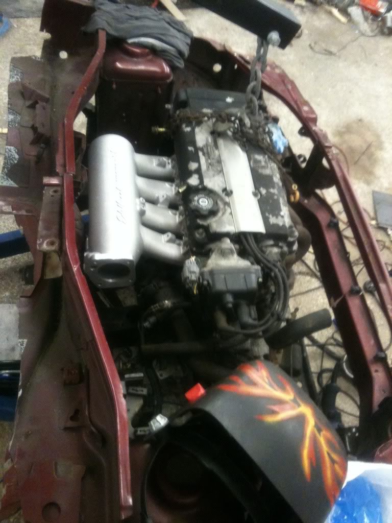

This is my in progress mk1 clio build, b18c4 has solid lifters and an LSD as standard in the box too which is a good cost saving on both fronts when building a "proper" motor.
