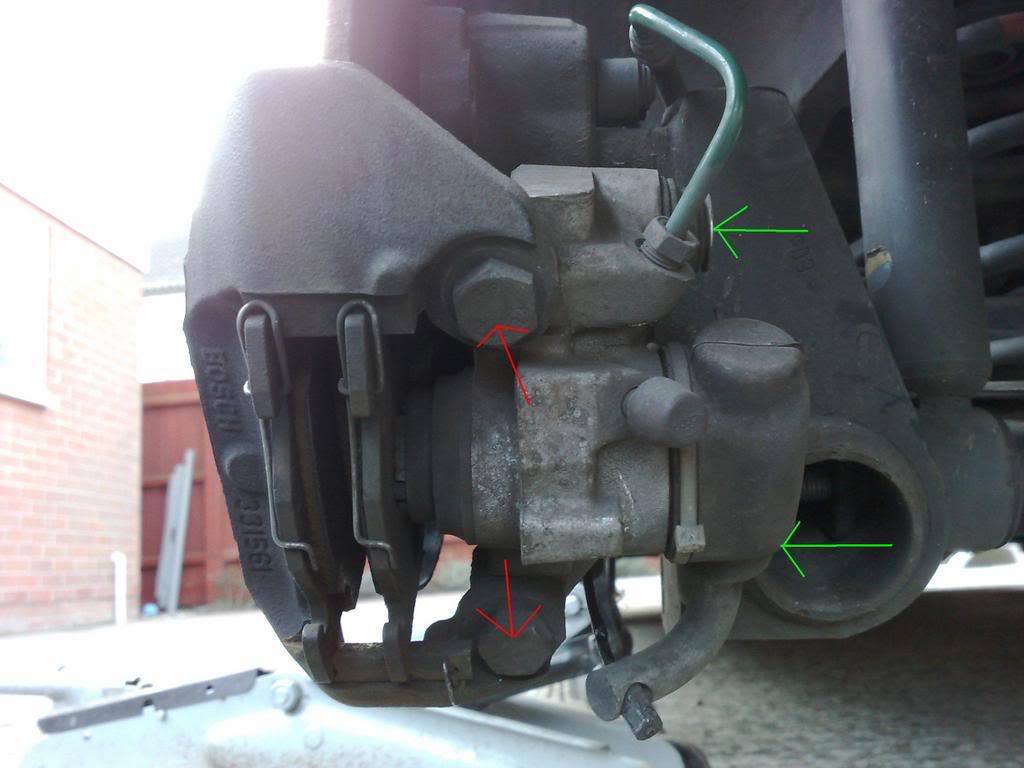

I went out today to change the discs and pads on the rear of my 182. I bought genuine Renault discs and halfords pads. I got everything off no problem, fitted the new disc no problem. I went to put the new pads and holder back on, but I can't get the 2 bolt holes to line up. It looked to me like the outside pad was too thick, so I got a micrometer and measured it. 11mm on the button, just as Renault specify. The two bolts I'm talking about are the ones with the red arrows (pic stolen from guide):
I've wound the piston back so there's plenty of space, so that's not the problem. It looks like the outside pad is too thick and won't allow the holder to move over enough, but as I've said they are the Renault specified thickness.
I'm not exactly Joe Mechanic, but I'm not sure where I've gone wrong :S

you dont need to undo the bolts arrowed in red.

Is the caliper assembly free to move on the slider pins?? ie move from left to right (and vice-versa) in the pic??
as above they slide on the caliper assembly from green arrow points. just give it a tap
I didn't try that, I'm sure that's what it will be! It's getting dark now but I'll try this tomorrow. Many thanks!
I had to remove the bolts as I was replacing the disc as well.
It would be worth taking the slider pins out anyway and giving them a good clean and some fresh grease.
good idea to make sure the tiny boots over the sliders are located over their lips after you've done as well, as they easily pop off whilst fiddling
Thanks guys, I took the pins out and put some grease on them. They had no grease at all on them, and they've not been off since the car left the factory. The caliper seems to slide a little easier now.
I got it all put back together, it was still a very tight fit. The pads seem a little tight against the disc, but I assume they will slacken off once I get some miles on them.
