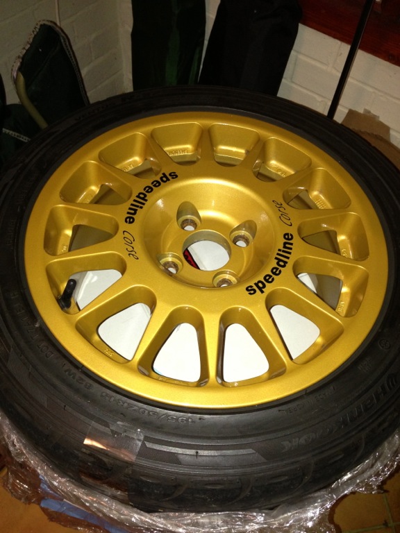

2118's should be arriving tomorrow also, so need to make a decision regarding the colour keep them gold for spray them up anthracite???

What offset are the 2118's?
ET38 I do believe so should hopefully negate the need for spacers! looking forward to see what Hankook RS2's are capable of..

Im not sure Jon I'm rather torn in the pics the wheels look mint so would be a shame to go over that finish i suppose..
If theyre the 2118s that steviant had off me, they were powdercoated in an Aston Martin bodyshop & the finish is very good. Tom@JMS had them done by Ollie82 at his old work for the racecar.

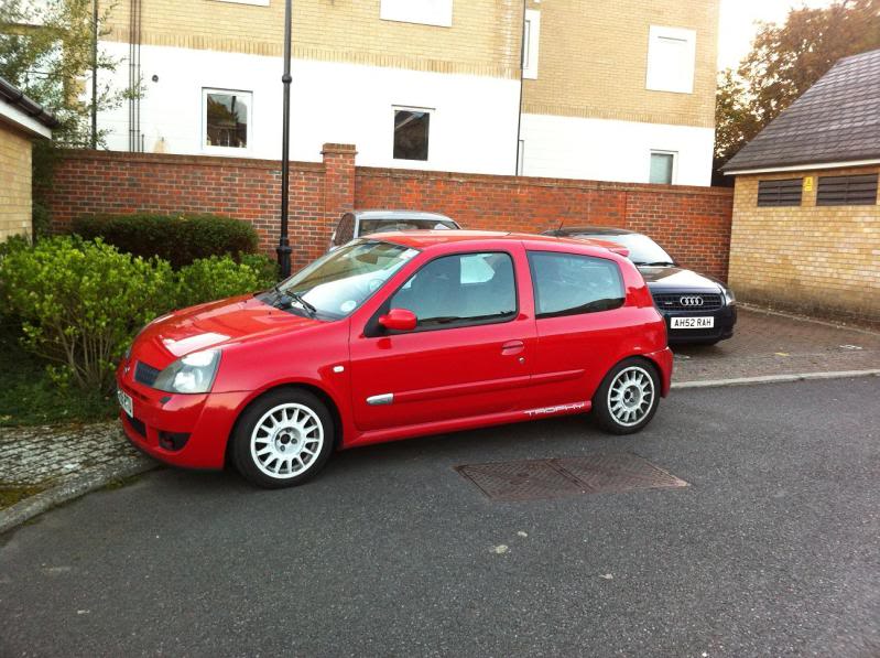

Did anthracite:
Then Nick did white(ish):
For whats its worth, i think they would have looked lovely, although i did have a habit of doing things just to go against the grain.

They look so good in gold, it would be a shame to have them refurbed in a different colour. I would liked to have bought these, but already have two sets of 2118s.
If you respray a mint set of wheels, I'll come round and shoot you.
After all, they're track wheels, right?
Im gonna give them a chance in Gold I think, can't promise they'll stay that way but for now it would be silly to ruin such a good finish with a DIY rattle can job...
and yes Jon just for track days ATM until i fall in love with how they look on the car then you never know lol

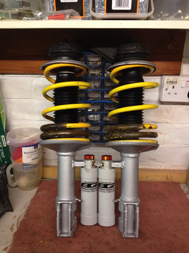

Have you got any springs, or are they going on the standard setup?
Awesome, I'm only really saying it because I REALLY want to see how good they look on the car.
Standard (aka 4x4 height) for Llandow after that I'm not sure, Want to see what the car is like in standardish form until I decide to start messing with suspension etc
If I like It then cooksports might go on to loose some of the arch gap
Pretty sure the dampers are unpinned btw.
Might be wise to ask Sam@btm what setting is a good starting point for track.
ye I've had a quick chat already with him and indeed the dampers are unpinned so can tweak in on the day with the advice of a few people there hopefully, anybody know how many clicks are on the sachs from full soft to full stiff?
43 If I'm not mistaken. They should both have yellow markings that line up, So you know when they are in the middle. 21/22 clicks in.
You can see what I mean here:
Ye there still on the yellow markers ATM Jon
So basically BG mark them up as half way as a good road compromise? Ill start off leaving well alone then look at possibly increasing the stiffness later on in the day
Yep that's right mate. Same position as what Renault had them at as far as I know.
^ This. 22 clicks in is standard and how BG set them up after refurb and unpin.
