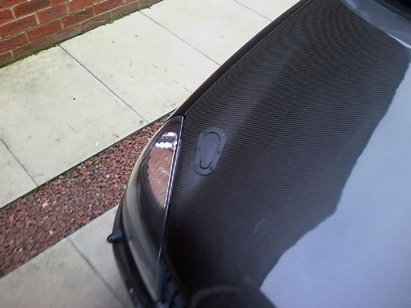

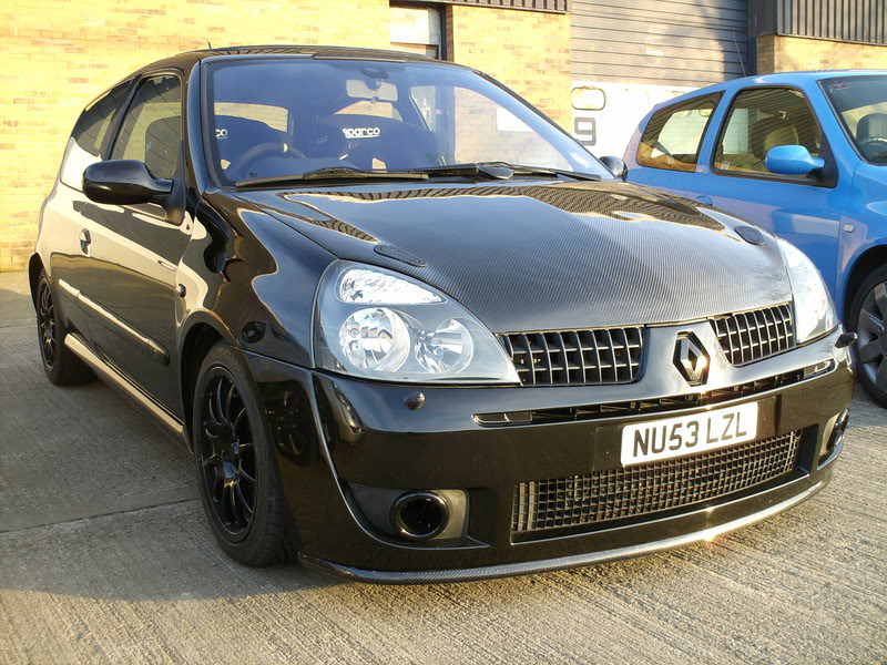

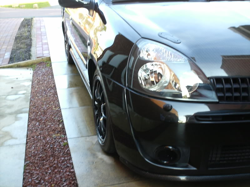

got myself a carbon bonnet from riri on here got it installed last week so after karting on the weekend i went about putting the aerocatches into the bonnet.
i managed to scuff one side as i wasnt watching what i was doing put it'll touch up
seemed to be a simple process of:
mark pins in slam panel as far in as i could go
drill holes in slam panel
put pins in slam panel
but blue tack on underside of bonnet and lower
where blue tack is indented drill a small hole through bonnet
use the hole in bonnet for crosshair line in aerocatch
stencil catch and then cut it out using special tool :)
remove more carbon from underneath to gain acess to bolts from aerocatch
fix aerocatch to bonnet securely
keep adjusting pins in slam panel until the bonnet correctly closes and is secure
job done
heres a couple of pics of the result:
looks really good in the flesh and is defo alot more trick then popping you bonnet from inside the car :)

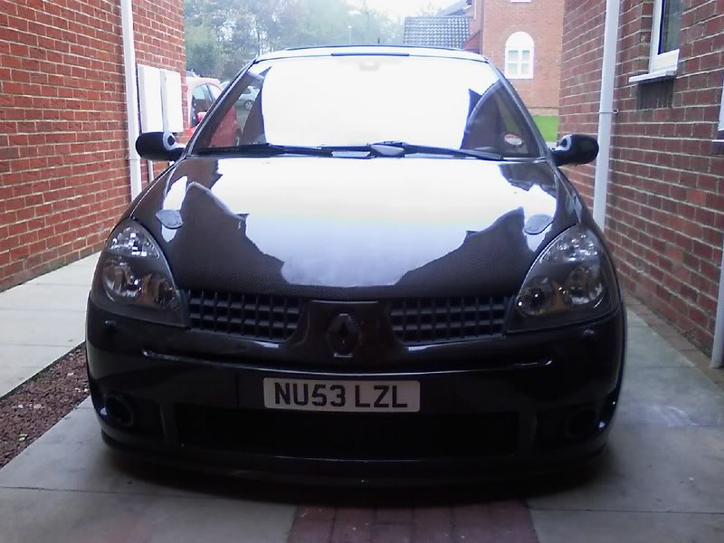

NEWS TODAY - just fitted 172 wings! hoorah only taken me a year just got to fit side skirts now :)

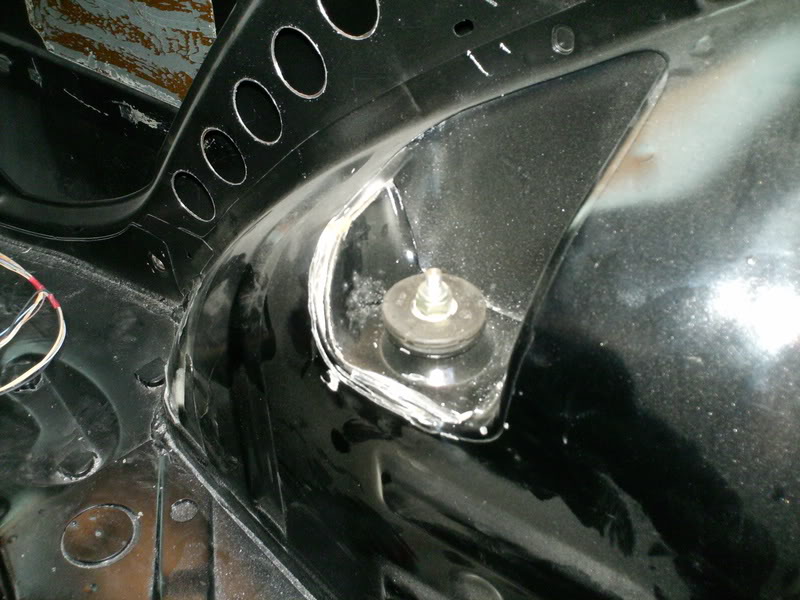

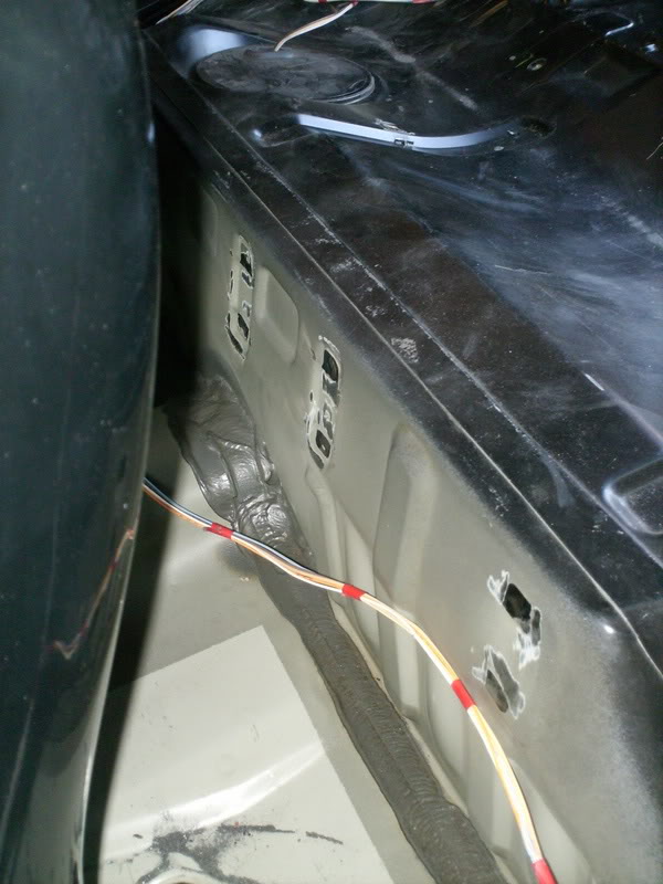

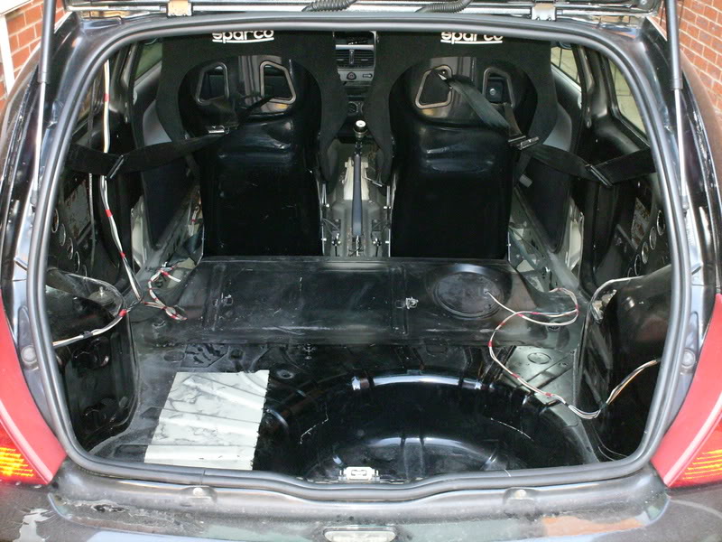

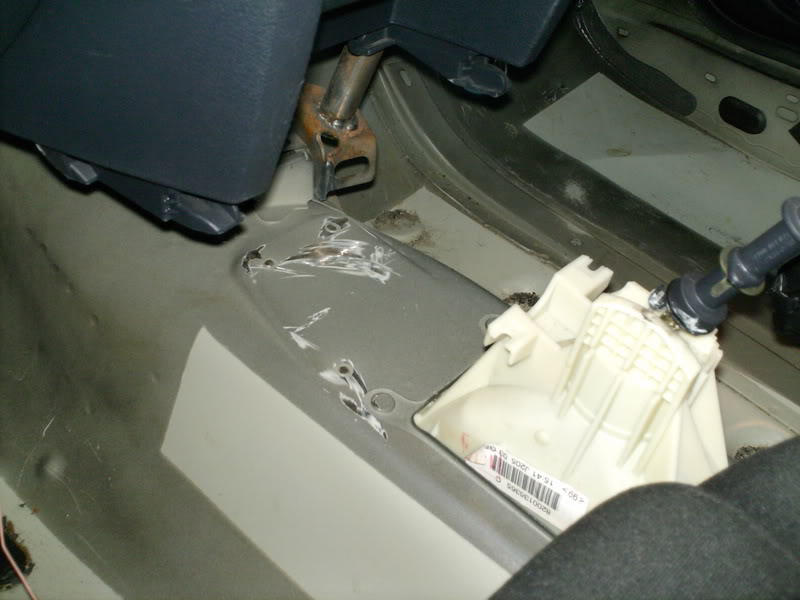

reeet since as though i'm waiting on parts being delivered and had nothing else better to do i thought i'd crack on with finally removing unwanted brackets and bolts in the car so armed with my tool but no safety gloves,goggles or ear protection i went about my business
(wish i could afford safety gear :dapprove:)
cut and ground and smooothed down :)
same here
and again!
managed to go through the arch on the lower section making like a 1cm hole lol have it patched when cage goes in
dirty shot from outside the car can see the damage on my rear bumper to :quiet:

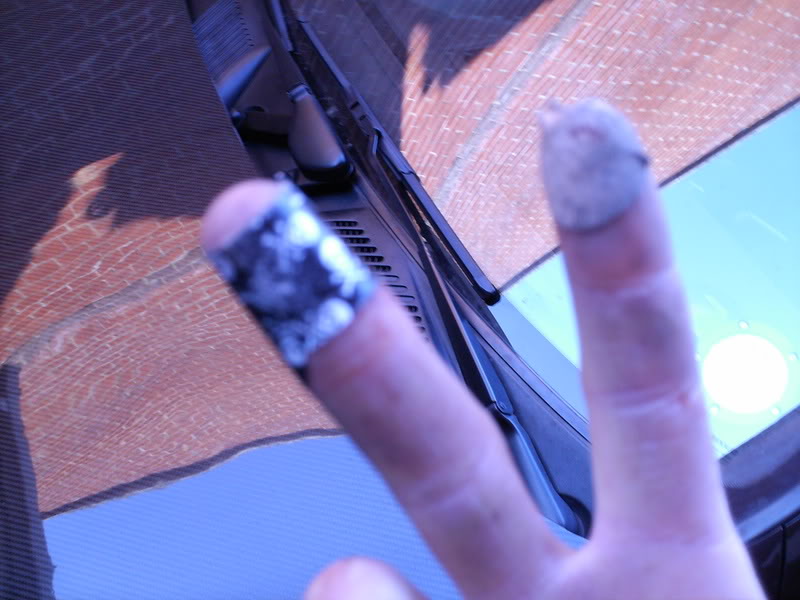

no safety gear i manage to cut myself twice due to being an impatient mofo
hehe and my ears are ringing i'll never hear that tone again :boring:
hopefully some parcels soon!

Looking good, lol at the plasters. Get some gloves Bruv. :rasp:
  80MPG BEEZA
skull n cross bones ftw!
its my bday next friday i'll try and get some gloves aswell as going to see rambo :)
