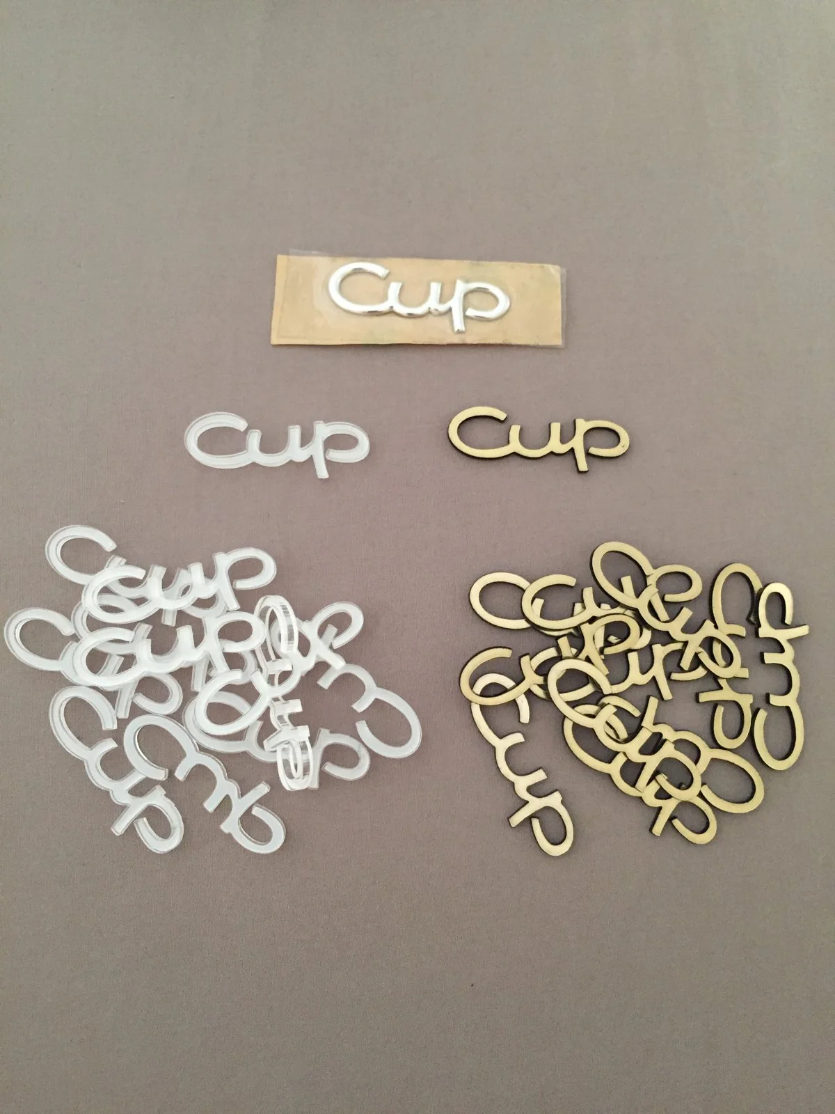

So I finally got my home made 'Cup' badge back! Quite excited about this as it's been a good month in the making!

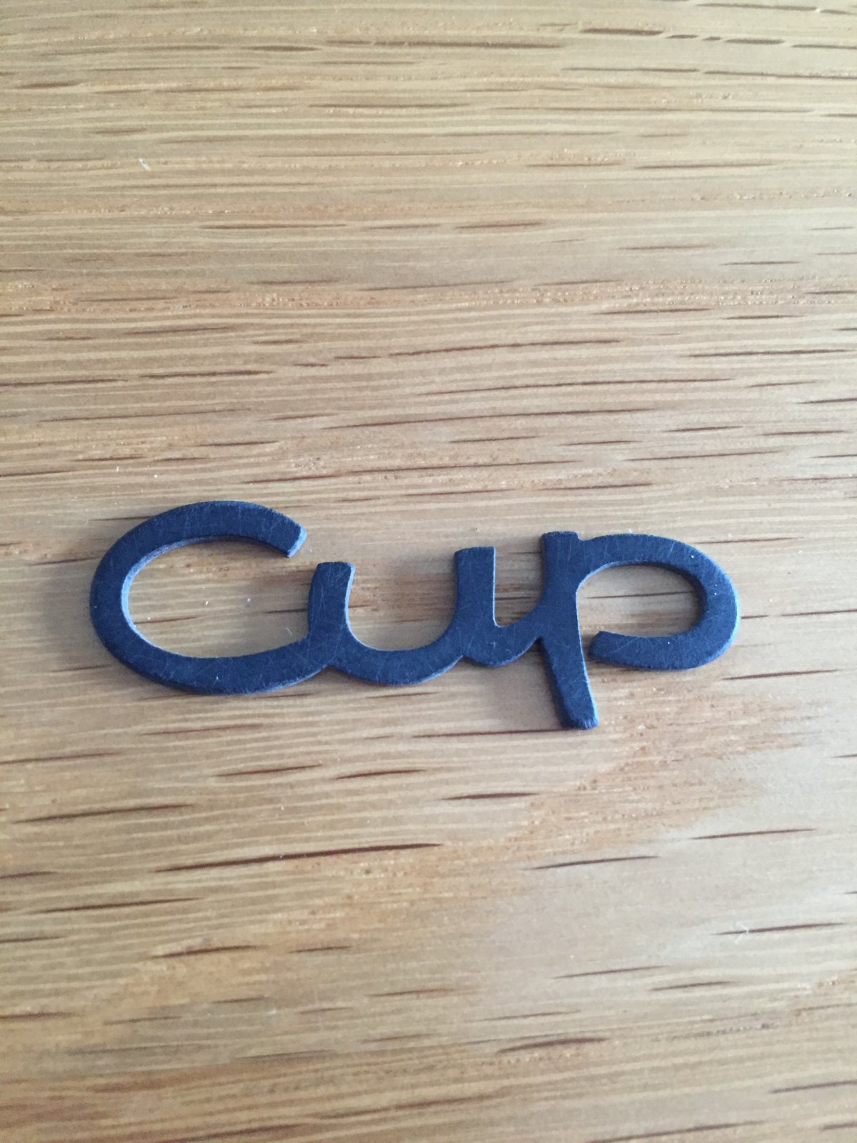

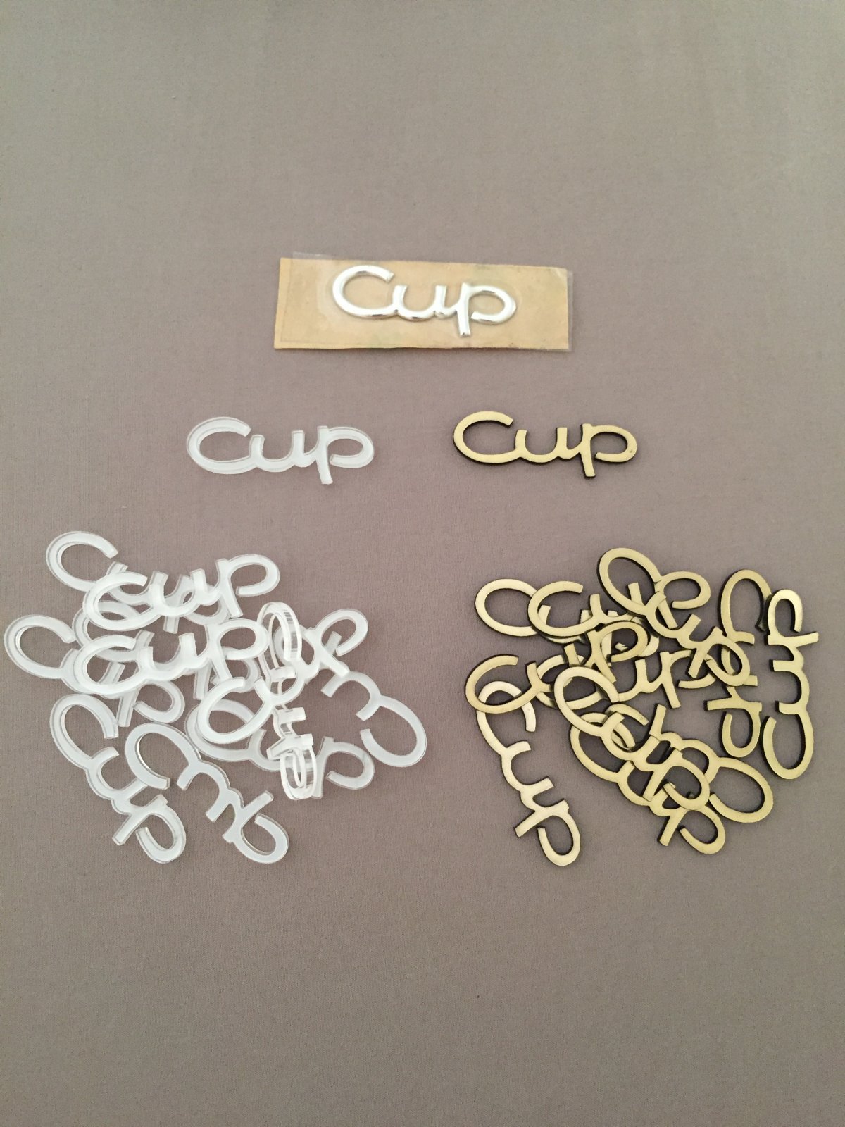

As I wanted an original 'Cup' badge and Renault didn't make them, I had to find a way to make a badge as near as possible to the original. I contacted lots of 3D printing companies thinking it would be a very straight forward thing but nobody wanted to do it, or felt they could do it justice.
I ended up being reccomended a local business 'Braunston Ltd' who cut me 20 badges with different thickness. The clear ones are just too chunky whereas the black/gold ones were perfect. You can see the original Renault badge at the top.
The badges before I started sanding or smoothing offered up next to the original -
I sanded them down to try and smooth the face of it as they had flat edges. I then bought some 'Chrome' paint, naively thinking it may produce a good match to the original. They look nice but more of a silver than a chrome.

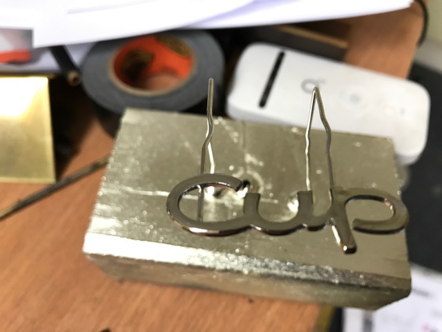

I found another company who chrome items, they are used to doing bigger jobs such as shop mannequinns and other bespoke parts but said they could do the badge for me. Here is a picture of it being finalised -

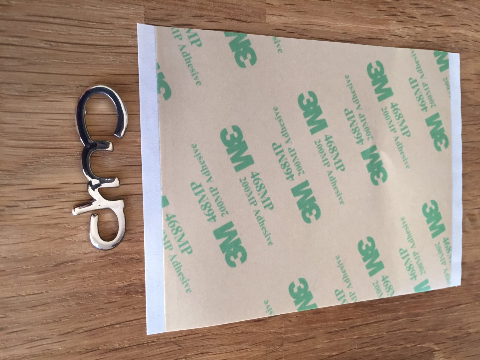

So far so good, but I needed some special double sided adhesive. I searched the Internet and found out about the 3M 200MP adhesive that's used in phones to hold parts together. I've spent the evening prepping it and cutting around the shape of the badge -

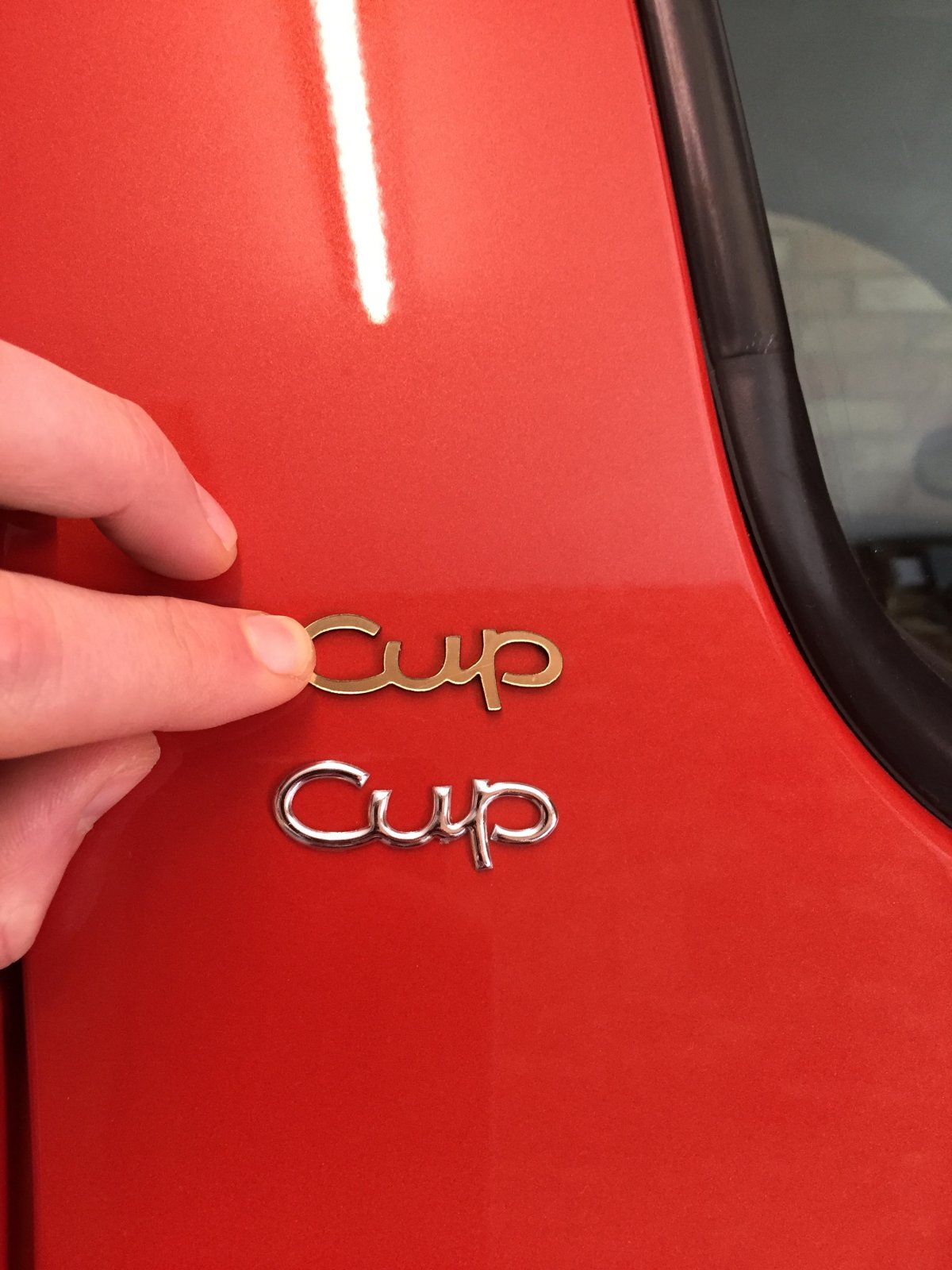

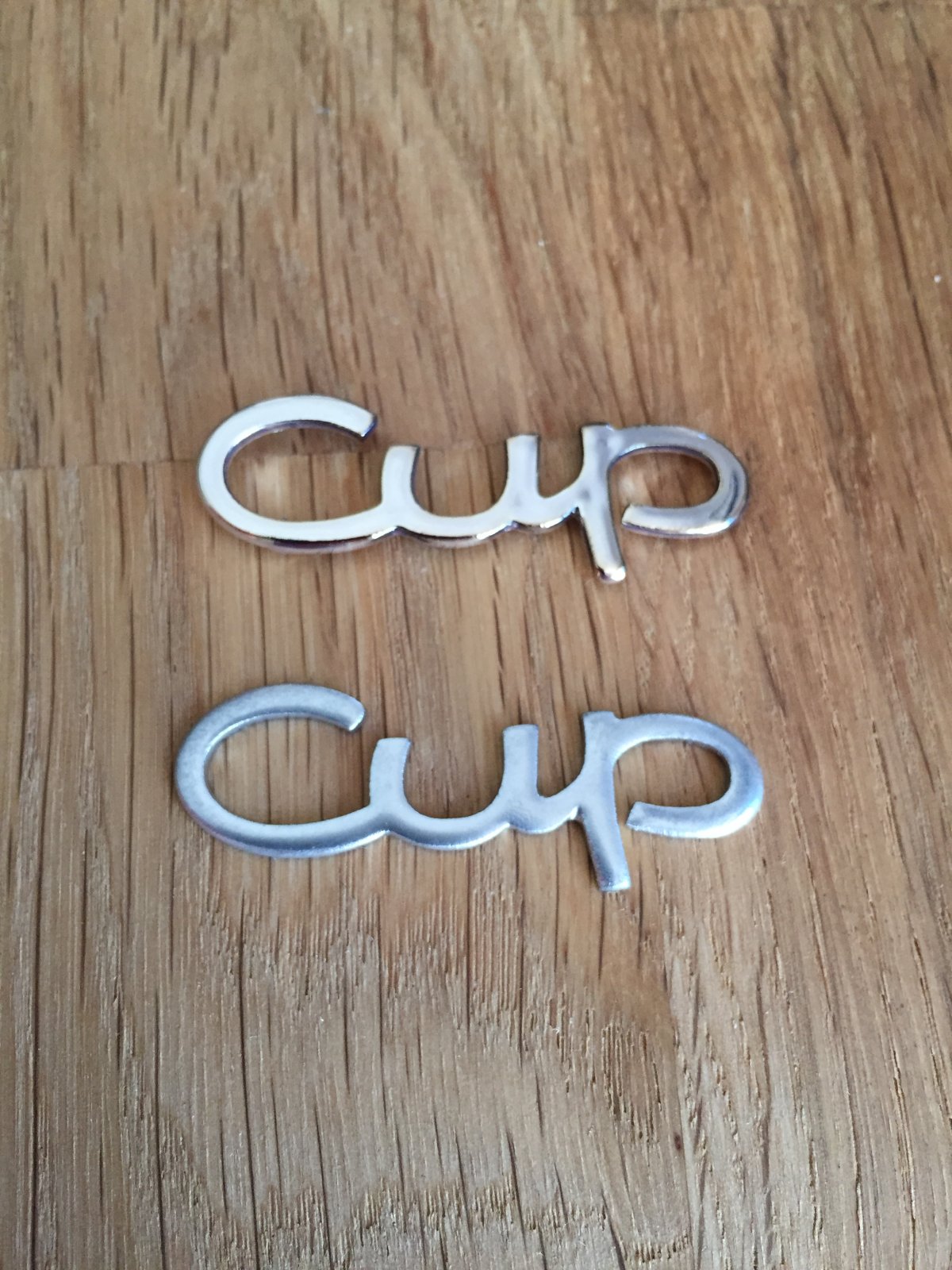

A comparison of the 'chrome' paint versus the chromed version -

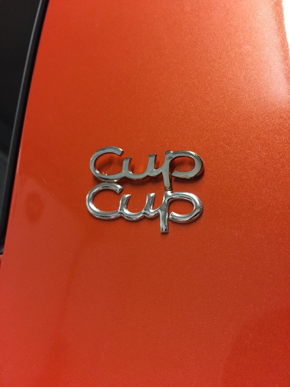

I again offered up the new one next to the original one for comparison, to see how it matched up. I was pleased with the final outcome -

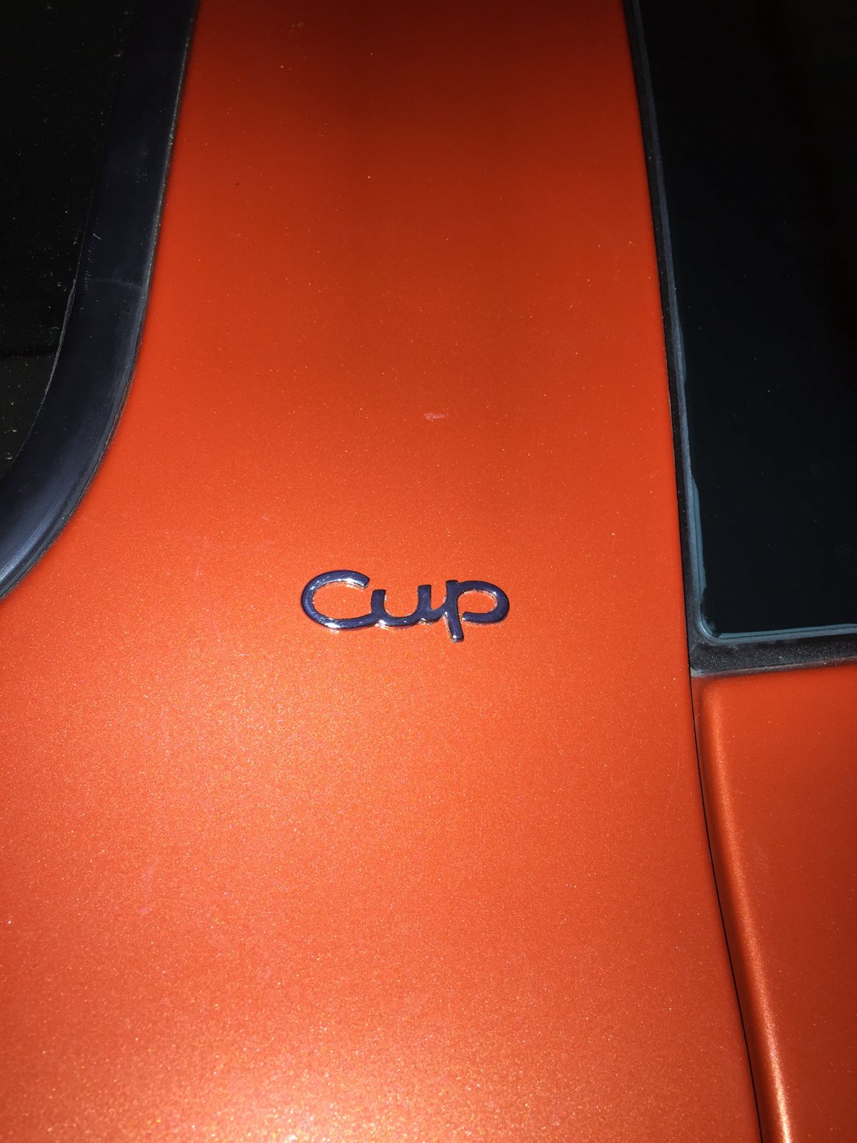

Once the adhesive was cut and applied I placed the badge on the other side and fixed it into its final position. It's as close to an original part as I think I'll get. It might seem a bit far just for a small badge but I want the car to look original on the outside, with the track day mods on the inside! The devil is in the detail..
Time will tell how it fares against the weather and other elements, and how long it stays on for.. I don't think I'll be going through this process again if it does come off lol.

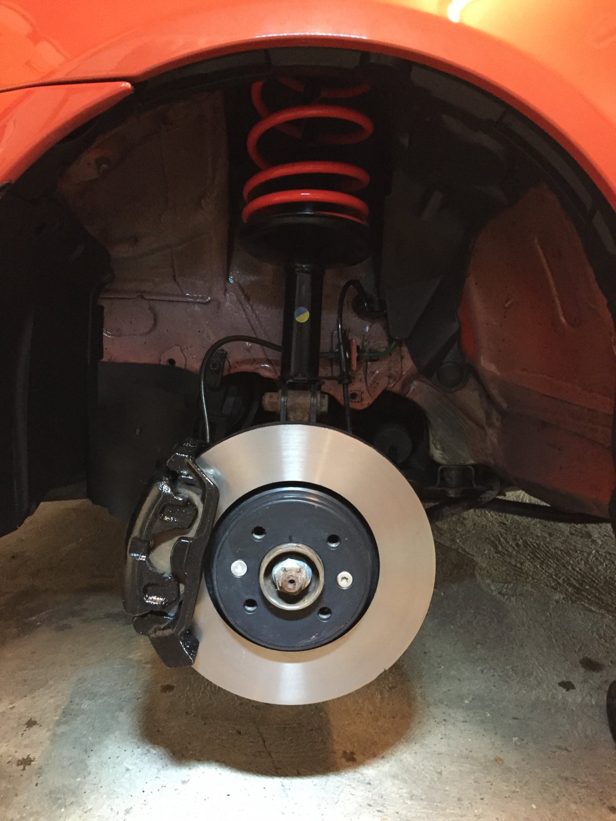

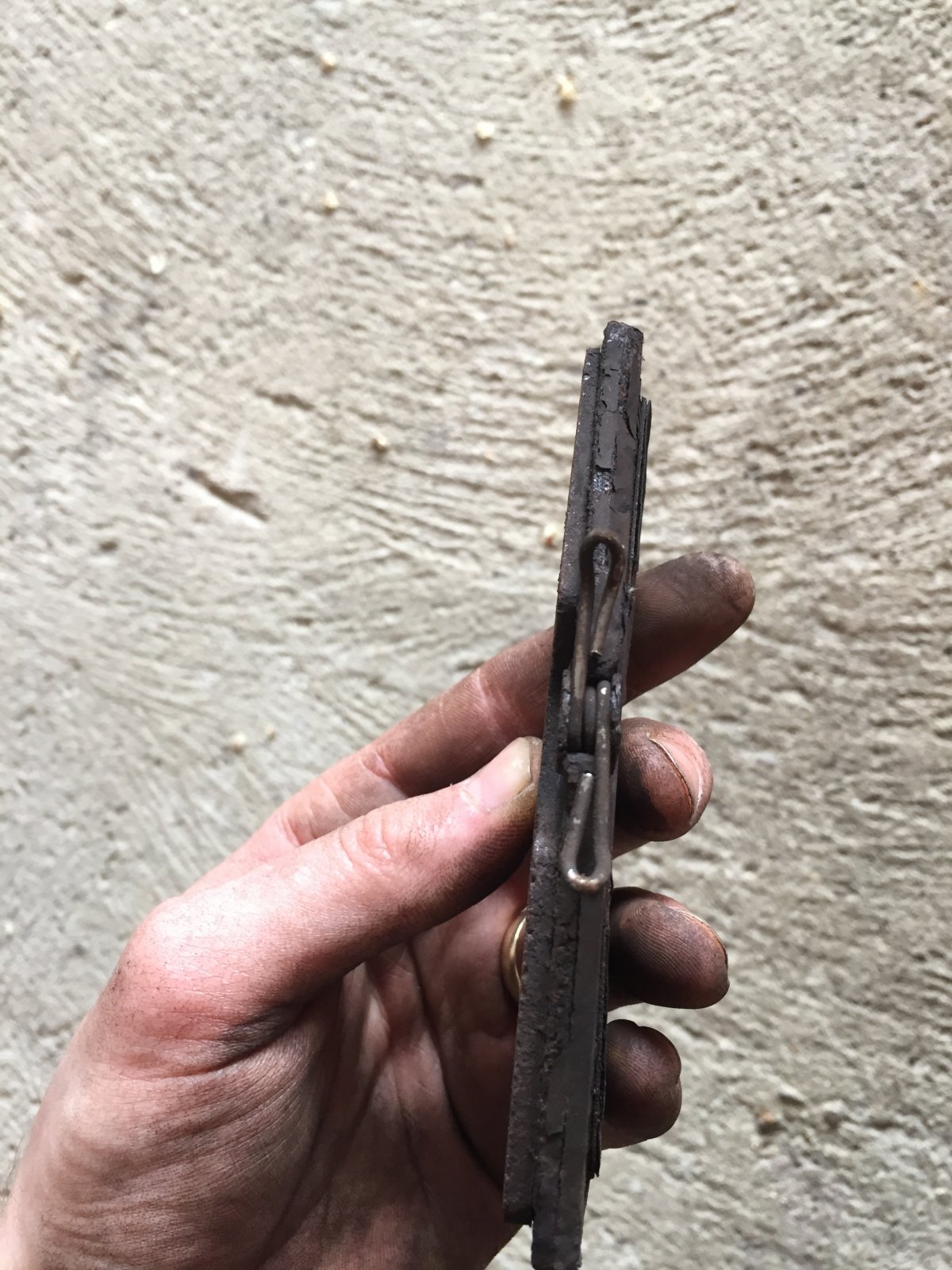

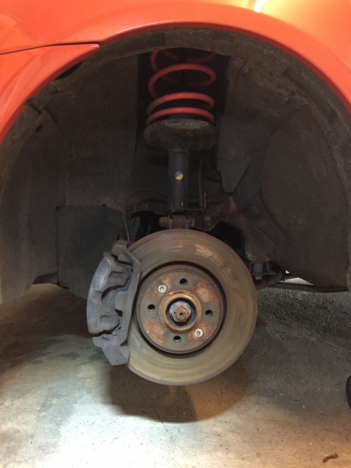

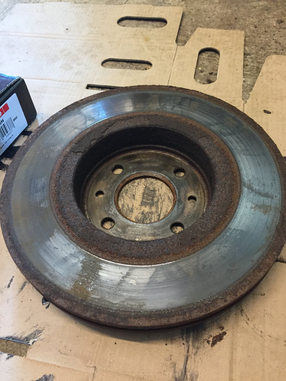

Today I changed the front discs and pads. They were very tired and the stopping power was extremely poor, not sure when they were last changed tbh. A fresh set of HC Brembo discs with Ferodo DS2500 pads. The calipers are now a nice gloss black after wire brushing them first. Whilst I was there I cleaned the arches so now it's looking much tidier.

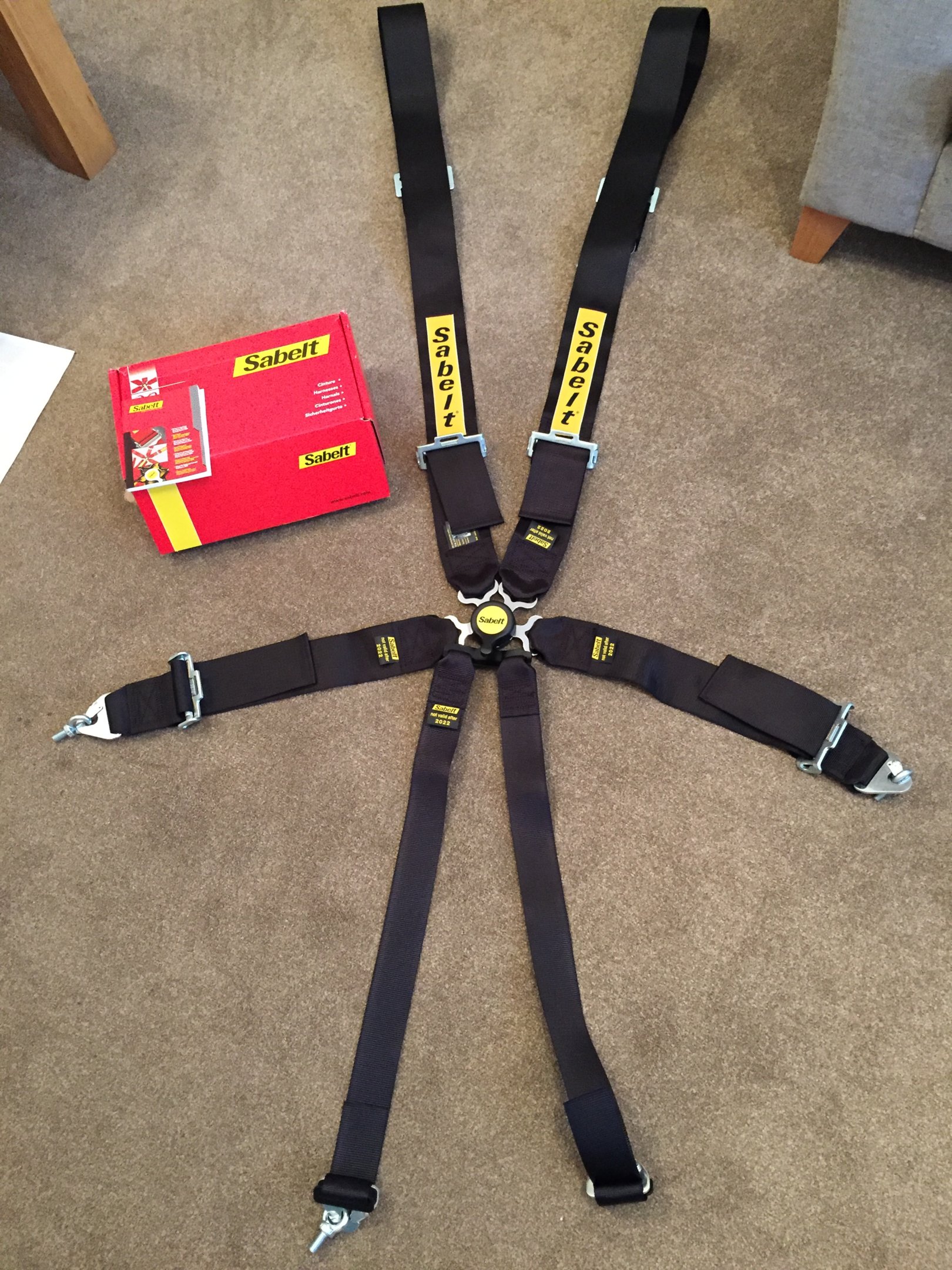

I've had the Clubsports on order since mid August so it was nice to actually finally get hold of them. I also ordered some Sabelt 'Clubman' 6 Point Harnesses, toyed with the idea of the slightly cheaper 4 points but from a safety perspective I felt these were the best choice -

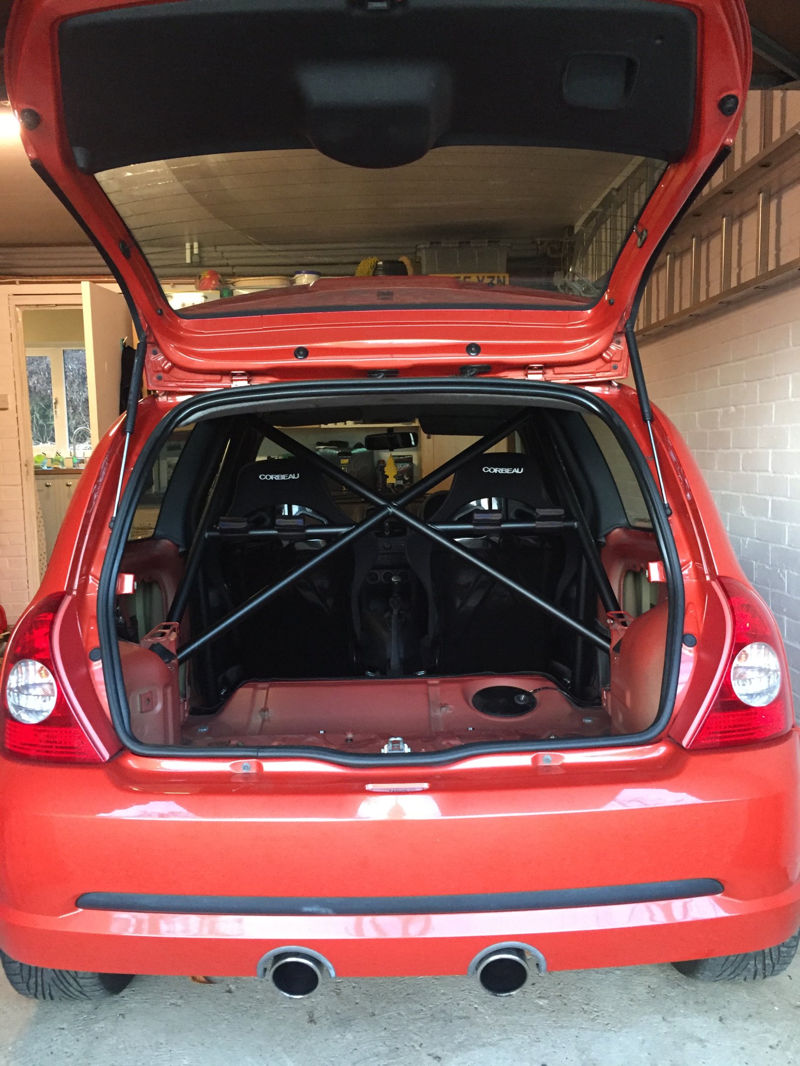

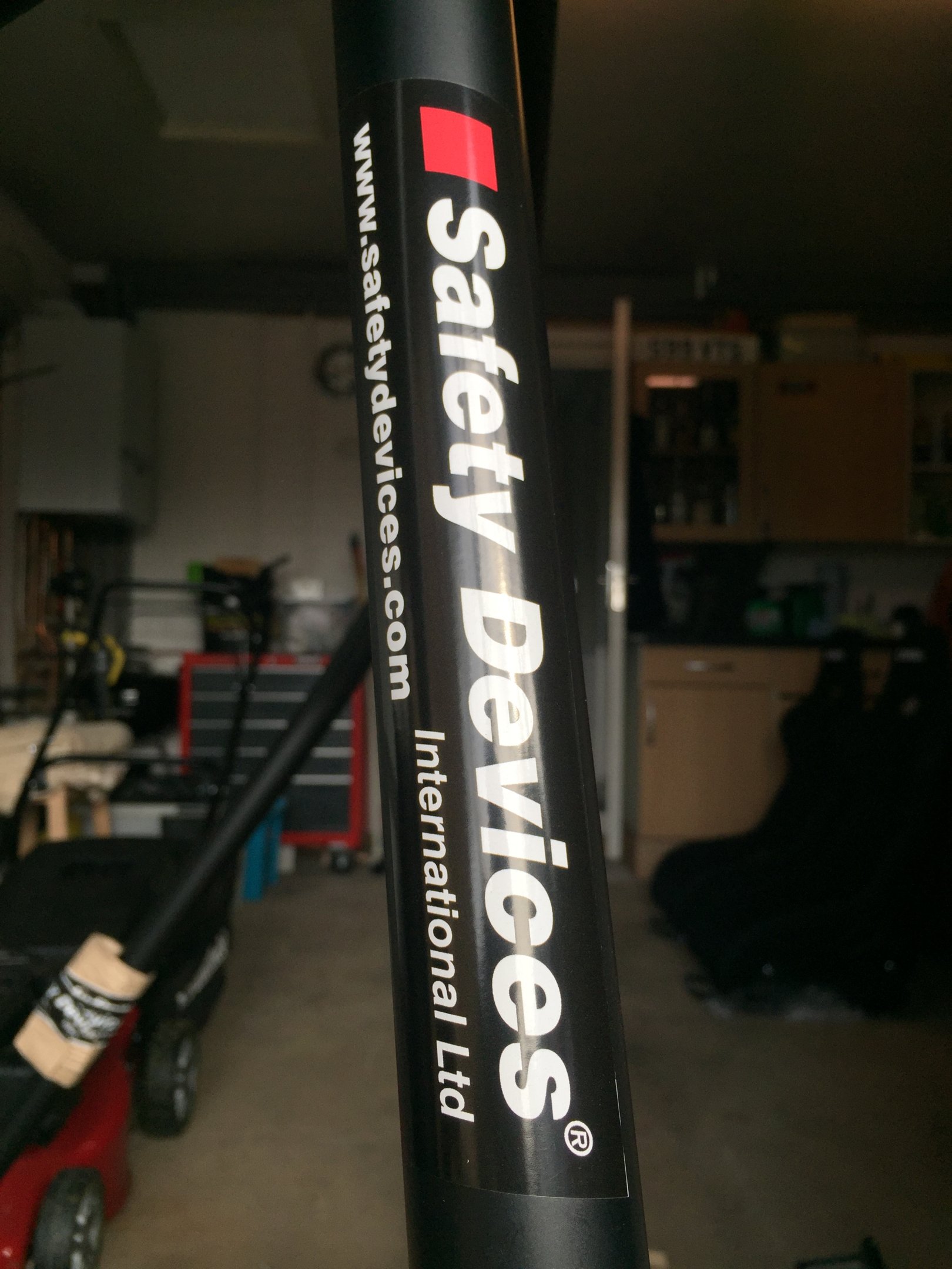

I've also had a SD rear cage on order with Mark Fish for a few weeks now and once that comes into stock I'll get it delivered and installed along with the seats and harnesses. It's nice to be able to put the 'upgrades' into the Clio after a good 6 months of trying to get it mechanically sound.

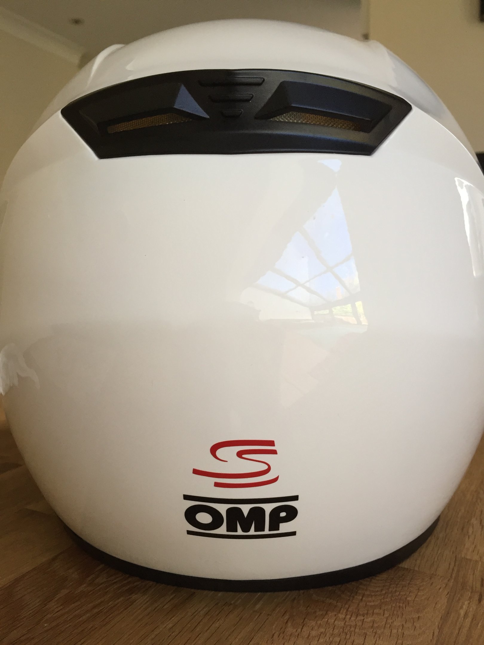

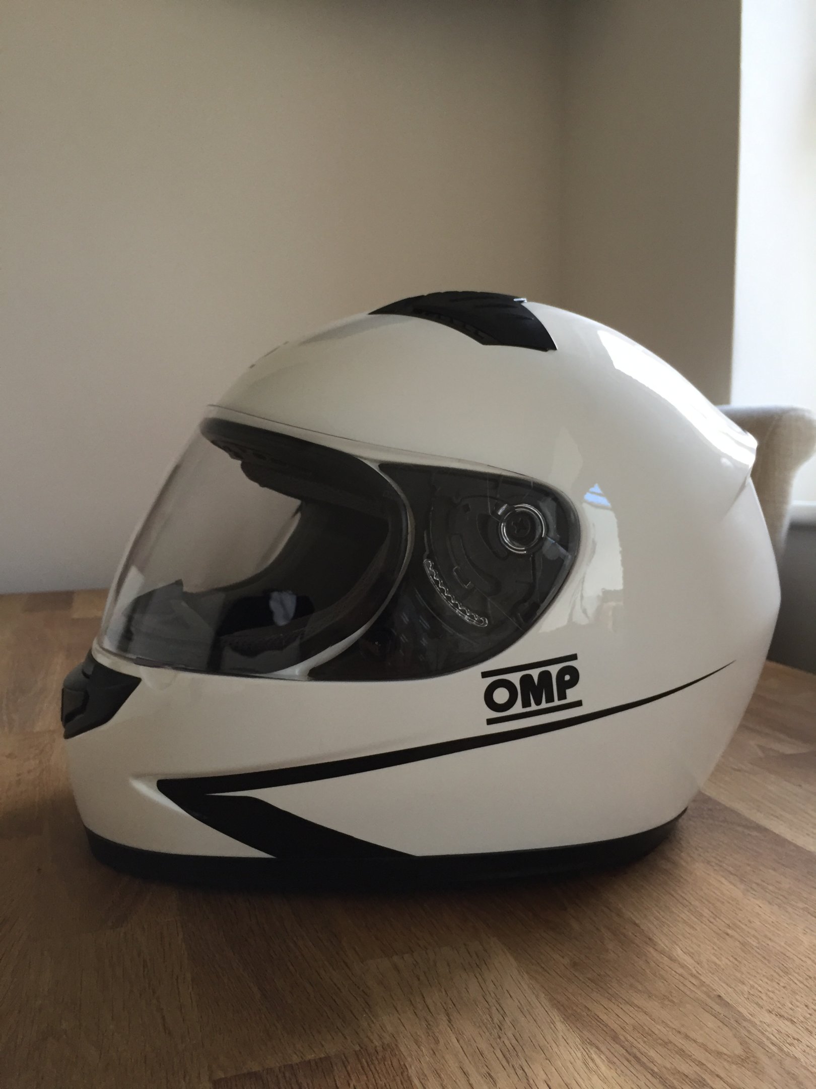

And finally as it's my birthday soon I treated myself to a trackday helmet. Went for an OMP one from Demon Tweeks. And added my own little sticker to the back..

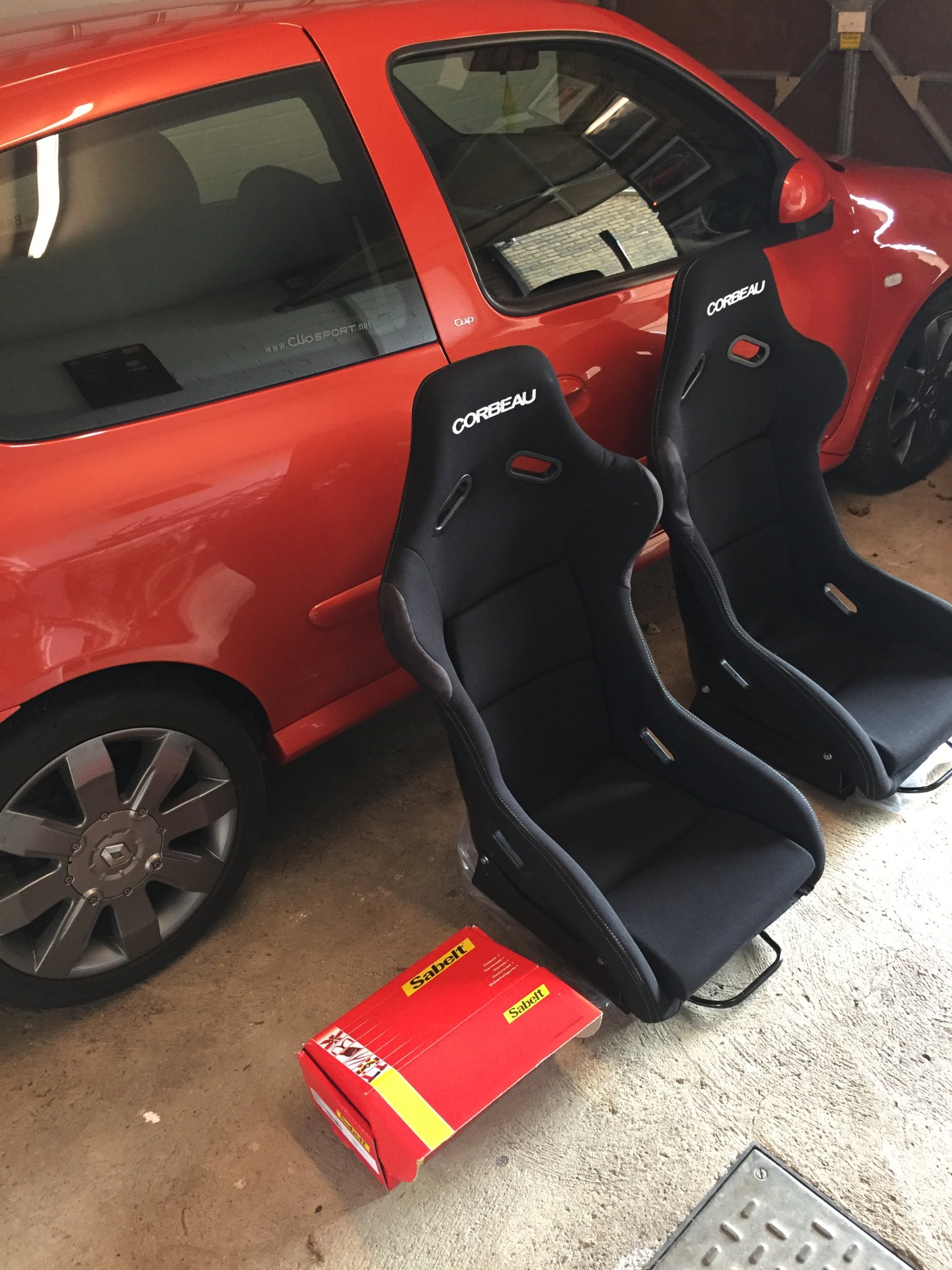

Guessed it. Went for the 'Standard' size as opposed to 'XL' and they're a snug fit. I'm 6ft 2" and a 32" waist. Any bigger and would probably need the XL. Having said that you do want a good fit otherwise there's no point

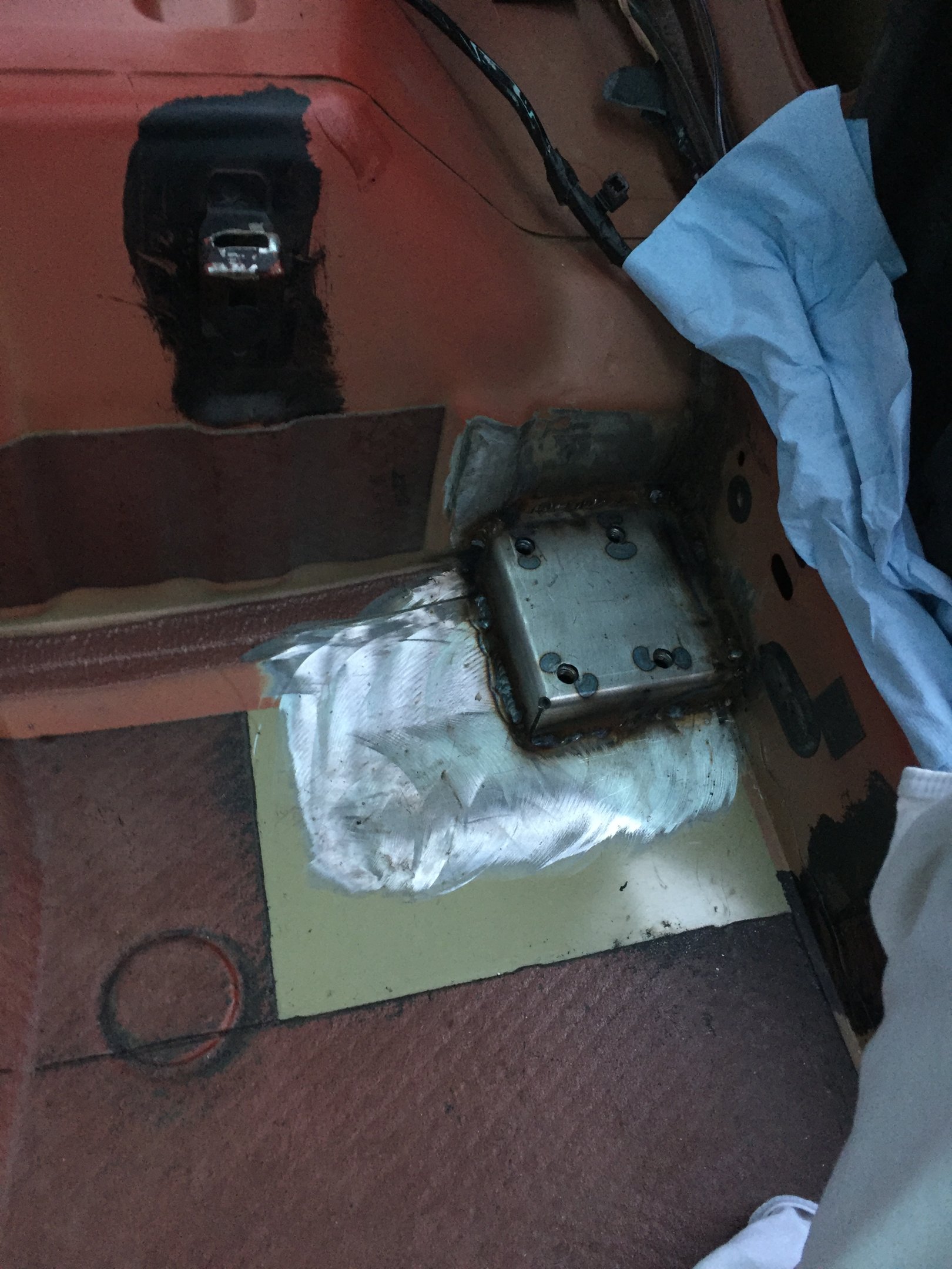

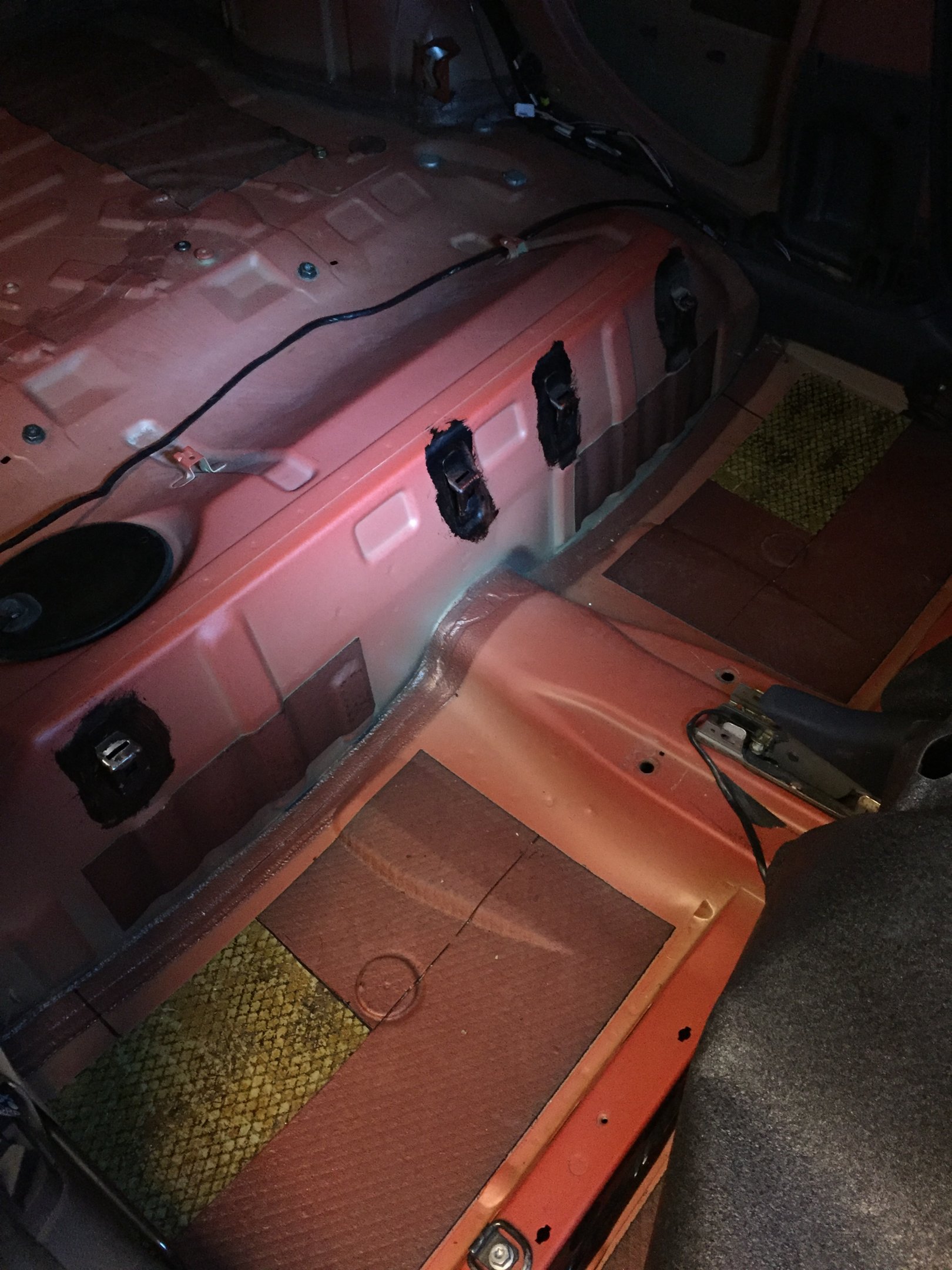

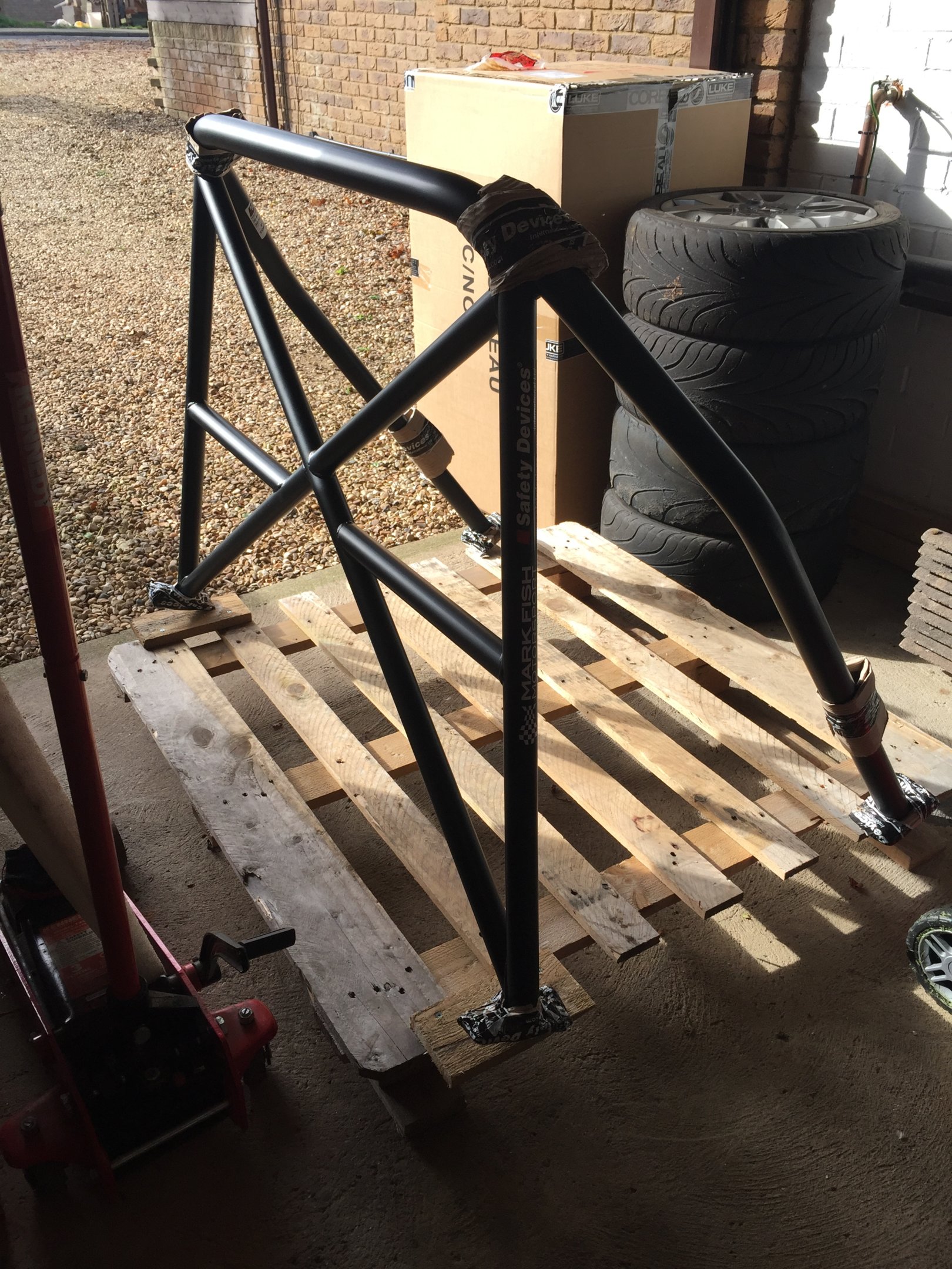

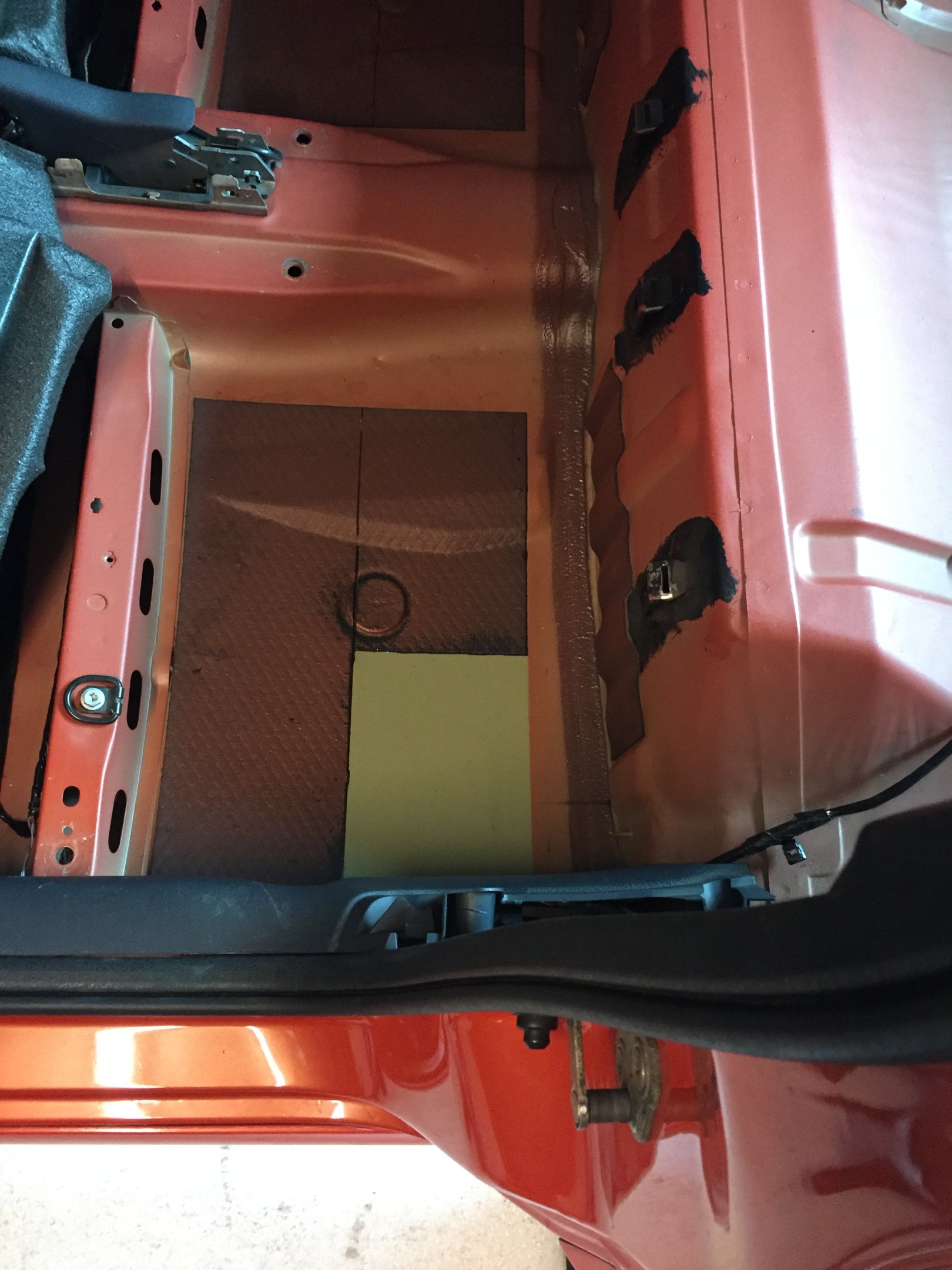

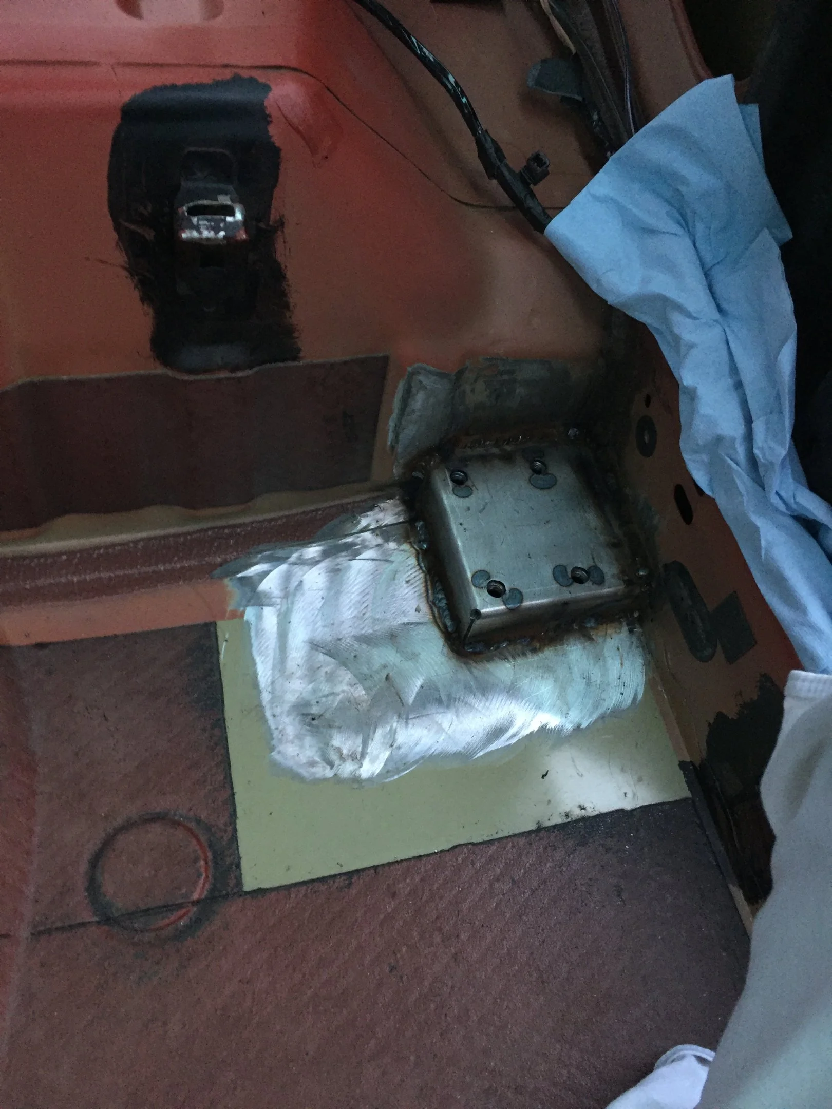

Ok so I spent some time over the last 2 days getting the prep done ready to get my cage installed. I was originally going to just get it fitted by someone else but decided to give it a go (up to a point) with some helpful advice from Tom @a17vts who has really spurred me on to make this happen.

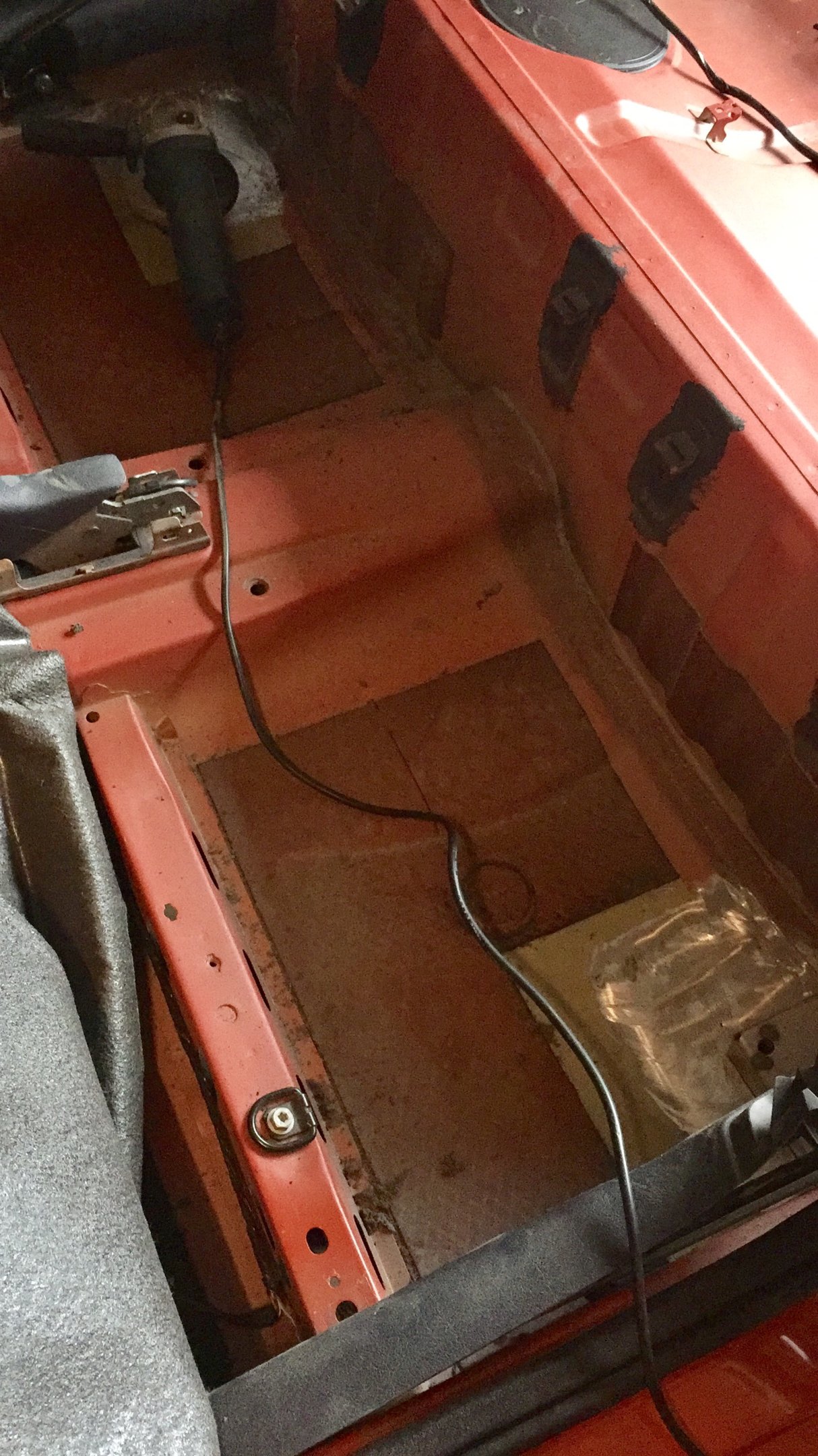

I removed the sound deadening with a heat gun. It came away so easily, not sure if I just got lucky but it peeled off after hardly any heating. I used a bit of WD40 which worked a treat to get rid of the final sticky residue it left behind.
Then I trimmed the carpet, still not sure if I'm going to keep the rear carpet but I'll make a decision once the cage is welded down.
Lastly I sanded back the paint in readiness for the spreader plates to be welded into position. I'm getting this done next weekend as I'm no welder! Then I got the cage into position today as a trial fit (on my own I might add) and stood back in admiration as it's starting to look the part now. For now it's resting in the car on the plates and cable tied the rear to hold it in position until the welding takes place.
I did pop the Clubsports in to see what they'd look like, but I'm awaiting some proper subframes from @JON FOZ which will be here in the next couple of days.
After this is all done, I'll be fitting the Sabelt harnesses :D

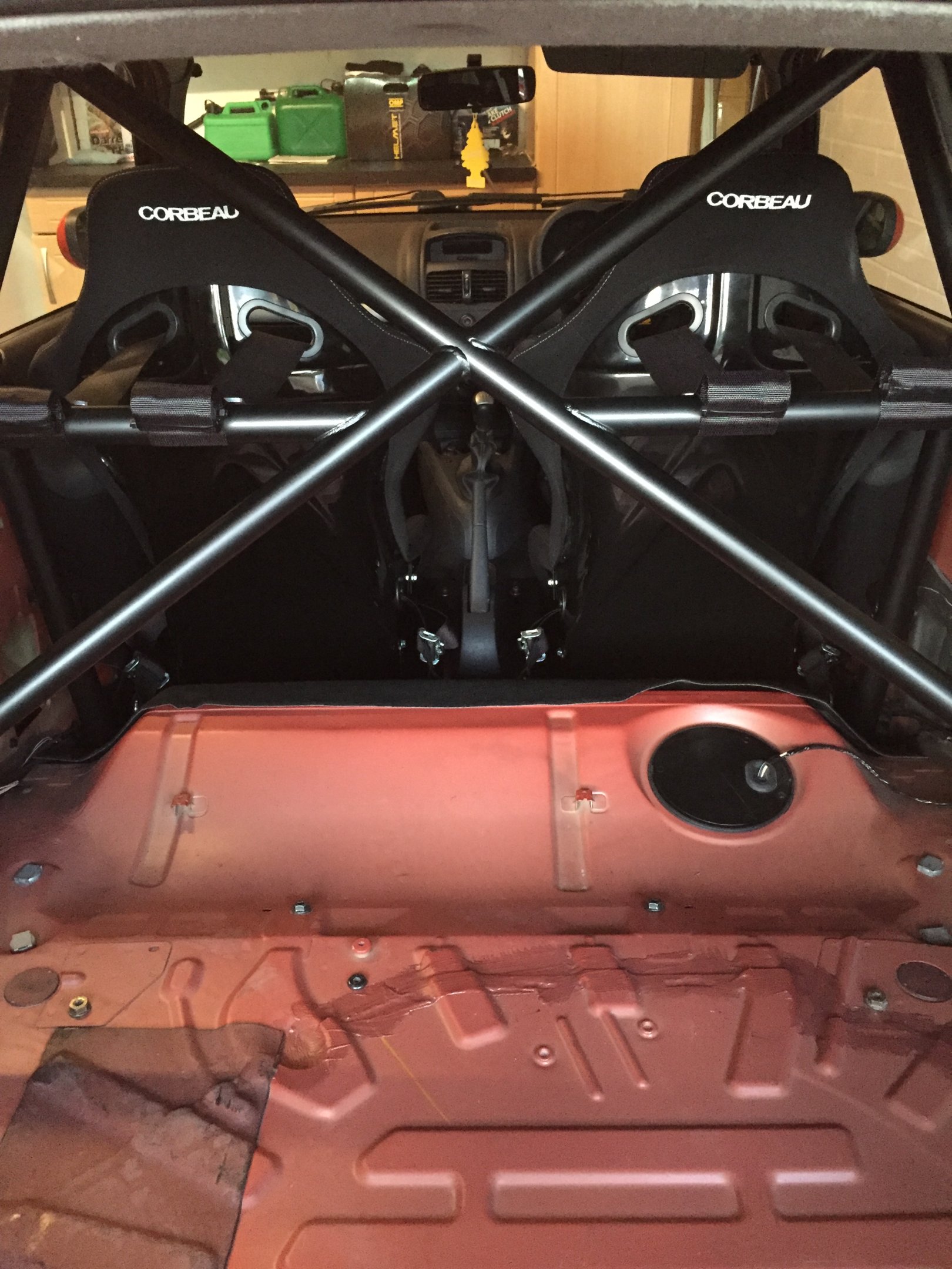

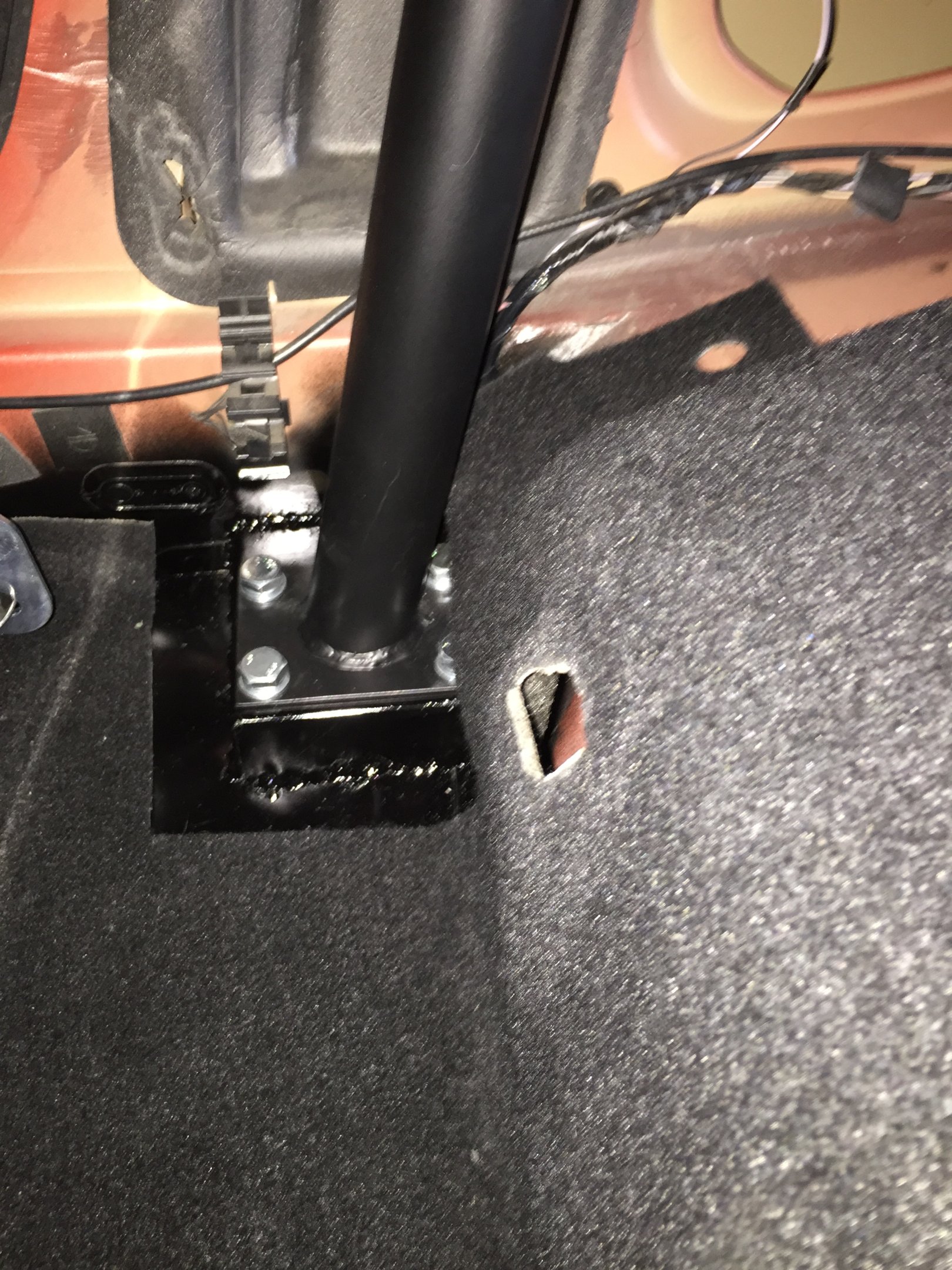

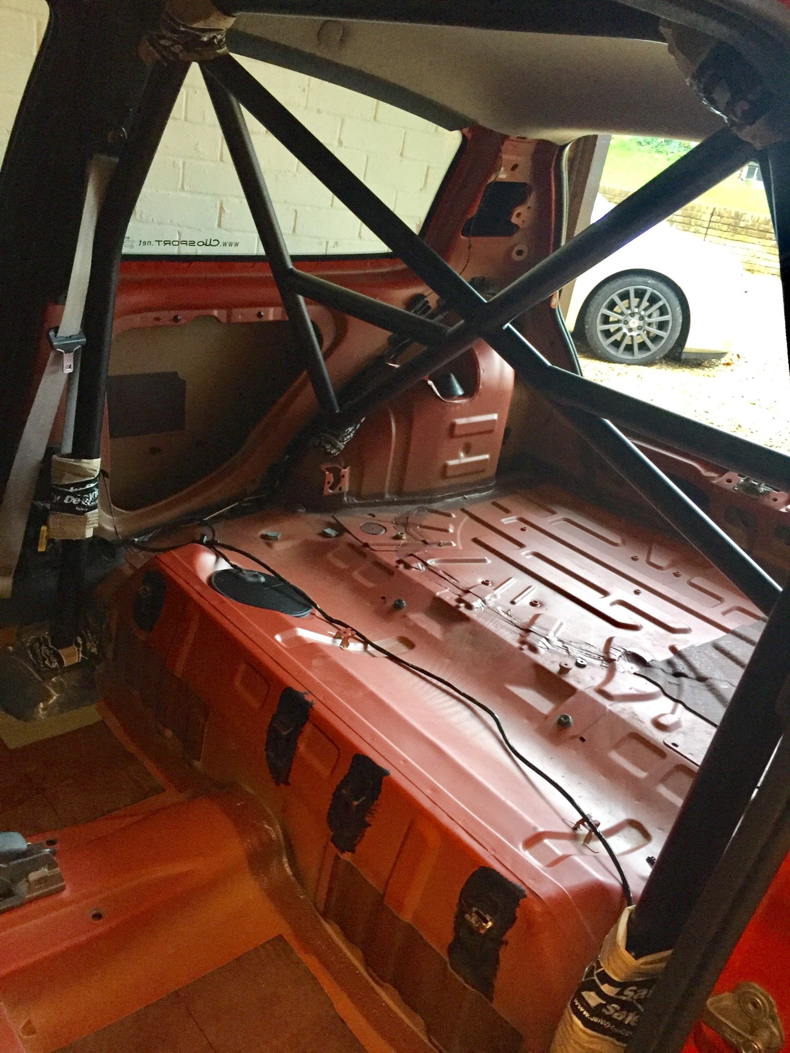

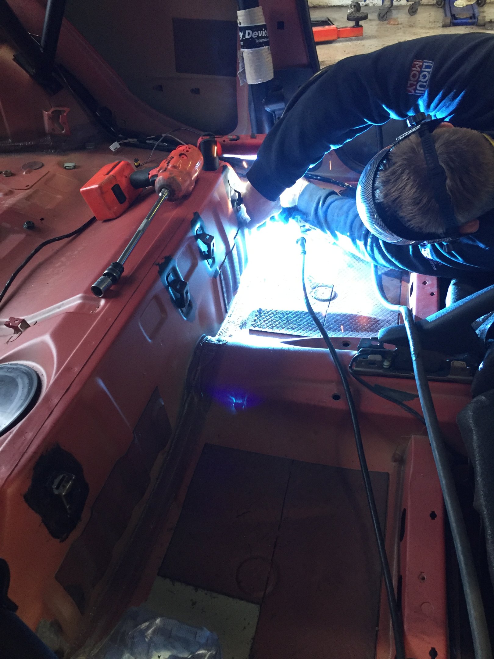

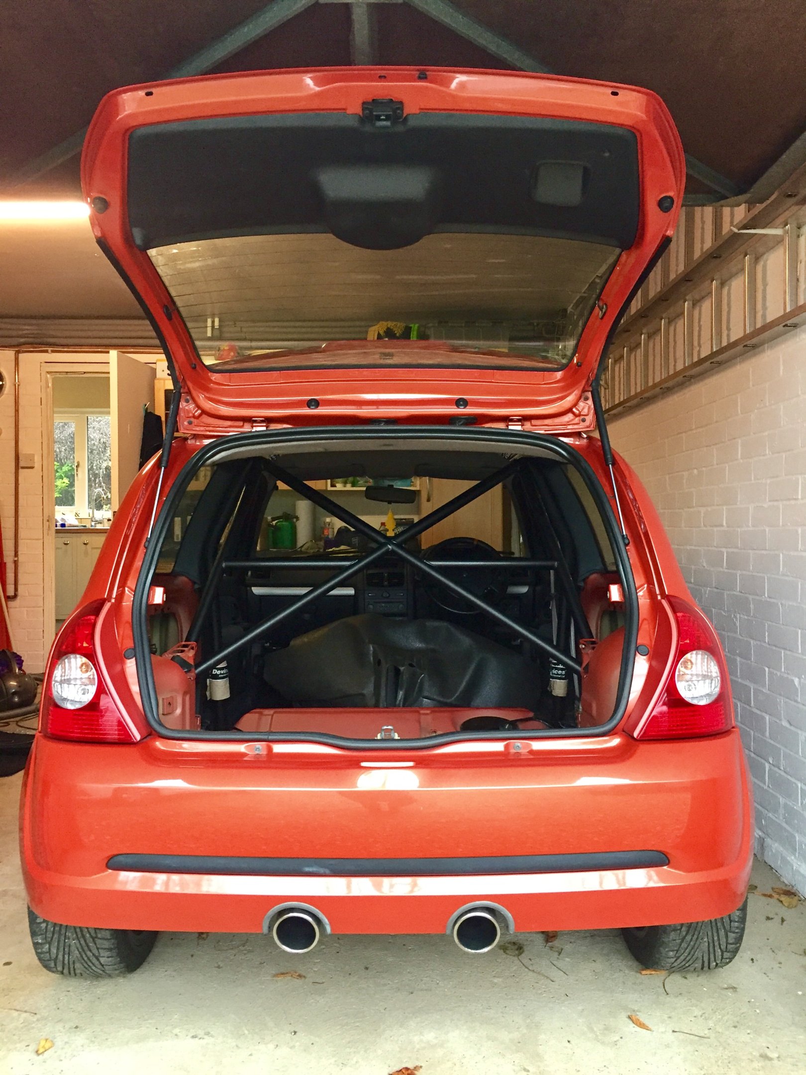

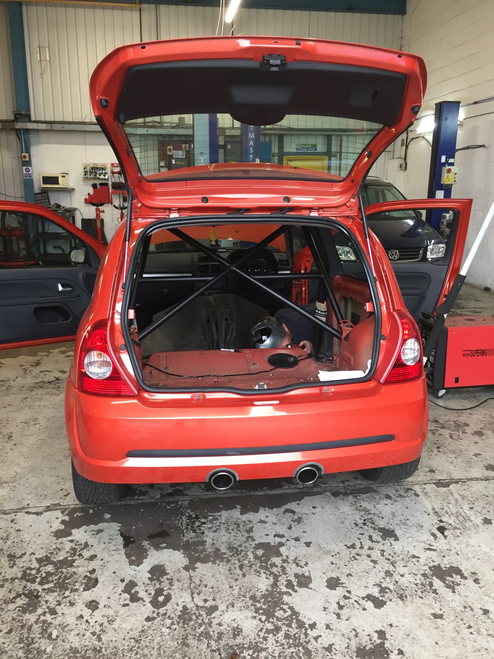

I dedicated quite a lot of time to the Clio this weekend. After prepping the car as much as I could in readiness for the cage to go in, I took it to a friend of my Dad who happened to be a welder and got the spreader plates fixed permanantely into position.
Then I used a Zinc based primer that helps keep any potential future rust at bay and layered that over with some gloss black spray paint I had lying around. The final fitting of the cage was a bit of a hassle as I ran out of daylight and the bolts for the rear arch stays were a tad short to get an initial bite on the thread but we worked it out in the end.
The finished article -

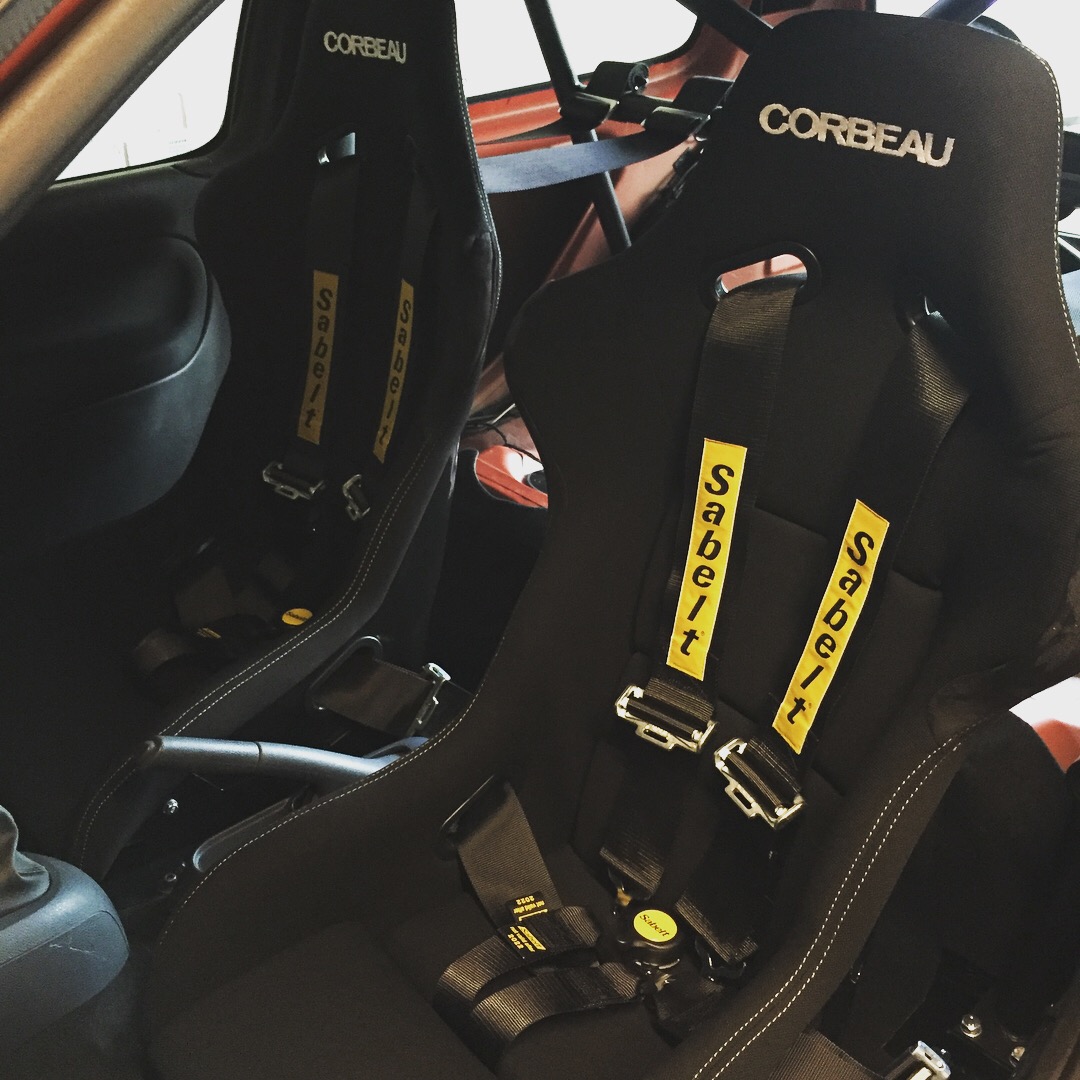

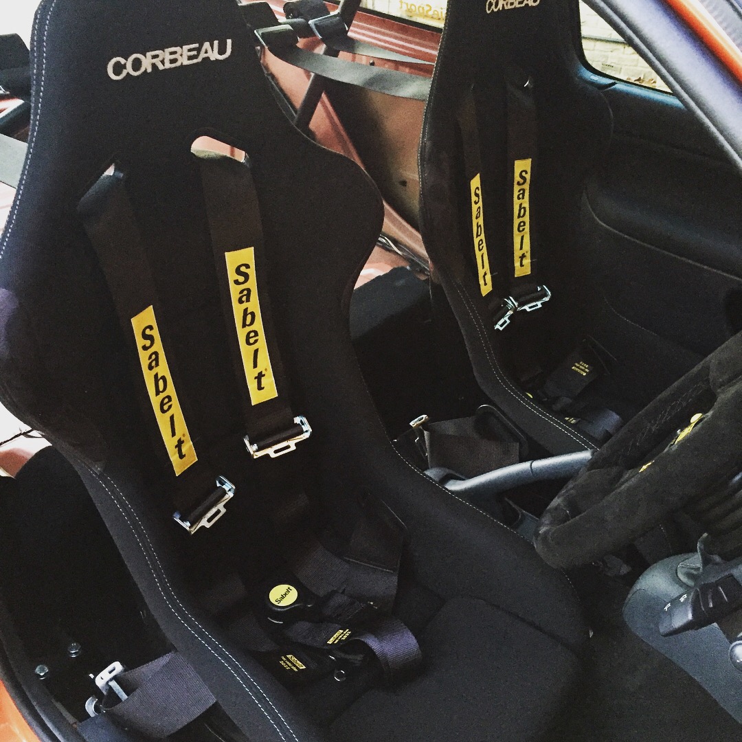

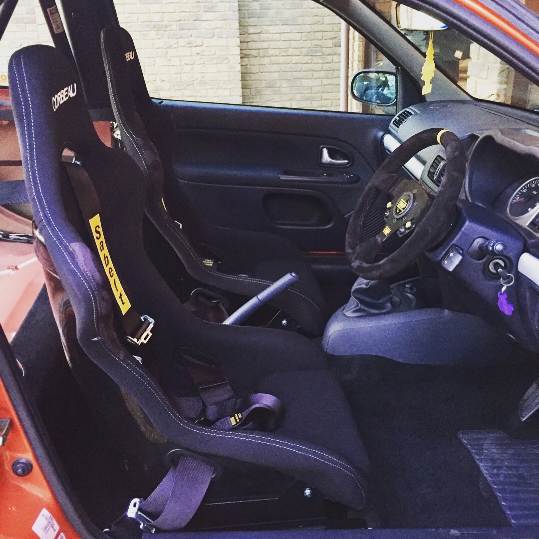

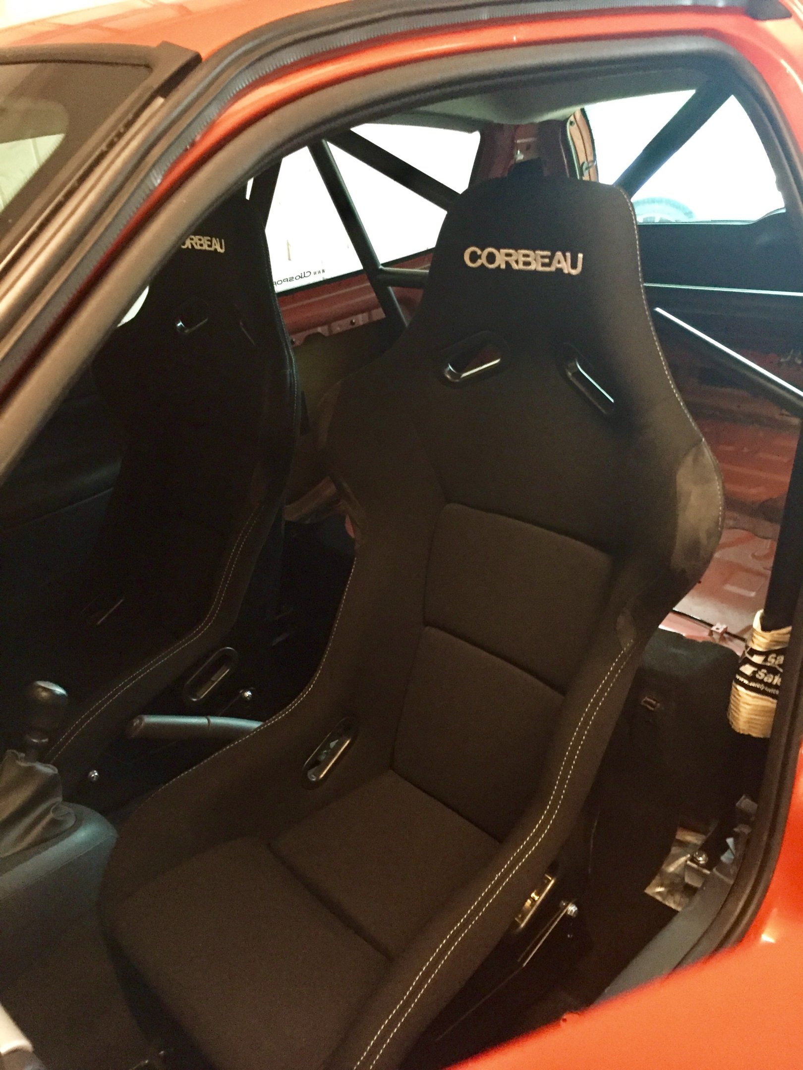

Today I fitted my Corbeau Clubsports on the VBD X-Low frames with the Sabelt Clubman 6 Point Harnesses. Accessing the bolts for the seats underneath the car (closest to the exhaust) is a total pain but I got there after some adjustment.

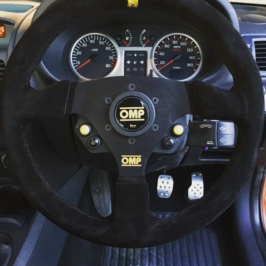

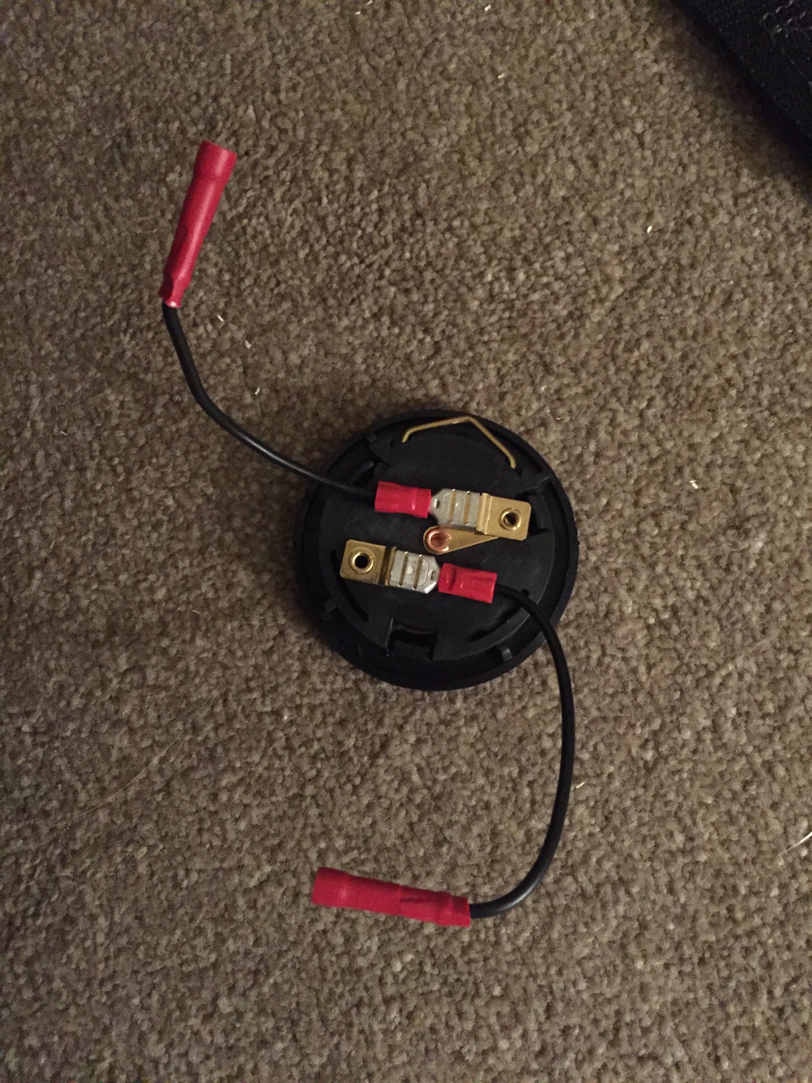

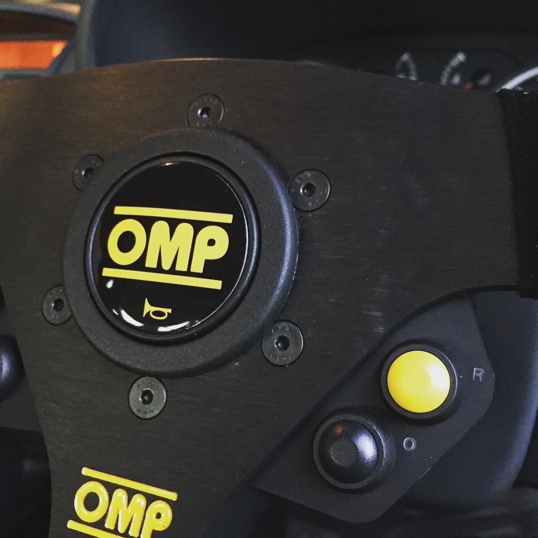

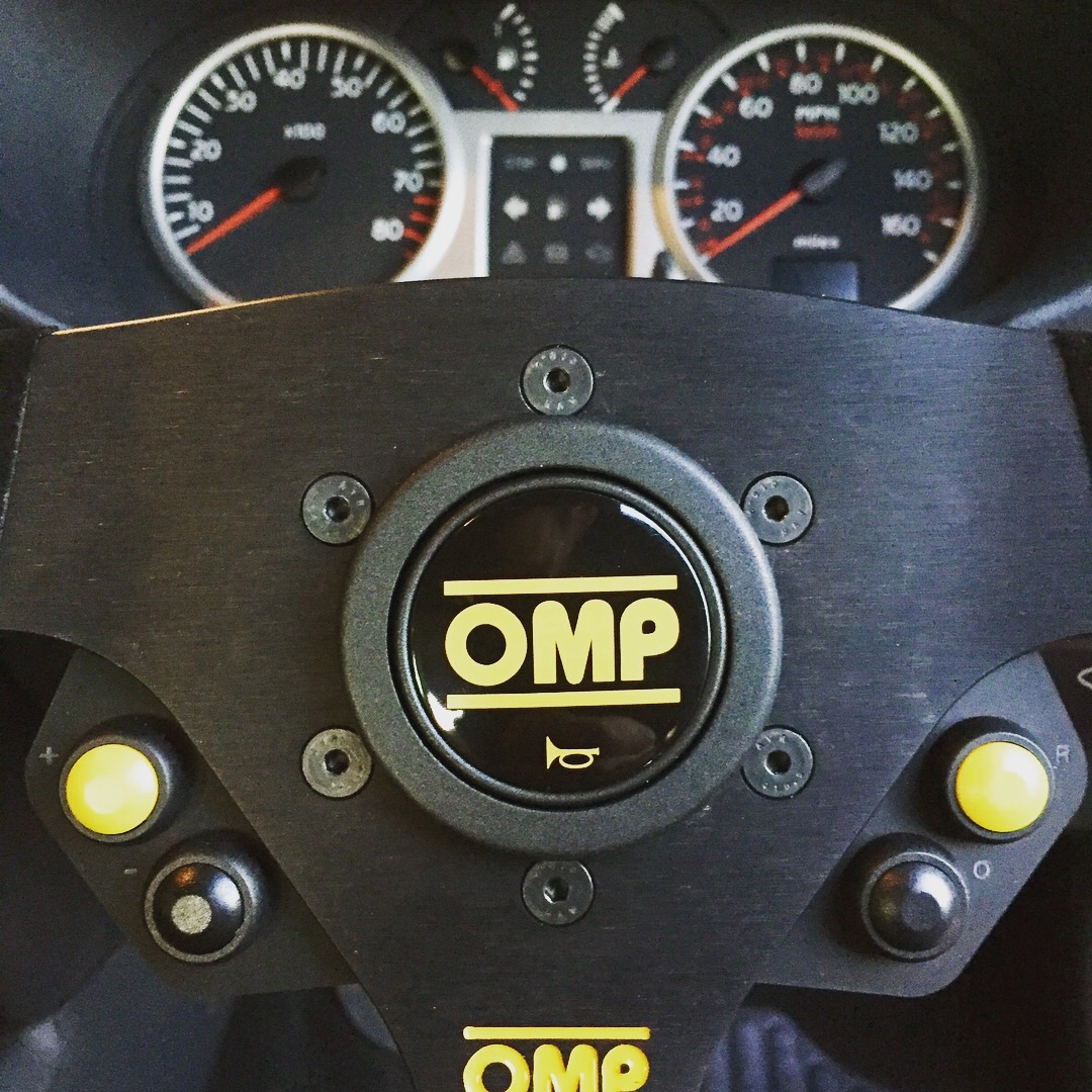

Lastly I wired up my horn, connecting the existing cables by crimping new wiring and spade connectors. I also cut the spring clip off the back of the OMP horn as reccomended after doing some research into it (apparently it can cause the wiring to short/melt if left on) and I didn't want that.
Darren61
I finished putting the wheel together and think it looks spot on especially with the colour co-ordinated bracket to keep cruise control
I took it out for a drive and am really pleased with the overall results. The car feels more rigid and tight through the bends and with the seating/steering position being a lot lower and together with the harnesses, its starting to feel (and look) really purposeful.
