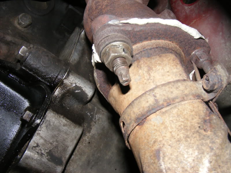

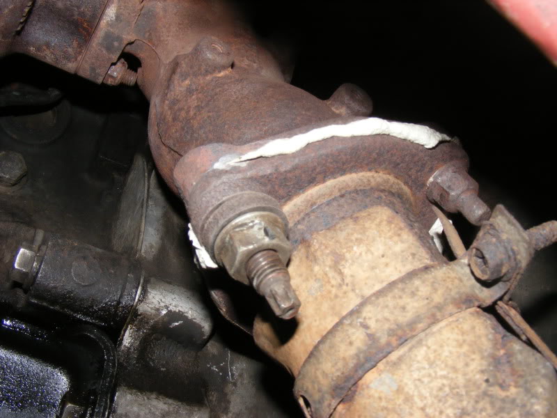

take a picture of the exhaust housing for me, take a pic of the arm that goes in to the exhaust housing... there is a metal bush that goes in to the housing... there is a weld on it, i need to see if the weld is cracked.... if it is that will explain your lag! the weld cracks, the bush slides out a mm or 2 and the wastegate flap gets stuck inside the housing untill any boost is made then it unfree's its self and pops closed...

Right ok, I'm not sure if this is what you were after mate but these are the only pictures I could get of the downpipe/exhaust housing area lol. Sorry if they arent any good but to actually get to the turbo I need the car up on ramps...

no mate them pics dont help i need pics of the back of the turbo... where the end of the actuator attaches to a little flat arm with a circlip on it... where that flat bar goes in to the rear of the turbo there will be a little weld on the rear part of the turbo housing thats what i need pics of lol, u going to trax? i could have a look then.
  Mustang, S13, AX GT
Sorry mate, I cant get a pic of that I dont think although I have tried on my phone, I just need to get the cable wherever its gone, I didnt think they'd help lol. I cant go to Trax now sadly, but I'll get these pics off my phone up soon.
