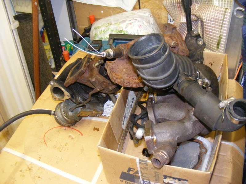

sr20 manifold wont fit, s14/a elbow is no good to you.
Core of the turbo needs rotating to line up the feeds and drain. s13 exhaust elbow needs 1 hole slotting to line up a bolt hole. Get a braided oil feed (hose solutions), Stock solid ones are well known for blocking, and as you've killed a couple of turbos already.......
Inlet needs a straight stub pipe to fit the stock hose, or use the s14 one but be prepared to modify the hose from the AFM/filter. Compressor outlet you'll need the s14 elbow, or have to chop and change the boost hoses about quite a bit. Actuator feed, for simlicity there's a small vacuum nipple on the underside of the throttle body, run a small bore hose to it. Think that's it (in very abridged form) There's a very detailed guide on SXOC by Turbo pete.
