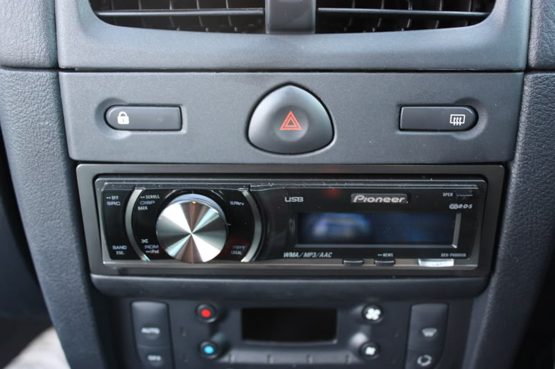

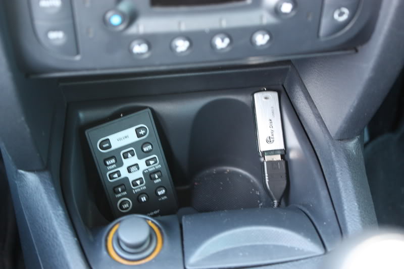

Anyway, since the last update ive fitted my new HU, steering stalk controls still functional! (£35 for the leads for that!!!)
with remote and 8Gb flash Drive, loving this faciltiy! So much better than ipod/cd changers etc! forgive the dirty car, havent hoovered it this week yet.
Also all my wiring arrived. RCA's and remote wires were put in when the HU went in so dont have to take it out again. Saves a lot of hassle!

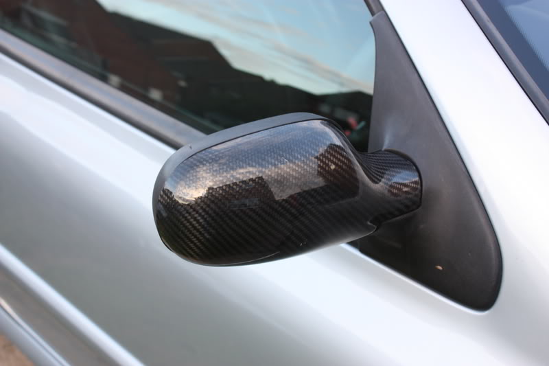

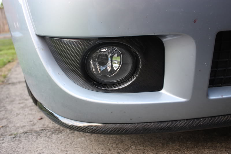

Also, been in touch with Bic about some carbon goodies. we came to a deal in which i could help him out with something so i got a right steal on these items, he even fitted them for me, perfect:

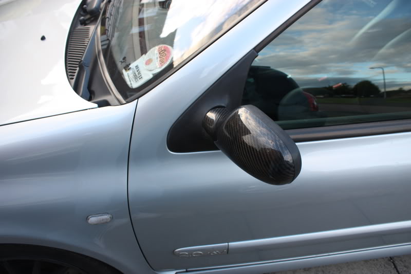

Carbon mirros:

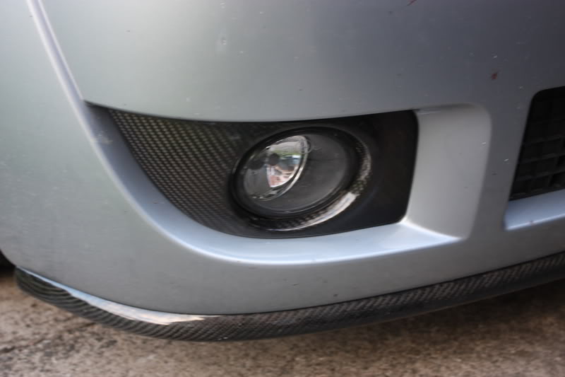

Carbon Fog light surrounds:
All the carbon bits are replacement parts too, so no additonal weight :)

Lovely :) Are the fog surrounds just glued in where the previous ones were or do you have to cut the fixings in the bumper away?

As for the fog light surrounds the do need to be bonded on, but the stock items are clipped into place. We used double sided tale to obtained the right positions in depth and used bonding stuff to stick them in place, taped over to hold in there, left for a day and it was sorteed :) easy peasy

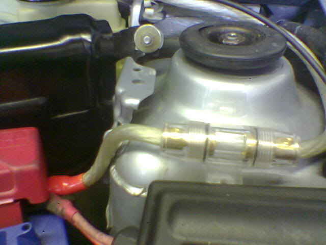

Then the power cable, 4 gauge, was an utter shite to get through the bung in the bulk head but here's what i ended up with:

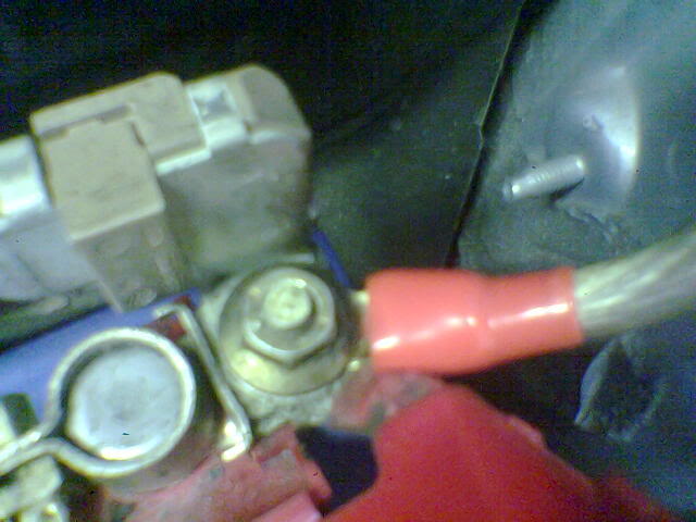

Proper battery connections and proper gold plated terminals:

mirrors are from streamline carbon chap :) Bic is your man on here for them!

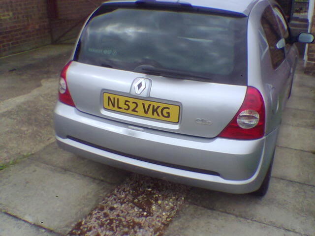

Debadged rear, Renault sport now gone:

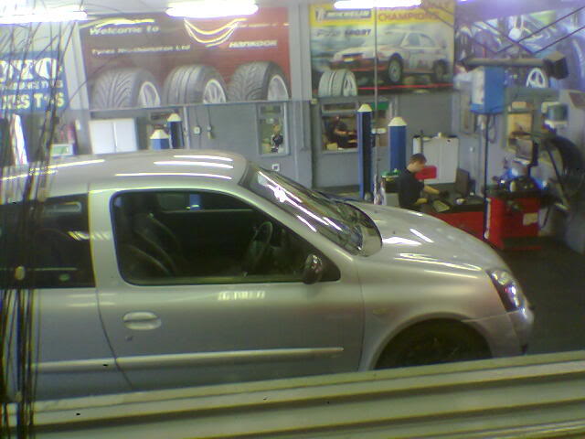

Had all the tracking and alignment setup, full geo check. £90 not bad :)
Car feels better now, turn in is sharper, steering is lighter. An overall improvement:

I use a place about 20mins from me called Northampton wheels n Tyres.
Excellent place to go. expensive for most things but the service is so good, waiting rooms have leather sofa's, air con, free drinks, sky tv, magazines, playstation etc.
Not your normal grubby tyre place, its immaculate. Plus i know the guy who runs it so usually he'l sort me out with free fitting if i go for tyres.
They gave me a full print out of all my old and new settings, took me under the car to look at a few small issues i should know about.
Would recommend them to anyone, esp for £90 too :)

lol, no its a full geometry check up and sort out. camber, caster, toe, tracking, alignments etc etc!
usually tracking is about £30. i have a full print out at home that shows all the angles before n after. I think Mark fish does this for about £200 although dont quote me!
