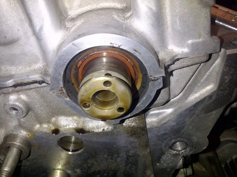

found this beauty earlier, awesome idea to fit an exhaust cam seal on the inlet!
notice how the dephaser pulley has machined a nice groove into the seal, the dephaser was sitting proud approx 5mm from where it normally sits, tippex cambelt, engine is now scrap
and people say us specialists arent needed and any old garage can work on F4R's, point proven

ive seen 2 correct inlet seals stacked on each other (ph-reebone ;))
never seen someone fit an exhaust seal on the inlet!

dephaser has slipped due to this f**k up and totalled the engine
