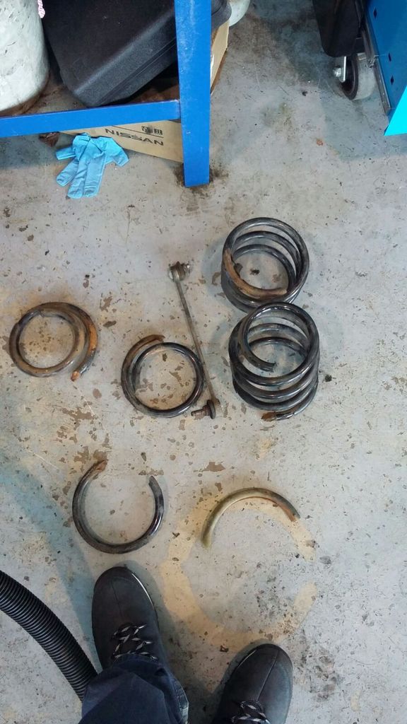

And this happened
Since I killed my brakes at Css, we changed them for oem discs and pads on the front yesterday.
With the wheels off... We noticed a snapped spring on the drivers side... Then another one on the passanger side lol.

How was the car amazing on track with two broken from springs?
I would have thought it would have handled like it was on roller skates?
Knuckles
ClioSport Admin
Tips melted into the diffuser?

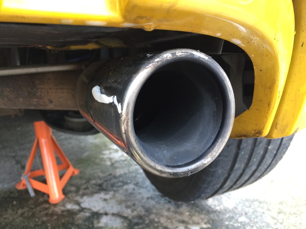

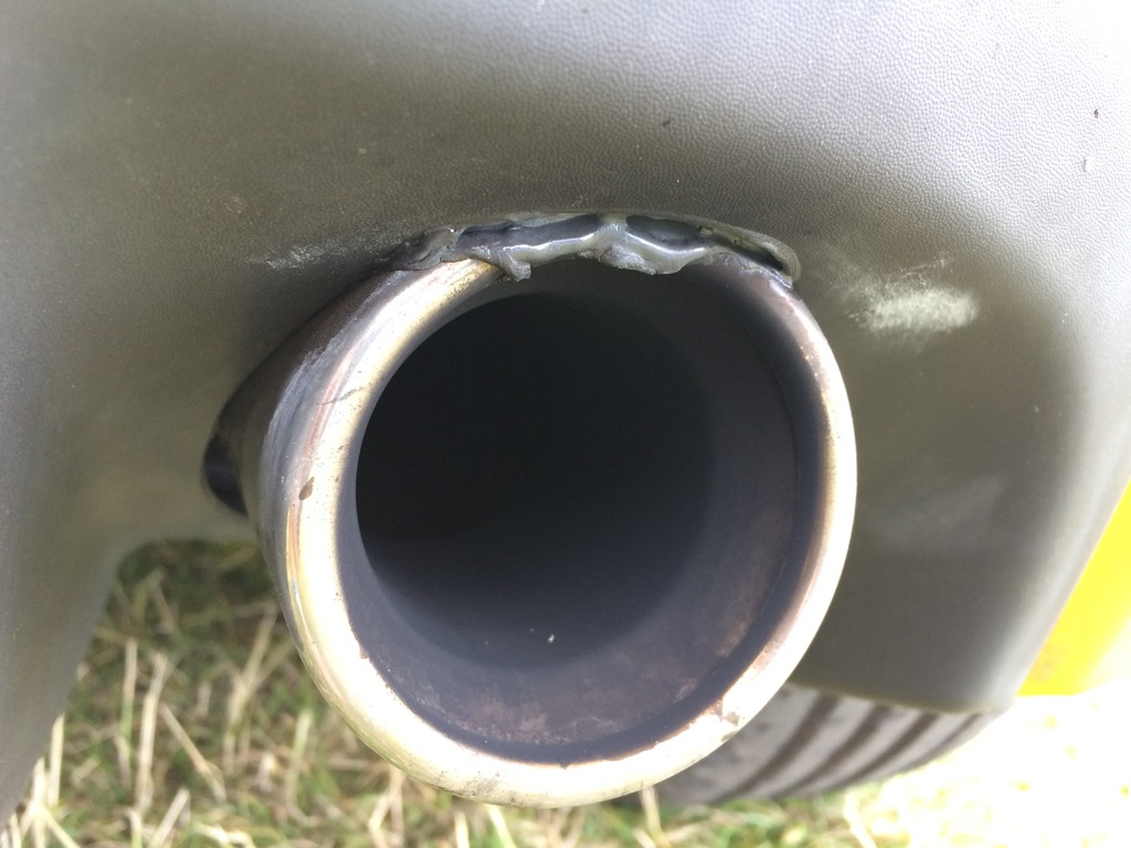

Yup. The right tip is slightly higher so melted the diffuser a bit.
I'll have to cut it out.
I genuinely have no idea. I even had it sliding around a little.
I didn't notice the springs in the slightest.

@Hawk182 helped me change my springs over at his work today. Thank god he did that! I wouldn't have wanted to do this on the drive!
The only problem was a tie rod end being rounded which needed cutting and replacing.
Two front springs came off in six pieces! ... Whoops

While the diffuser was off, I trimmed off the melted parts and we adjusted the (unbranded?!) exhaust, which needs readjusting as it's now too far down on the right hand side.
But that's a job for another day.

Tbh my friends 330ci coupe has a snapped proline spring and he didn't notice it until we got it on the ramsp for another reason. Still drives ok to this day and that was weeks ago that we noticed it.
But I would of thought the MOT would have picked yours up as it would have shown various cracks.
Knuckles
ClioSport Admin
He's still driving it on snapped springs? I stopped driving the clio as soon as I realised lol
But yeah, I'd have thought they'd have noticed the cracks in the springs. One had a crack up a length of it!

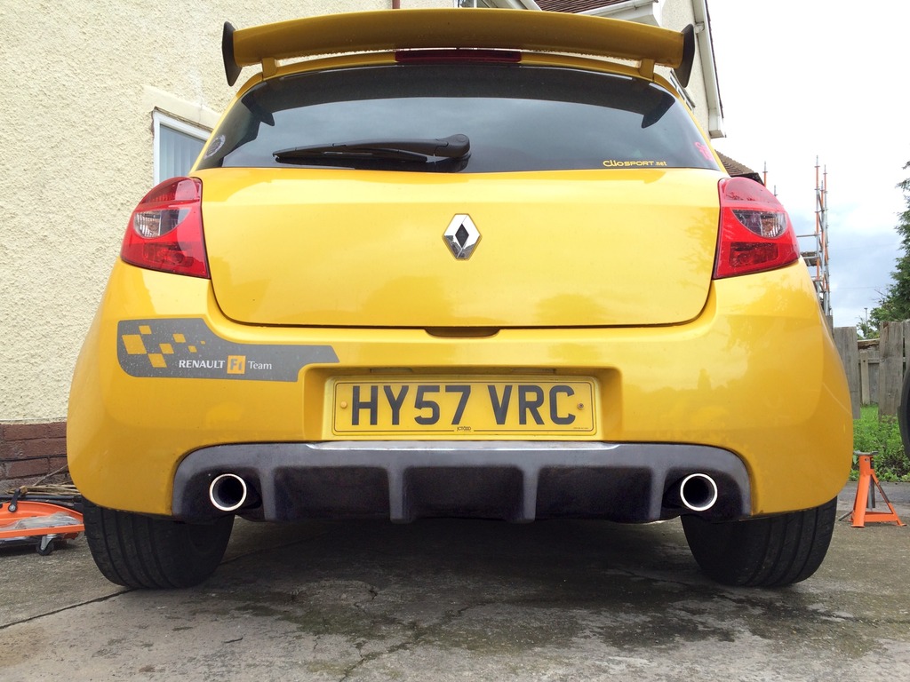

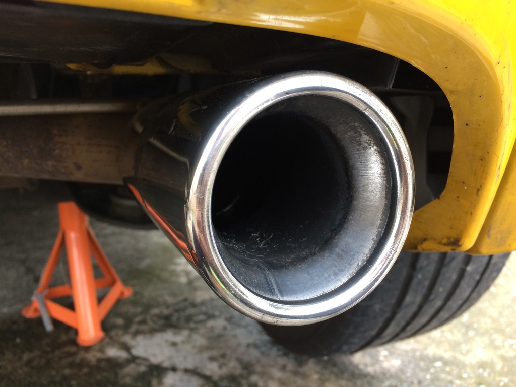

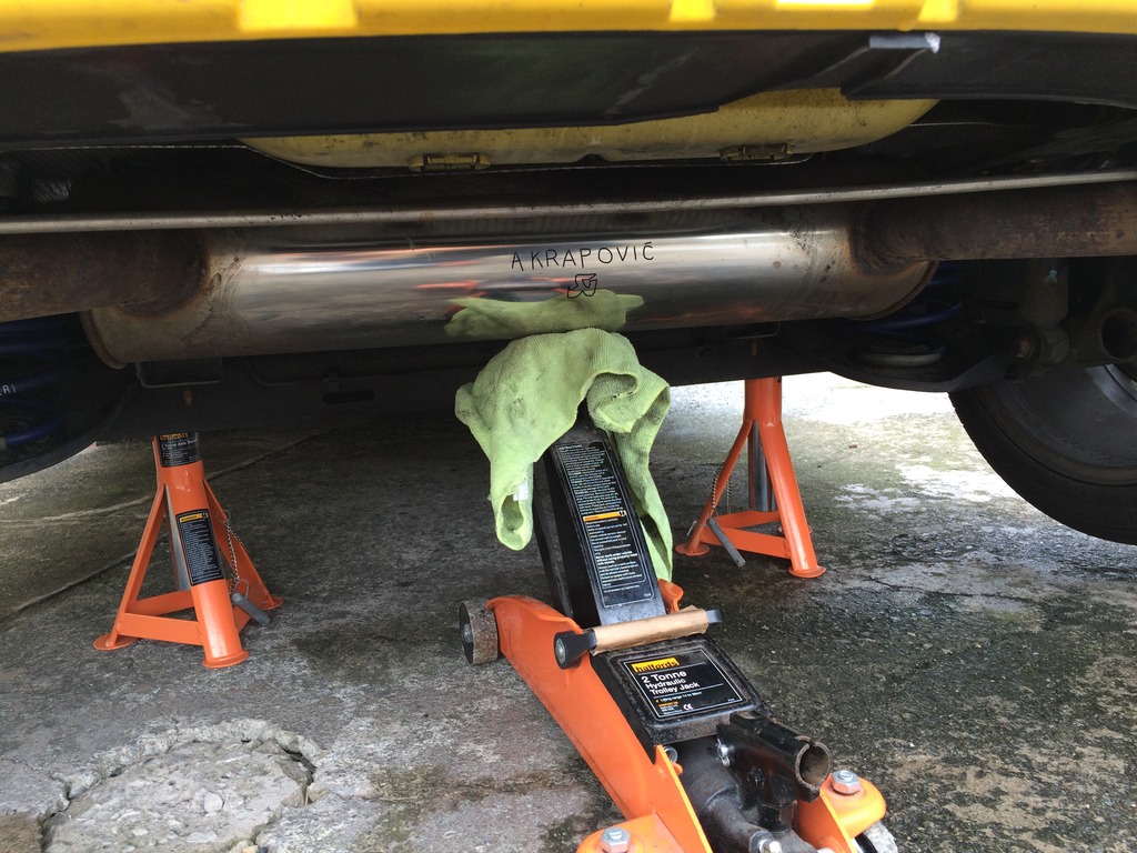

While adjusting my exhaust today, I got the idea of colour coding the diffuser to the stickers so I did a quick shop. Personally, I love it and have been looking into plastidip and anthracite vinyl (because I don't want it to be permanent) and I thought I'd see what everyone else thinks... Although I know how you all feel about the Anth pack on the 200s :blush:
I gave the back box a quick wipe too while I was there
And gave the tips a good seeing to
I'll be whacking up a diffuser removal guide soon too.
Yosemite Sam
  Whichever has fuel
Cheap exhausts (which it appears I have) and decals make it much worse, I have no idea why. Apparently now mappers can remove it. Decats used to make it tricky to map out.
Your exhaust says Akrapovic....
That's very not cheap!
