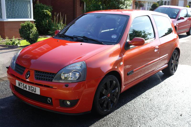

Thought I would start a build thread to keep a track of what work I am doing with the little Inferno 182.

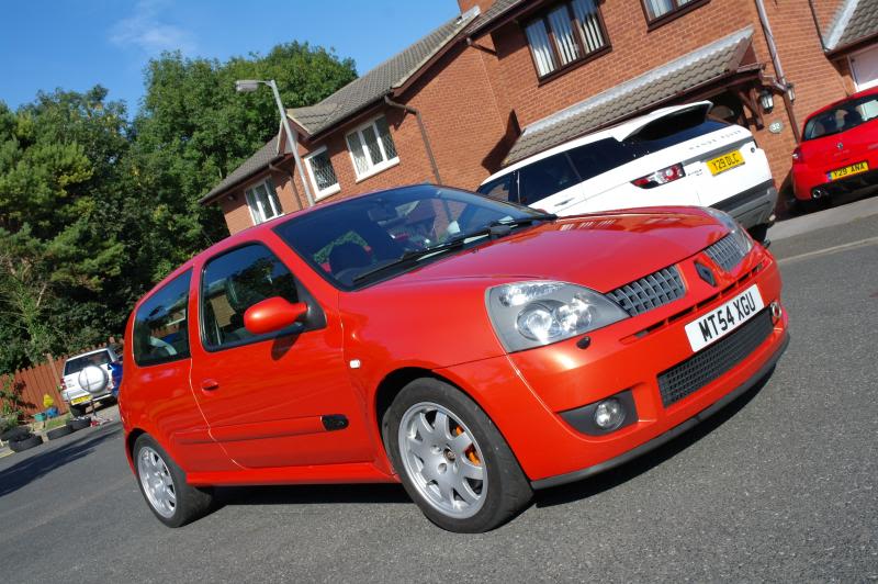

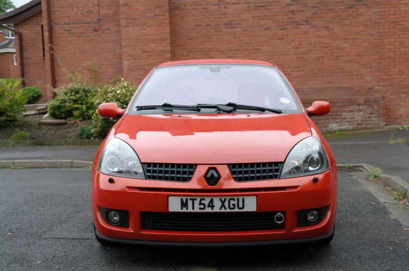

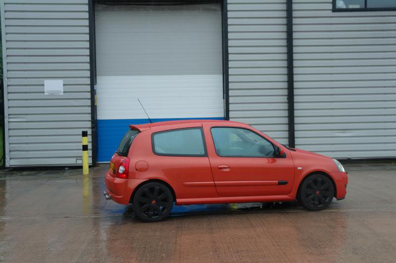

Bought it like this from DTM cars and the weather was horrendous:
Today managed to spend some time on the car:
- Tracking set as pulled to the left very slightly

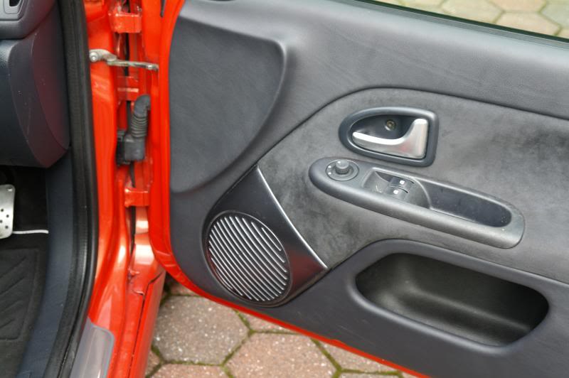

- Anthracite speaker covers fitted
- Standard engine cover refitted

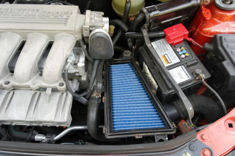

- Stainless bolts for the airbox
- Replaced bolts from connectors in engine bay
- Tried adjusting exhaust but is blowing so getting stainless one sorted
From what I have checked the car already has the following fitted:
- Panel filter

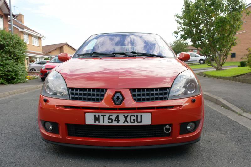

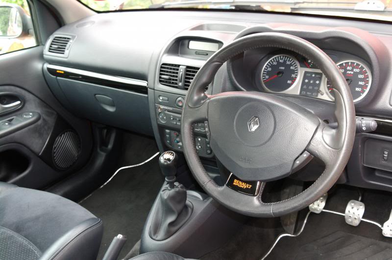

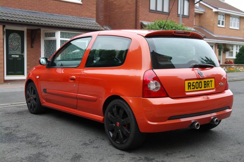

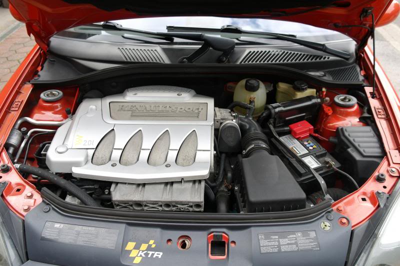

These are some pics from when I finished my work:
Interior -

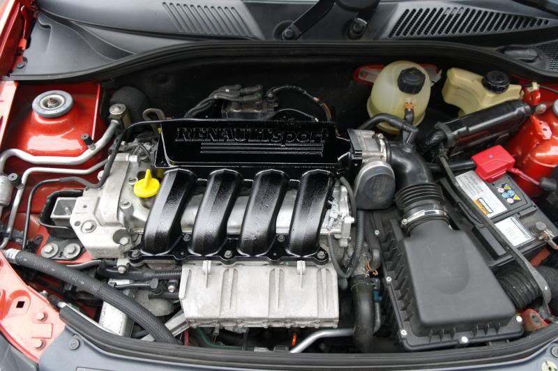

Engine Bay -
Outside -

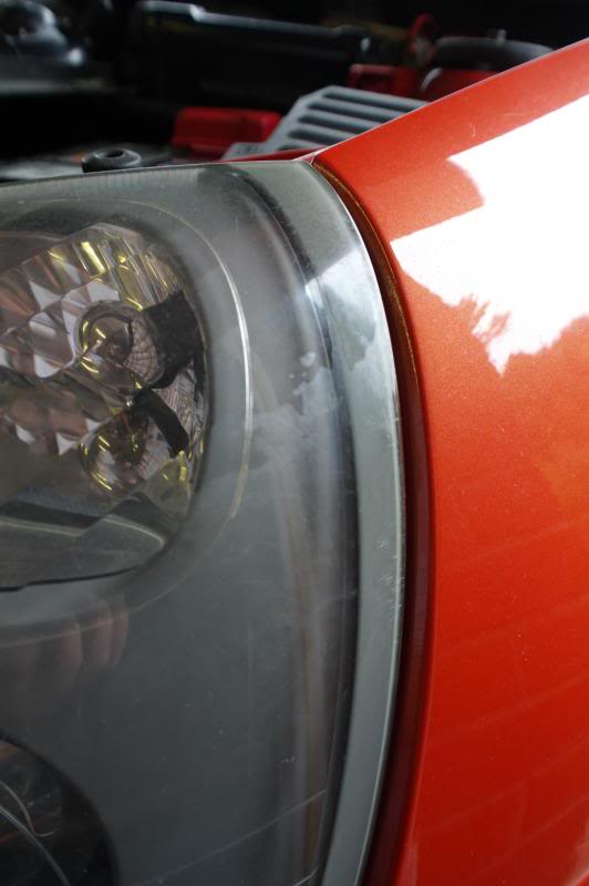

Well another day and thankfully a day off so managed to start working through my list of jobs of the Inferno.

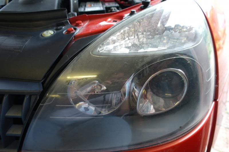

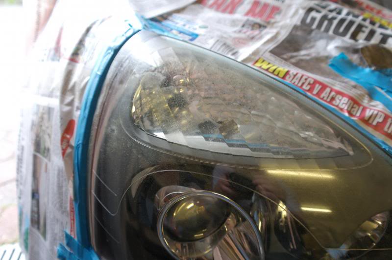

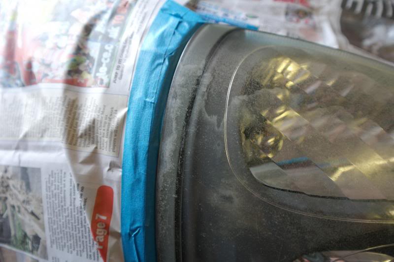

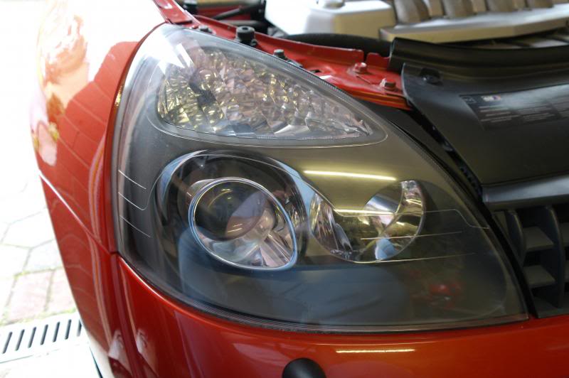

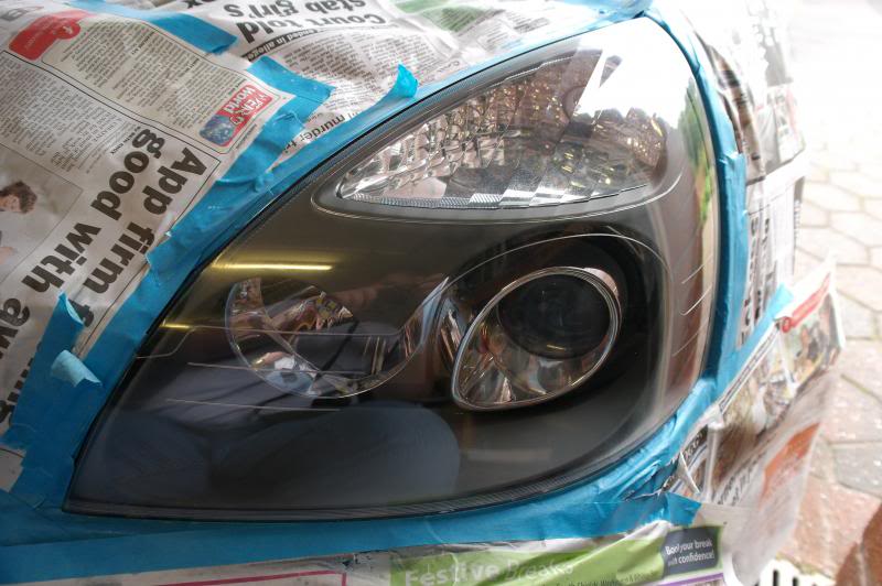

First up was sorting the aged headlights as these really let the car down when the paintwork is so good, used the Meguiars Headlight restoration kit which I would highly recommend.
Drivers side:
Passenger side:
Also fitted a cup racer tow eye as loved the look on the previous 172 I had. The car came with a 3/4 front plate but was unfitted so also fitted this. My private plate will be going on in a few weeks once the V5 has come through.

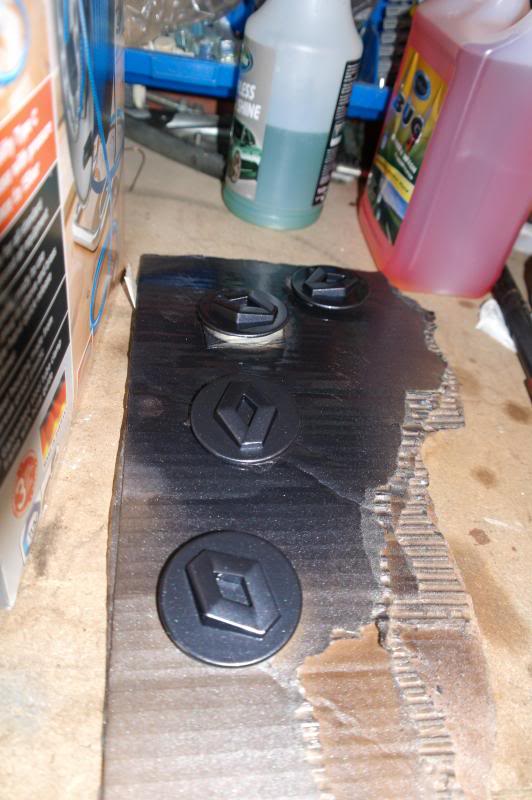

Today I wanted to sort the badges out on the car, didnt like the black Clio badge and the Sport badge.
Removed these and got a standard Clio badge for £2 from the scrappy.
Also removed the front and rear diamonds and painted these in anthracite as the front one was black and rear standard silver so looked odd.
Definitely looks better in my opinion

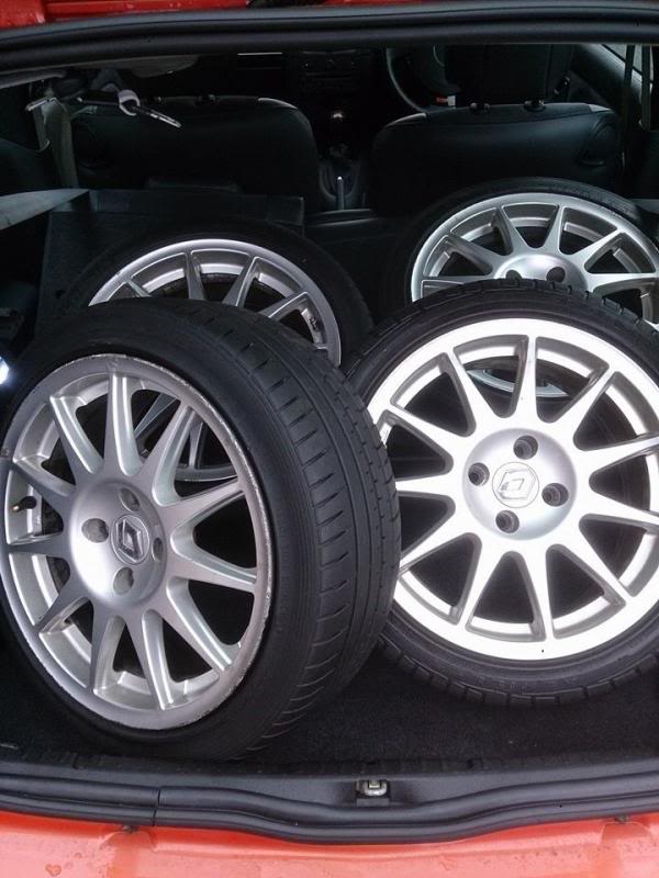

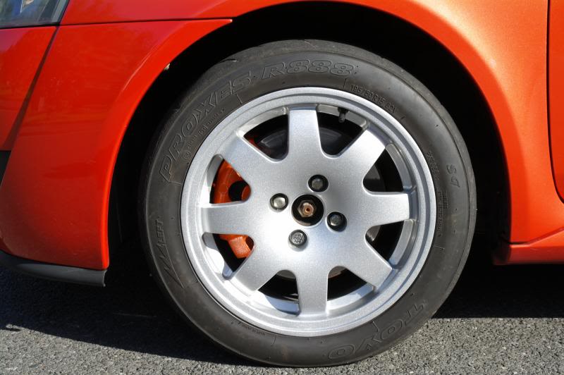

Well busy couple of days for me - I bought some wheels off Gumtree and ended up driving a 625mile return trip to North of Aberdeen to collect them.
The wheels are lovely high metallic silver williams wheels with R888 tyres. Plans are to get the wheels repainted high metallic anthracite and put my winter tyres on and keep the R888's for track or sell them on.
Ordered some centre caps so waiting on them as well.

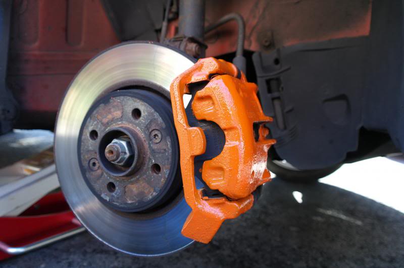

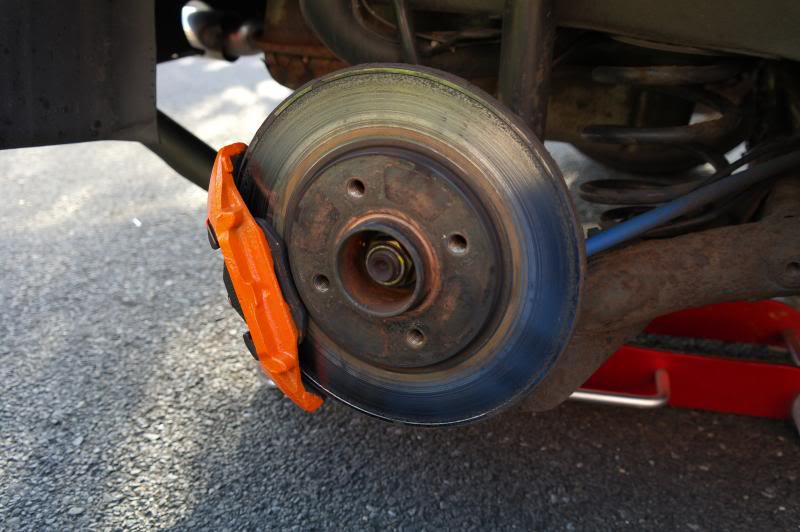

Also picked up some paint for the calipers and some more detailing gear:

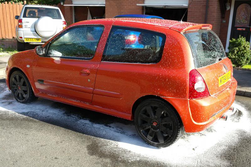

So today I had a day of playtime, first up a clean of the car, using Dodo Juice wax safe wash:
All clean and time for more work:
Calipers painted:
New wheels trial fitted:

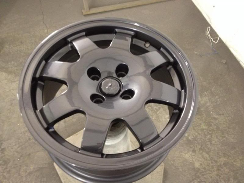

Wheels are being dropped off tomorrow for repaint in anthracite and also got some centre caps which may be ok for now.
Should suit that colour much better rather than silver

Well wheels are in getting painted now and should be ready at the weekend, also will have some custom renault centre caps if it turns out the way I wanted.

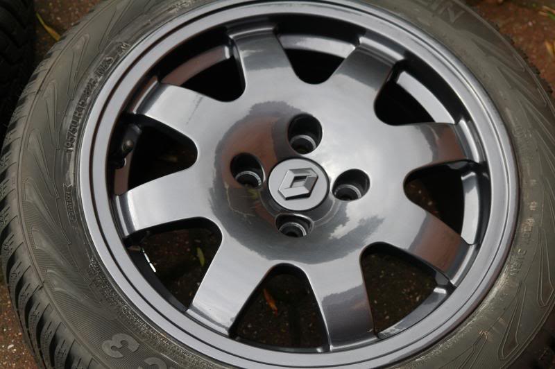

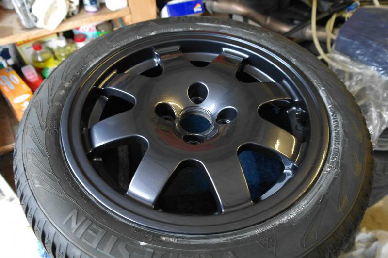

Well I now have these all ready to go on before going for laser alignment.
Photos sent to me from paintbooth:
Now with tyres on and custom centre caps ready to fit:

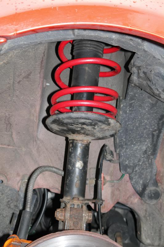

Also got my Eibachs from Lithuania (much cheaper than from over here haha):

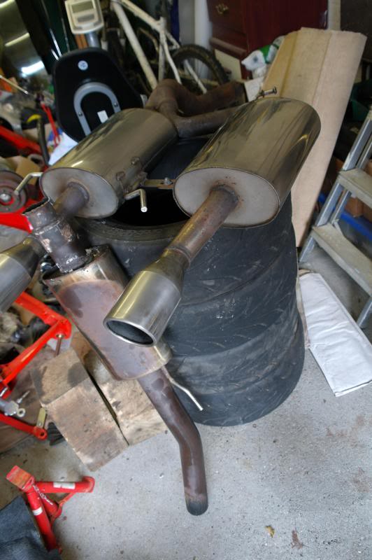

Now also got a Milltek stainless exhaust for a bargain price so that will be getting fitted soon as well

Also my bargain £90 Milltek exhaust:

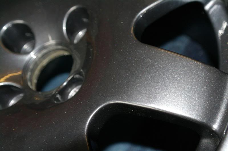

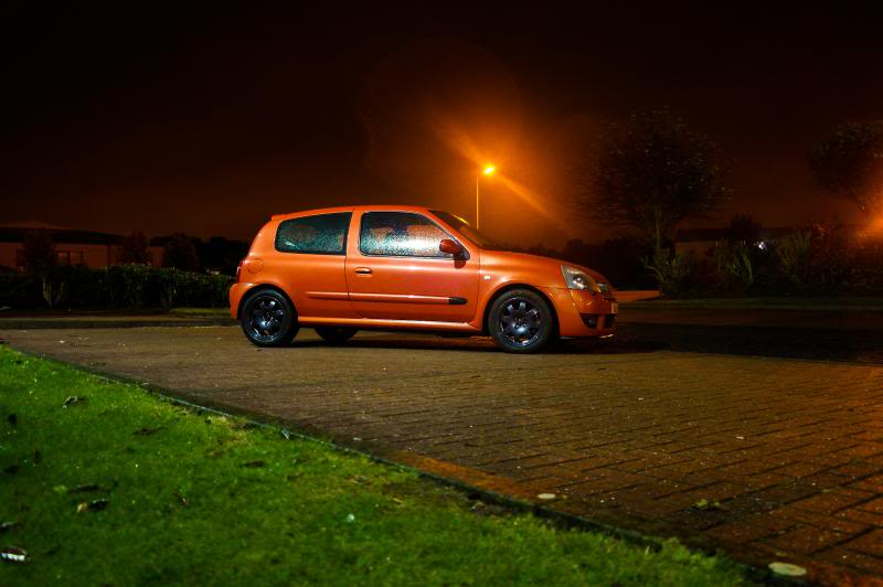

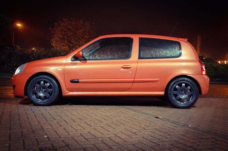

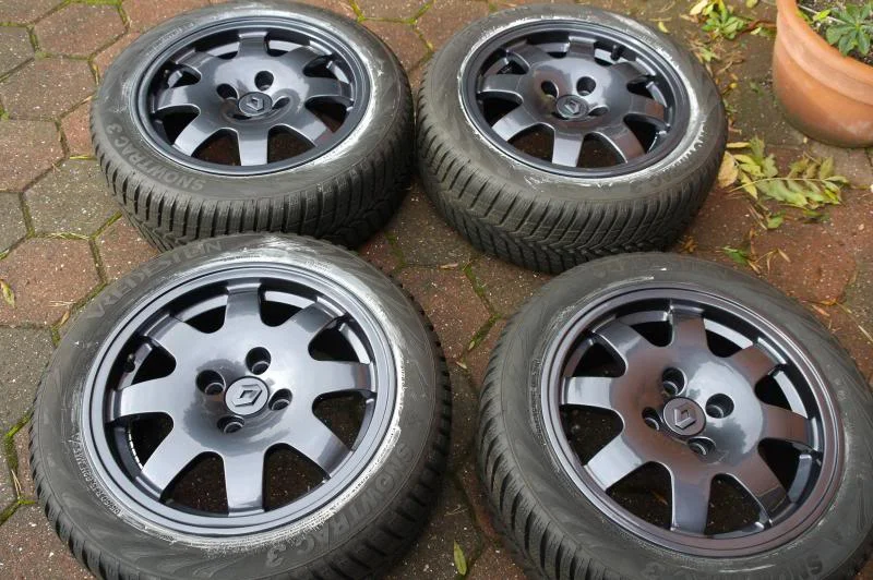

Well the repainted Williams wheels are on along with my Vredestein winter tyres and also managed to get the Eibachs fitted. Absolutely soaked off doing it but it needed doing haha.

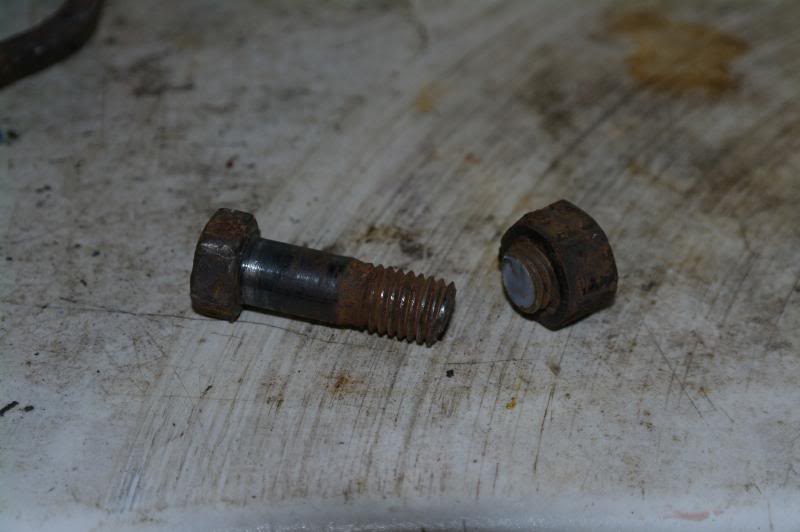

I also snapped a lower strut to hub bolt and they dont appear to be the correct bolts so these were replaced along with proper spare ones:
And the result:
Rob

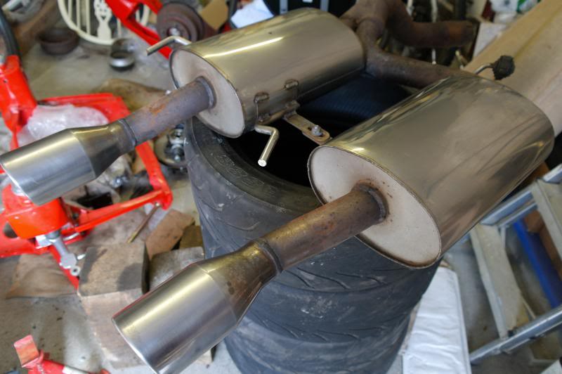

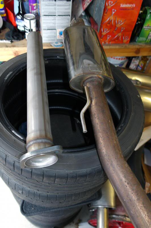

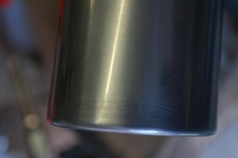

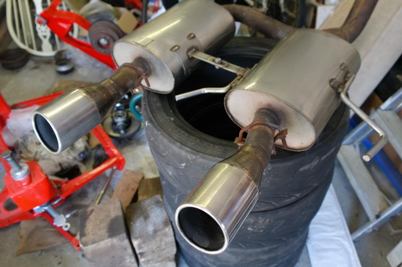

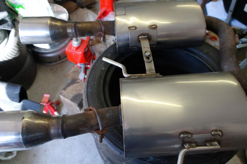

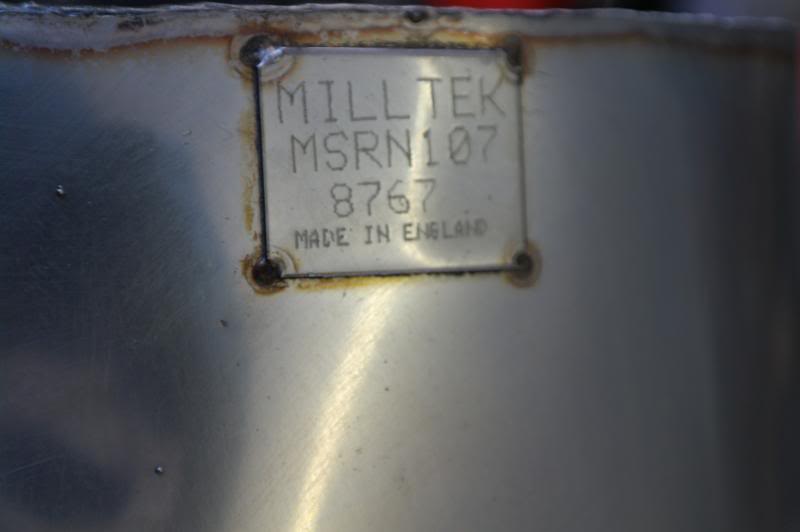

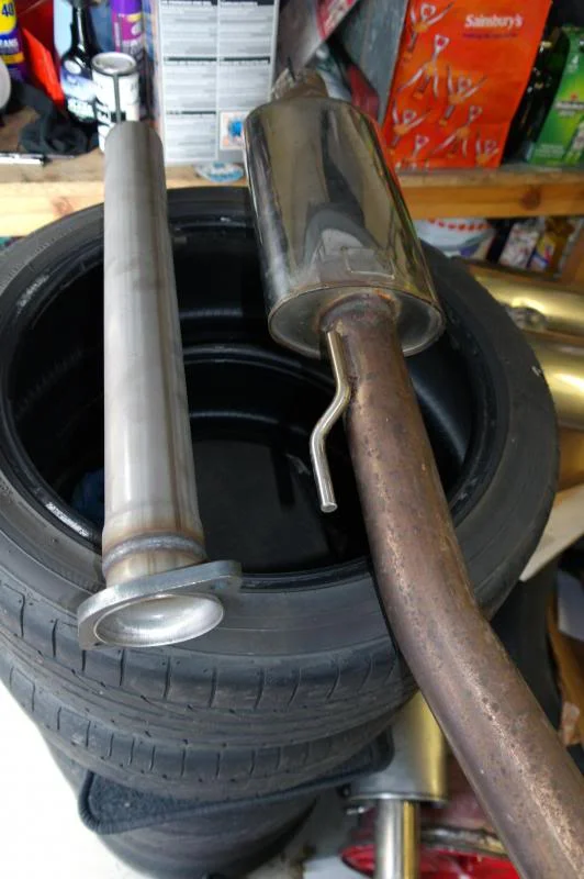

Finally got a day off so sorted all my bargain Milltek system out. For the grand sum of £180 I have a Milltek catback with 2 centre sections (1 is going to be a straight through section for trackday/summer) 1 is the standard Milltek centre section with the additional silencer.
I bought a brand new Milltek decat and genuine front fitting kit from Renault then got 3 new hangers.
The hangers have been filled with mastic to aid there strength and all being well will be fitted next week at MB Motorsport.
Also got a Milltek stainless adaptor for the olive fitting on a normal 182 if anyone needs one it will be for sale.
Cant wait as standard exhaust is blowing like hell now.

Wheels, tyres, ride height: Looks such a good winter set up :)
Re: My Inferno Orange 182 Project Thread - Fast Road/Occasional track day car....

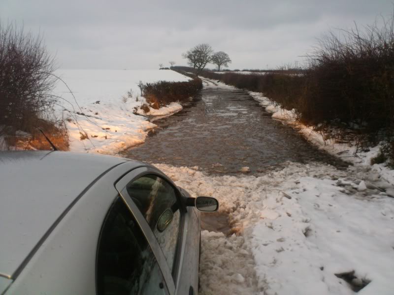

Is a great winter setup - had a very similar setup on a bargain bucket Ka last year and went all over in the snow haha
Unfortunately I was still defeated by this:
Wow that's some serious winter weather obstacles. Never thought a KA could master the snow

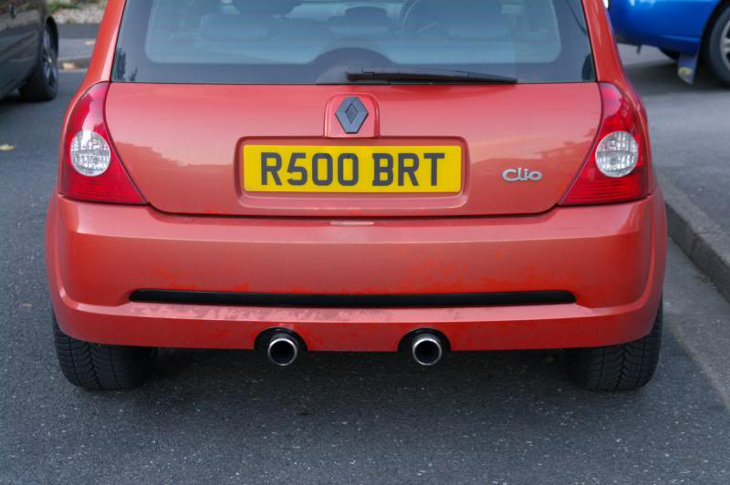

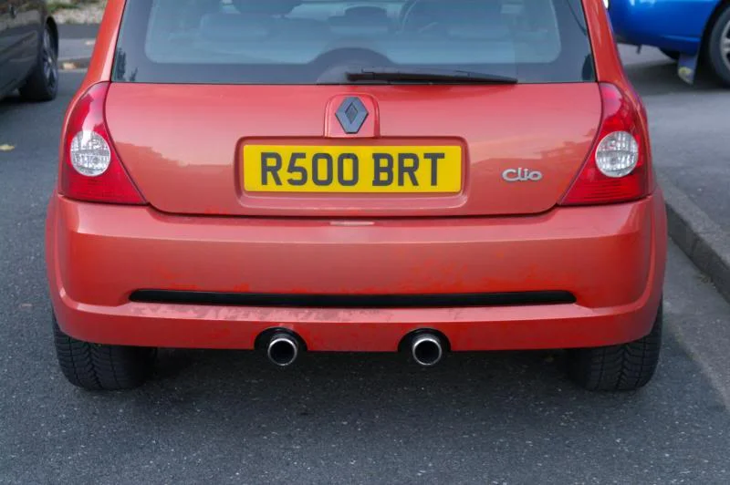

Made a start getting all the horrible grey/black plastics all repainted. Only got the back bumper insert and exhaust surrounds done as weather stopped play.
Ignore the dirt on the car - weather permitting the car will be getting cleaned and a third layer of wax adding tomorrow
Rob

How did you get that rear bumper strip out? I've done every plastic on mine matte black now but can't get that rear strip out!!
Cheers
I gently pushed out one edge from the back (2 visible tabs when looking from underneath). Then gently work along bumper with a large screwdriver between the strip and the bumper turning it a quarter turn to pop the clips out.
Was a slow and careful process to prevent the strip from bending and snapping.
