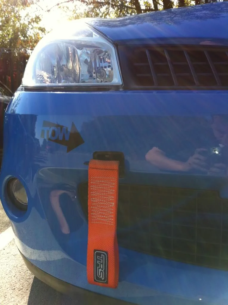

First update: The custom Tow Strap... and spray

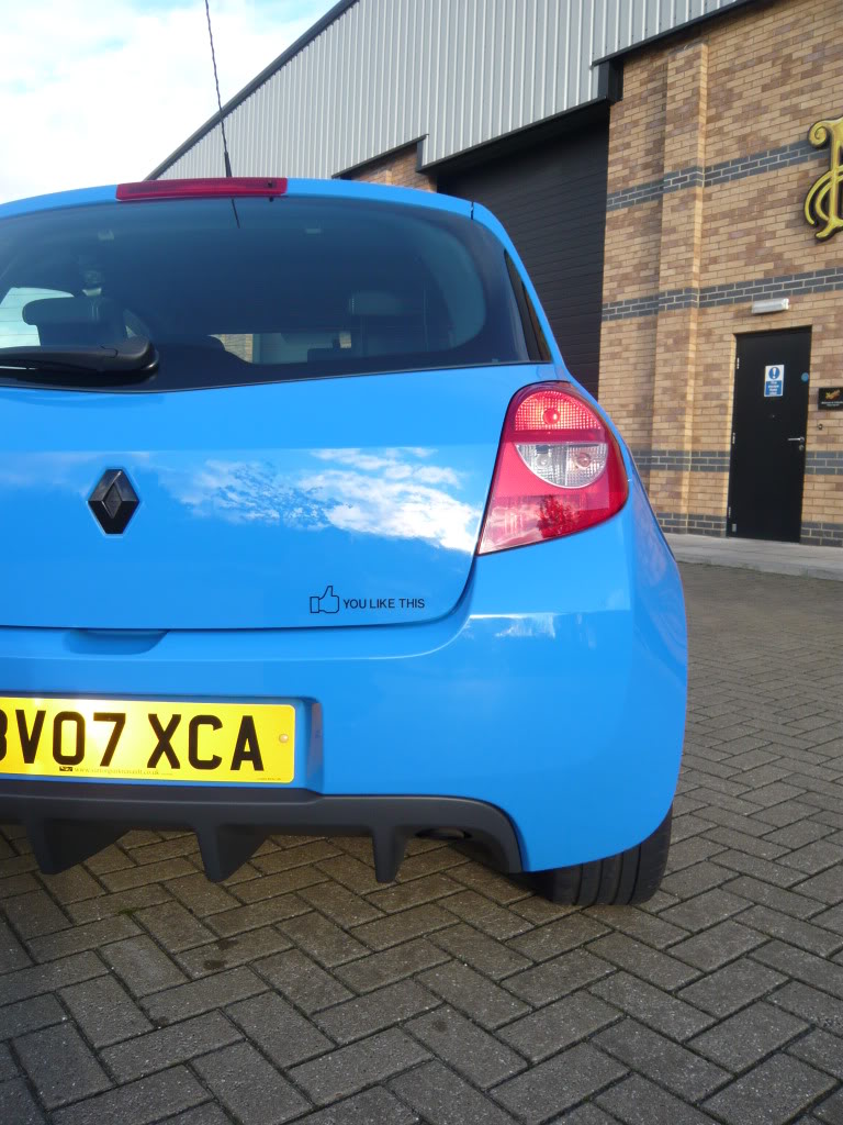

first came a sticker order and a de badge with my first go with clay :/ (need help with this but that will come)

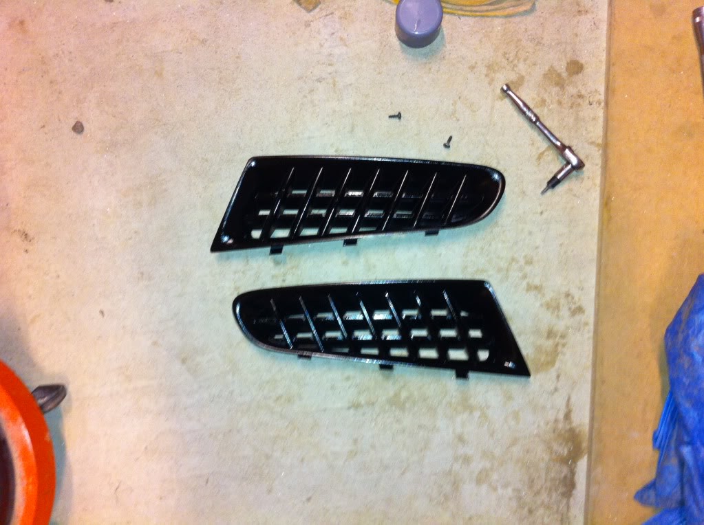

then badges and grills went black

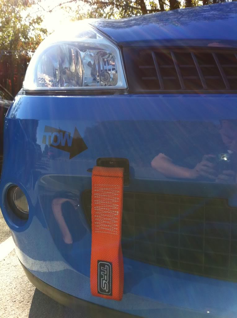

And the orange and blue theme begins

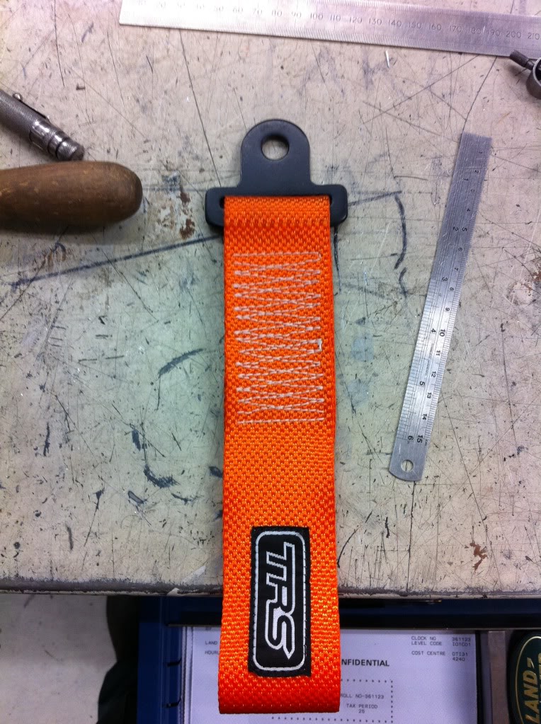

with an order of an orange TRS tow strap.

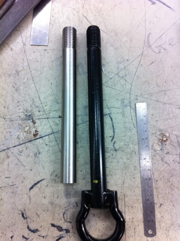

and the custom bar was in the making using the original as a guide,
and fitted (got loads more pics)

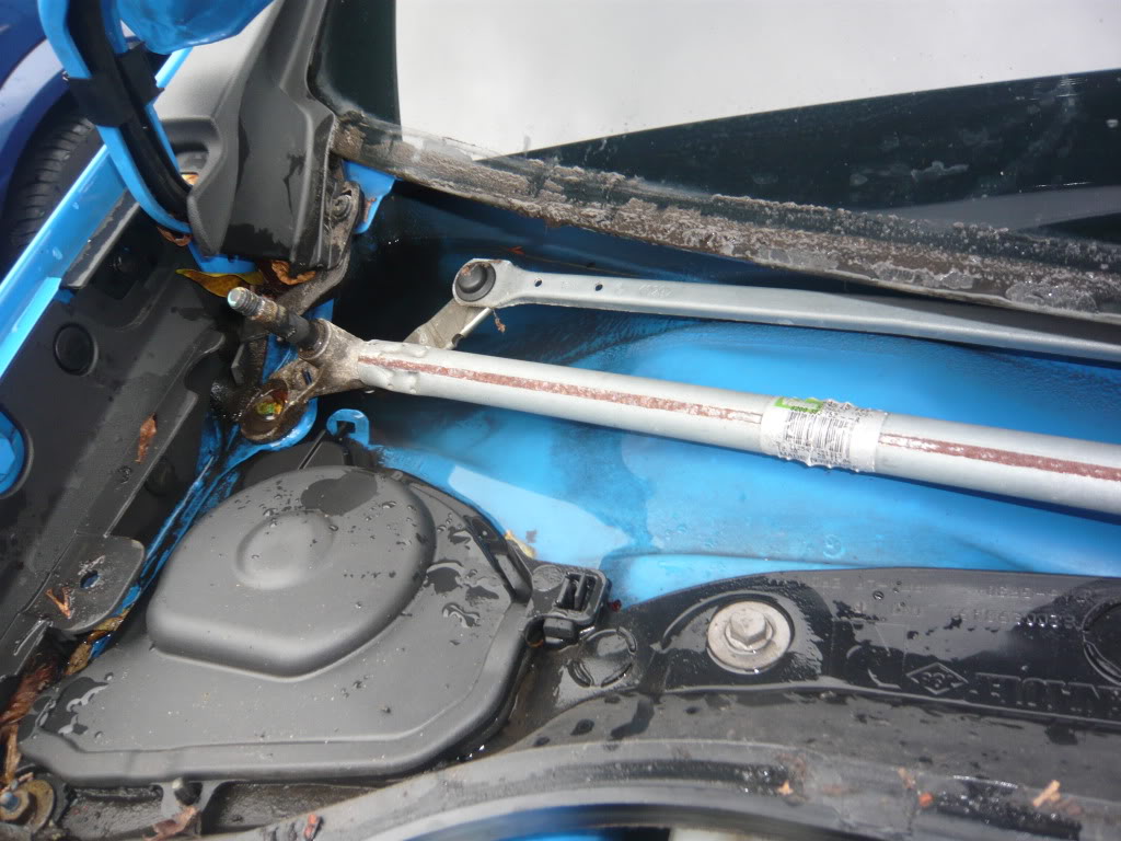

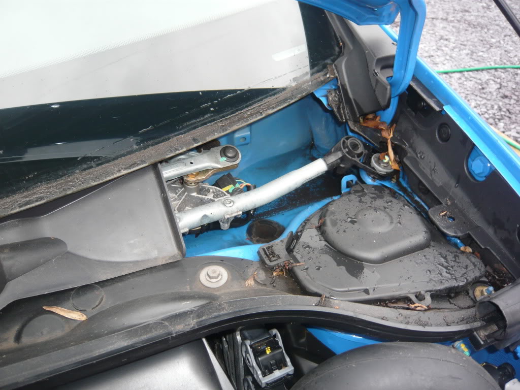

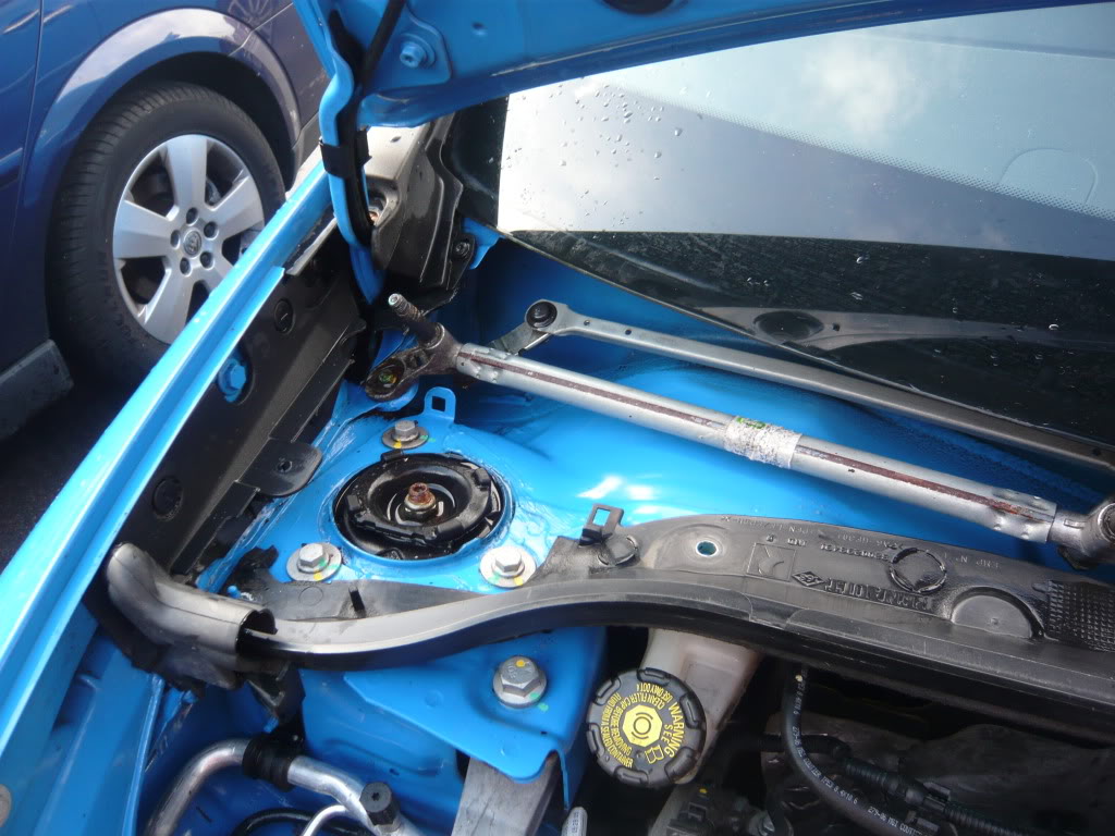

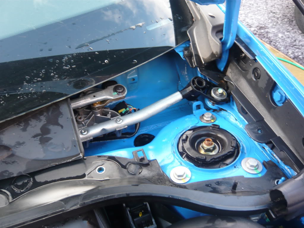

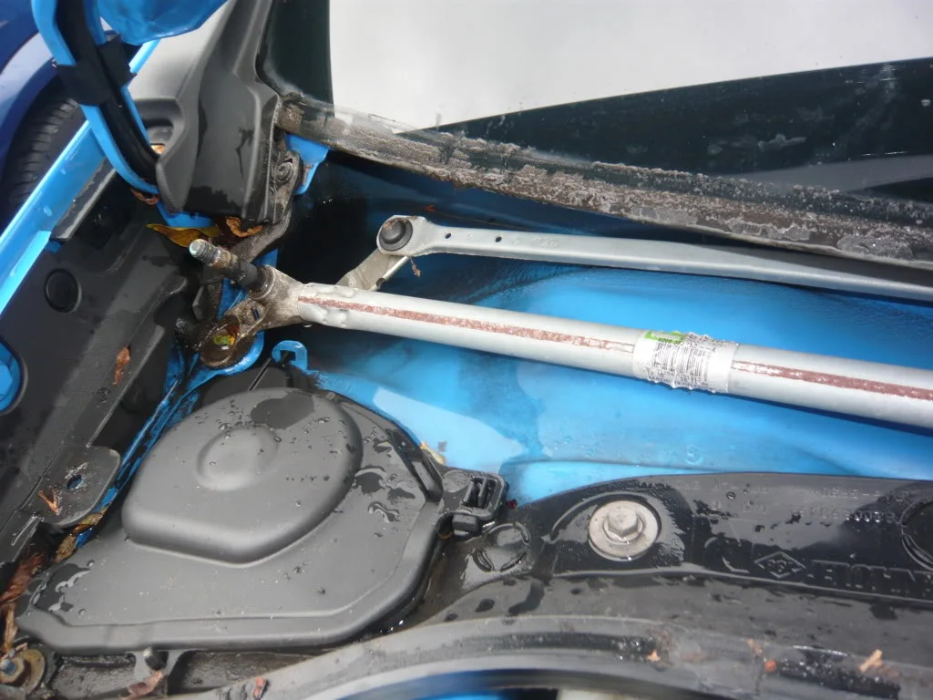

Decided to give it a once over, and i needed to attack my random water problem, where when i broke sharply water was spraying out the bonnet and up the wind screen NOT COOL:mad: as i explained at the start of the thread when i broke heavily and water was spraying out the sides of the bonnet and up over the sides of the windscreen.
In my hunt i found these pools hidden away under all that plastic;
basically it was full of gunge and general S**T i had to use wire down the pipes to clean them out so the water could flow out of them. and cleaned the general area.

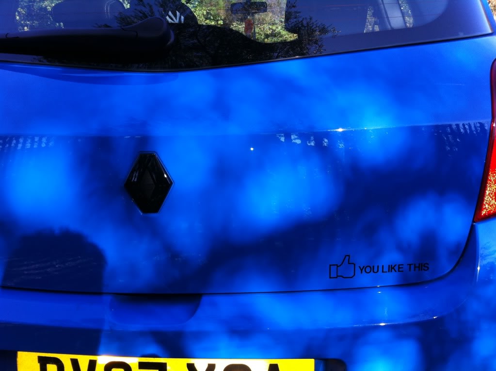

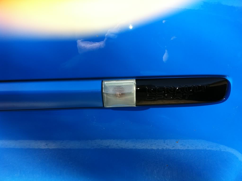

also i mention the so called 'ghost marks' but the like small spots that WILL NOT MOVE of the paint?
If anyone has any idea on what this could be or how do get rid of it would be much appreciated. I've tred clayin the polishing and i dont mean a quick clay and polish i speant a good while trying but didnt seem to budge.
There highlighted in RED
