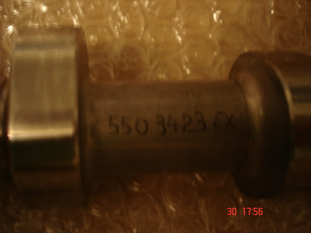

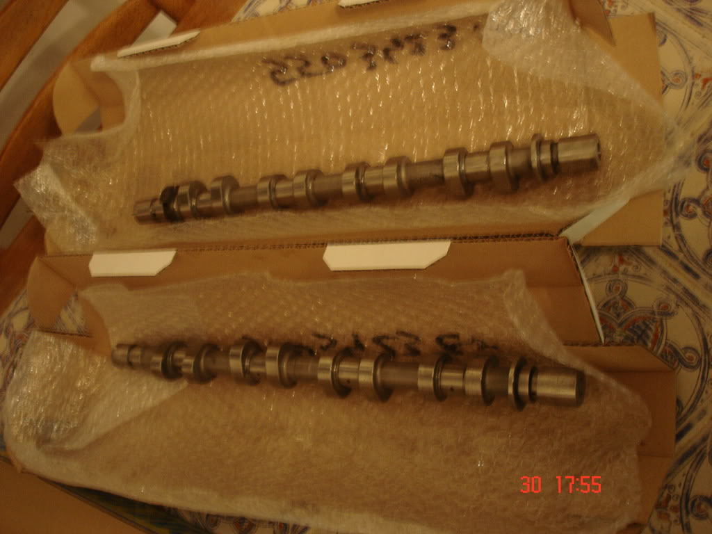

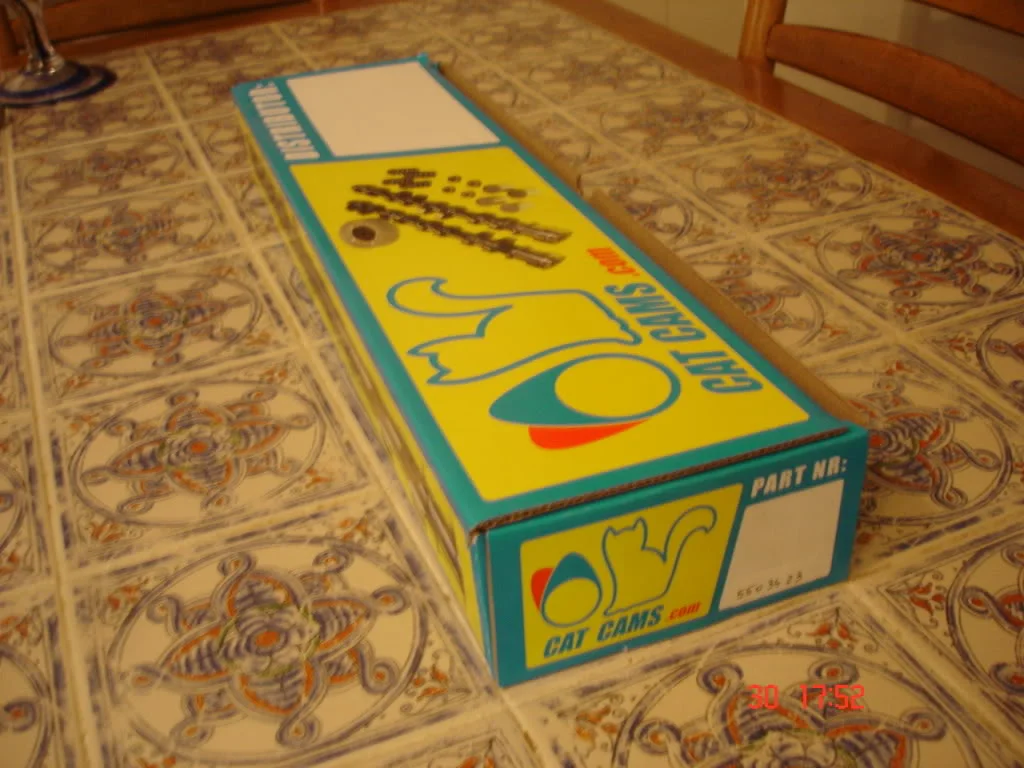

423's
Conrods

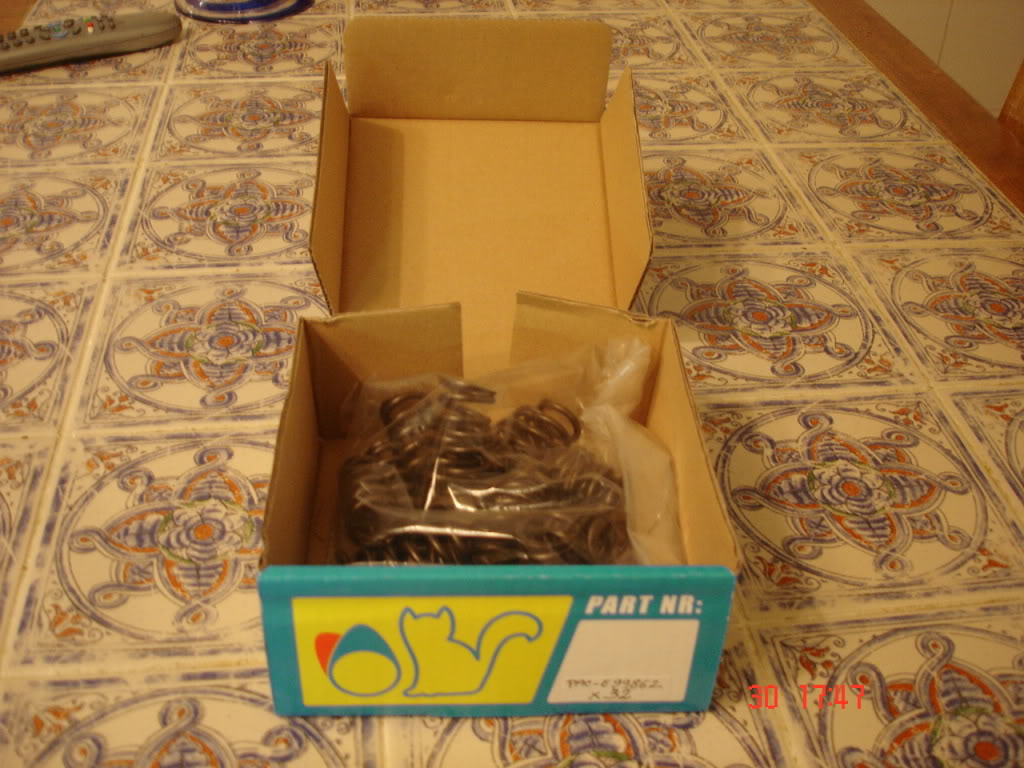

Valve Springs

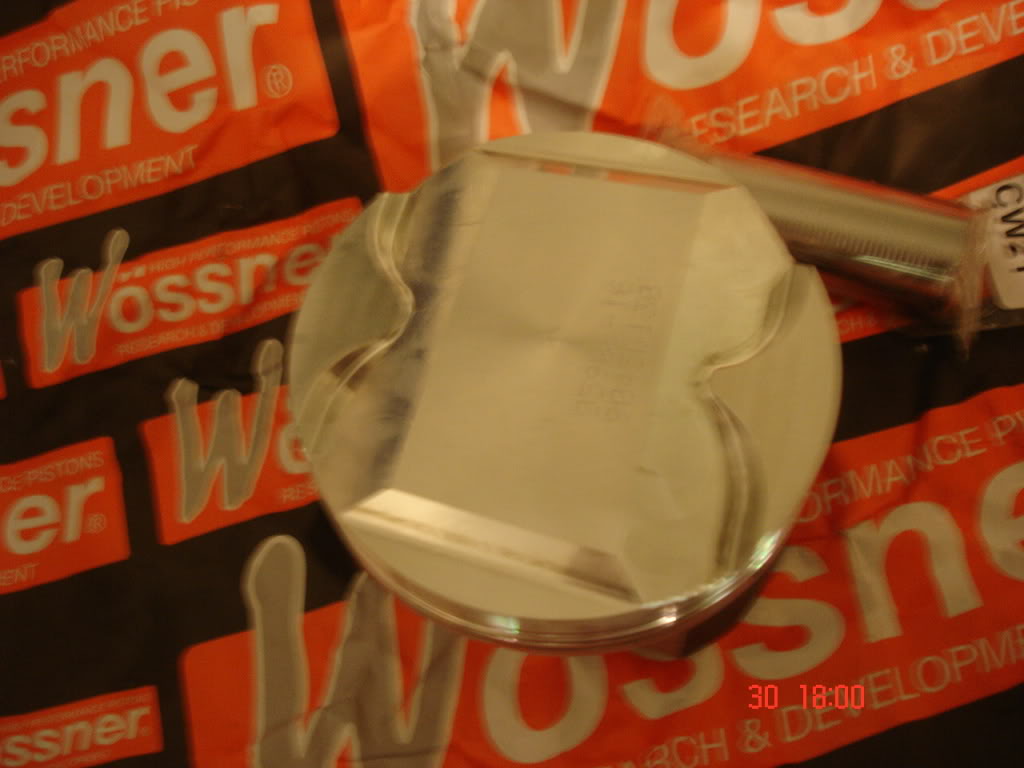

Piston

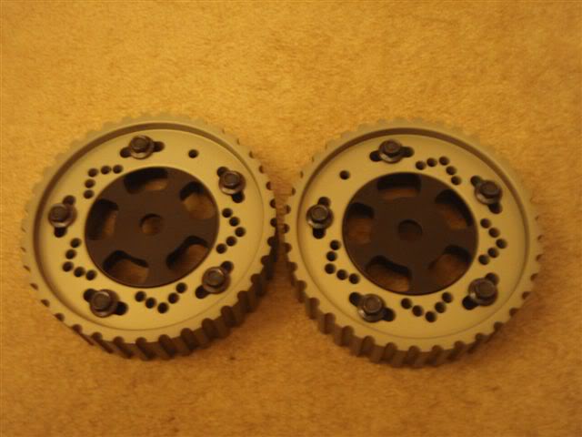

Adjustable Pulleys

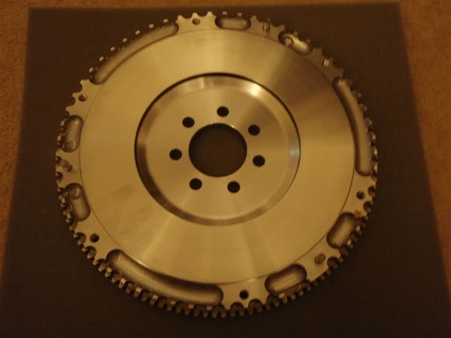

Flywheel

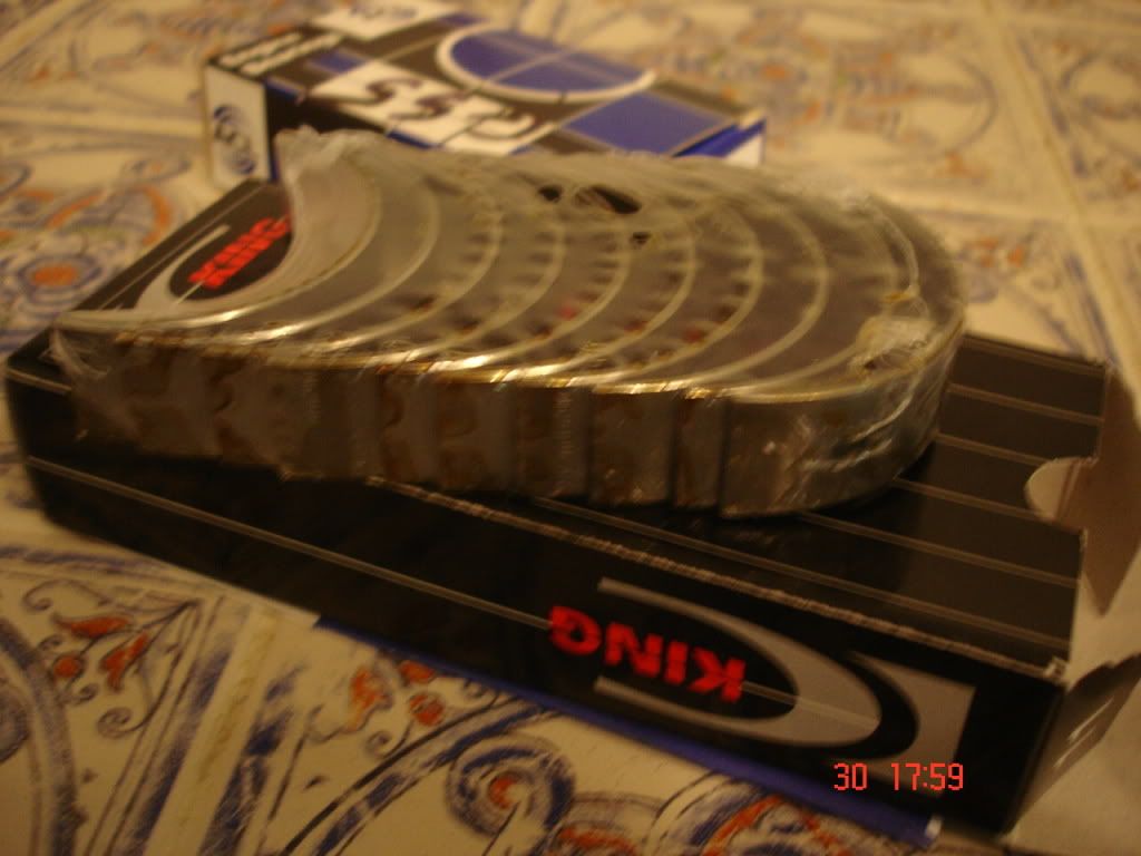

Bearings

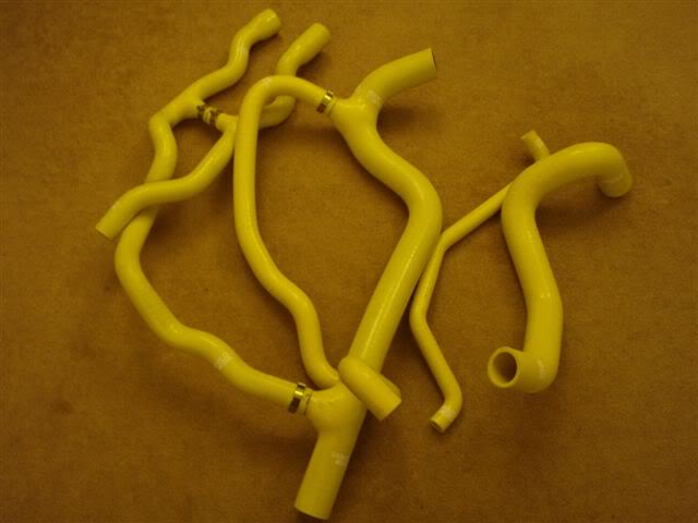

Hoses

Nice list of bits. I don't ever recall seeing 423's being used in a road car, has anyone before? Are they much more agressive than 422's?
Cro
  Meg'd r27
Re: PH1 172 Track Car, abit special *ITB update*
Oooooooooooooh nice list of goodies you have planned there :)
Barron
  Turbo S,Exige,R5,182
havent seen them used on a car.
5502422
284 / 276°
247 / 239°
11.25 / 11.25mm
3.40 / 2.85mm
custom
HYDR: rally & cross
5502423
292 / 284°
255 / 247°
11.25 / 11.25mm
3.95 / 3.40mm
custom
HYDR: rally & race
thats the spec difference, so abit wilder. Hopefully they dont peak too highly.

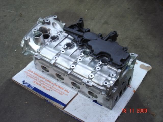

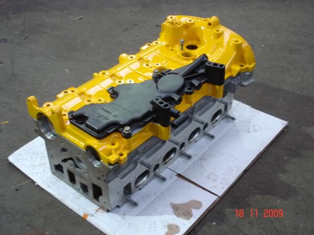

Yellow looks pretty tho, is that sprayed silver or polished?
Daz.
  Clio 200 RS EDC
suprised i'm saying this but yellow.
