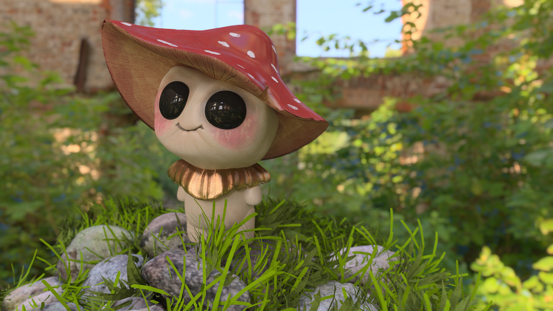

sipt2_20220306_021407_1920x1080_s25665 by Andy Eder, on Flickr
sipt2_20220306_030904_1920x1080_s19942 by Andy Eder, on Flickr
sipt2_20220307_031731_1920x1080_s30720 by Andy Eder, on Flickr
sipt2_20220307_223341_1920x1080_s45824 by Andy Eder, on Flickr
sipt2_20220308_032013_1920x1080_s6622 by Andy Eder, on Flickr
sipt2_20220308_183543_1920x1080_s5029 by Andy Eder, on Flickr
sipt2_20220309_010029_1920x1080_s20892 by Andy Eder, on Flickr
sipt2_20220311_234530_1920x1080_s22281 by Andy Eder, on Flickr
SIPT Test Render by Andy Eder, on Flickr
I also put a recent-ish video together showing v2.0 running for the first time. Sadly YouTube compression does not play well with path traced graphics so the quality isn't a true representation of the final quality!

Absolutely amazing, what are you hoping your application will do that others don't?
It did look incredibly fast in your youtube, I think faster than whatever engine blender uses. I found the 3090 to be a big step up in terms of rendering speed too.
SharkyUK
Thanks, mate. (y)
My path tracer, in many ways, is fundamentally similar to that of the Cycles renderer in Blender. Having had a very quick look through the Cycles code it would appear that they have been following the same research as I have and getting ideas from that, although our realisations of that research obviously differ in terms of interpretation and implementation. I do believe that my path tracer is faster than Cycles but it's not quite so clear cut once you start digging deeper.
Blender's renderer is a LOT more flexible and powerful than mine and is capable, at least for now, of handling far more complex material types (and, consequently, the way light interacts with those material types). I sacrificed that complexity in a bid to see what levels of performance I could reach whilst still maintaining real-time (or interactive) frame rates. Whilst Blender is still very much focused on "offline" rendering (where it doesn't matter if a single frame takes hours to render), I wanted to see how path tracing could be used in a real-time scenario as typically found in gaming (or, indeed, pre-vis for movies and VFX). To take it a step further, I did not want to go down the route of leveraging the likes of RTX as, whilst impressive, it only represents (and accelerates) a small part of what path tracing is about and is closely tied to the existing shader and rasterisation hardware in GPUs as we know them. I'm thinking ahead a few hardware generations where we might start to look to move away from rasterisation and to where GPUs are increasingly becoming general parallel computing powerhouses.
sipt2_20220219_035724_1920x1080_s100365 by Andy Eder, on Flickr
As daft as it may seem, it could actually make the rendering developer's jobs easier as it means fewer hacks and smoke and mirrors are needed to generate imagery. Right now, modern rasteriser-based game renderers are comprised of multiple complex systems that have to work together in harmony to produce the visuals we demand of them. Even RTX cannot fully harmonise this (although it can certainly help with reflections, shadows and global illumination to a point). Hands down, the modern rasteriser-based renderer is a real b!tch to implement and maintain. :LOL: That's not to say a path traced solution is simple (it brings its own problems) but the unified nature of the algorithm means complexity should be reduced. Do you want shadows? No problem, path tracing automatically handles that. Soft shadowing and prenumbras? No problem, path tracing handles that. Caustics? No problem, path tracing has your back. Ambient occlusion? Global illumination? No problem, no fancy auxiliary systems are needed as it's inherent to path tracing. It could also mean a reduction in the complexity of uber-shaders or not having to write hundreds of shaders to handle every different type of surface/material interaction that your game/application may require. Once your path tracing pipeline is set up you can simply implement well-known BRDF/BSDF/BSSDF/etc. as per your needs - these are just physically-based algorithms that generate realistic (or good approximations) of how light and surface interact together. If you need special effects then you can simply write stylised variations to suit.
I'm not really sure where I'm headed with my project as it's very much for fun and research, almost like a sandbox for experimentation. I think I will probably look to improve its material handling and to align it with current trends and algorithm adoption as per many of the big-boy commercial renderers out there. The downside here is that it's quite an undertaking as I'll have to refactor a lot of existing code. But that's the challenge and where the fun lies for me. Always learning! I've been collaborating and working with a couple of businesses recently (alongside my other contract work, and who certainly know a thing or two about computer graphics) and the research and advances being made in this area are very exciting (both on the hardware side of things and on the software side, too).

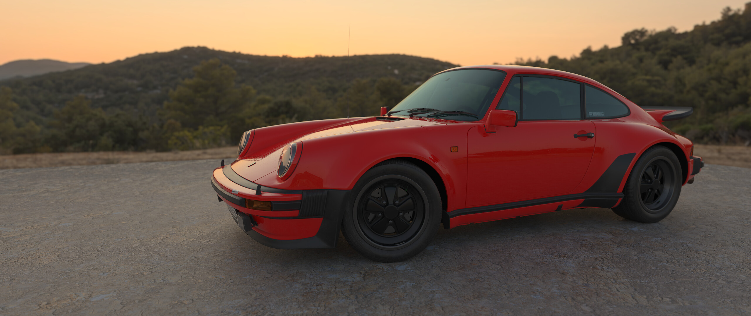

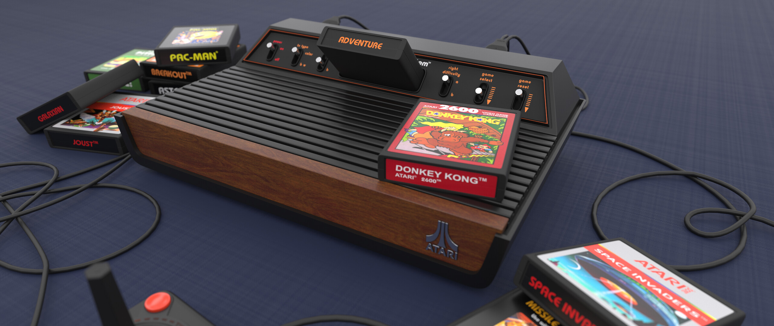

I've not had as much time as I'd like to work on things recently but here are a few more test renders from some ongoing GPU path tracing research I'm doing.
SIPT Test Render
SIPT Test Render
SIPT Test Render
SIPT Test Render
SIPT Test Render
SIPT Test Render
SIPT Test Render
SIPT Test Render
SIPT Test Render

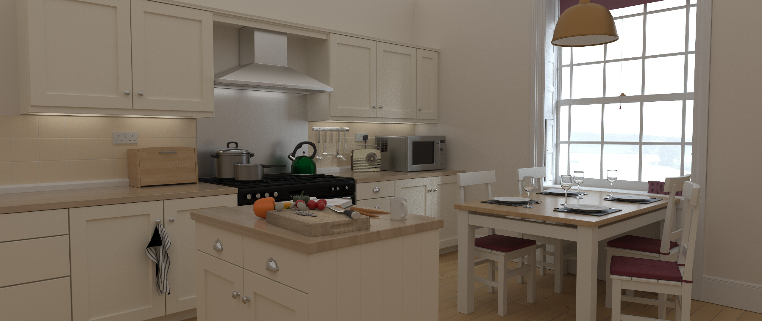

SharkyUK
A few more test renders. All a bit boring but the project is undergoing a significant rewrite in places and the test renders at least offer some confidence that things are working (or thereabouts!) :ROFLMAO:
Test Render
Test Render
Test Render
Test Render
Test Render
Test Render
Test Render
Test Render
Test Render

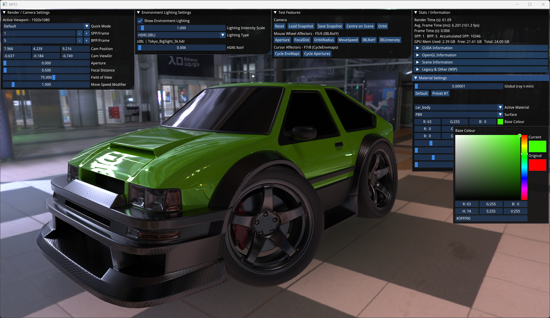

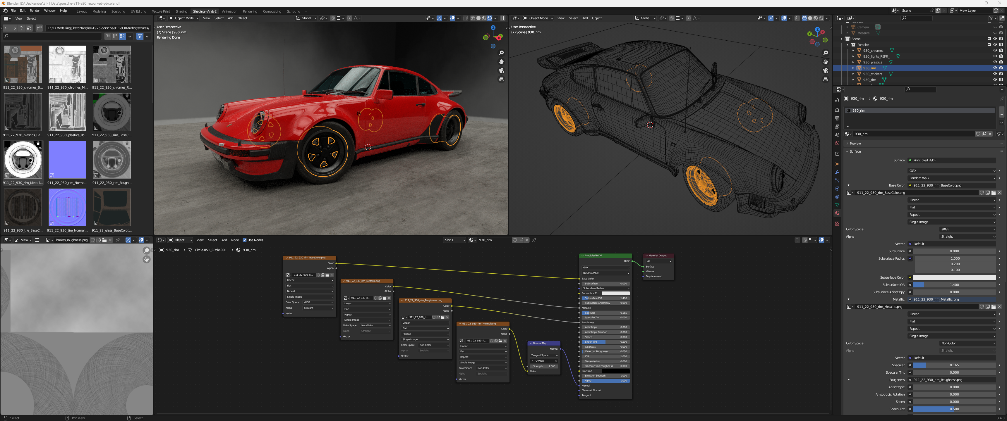

As mentioned in the paragraph above, my rendering engine is basically a 3D scene viewer with some interactivity thrown in for good measure. It mainly came into being due to:
  • My interest in 3D CGI and the tech behind it
  • I wanted to write a ray/path tracer that used the GPU rather than the CPU (I like a challenge!)
  • I wanted a sandbox to play with new ideas and to implement new papers/algorithms in the computer graphics domain
  • I wanted a sandbox to experiment with ideas that I could use as a hobbyist and also with clients who were interested in my graphics coding abilities
As a result, the rendering engine is a mish-mash of technologies, ideas, hacked algorithms, and research stuff - but geared specifically to physically based rendering (PBR) to achieve realistic results that closely approximate nature - i.e. geared towards what happens when light rays/photons hit surfaces and how those light rays move travel through different mediums, how light is scattered/reflected/refracted/transmitted, and so forth. At the heart, my engine is using very similar methods and algorithms to those used by Pixar, Industrial Light and Magic, Disney, Weta, etc. and in the tools they use. Strange that... ;) :p
Due to it being a viewer rather than an editor, I am relying on other tools to author my 3D scenes. My current tool of choice is Blender. It's free and it's incredibly well-supported. It is also capable of producing some fantastic results comparable to those in higher-end products that cost thousands or that are utilised by visual fx studios. I basically use Blender to build the 3D scenes (using existing assets more often than not) and to also set textures/materials, lighting, camera, etc. I then export that scene from Blender and my render engine has custom code that can import/consume that data, and then render it. Simples! :ROFLMAO: In fact, hold on... some examples...

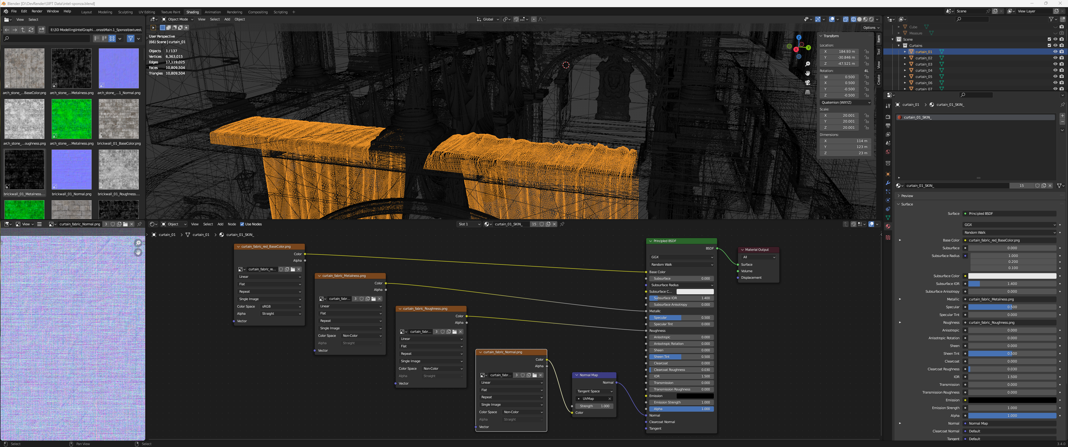

There you go, Blender in all its glory! As you can see, I use it to position objects, set texturing and material properties, and so forth. At this moment in time, I am going through a huge rewrite so lighting and camera information that I set up in the scene are currently... hence my render engine currently handles that by using image-based lighting (IBL). More on that in a moment.
So yeah, I fiddle with the scene in Blender and - when I'm ready to go - I export the scene and load it into my render engine. It's quite useful being able to compare the path-traced results that my engine produces directly against those produced by the Cycles renderer built into Blender. There are a lot of similarities but, again, this is due to the fact that - at their heart - they are using very similar technologies and algorithms (which is kinda becoming standard in the CG rendering domain these days).
Does my engine have a GUI? Well, sort of. :ROFLMAO:
Again, my engine is not an editor and is very much a research project/hobby so the GUI is very limited and changes to reflect what I am working on. Or what I am trying to fix when I hit issues. And that happens a lot. As much as I love this s**t, it can be a complete mind f**k at times. I won't lie, a lot of physics and mathematics goes over my head sometimes and I have to seek help or just rely on mathematical proofs/equations being correct even if I can't understand some of the more complex stuff! LOLz! Anyways, I digress... my GUI is mainly focused towards allowing me to see useful information (such as camera position and view direction) and other debug stuff so that I can track down and fix issues with the rendered imagery. It also provides me with a simple means with which to have limited interactivity with components in the scene. So, for example, I can access the materials I set up in Blender and tweak them on the fly in my rendering engine. Here I have changed the car's paintwork from red to green...
In addition to playing with materials, I can change the camera aperture, focal length, depth of field, etc. It's not a fancy GUI by any means, but it's functional! I can also tweak lighting, which is useful due to the fact that I currently cannot import lighting information from Blender. Well, I can't import DIRECT lighting information (i.e. explicit light sources such as point lights, cone lights, directional lights, etc.) - lights which are typically used to represent any light source in a 3D scene other than, perhaps, the sun! This will be fixed at some point and my render engine does have support for direct lights but... it will be a while until that is in and working again.
So, in the meantime, I am relying on IBL (image-based lighting) to light the scene. This is no bad thing as it is what movies and visual fx studios use to provide the global illumination (INDIRECT) lighting for their 3D scenes. It gives a very realistic look to the scene and helps ground objects within the environment. Basically, an image is used to wrap the entire scene and this image stores radiance data as opposed to just RGB colour values. That way the image contains both colour information and also light intensity - hence the image may contain the sun with realistic lighting values encoded in the image, which I can then use to light the scene as if in the real world. It means my rendering engine produces true HDR images (which I can then tonemap back to standard SDR if needs be). In the image above, the cartoon AE86 car is lit purely by the image of the shopping mall you see around it. Whilst it looks like a shopping mall image, that image also contains the light intensities (as described) so light sources in the image are representative of real-life light sources and can be treated as such to light the car. It's pretty cool and a common way to light scenes these days, especially in visual fx and archviz. My render engine can load HDRi images for IBL and I can then manipulate their intensity and/or rotate the environment image to find better lighting angles, etc.

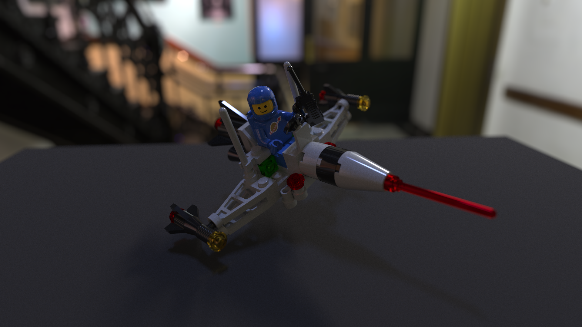

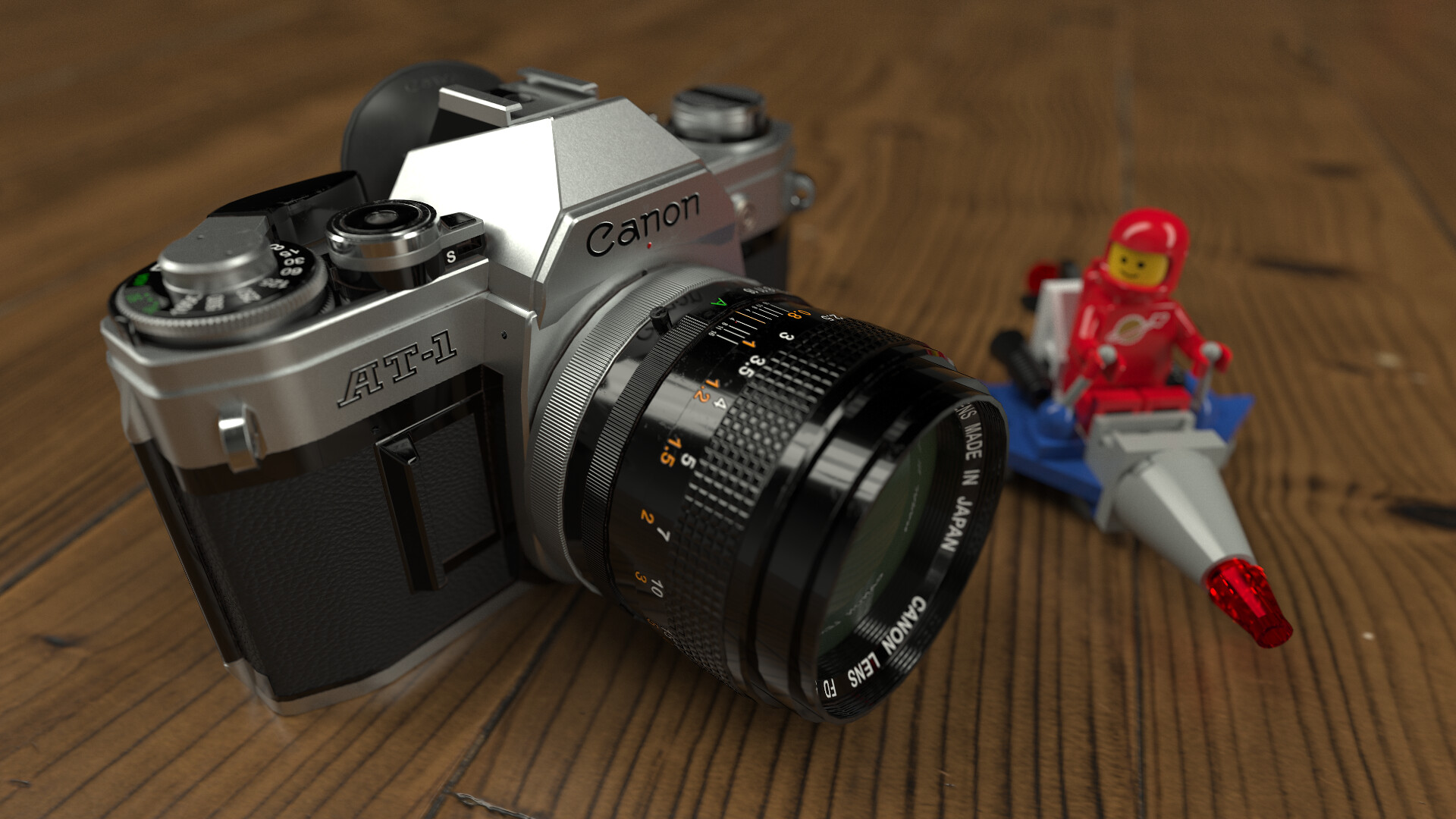

It can be used for both really. It uses Monte Carlo methods to render the scene which means that, over time, the rendered image finally resolves towards a cleaner and more accurate result/image. Depending on the lighting and material complexity within the scene, it's quite possible that the rendered image appears quite noisy as the algorithms attempt to calculate the correct physical representation of what we see as light bounces around and enters our eyes. The longer the time spent rendering, the more 'perfect' the image. Let me find an example...
The first image (above) was captured within a few milliseconds of the rendering process starting. You can see the noise/grain in the image. This is because the algorithm hasn't traced enough light paths to generate a satisfactory image. In this example, each individual pixel had been sampled 800 times, which means each pixel has had 800 light paths traced for it (although each light path can bounce multiple times before terminating). However, the process is accumulative and refines the image over time...
...so the second image (above) is a lot clearer and a closer approximation to what we'd expect to see in the real world. The lights shining through the glass-like spheres are clearer (the white blobs are simulated lights I added programmatically) and the floor looks a lot clearer and defined. In this case, each pixel has had light paths traced over 50,000 times each. I won't do the maths but it's a LOT of calculations. We are talking billions due to the way this process works (and the reason why ray and path tracing is generally so slow).
And here's another example, using the same image to provide the lighting for the Lego model. Noisy image...
...to a cleaner image (after a period of time).
That's why AI de-noising is such a big thing these days. It means we can get cleaner images in a fraction of the time (or at least that's the intention, and massive strides are being made in this area). The AI 'filters' the noise away.

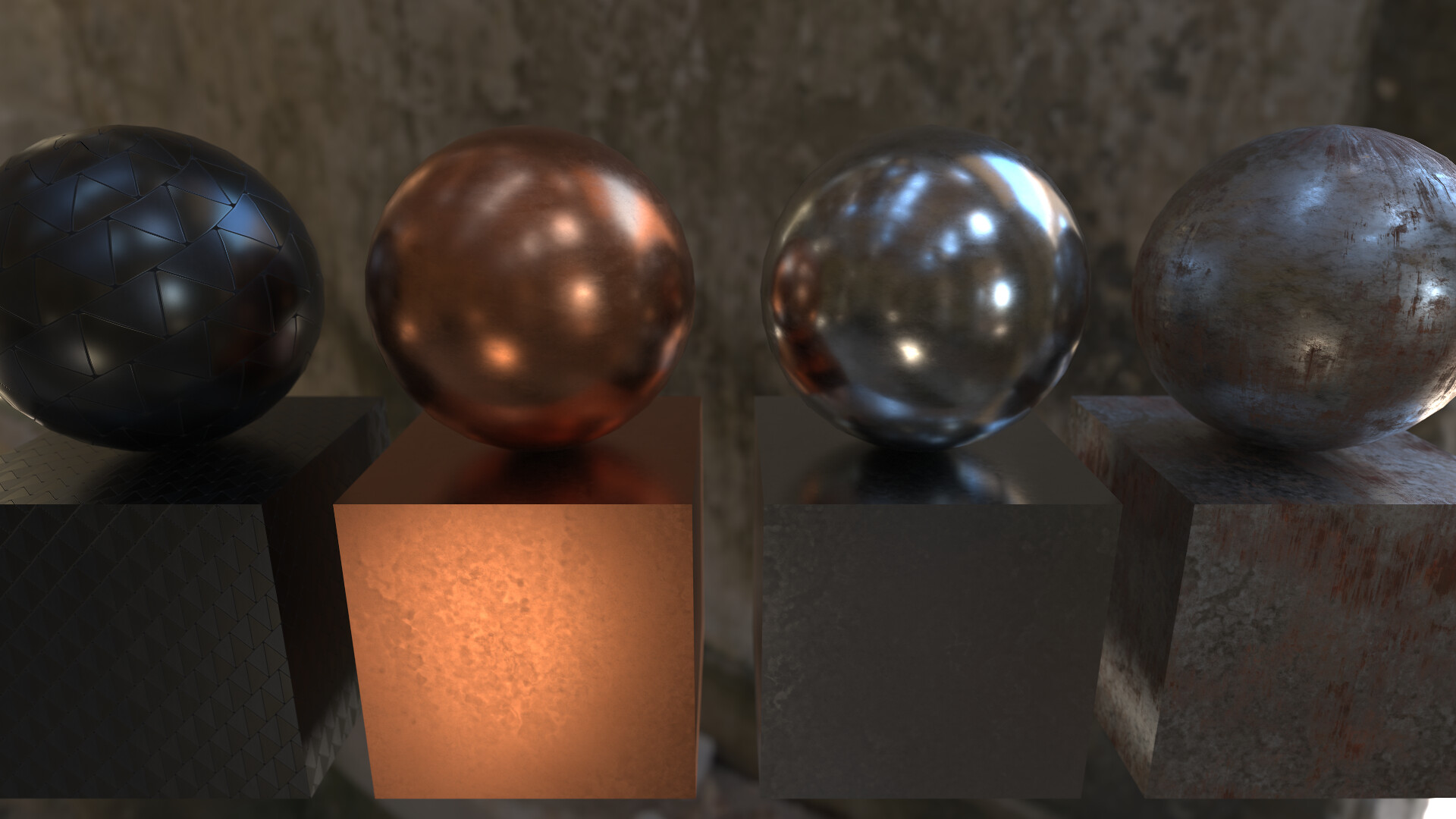

Here are a few more test images I made recently with the new changes I'm working on. Not great, a few things are broken as already said...! :ROFLMAO:

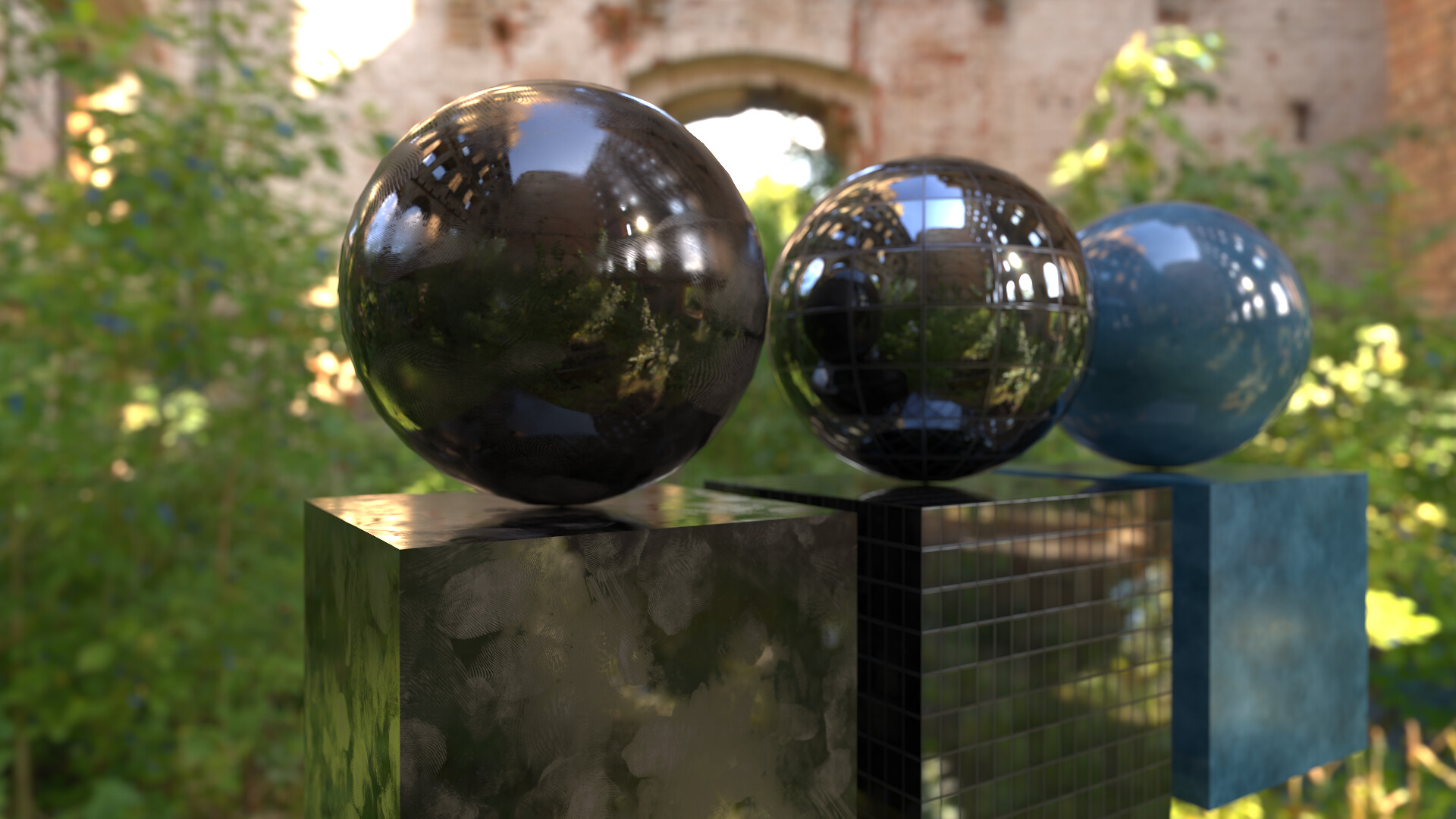

Some material tests...
SIPT Materials Test
SIPT Materials Test
SIPT Materials Test
SIPT Materials Test Render

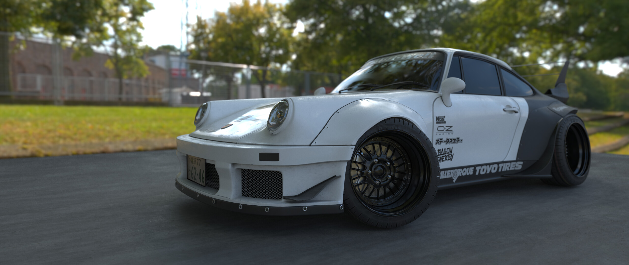

And some more tests...
SIPT Test Render
SIPT Test Render
SIPT Test Render
SIPT Test Render

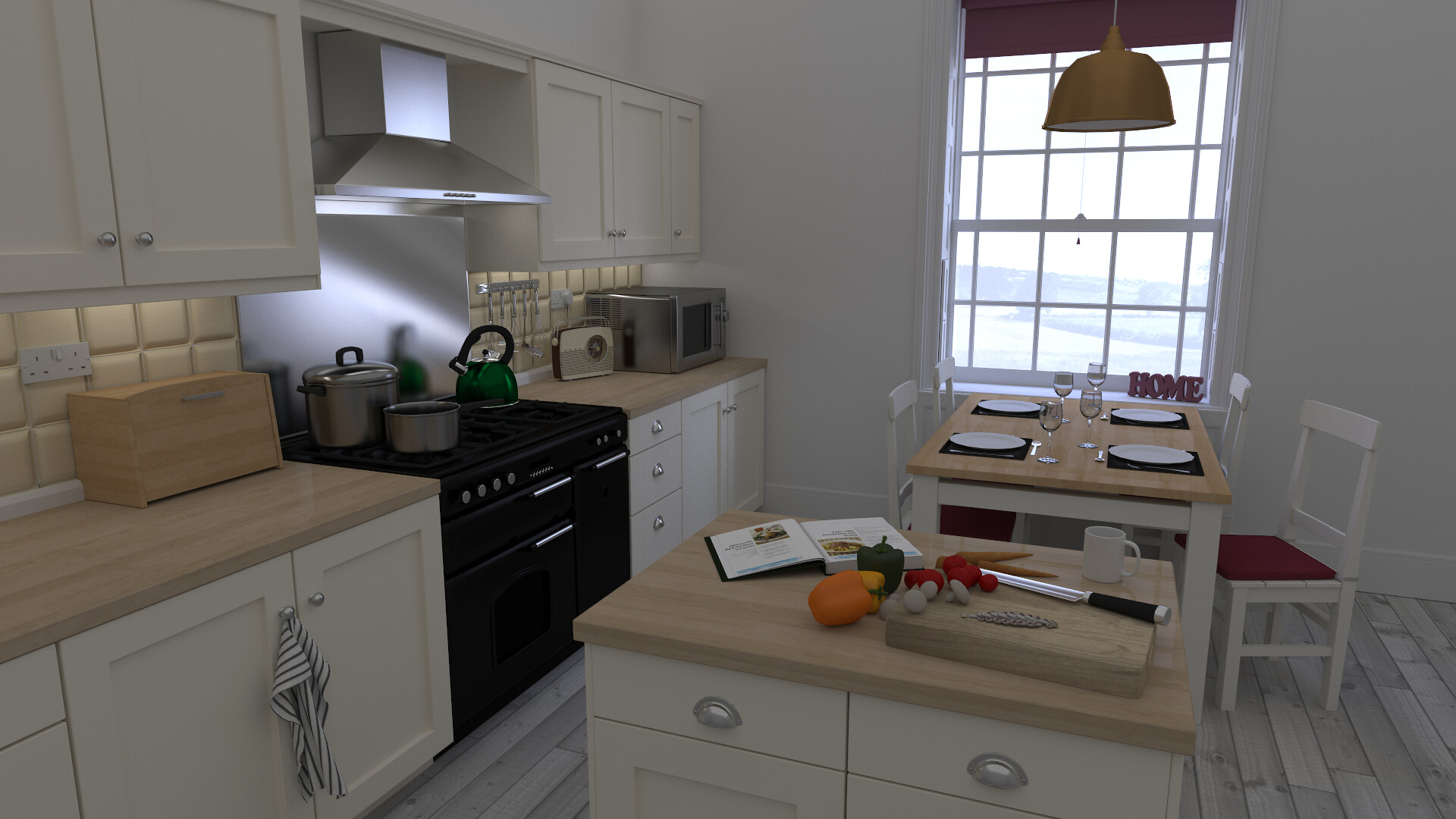

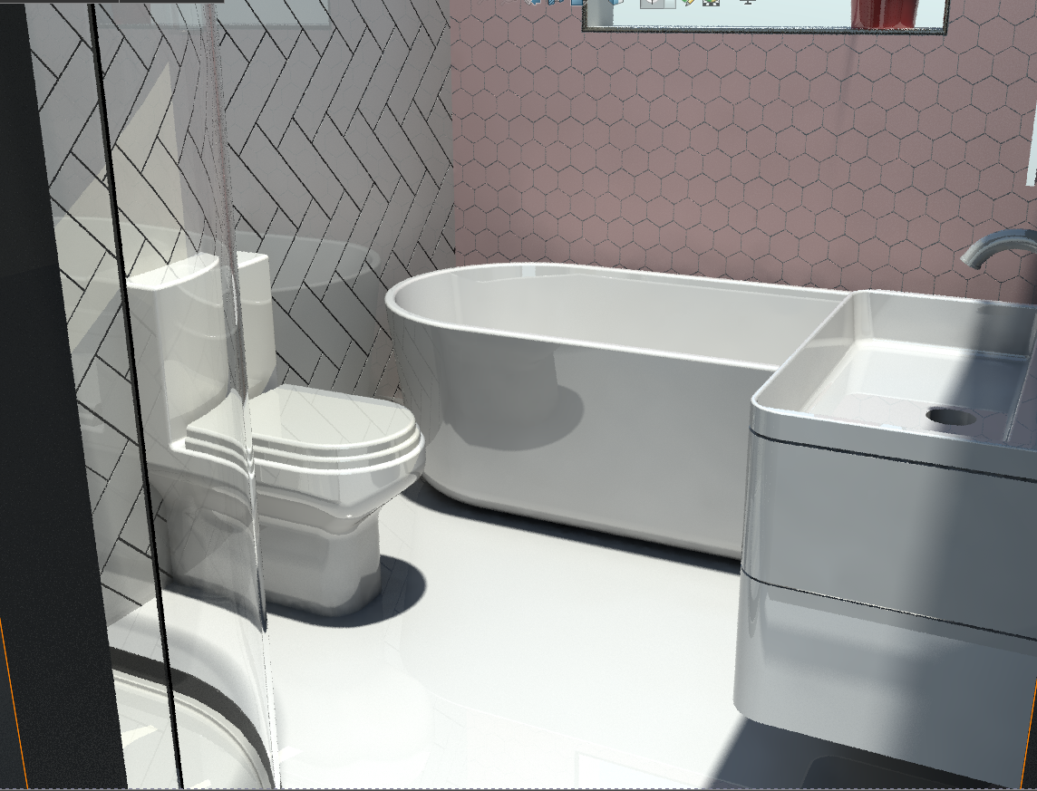

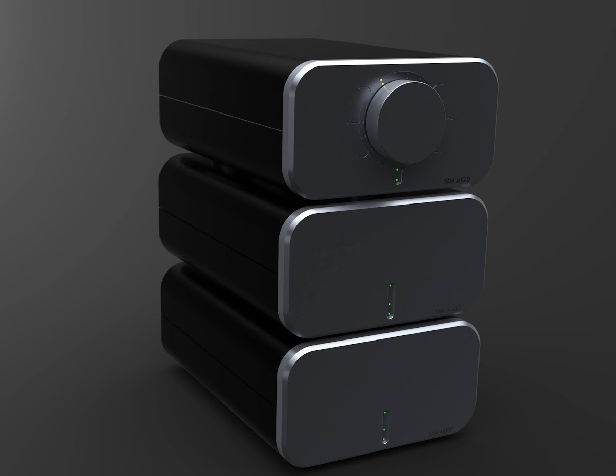

I primarily use Solidworks which is a 3D CAD package. Solidworks has a built in renderer called photoview 360 which is very easy to use but slow. Solidworks has a ton of materials in a built in library which also helps as there is no way really to create a custom texture the way you can with blender. The renders are CPU only and high res ones take an eternity even on my work station beast which has the worlds core supply. Whilst its very easy to press go and have something work its very difficult to actually get something that is approaching photo-realistic, I find the lighting is enormously important and take a long time to get right.
For example - here when we were trying to workout bathroom layouts I modeled a 1:1 bathroom in solidworks - render is good enough for what I was doing but not exactly realistic:

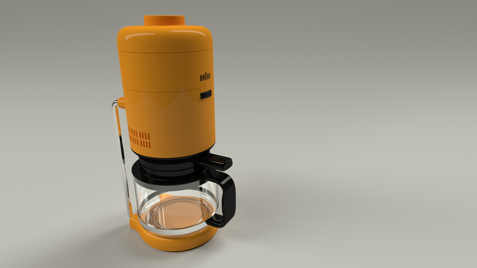

More usually I would use the Solidworks tools for quickly rendering product images to show to other people:

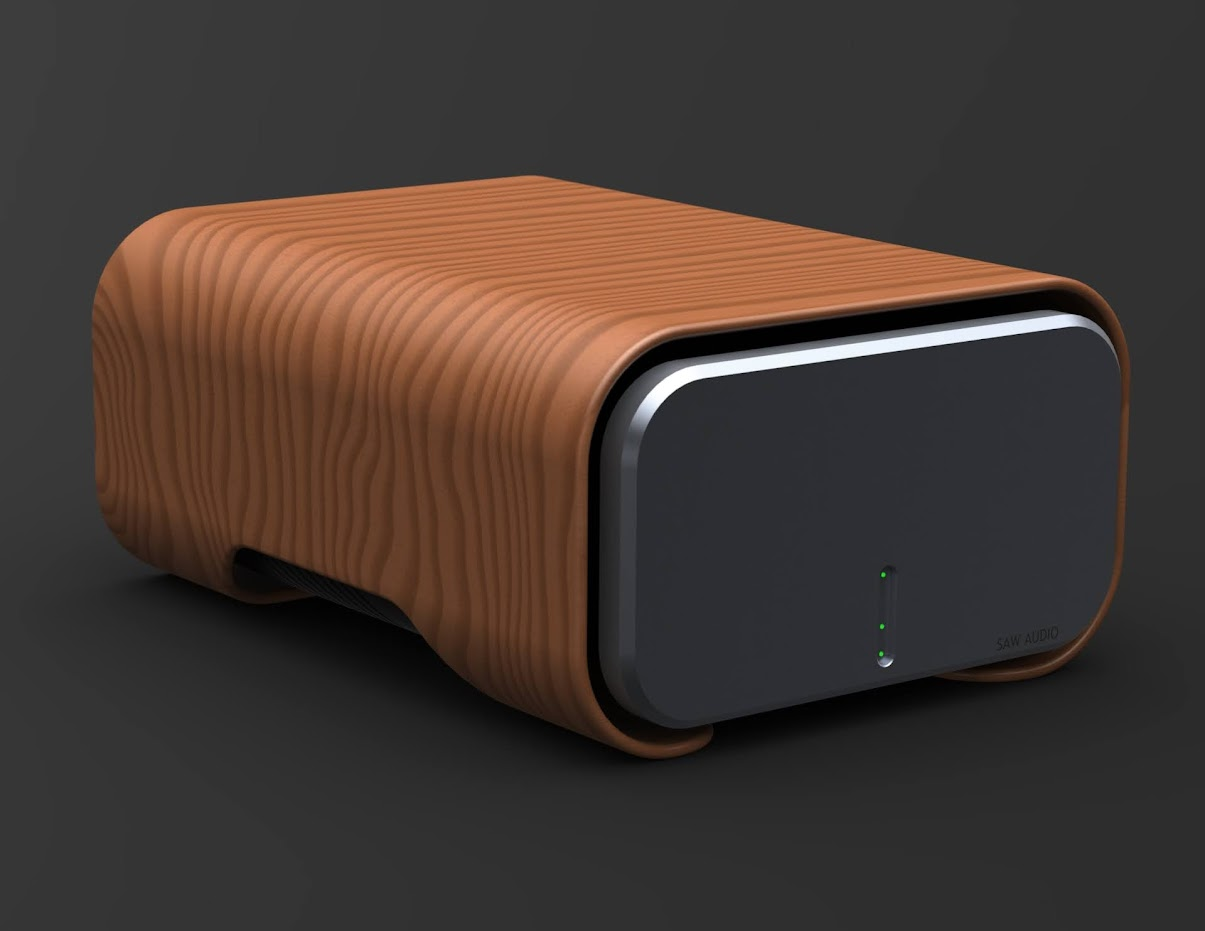

These are concept renders for an amplifier I have been designing on/off for a few years.

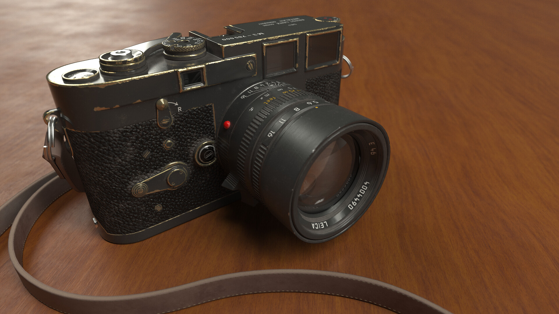

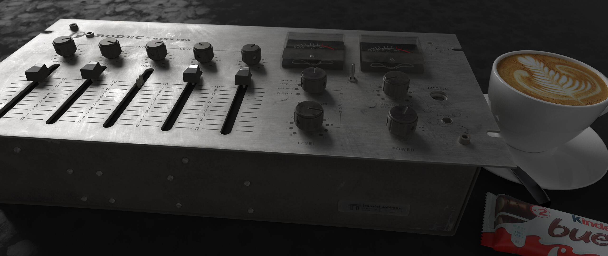

SIPT Test Render

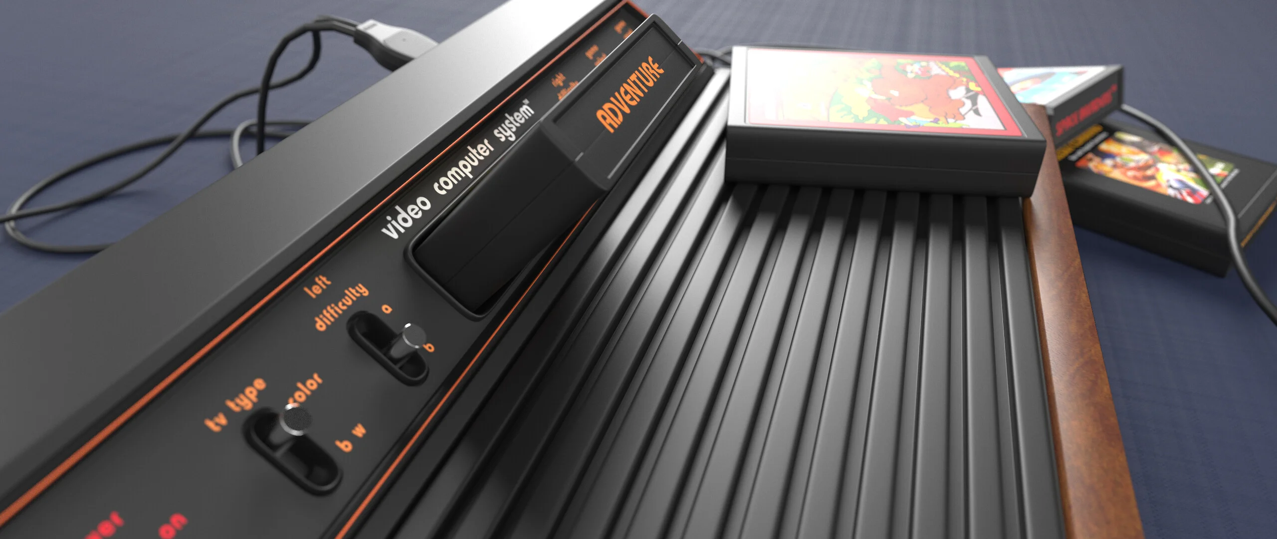

As in the render produced above, the look and feel of the light and material interplay really can bring the image to life, thus giving that sense of photorealism. However, the work required to get to that point is quite labour-intensive. For example, the worn/distressed and stained metal surface material of the mixing desk is not simply a texture applied to the underlying model. It is several textures that have material information encoded within them - such as how metallic the surface is, how rough the surface is, a normal map that is used to perturb the surface geometry to give the impression of additional high-frequency detail, opacity maps to determine how see-through parts of the texture are, and other texture layers, too. Then there are additional properties specified that all go towards determining how light rays bounce - or are transmitted through (or both) - from the surface. For example, index of refraction (to determine how much a transmitted light ray is deflected when entering or leaving a medium), clearcoat (to simulate extra specular shine, such as the additional shine you get from the top coat of clean car paintwork), and many more properties. Here's a small selection showing some of the texture components that go towards realising the metal material used in the render above (I've scaled the images down as the originals used to render the above are 8k textures and weigh in at several hundred megabytes!)... :ROFLMAO:
Interestingly, this process is generally used by both big-screen visual fx studios for their movies as well as game developers making modern games. It is the effort and time investment required to create these assets that significantly contribute to the massive costs associated with creating such movies or games.
(Sorry to those who find this boring...!)
So - here's the base colour texture (sometimes called an albedo map). It contains the base colour for the material, albeit devoid of any light or shadow. Don't forget, our rendering engine is responsible for creating light and shadows.

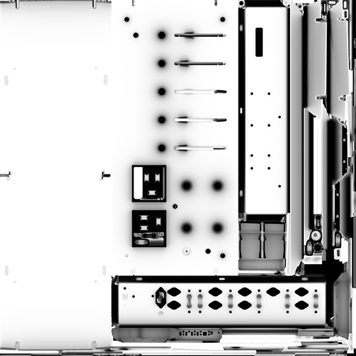

Then we have an ambient occlusion map - which can be used by the renderer to indicate areas that might not receive as much indirect lighting as other parts of the model. Depending on the geometric complexity of the model, some may use a texture like this for performance reasons, whilst others may calculate the ambient occlusion from the geometry directly for ultimate quality and realism, but at the cost of performance.

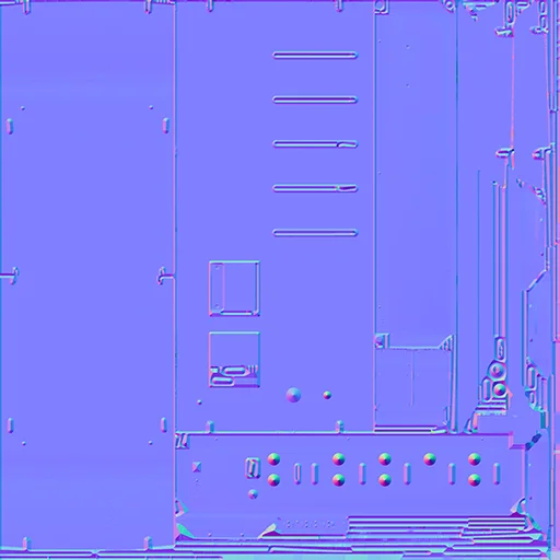

Next up, something called a normal map. This is used to realise additional high-frequency detail across a surface (such as scratches and/or other surface perturbances). The strange blue colour is due to how the associated data is encoded within the texture map. The normal map can be a great way to improve rendering performance by encoding detail in a texture rather than having to have the detail actually modelled within the 3D geometry.
Then, we have the metallic map (which is generally only found on metallic surfaces, surprise, surprise). This indicates which part of the material are metallic, or how metallic the material might be. It is possible for a material to be metallic and non-metallic... imagine a rusted metal sheet. Parts might still be shiny and other bits dull where the rust has set in. This metallic map allows this information to be encoded within it. The brighter areas are "more" metallic.
Let's finish with the roughness map - which determines how rough the surface appears, and basically controls how a reflected light ray might be scattered afterwards. A rough surface will appear dull (think of tyre rubber) as light rays hit the surface and then bounce off in pretty much any random direction. It results in a matte look. A "less" rough surface will appear shiny and show reflections of things around it (think of plastic Lego blocks) because light rays are reflected in a tighter focus rather than randomly scattering in any old direction. The brighter areas are rougher and result in a more matte/dull look.
So there you go, a basic rundown of how textures can be used to simulate a given material and control the interplay of light with said surface material. There's a fair bit more to it of course but it might give some idea as to the shizzle that goes on behind the scenes in just creating and preparing the assets for rendering! And, again, that is just for the surface of the metal mixing desk. The whole thing has to be repeated for all other 3D objects in your scene/world...
