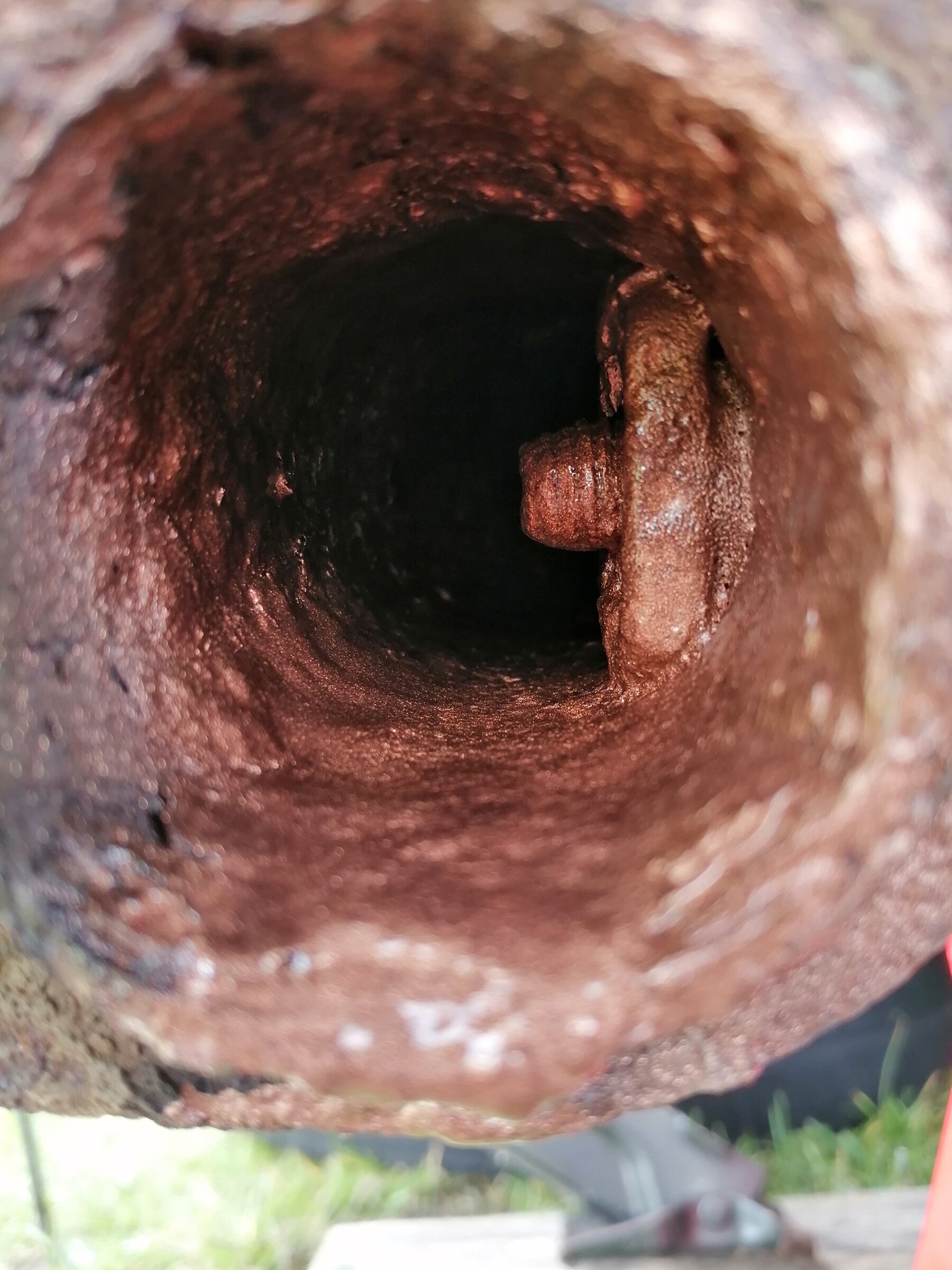

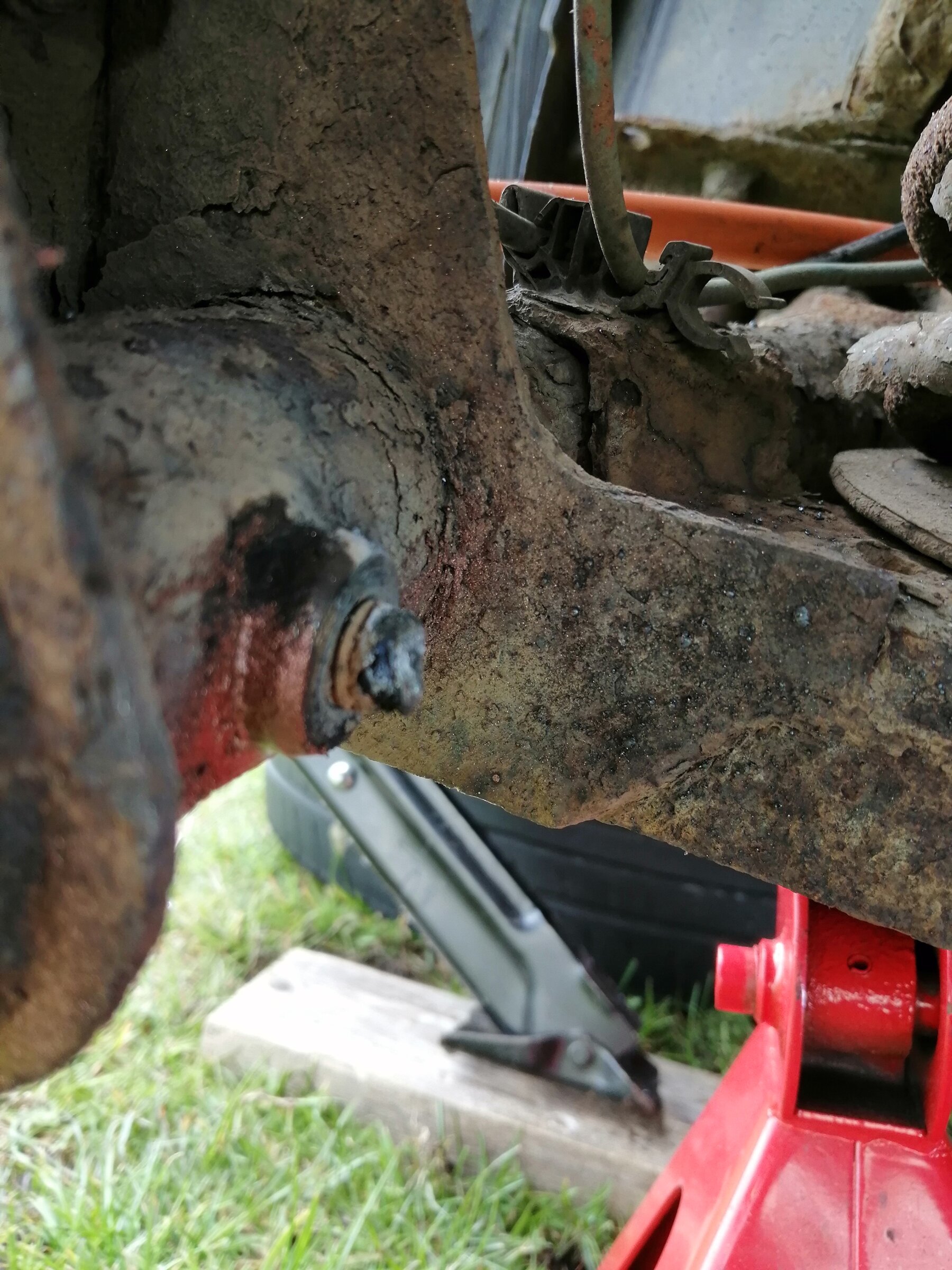

This bolt has pretty much become my second job, few hours before work try the bolt, few hours after work try the bolt. Sooner its done the better before i really lose it haha

If you are struggling with the welder but some EZ outs and don’t forget to get a tap and tap the hole out again so it is a clean thread when you put the new bolt in
dann2707

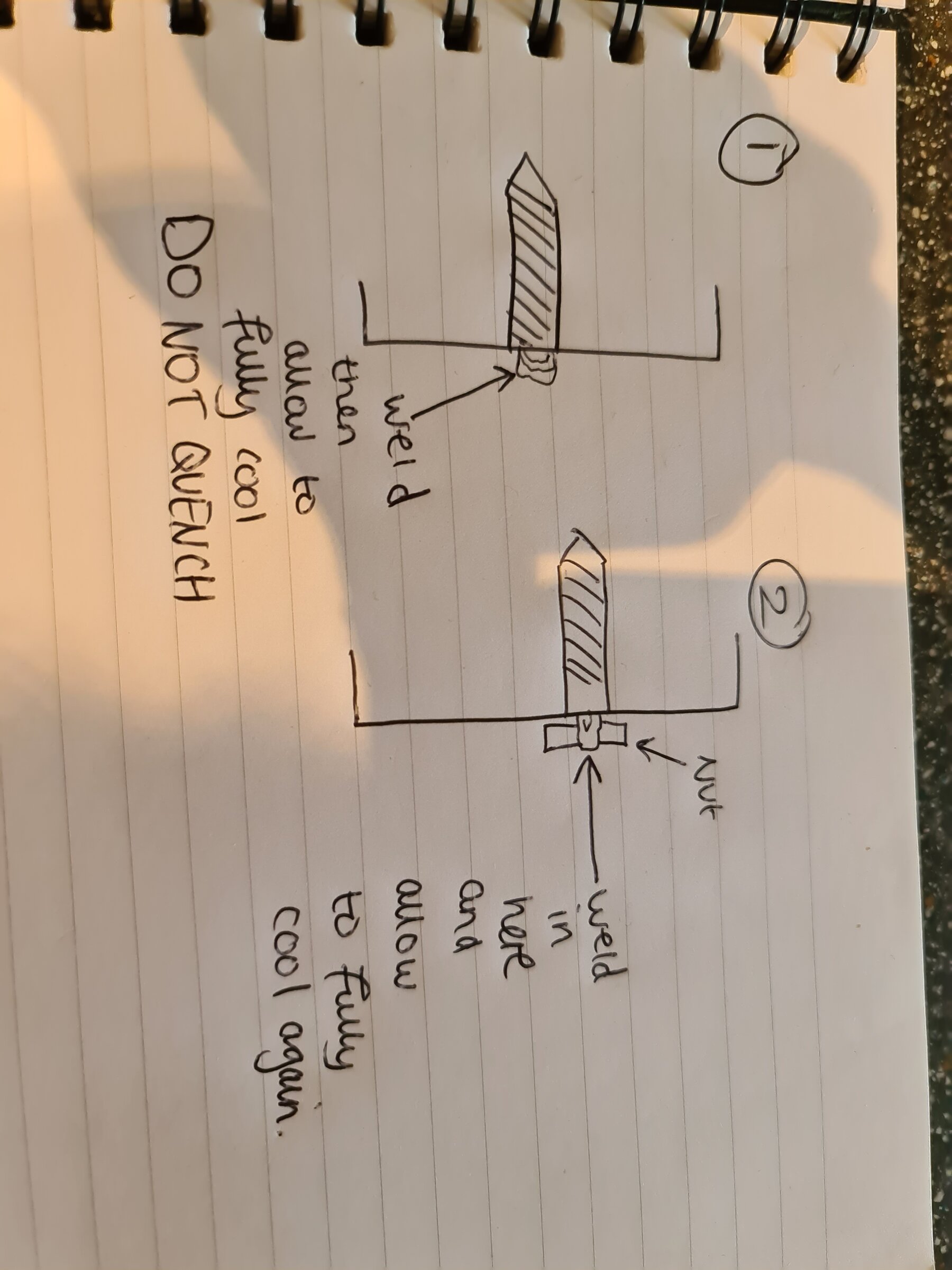

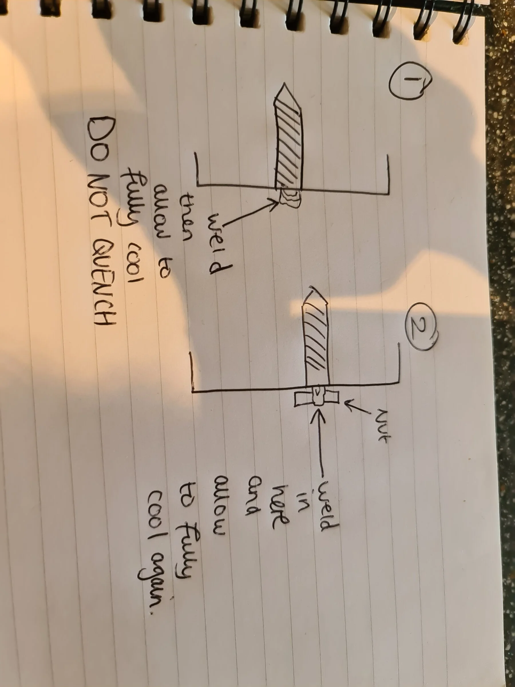

You need to build up some metal on the snapped bit over and over so it protrudes out, then put a nut over that bit you've built up and then weld inside it.
Make sure you allow it to cool fully before doing anything again and don't quench at all. Quenching it will weaken the weld and cause cracks in it and it will snap off. (imagine heating up a glass and dunking it in cold water)
Dont be spraying it with oil to quench it whatever you do, just asking for the nut to snap off each time. You need to make sure everything is imperically clean before welding or you're just shooting yourself in the foot. It's like washing yourself in the shower with mud. For the weld to actually weld it needs to be clean.

What I will say is, make sure you're building up some metal on the snapped off bolt before going full ham with the nut. Doing a drawing for you now one sec

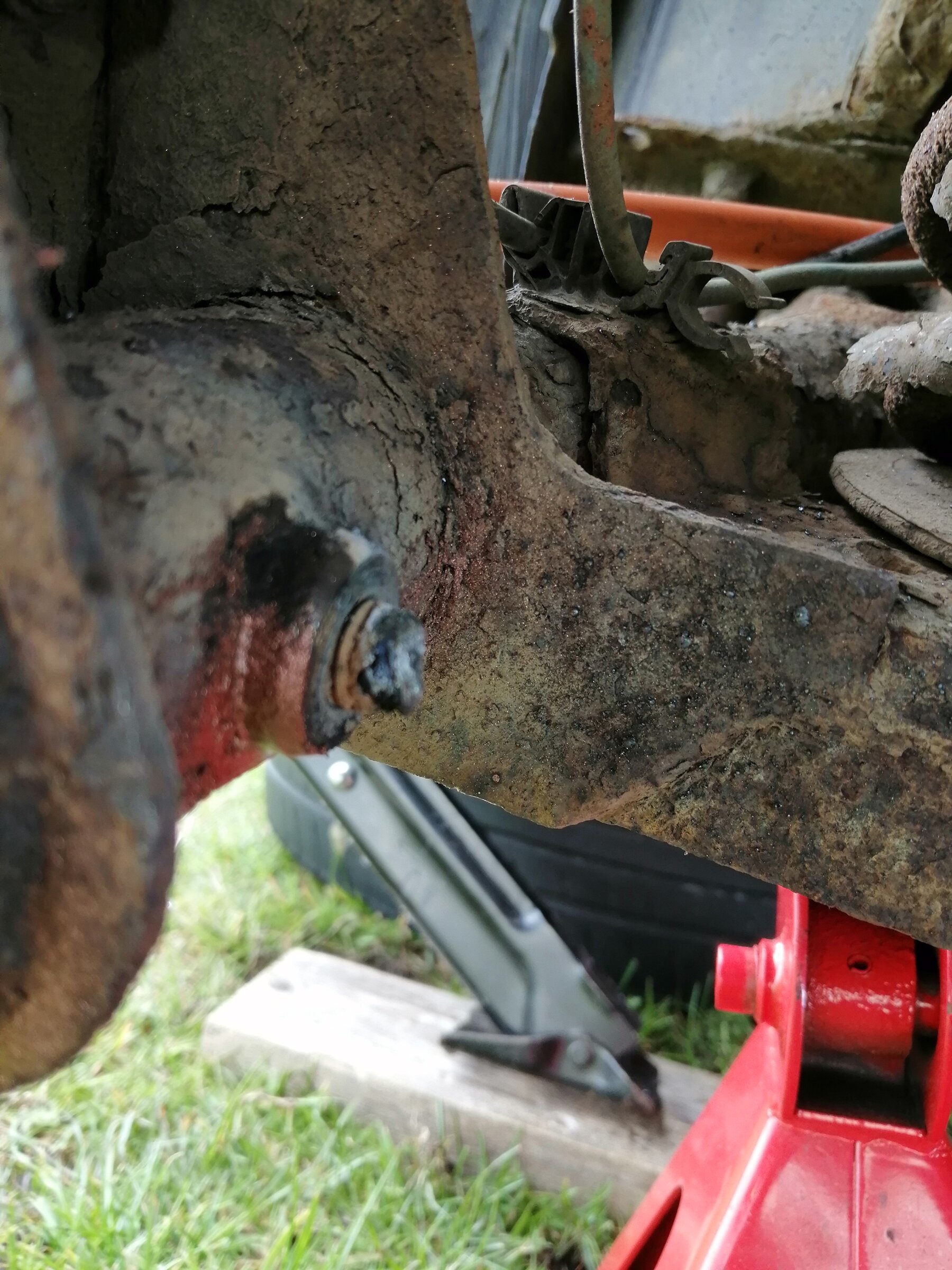

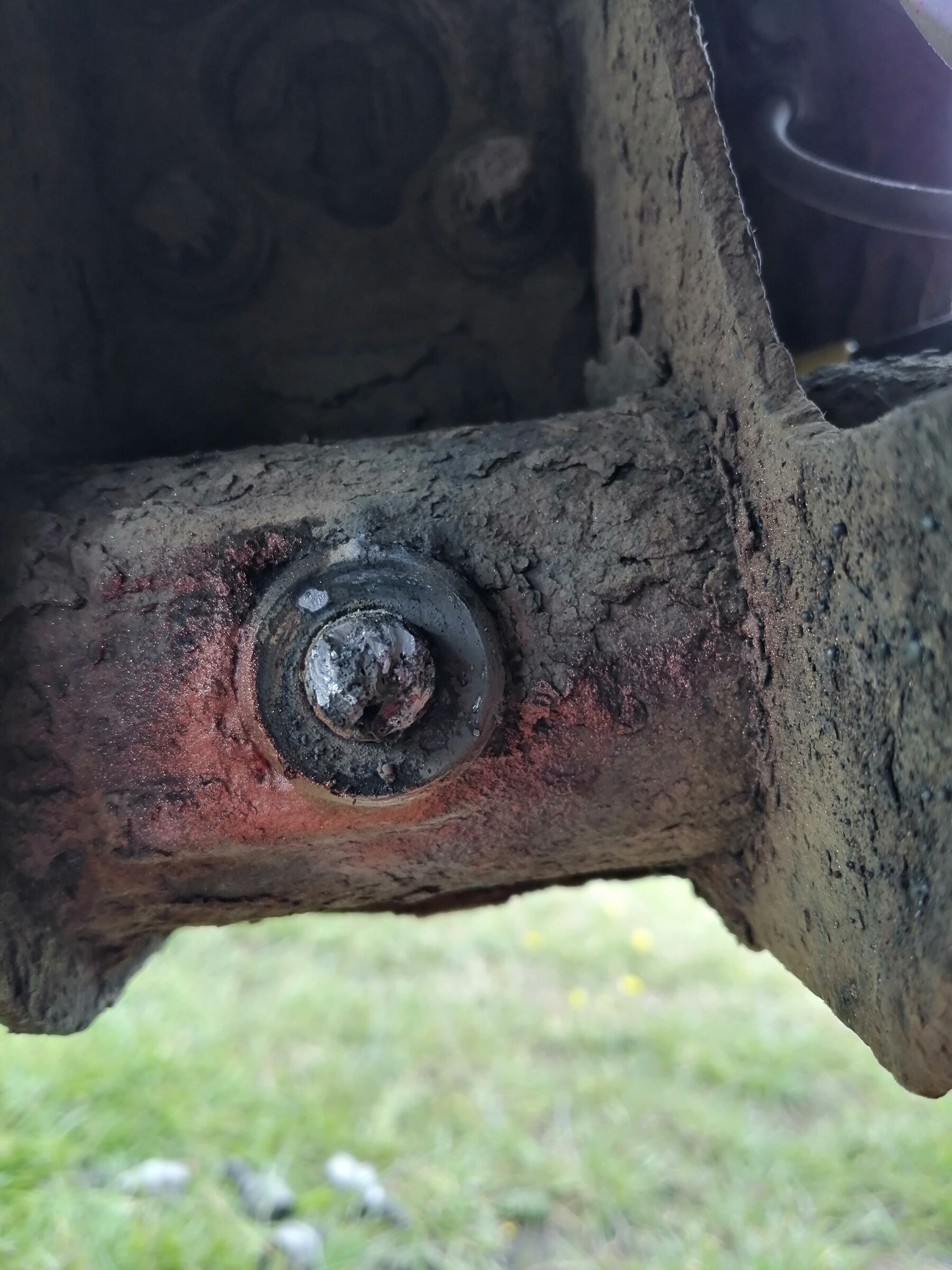

Few pictures here:

View attachment 1484767View attachment 1484770View attachment 1484768View attachment 1484769

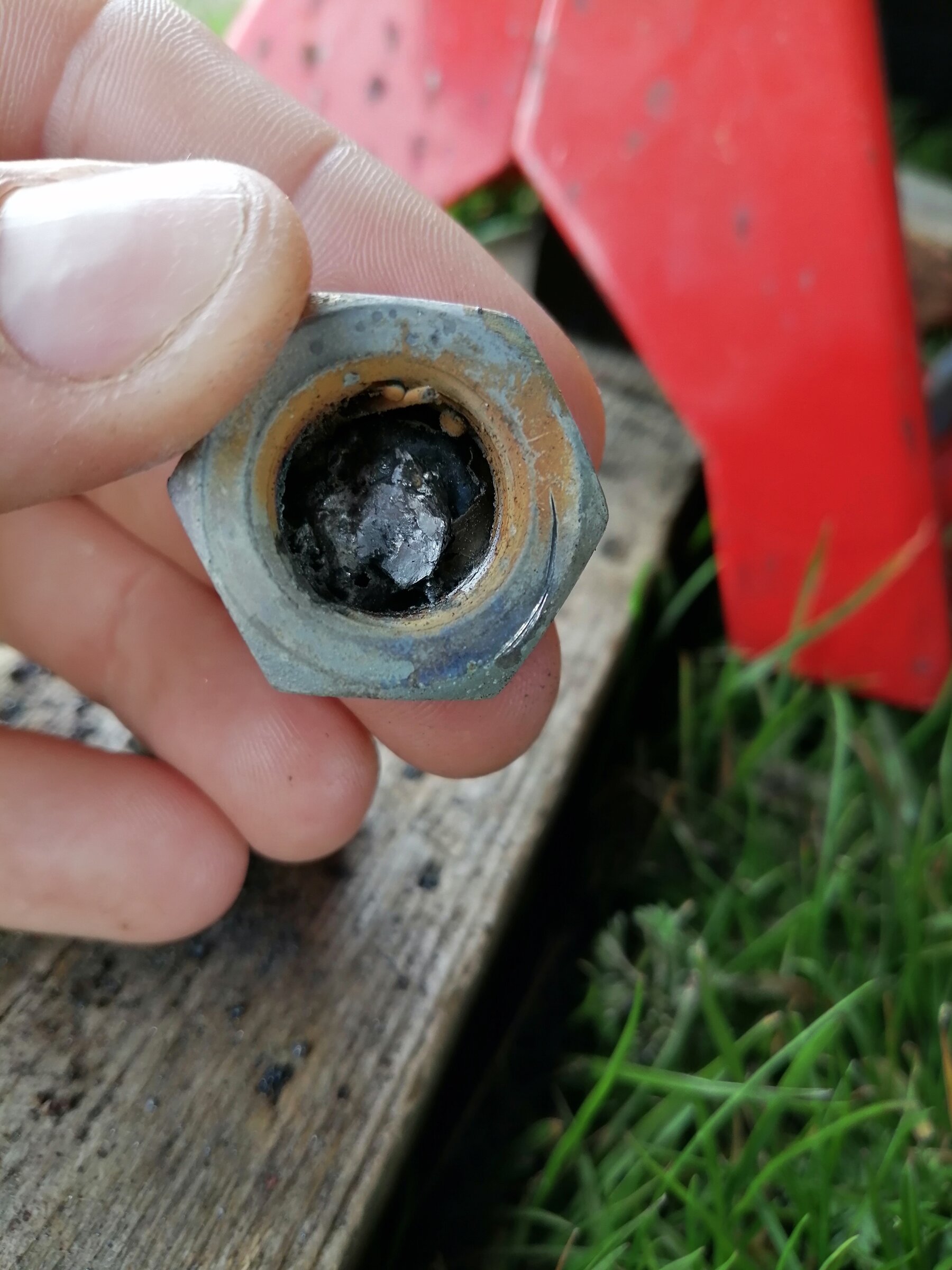

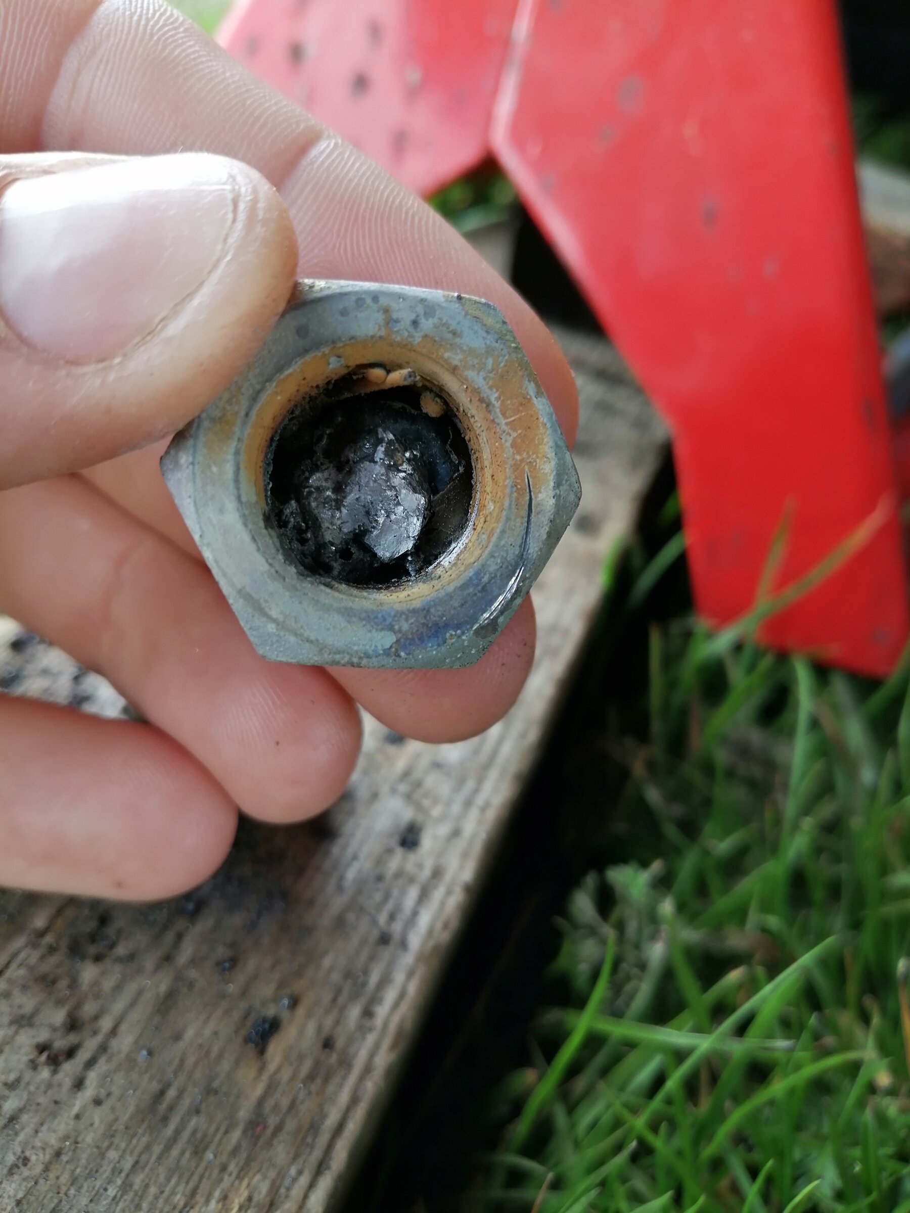

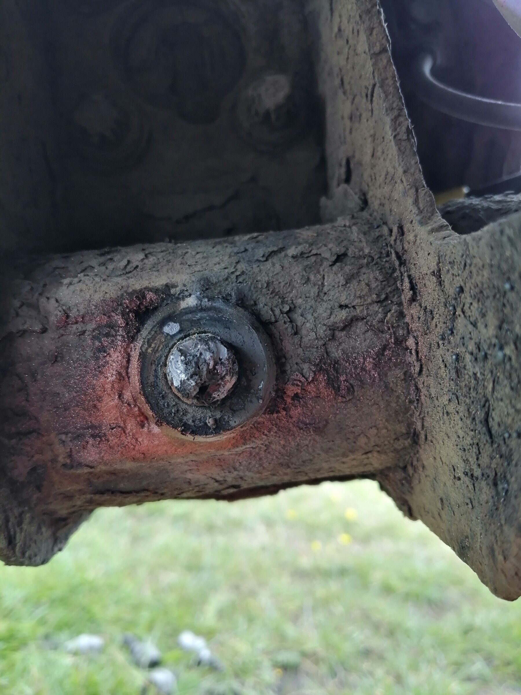

Okay cool, what nuts are they? Make sure they're not zinc plated as that will affect the weld. Just self colour mild steel nuts should be used. Are you using gas with the welder? If not are you using the flux cored stuff? If no gas make sure it's the correct wire.
Keep making that bolt as shiny as you can back to bare metal and clean everything up too
Be careful if those nuts are zinc coated as the galv coating will come off when welding and the fumes are really toxic
  Renault Clio Extreme
Ah.. the nuts are zinc plated.. will order some more tonight.
The welder is gasless, just using the wire that came with it which is the flux core stuff so no problems there.
Dont think i will try with them nuts again if the fumes are that toxic lol

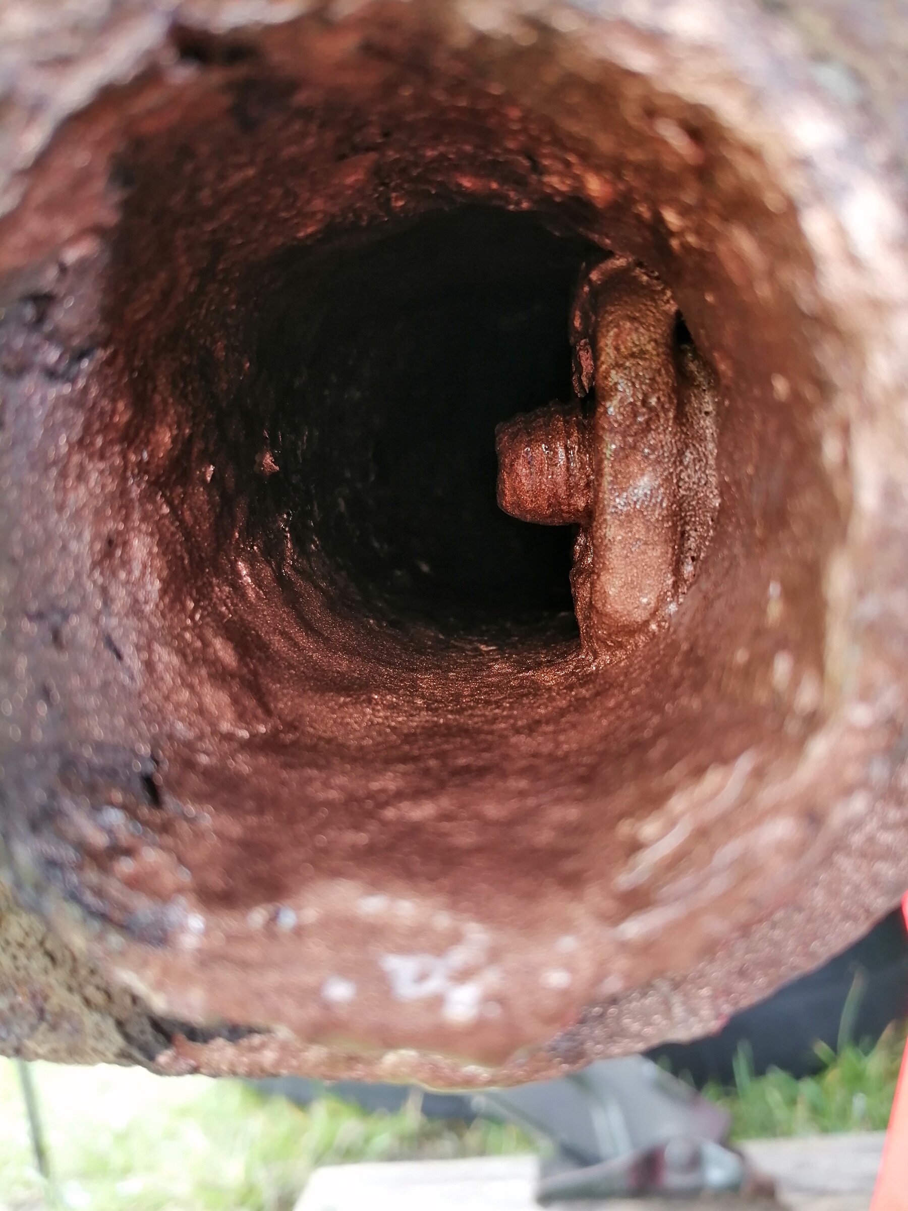

Yeah the flux core stuff should be okay. Definitely try with the new nuts and go from there. Another thing to consider is the amount of friction that's going to be generated on the inside of the beam too - Get all of that grease off with a small wire brush and penetrate some plus gas spray on the inside there. At the moment it looks like the threads are caked in god knows what underneath that copper grease.
Basically anything that's going to cause friction is going to go against you - in this case the grease is okay in a long term anti corrosion way but now you need penetrating oil on the inside.
