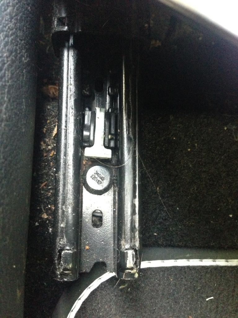

Hi, my Trophy has broken its clip which controls the rear slide position 'memory'. I've phoned Renault and they tell me the recaro is Trophy specific and I have to replace the whole metal base.
The price for this is £900 + VAT !
I know these trendlines were optional on the 182 as well. Does anyone know if the base is the same?
I really need to fix this as I have a 3 year old who travels in the back and my wife can't get in the front anymore.

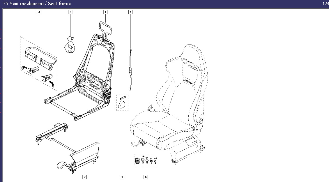

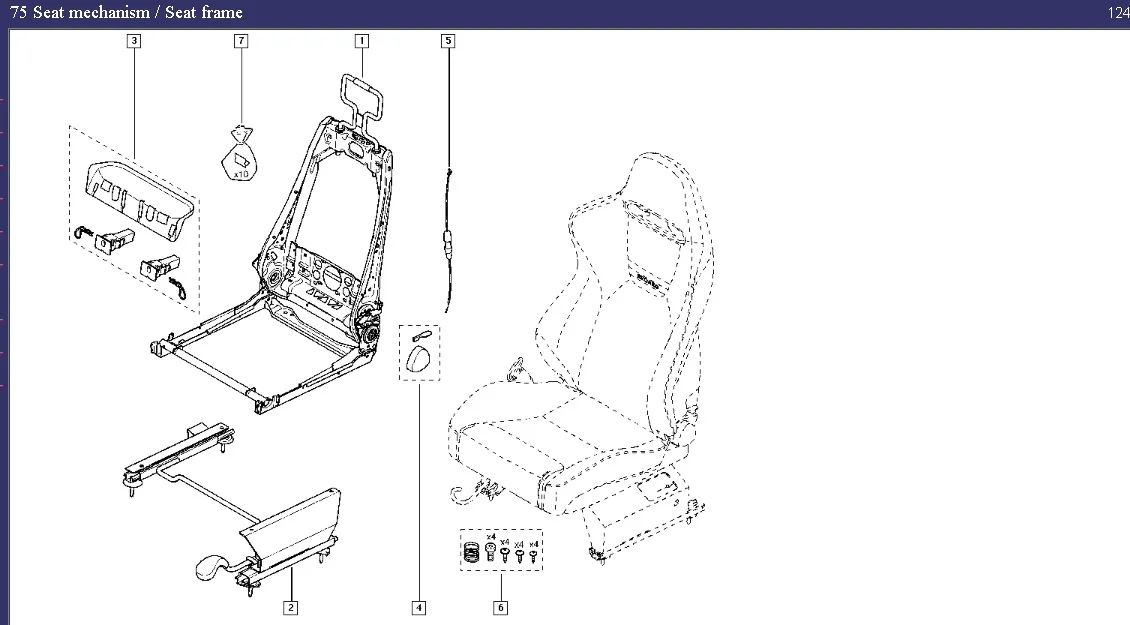

This is what the renault parts system shows for the Recaro Seats with My Trophy Vin put in.
  Clio 182
Thanks for that. The part labelled 1 is probably the part I need. Either that or 11. Strange the Renault dealer provided me the below diagram.

I have exactly the same problem with my passenger recaro! Did you order part 11 and did it work?? Would really appreciate any help.

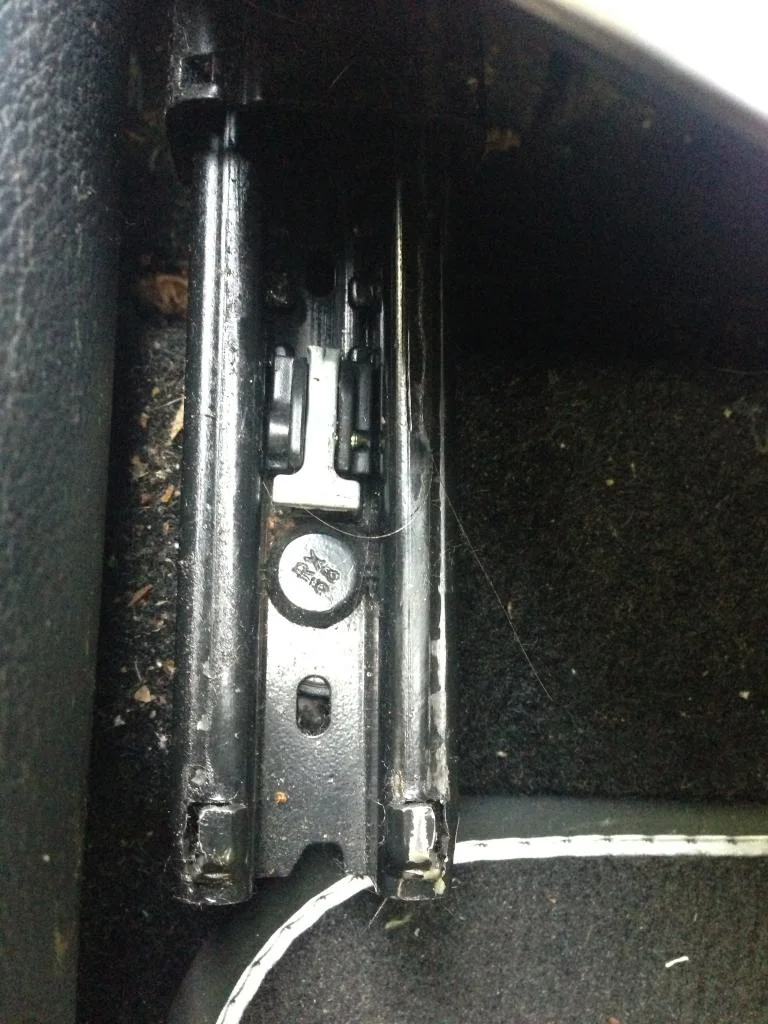

Thanks, was it just a case of taking out the broken bit (same as first pic) and placing the slider in the runner??

I had a spare set of sliders from a set of standard 182 seats and unbolted one slider unit (2 x 13mm nuts) and just swapped it, very easy mate.
mossyv6
  Trophy,V6,5GT,AG200
When changing the slider I would remove the seat to get to the broken side. Again easy to do, 4x 13mm nuts behind the sloping sides and remove the under wire. Then 2x 13mm nuts underneath the car need removing (covered by rubber grommets). Just then need to remove the centre bar, which just unclips from the 2 sliders.
