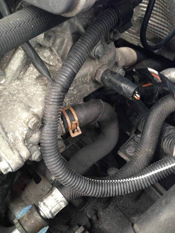

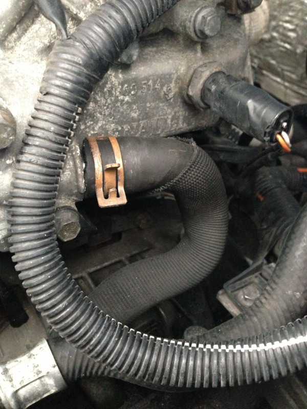

right better late then never.. here are the photos of what I did with the coolant pipes..
I cut the pipe just before it splits off to go to the matrix and it fits perfect, flows well and the car doesnt overheat at all..
  Mental 172 Cup
Yep all the original piping, just cut before where it splits for the heater matrix, then put back into the thermostat.. Just basically bypassed the matrix..
The spring clip is perfectly fine mate.. They are strong as hell..
