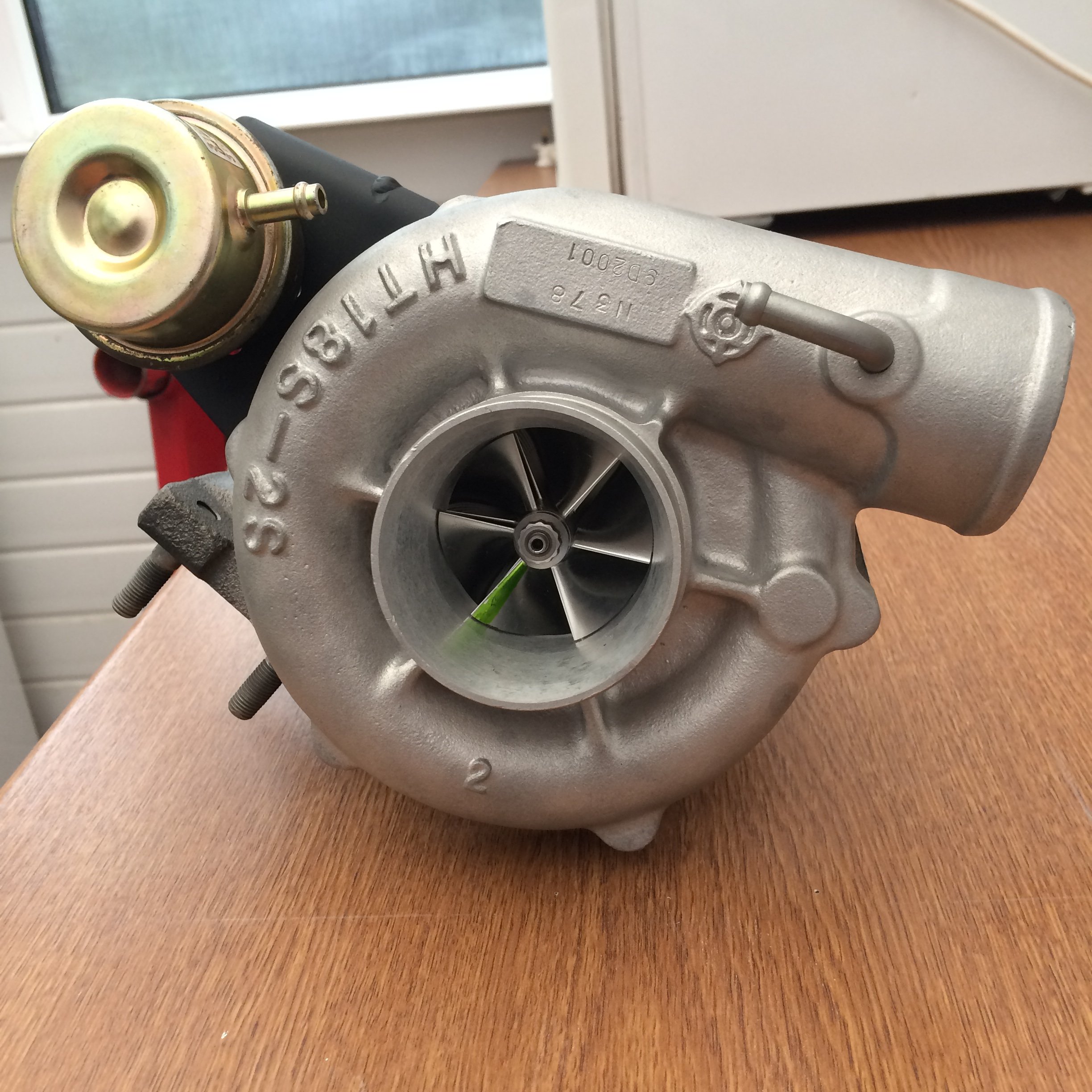

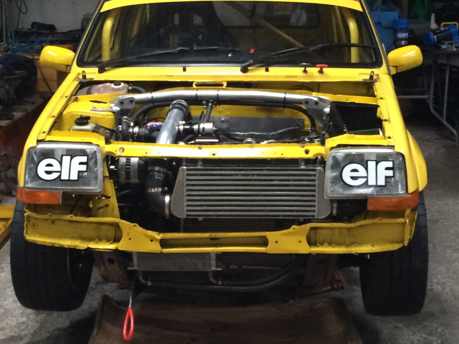

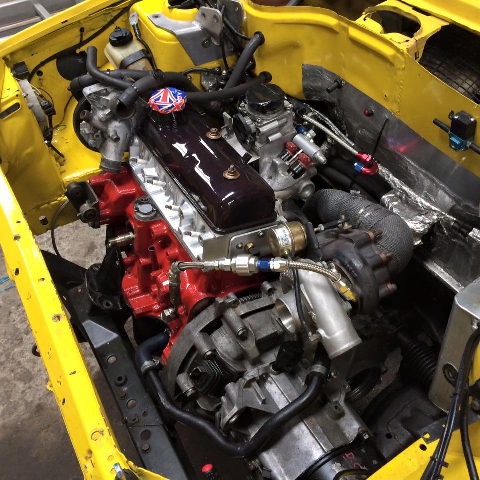

New turbo finally on and all mapped.

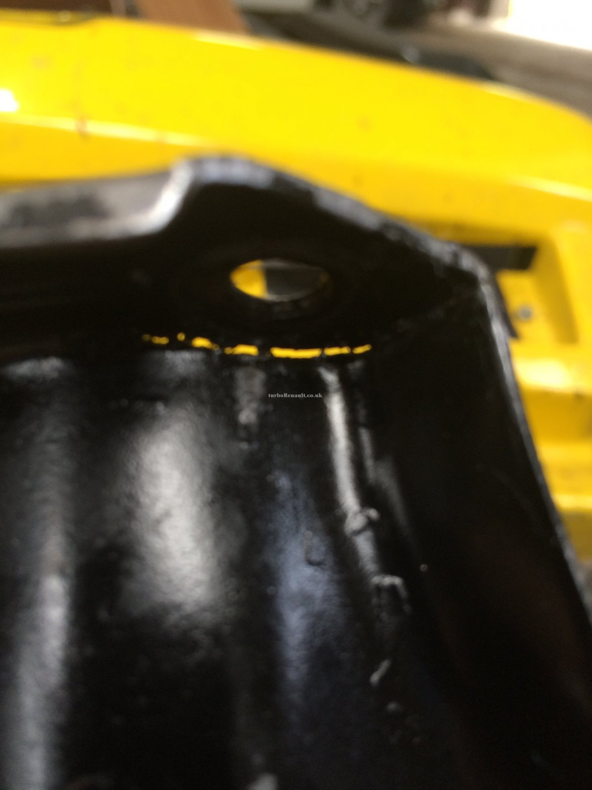

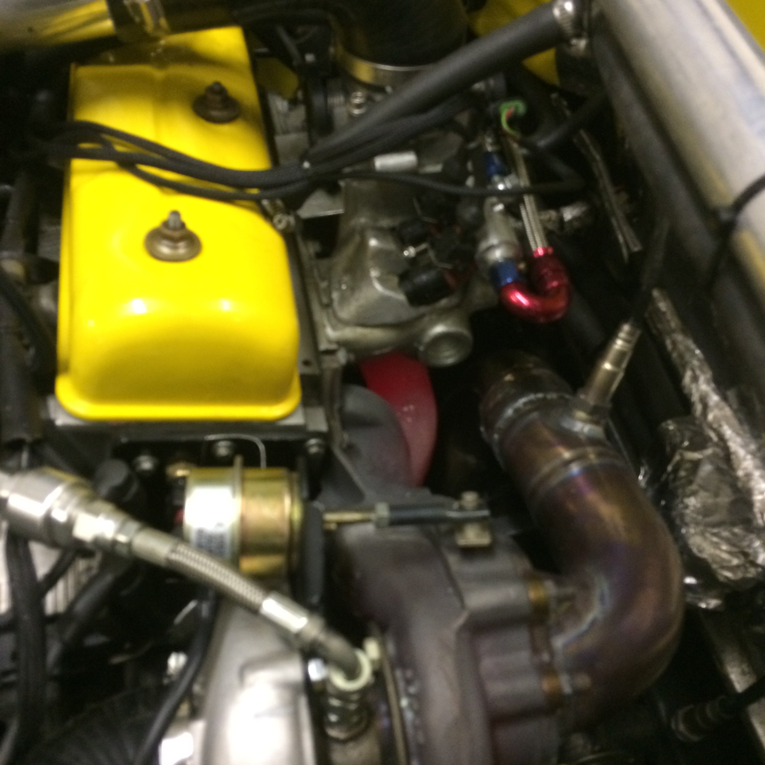

This has plagued us all year. A persistent oil leak, which we now know from the sump, causing lots of problems.
All fixed so looking forward to Brands on the 30th.

I say that's a mighty big hole in the sump , can't see where it is thou , can't make it out .
Nice motor btw .
Nice motor btw .

Thanks, yes not the best picture, that's the last bolt hole at the half moon for crank....
We welded it up and all seems good, nice to have car running and not have oil dripping out.
