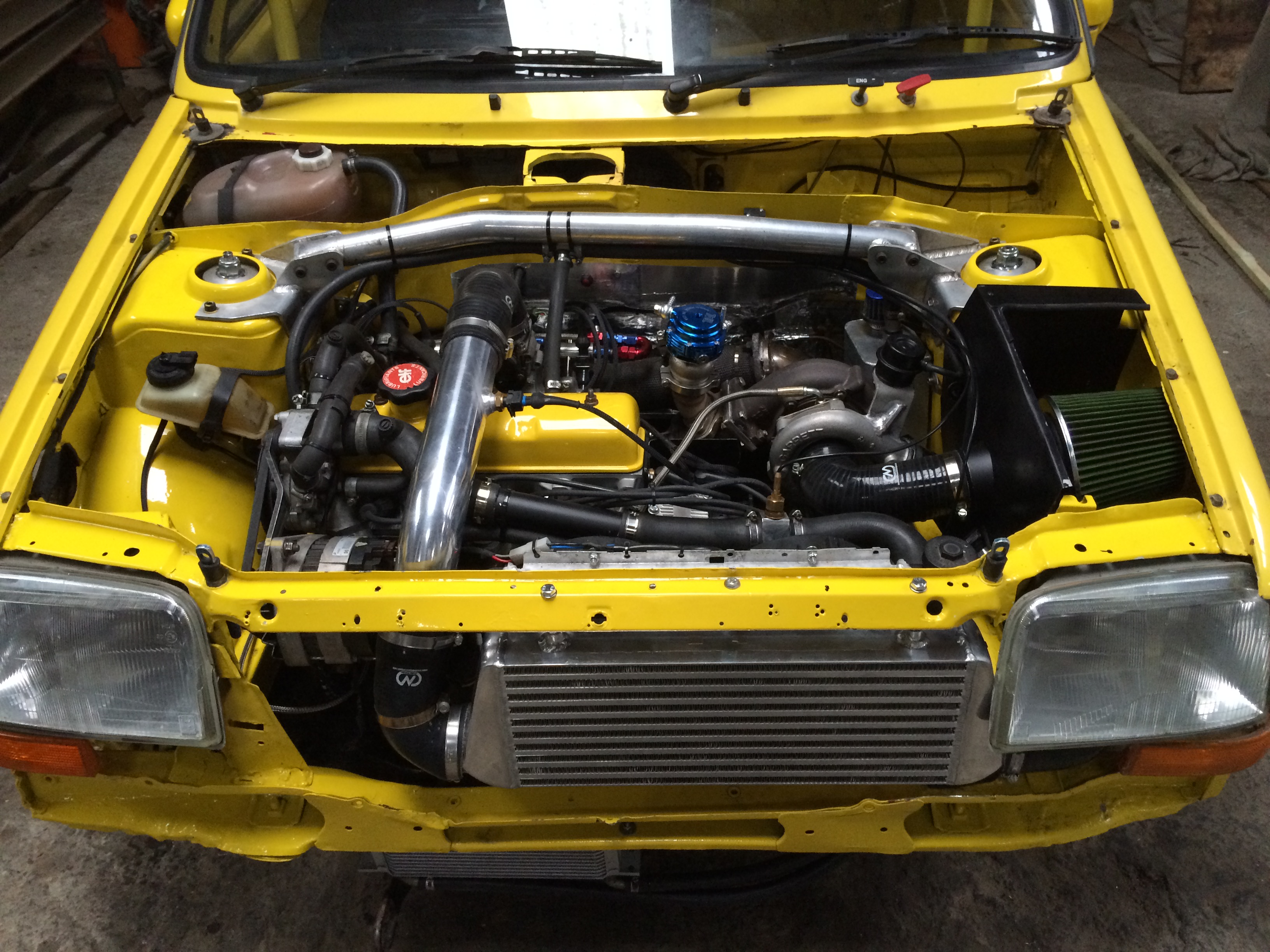

Got on track to do a few laps with hardly any brakes. Discs were slighty rusty where cars been sitting over the winter so needed a few laps to clean them up. Brakes getting better, then developed a misfire. After 5 laps got pulled in for being too loud.
Car wouldn't start after that and when it did only on two cylinders, Found the problem 6hrs later after stripping everything. The loom had been burnt through from the exhaust manifold.

Easy repair mate, now we know what it is.
Shame to waste a day but I guess that why we go testing to find any problems.

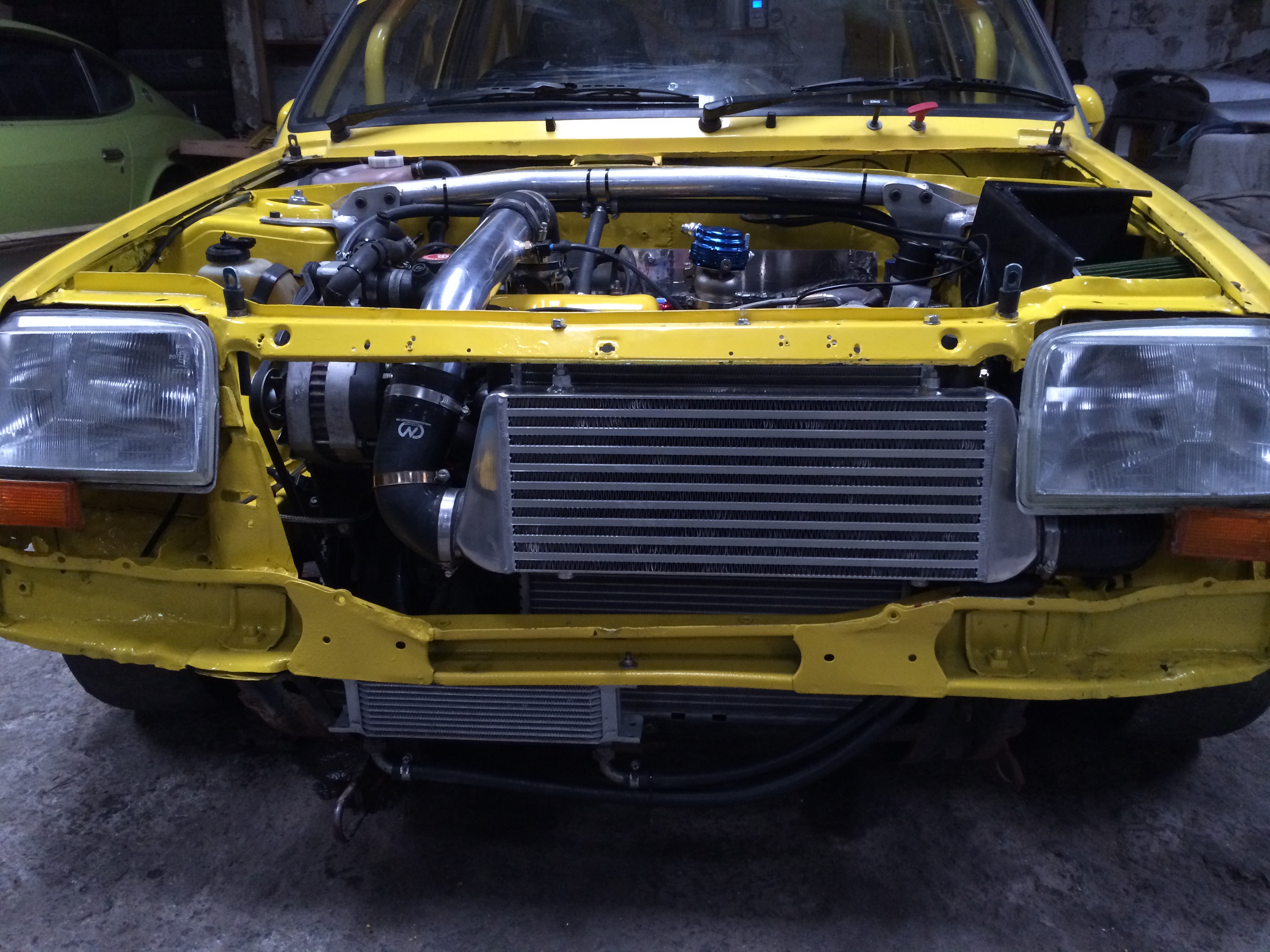

any power figures since the efi conversion, or top secret :wink:
No secrets here mate :) Power figures are down since converting to efi. We are running a different turbo set up to make the power earlier with more torque. Engine a lot more responsive with the efi.
200bhp with 197lb/ft @4500rpm

  Renault 5 gt turbo
Engines coming out to take a look at the clutch.
Couple little bits to do while its out.
Hopefully be done for Cadwell..
  Renault 5 gt turbo
All back together with another clutch pressure plate.
Just found a leaking crank seal.......... No time to pull it all out again.
Will give it a run this week to see how bad the leak is.
