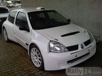

hi, this is another of my Clios, its a Clio RS shell that i bought, the ideia its a trackday/time attack and hill climbing car
for exterior its gonna take a S2000 rally kit, roll bar in the interior, a Williams engine with a Turbocharger and a Supercharger
gonna post more pics soon and with time 8)
