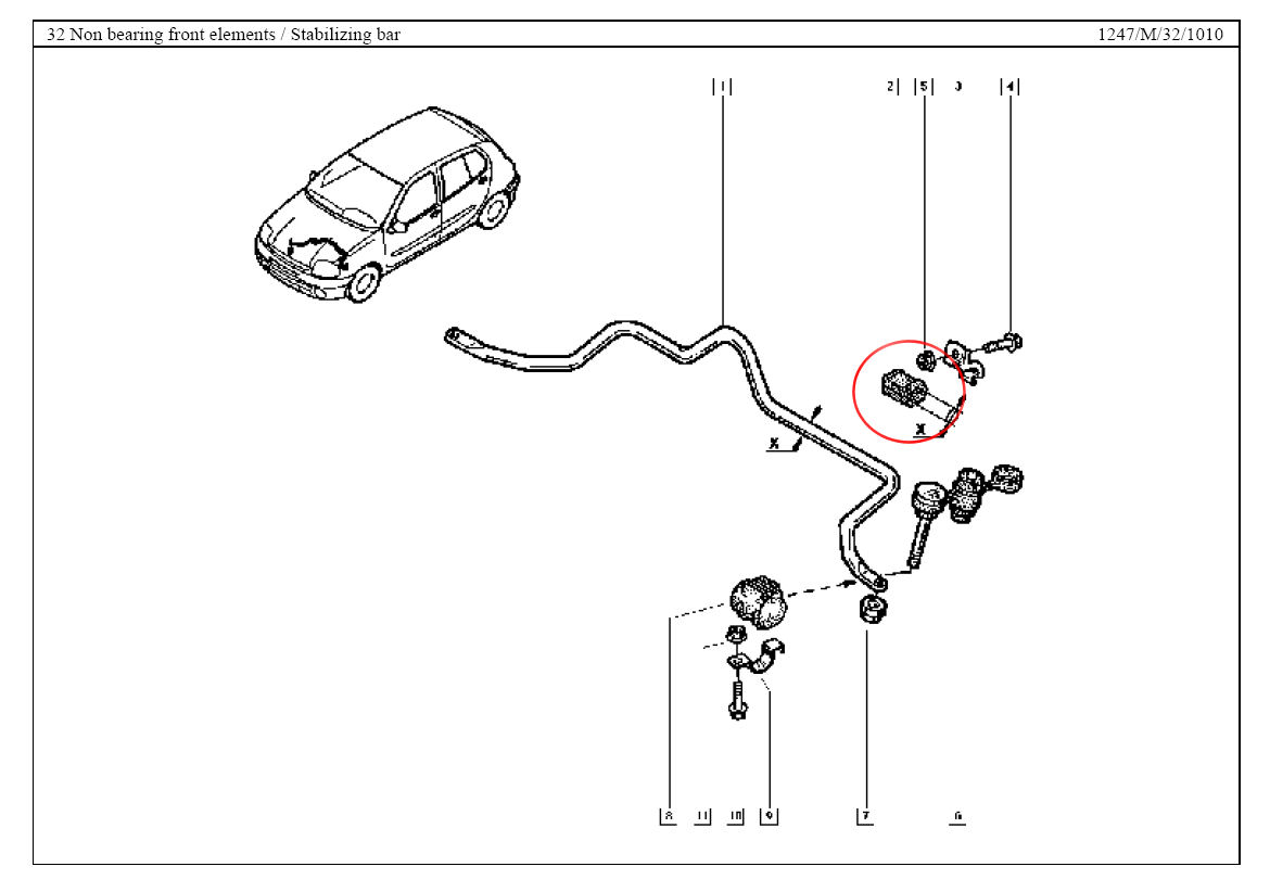

Thats the bush that dialogys shows for my car, looks to be a split bush. Can anyone spread any light on it?

Well the noise comes from under the car rather than towards the wheel arch but i'll check them as well.
Well its more of a rubbery knock noise when I go over speed bumps or the like. If I go over one of those split bumps with the passenger wheel and the drivers wheel on the flat then the noise comes from the drivers side. I'm all out of ideas as to what it could be other than the ARB bushes.
No problems when turning.
i very much doubt its the inner ones, mine are fine after 90Kmiles and being lowered 100mm
i have however gone through 2 sets of outer ones (about £10 per side)
Hmm, makes me wonder if it is that tbh. Any ideas on what else could be causing it i'm 99.99999% sure its not the struts. Its on a 40mm Apex kit if it makes any difference.
