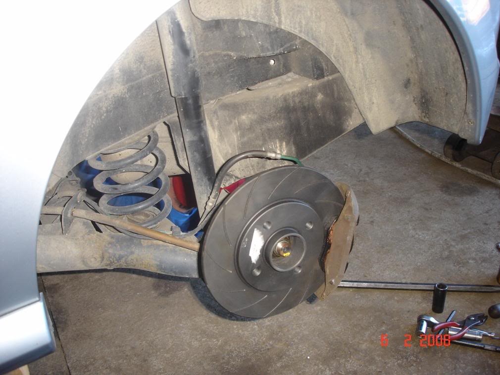

Wednesday 6th Feburary

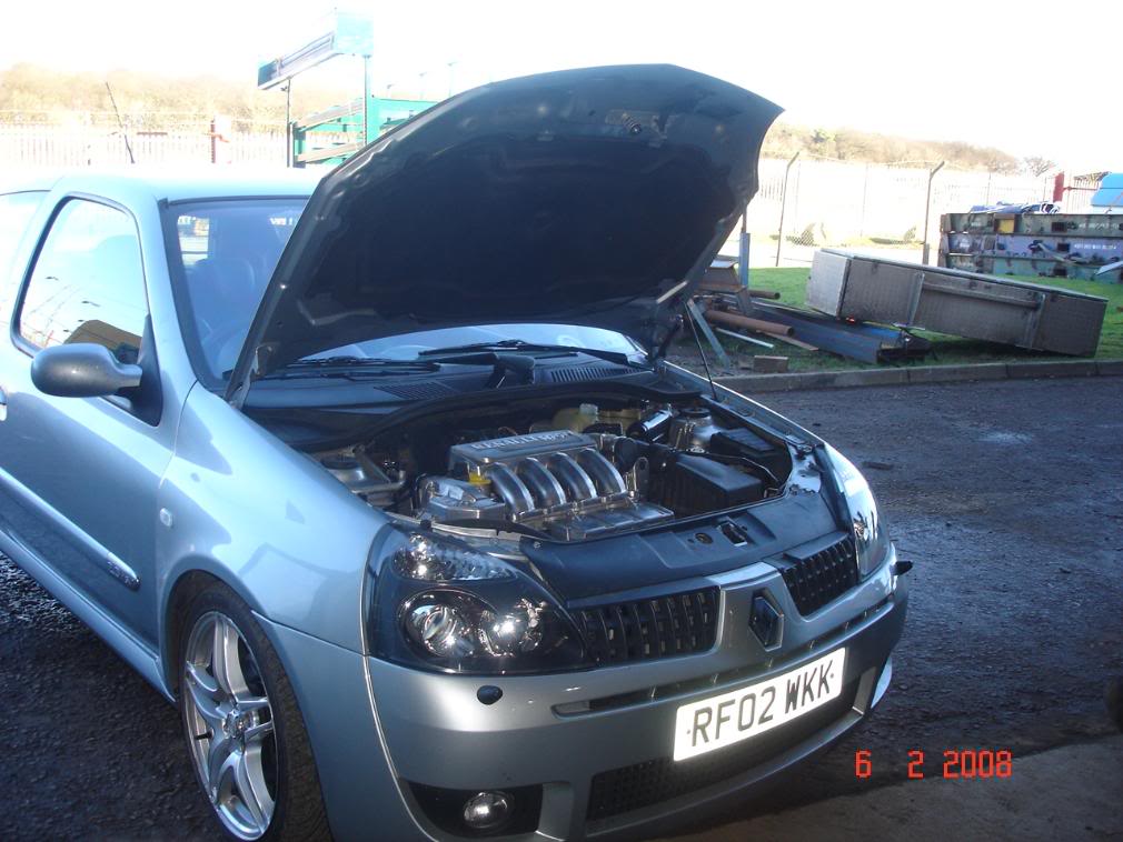

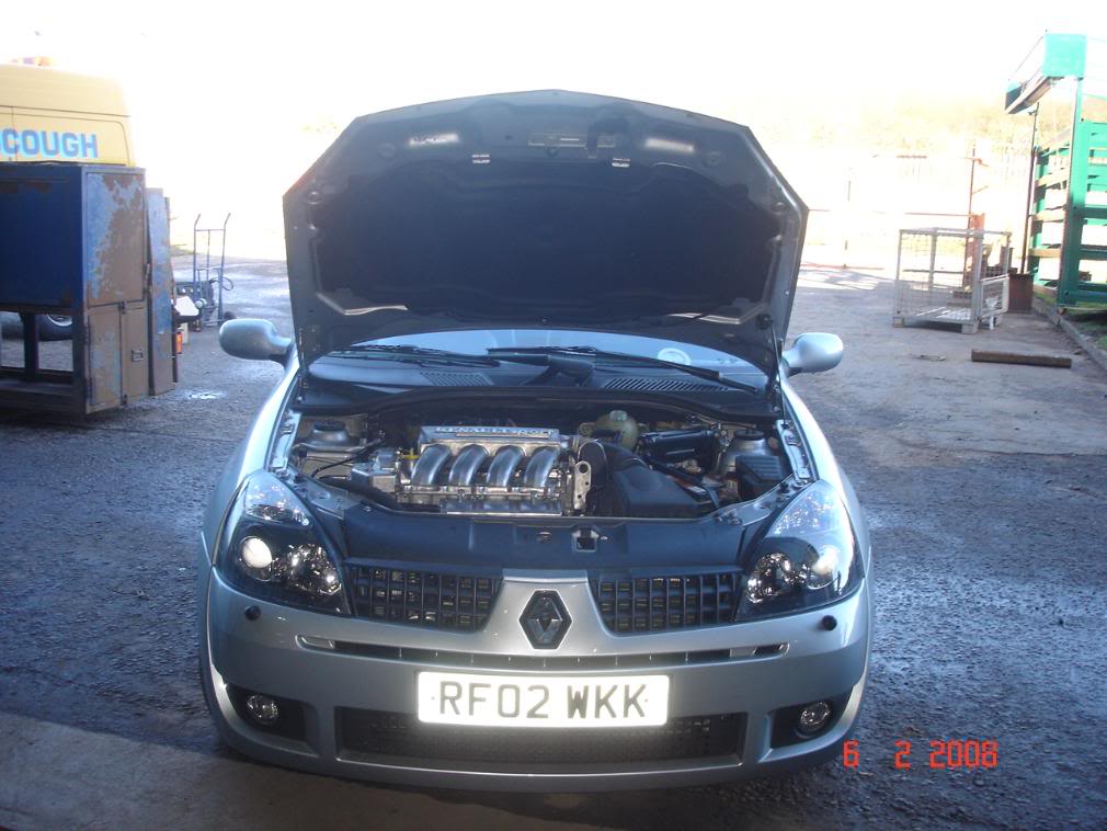

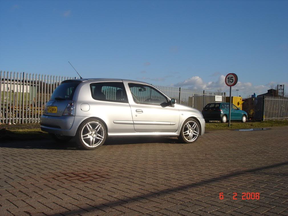

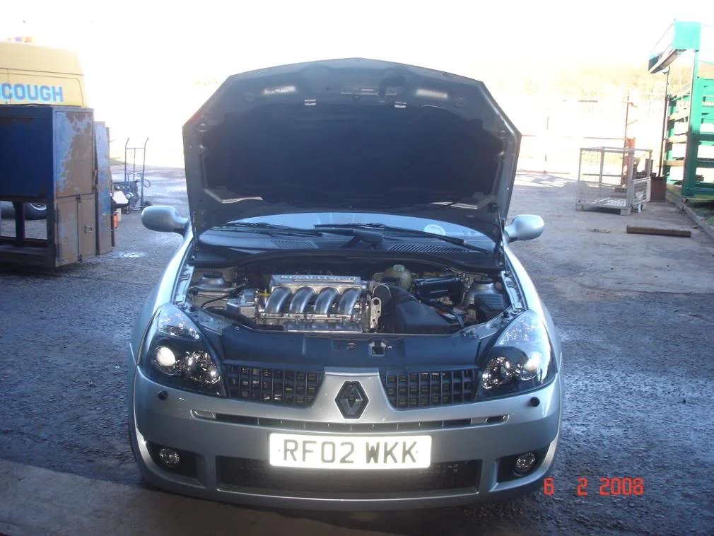

Good news! as posted earlier the car is now running after getting a new very expensive starter motor. :cool: So today and yesterday have been about fixing the car up and getting it back on its feet. The front lights, bumper and bonnet were all fitted and today fitted the sportlines on the back and the rear discs + pads (Black Diamond discs with Ferodo DS2500 pads).
Back on its feet, Ignore the shite 17" alloys and the lexus lights :eek: they will be changed asap but atleast shes running! :)

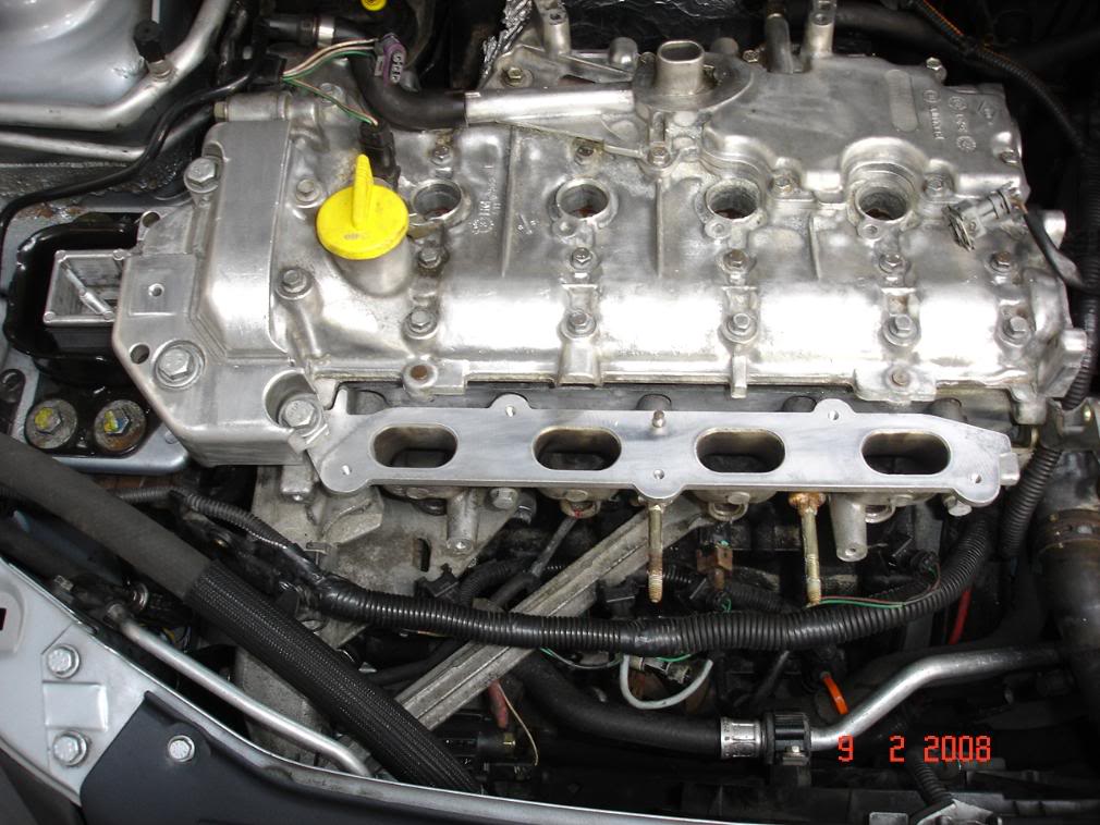

after a lot of scratching heads on trying to find out why it was misfiring i decided to take the 172 to a local renault specialist. Plugged it into a clip computer and the only error shown was the misfire. The guy working there did some scatching of heads and came up with the conclusion that there was an airleak in the inlet manifold. He squerted some liquid towards the inlet manifold gasket and tada! there was the problem! so today the lower manifold gasket was changed along side the injectors and the lower manifold.
It now runs very very smooth and changes gear like a dream, what a great car :D

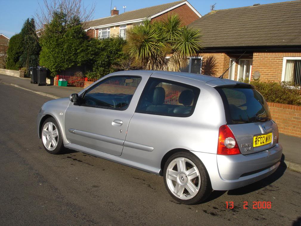

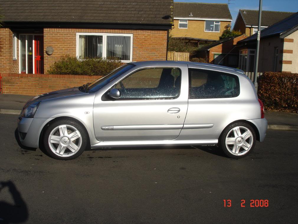

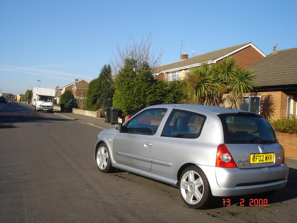

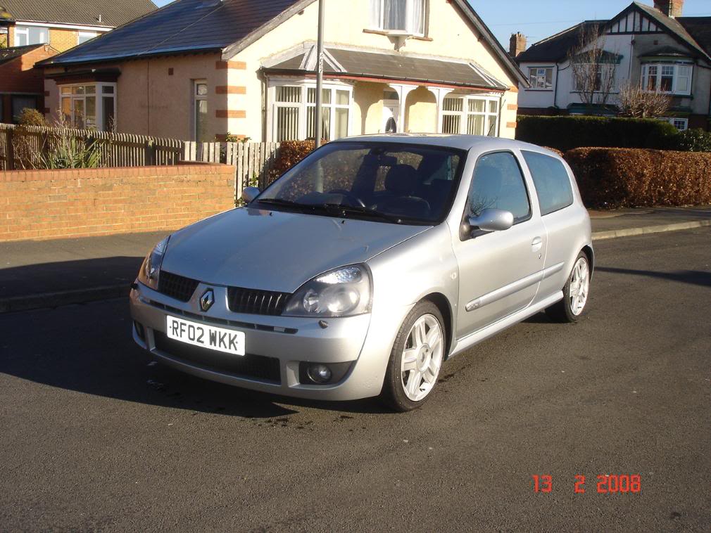

13th Feburary 2008
Fitted standard lights and 16" 172 alloys.
going to bodyshop this weekend and next week to get tidy'd up and a cup spoiler fitted.
will update next week.

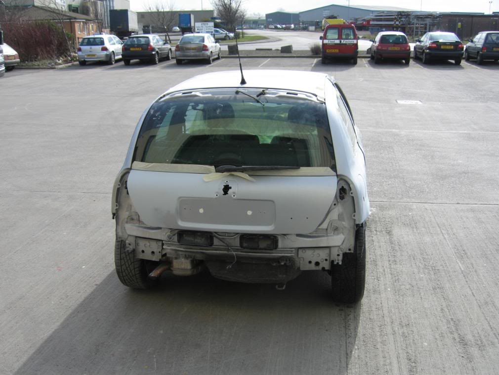

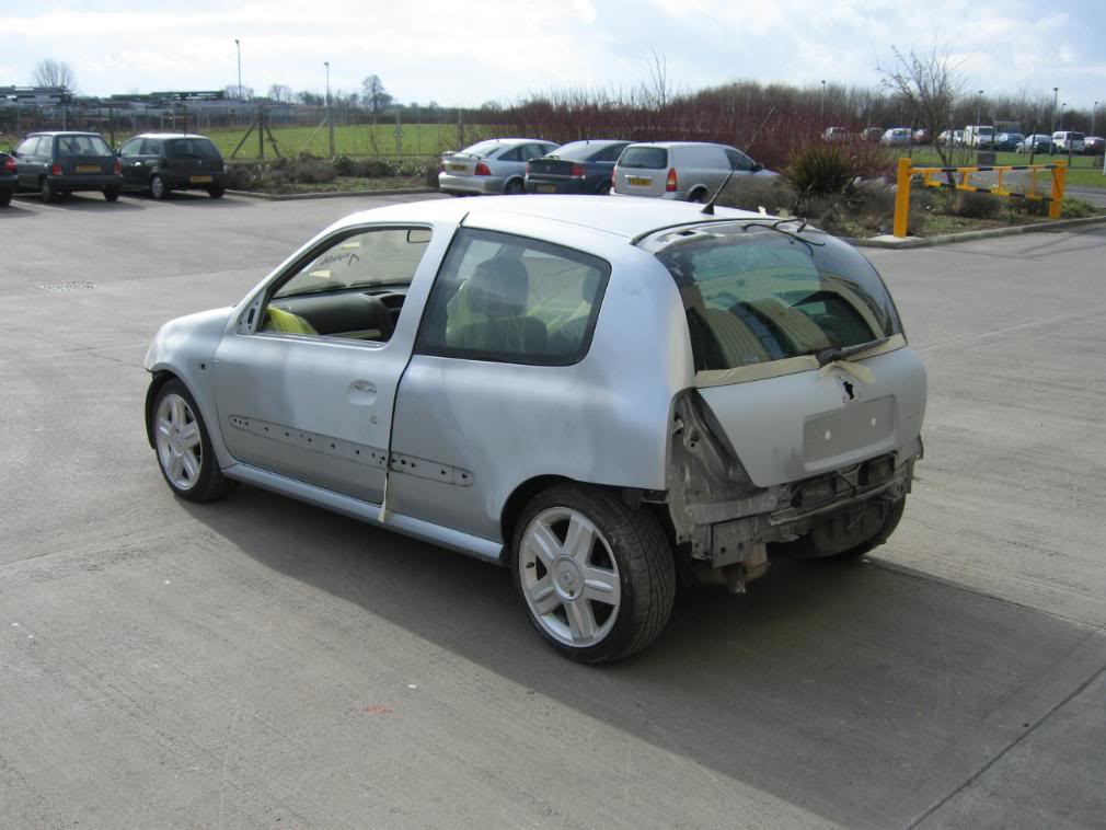

28th Feburary 2008
After sorting out the mechanical side of the car ive decided to turn my attention to the cosmetic side. The previous owners didnt really look after the car and had many dents and many chips/scratches etc. Because of this its now in the bodyshop getting a lick of paint and a cup spoiler fitted.
so far:

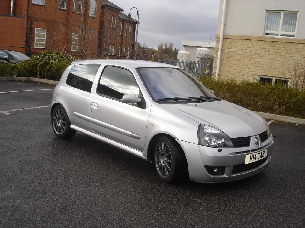

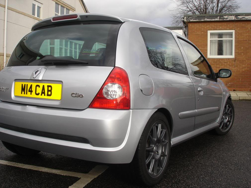

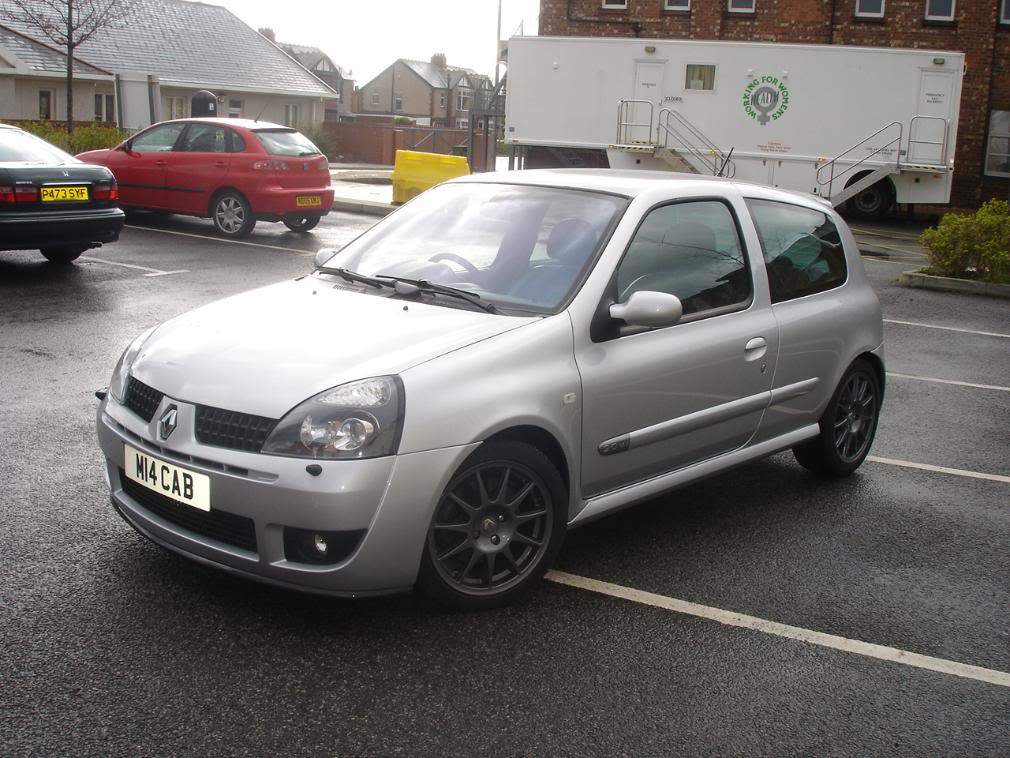

21st March 2008 - Car returns from bodyshop
After picking up the car last night i decided to spend my day making sure everything was fine.
-Fitted new gear stick gaitor
-Cleaned engine bay
-Fitted CF engine cover
-Fitted CTR aerial
-Fitted Justmatz Cliosport mats
-Cleaned the interior.
-Cliosport sticker applied
not the best photos but an idea of what it looks like now:
