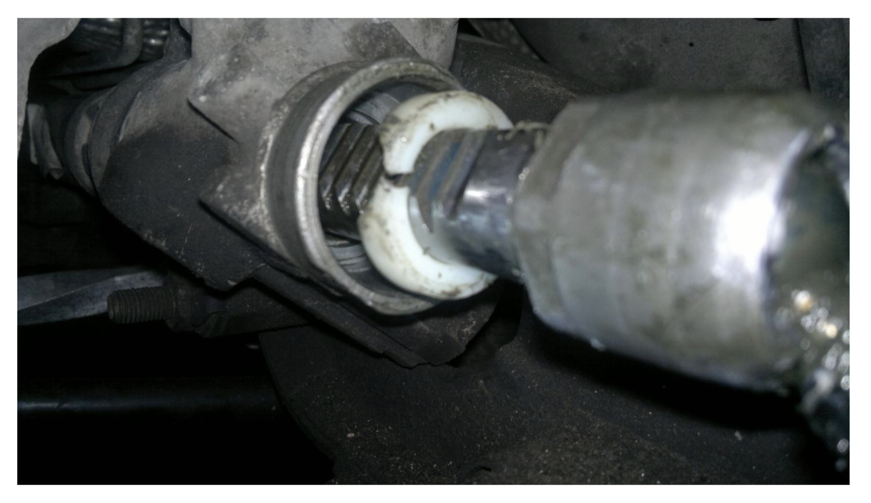

I'm looking to replace my inner track rods and have seen lots of posts which refer to a plastic fitting which sometimes needs to be split in order to get the crows foot spanner in there.
I can't seem to find those plastic parts anywhere: could someone point me in the right direction to a supplier?
The white plastic bushing. The guy who took this photo had to replace it as he split it to get the track rod. He then had to buy a replacement. Unfortunately he posted it in 2012 and I can't contact him now!

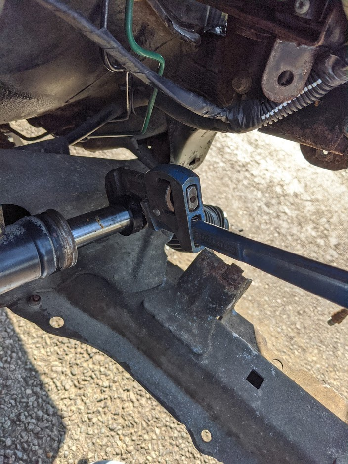

I remember seeing @Dr Jekyll using a viscous fan spanner (I think) to change his tie rods.

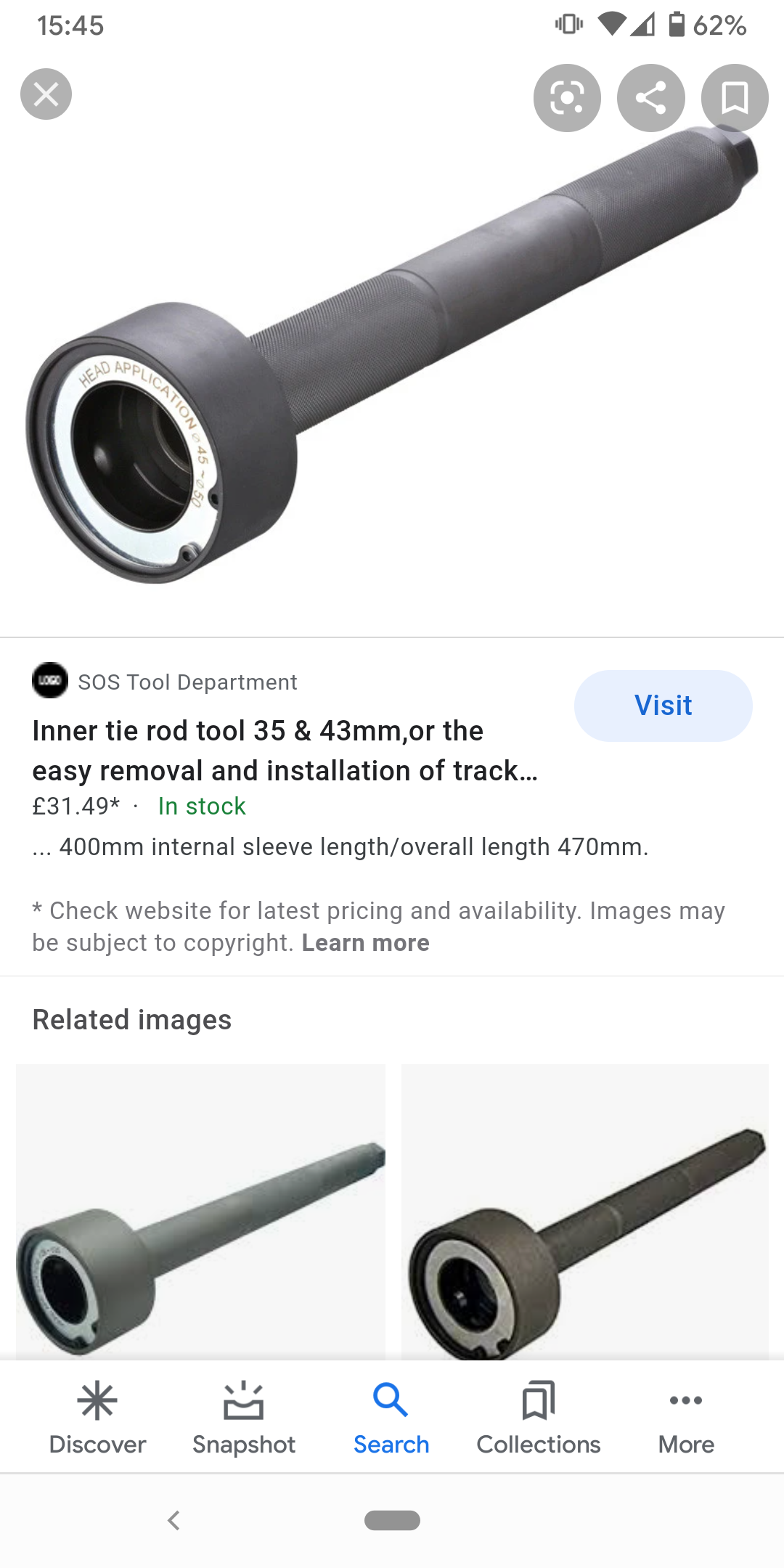

I’ve ended up buying both the spanner and the tie rod removal tool for when I tackle this job at somepoint when it comes warms up outside.
Edit: found the page in his project thread:-
What I used. The hard part of this job is putting the gaiter back on
Yes that's what I used. Done it a few times now over the years and the tool has always worked fine. Been meaning to buy the one James linked to, but forget so just use the fan spanner when doing the change.
As @ZachB said, the hardest part is getting the gaiter back on as its greasy and slippery. A small screwdriver does the trick.

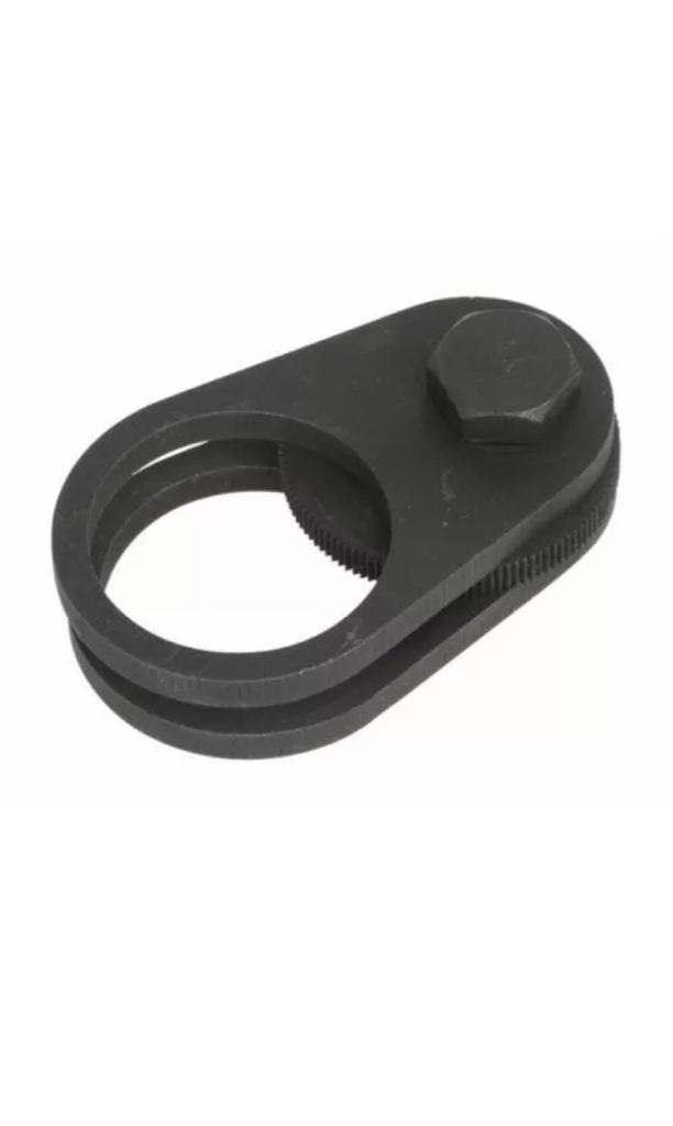

So literally just purchased this one to replace a broken item.
