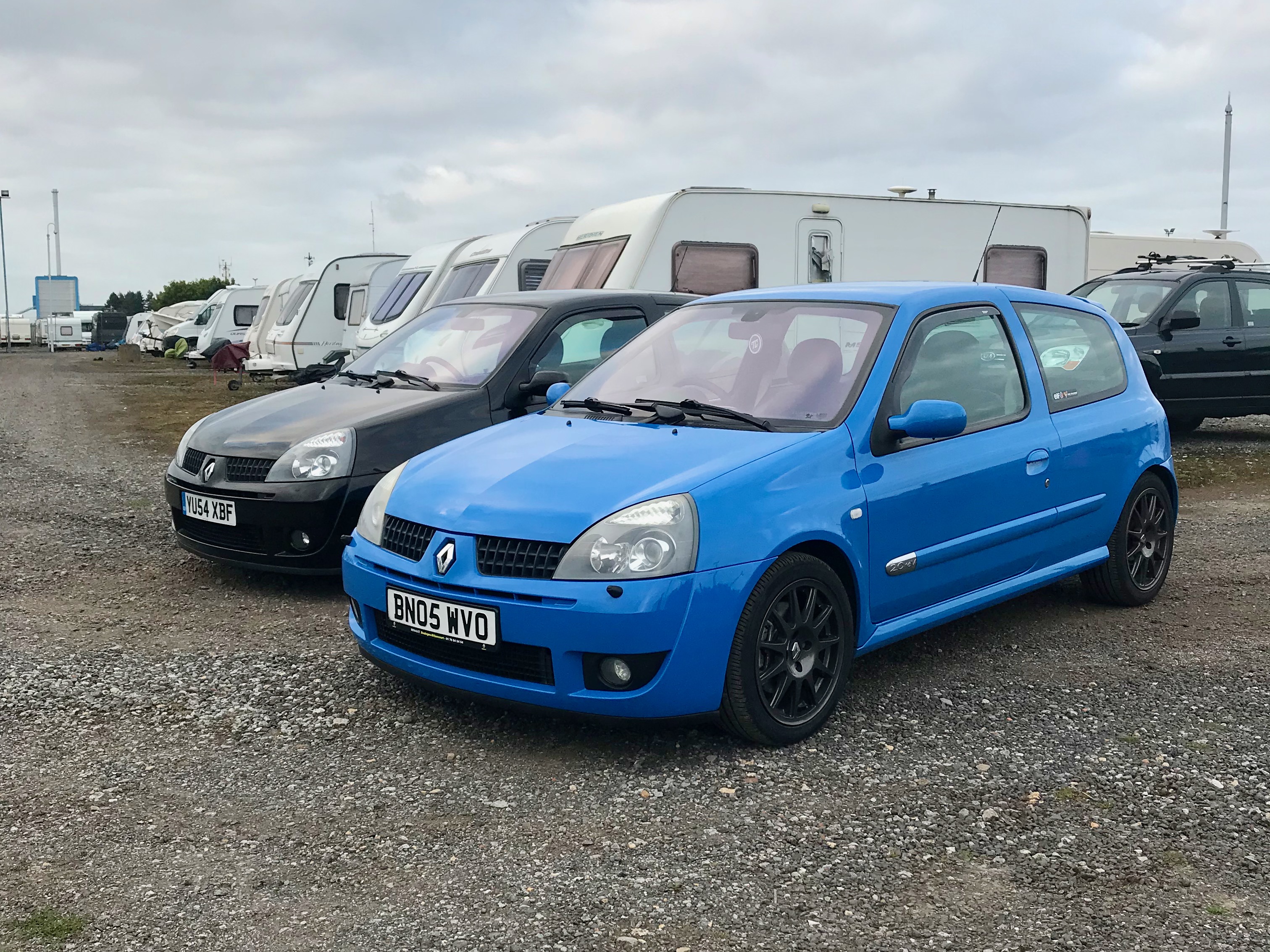

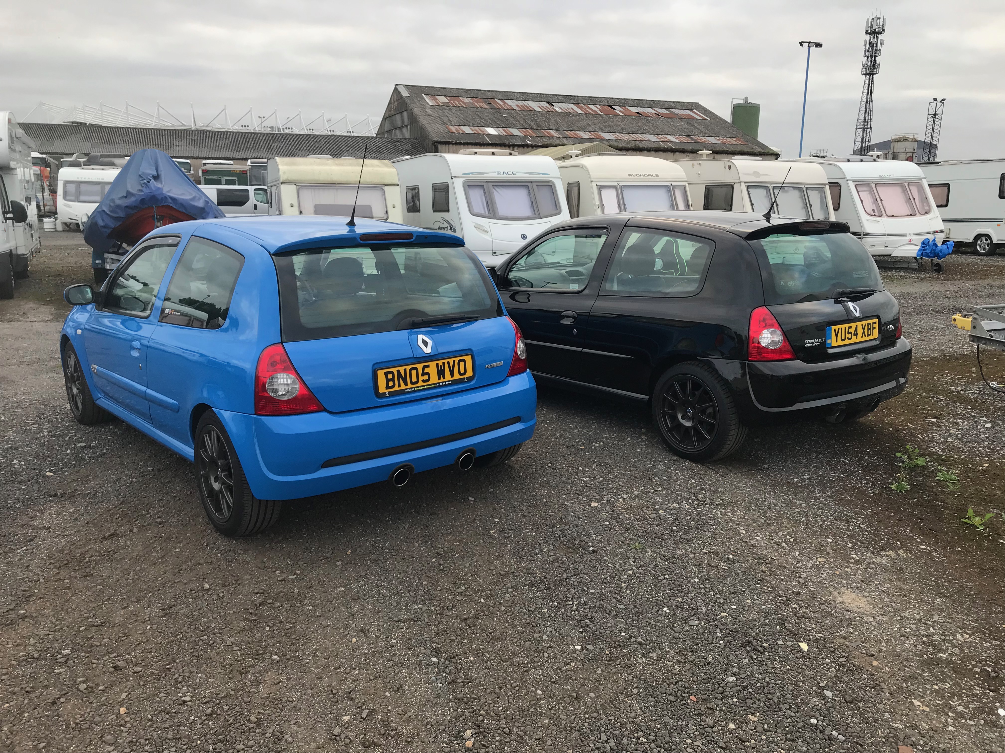

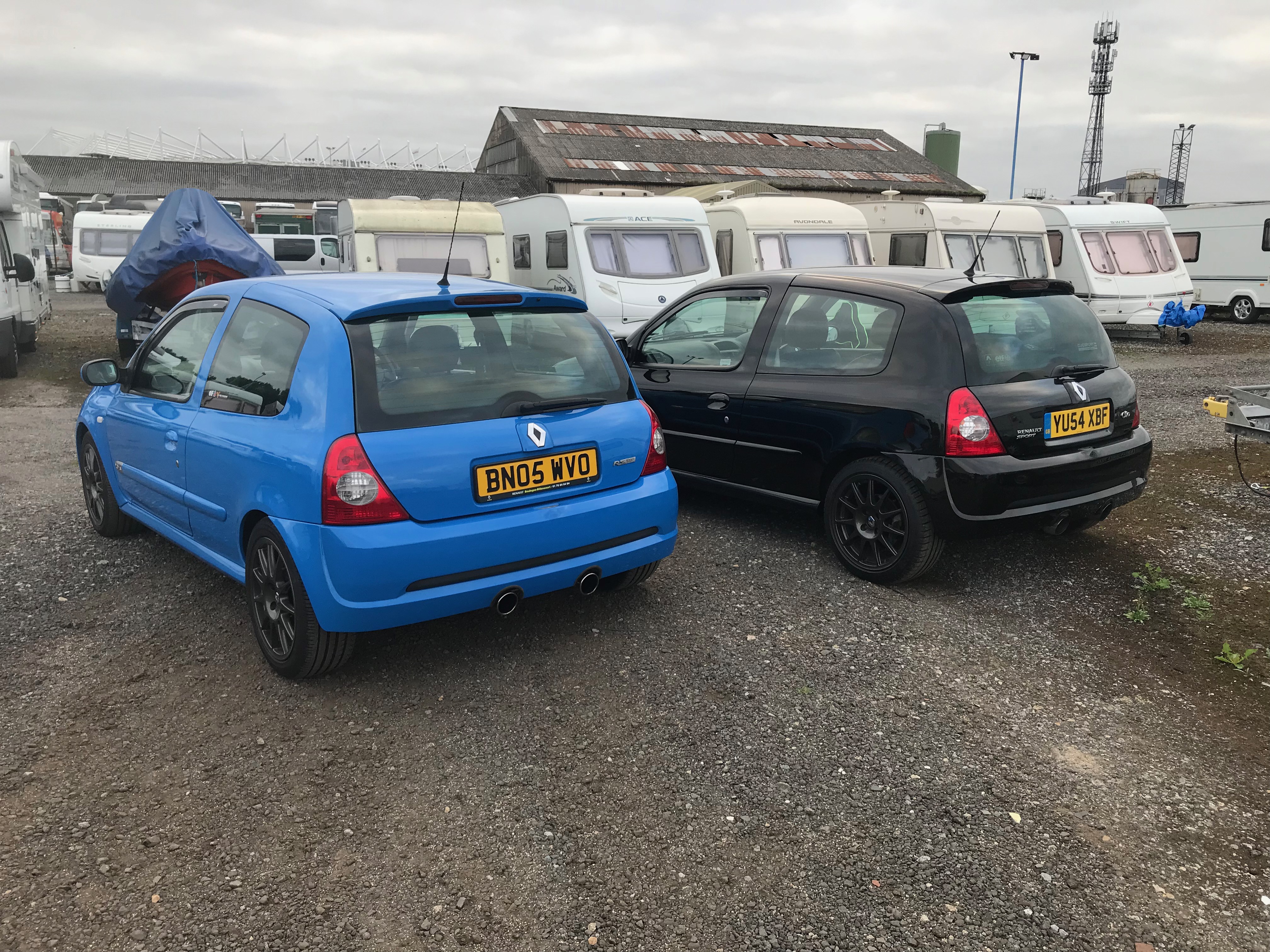

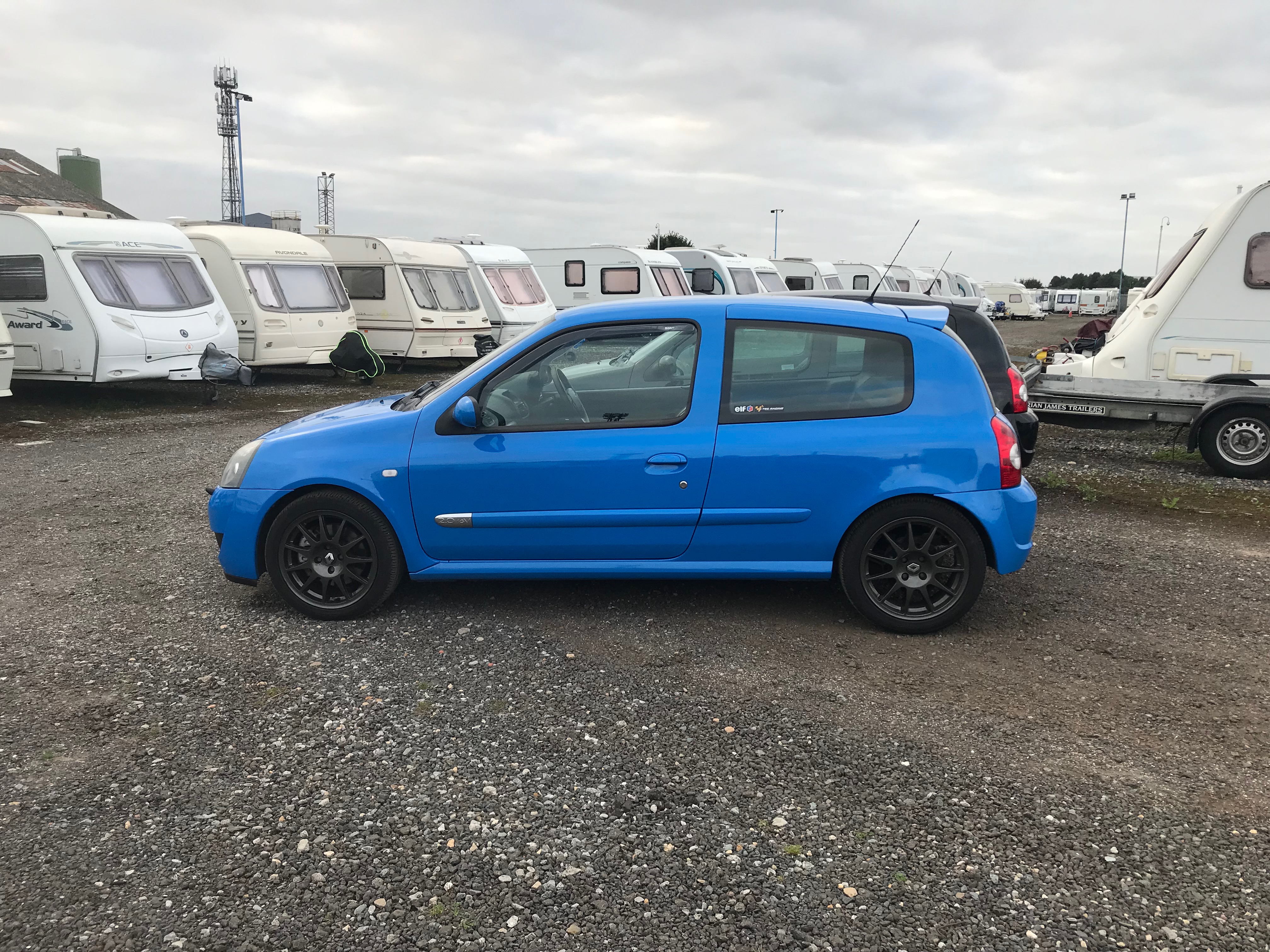

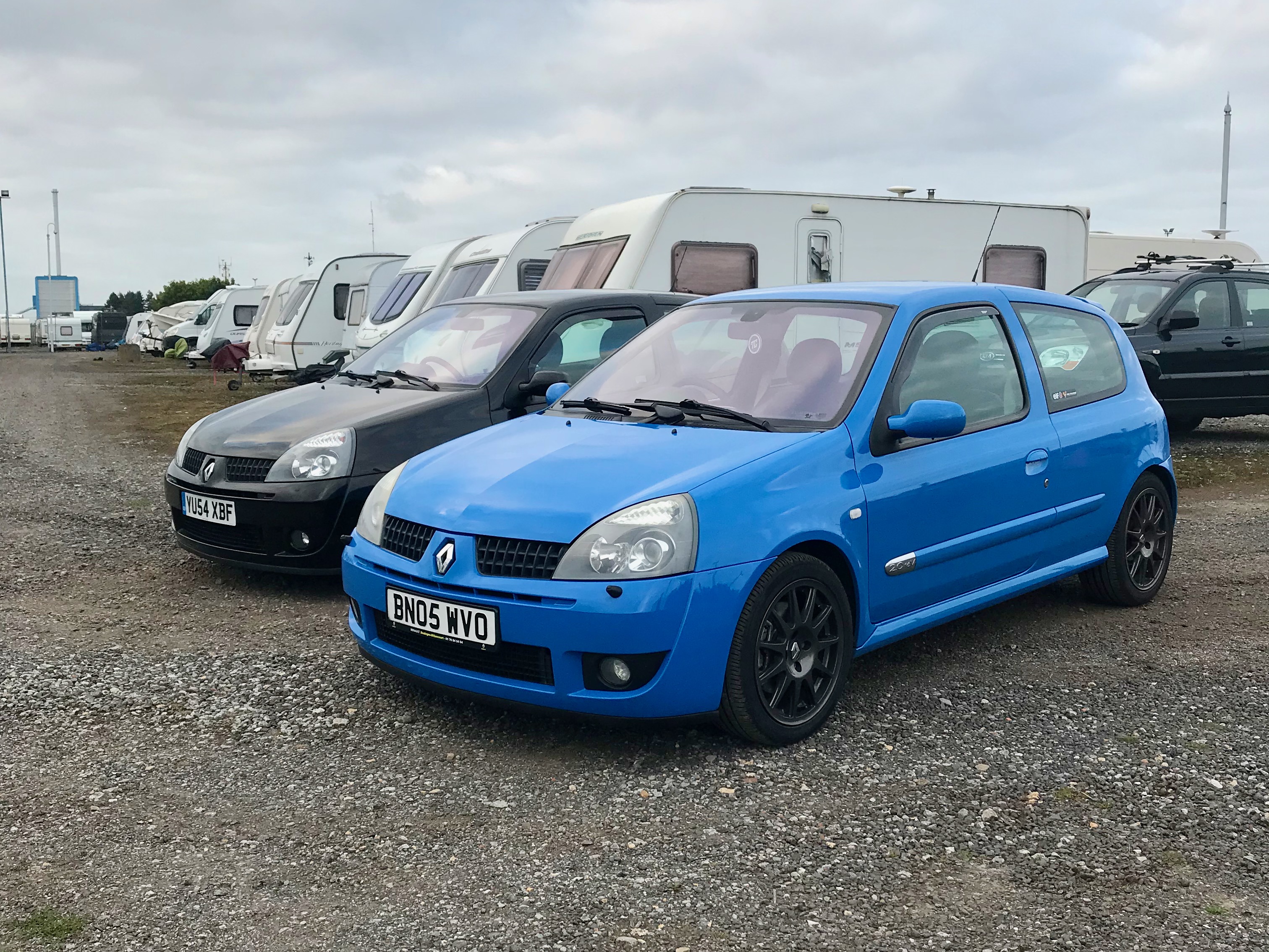

Anyway, here are the pictures of the car when i first collected her alongside my restored BG. I've already done some work on the backend which i'll update on here over the next week or so. Hope you enjoy and thank you for reading.
View attachment 1563773View attachment 1563772View attachment 1563771

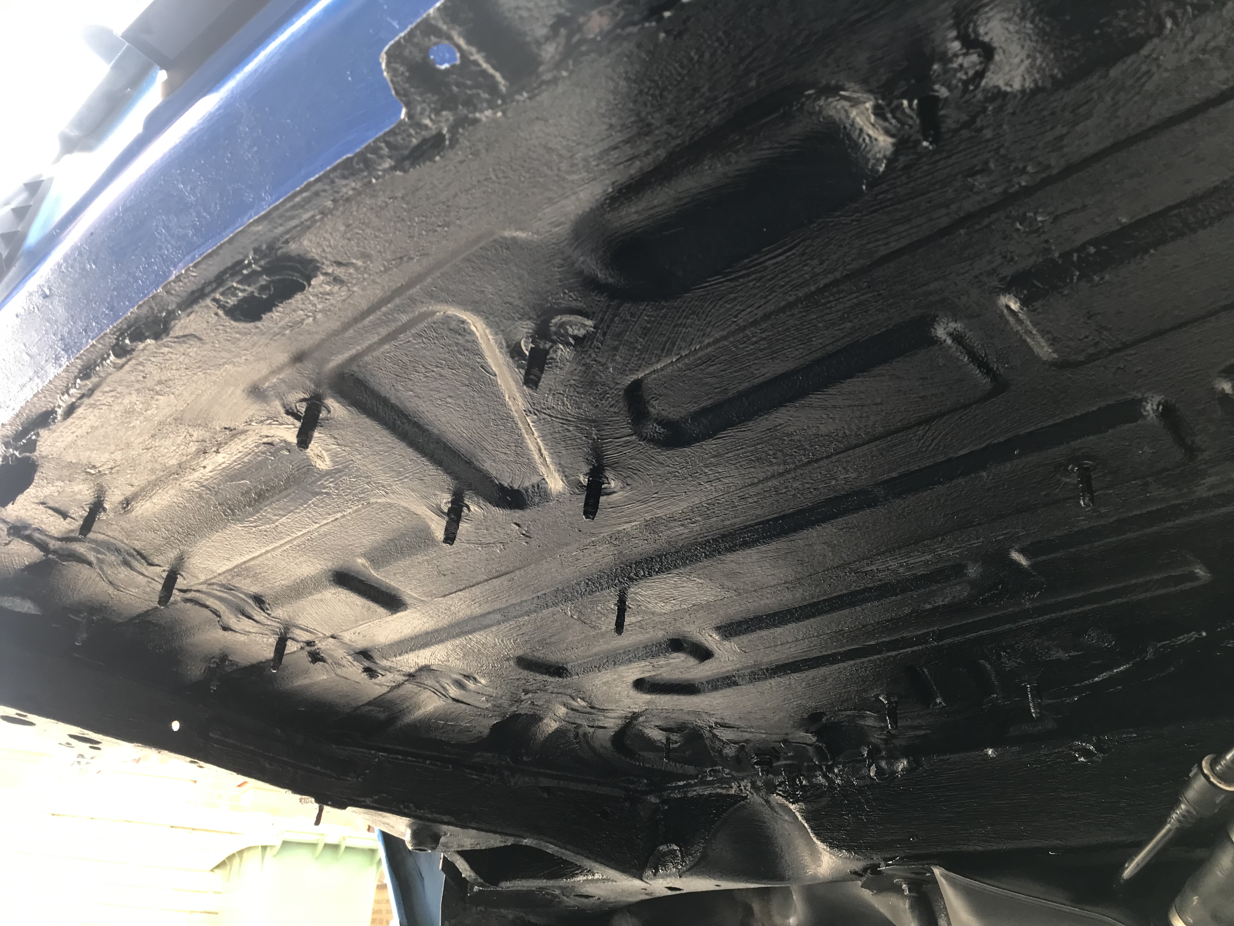

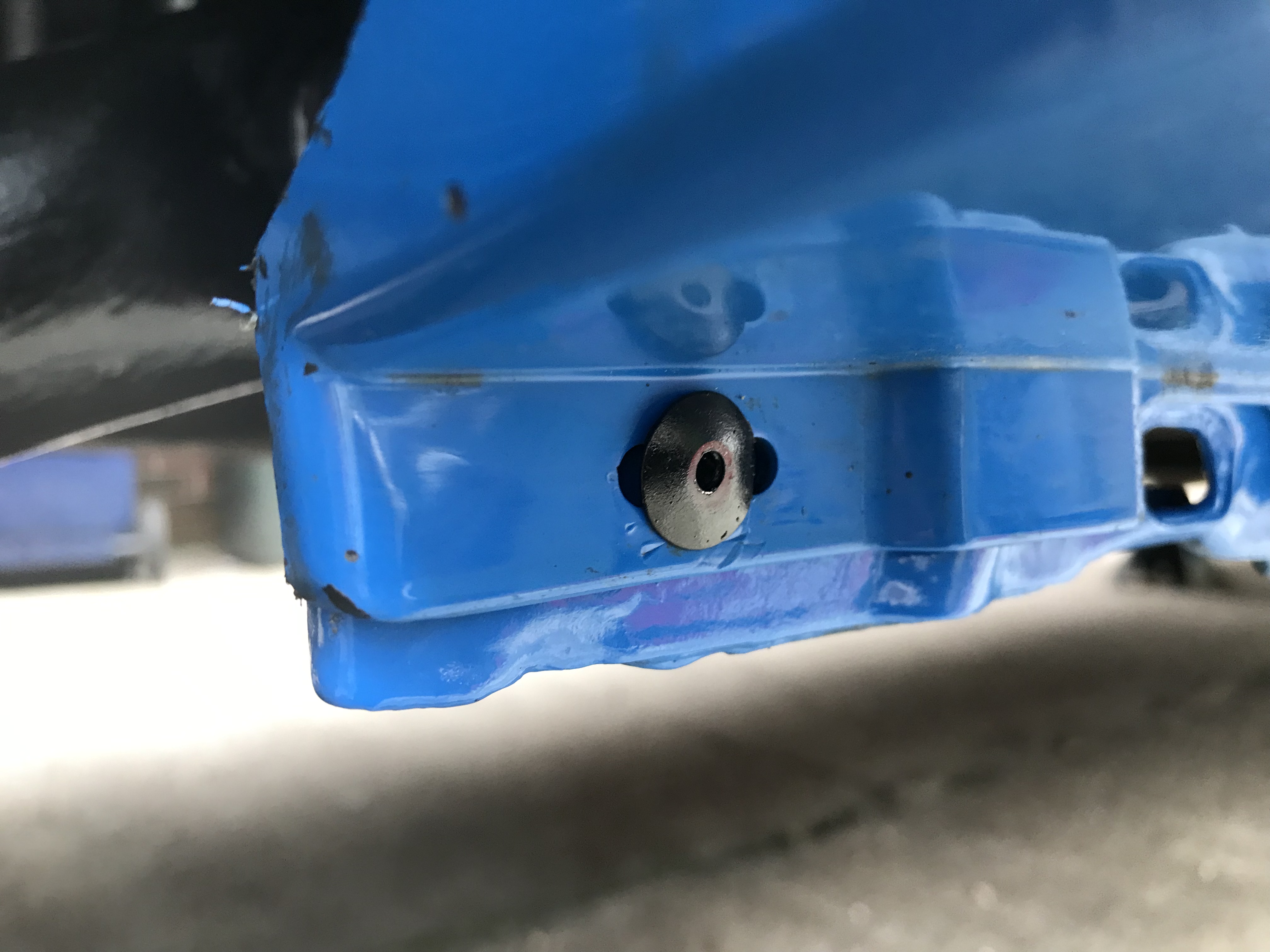

Underneath wasn't bad at all, so i just gave everything a clean up and then undersealed, touched up the painted areas and then cavity waxed oiled it. It's ugly but the goal is to avoid any corrosion and the treatments i used are in brush form only.

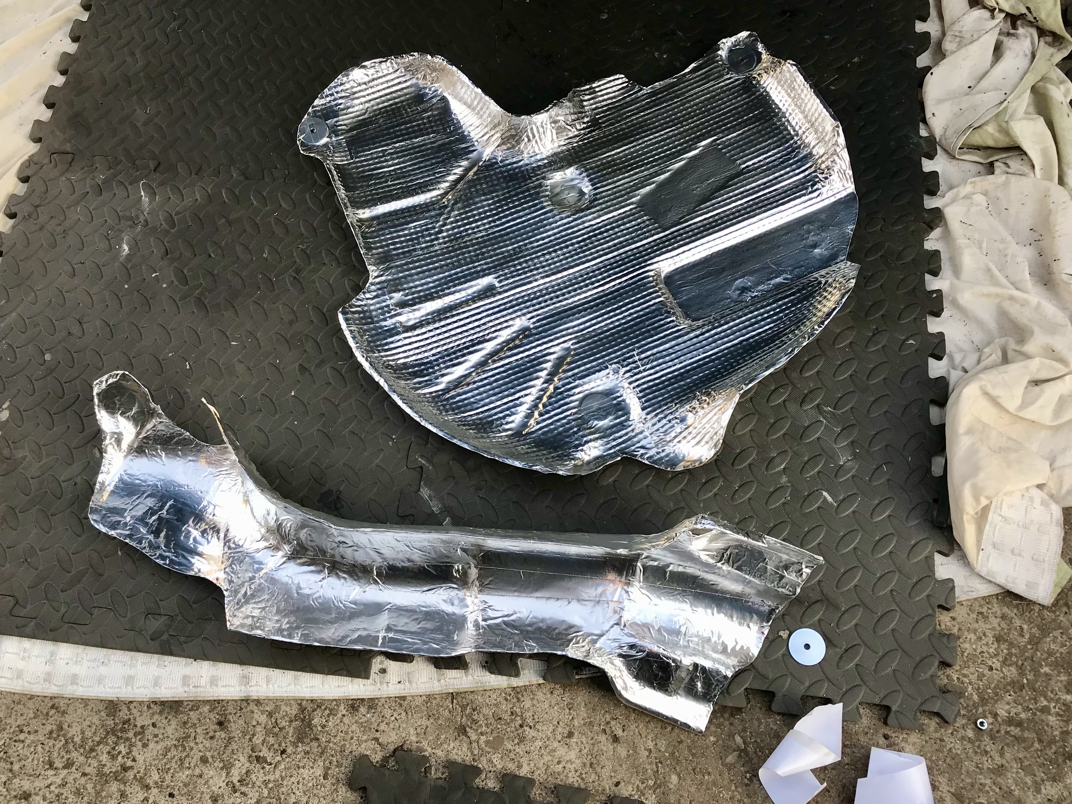

Even had a go at the exhaust heat shields :ROFLMAO: god knows how long they'll last. I've since bought a large sheet of nimbus heat shield so stay tuned for a Frankinstein monster of an attempt at replicating the rear shield.

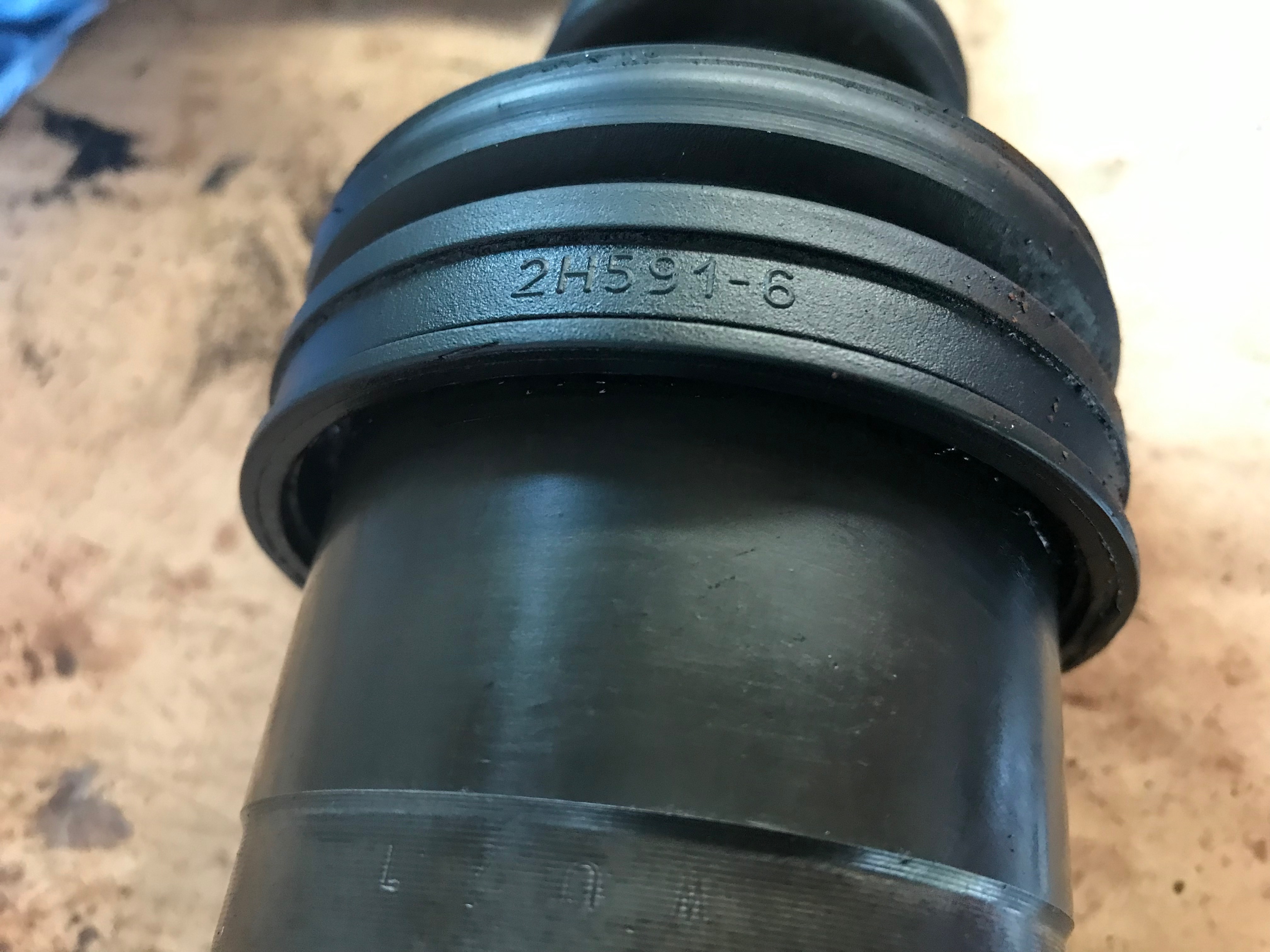

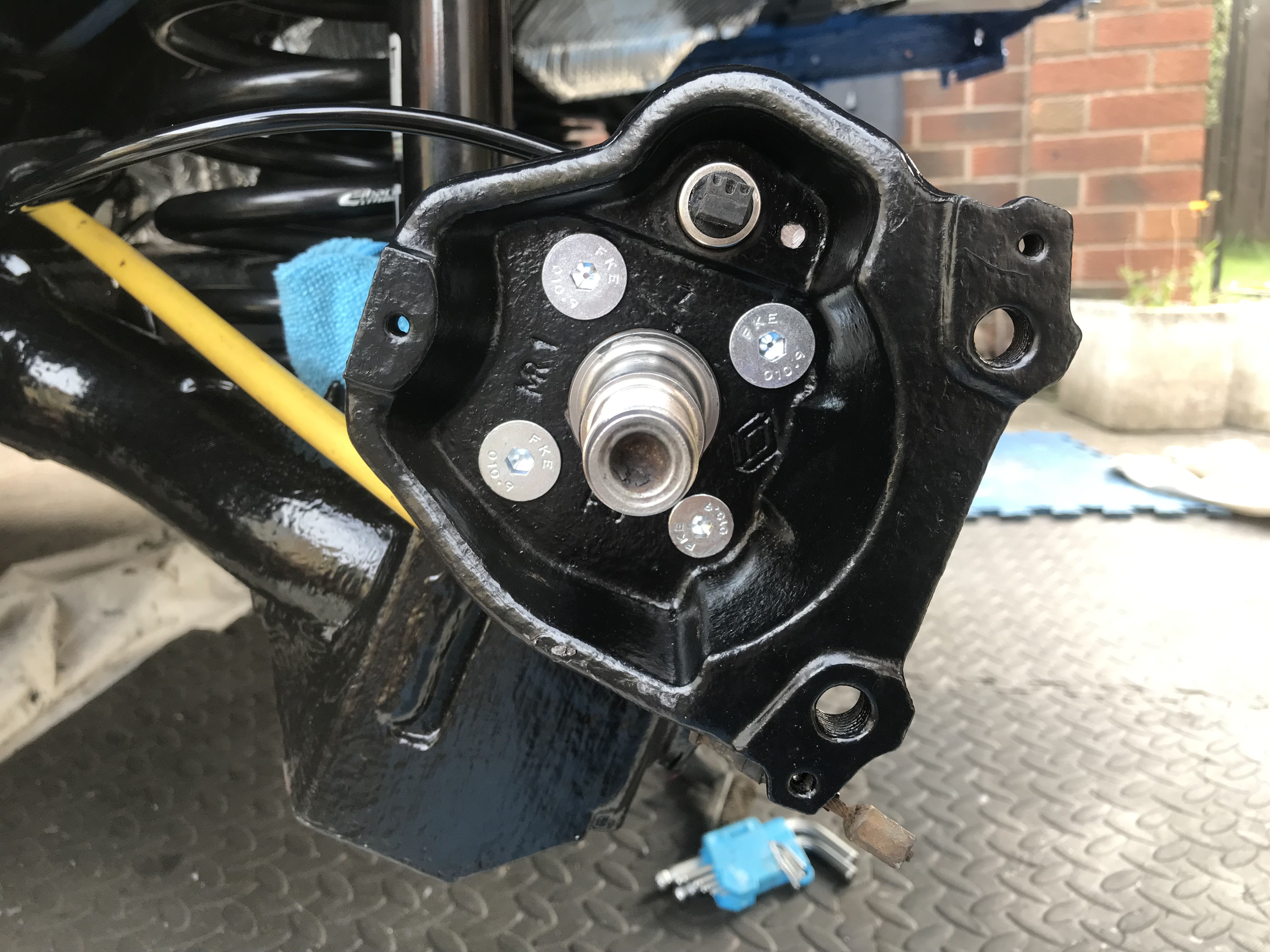

Rebuilt the restored beam with new bolts, nuts, brake lines, calipers, brake discs and pads etc....Old brake lines on the rear didn't look great so replaced with stainless steel braided lines.
I've been trying to get my hands on some genuine cup springs but the ones i've been offered are pretty much useless, so may just keep the Eibach spings on for now. I've also bought brand new front and rear Cup dampers to replace the new aftermarket dampers currently fitted. I'll stick these up for sale later when i take them off.

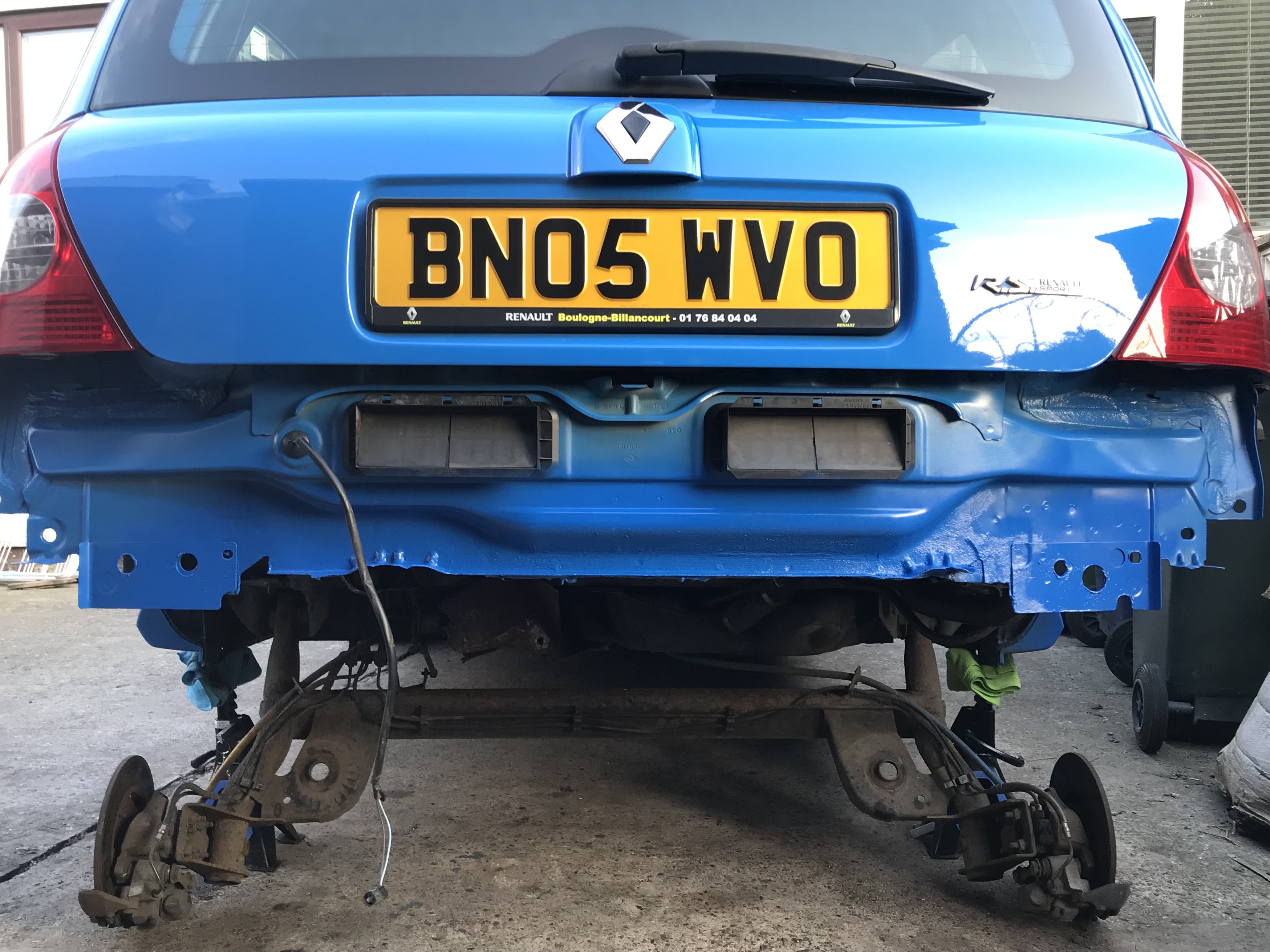

Had a few parts aqua blasted, replaced the exhaust bushes and cleaned up the exhaust. I was going to replace the Scorpion system on it with a PMS but it's almost new and doesn't sound too bad at all.
With the rear done i began working my way down towards the front starting with the drivers side. I noticed the side skirt was a little chewed up and it looked like it had been off before as it was stuck on with self tappers.
Yes it had definitely been off before, probably to do some remedial work, but why they didn't use rivets to stick the trim brackets back on is beyond me.
Anyway it's an easy fix. Job done.

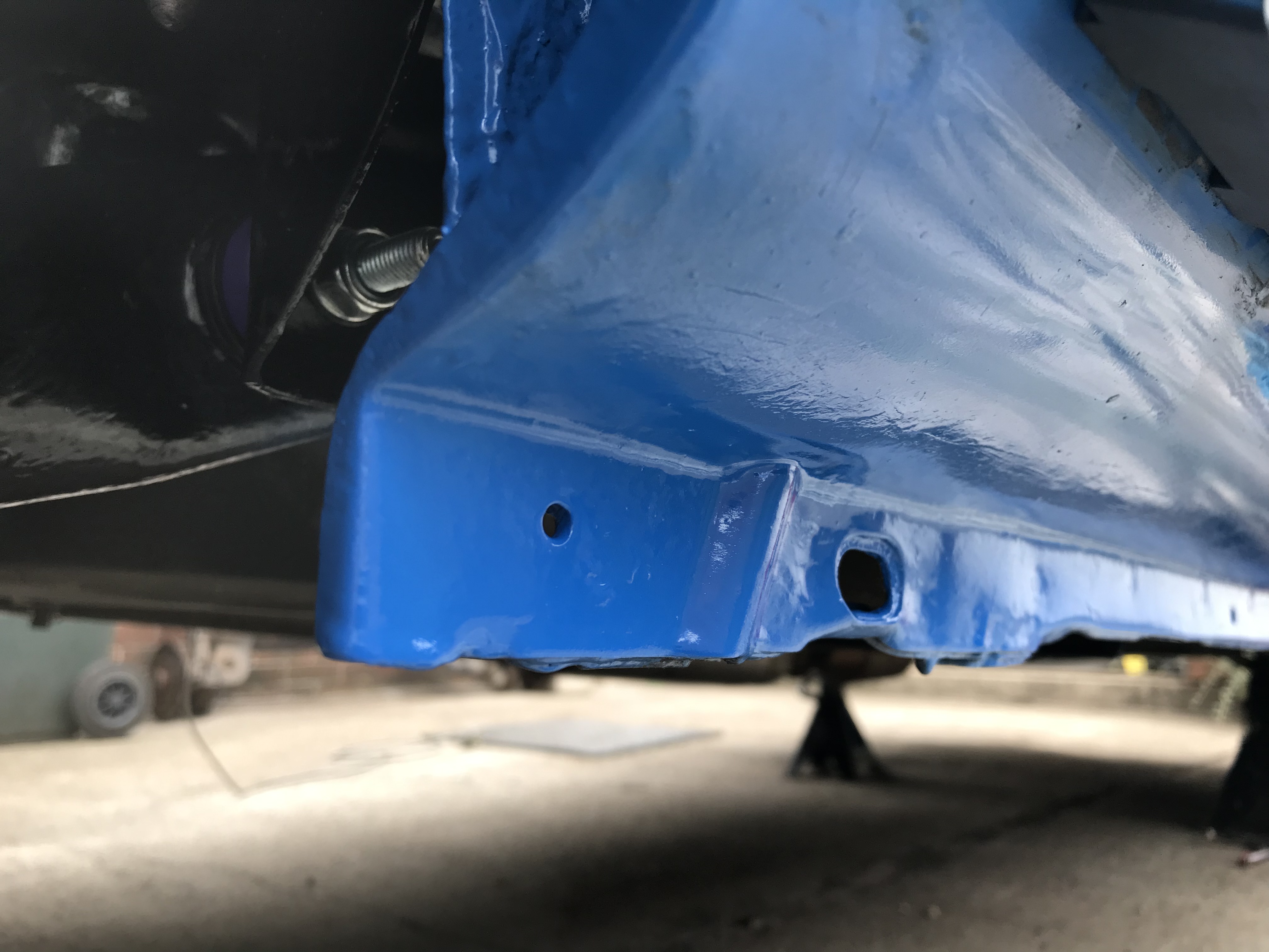

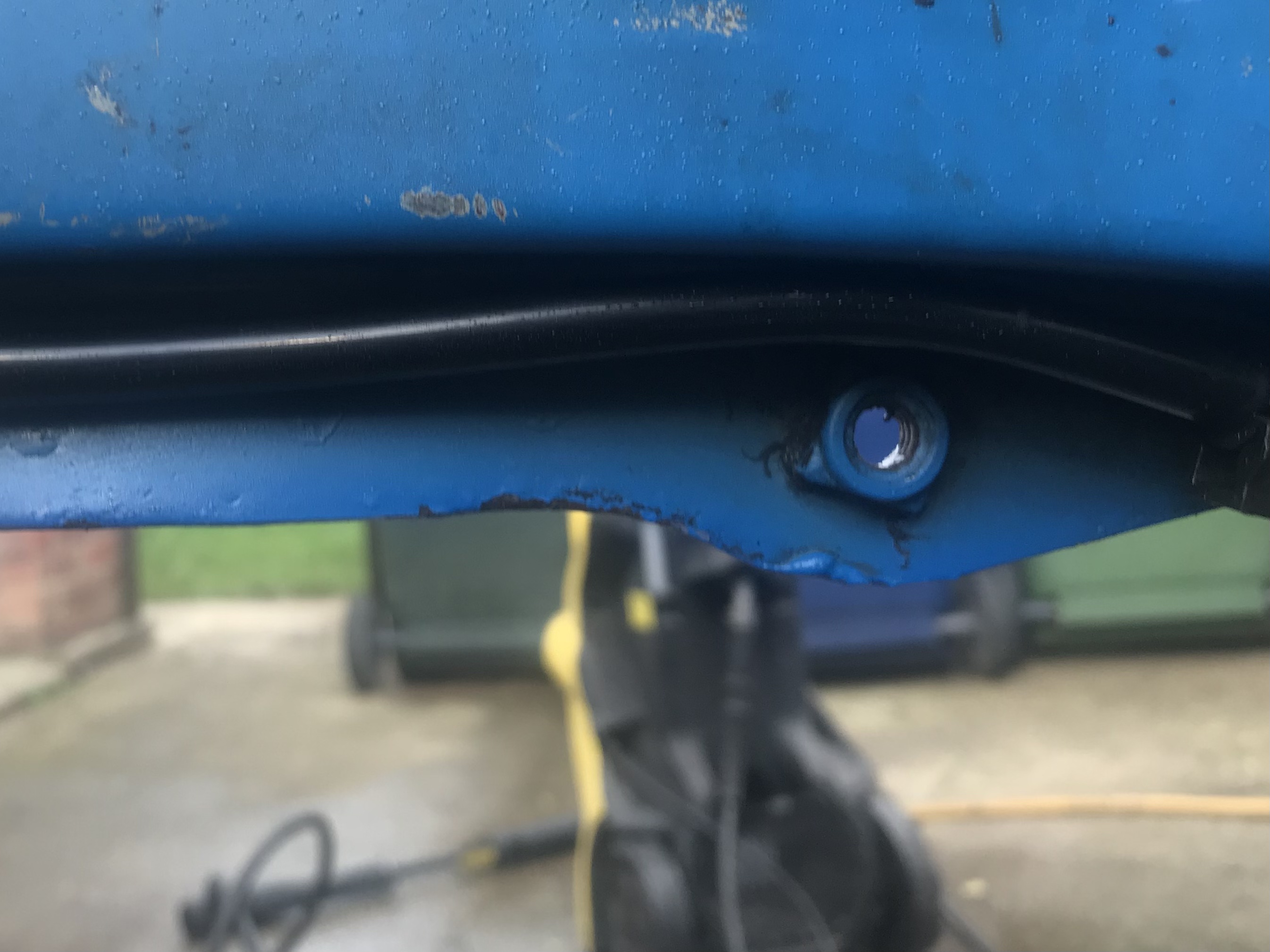

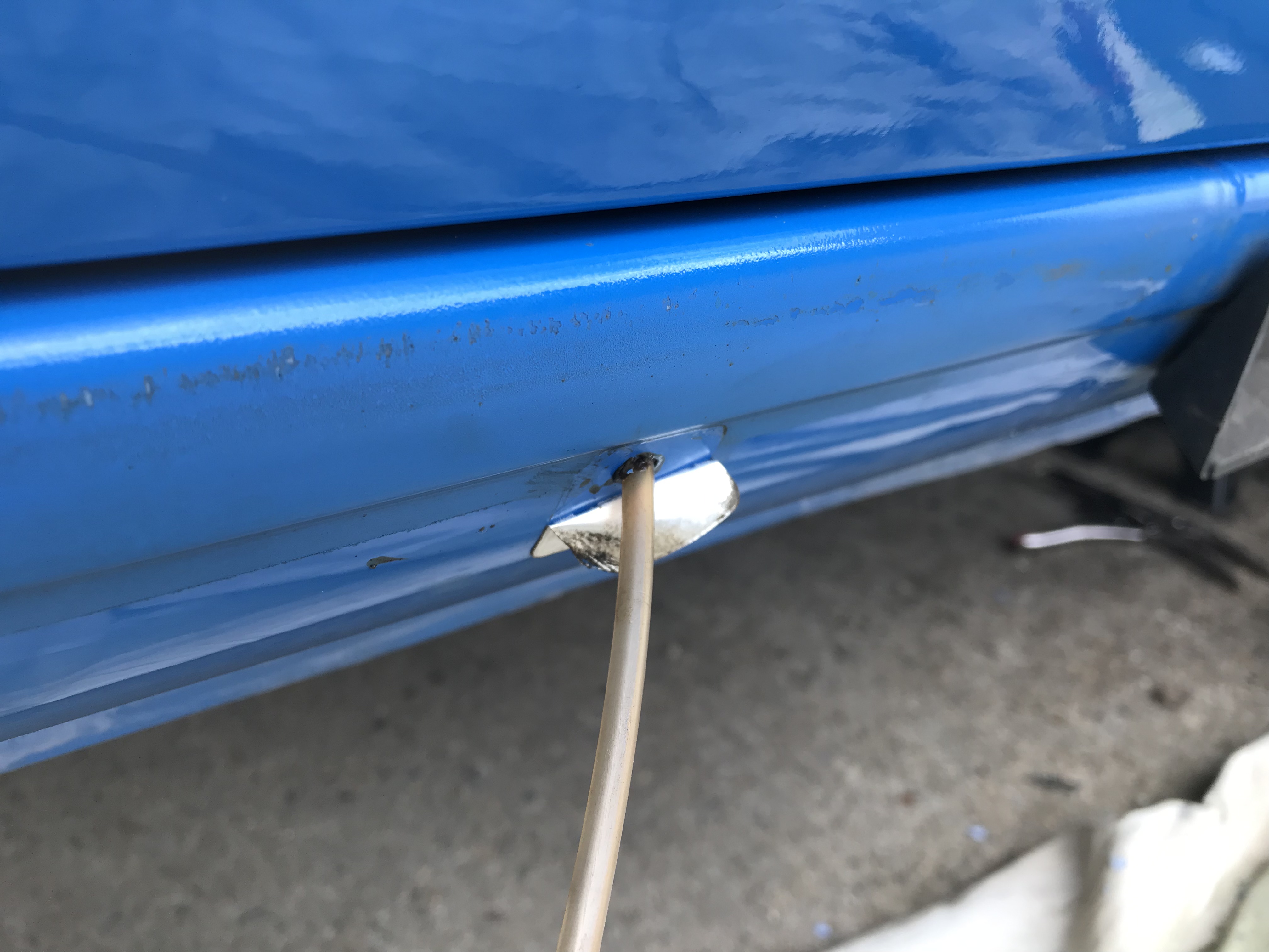

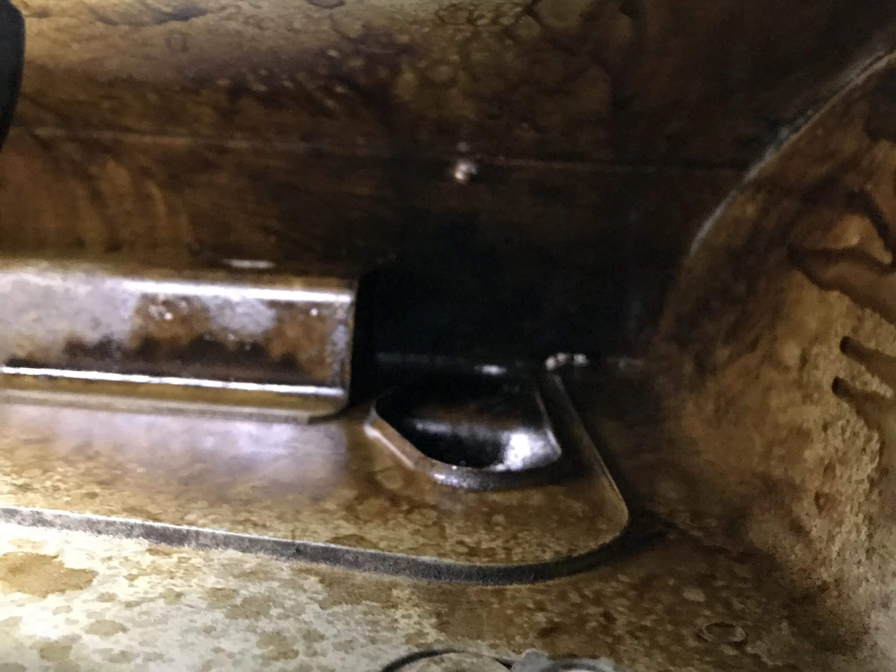

The rear seats were already removed from the car, so i took a peek down into the rear arch. It's a very scary thing to do I can tell you. A bit of relief when there's no corrosion 😅

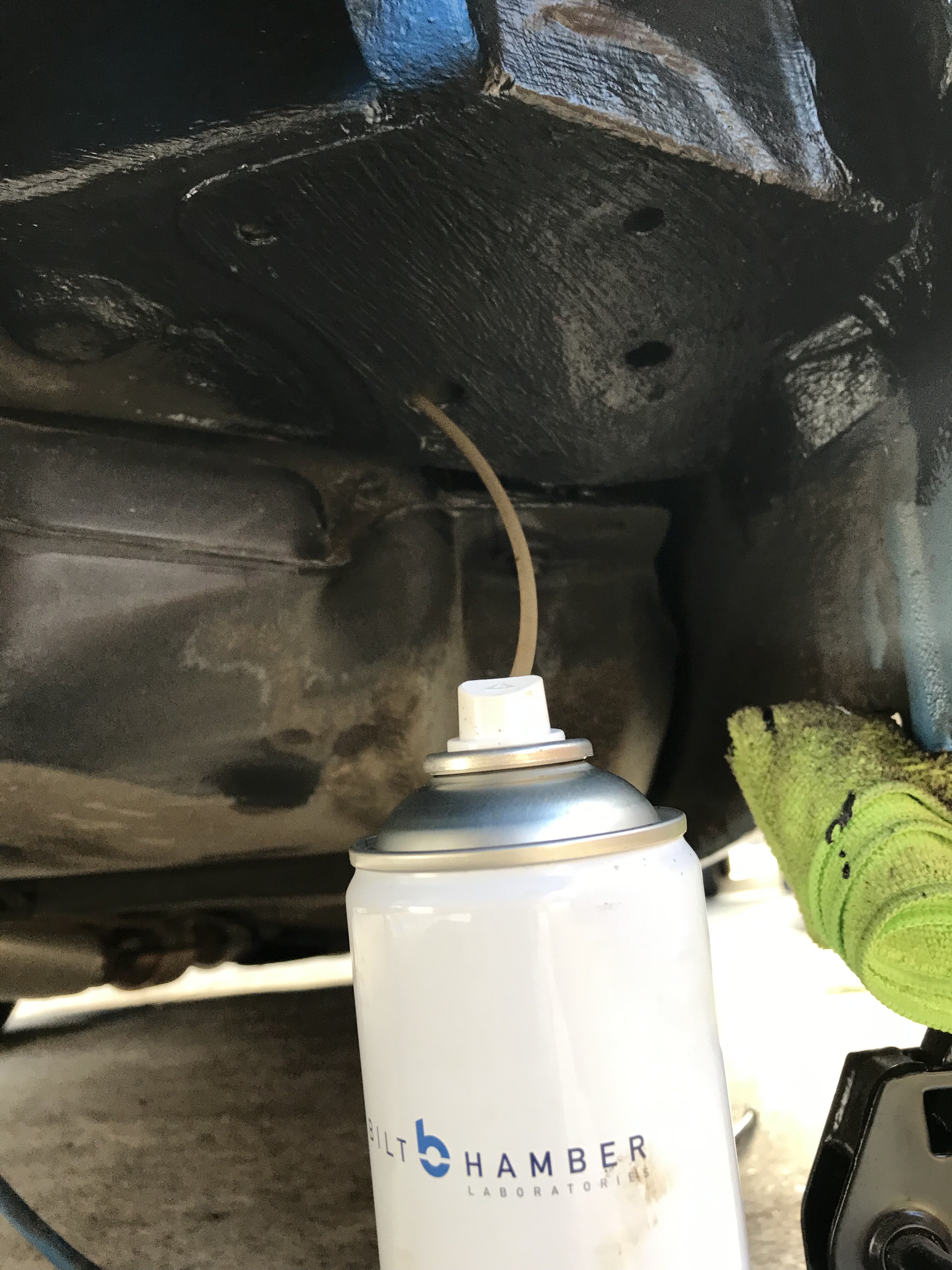

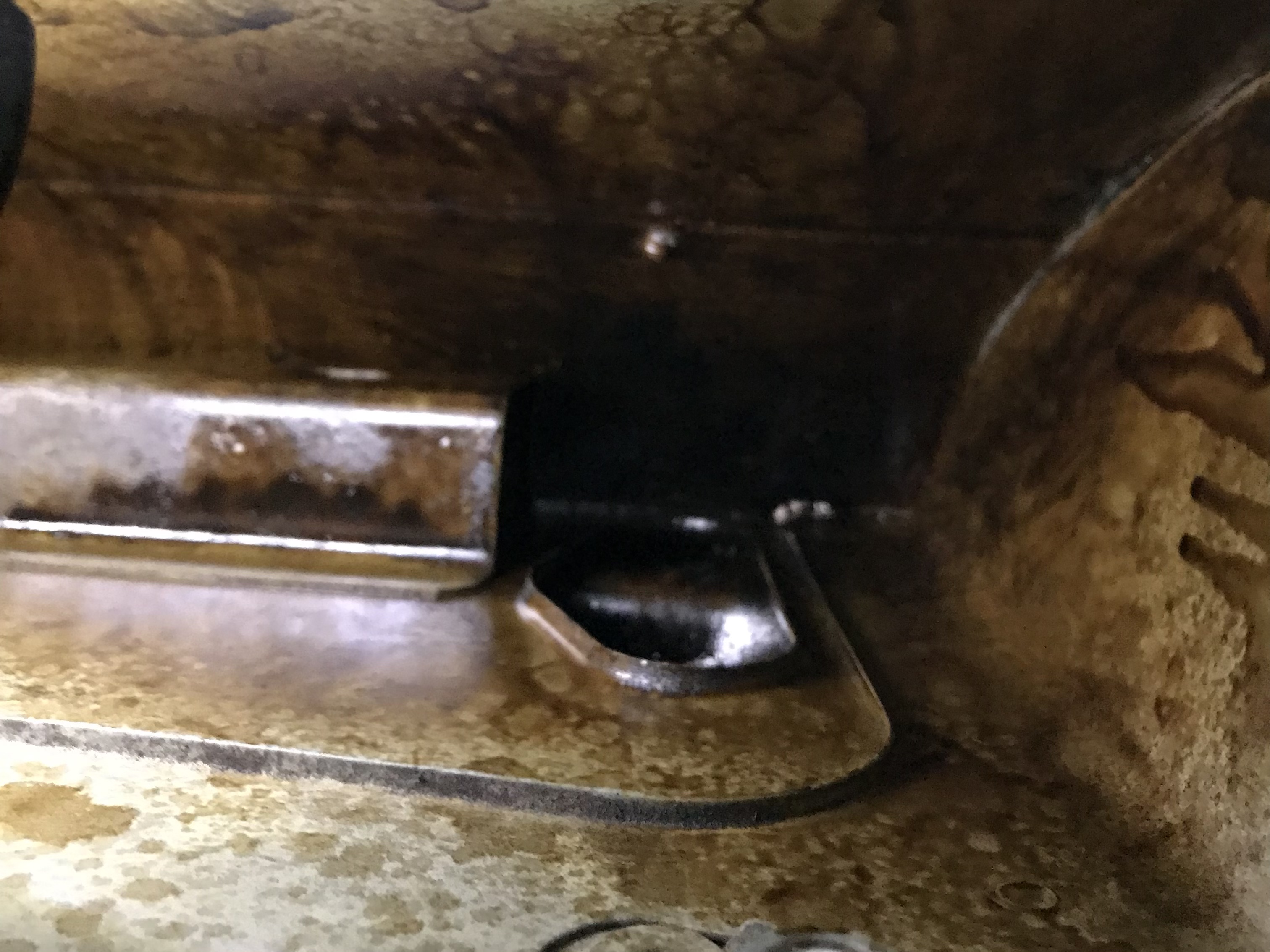

By now i'd stuck the wax oil lance into the sill and was happily blasting away, before i realised i didn't get any pictures for reference.
Oh well, at least that's not rusting anytime soon.
Finally i tret a few small areas with Hydrate-80 and touched up the lower sill to tidy it over winter.

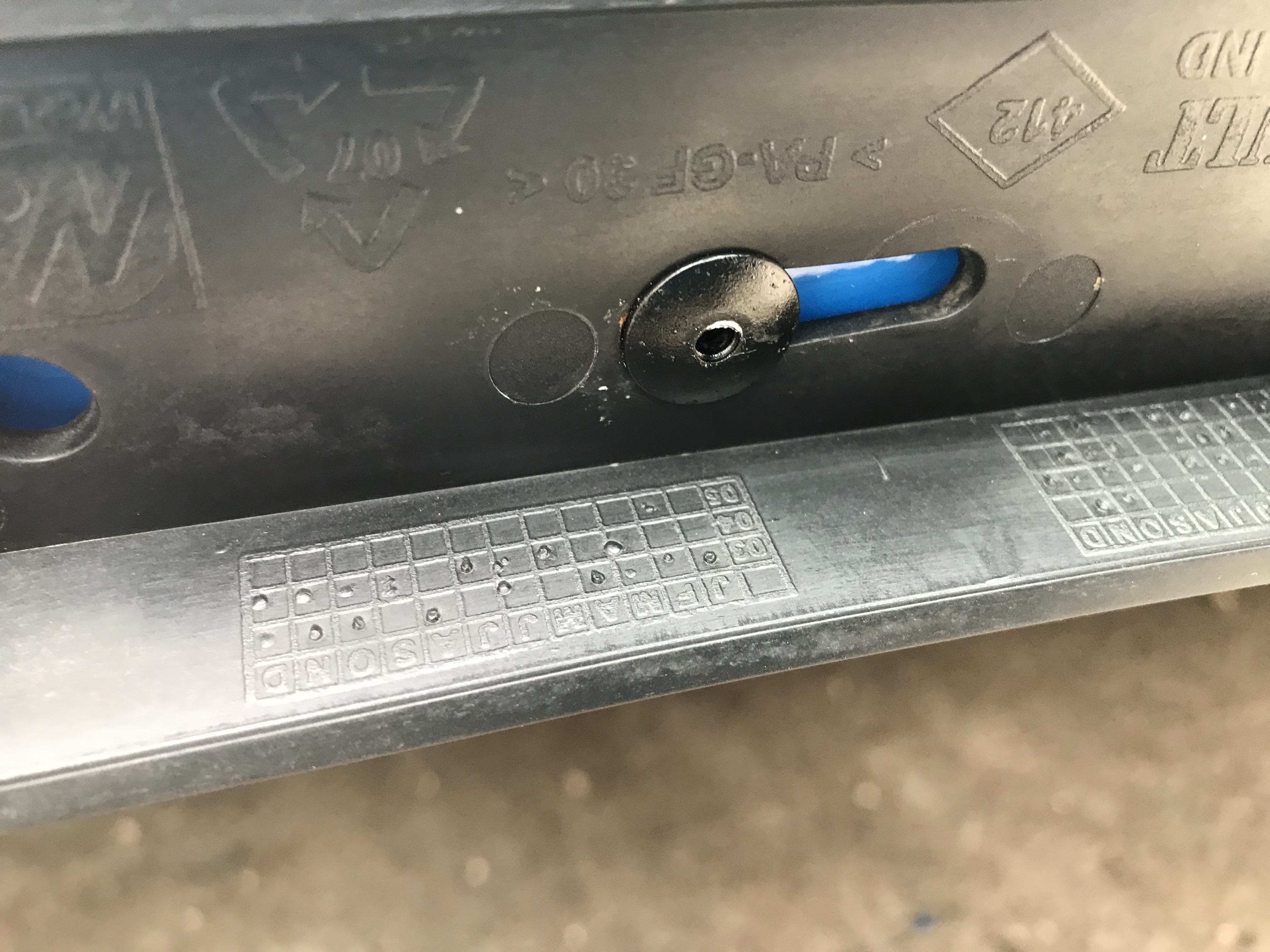

The car is going in for some paintwork in the spring as i fully plan on sending the car off for a proper detailing job, so want it perfect before i do that.
Stuck the side skirt back on and began the search for a replacement part - more on that later.

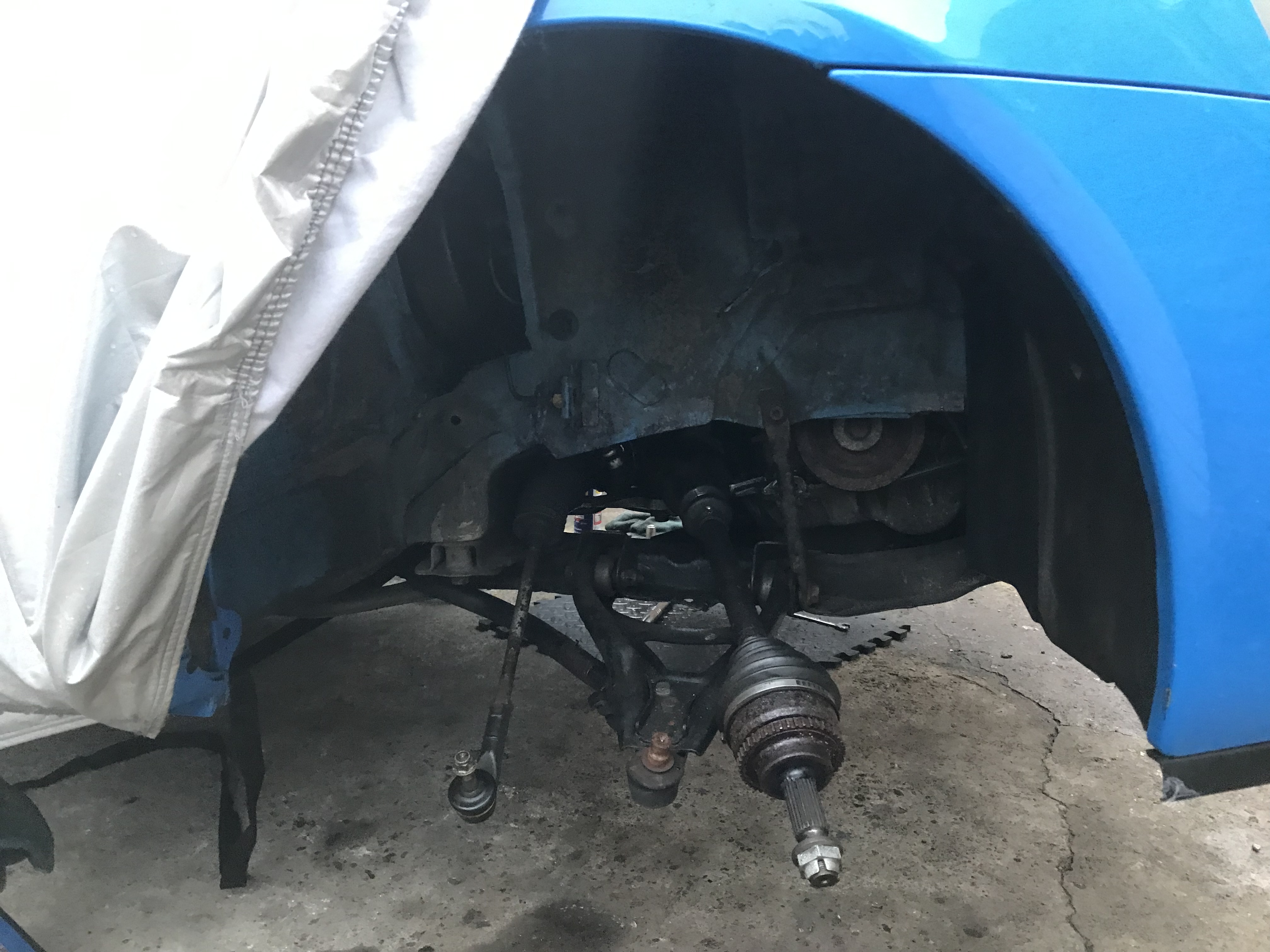

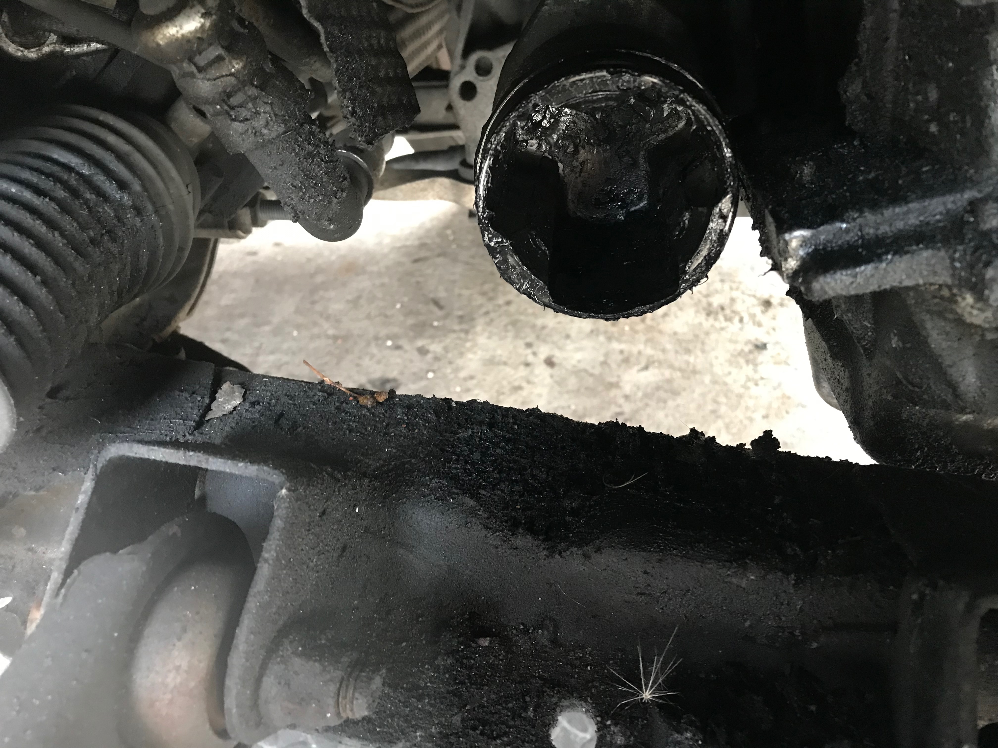

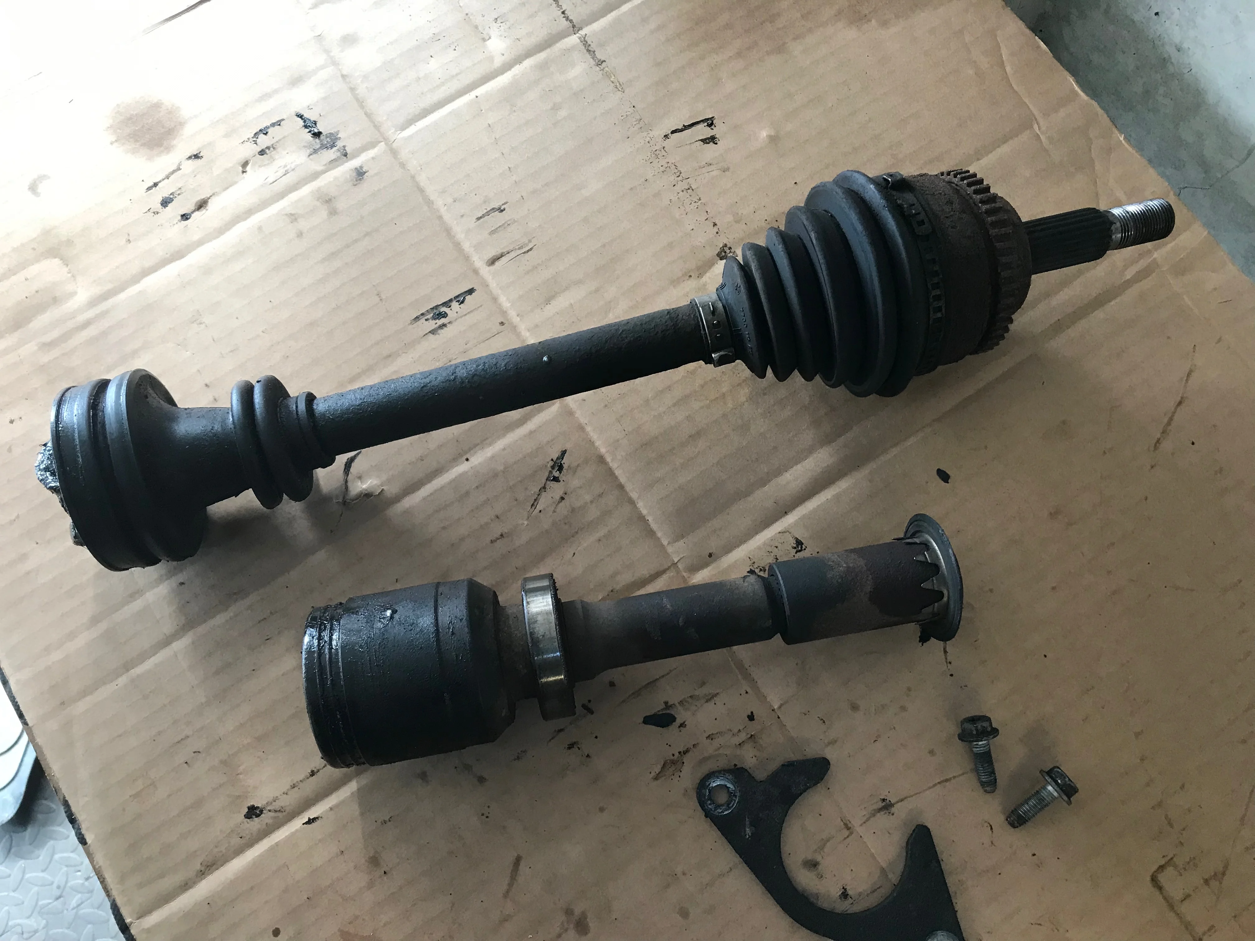

When i bought the car i noticed the steering was very vague, nowhere near as sharp as my BG. The owner also mentioned a knocking sound on pulling away.
I couldn't really get it on a ramp in the middle of the compound, but i had a feeling i knew what the issue was.
Whipped the wheels off to find moly grease all over the subframe and engine sump. Pulled the discs and hubs off and noticed the CV boot and ABS rings were the wrong ones. Bodge alert! 😅
The driveshaft separated pretty easily as it wasn't even fixed on. Probably had clips on it but no doubt they broke off after bouncing off the sump.
Anyway, i've now bought a Shaftec R396R replacement driveshaft.

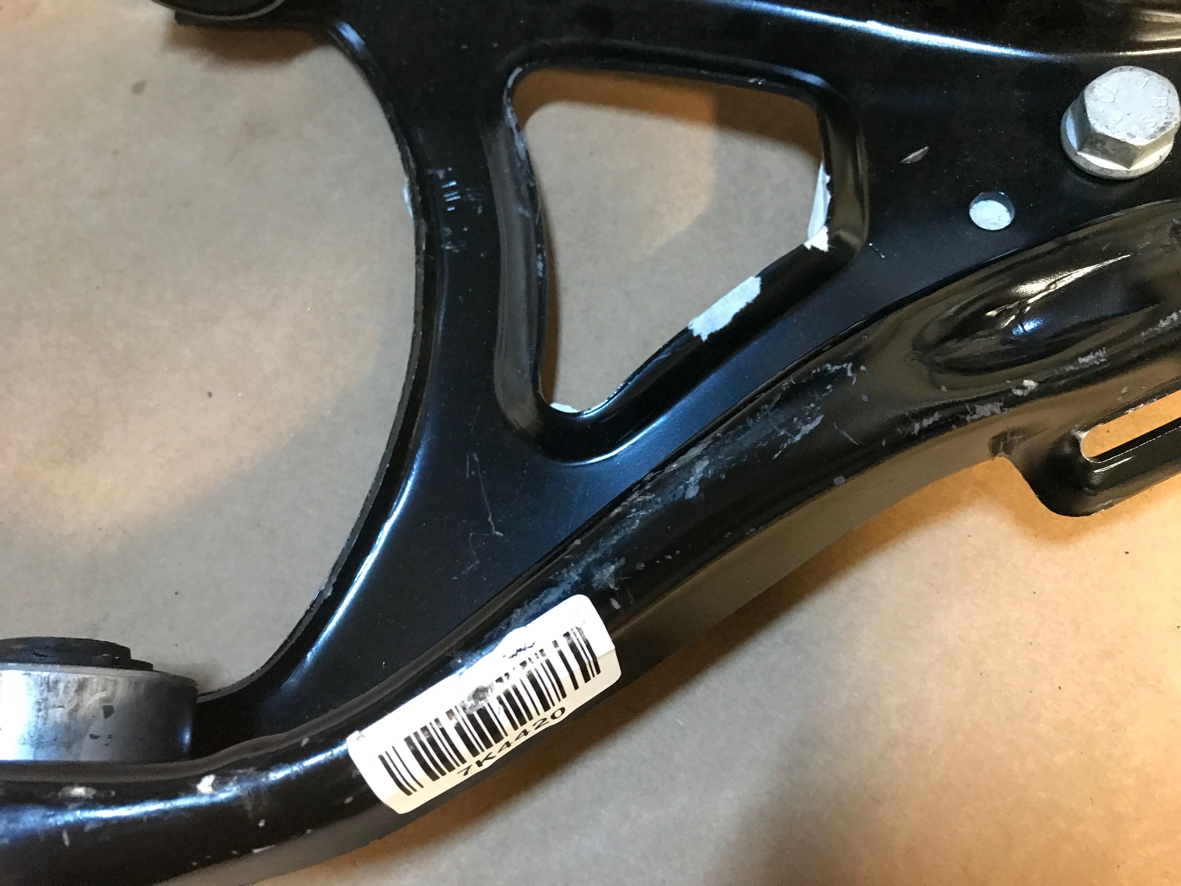

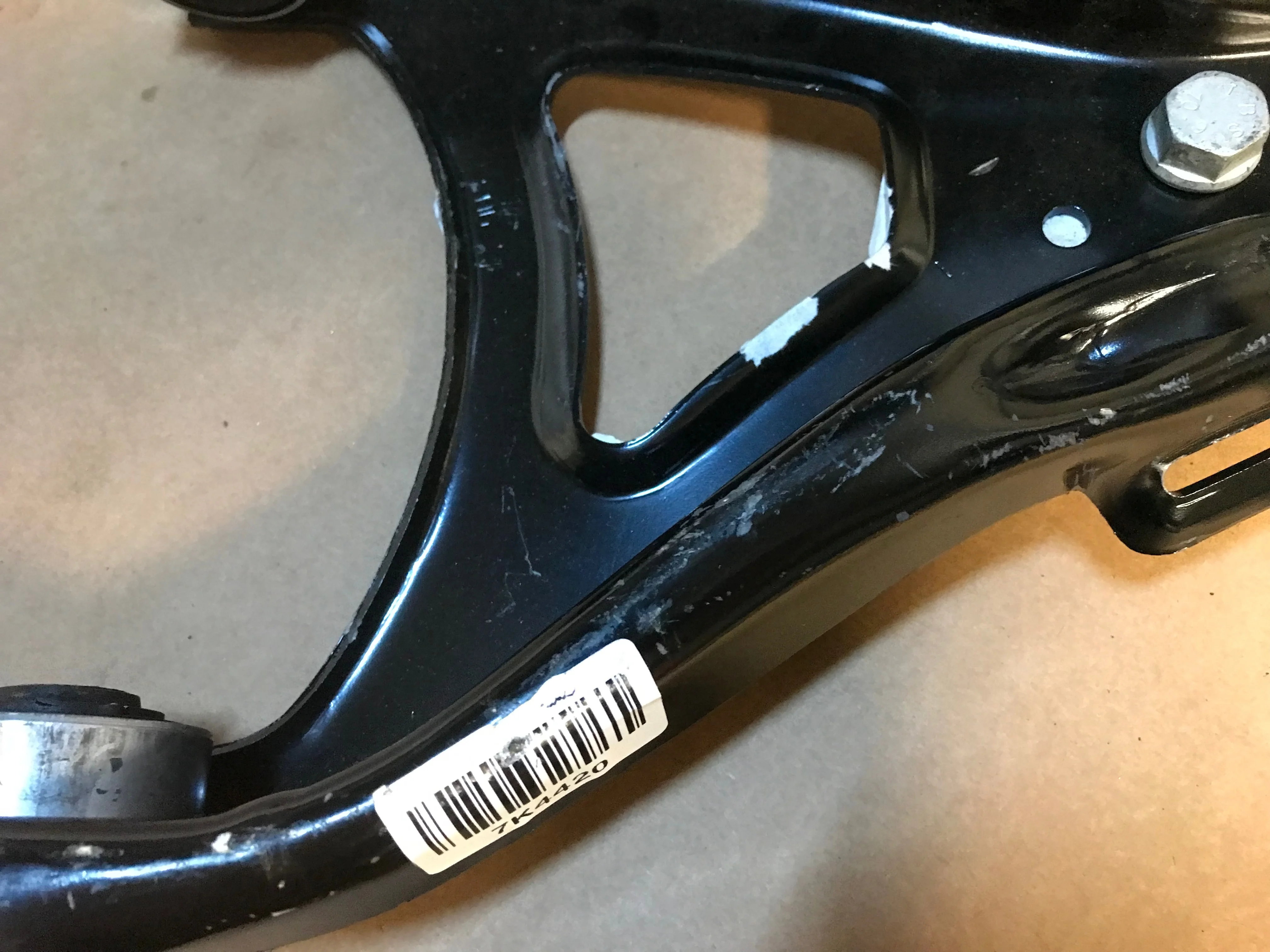

I also noticed the wishbones were newish but didn't look quite right. Contacted previous owner who confirmed they'd been replaced with aftermaket cheapo's from AZ Taz. Crikey, they're not even the right length. Might explain the vague steering.
Luckily for me i managed to get myself the very last set of genuine wishbones off Kevin at Kam racing. The drivers side was new but lots of marks on it, but i'm assured this is how they're stored at the warehouse and i don't have much choice unless i refurb some older ones.
So naturally the next plan is to whip all the aftermarket bits off the steering and suspension, replace the wishbones, brakes, discs, driveshaft, track rod ends, steering bushes, dampers etc then get a proper geo setup.

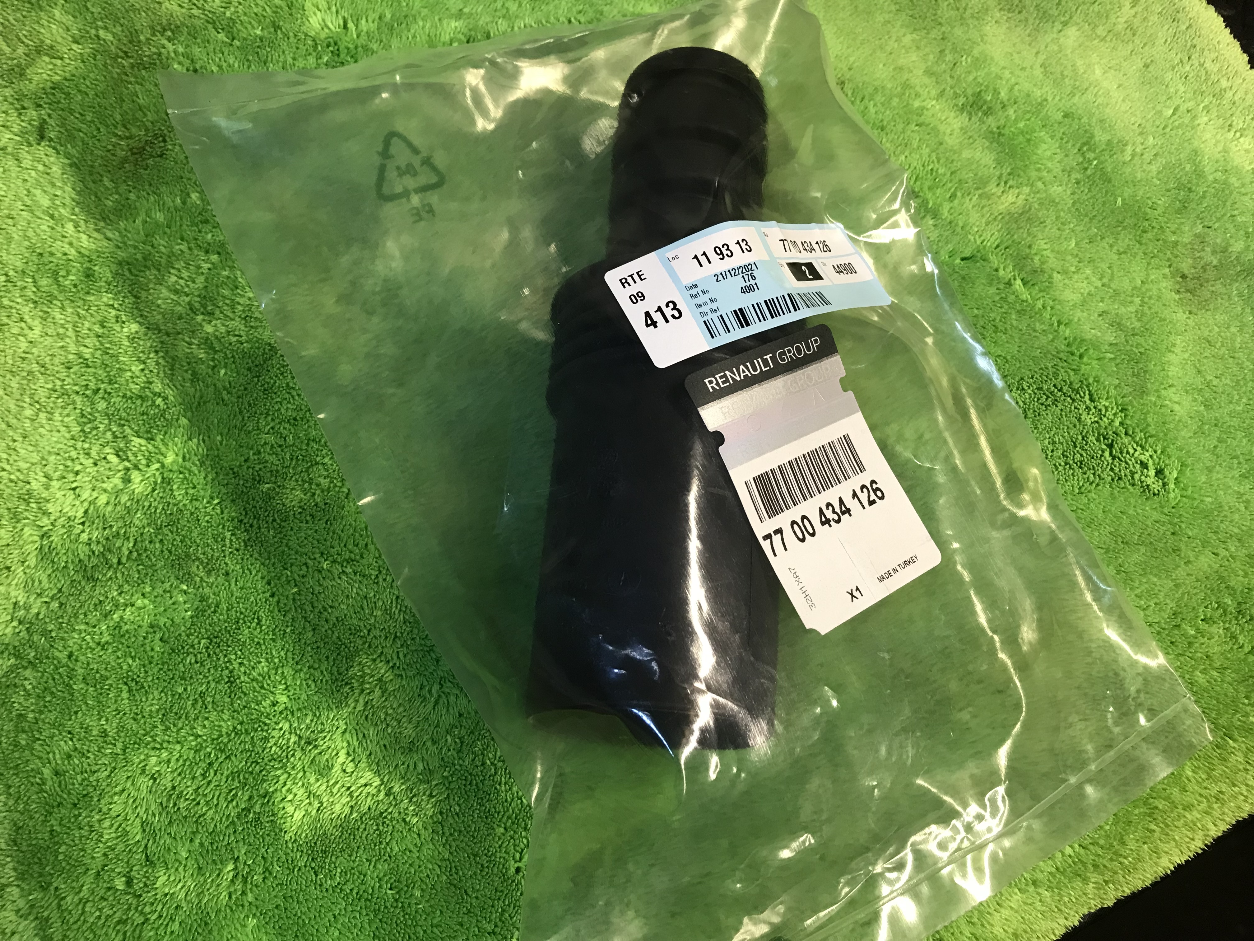

In between that i've been collecting a few small parts which were missing off the car. It's been really difficult getting hold of these items, or at least finding the right people motivated enough to send them out to me.
So a big thank you to Stuart Robinson, Russ Hopkins aka @DavidDave and BTT Motorsport for helping me out.

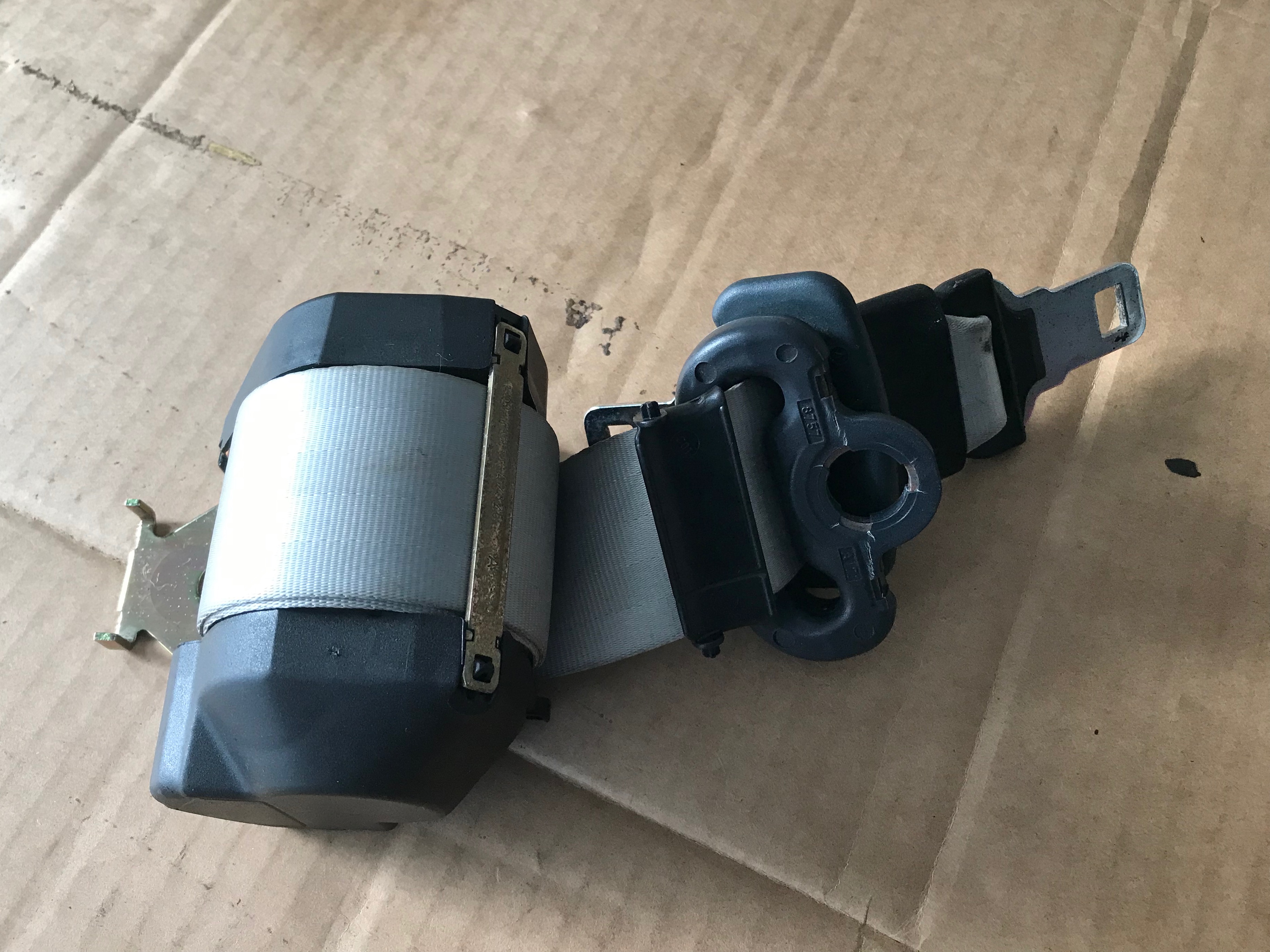

He supplied me with the rear seat bracket 👍

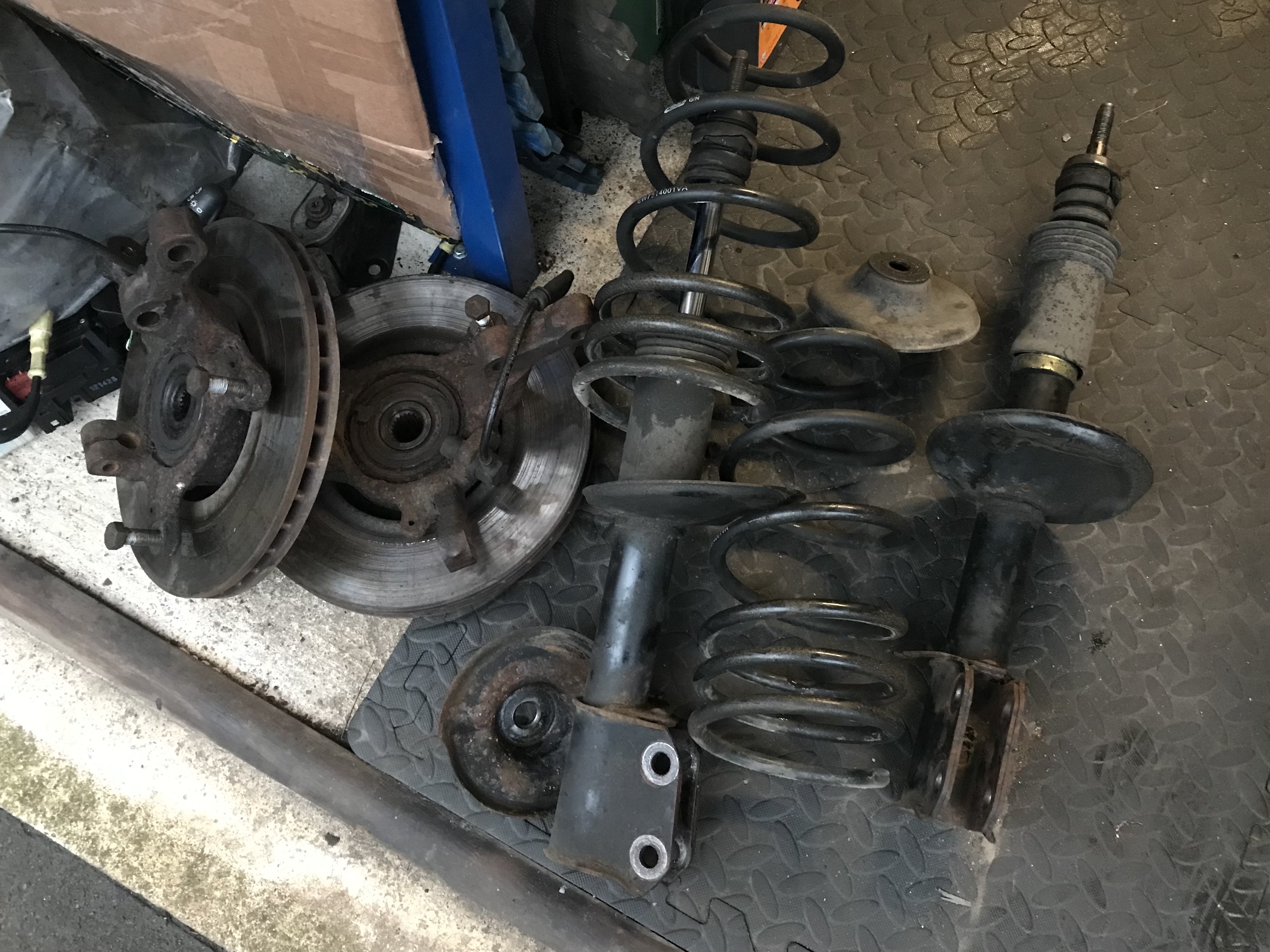

Began stripping out the suspension today. Everything came off pretty easily as I suspect the parts have been recently replaced in the last year or so.
I’ll be replacing pretty much everything with genuine parts and bolts, except the springs and hubs which I’ll refurbish.

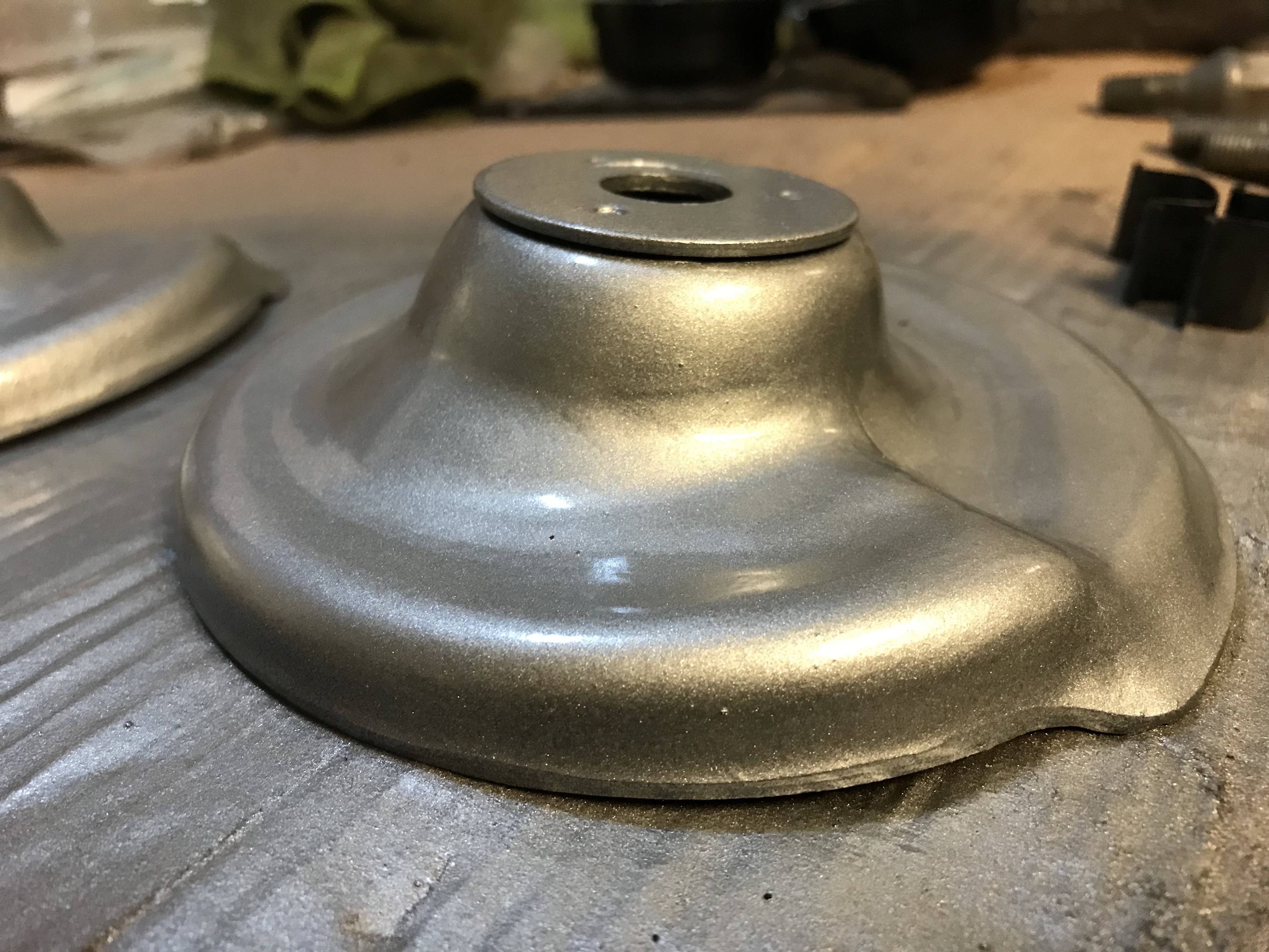

I was going to treat the top spring platforms with some gold passivate to get a factory finish, but sadly there was some pitting. Instead I mixed up some paint to give a goldish finish.

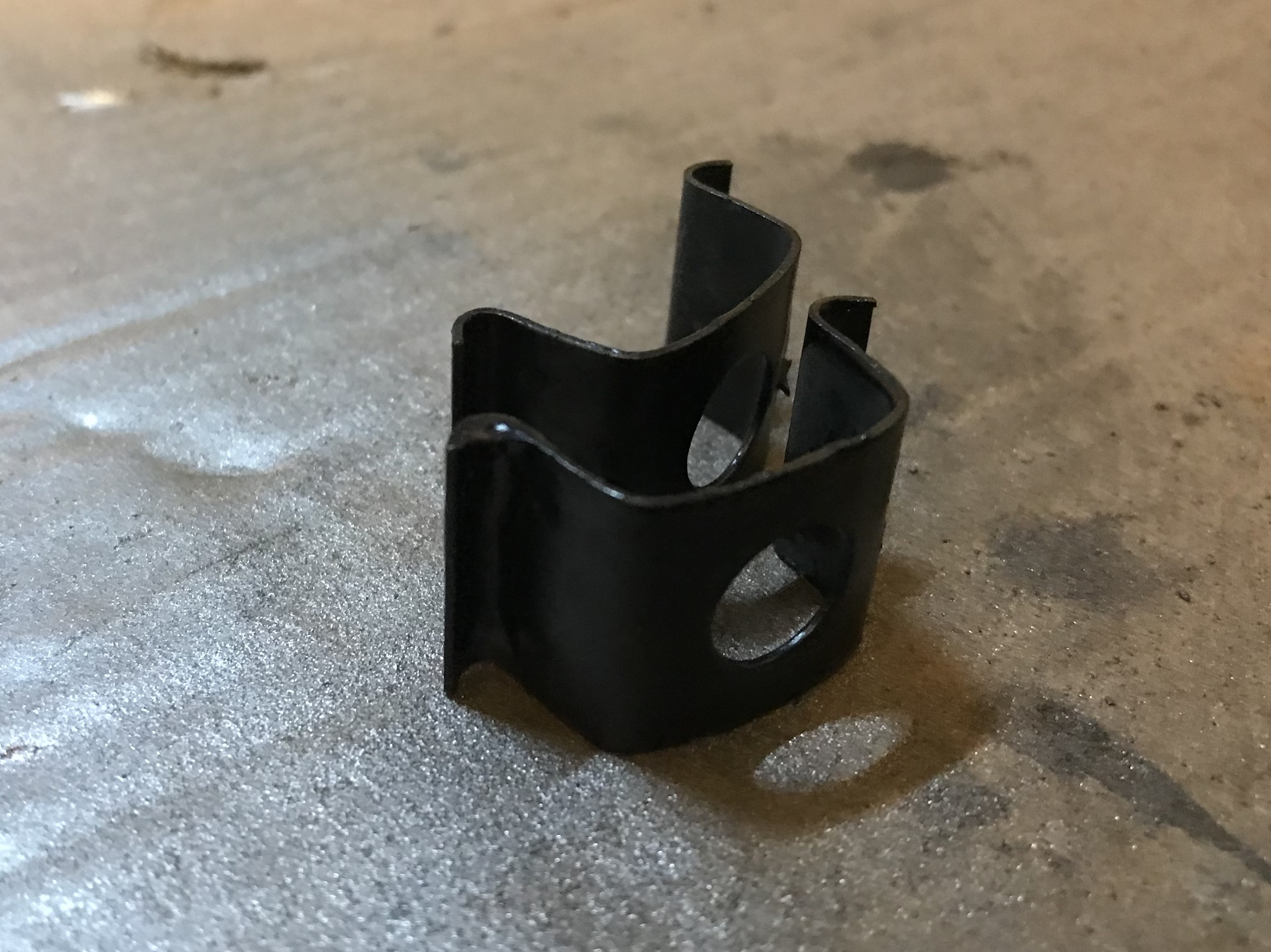

Even the brake pipe Clips get a bit of TLC 😊

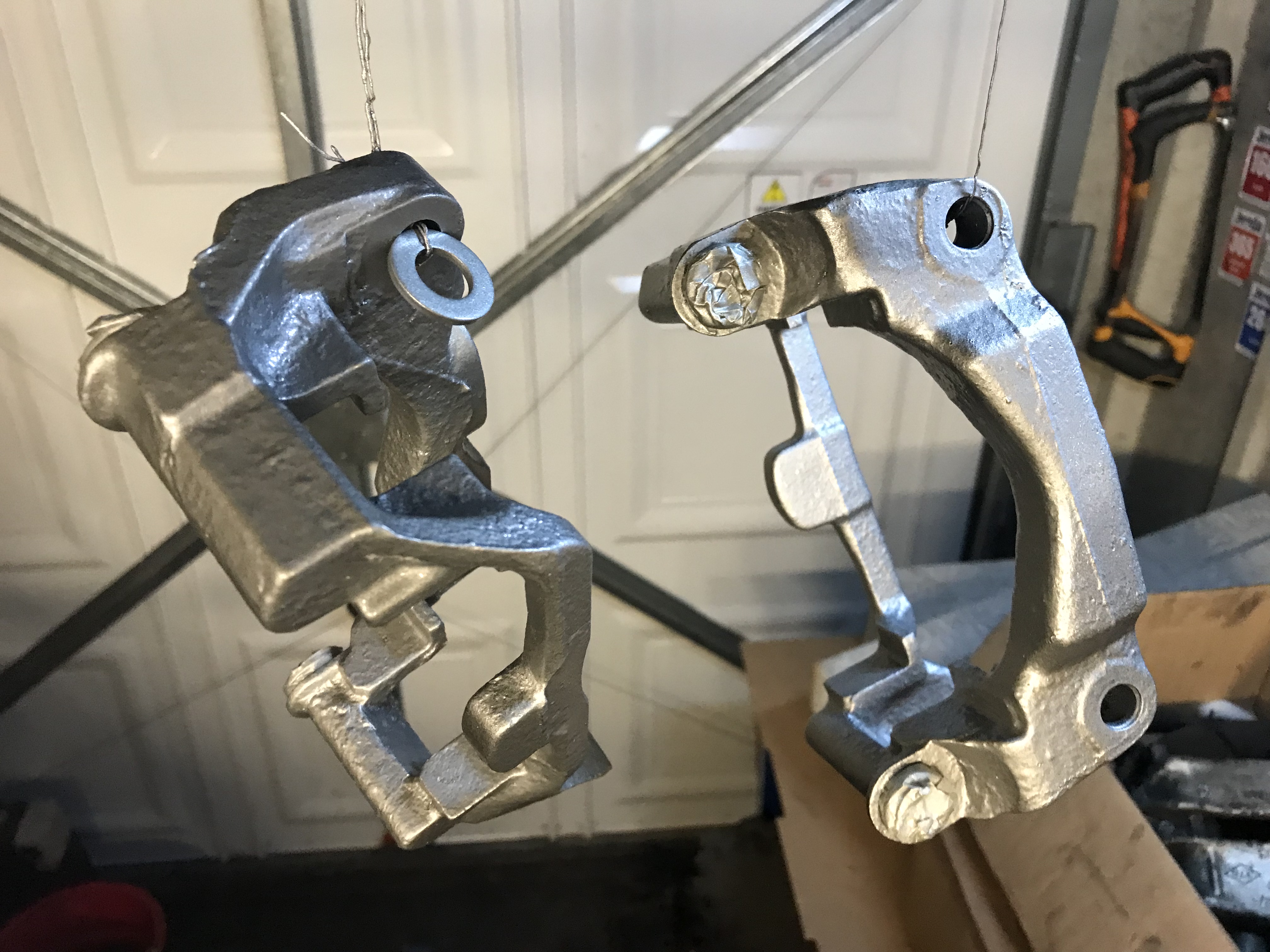

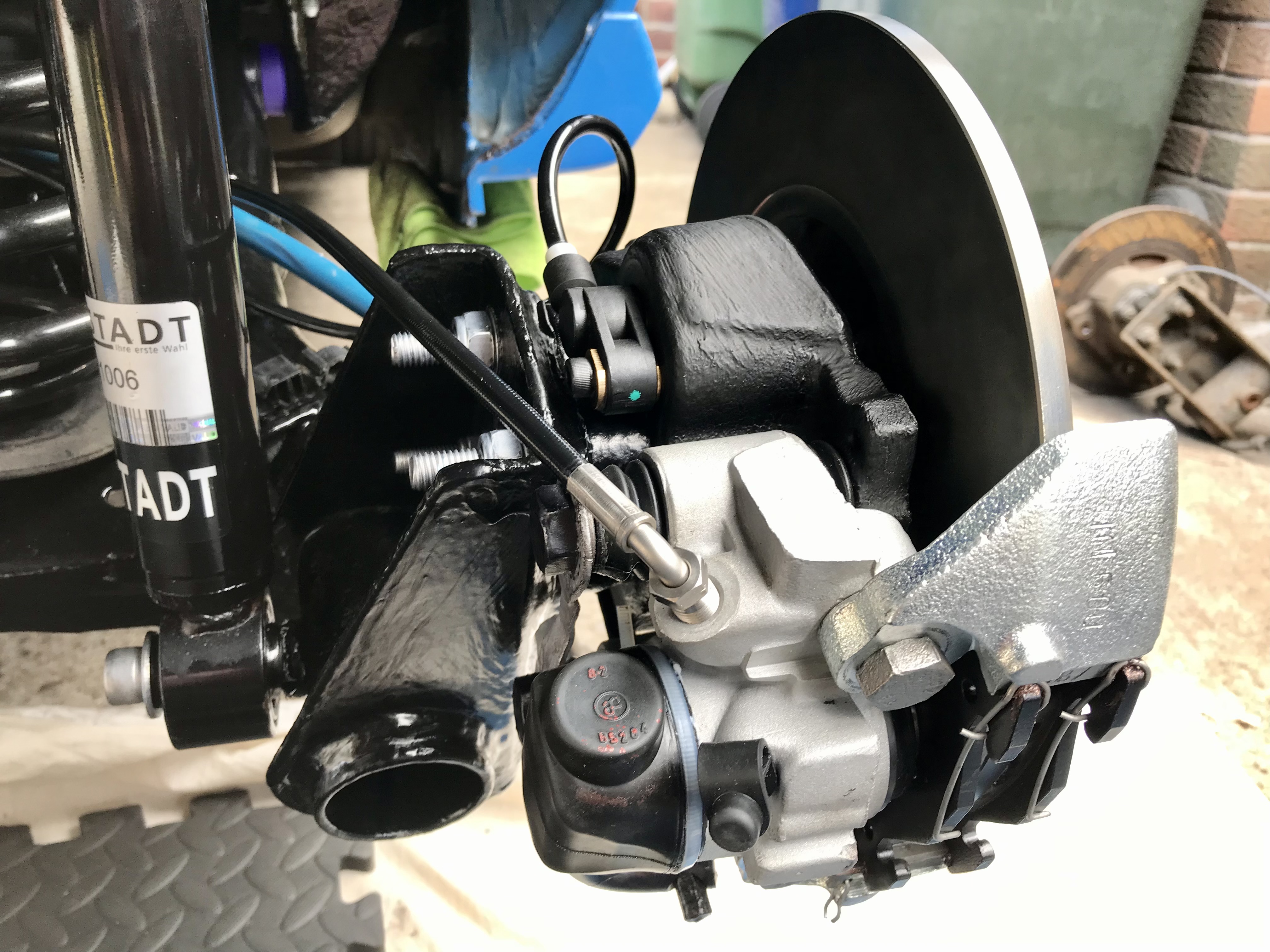

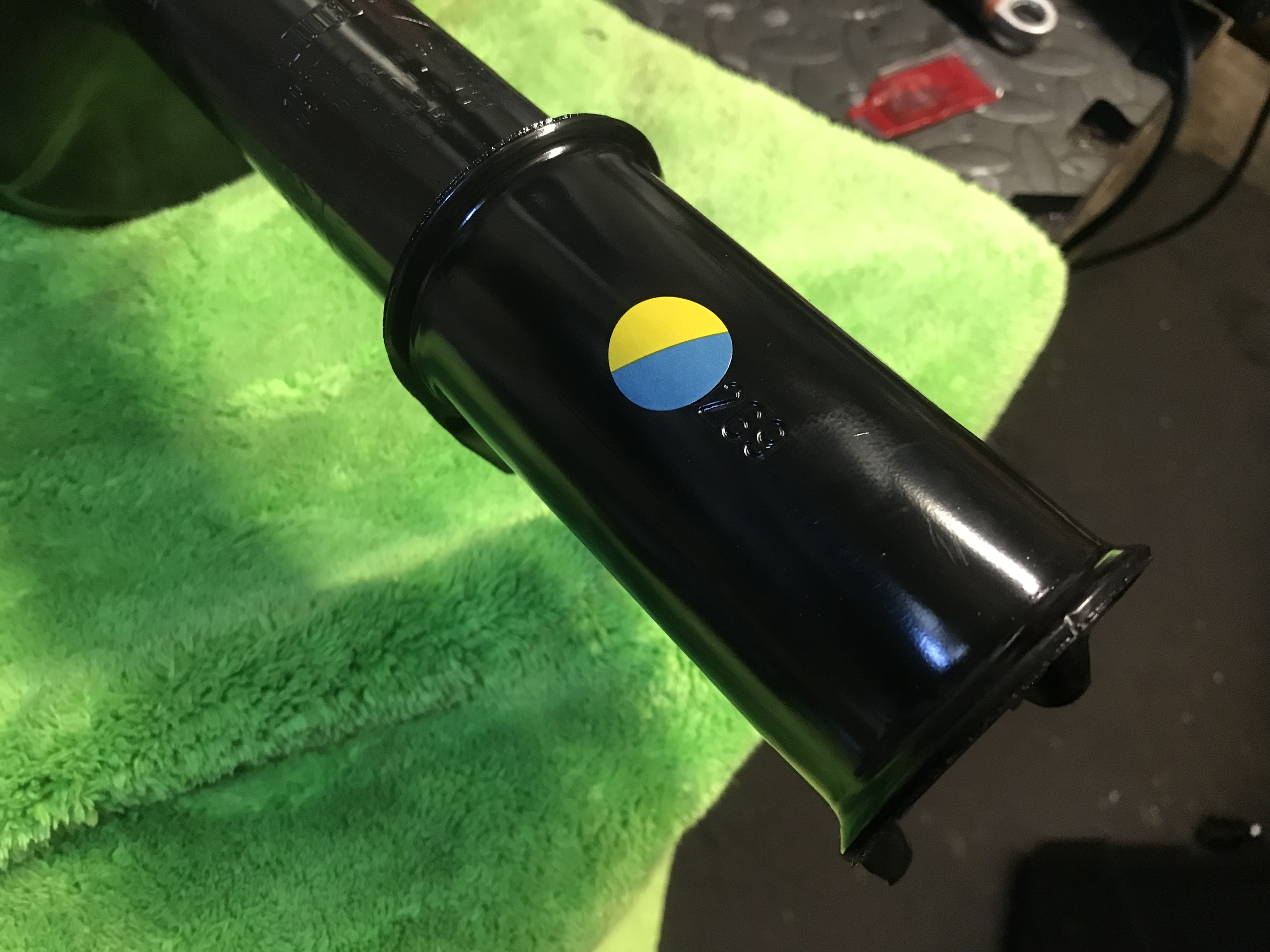

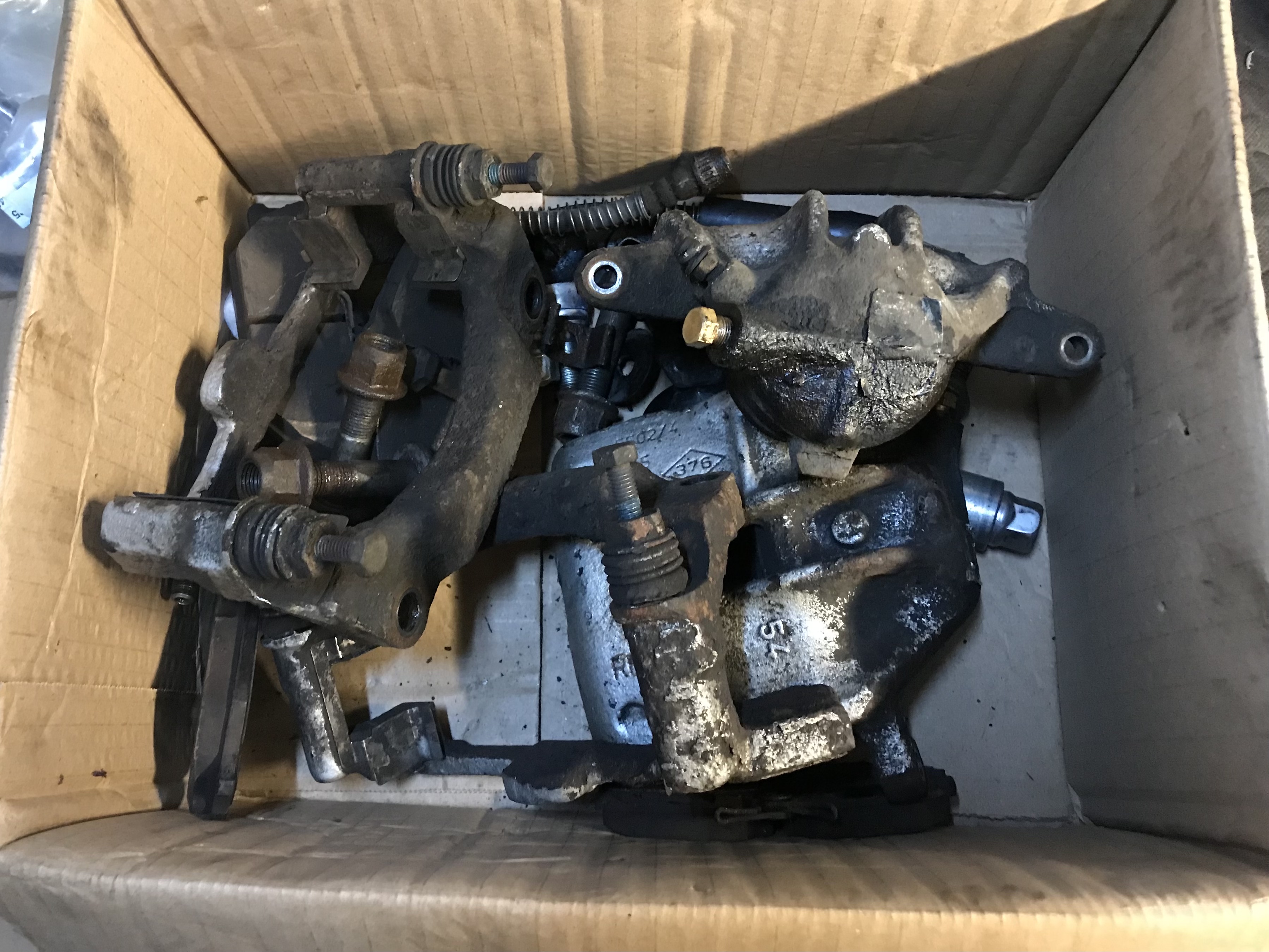

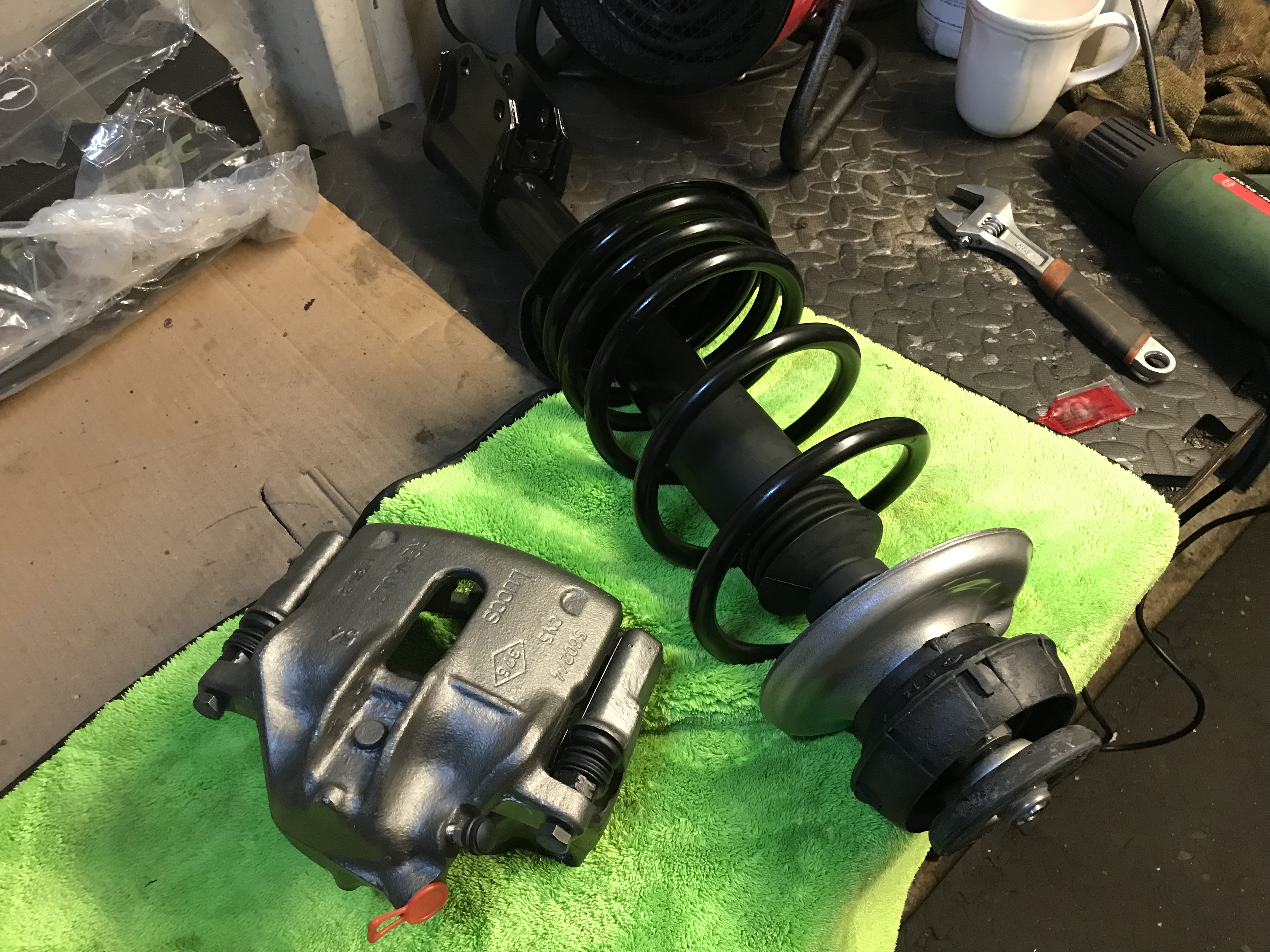

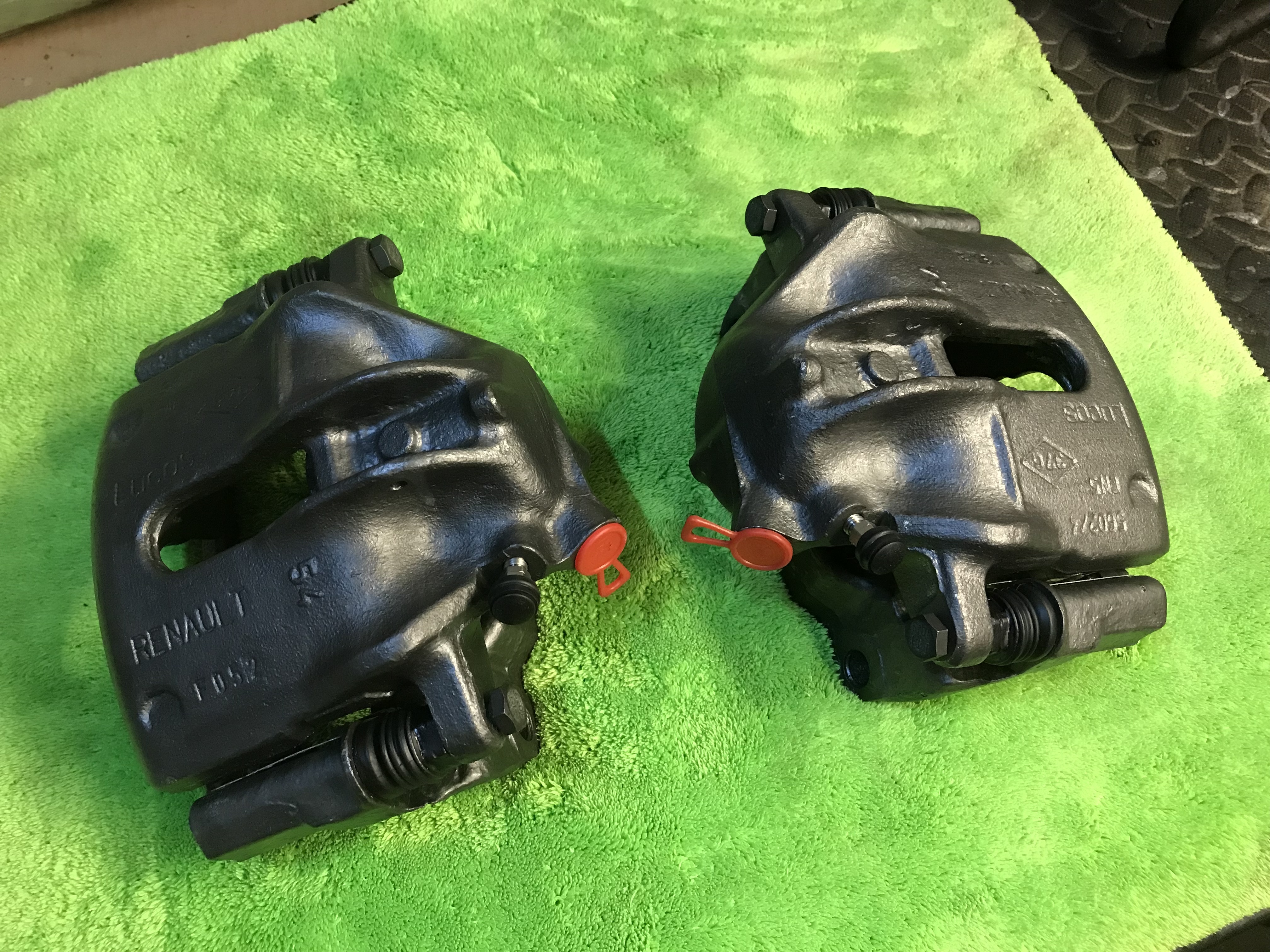

Started reassembling the front dampers and finished off the brake calipers.
Totally rebuilt the calipers with new seals, pistons, bolts and HEL stainless steel bleeders. Hate the factory ones as they’re so soft.
Gave the springs some anti-corrosion treatment, some extra layers of paint and then rebuilt the dampers.
All parts are new with genuine CUP dampers, gators, spacers and top mount kit.

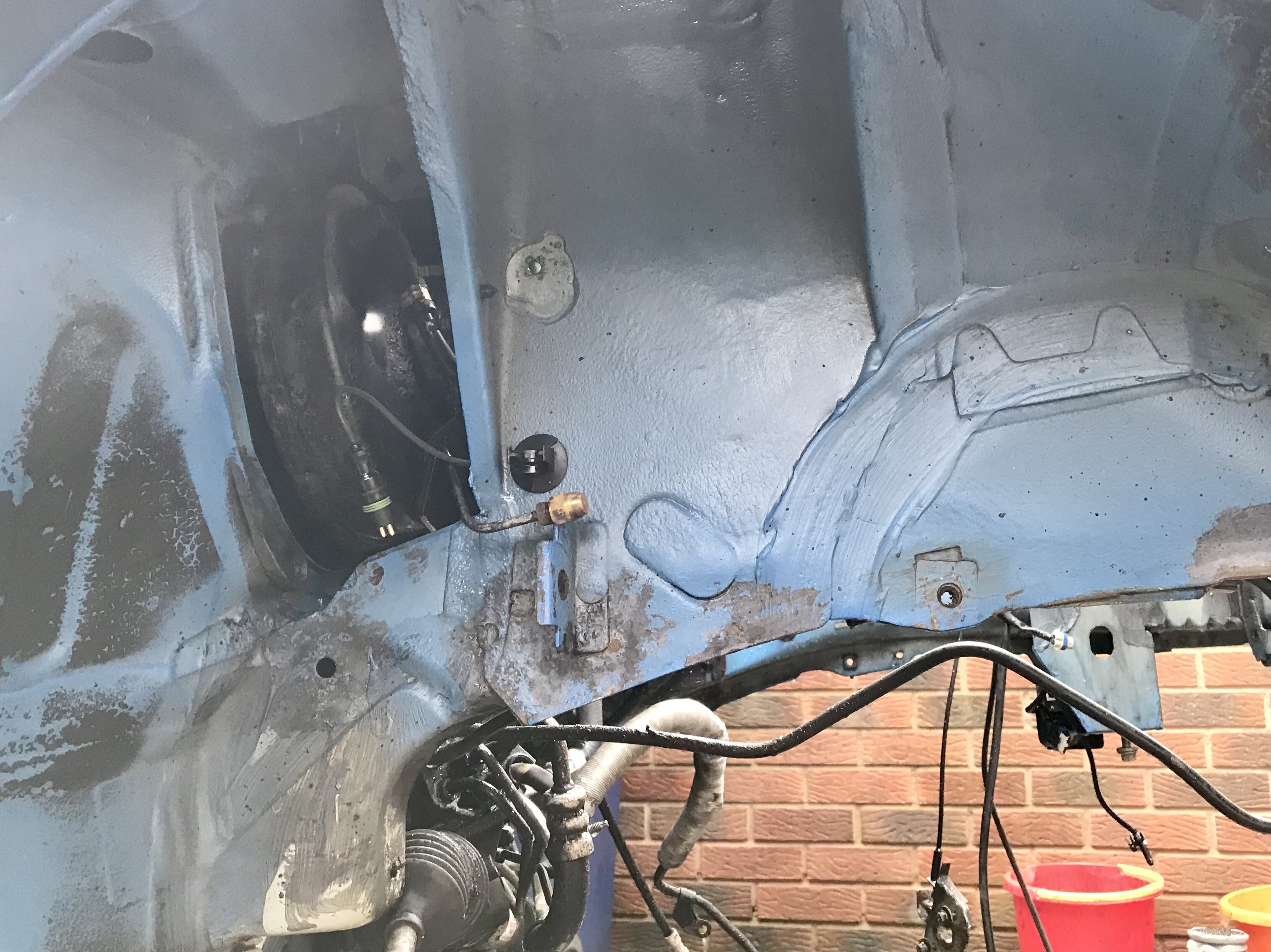

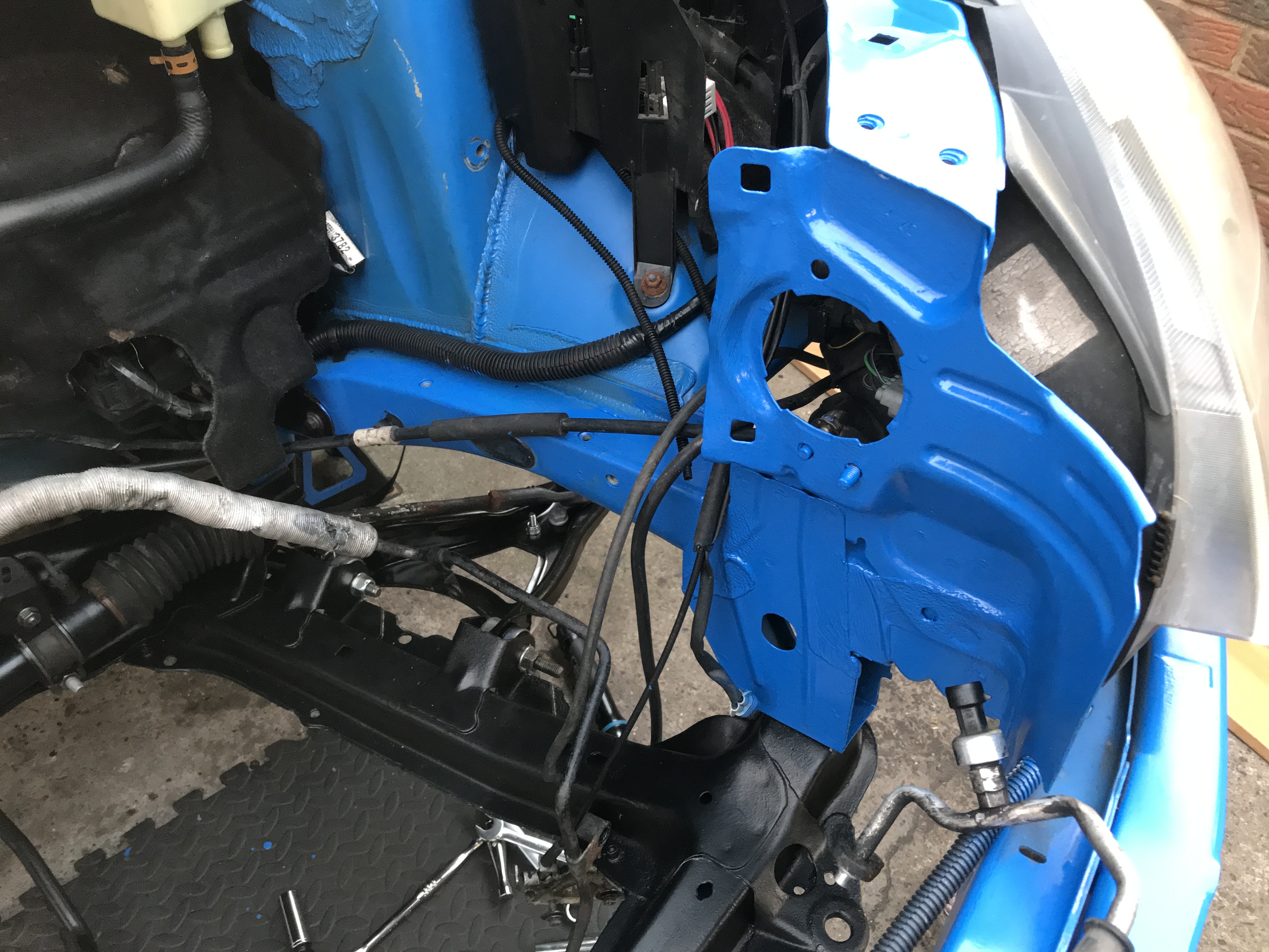

Took advantage of the balmy weather and set about removing the subframe. What a nightmare 🤦🏻‍♂️
One thing I’ve learned about this car is the real reason the previous owner sold it. Now’t to do with “needing the space” or “got too many cars”. More like I’ve tried to fix it on the cheap and I’m now out of my depth 😂

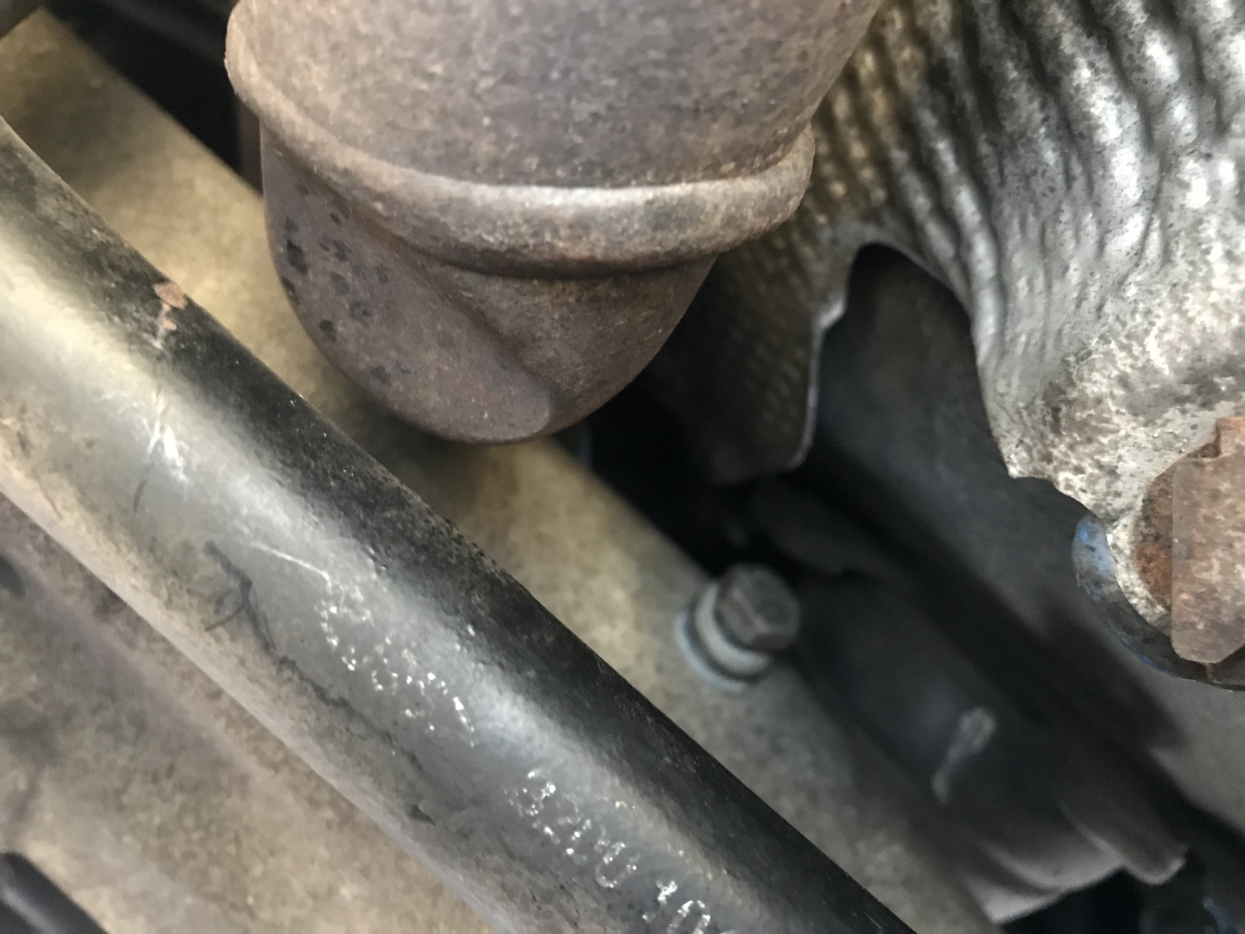

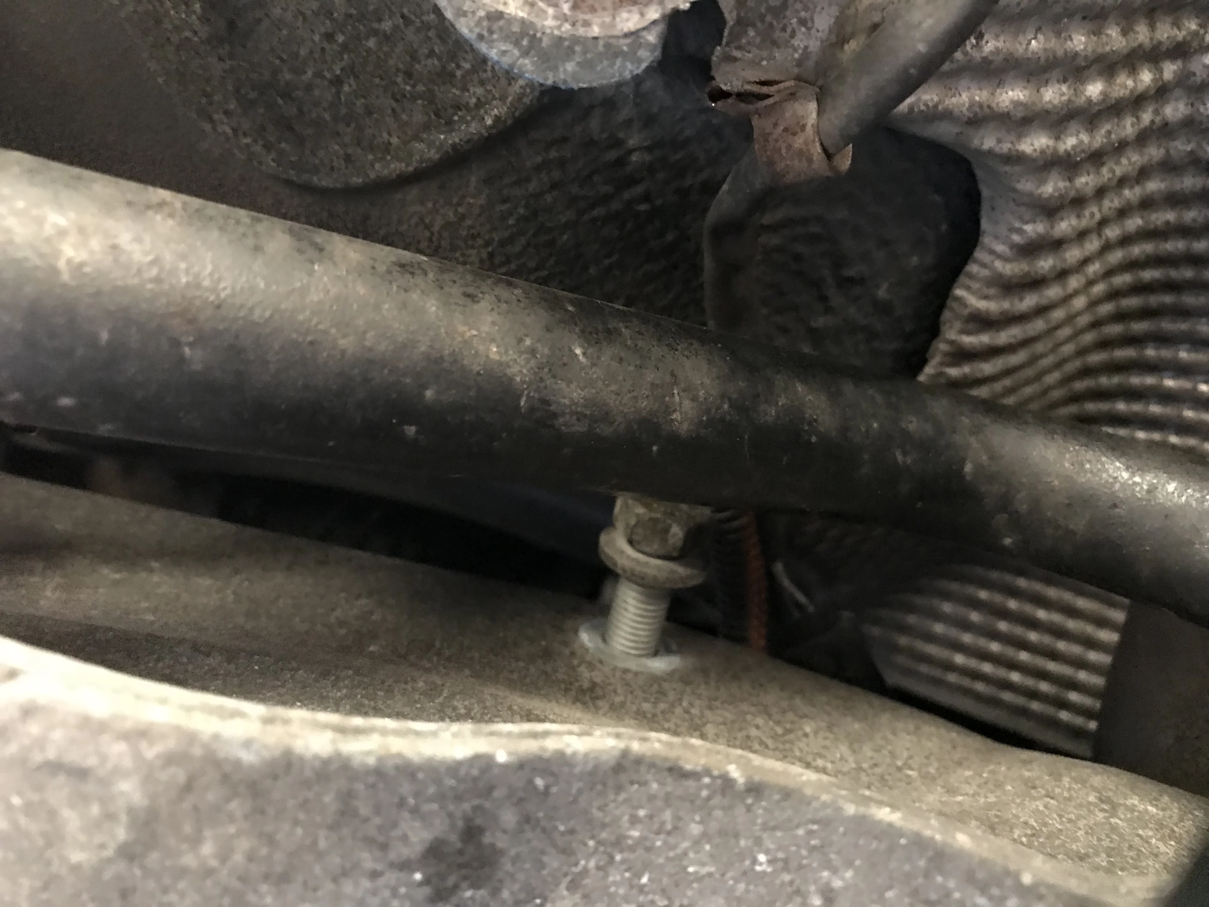

Bodge alert - so the two bottom photos are what I saw when I got underneath to look at the subframe.
The 2 upper bolts on the steering rack, both cross threaded, not all the way in but very tight. The lower bolts weren’t exactly tight either. Probably explains the knocking sound, along with the dodgy driveshaft 🤨 Can’t believe he’s been driving this car on the road 🤦🏻‍♂️
Anyway, got the bolts out then went on to remove the 3 bolts from the heat shield below the manifold. I normally leave the steering rack hanging so needed these out first.

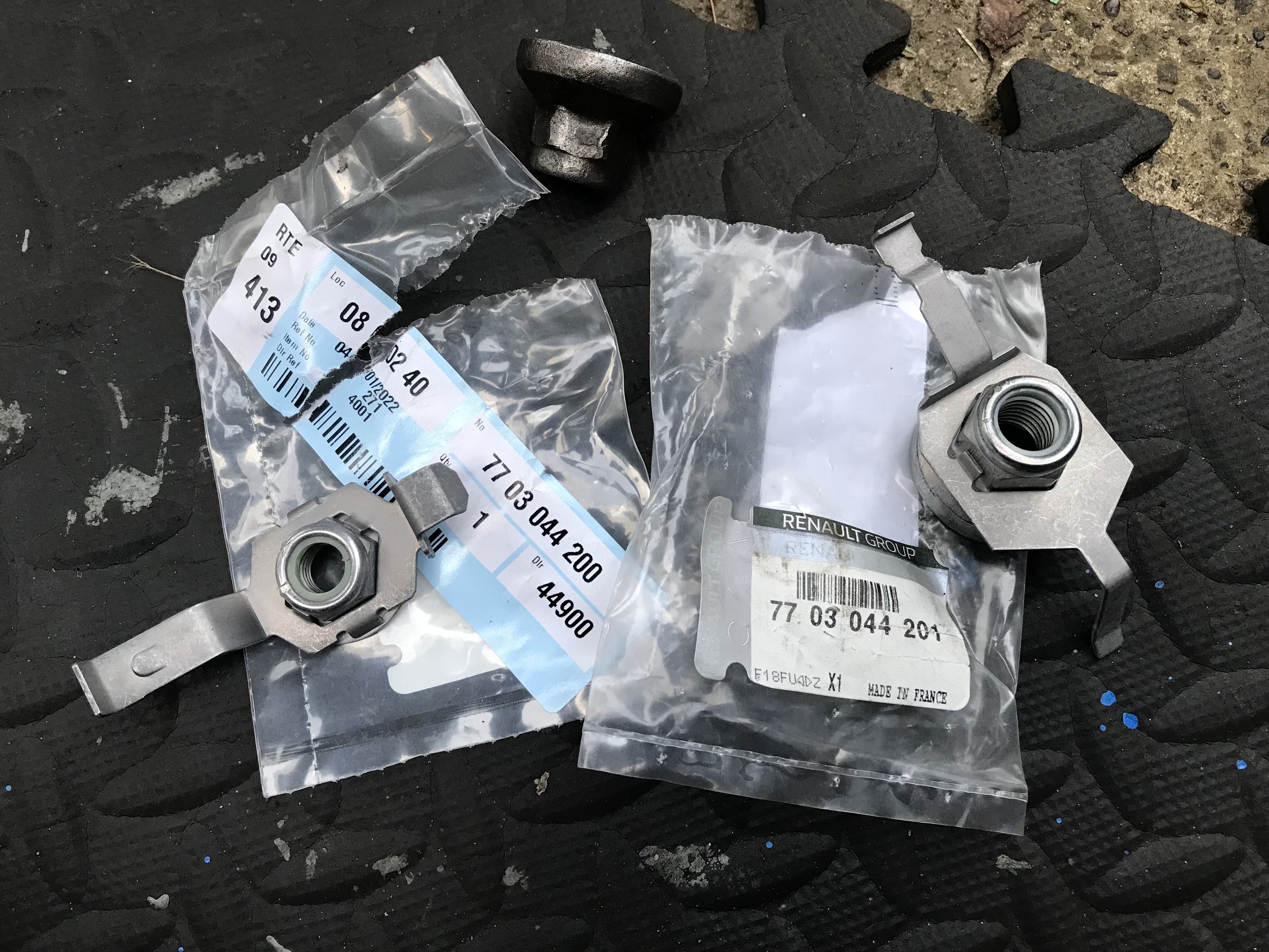

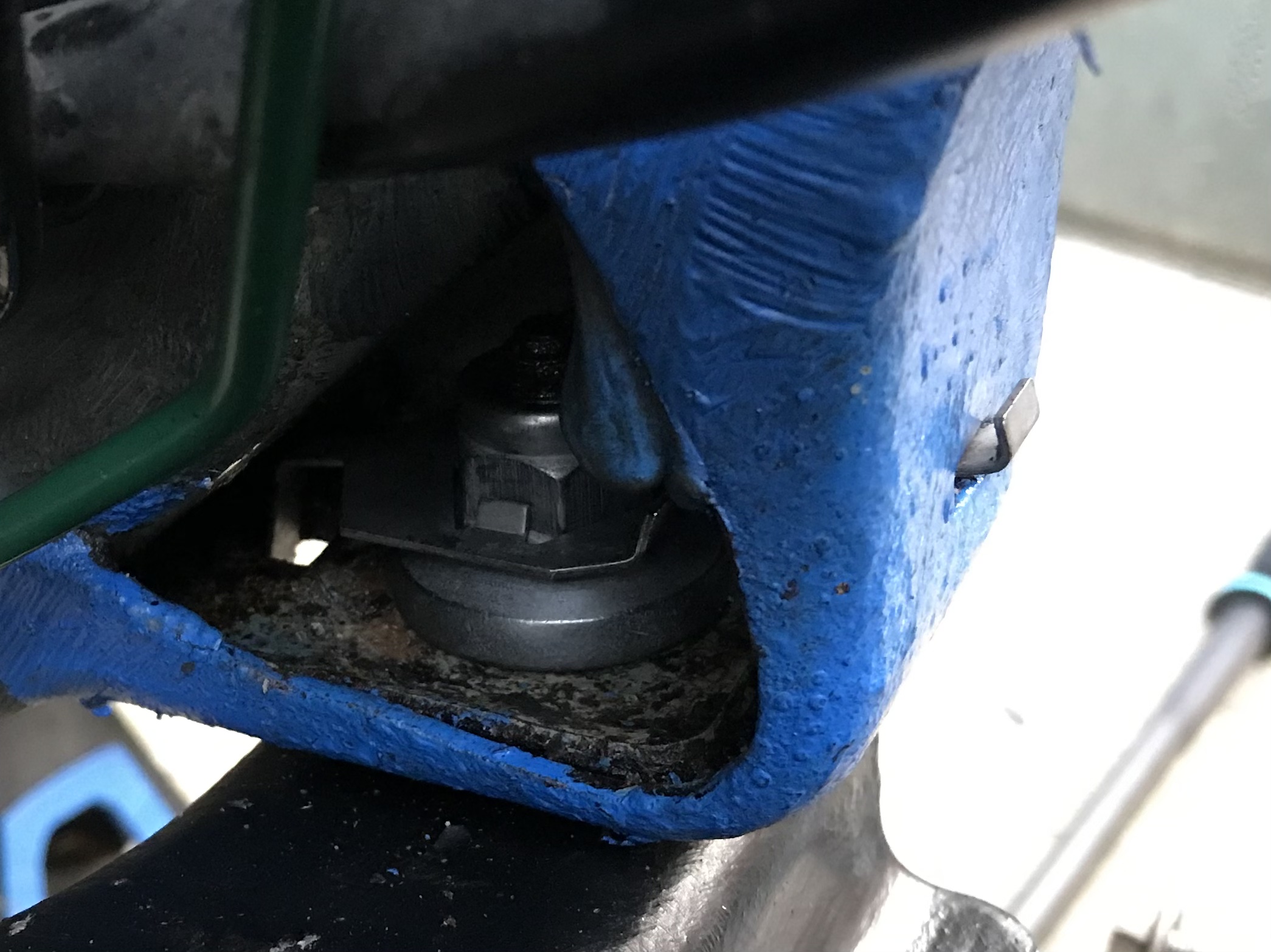

Got those out then went to remove the subframe bolts and both rear nut cages were missing, meaning the bolts were spinning 😵‍💫

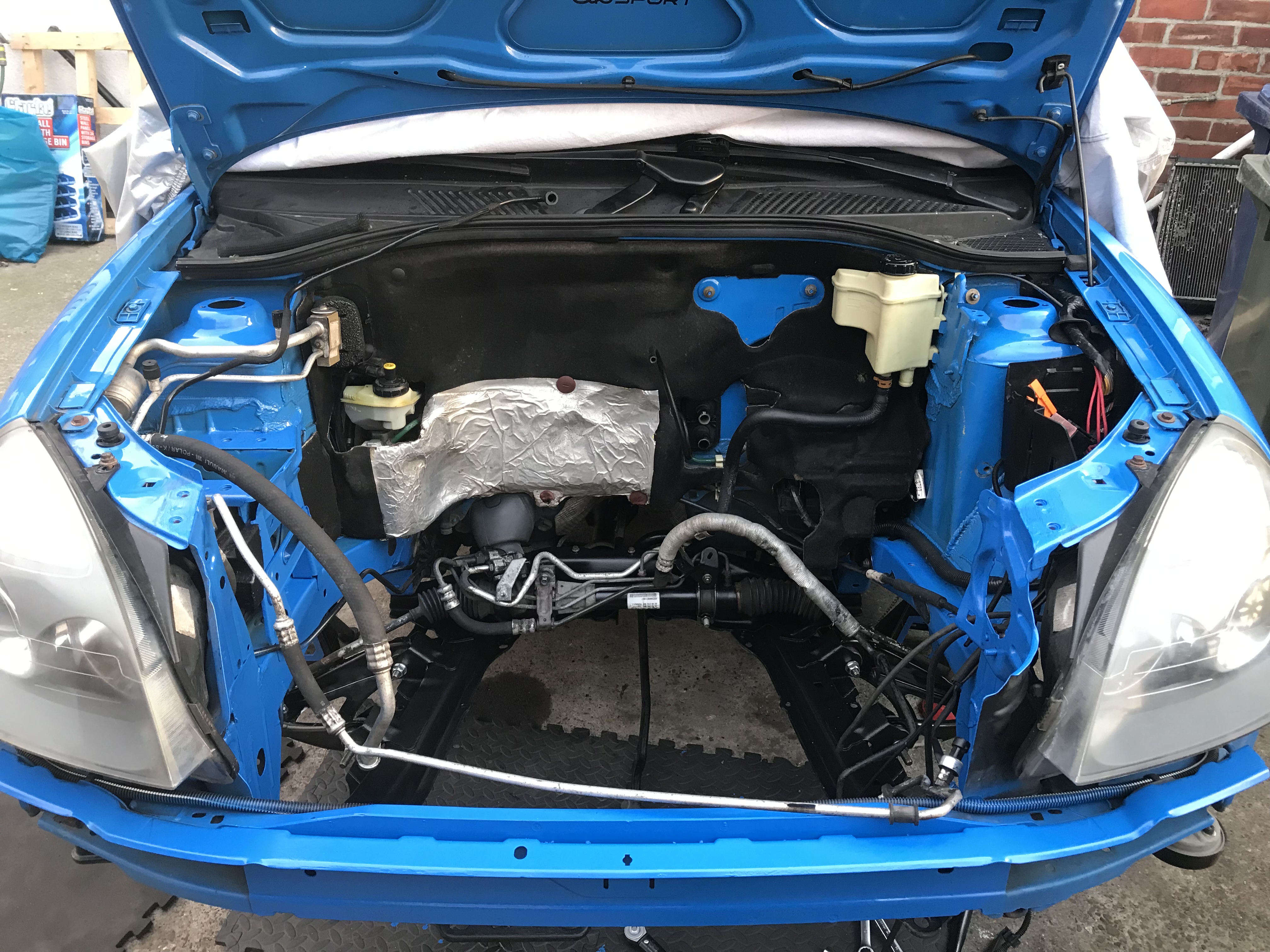

As I’m now going to have to take the steering rack out now to re-thread, I thought fook it, Engine out 😂
Followed by the subframe.

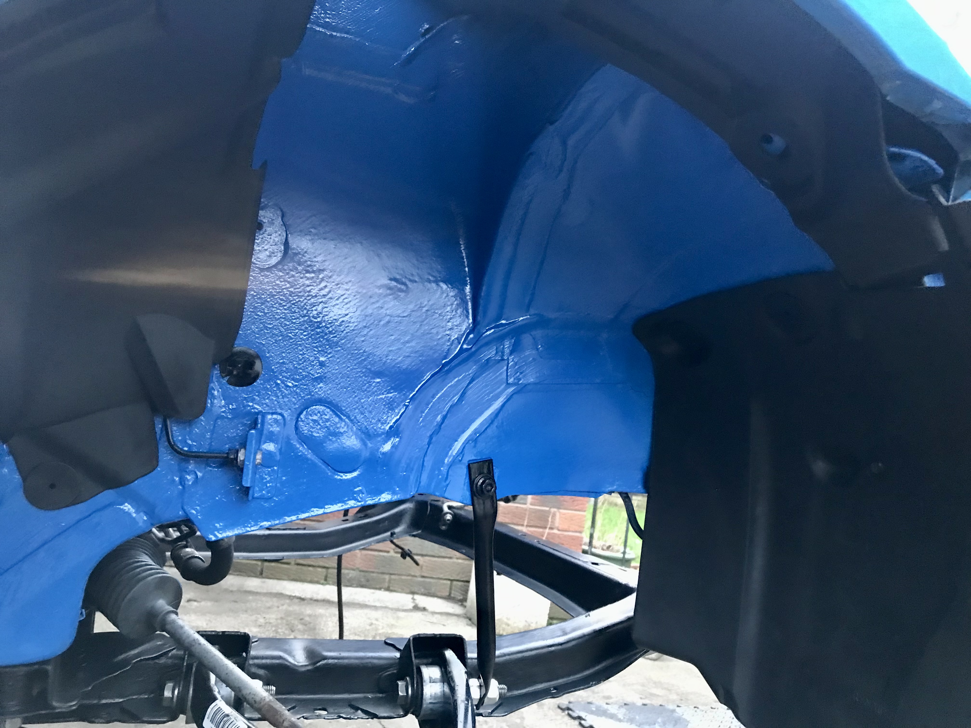

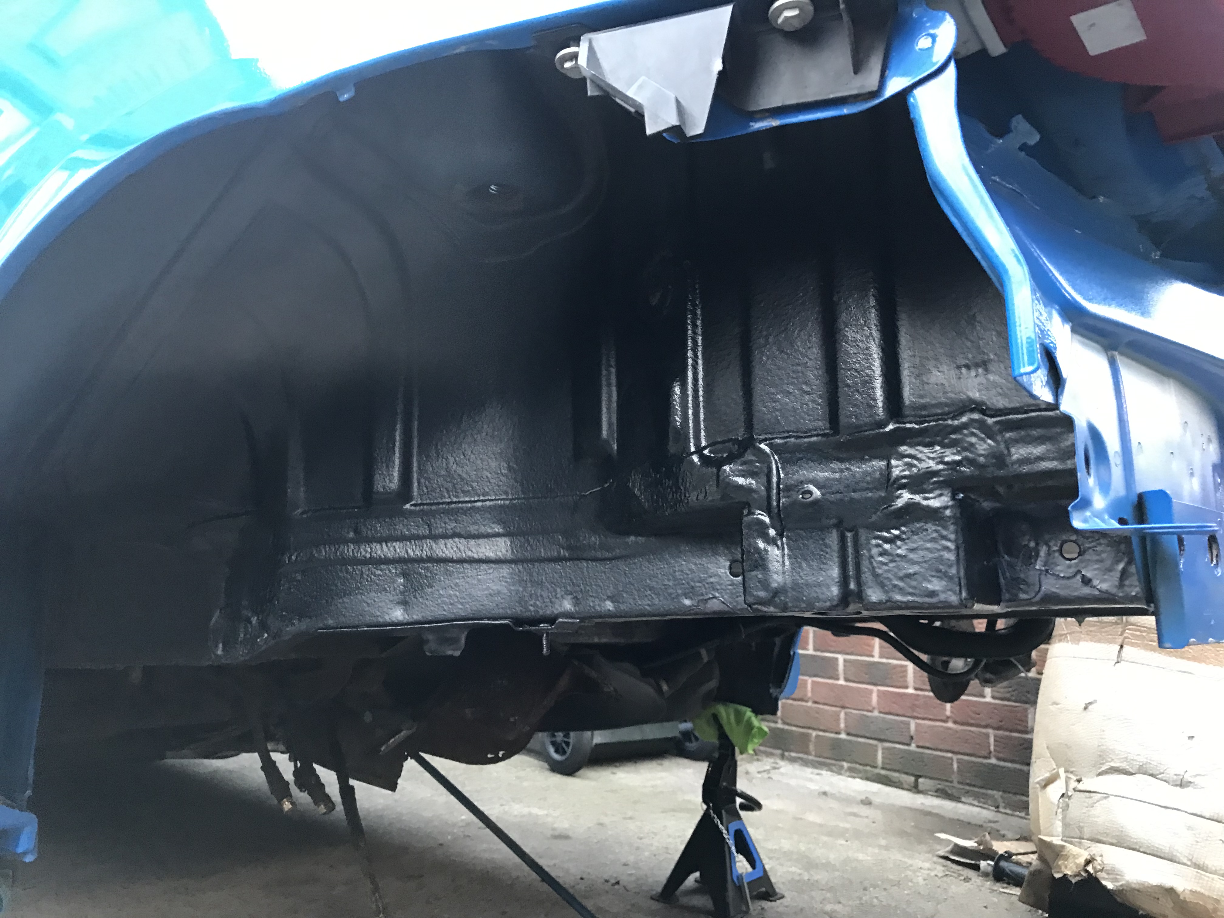

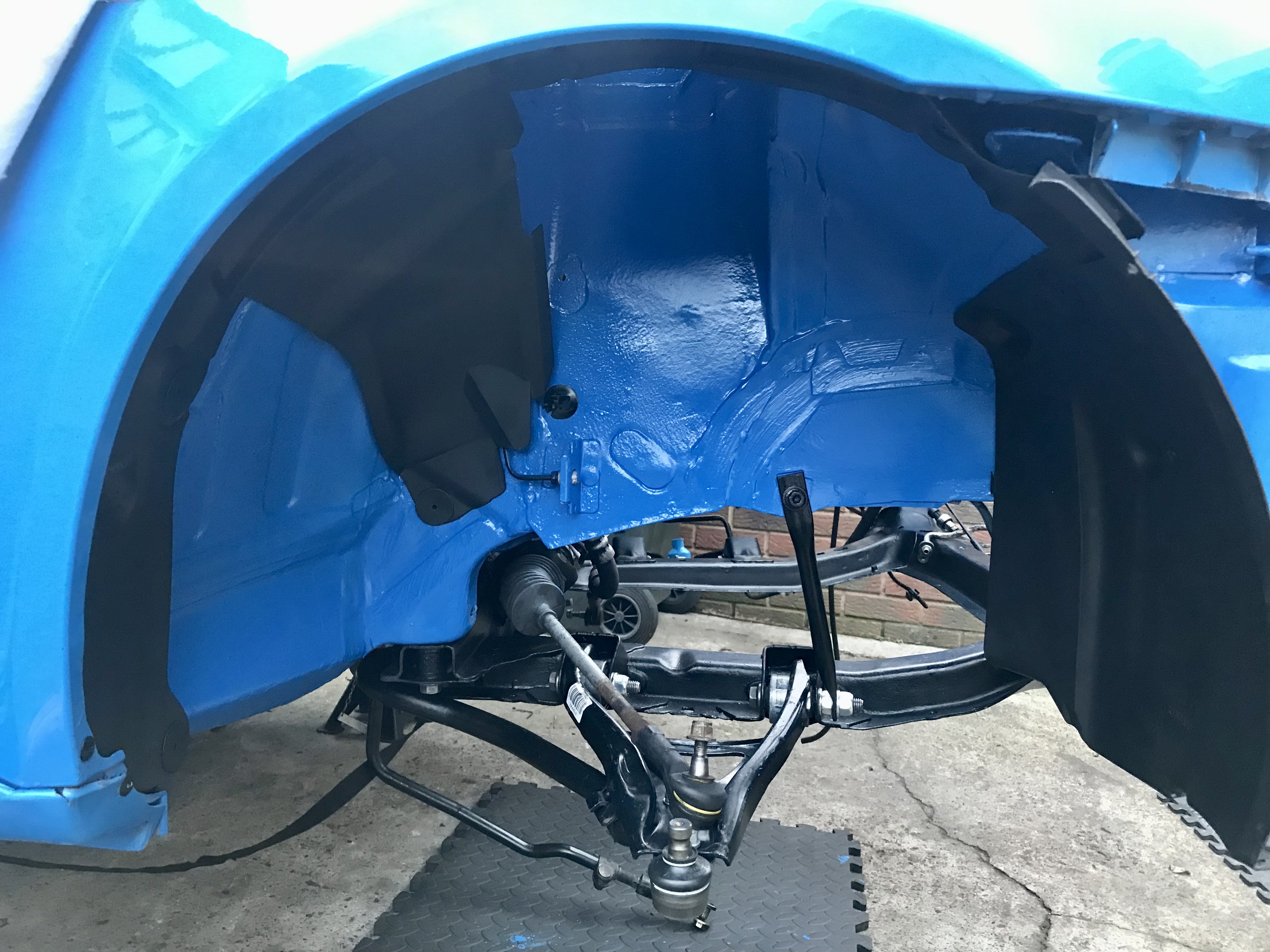

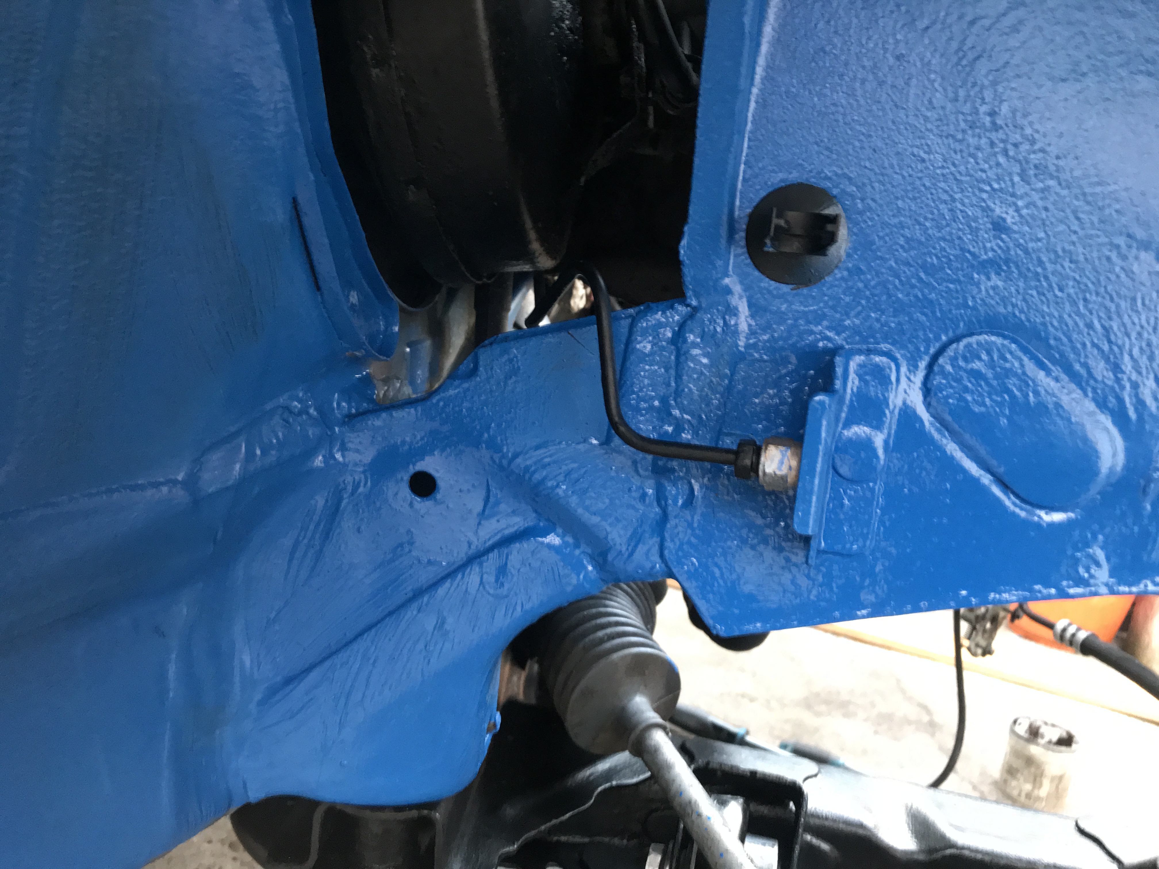

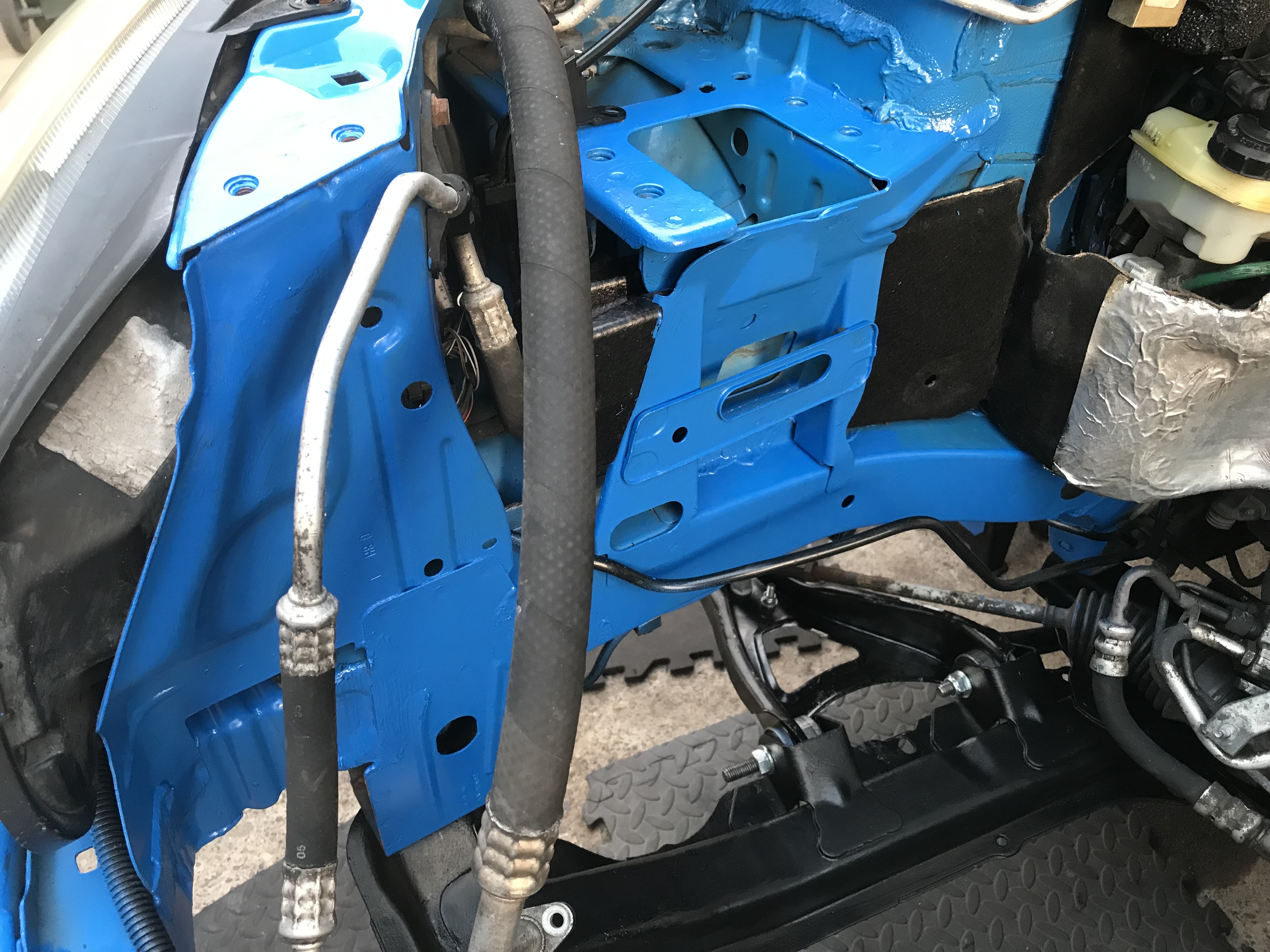

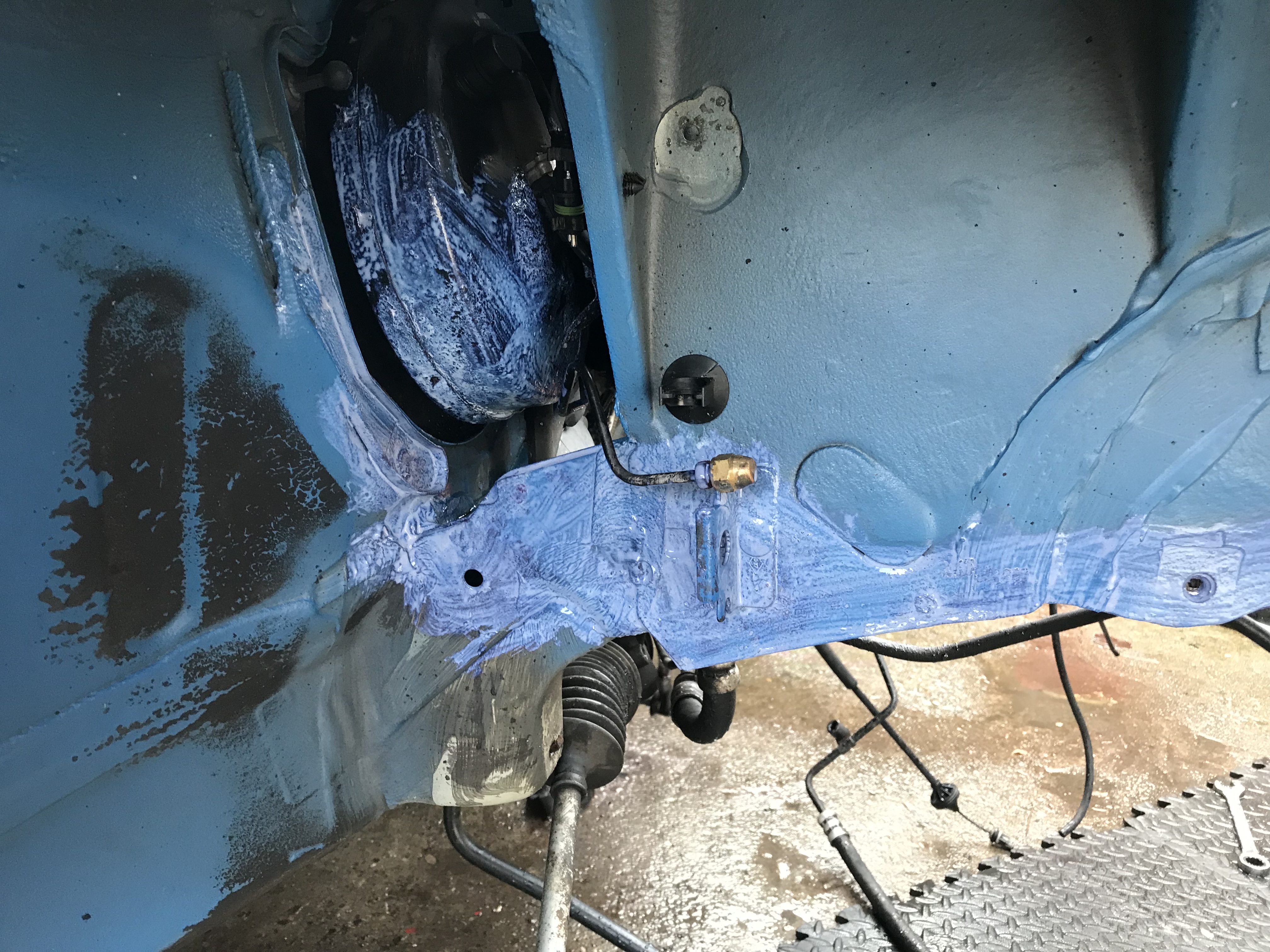

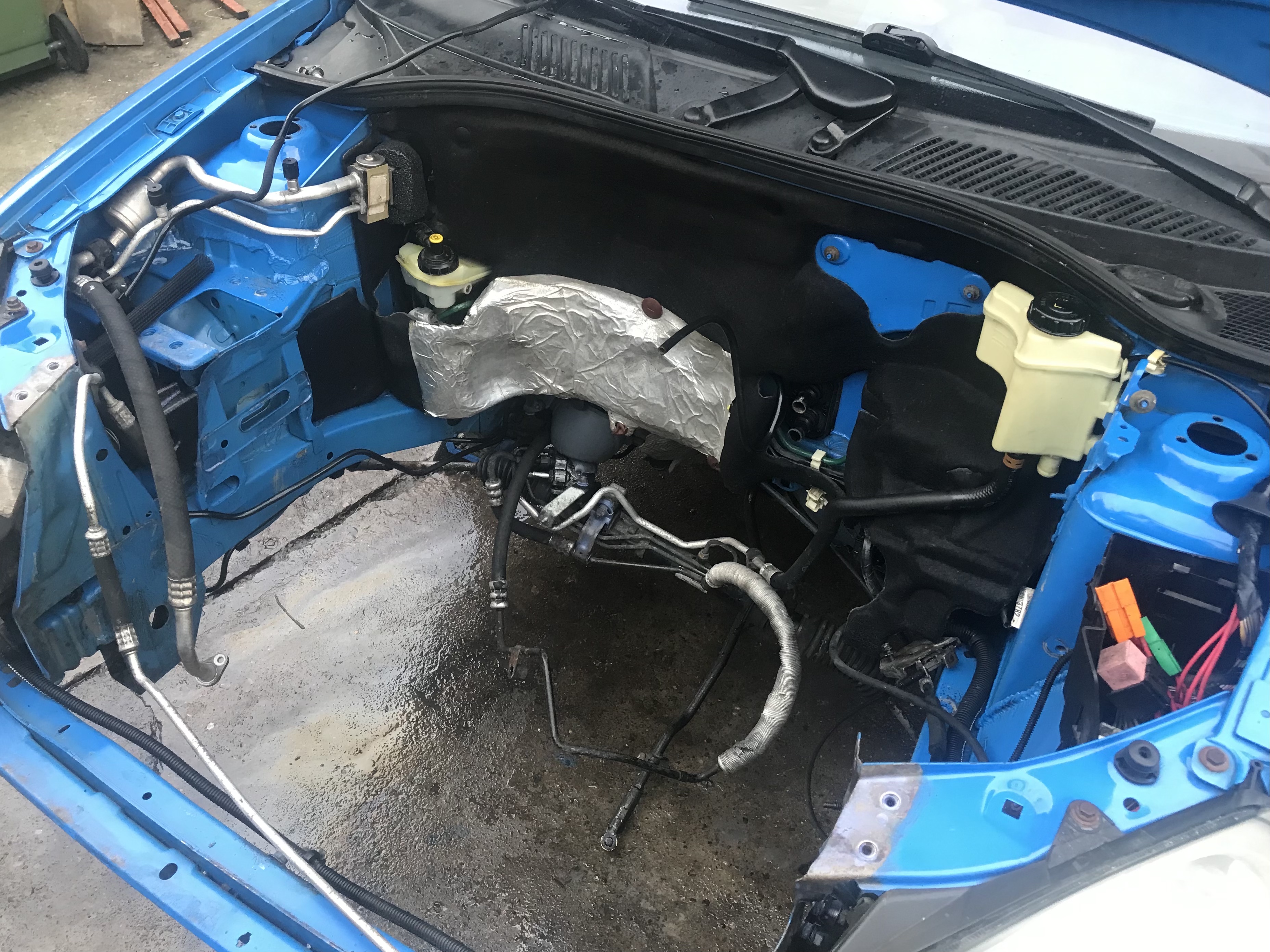

Engine bay’s not too bad thank god and there’s not a lot of rust under the arches either.
Just the usual bubbles around the wishbone stabiliser and where the brake pipes attach, although none on the other side which is good to know.
Gave those areas a good coating with Hydrate-80, then I’ll primer it up with B&H Electrox, then paint in Racing Blue when
Haven’t really had a good look over the engine yet but I’ll tidy it up for the winter, then take it out again in the summer and give the parts a good refurb.

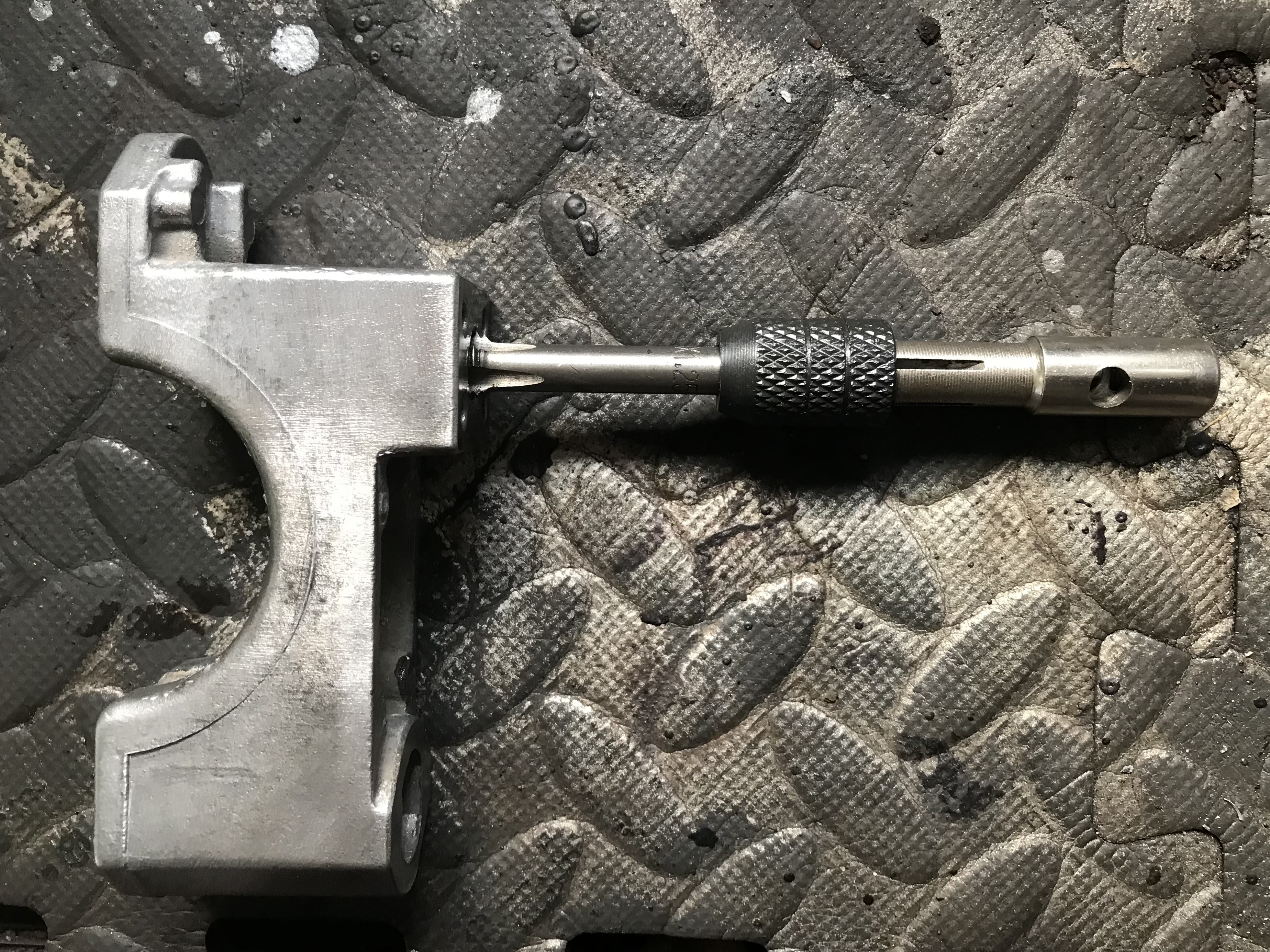

Quite a productive couple of days on the RB starting with the steering rack brackets and sorting through some bolts.
This is the direction the upper bolt which goes into the steering rack bracket was going. Obviously forced during previous assembly as room ipretty tight under there.
Easy fix with an M8 1.25mm tap to re-thread.
Job done!

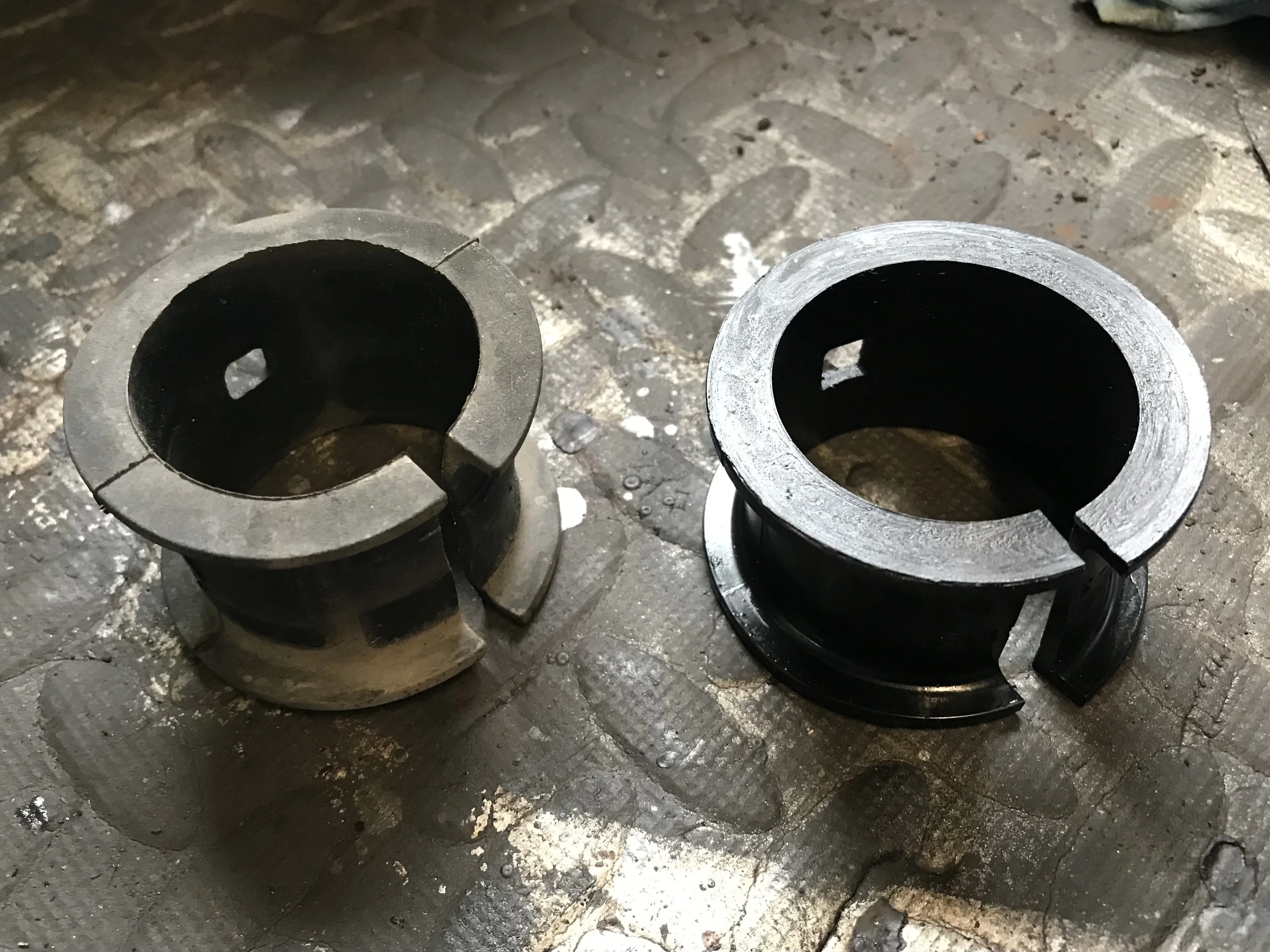

Steering rack bushes looked in decent condition but I changed them anyway.
Gave the rack and the brackets a clean up and that’s that job sorted.

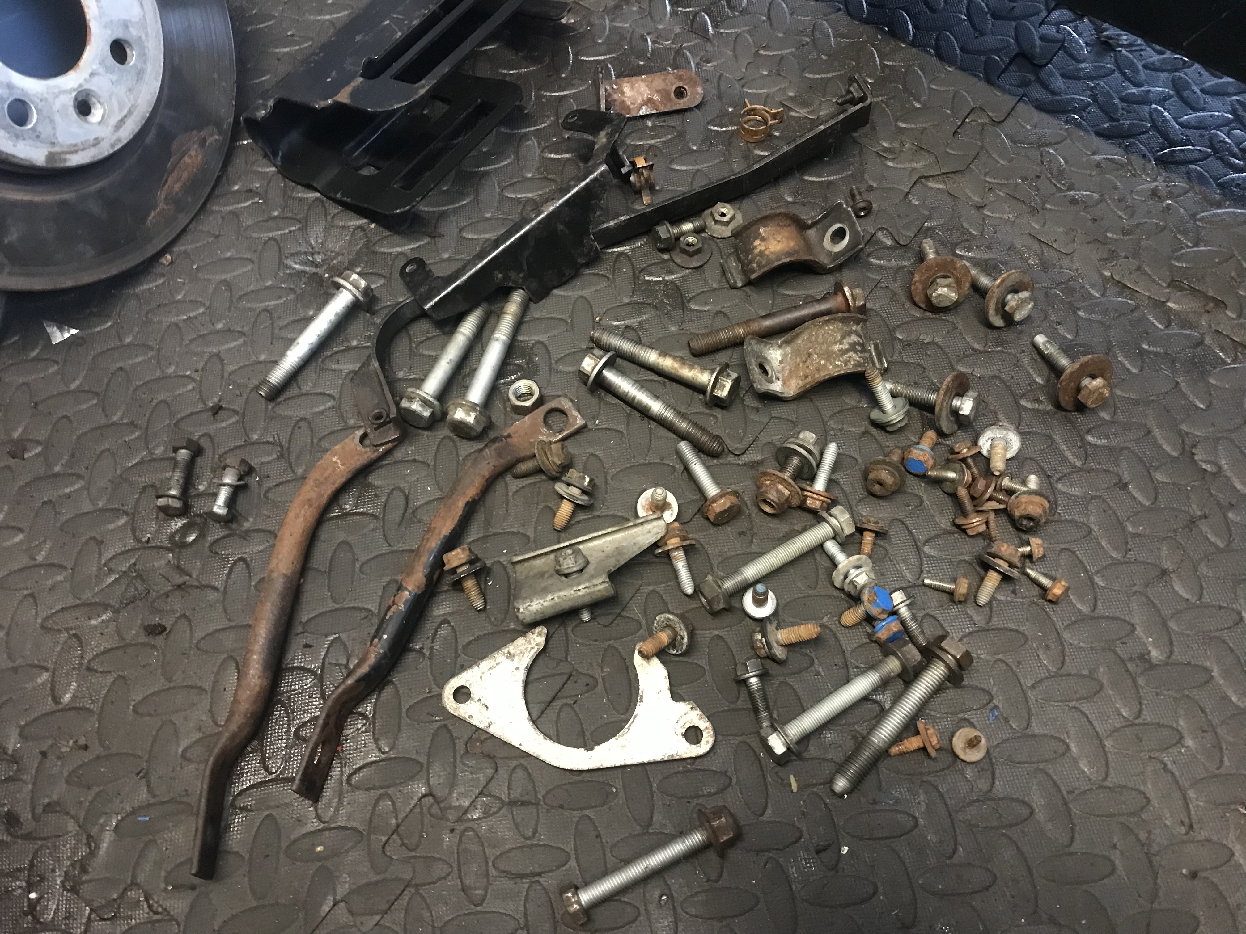

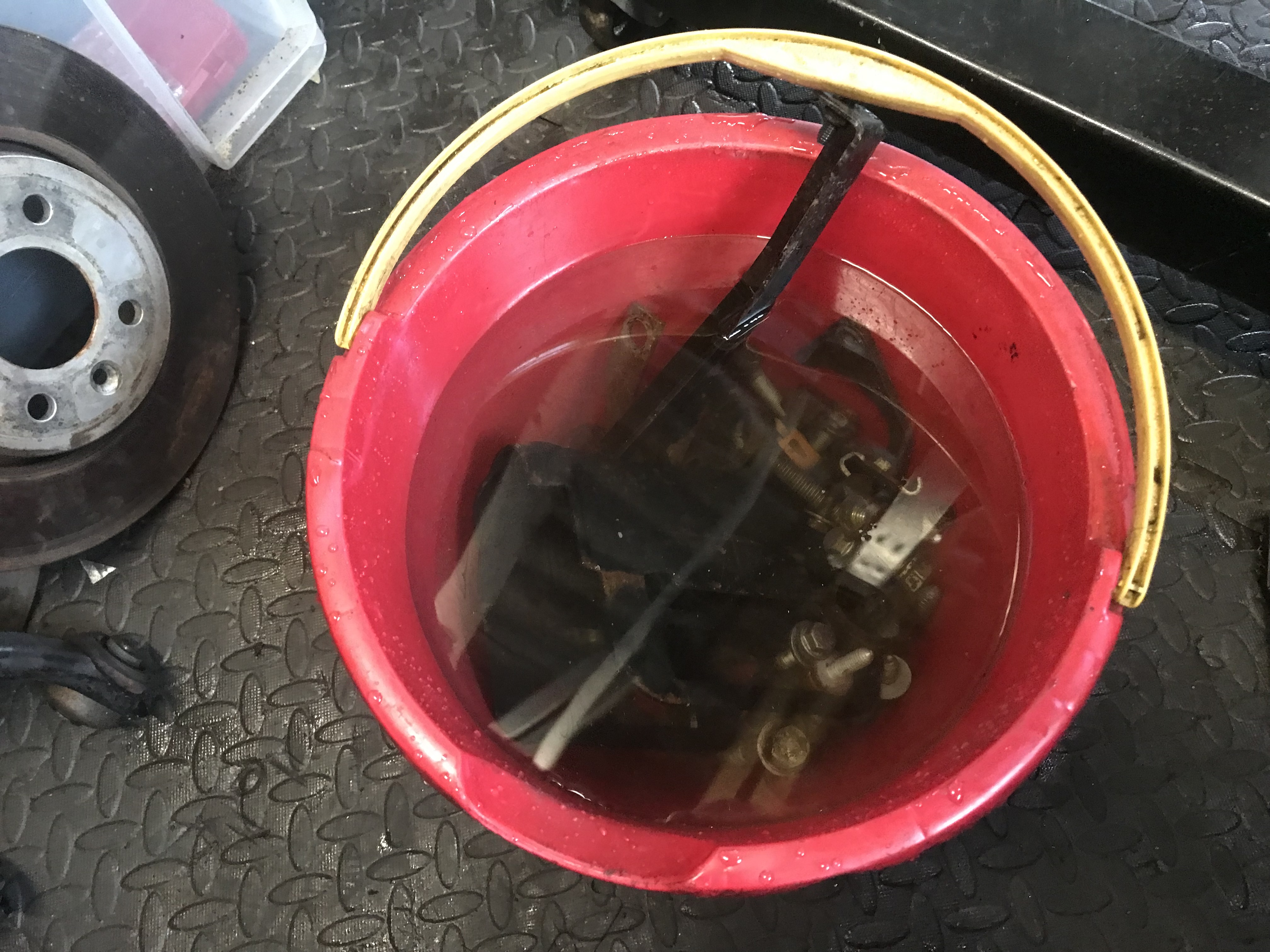

Went through some brackets and bolts that I’m keeping, then gave them an overnight soak in a bucket of warm water and B&H DEOX-C.

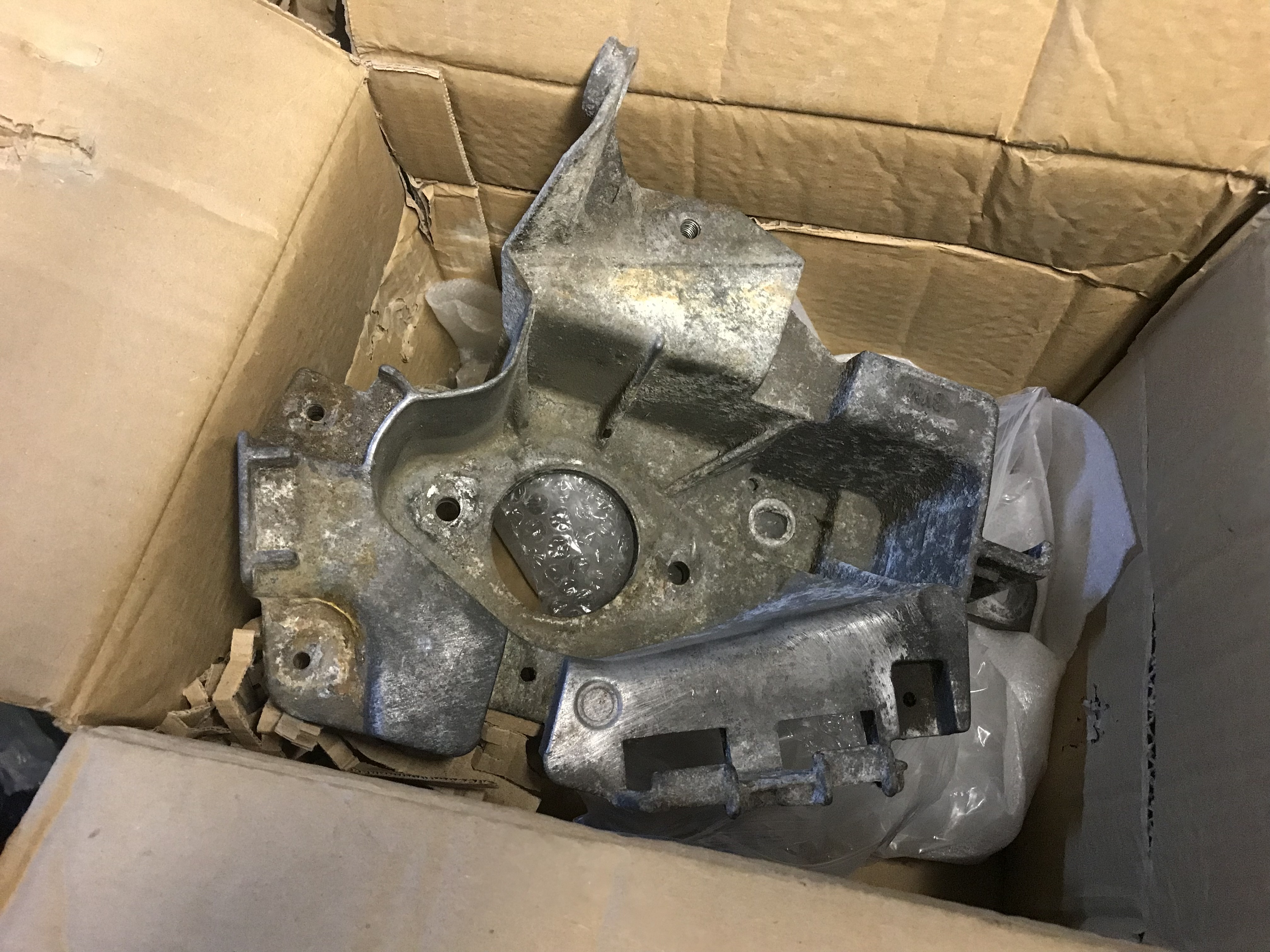

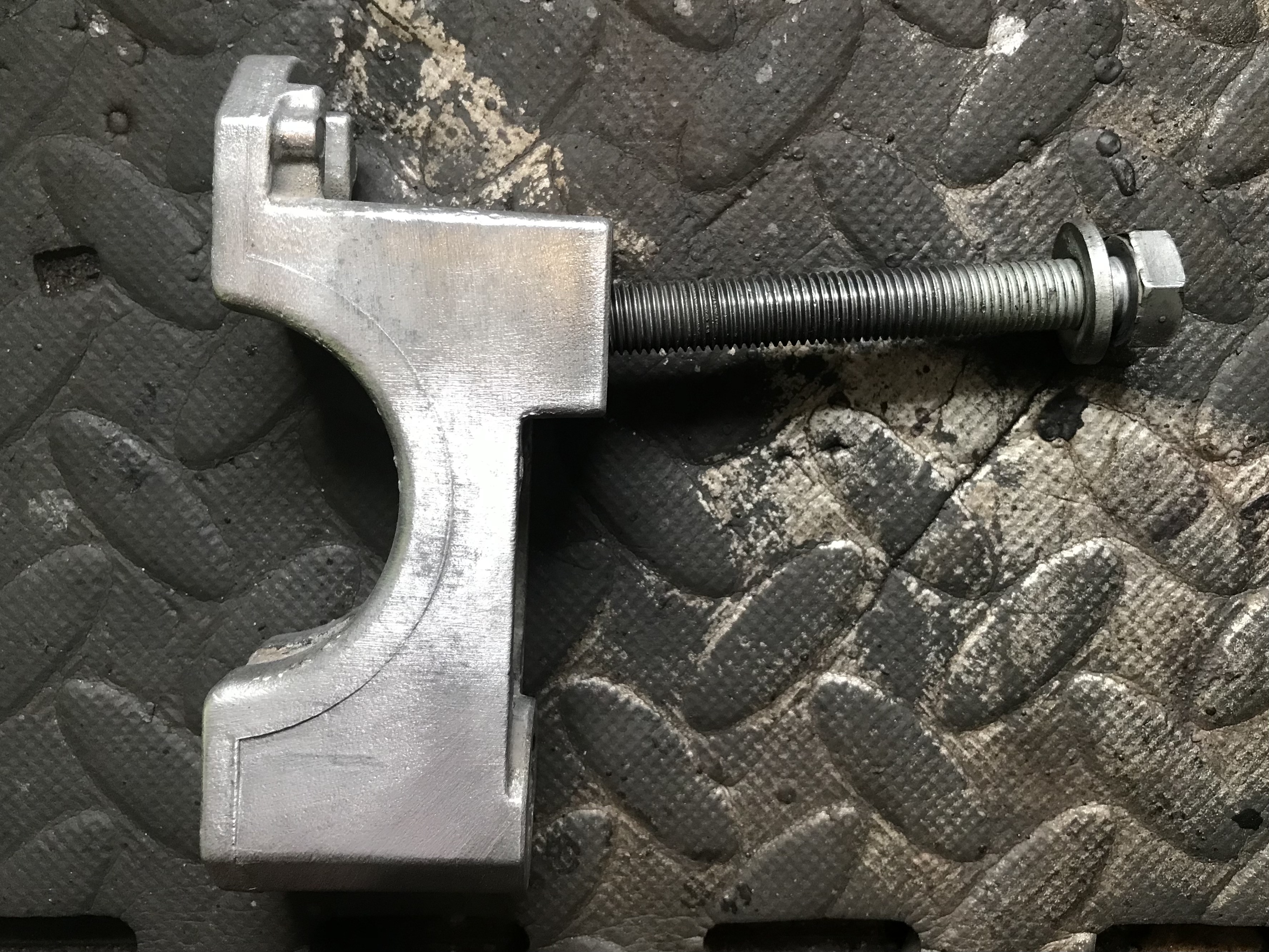

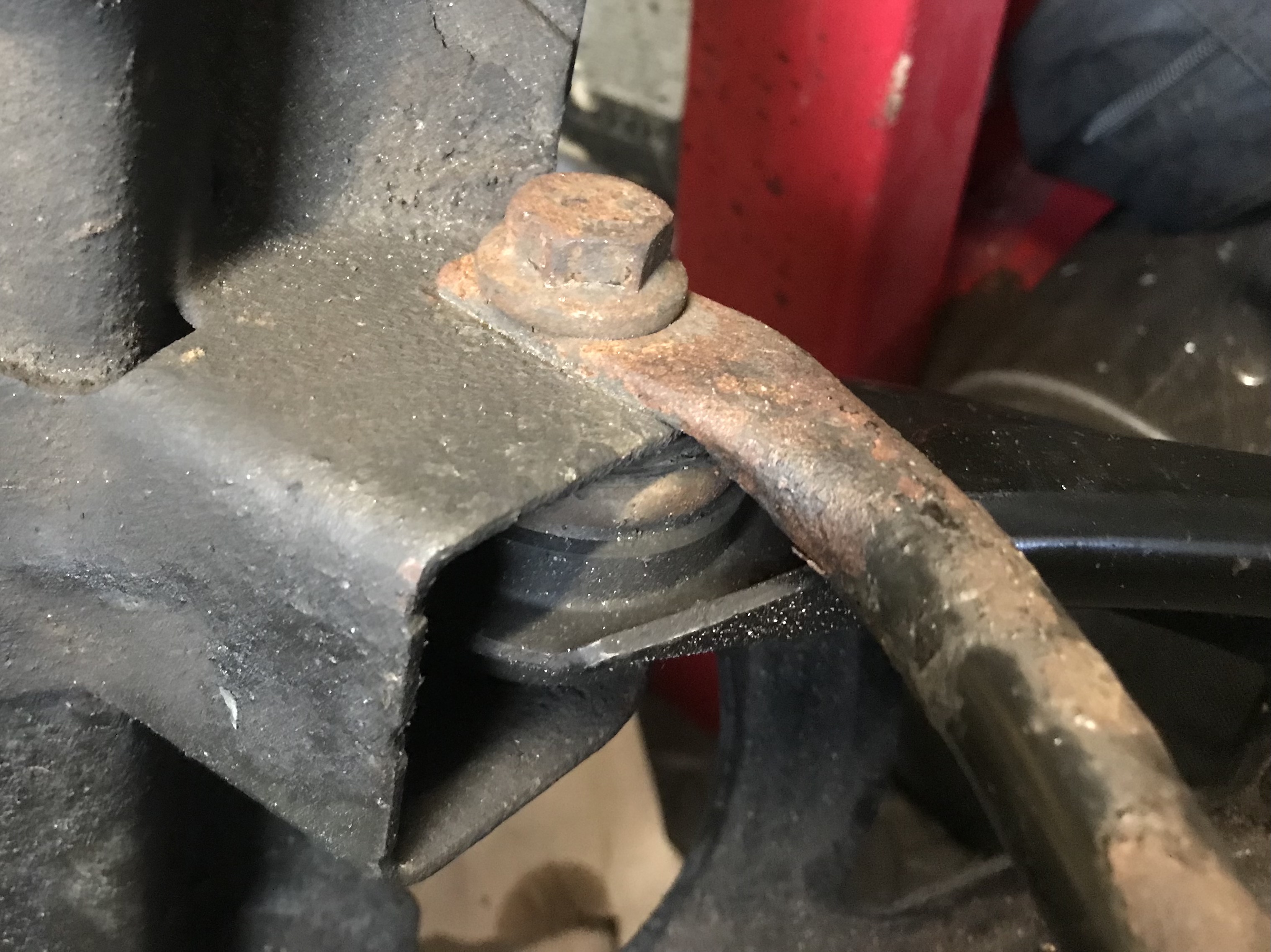

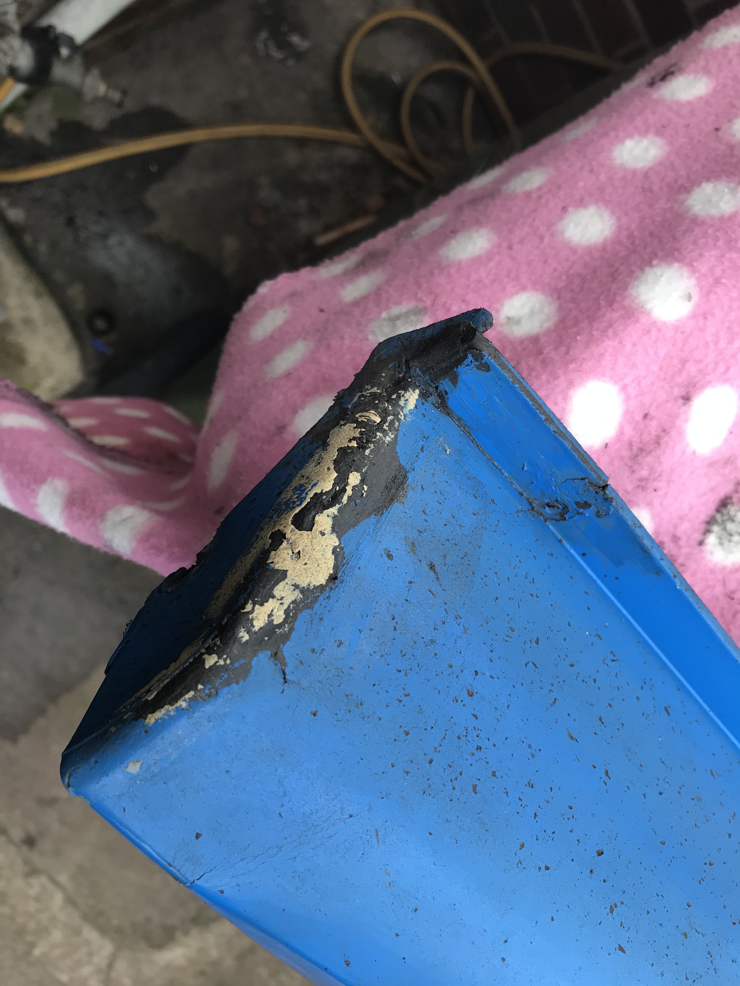

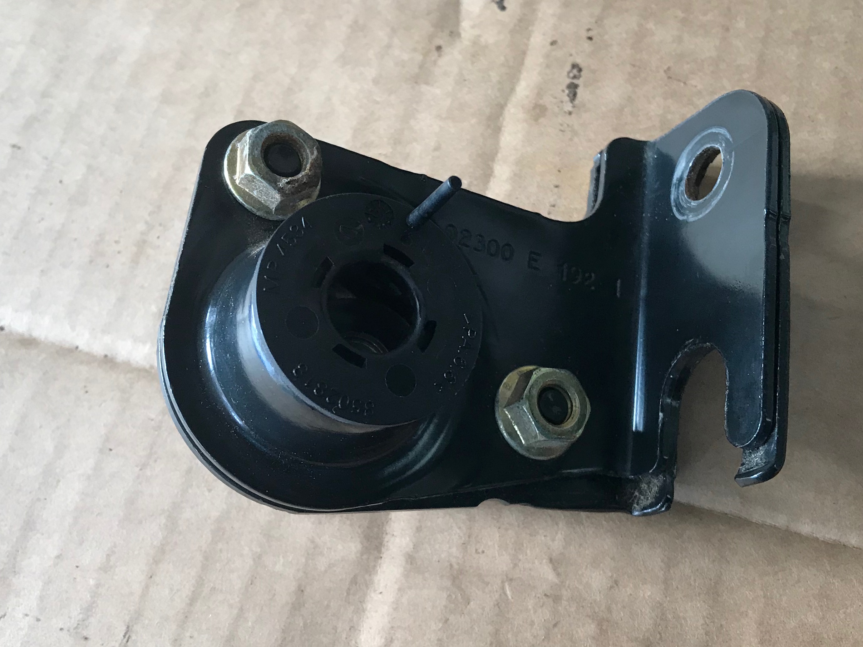

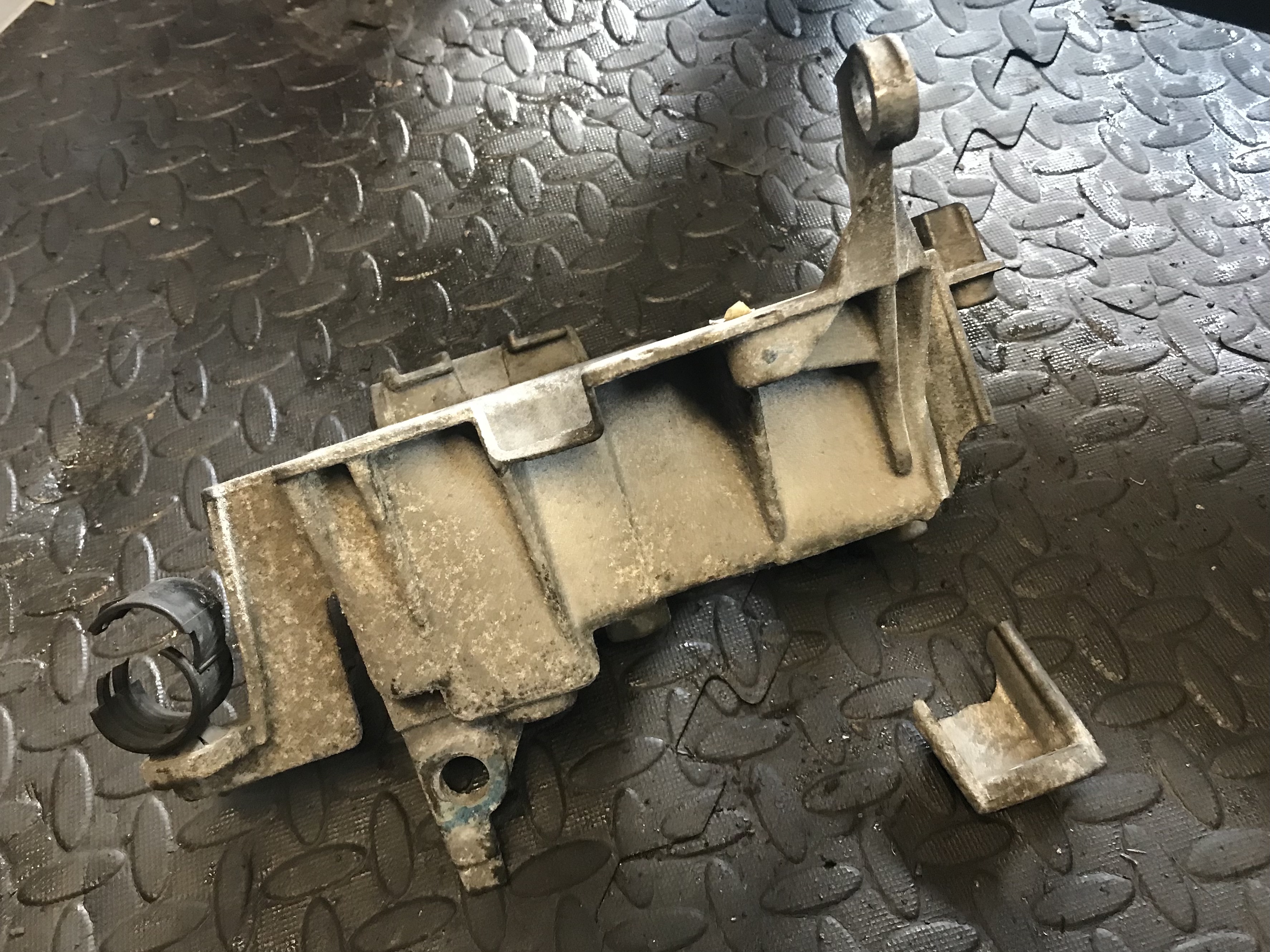

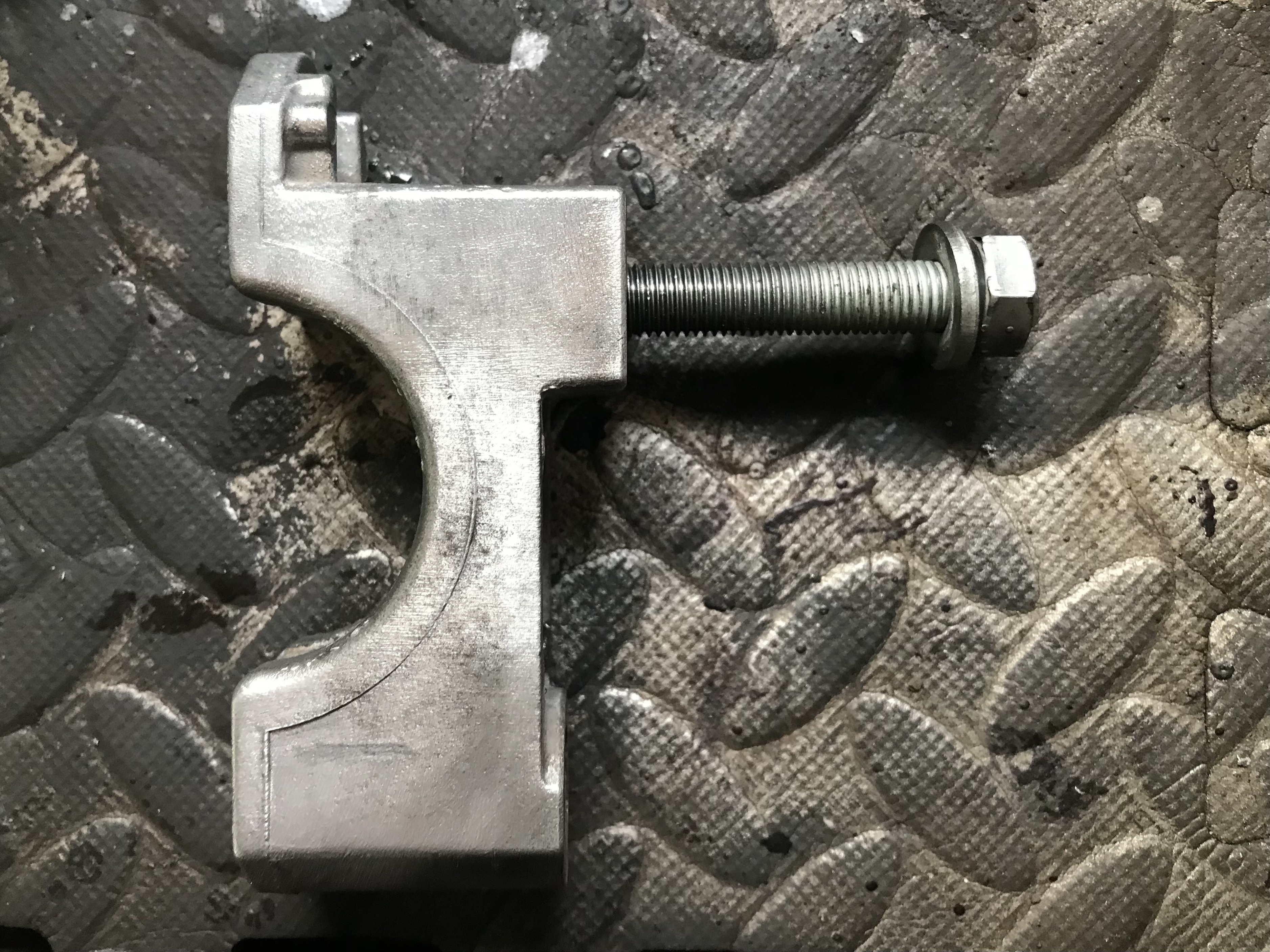

Discovered a broken battery/gearbox mount bracket when removing the engine. NLA so will be on the lookout for a second hand one.

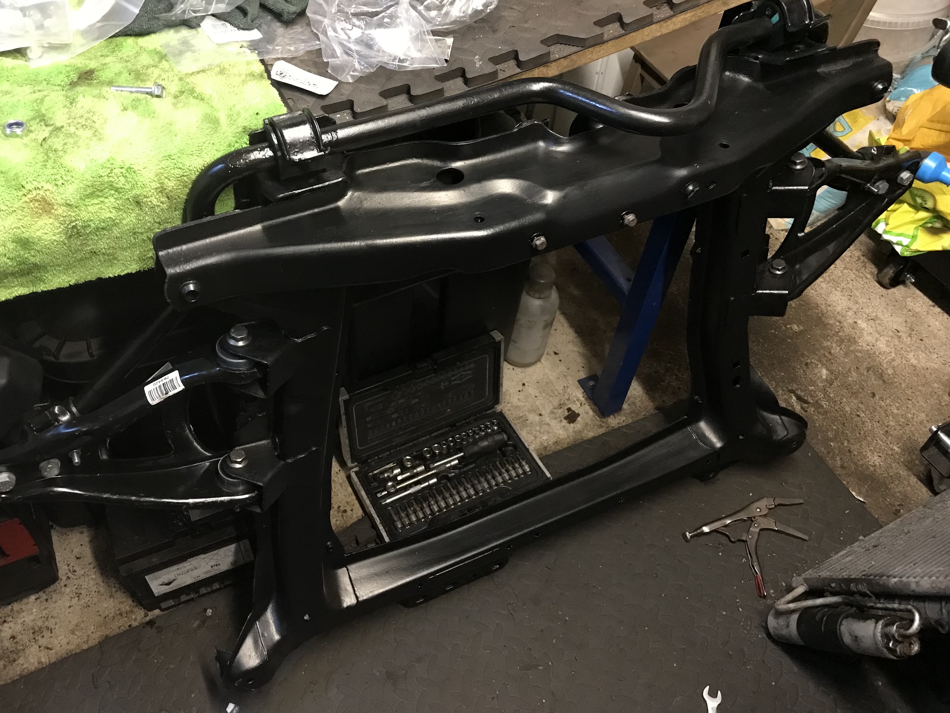

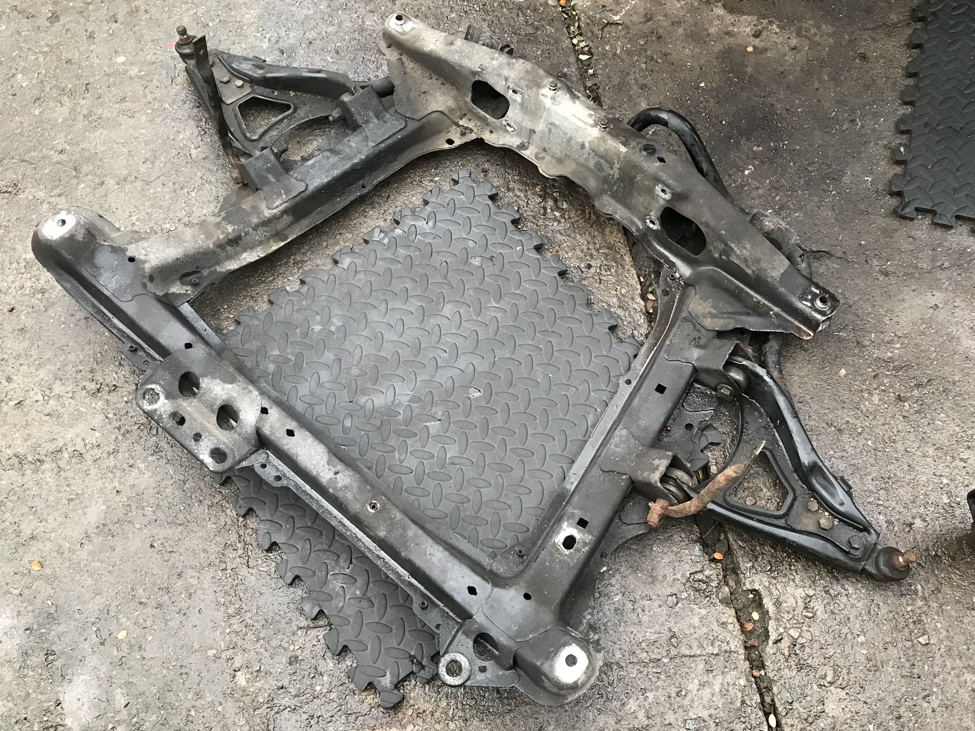

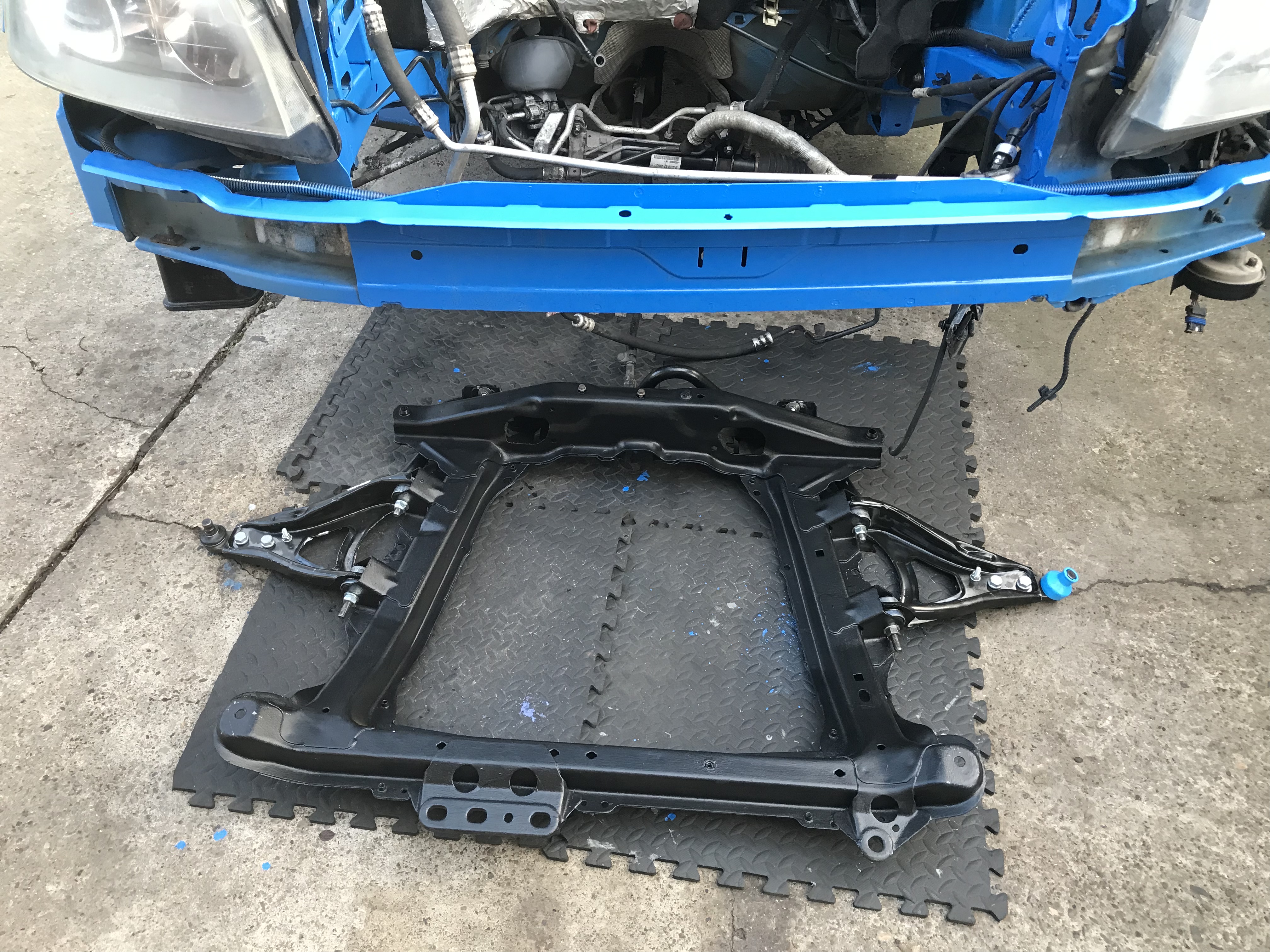

Next job was to refurb the subframe and anti-roll bar.

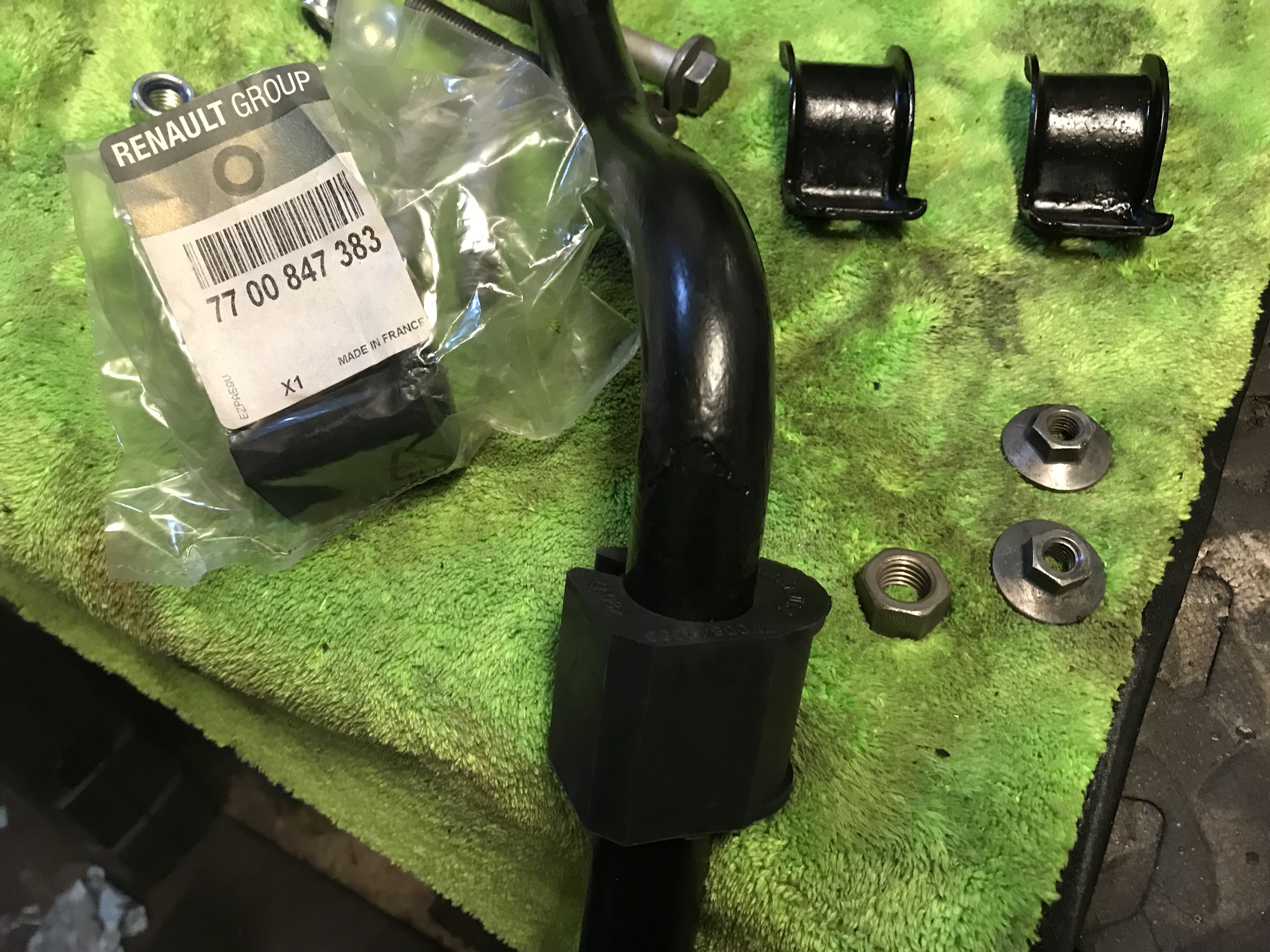

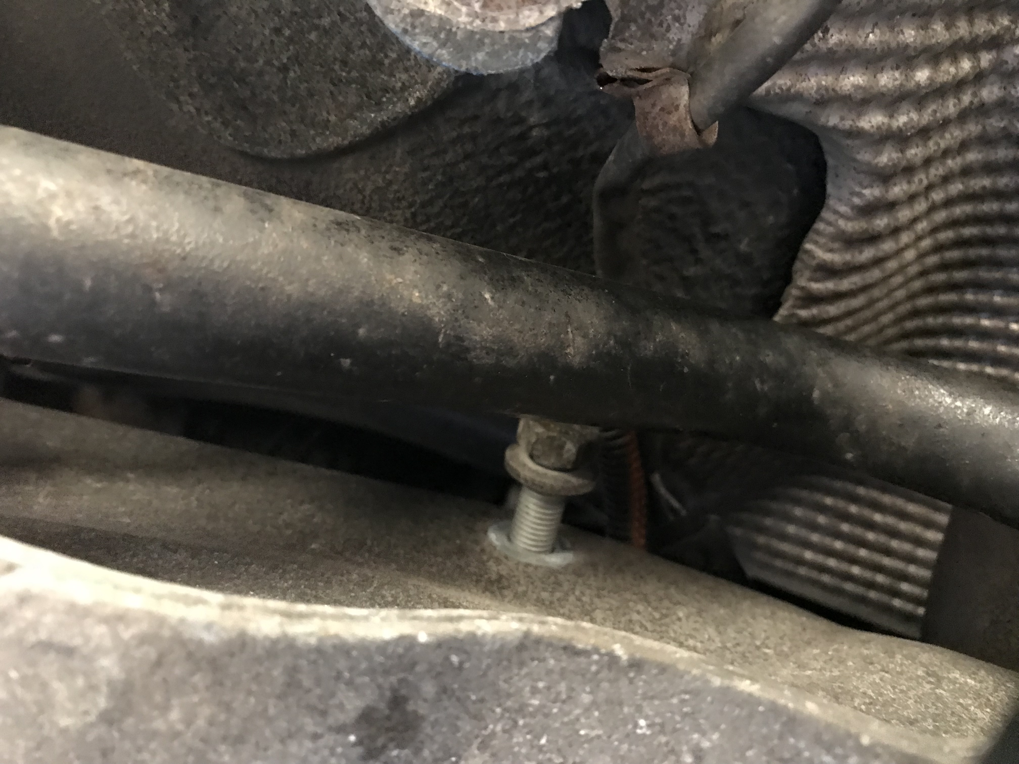

First thing i spotted when disassembling the subframe was the bolts were pointing in the wrong direction. This is one of the longer bolts on the wishbone which should be the other way around, then separated by a spacer nut, followed by the small stabiliser bar and then a locking nut. It was the same both sides 🤦🏻‍♂️
Anyway, onto the subframe. I was going to get it powder coated but decided it’ll last longer if I restore it myself. Treatment is pretty much the same as the rear beam axle but instead of a coating of Electrox primer, I used Etchweld which is perfect for Zinc/Galvanised steels.
Didn’t get any pictures worthy of sharing but here’s the subframe along with the anti-roll bar and wishbones.

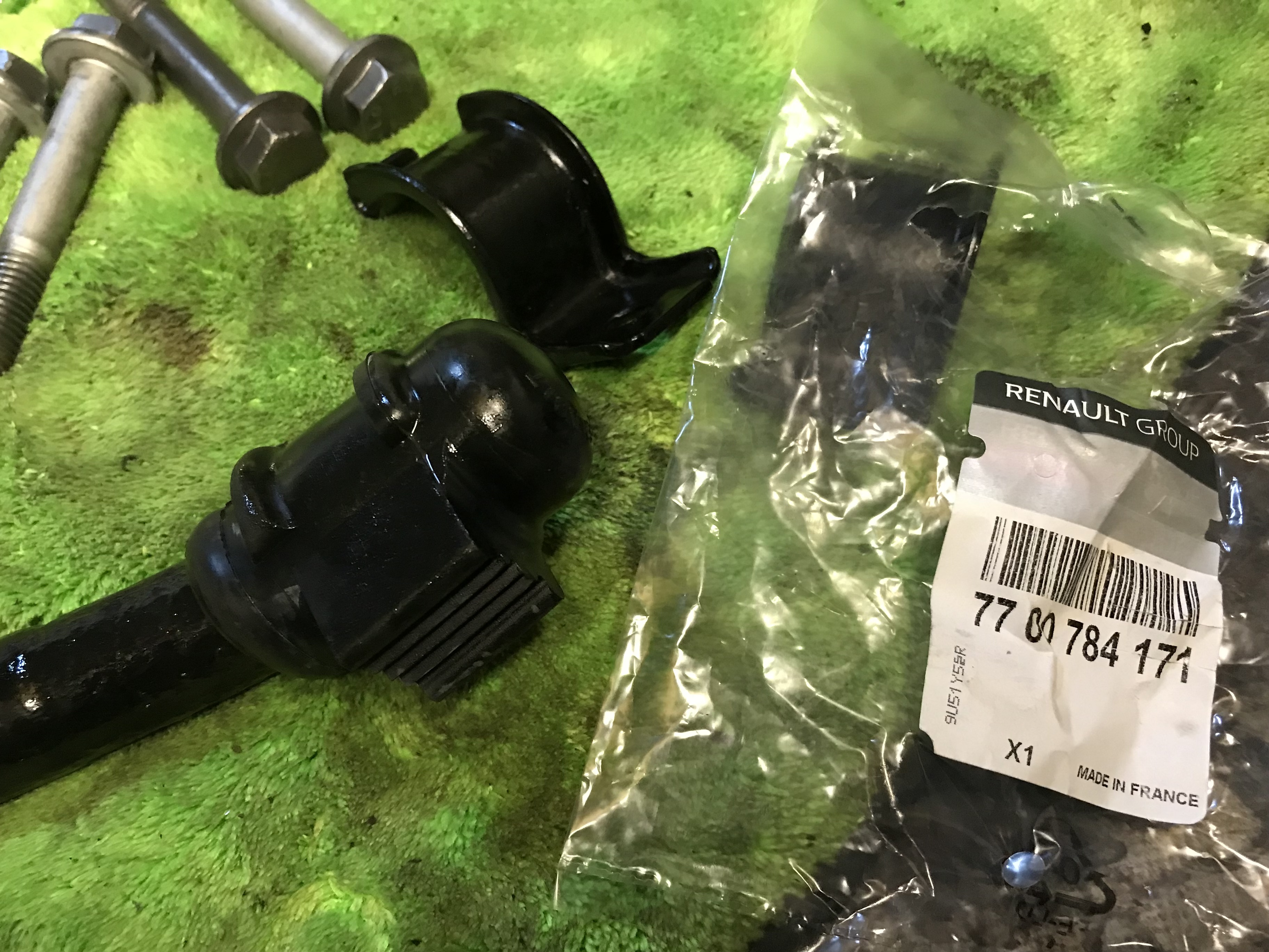

Final coating after Degeasing, Hydrate-80 and Etchweld was Black Epoxy Resin. It’ll never rust 😂
I used genuine inner/outer anti-roll bar bushes, brand new genuine wishbones - last set in the country apparently- restored the original wishbone bolts and replaced the anti-roll bar bolts with new zinc plated equivalents. The only part that’s not factory are the inner bush brackets which are coated in yellow passivate. I just painted it Black.
And that’s pretty much it. I might get the subframe back in tomorrow if the weathers not too bad. Thanks for reading.

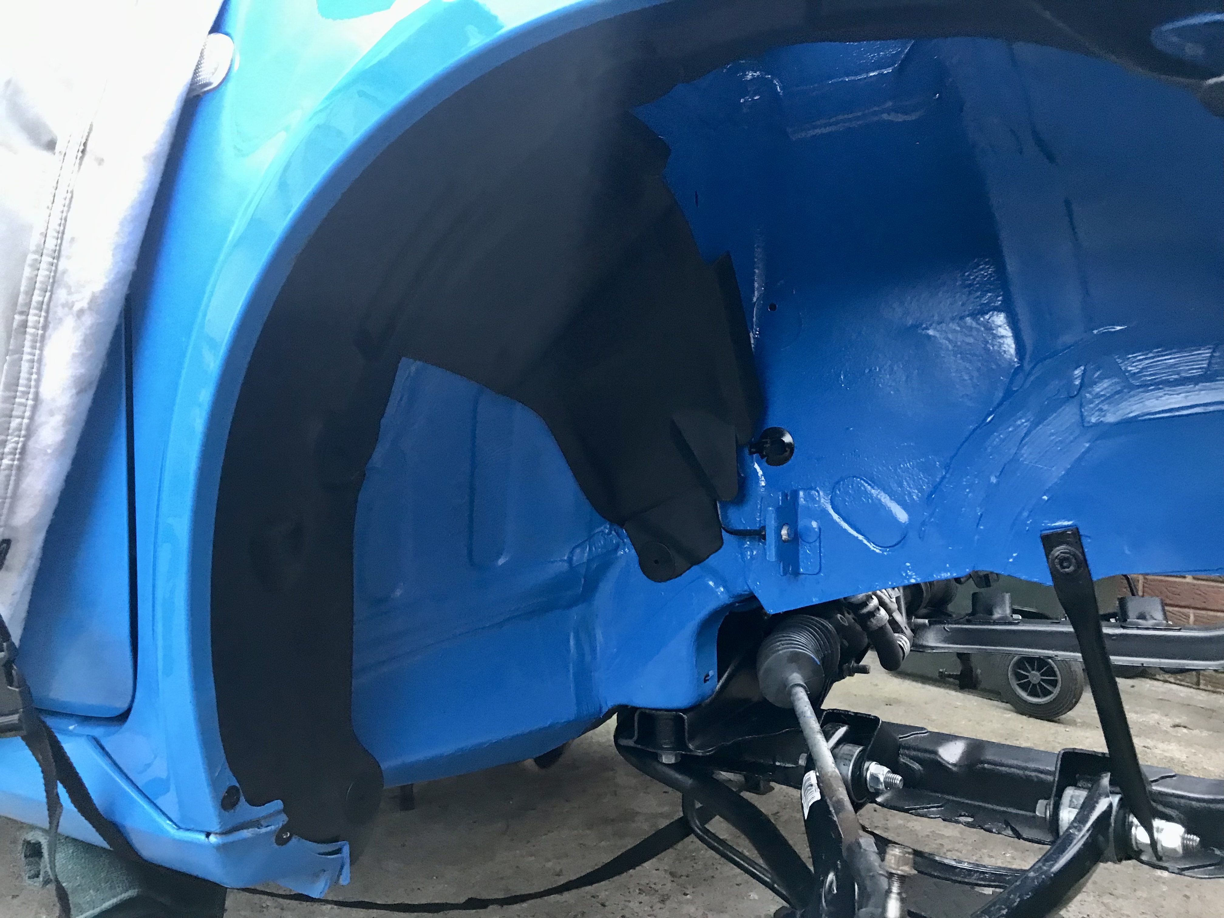

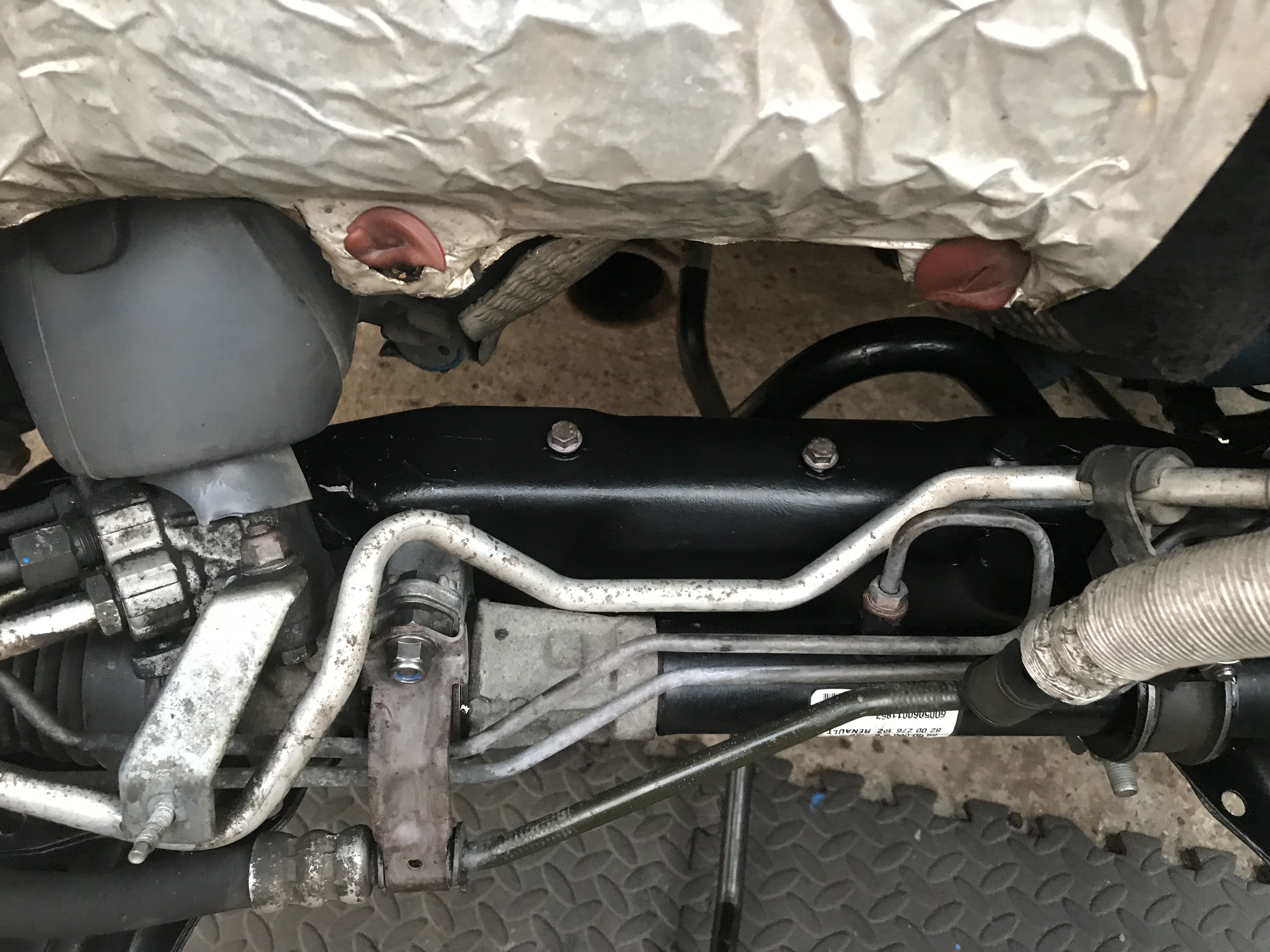

Subframe back in and steering rack fitted correctly.
Did a bit of tidying up in the engine bay and painted under the arches.

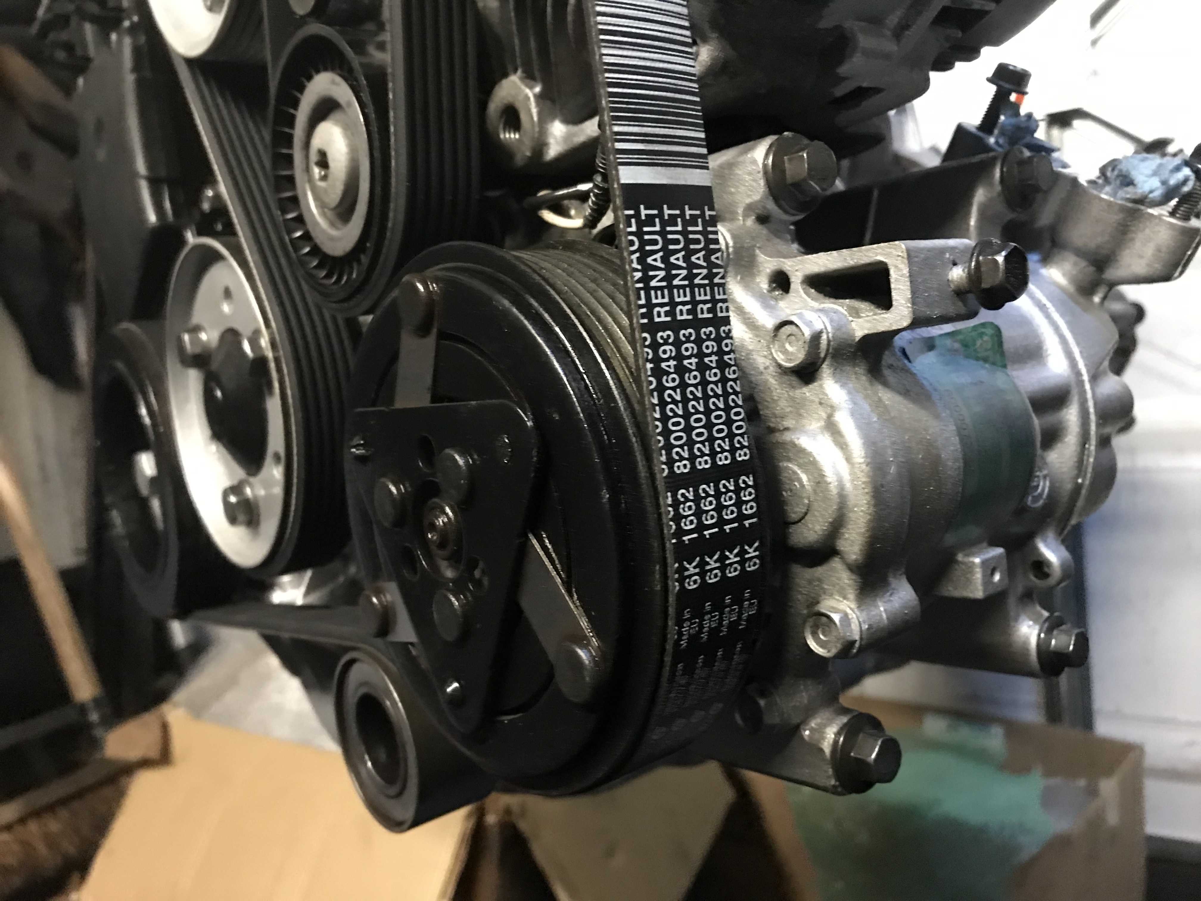

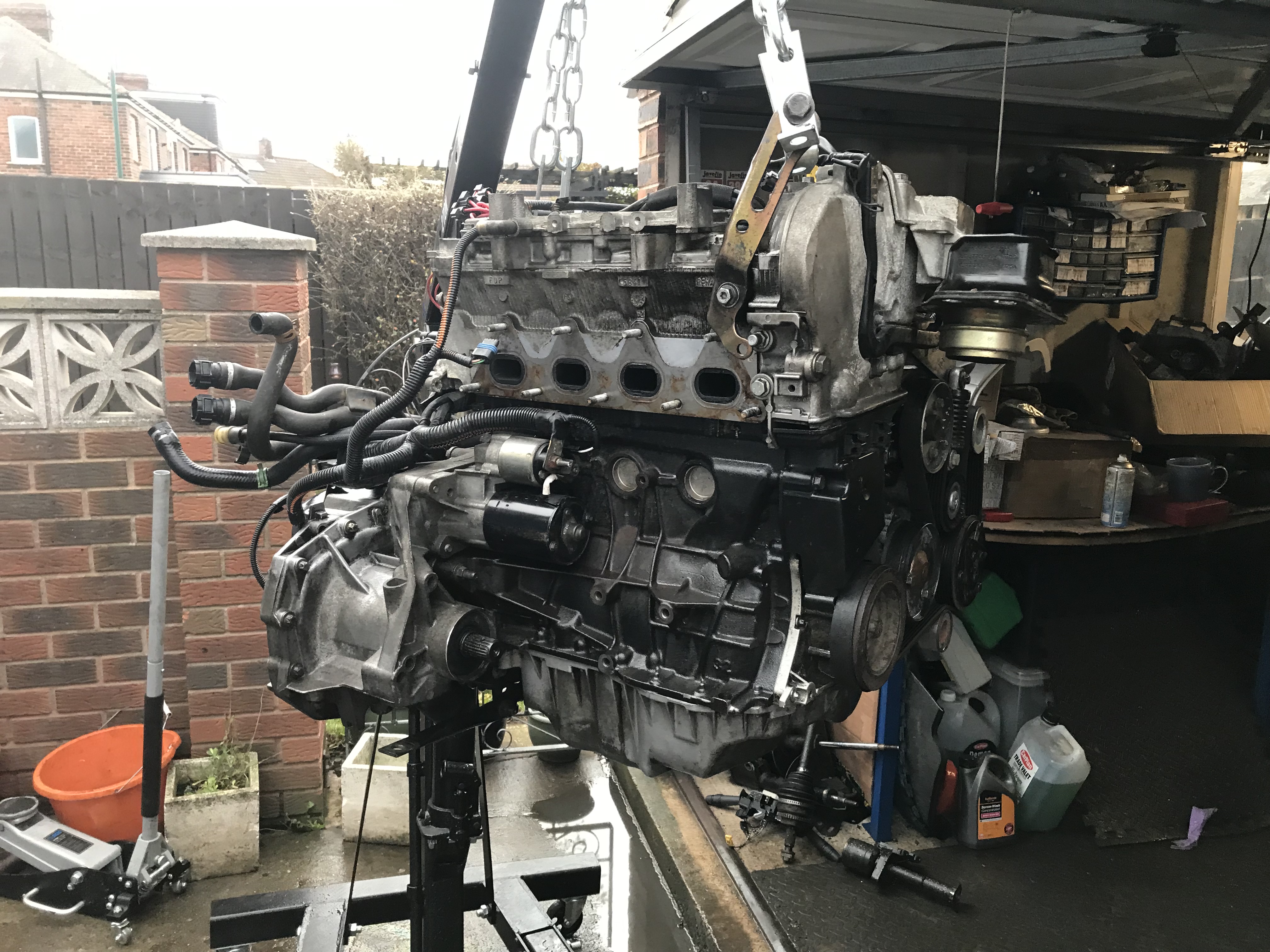

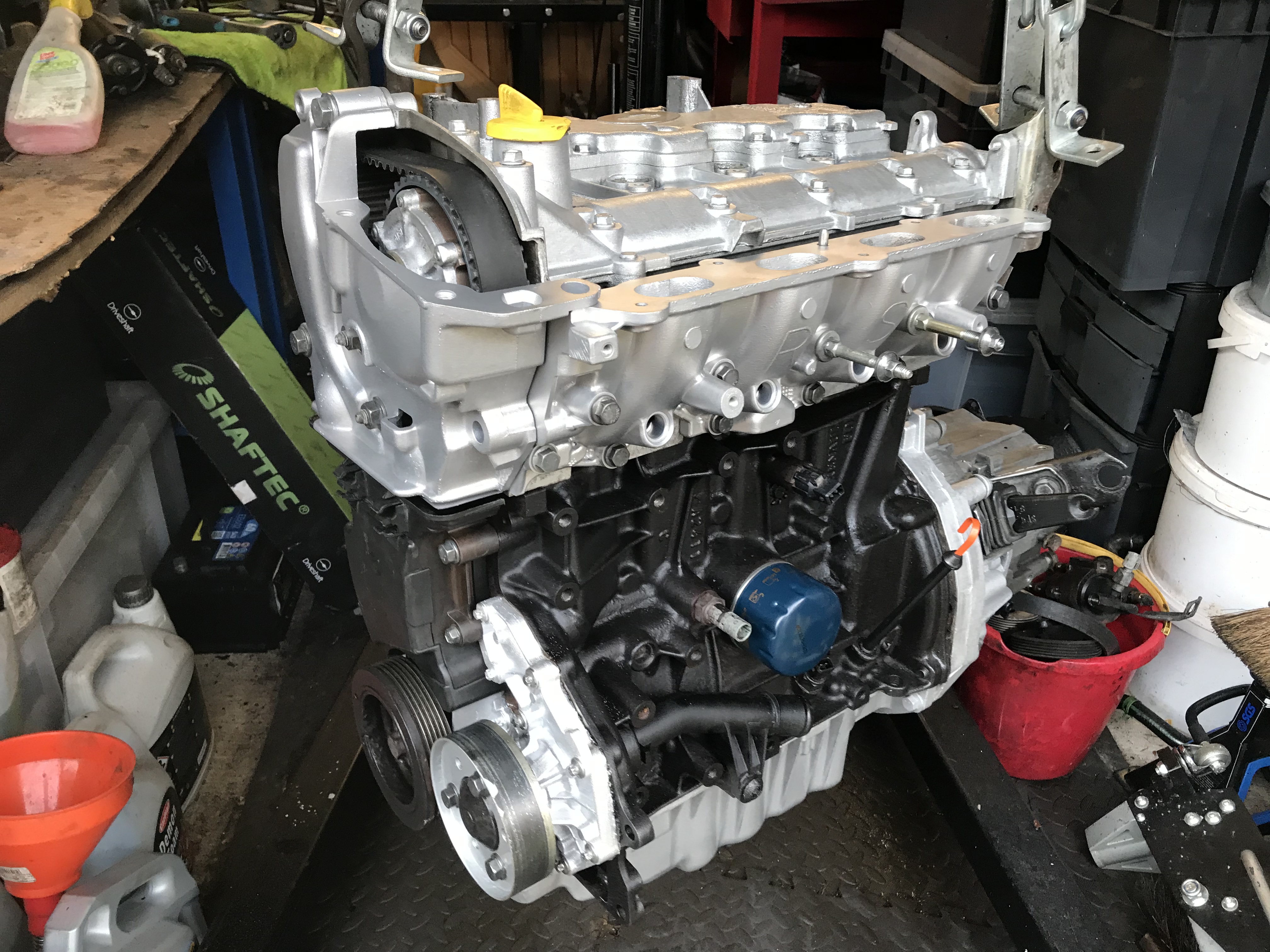

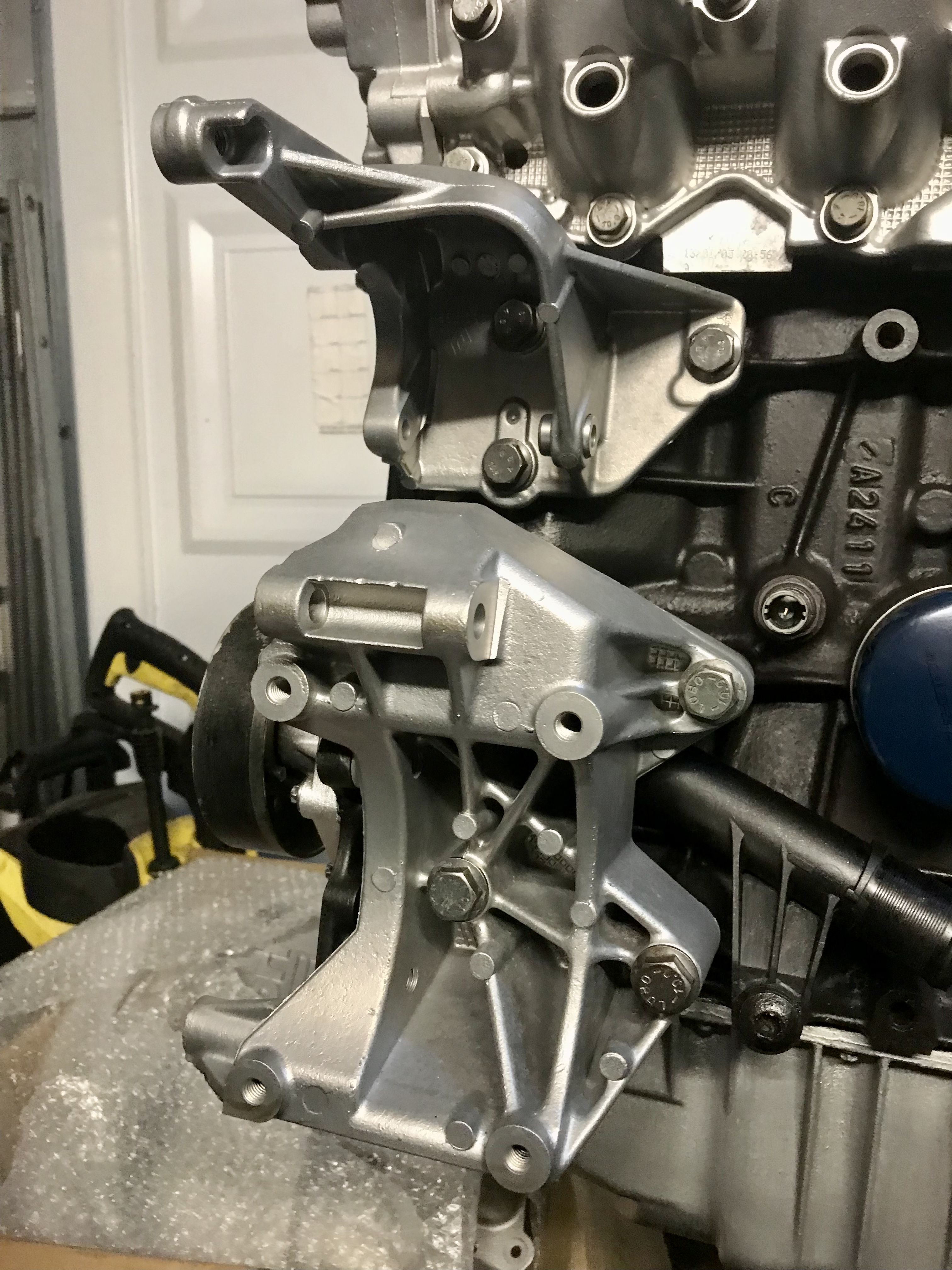

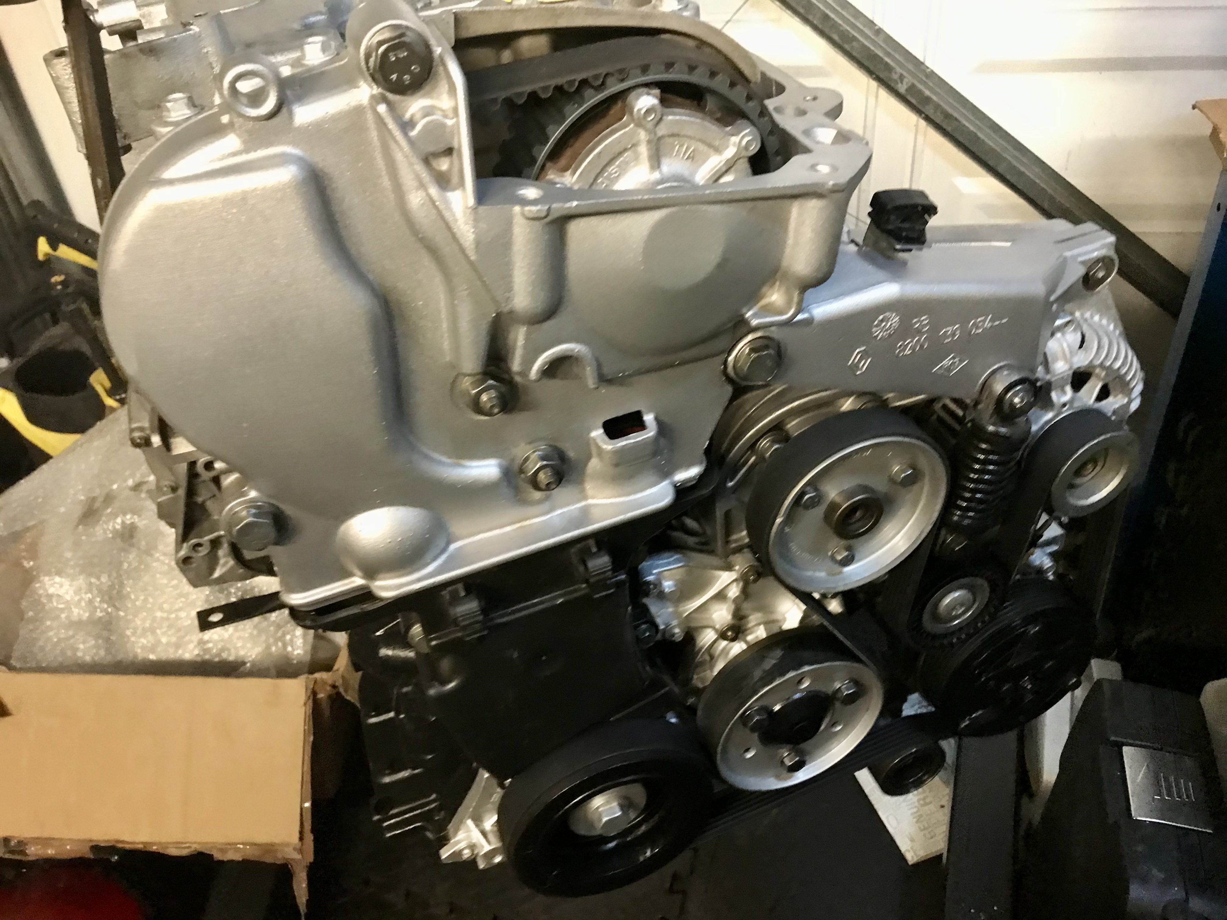

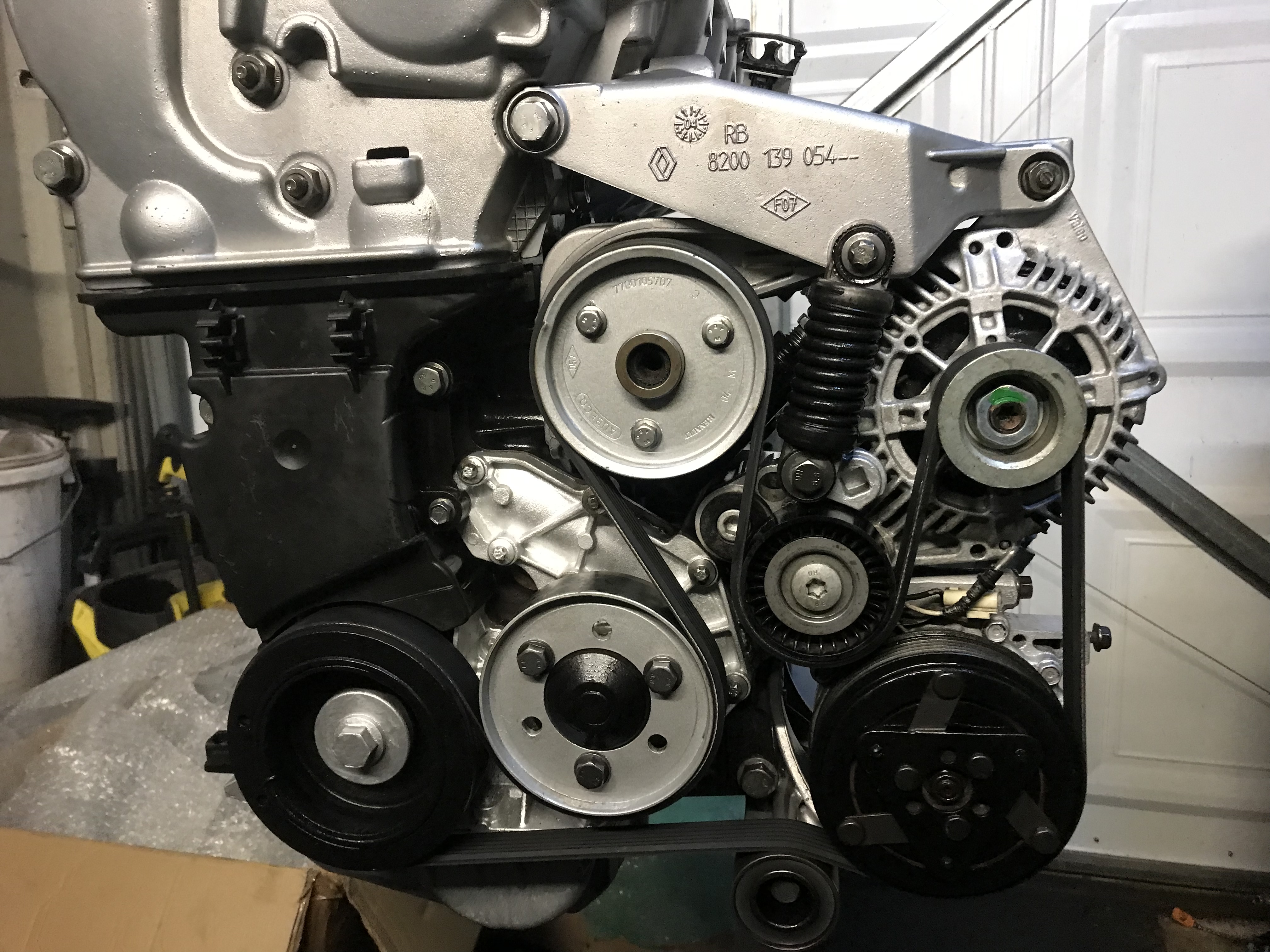

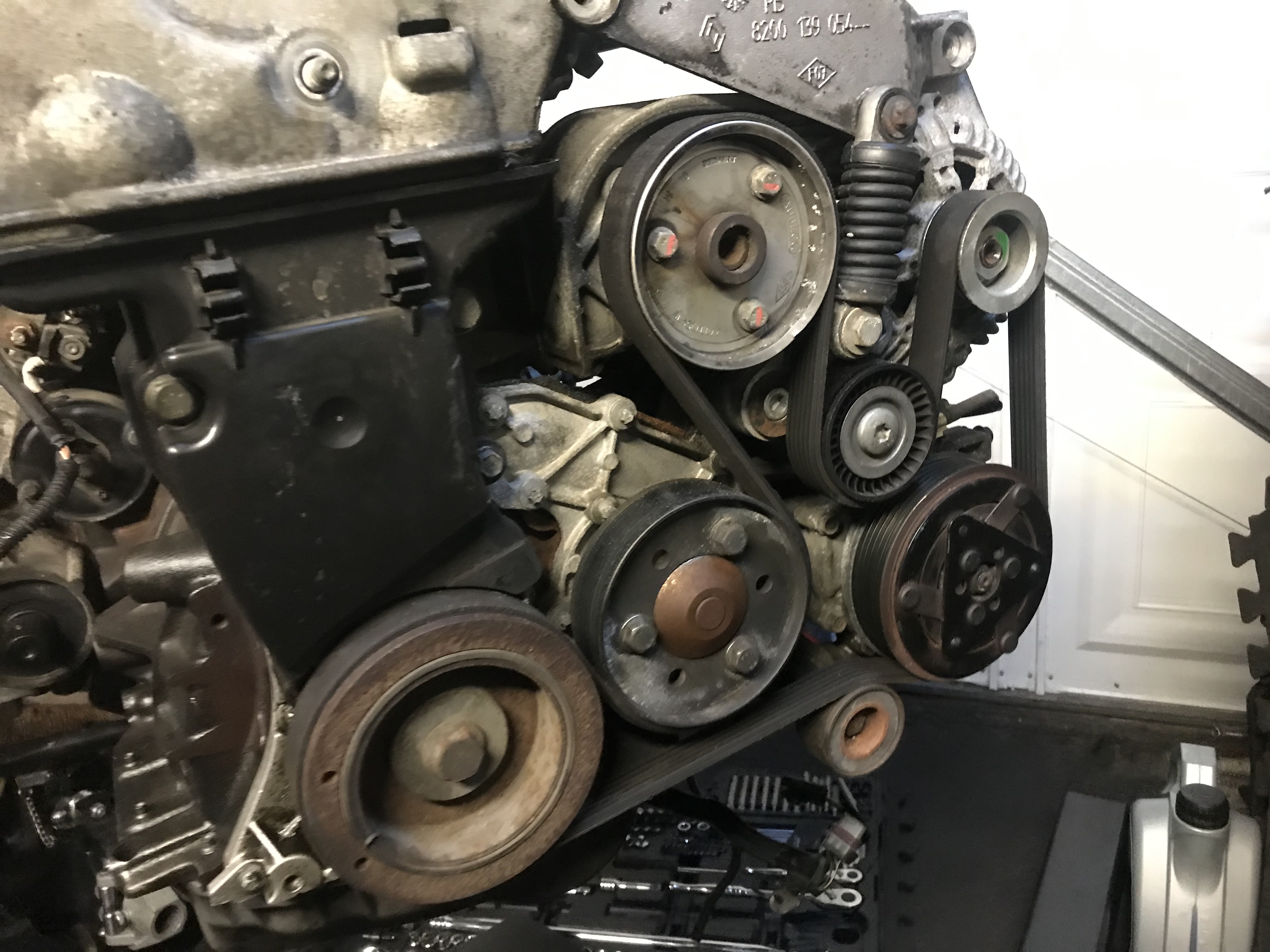

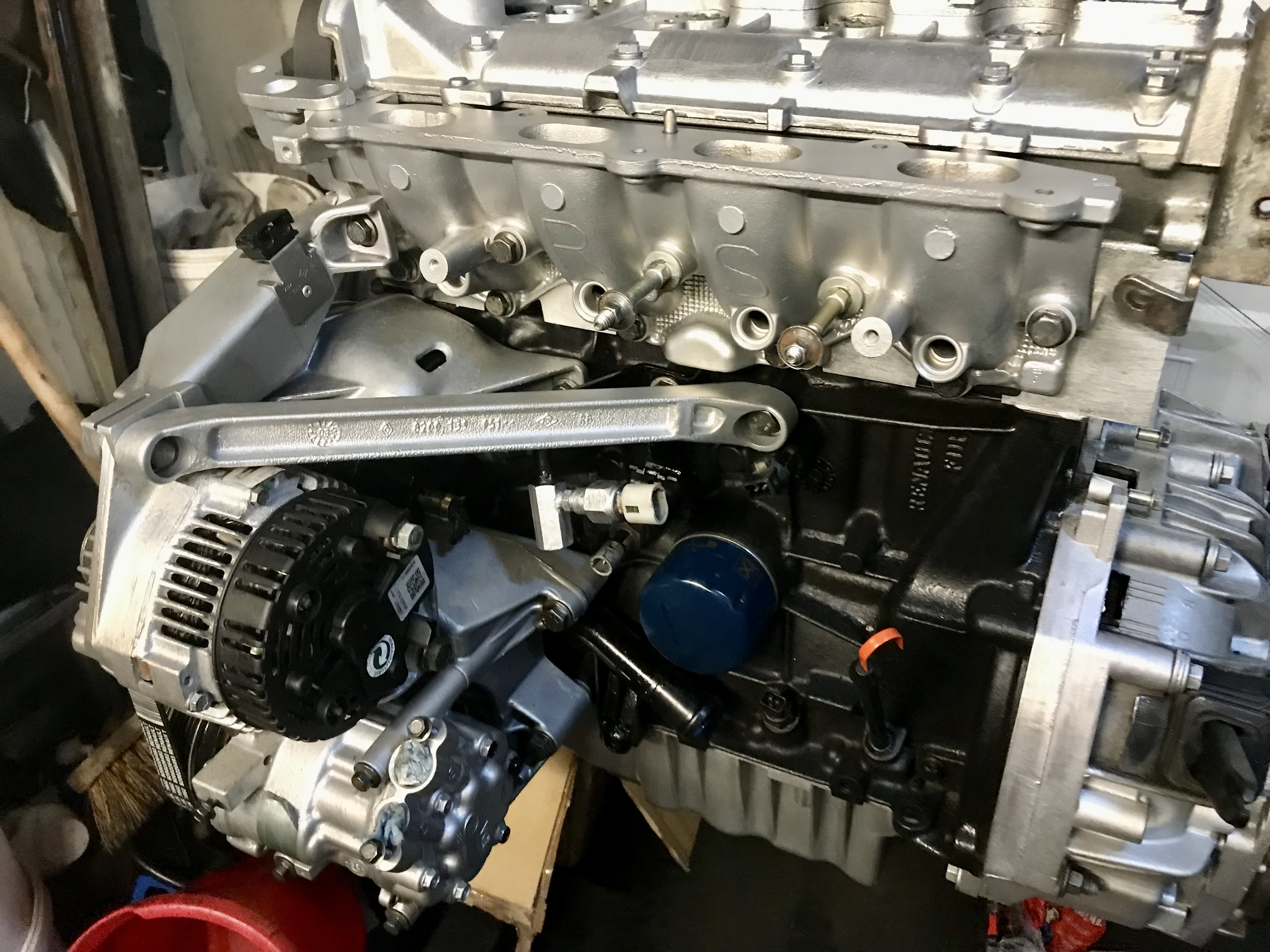

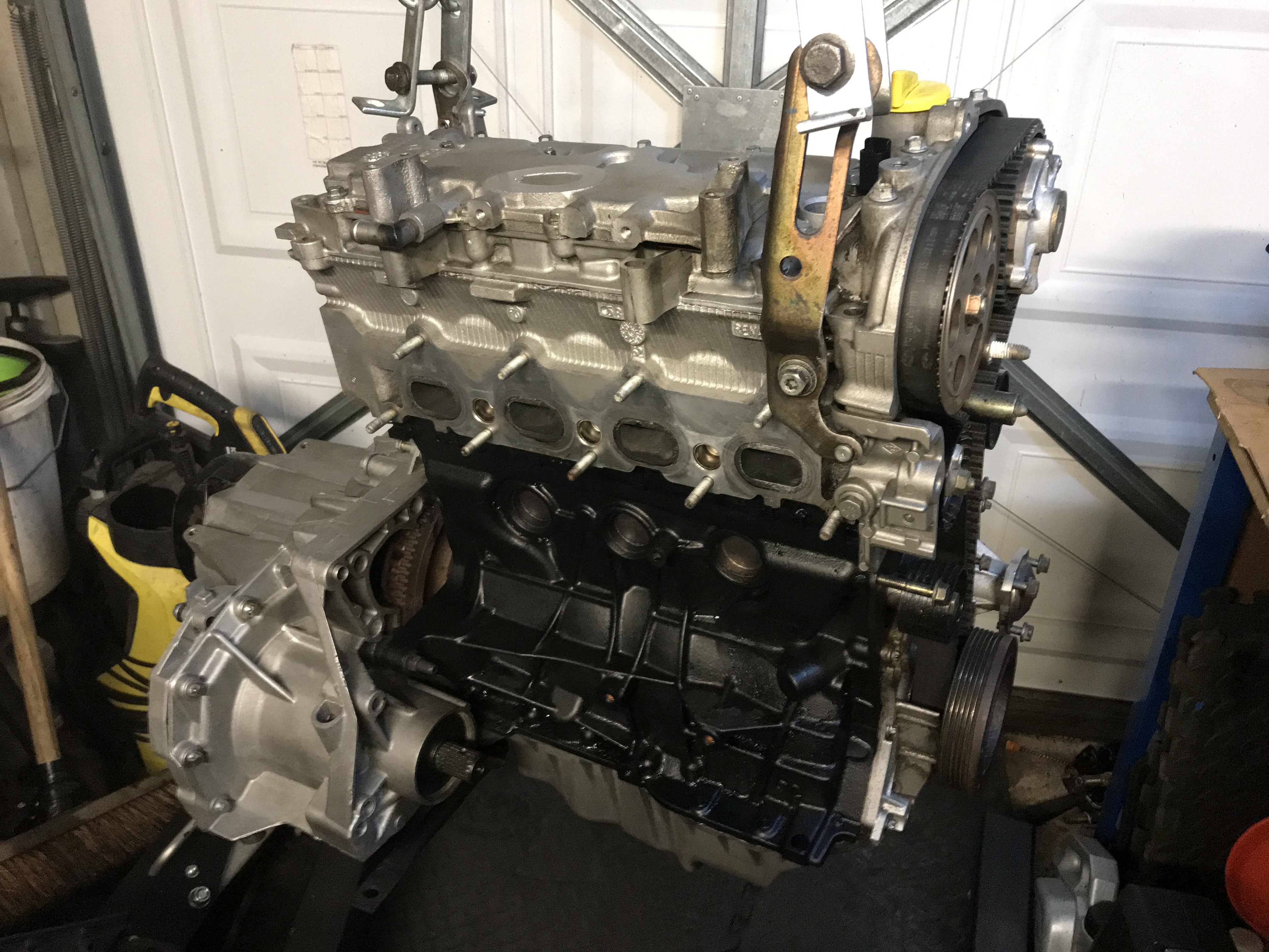

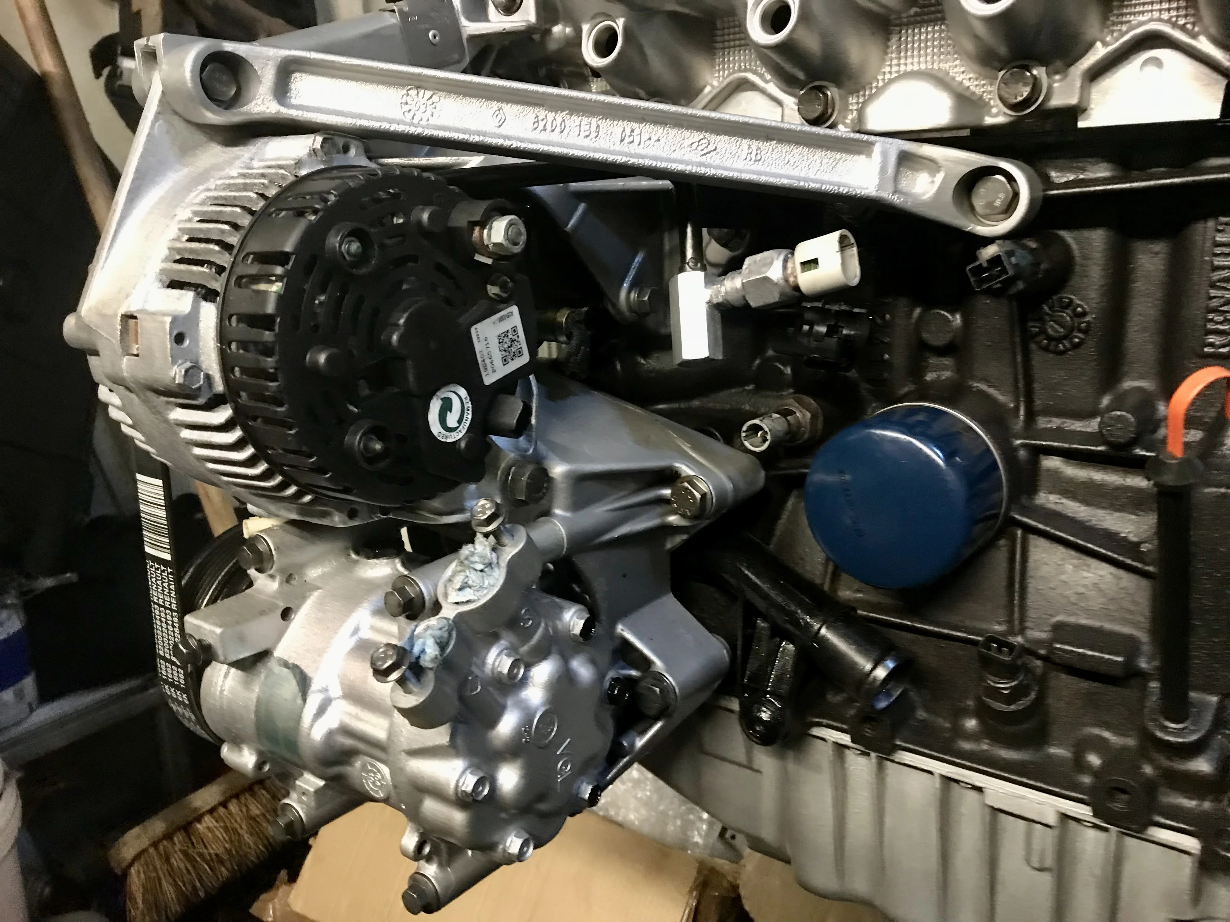

Rubbish weather today mean’t a day in the garage cleaning up the engine.

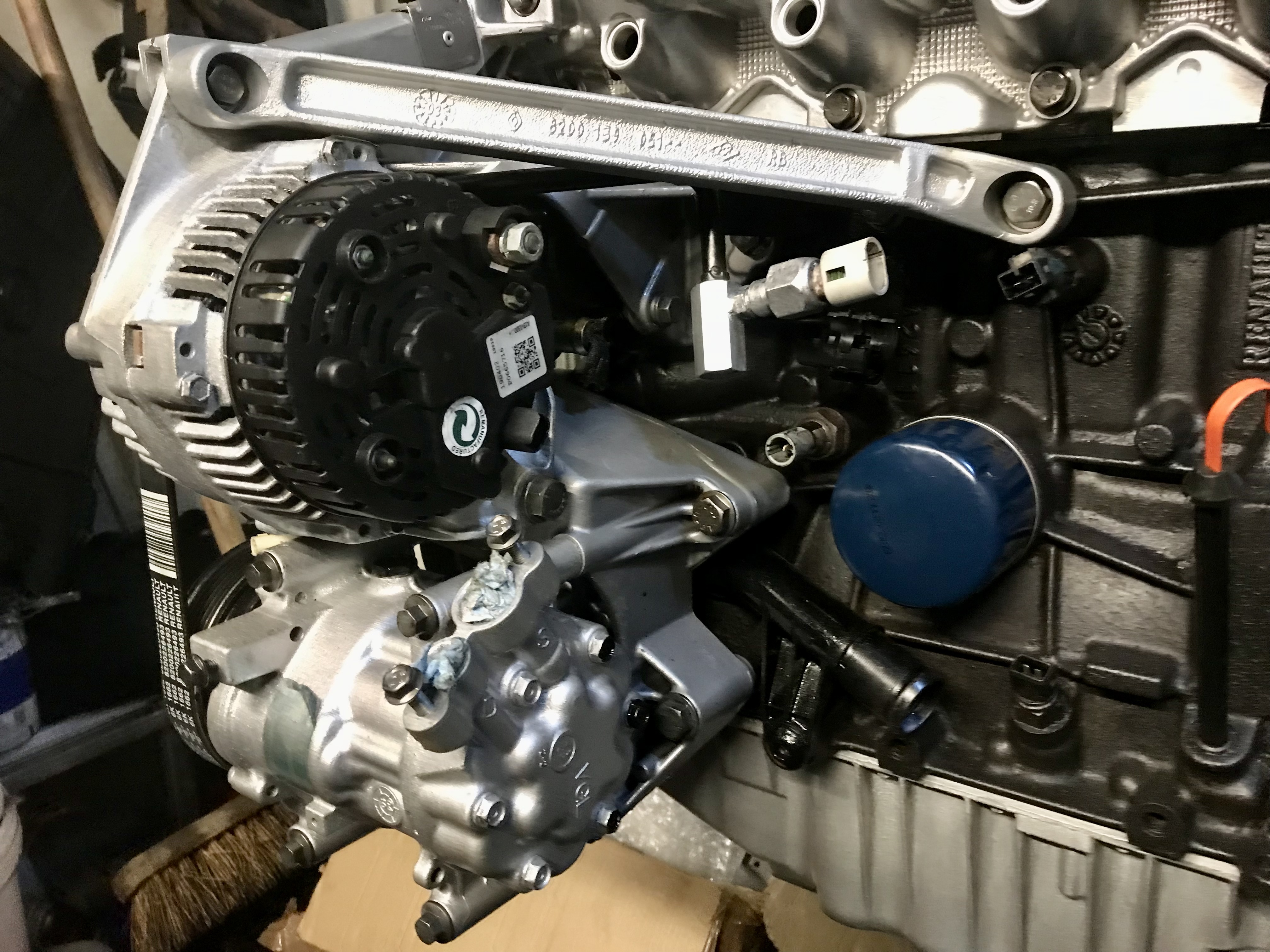

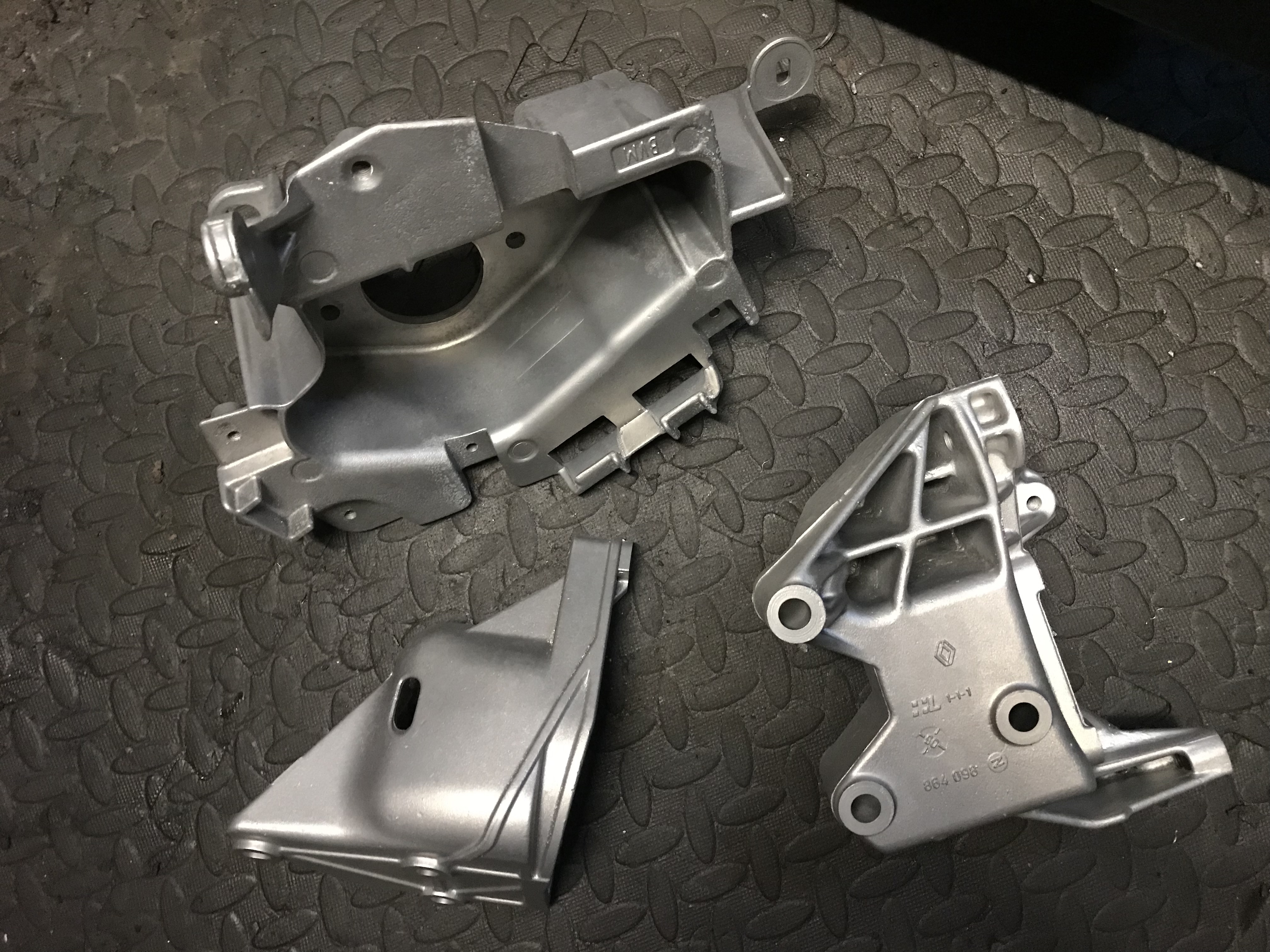

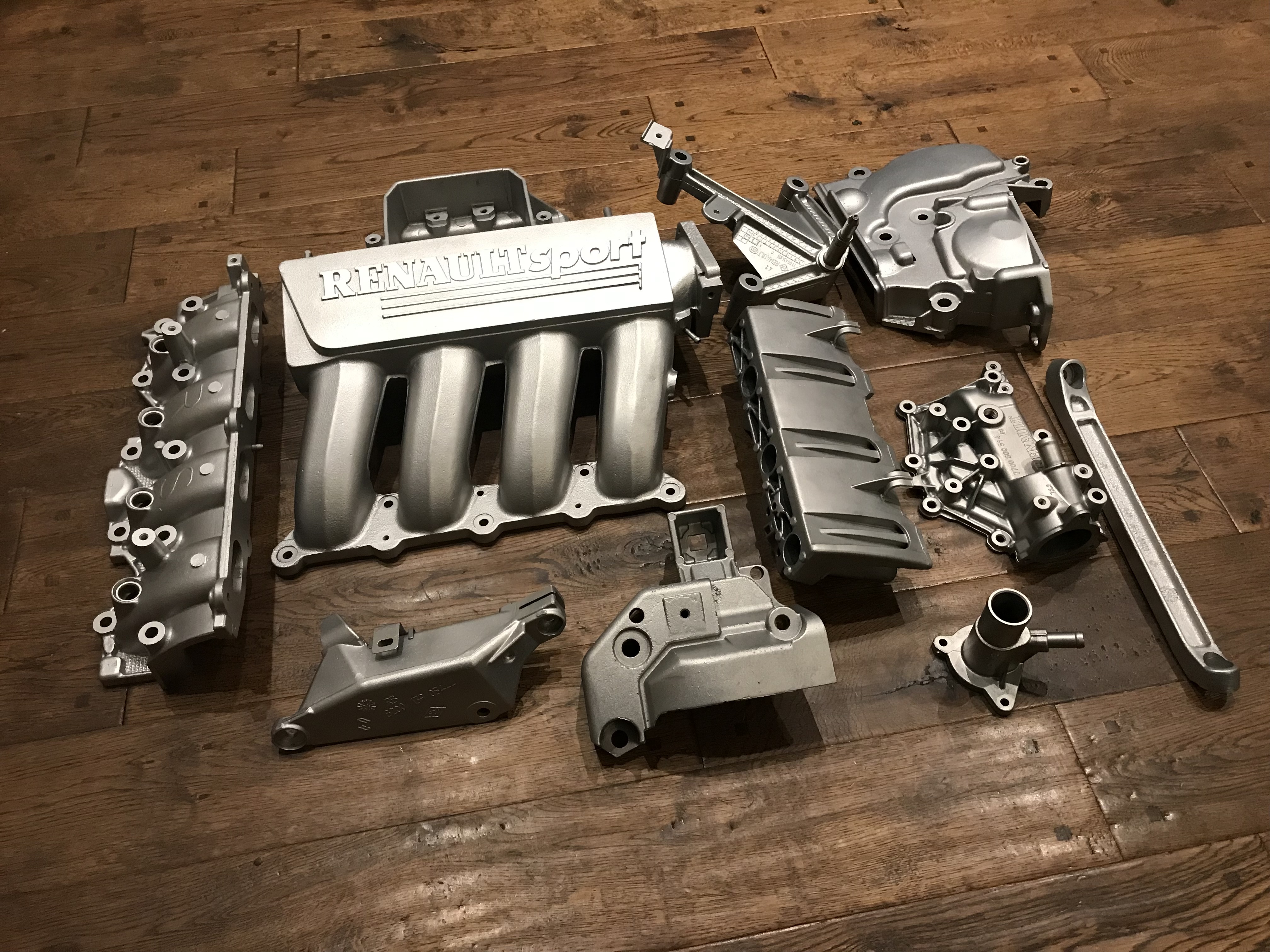

Removed all the ancillaries, boxed them up and sent them off for aqua blasting.
Gave the engine a proper clean up with degreaser. Took about 5 hours as it was absolutely filthy but the gearbox and rocker cover came up a treat, so I’ll probably leave them as they are.
Got some Hydrate-80 on the block then painted one side. Not sure if I like the Matt Black finish 🤔 Might just do Charcoal like the BG.
Managed to pick up a replacement battery/gearbox mount tray from BTT Motorsport which arrived today, so that’s gone for blasting also.

  • Rear Beam Axle completely refurbished along with brackets, hubs and carriers
  • Brand new Purple Powerflex bushes
  • Brand new Genuine body to beam bracket bolts
  • Brand new Genuine rear calipers and HEL stainless steel bleed nipples
  • Brand new Genuine rear discs, Motrio pads and axle nuts.
  • Brand new Genuine rear ABS sensors
  • Brand new stainless steel braided lines inc rear axle lines
  • Brand new 10.9 high tensile nuts and bolts in hubs, beam axle and lower damper
  • Brand new Genuine ‘Cup” dampers
  • Rear springs clean up
  • Complete restoration of the rear section, including chassis legs up to and in around the fuel tank
  • Descaled, degreased, application of DEOX-Gel, followed by several coats of Hydrate-80, followed by Electrox Primer then finally Epoxy-Mastic and undersealing
  • Cavity waxed with Dynax S80
  • Rebuilt, repaired the two rear heat shields

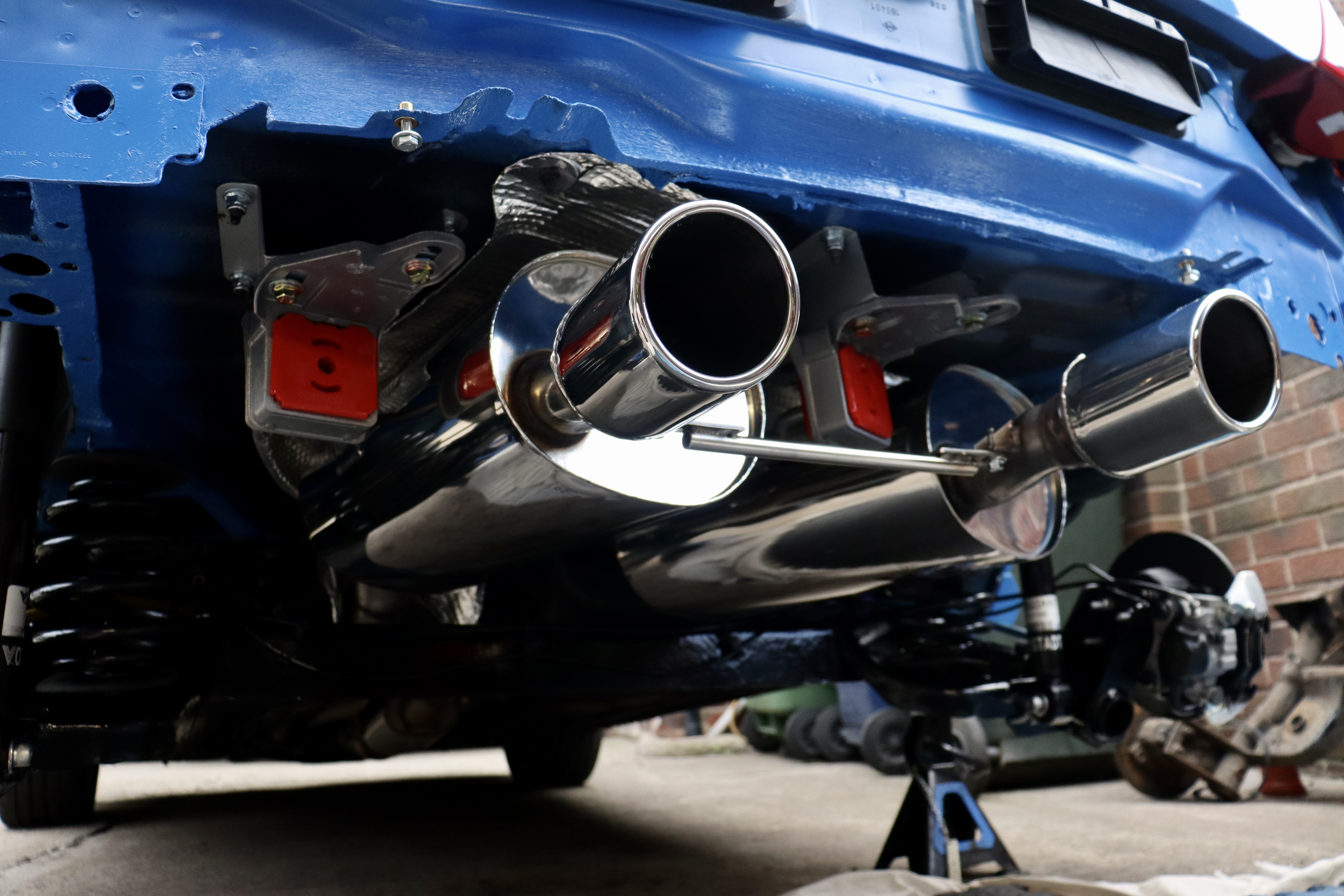

  • Removed, cleaned, polished and refit rear exhaust section
  • Replaced rear exhaust hanger mounts with Pro-am Racing stainless steel versions and applied additional paint and protection for longer life

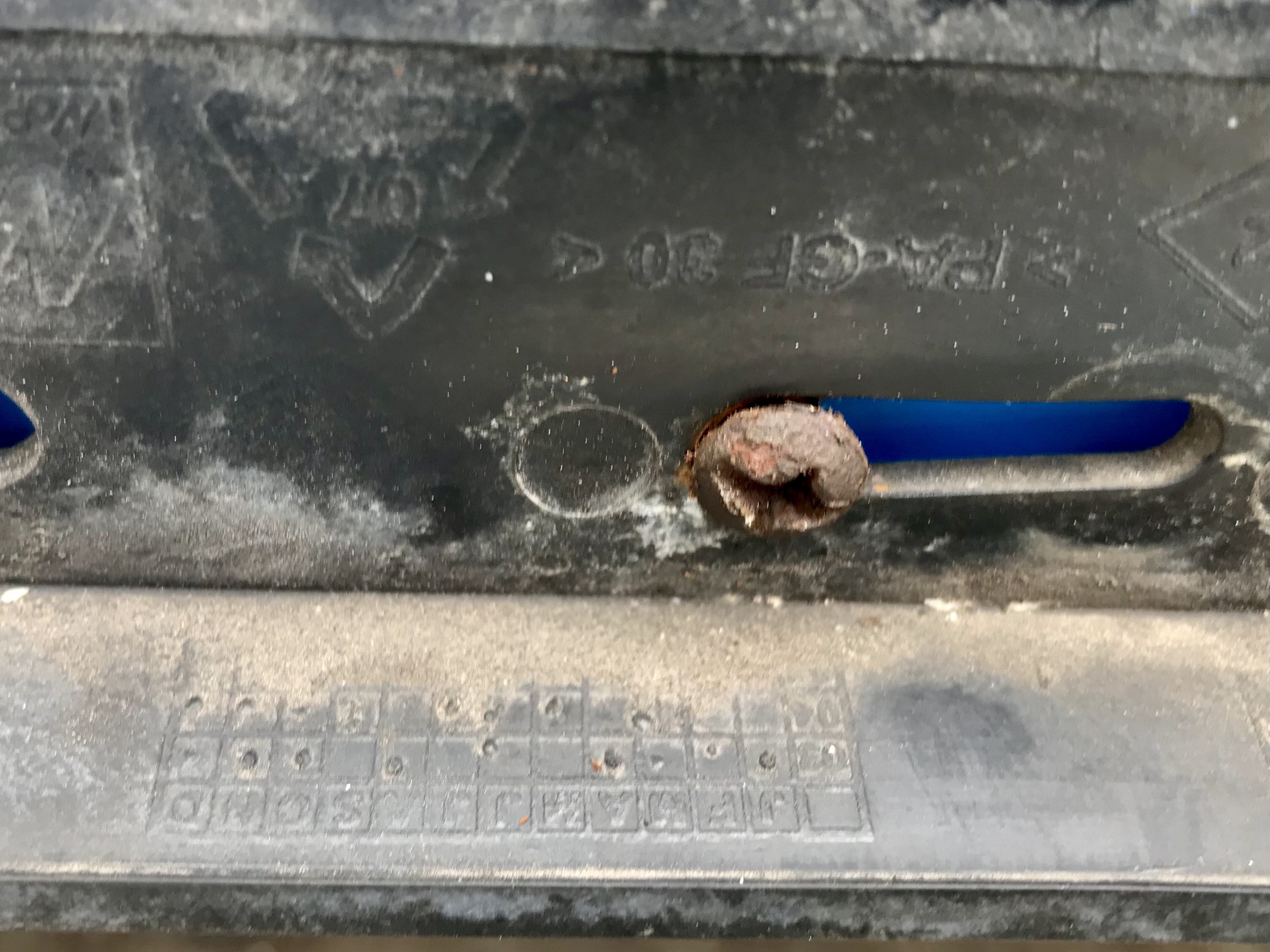

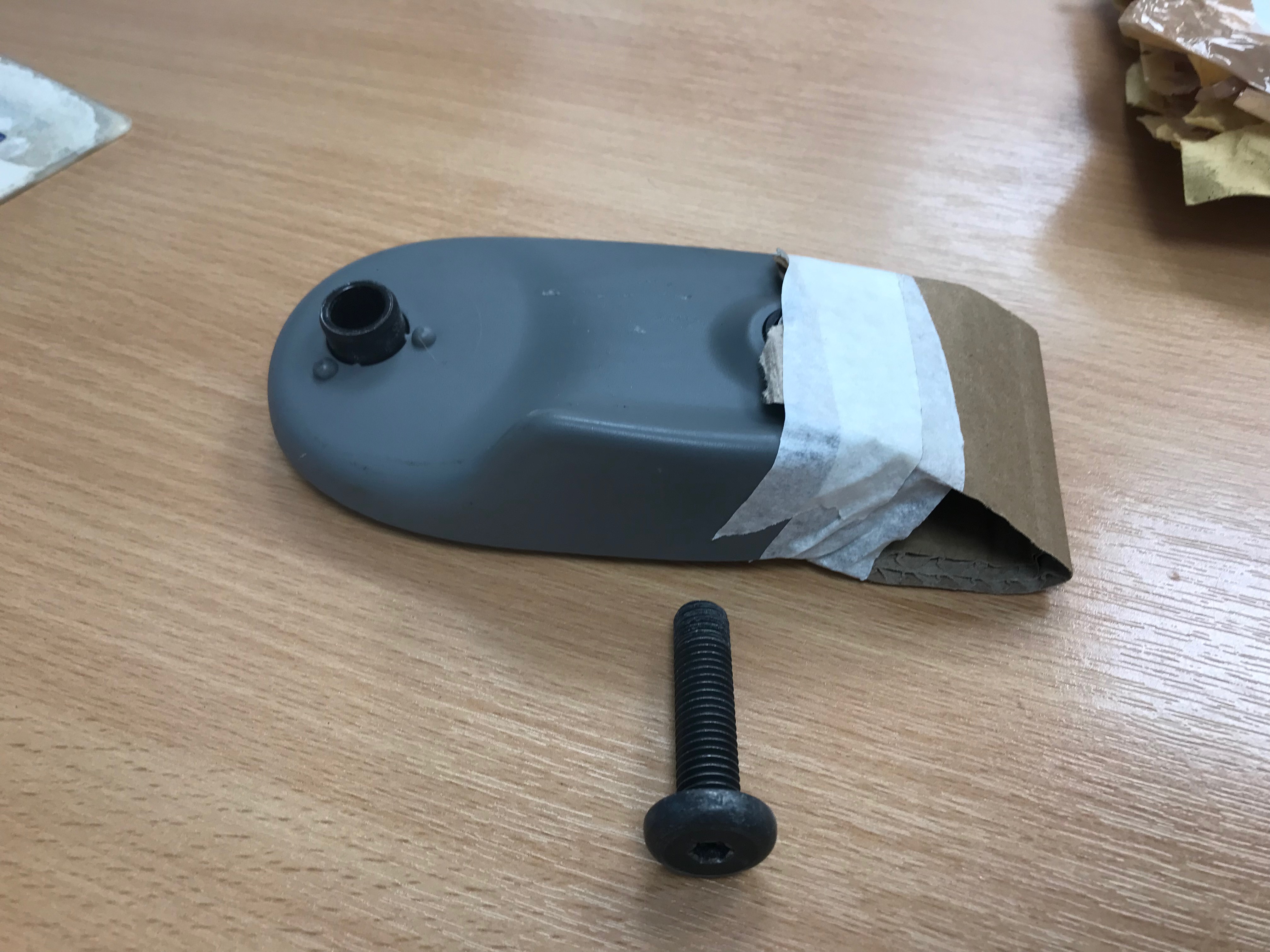

  • Removed lower body kit, cleaned, repaired and applied some paintwork - these are getting completely replaced
  • Removed old rusty screws and replaced with Black rivets

  • Complete restoration of the inner arches, chassis legs, in and around headlamp area and pretty much everywhere else
  • Descaled, degreased, application of DEOX-Gel, followed by several coats of Hydrate-80, followed by Electrox Primer then finally repainted in Racing Blue

I use a lad called Wayne in Stockton. He has a Facebook page called Aquablasting UK. Very good and quick turnaround.

Ahh great I’ll look him up cheers! Need to tidy my engine bay up. Yes it probably was me as I live just off McMullen road, I’ll keep an eye out for you in future, don’t see many 172/182s around town [emoji1360]
Last few jobs over the weekend building the arches back up and fitting a couple of captive bolts to the subframe.
It’ll save me a lot of pain later should I need to remove it again.
Tidied up the inner wheel arch protectors then refitted to the freshly painted arches. Pretty pleased with how it looks although won’t stay clean very long 😂
Ran out of time with other things going on, but got a few brackets back on the engine, dropped the oil and stuck a new genuine oil filter on. I’ll build it all back up through the week after work, so hopefully I’ll be able to get the engine back in next weekend.
Appreciate all the kind words and thanks for reading 😊
A few more engine brackets arrived on Tuesday from Aqua Blasting, so I put a few late shifts in after work to build the engine back up.
It’s not perfect and had to paint the alternator and air-con compressor due to time constraints - major building work to the house at end of Jan).
But it’s clean, tidy and oil free. Hoping to get the rest build up so I can get the engine back in this weekend - weather permitting.
