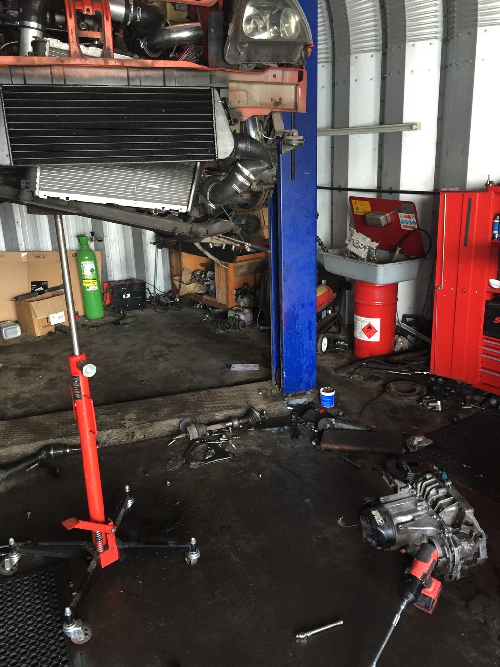

Did a little bit of work on the Clio today with the help of @Dan@SJM and @Dan The Top Bloke sorting out an oil leak and coolant leak. Oil was leaking from the crank oil seal between the block and the box, so this meant gearbox out to replace the seal. Also this gave us a good chance to check things and everything looked good.

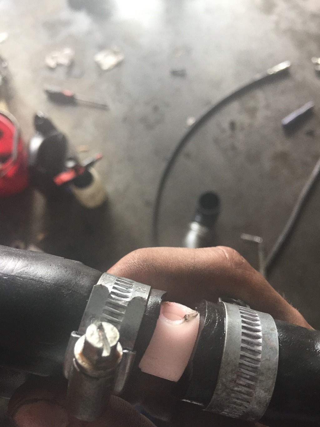

Then it was the coolant leak to fix, and this was relatively easy to find. Where I had cut into the coolant pipe to put a T-piece in for the turbo coolant return, the plastic t-piece had snapped in the hose causing it leak.

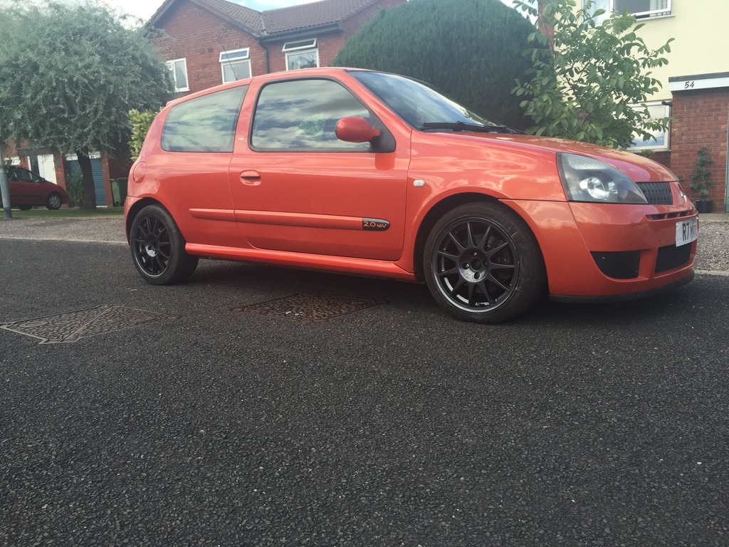

I then put my wheels on that I'd recently got back from refurbishment and I'm very pleased. Only downside is the car is still weeping oil, but we think this is the sump gasket now.. I did it up to tight! But at the end of the day this has been a massive learning experience for me so I didn't expect it to all be spot on at first.
