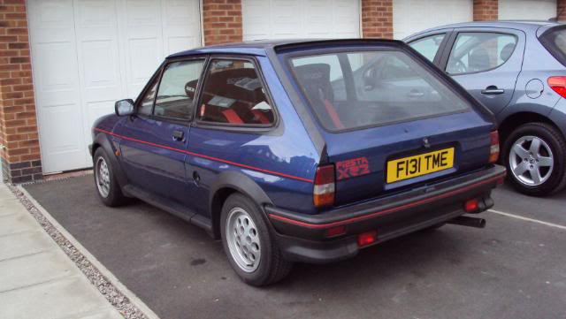

Riggers' Mk2 Xr2 project...

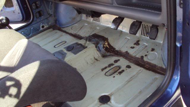

Looks like the rust has started going through on the bottom right...id get it all wire brushed back and treated ASAP lol
Il have a proper look next time I see it and see how bad it is before I suggest anything, lol.
C'mon it aint that bad lol!

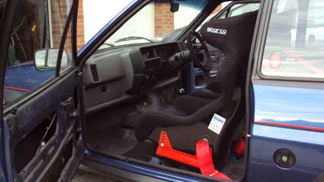

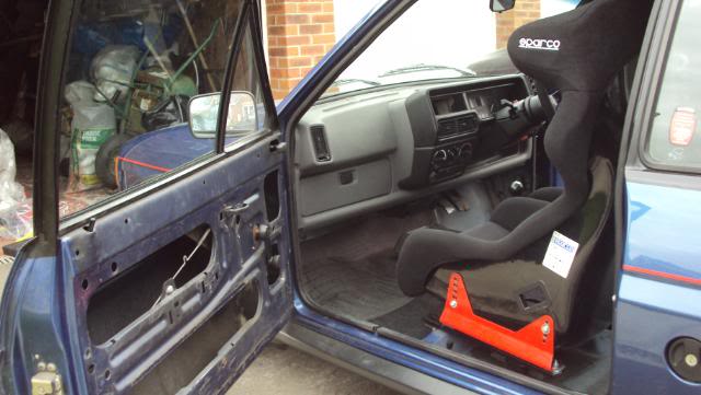

Got the square 5mm washers i needed to fit the buckets, so... -

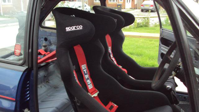

didnt even have to drill one hole out like i had to on both my ZS', win!.. will get some better pics once i have the strut brace welded in as i cant use my harnesses until then...
also drilled the rivets out for the old door grab handles so this is how the doors look now ( VERY flexible!) -

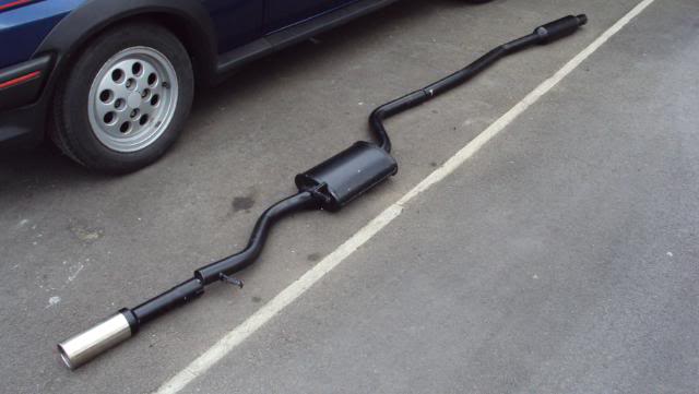

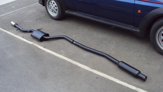

Collected the exhaust on the way home form work form the couriers -
Booked it at 3.30 on thursday at pipewerx to be fitted as it needs a flange to match the manifold and im also having a custom tip instead of that thing lol

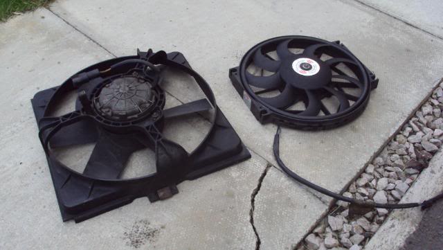

ties for the kenlowe fan also arrived today so... -

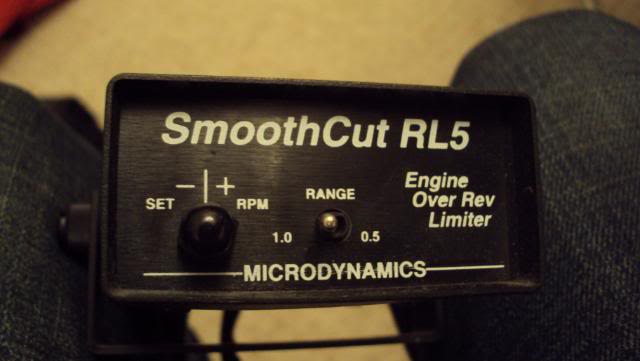

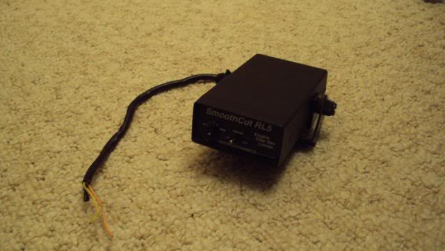

also buying a rev limiter of a guy of the xr2 forum as i think xr2s dont have a limiter at all and i want to be safe...

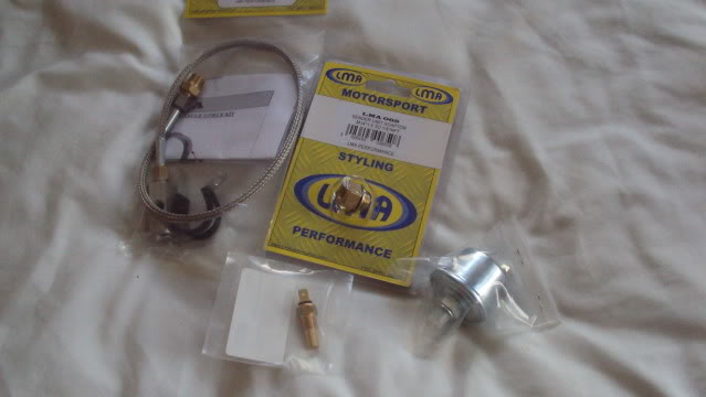

also ordered new adapters, sendors, T-peice and flexi from Jon @ Shawspeed too so i can fit my gauges to see whats what with the cvh.
Just got back form bolton, been to pick up a rev limiter off a guy who races in the XR challenge off the xrtwo forum, had a good chat to him about racing, xr2's learnt quite abit.
will be getting wired in sometime with help form f0xy along with the gauges once the senders arrive, will just do the 3 at once should only talke a few hours if that.

They dont have a limiter as standard, and if you have a good one they do rev well, but there isnt muxh point in going over 6500

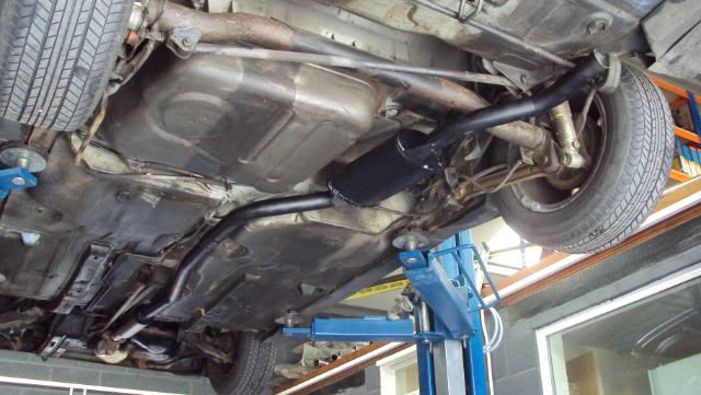

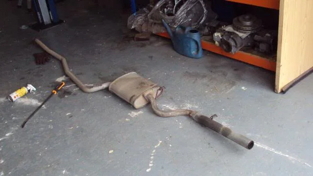

Went to Pipewerx earlier had my exhaust fitted...

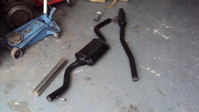

New exhaut with chosen pipe for tip (2.25") -

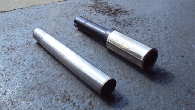

Compared new pipe to the tip that came with the system -

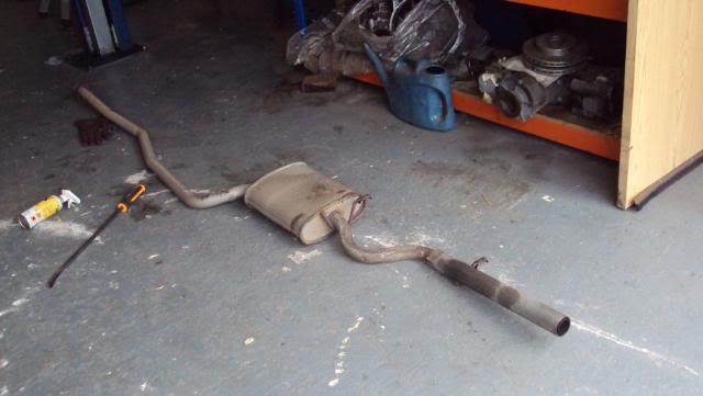

Old system off -

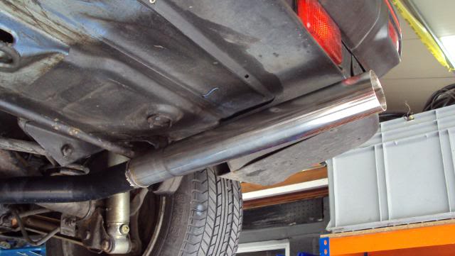

New one fitted without tip -
Tip fitted -

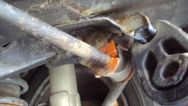

whilst the car was up in the air i checked all under the car and the bushes... everything seemed to be fine apart form the rear ARB bushes -
good job the lad who i bought the car off gave me 2 spare, now i know why he had them spare as i take it he couldnt be arsed to fit them lol...

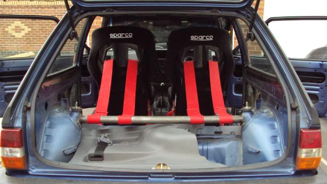

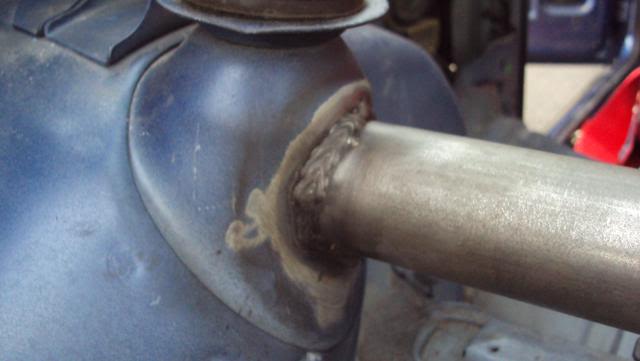

Rear strut barce welded in -

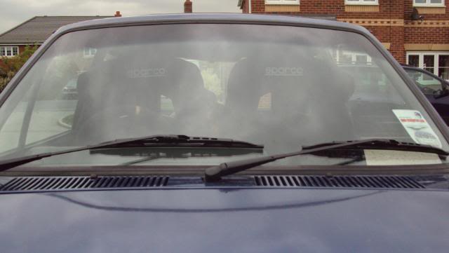

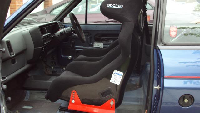

Then when i came home i fitted my harnesses and lowered the seats a notch :D -
another good days progress... next on the list is removing the sound deadening!

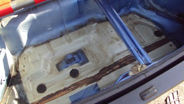

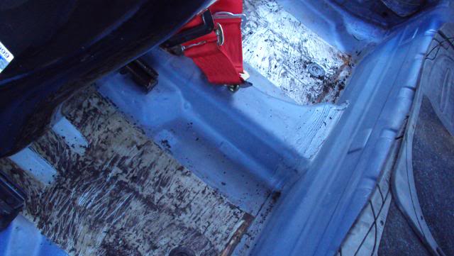

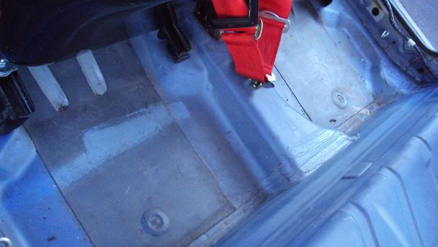

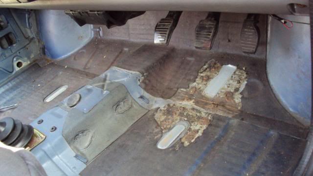

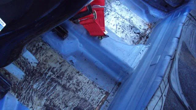

front footwells before -
after -
rear footwells before -
after -

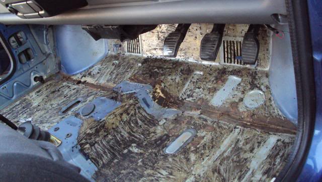

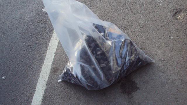

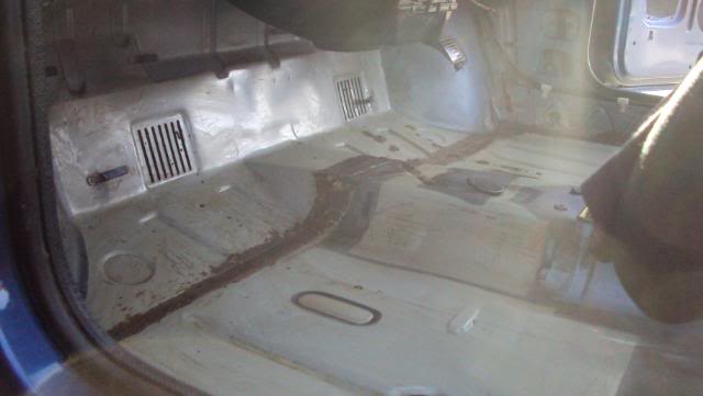

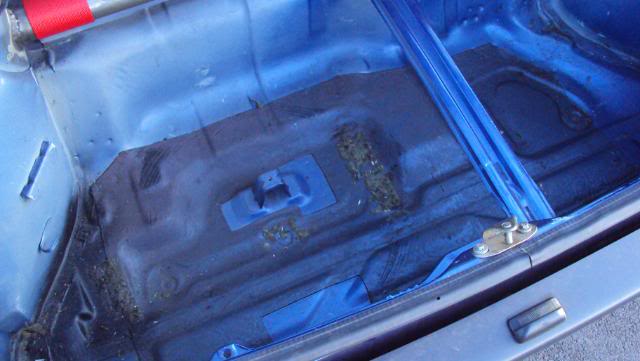

so far removed -
left to do -
once ive removed that last lot in the boot ill re-heat it all back up and go over it with some white spirit and a cloth ready for paint.
Love this. Brilliant project!
Cheers :D
Fooooook me thats a lot or tar. you'll have to weigh it all :)
Did earlier, 4.5kgs in total!...
When i got home form work spent a couple of hours removing the rest of the sound deadening and cleaning it all off with some white spirit...
Nearly there just need to do the rear footwells but ill do them when i remove the seats to paint it all...

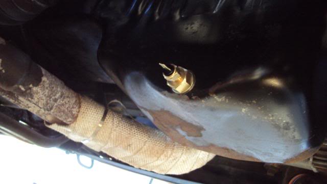

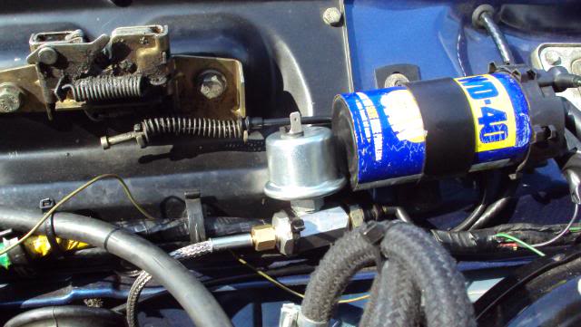

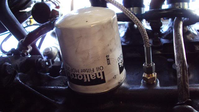

Just got some Mobil 1 15w40 and a filter so thatll be getting done tmoz along with fitting my new Oil pressure & temp. senders etc -

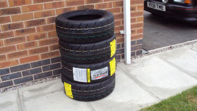

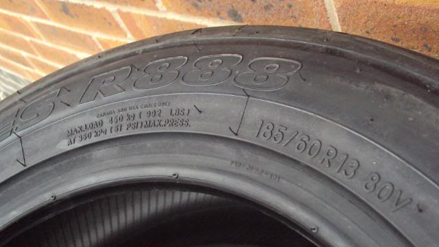

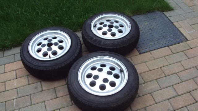

Also just bought some R888s, brand new for 262quid delivered, 13s FTW :approve:
Oil and filter changed and senders, T piece and flexi fitted -
Where i decided to mount the pressure sender, nice and accesible -
