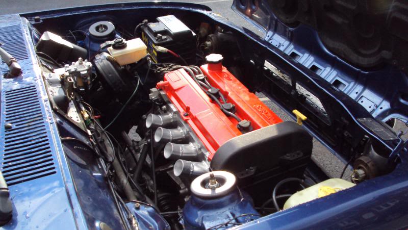

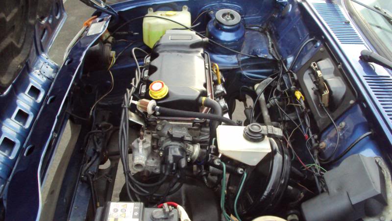

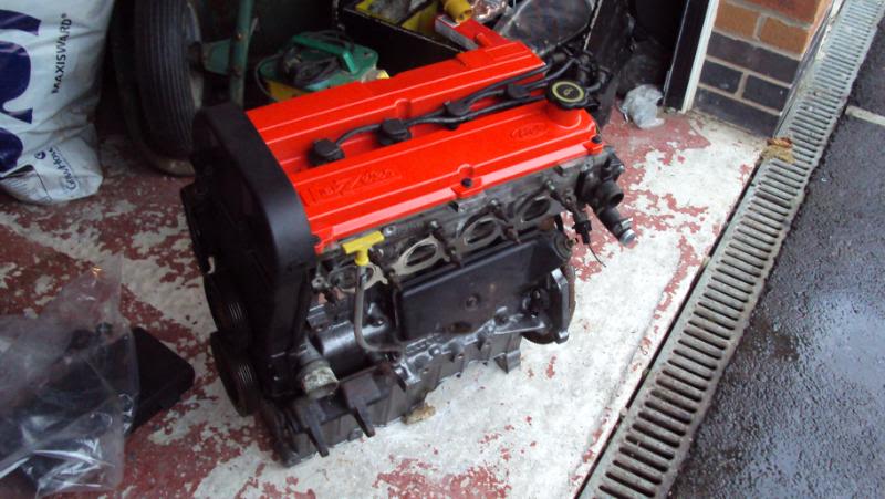

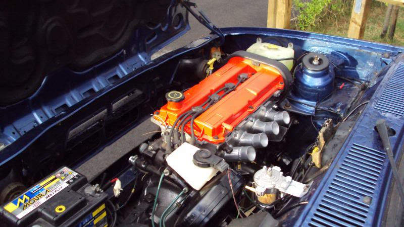

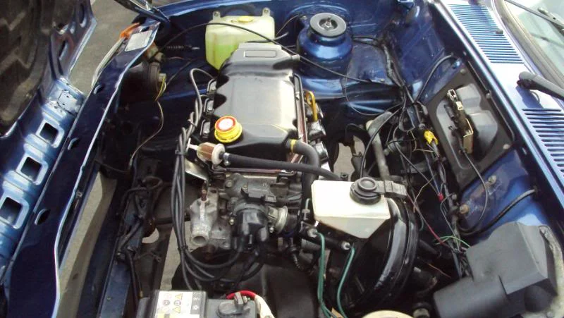

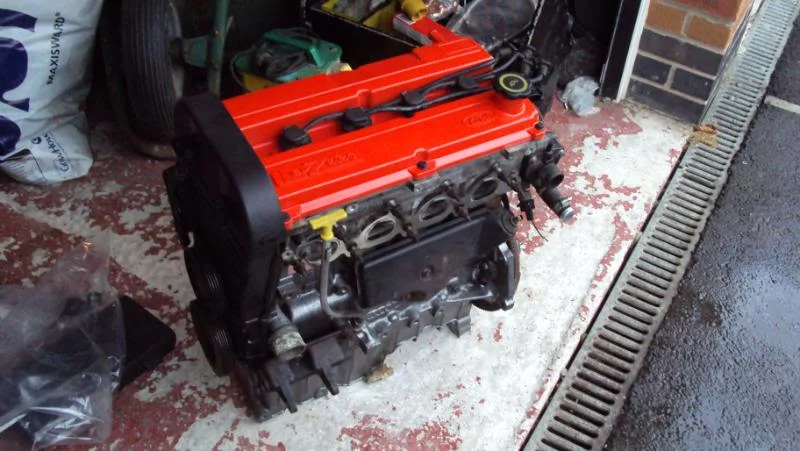

Tried the clutch before to make sure it 100% fitted the 1800 flywheel and it does so when jon comes to time the cams up ill ask him to take the flywhell away to be lightened and balanced...

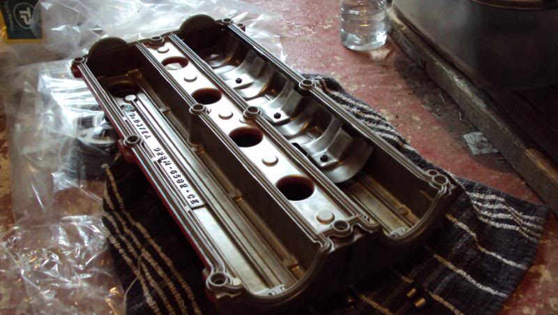

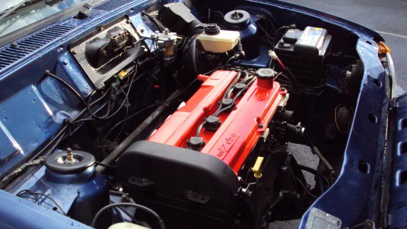

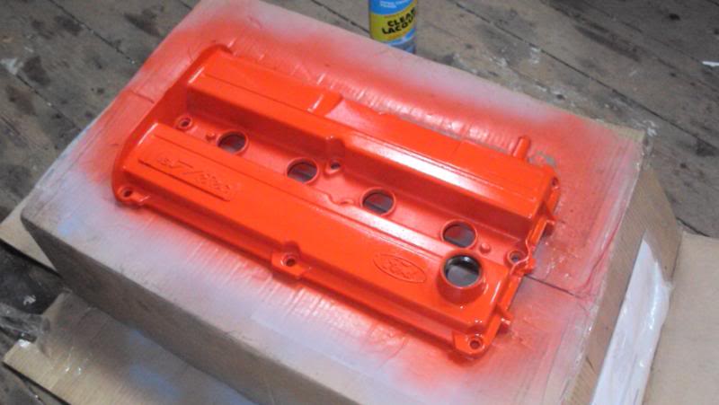

Laquered the rocker cover so now its finished -
This image has been resized. Click this bar to view the full image. The original image is sized 800x451.
looks really bright in the pics because of the flash buit it ios the perfect shade of red i was after!

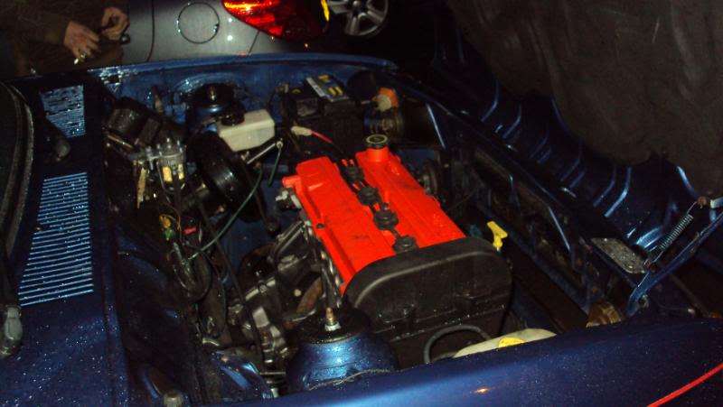

block and sump painted... before -
now -

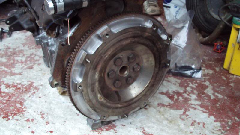

Also dropped the Flywheel off at Shawspeed on thursday for jon to send it away to get lightened and balanced as they weigh 8kgs as standard lol

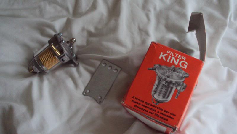

and Jon has ordered me a Filter king fuel pressure regulator/filter instead of my random seperat ones i have atm.

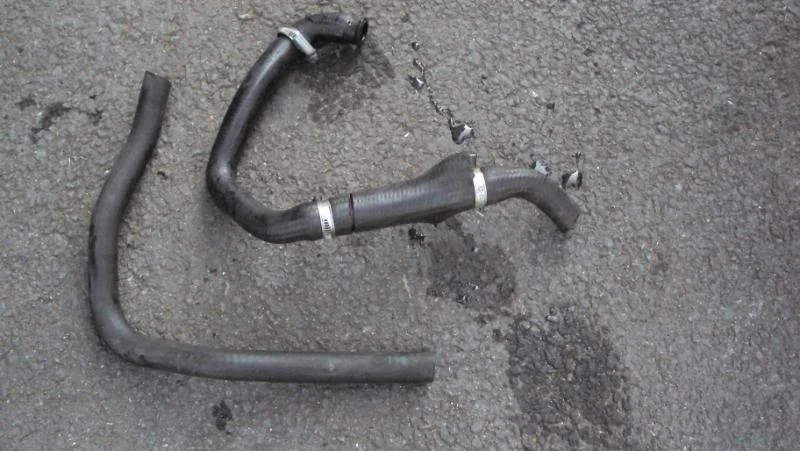

changed that hose... old vs new -

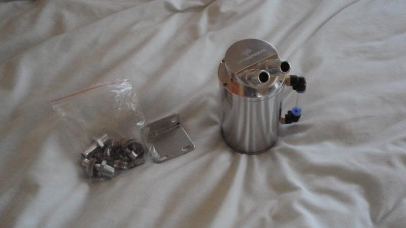

catch tank arrived today -
wont be fitting it till the zetecs in...

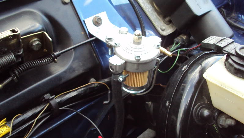

Got the new fuel pressure reg. & filter copmbined last night -

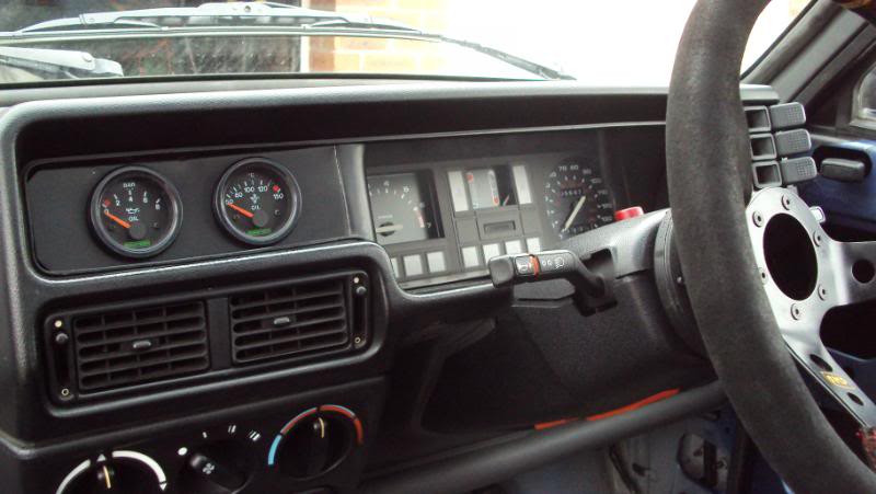

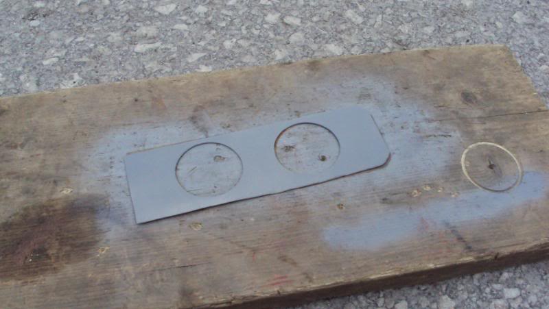

thought id make most of the afternoon today as i finished work at 2 so decided id make the new ally plate for the gauges which i had in my ZS (Oil pressure and temp.)...
cut to size, holes drilled with 51mm holesaw, sanded and primered -
painted Satin black and fitted -
looks right at home imo...
they're all wired up together they just need wiring to an earthing point, 12v inginition, illumination etc... will do that sometime soon hopefully when f0xy has a spare hour

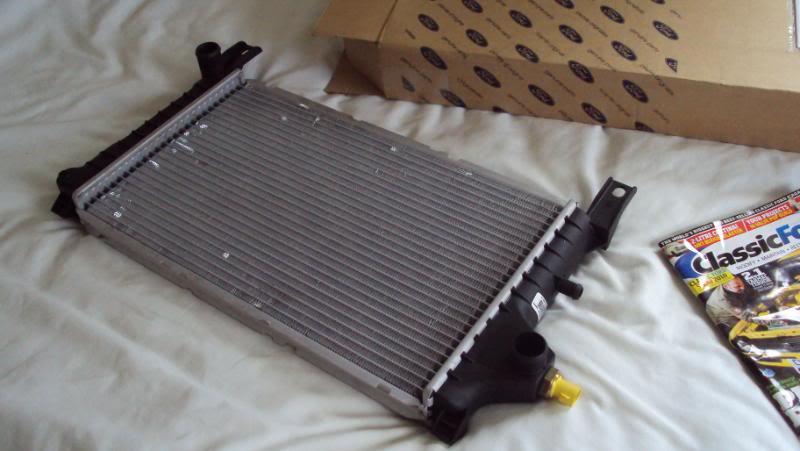

also just payed for the mk3 zetec radiator from al...

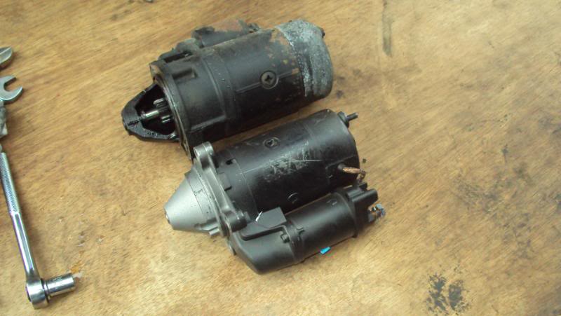

and bought myself a Brand new xr2i CVH starter motor as its a little shorter than the xr2 one so wont need to remove the ashely manifold if it ever fails like i would have to with a xr2 one.

Picked up the new Mk3 Zetec Radiator this morn -
another new item awaiting to go on, my rooms getting quite cluttered now lol
interiors in bits atm lol... just wired up the earth and senders for the gauges, doing the rest with f0xy tmoz and help with his soldering iron.

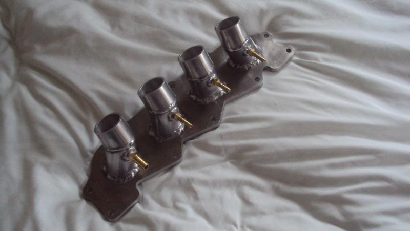

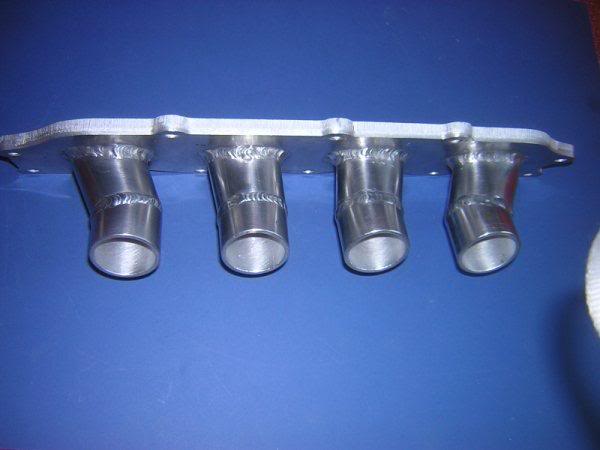

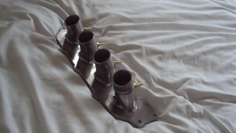

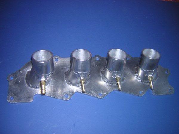

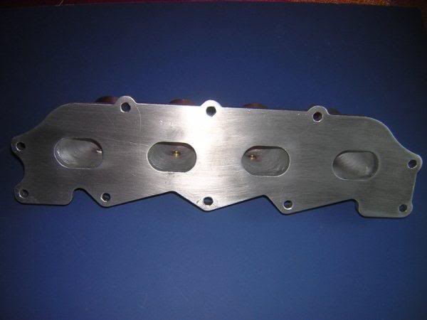

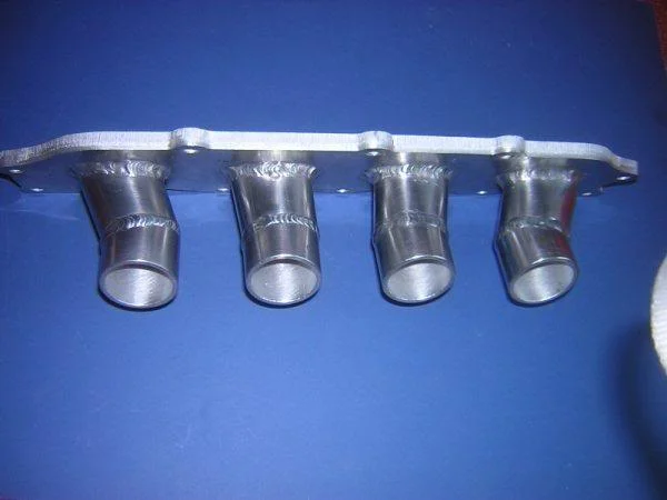

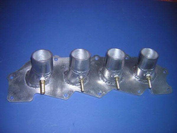

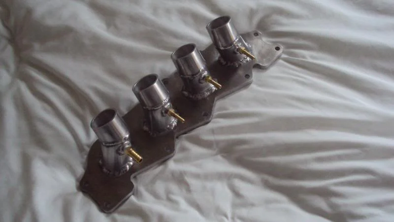

Had an E-mail the other day formt he guys whos been making me the inlet manifold up -
just payed for it, should be here early next week id imagine
also bought a top raditor hose that goes to the thermostat housing off a fiesta Si that turned up today too.
Just earthed the pressure sender and took the dash parts out ready to wire the gauges up mayeb later if not probs tmoz.

Gauges are wired up thanbks to help form f0xy

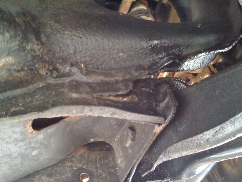

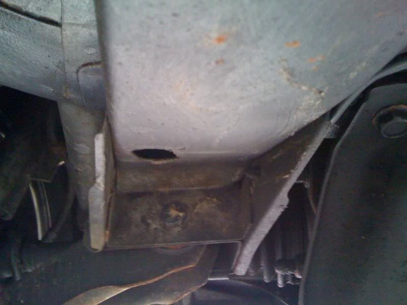

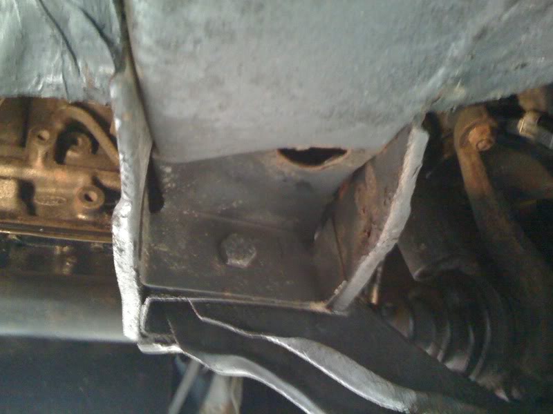

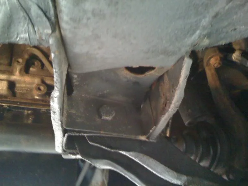

also had a moment with a curb on friday night and bent the rear beam and also done this to the chassis leg...
how it should be (near side) -
how the offside one is -
the guy at the body repair place said the chassis leg is very common to go on these as they are like the weakest point on the car...
and he just said get a new rear beam will i will done once the fornts sorted..
the guy said well if your planning on taking the engine out soon anyways itll be FAR easier and cheaper for me to remopve it and then let him take it form there, he said he'll come pick it up too which is a bonus just hope he can find a new chassis leg tho, im gonna do the rear beam once the fornts sorted and its 'driveable' again...

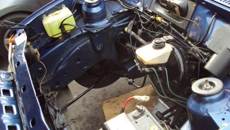

so the progress -

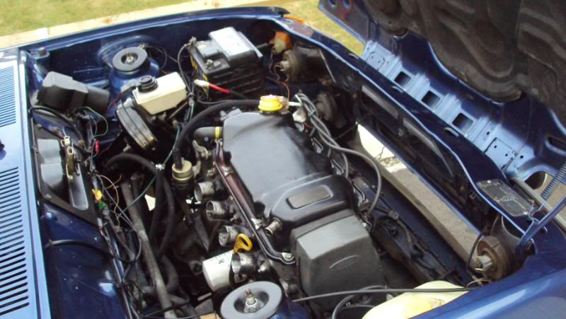

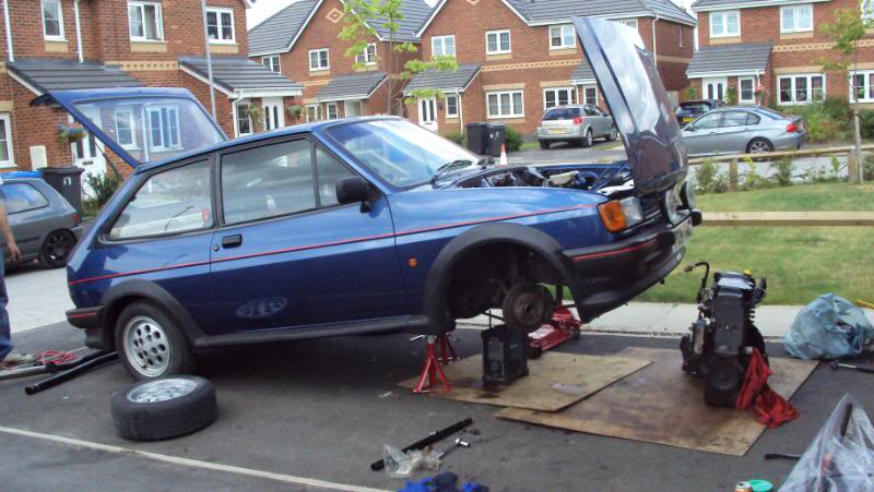

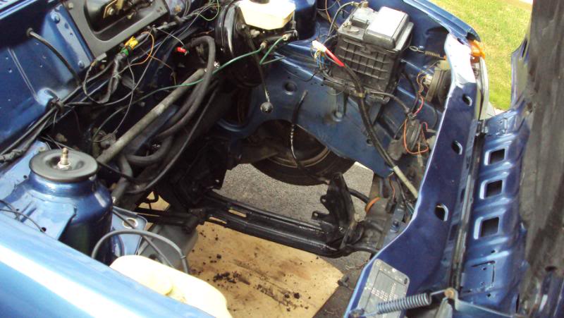

drained oil & coolant
re-fitted sump plug instead of the temp sensor
removed braided hose and oil press. sender
removed hoses, header tank and rad
removed carbs
removed coil pack
removed starter
remove alternator

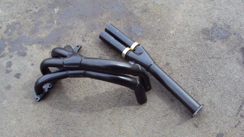

removed exhaust manifold and system
disconnected gear linkage and stabiliser bar
xr2 vs new xr2i starter-
Hopefully have the engine and box out tmoz or friday night :D

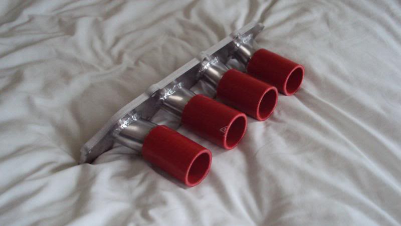

Had a nice package arrive today -
the guy has done a mint job!
ond the hoses i got obviously need cutting down to suit the room in the engine bay, probs have to knock off about 1'' off them.
also i got hold of a lower rad hose of a RS1800 too, that arrived today...

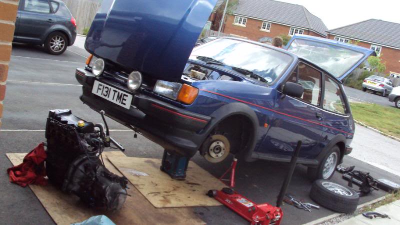

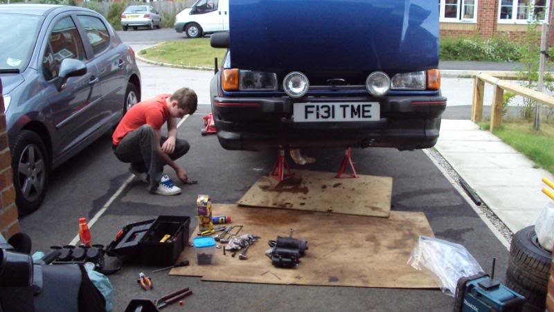

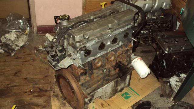

then got home called Jord and Bren for some help and we got the engine out after diconnecting the clutch cable and driveshafts we made it lol -
will be giving the bay a clean before the guy comes to pick it up monday morning :D

Went to ford yesterday and bought/ordered a RS1800 inlet manifold gasket and some new pinch bolts, going to collect them thursday once im back for Cadwell.

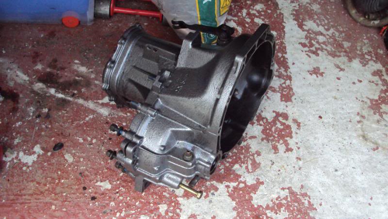

also gave the Gearbox a lick of paint last night -

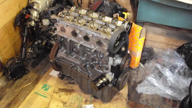

then went to jords factory to fit the alternator bracket onto the 1800 and fit the zetec alternator pulley onto the CVH alternator as thats what im going to use over the zetec one as its lighter, no need to alter wiring and can use a shorter belt therefore mpre clearenece between the alternator and the fornt crossmember...

That inlet Mani looks cool :)
Oooops about the little curb eating :S
yeh its awesome mate cant wait till its on

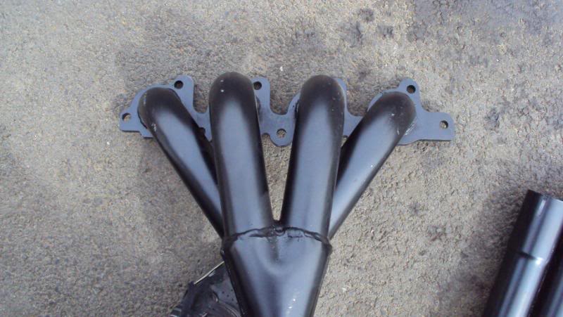

Fitted the Filter king fuel pressure reg/filter yesterday after modifying the plate that comes with it -

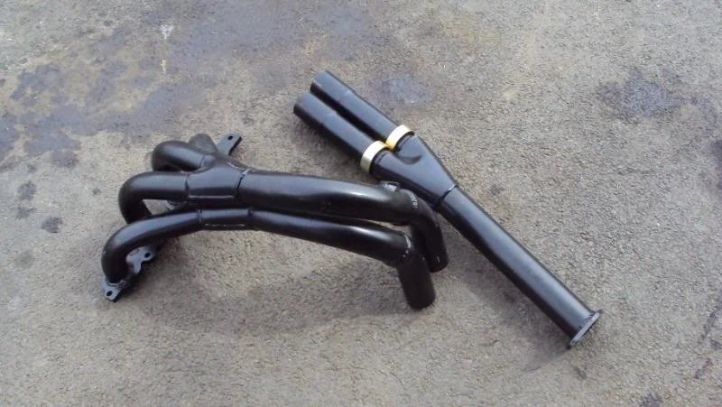

Exhaust manifold should be here tmoz.
Ordered a aluminium blank, three pipe joiners and one reducer earlier to complete the coolant side of things, shoudl be here tmoz too

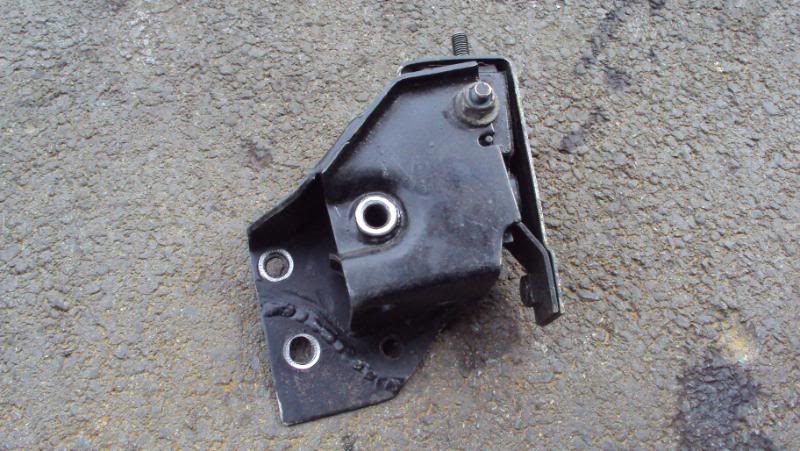

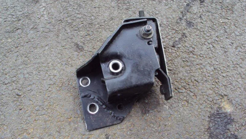

still waiting on the cvh.zetec engine mount to arrive.
  JDM Dc2
Looking good! Hate FPR's though, lovely tendency to adjust themselves :)
tighten them up then lol
Ashley manifold has arrived -
as has the engine mount -

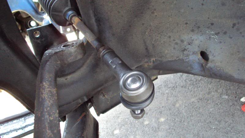

Got the car back this morning...

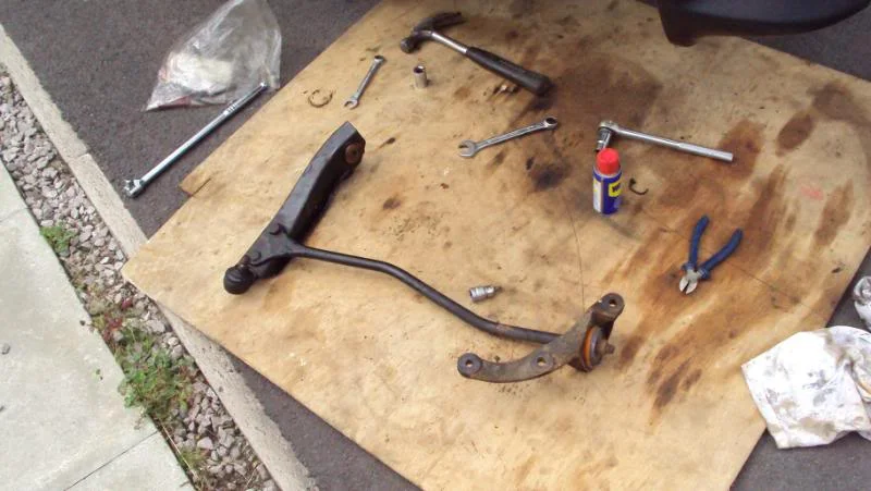

straight away jacked the car up, fitted the new track rod ends onto the rack -

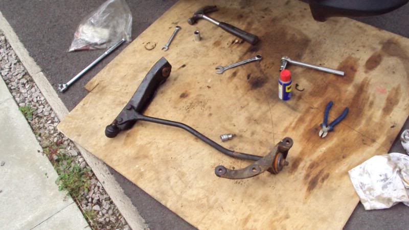

then took the offside ball joint/lower arm/tie bar off as one side needs to be to get clearence to fit the zetec -

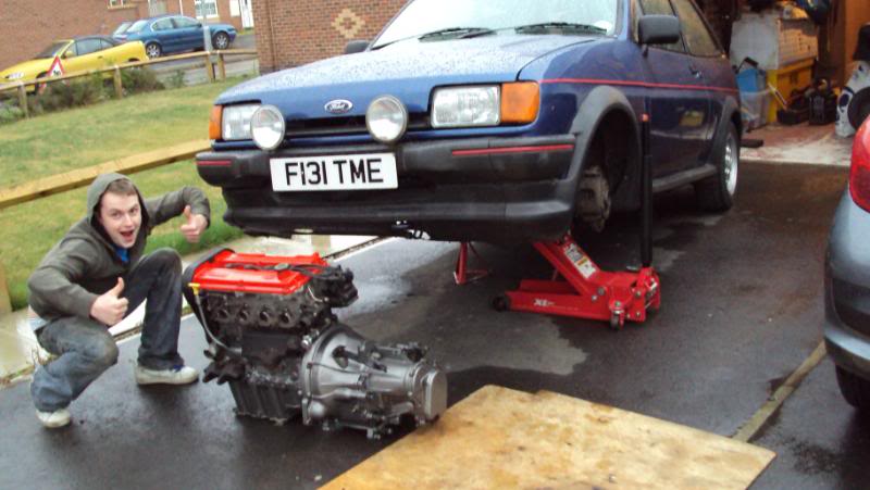

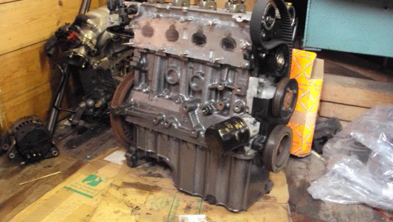

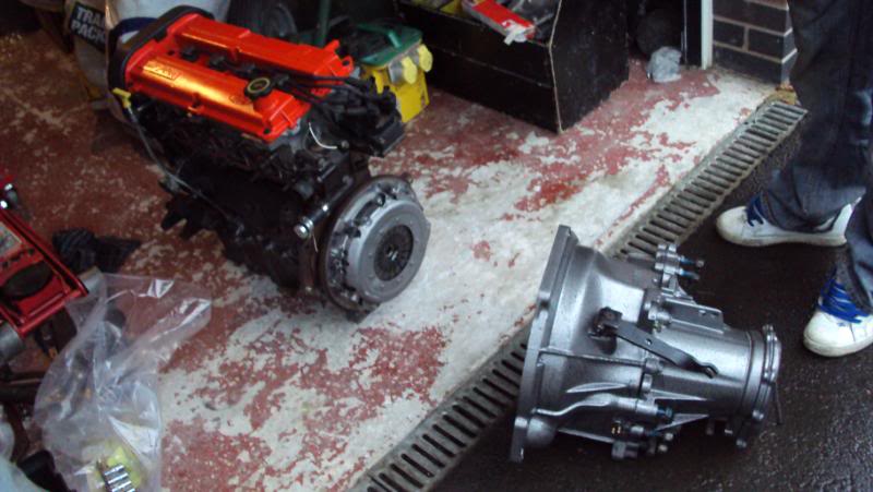

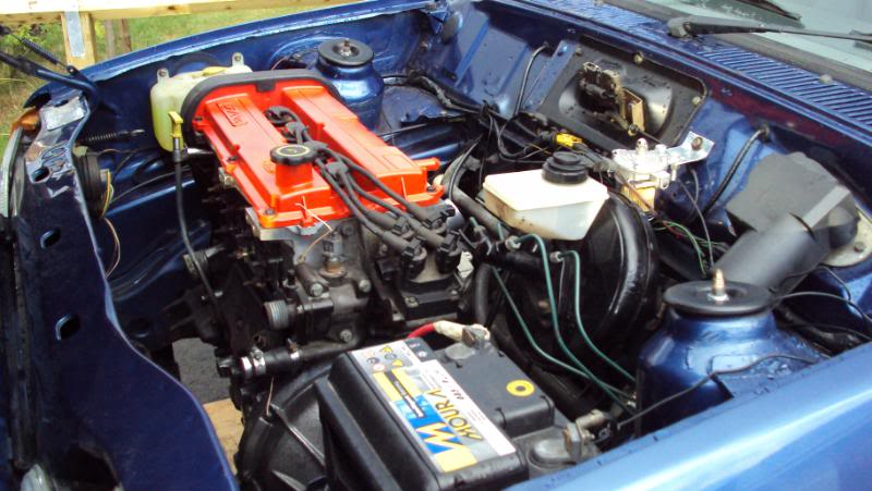

Jon from Shawspeed came round around 6is last night, got the cams in timed up etc... then i fitted new rocker cover gasket -
then cam belt cover on, new NGK plugs and fitted the leads -

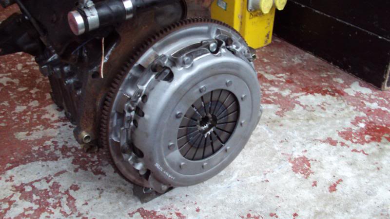

flywheel on -
clutch on -
New helix release bearing fited and box ready to go on -
box on and dragged round to the front of the car with some idiot -
about an hour our later after getting VERY wet we got it in, sorry for the pic as it was taken at like 10 last night lol -
and just been dodgeing the rain for the past 2 hours...
progress is... Driveshafts are on, track rod ends are on, nearside ball joint is on, gear linkage is done, speedo cable is done, went over all the engine mounts again with my socket to make sure everythings tight...
once the rain stops/basically tmoz ill get the offside ball joint/lower arm back on, exhaust manifold on, starter on, oil temp and prssure sensirs done depending on the weather maybe more
