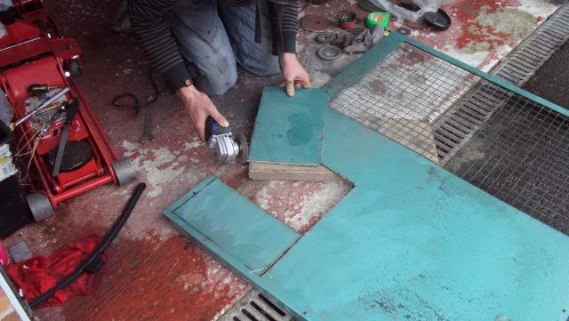

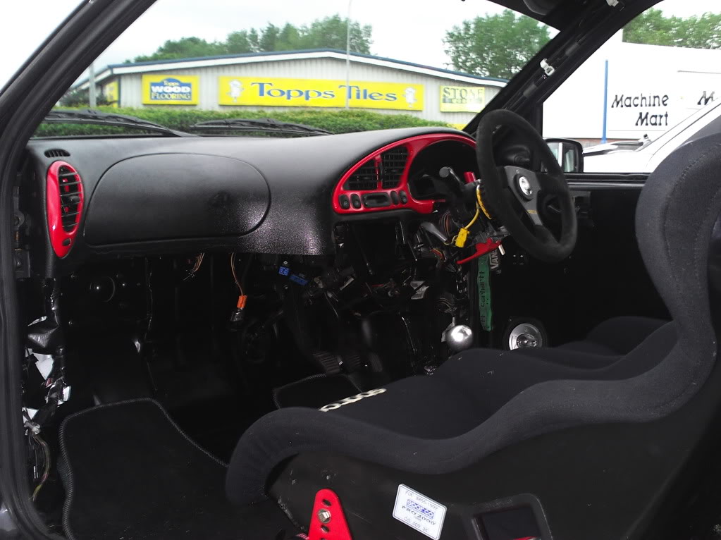

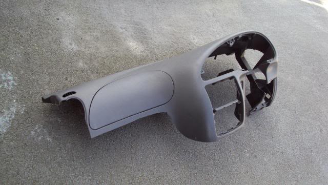

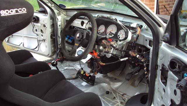

Plan on making a front section to the cage soon maybe after Oulton so thought id get the dash cut ready and i chopped some more stuff out whilst i was at it...
Out -
Even lighter cut down dash -
Removed...
How it stands -

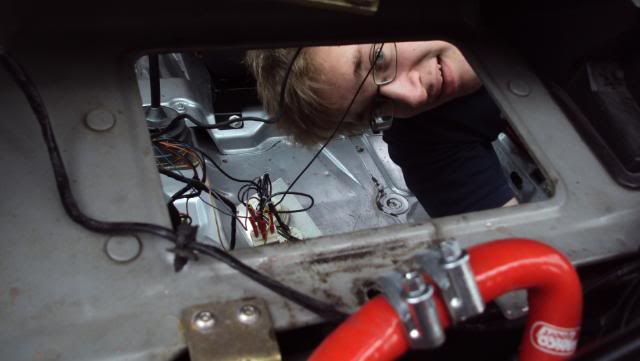

dash will be getting put back in when the loom has been sorted (where the Omex links on to the standard ecu, replace the crimps and solder and heat shrink all the wires with f0xys help).
  JDM Dc2

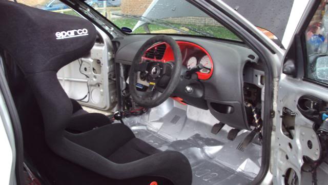

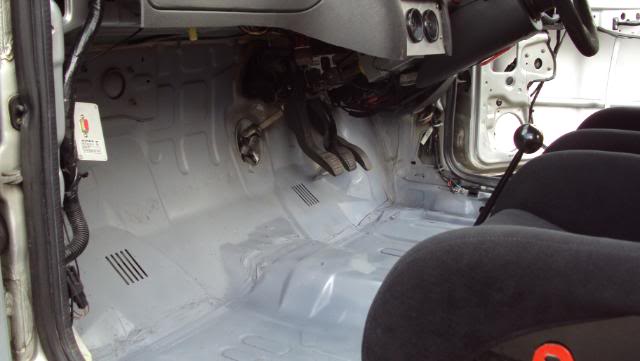

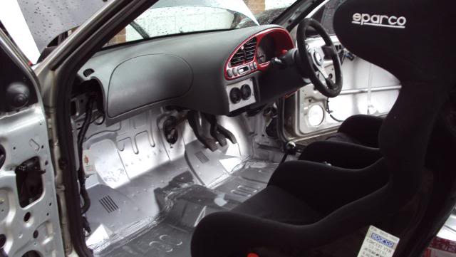

Dash is all back in, will get pics up when it stops raining, its flimsy as hell now, love it! must weigh like 3kgs MAX all in with the gauges, dials and heater control panel and vents etc...

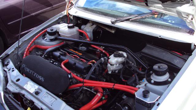

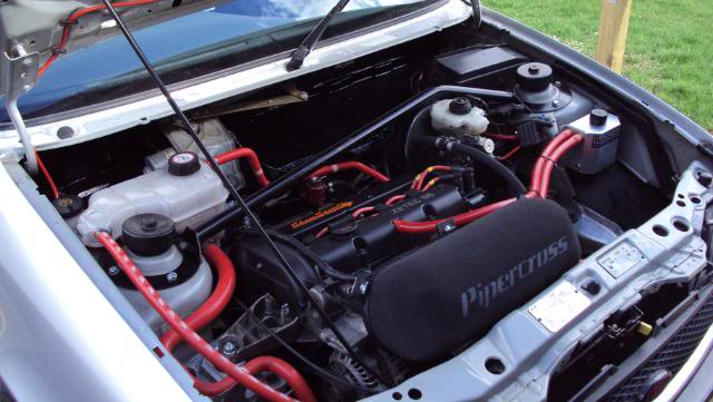

current spec list and plans -

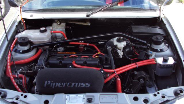

Engine :
  • 1600 Zetec SE;
  • Jenvey 42mm DTH tapered throttle bodies, 45x90mm trumpets;
  • Pico 330cc injectors;
  • Omex 600 ECU with rev limit set at 8k;
  • Shawspeed SS4 cams;
  • Big Valve head;
  • HD Piper valve springs;
  • Shawspeed HD big end bolts;
  • Shawspeed Baffled sump;
  • Webber 3.5bar fuel pressure regulator;
  • Magnacor 8.5mm HT leads;
  • Pipercross 600 series filter (125mm internal);
  • Mocal 13-row Oil cooler;
  • Mocal Oil catch tank;
  • Kenlowe lightweight cooling fan;
  • Removed PAS & AC;
  • Samco hoses;
  • Milltek 4-2-1 manifold;
  • Custom 2.25" De-Cat;
  • Piper Decat-Back with mid-box removed and custom 2.5" tip;
  • FRP gearbox;
  • Shawspeed lightened flywheel;
  • Helix Organic clutch;
  • Vibratechnics engine & gearbox mounts all-round...
Mapped - 166bhp @ 7.7k, 121lbs/ft @ 6k...

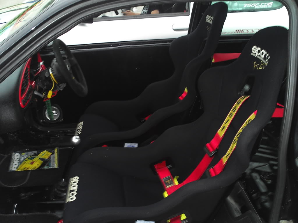

Interior:

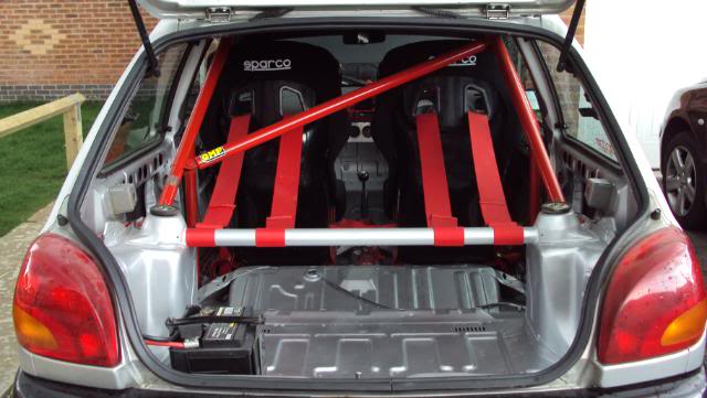

  • Fully Stripped apart from lightened dash and heater;
  • Lightened doors and bootlid;
  • OMP half cage welded in;
  • Sparco Circuit fibreglass buckets with head restraints;
  • Modified OMP subframes;
  • TRS 4-point 3" all round harnesses;
  • Oil temp. and Pressure gauges;
  • Sparco steering wheel;
  • 8 ball gear knob;
  • Hand-held fire extinguisher;
  • Battery.
Weighs 875kgs... 166bhp/875kgs = 190 bhp/tonne.

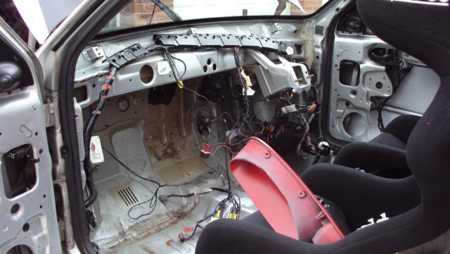

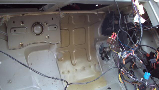

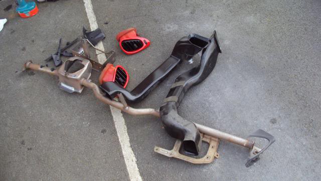

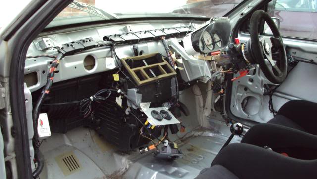

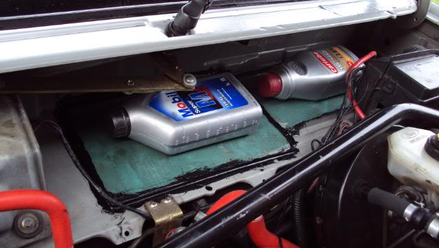

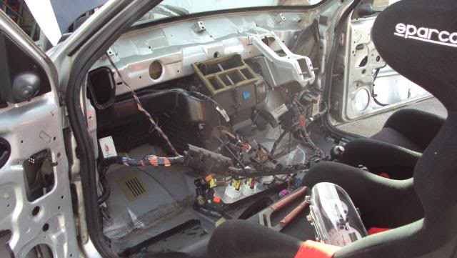

Dash out AGAIN & heater matrix -
Rest of the sound deadening -

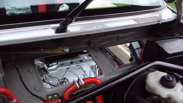

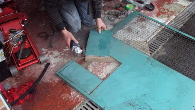

Blanking plates cut out of some random steel f0xy had lying around lol -
Tiger sealed in -

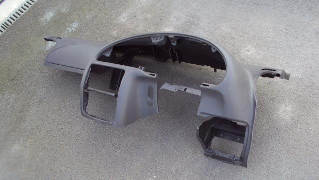

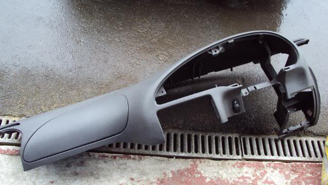

Dash cut down even more -

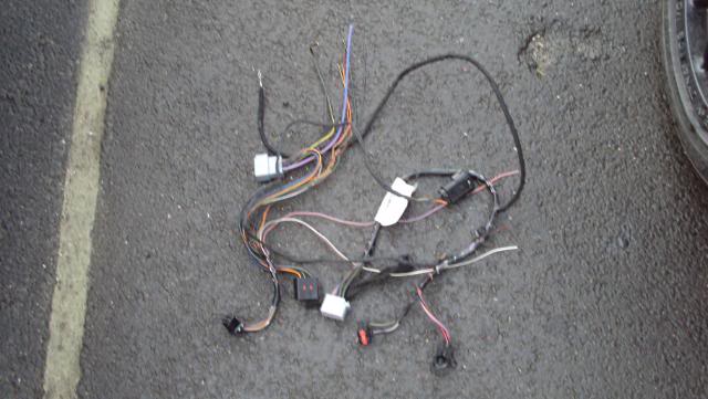

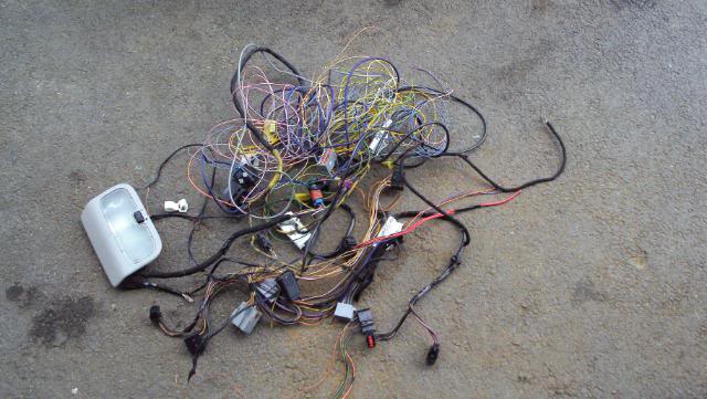

Now when it stpos raining need to cut down more of the loom thats not needed, then re-spray the interior and hoover all the **** up from grinding the lip down of the pollen filter hole... then re-fit the dash again then paint the bulk head once the tiger seals dried.
  JDM Dc2

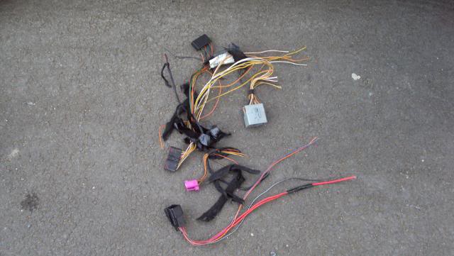

Cut down even mpore off the loom -
Total amount of wires thats been cutt off lol -
Dash in then hoovered and primered -
Whilst that was drying went to get some aluminium coloured paint, sprayed

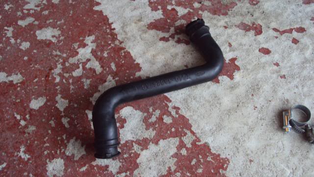

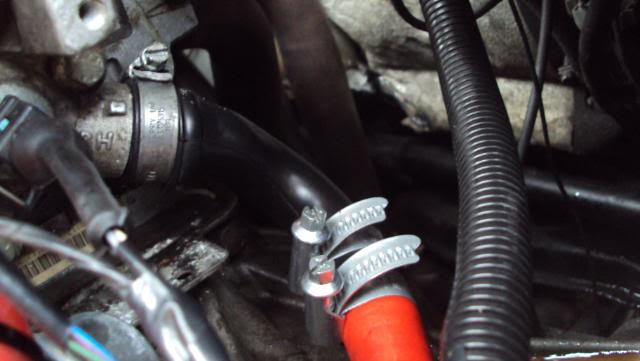

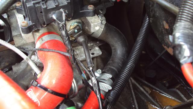

Whilst on the way to get some paint, nipped to a scrappy and got this hose off a mk4 TD lol -
Cut down to suit with adapter -
Fitted -

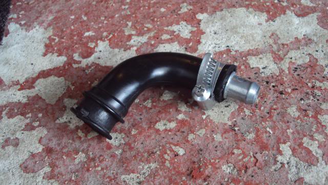

The thing is it was the breather hose on the Mk4 TD... so to make sure it didnt expload when i was driving, let the car warm up to 90degrees (oil) the fan had already been on 10mins before it reached 90degs... just wondering will it be okay to withstand the pressure with it being a breather hose instead of a coolant hose... there is no strain on it whatsoever...

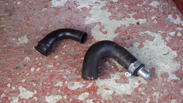

That hose should hold up if it's already took the pressure. Just keep an eye on it for the time being, check for any bulging when it's up to temperature.
replaced now ;)

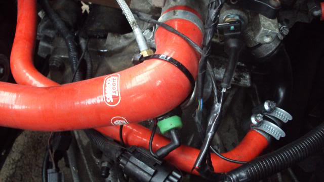

Got an old coolant hose off f0xy last night from his old F7P... breather hose on the left vs the new coolant hose on the right -
Fitted -
Let the car get upto temperature and bled the system, didnt seem to get quite as hot as that breather hose so seems a good choice to have replaced that
