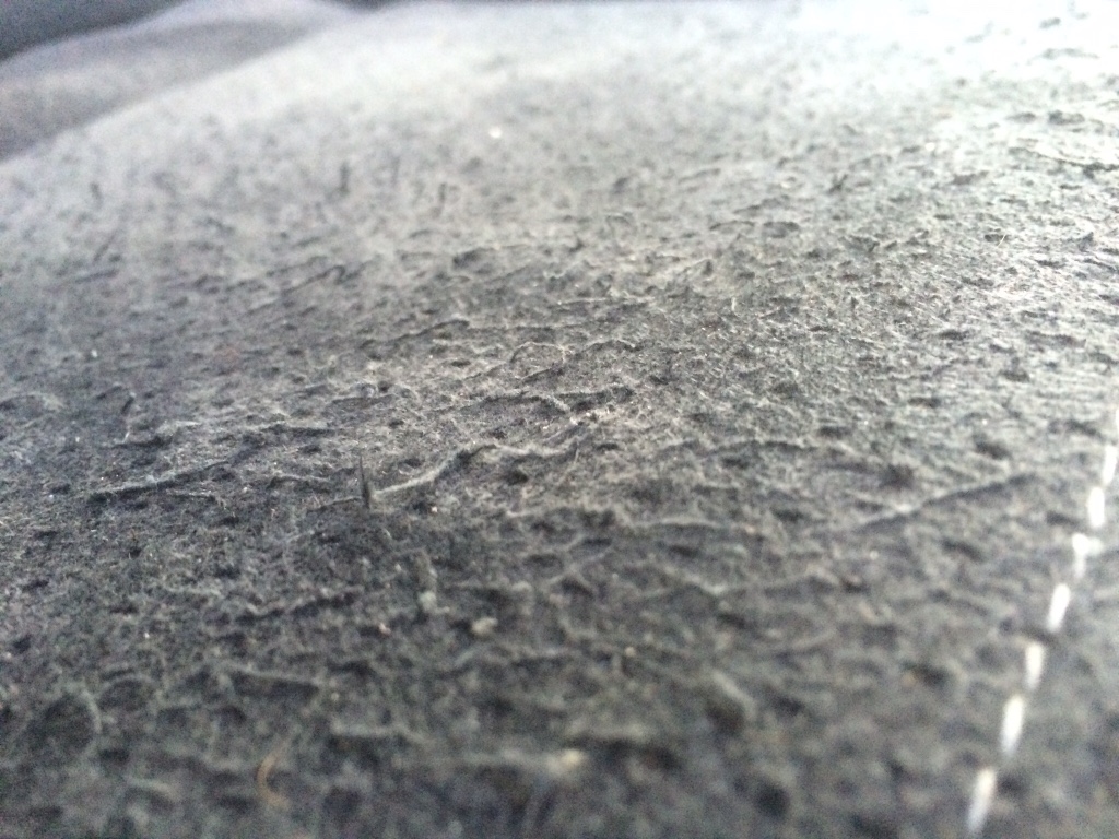

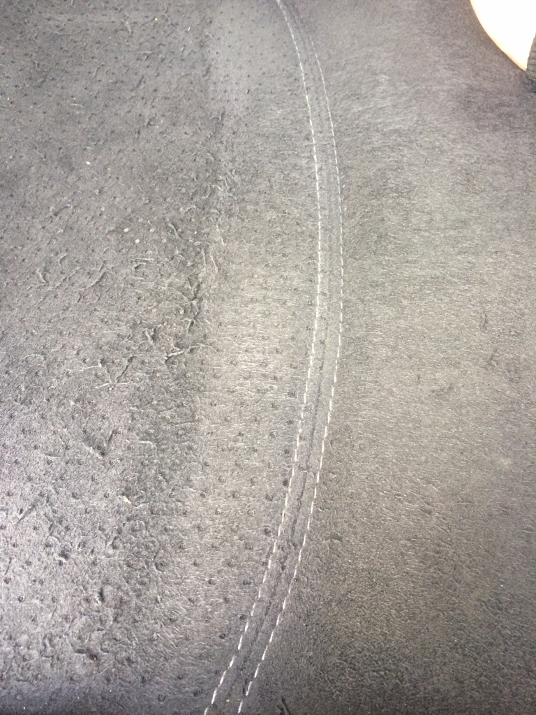

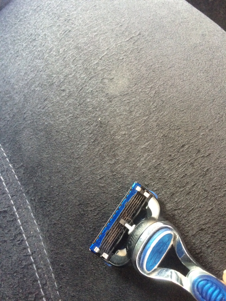

Got rid of this off the seats nicely
:D

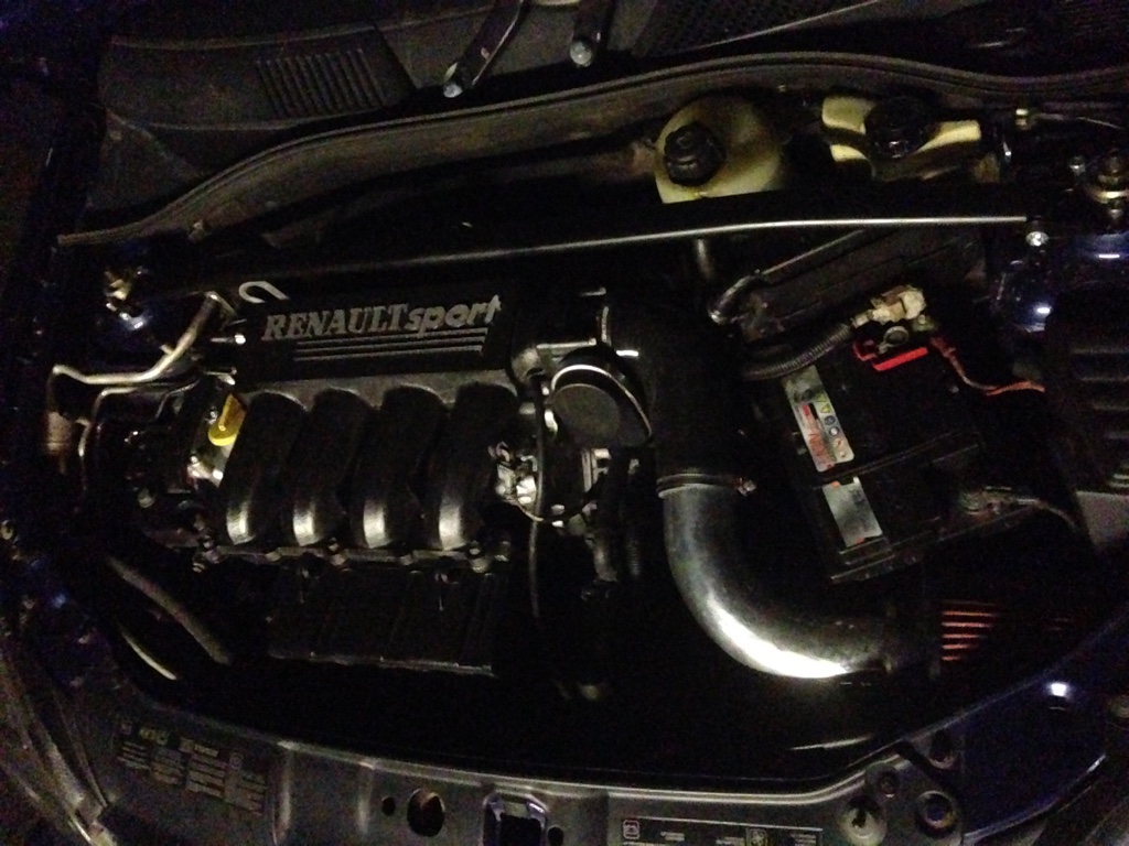

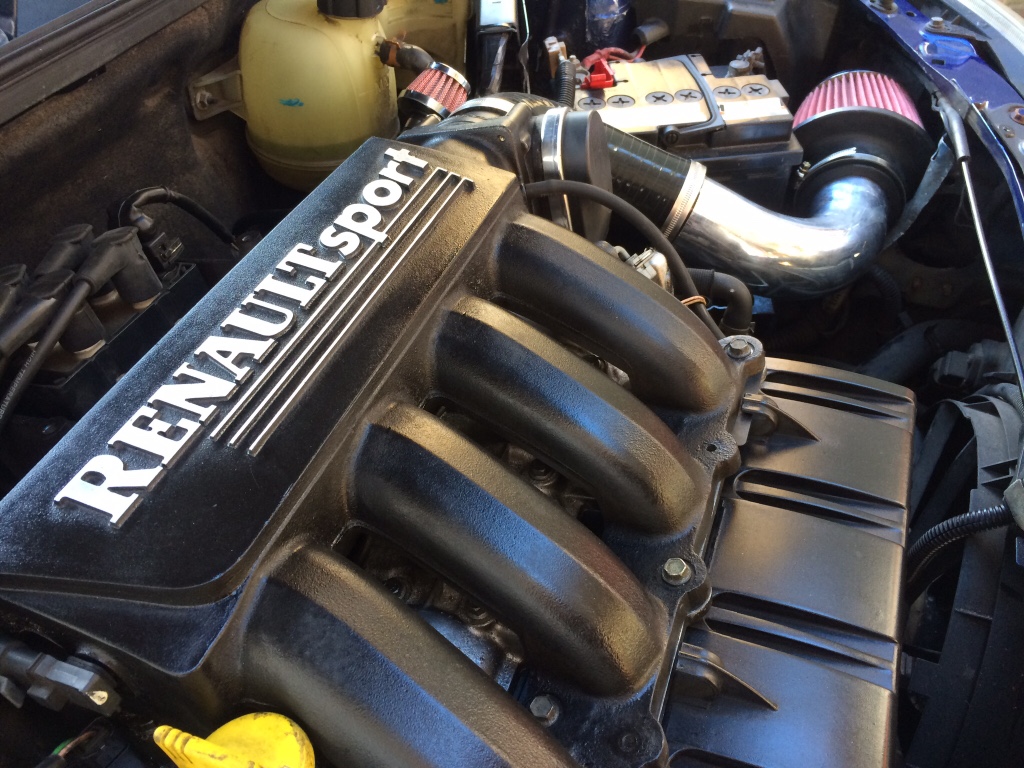

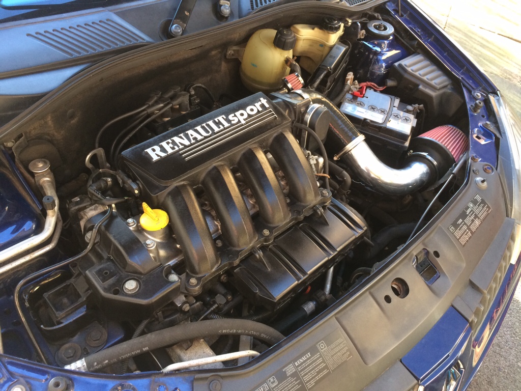

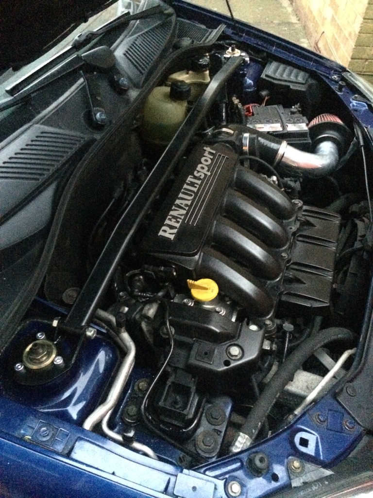

Engine back together with matched inlets and induction

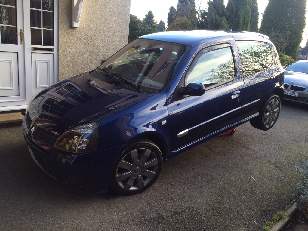

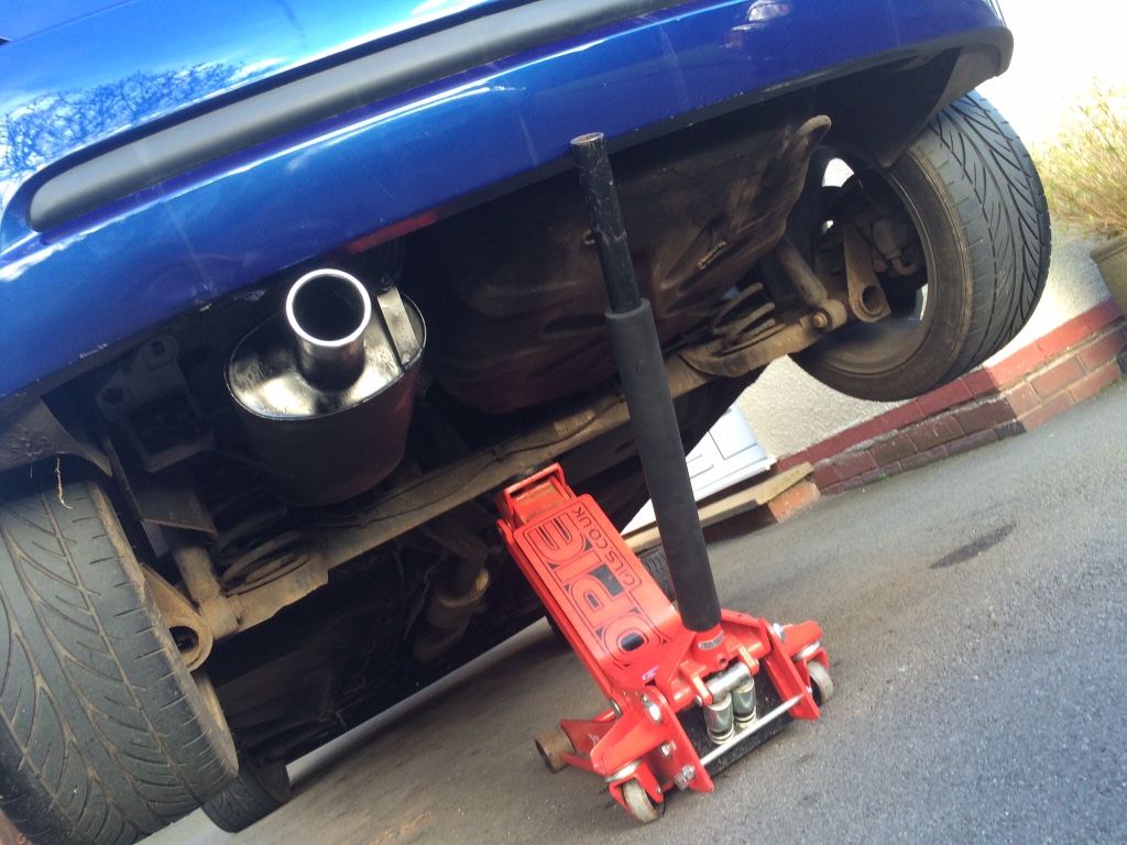

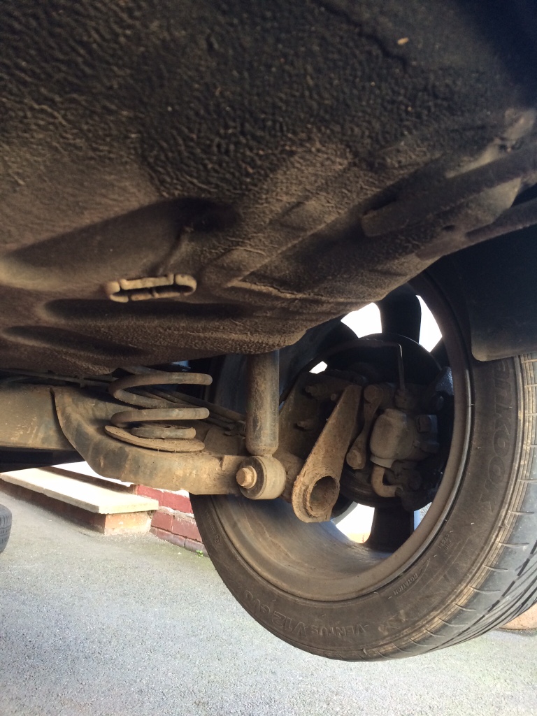

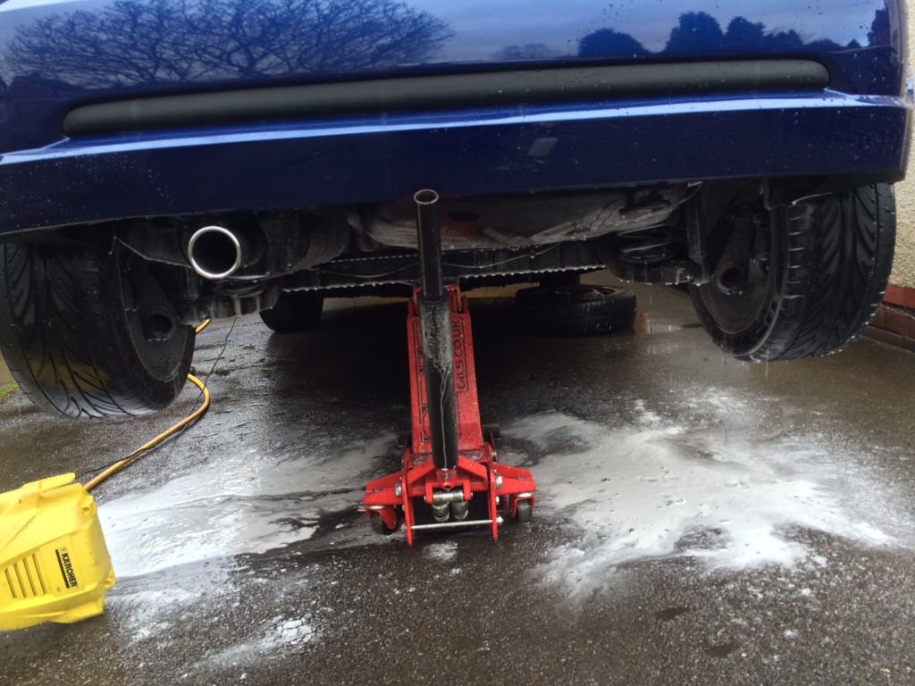

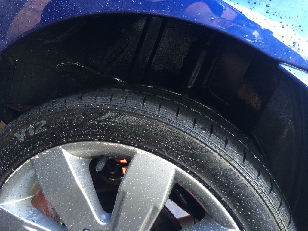

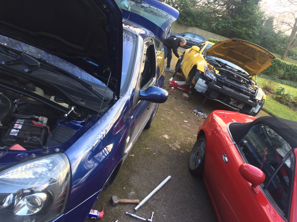

Cleaned the underside and all the arches.. Jacked it up..
All this came out..

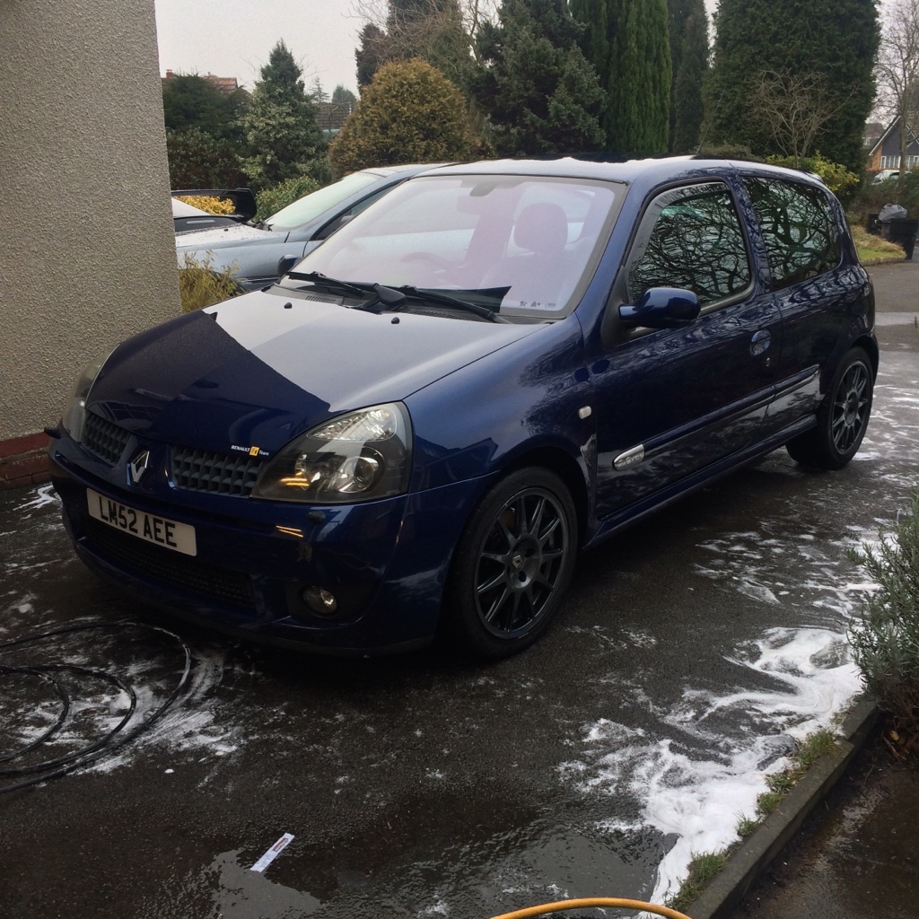

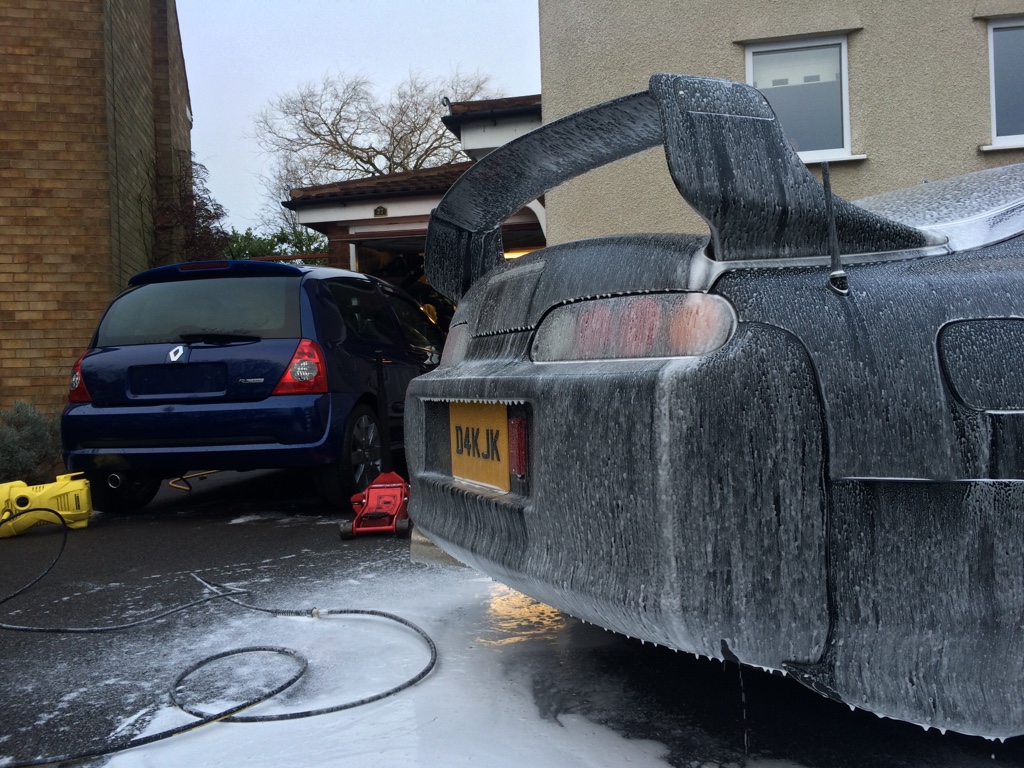

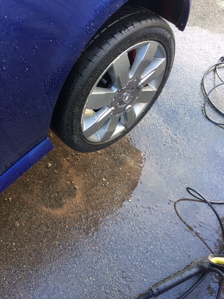

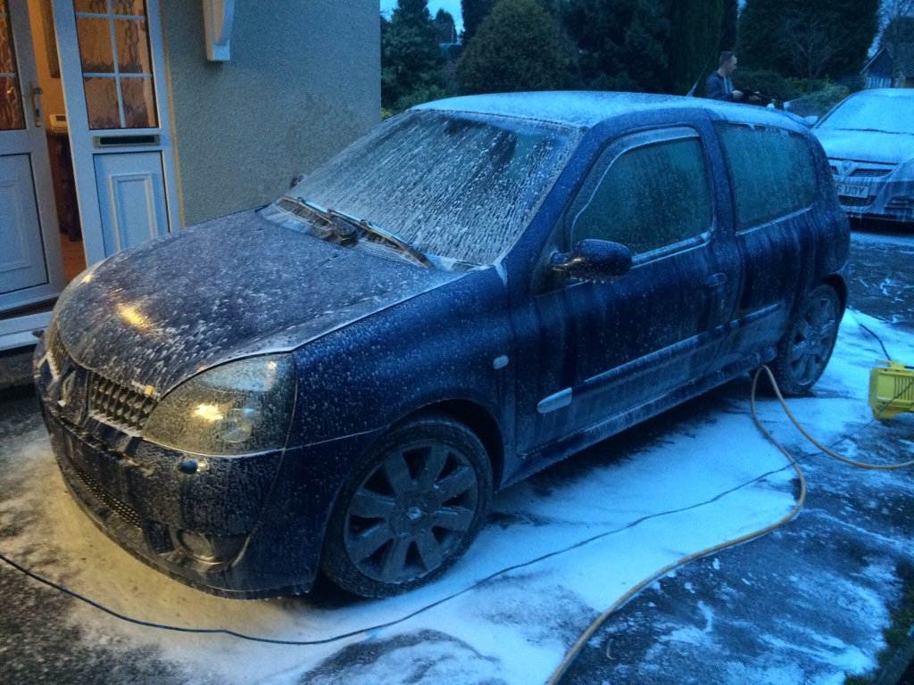

Snowfoamed and cleaned all the cars

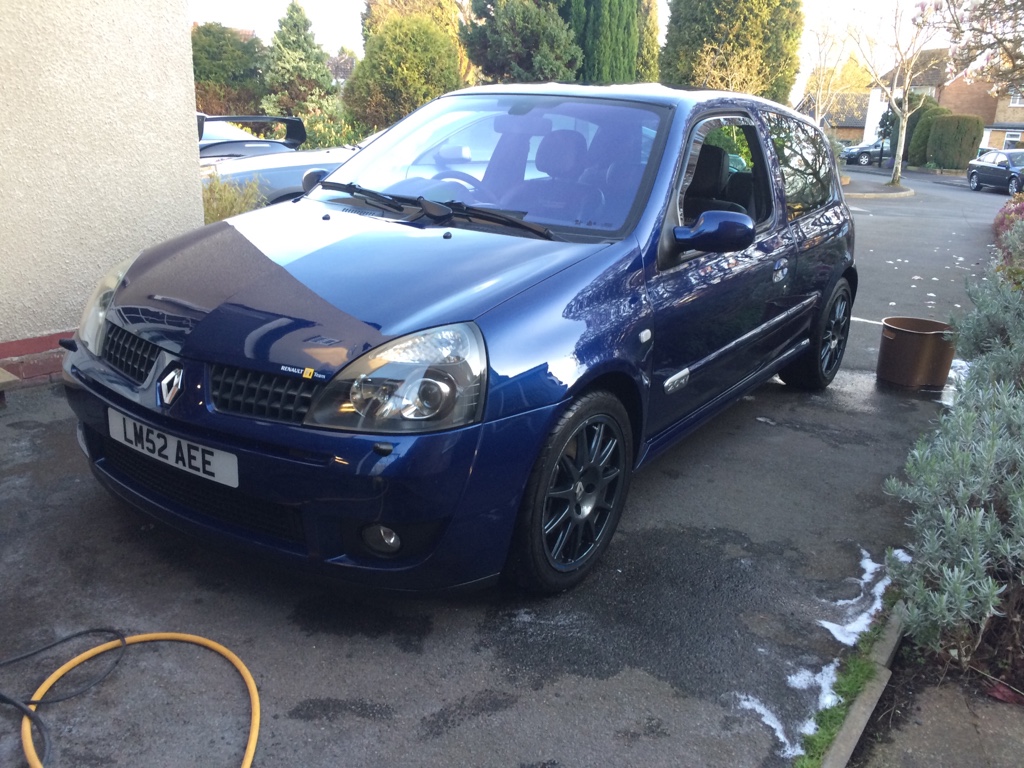

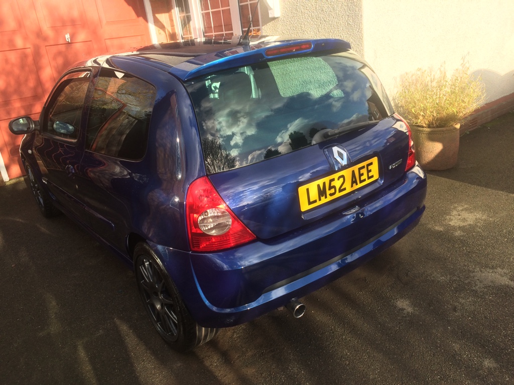

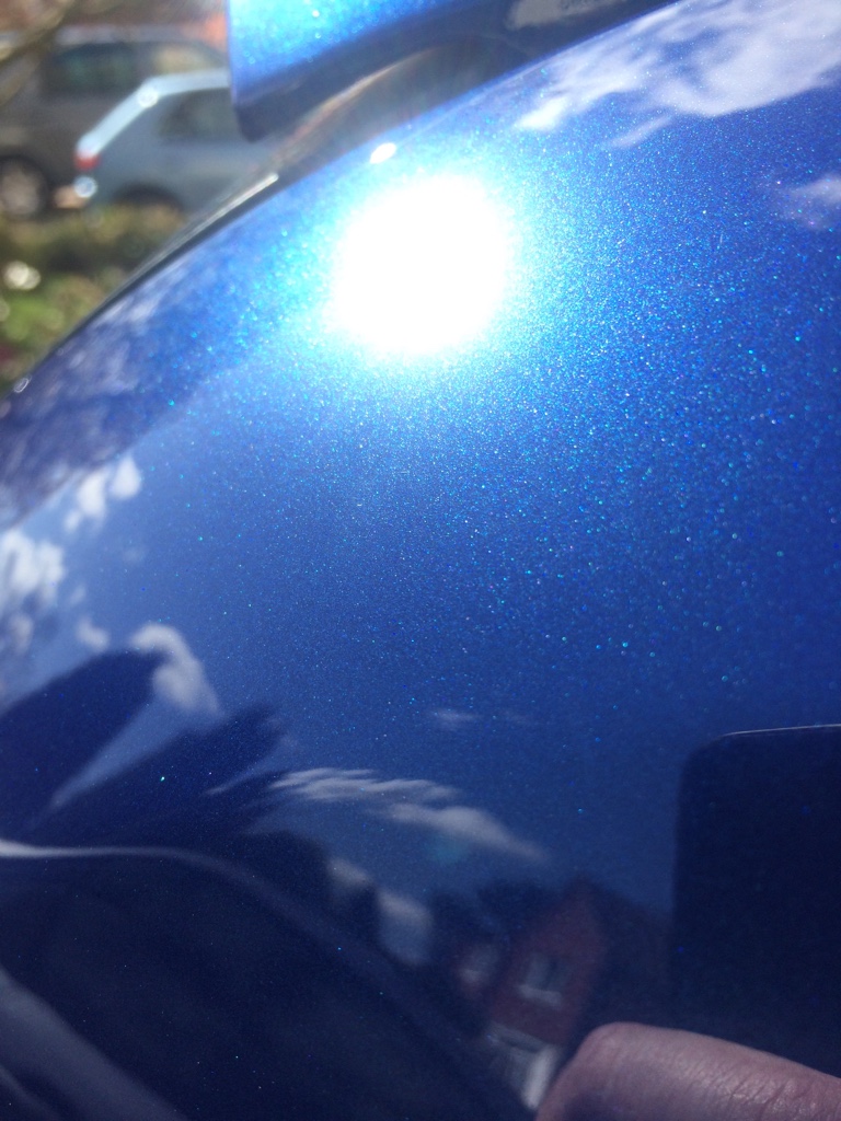

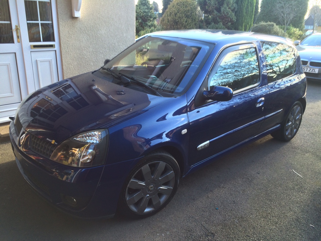

Cheers mate it's took a long time but it looks like a different car.. Really put the hours in but I'm over the moon with how the paint has turned out

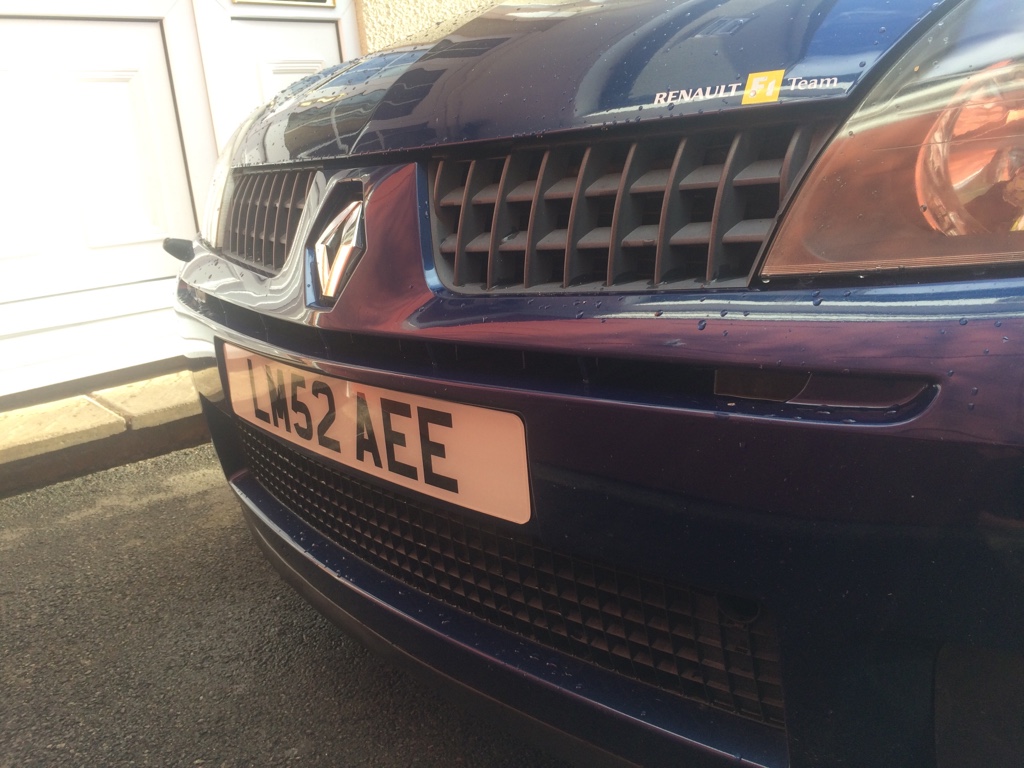

Some fresh plates arrived from fancyplates :)

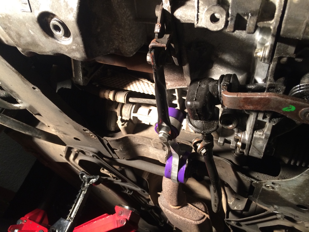

Powerflex dogbone arrived going to fit this Sunday weather permitting
It's booked in now for belts and dephaser at diamond motors in a couple weeks and Bodyshop tues :)
  Stealth 438'd 182
Dogbone on :) this sorted the vibrating/knocking noise :D

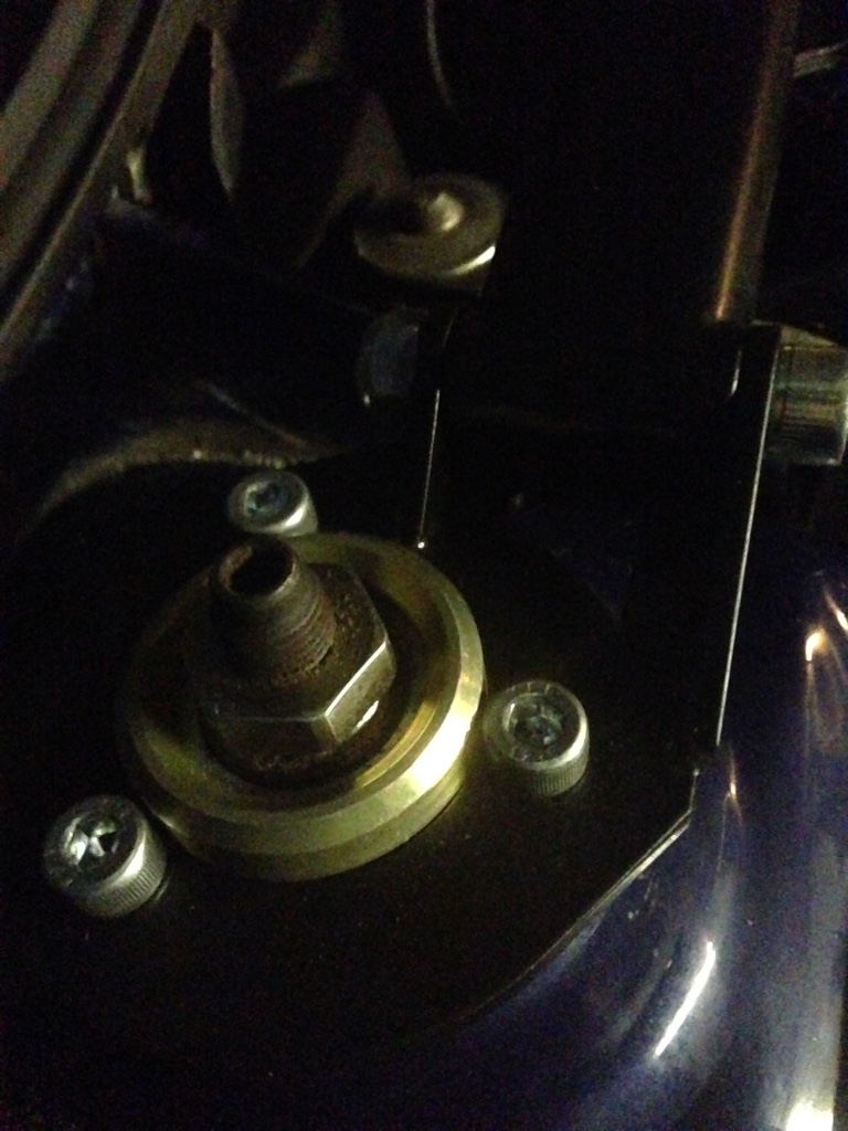

The arrival from Pure Motorsports today should help by getting rid of the old knackered top mounts and replacing with this set up

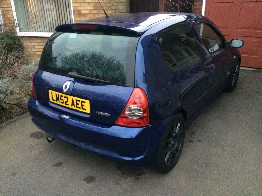

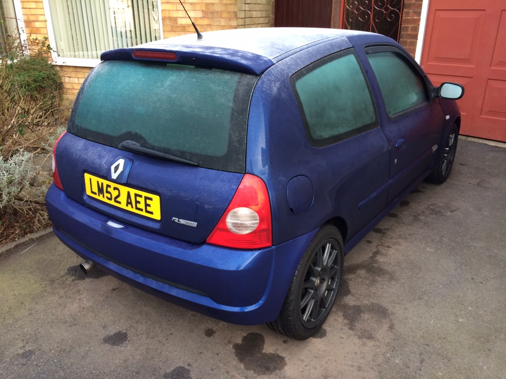

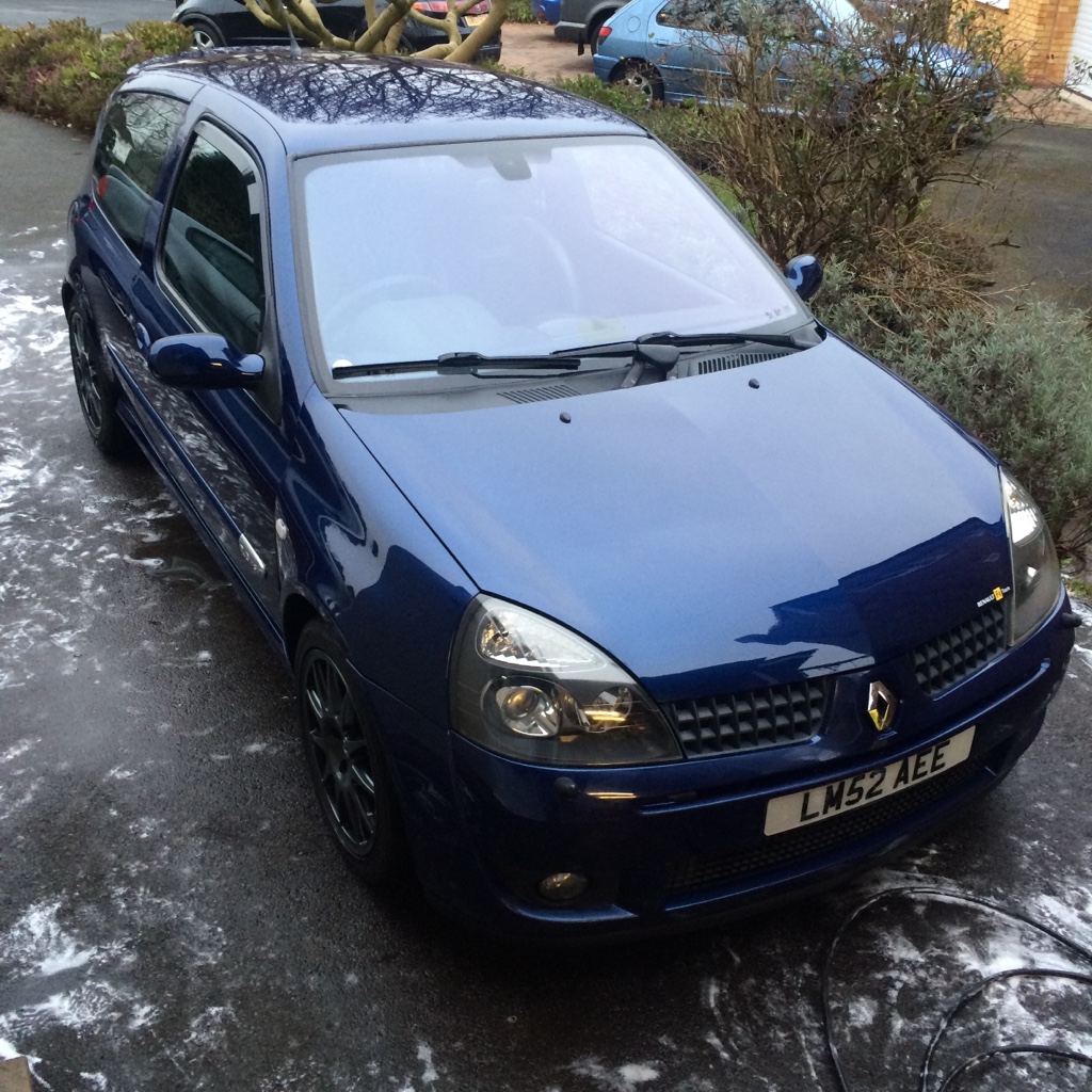

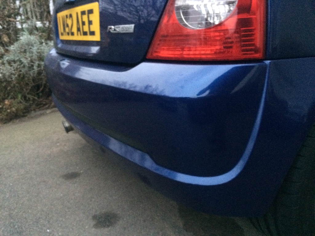

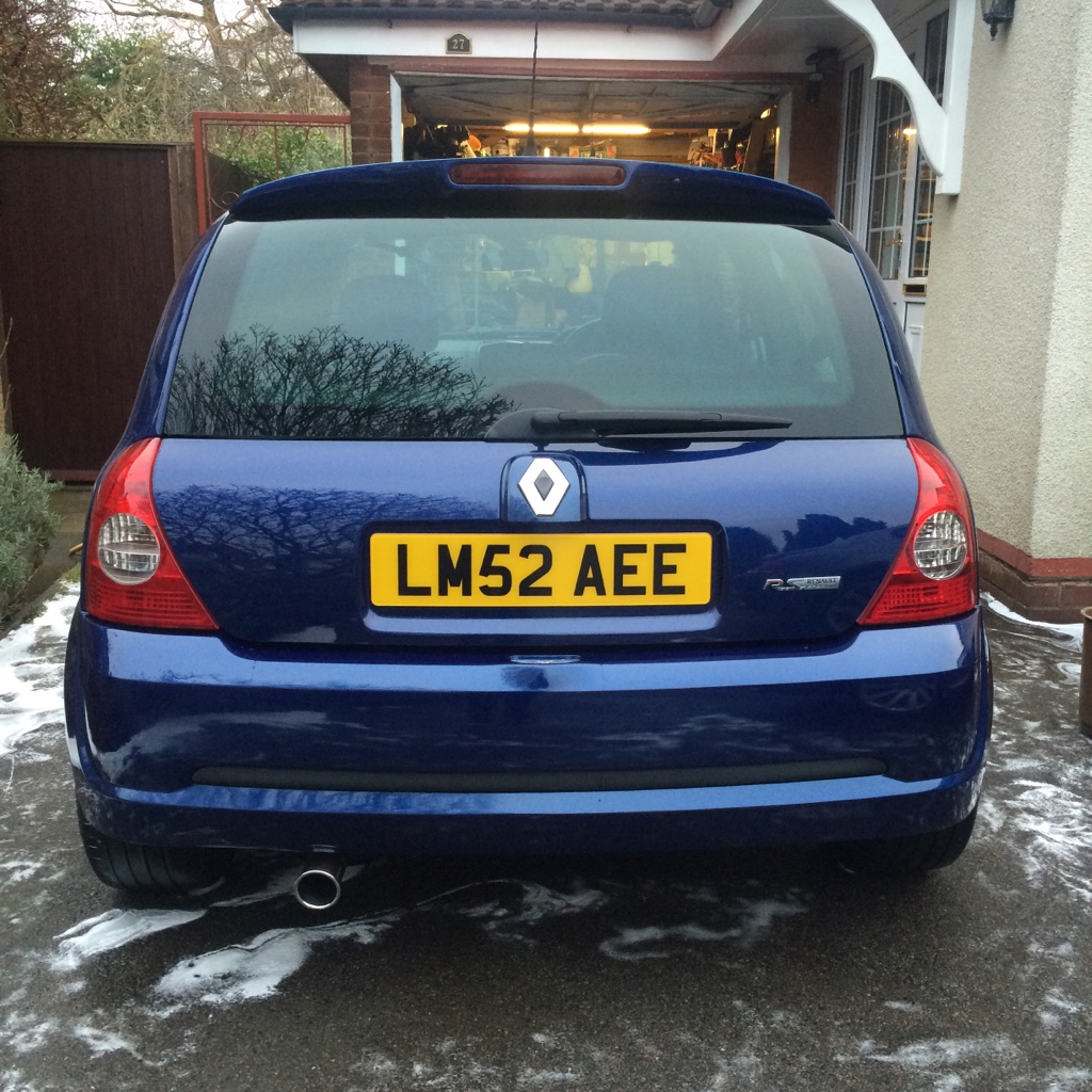

So it's back with everything the right colour.. Spoiler and rear bumper have had a fresh spray :)
Haven't had a chance to clean it so this is the only *frozen* pic I have.. More to follow

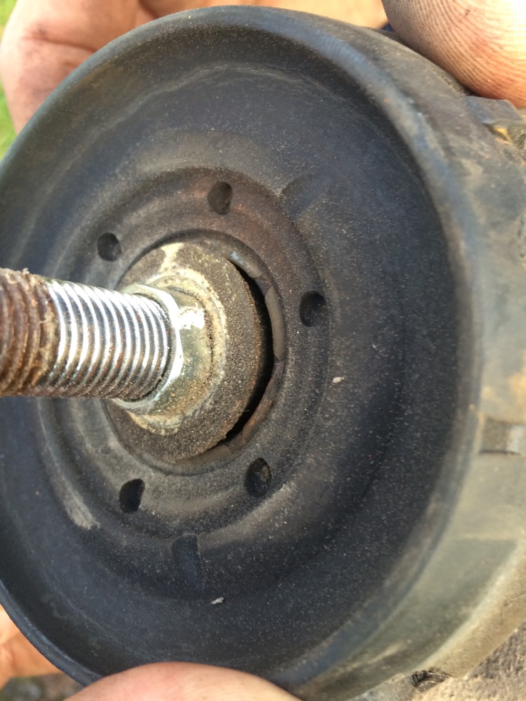

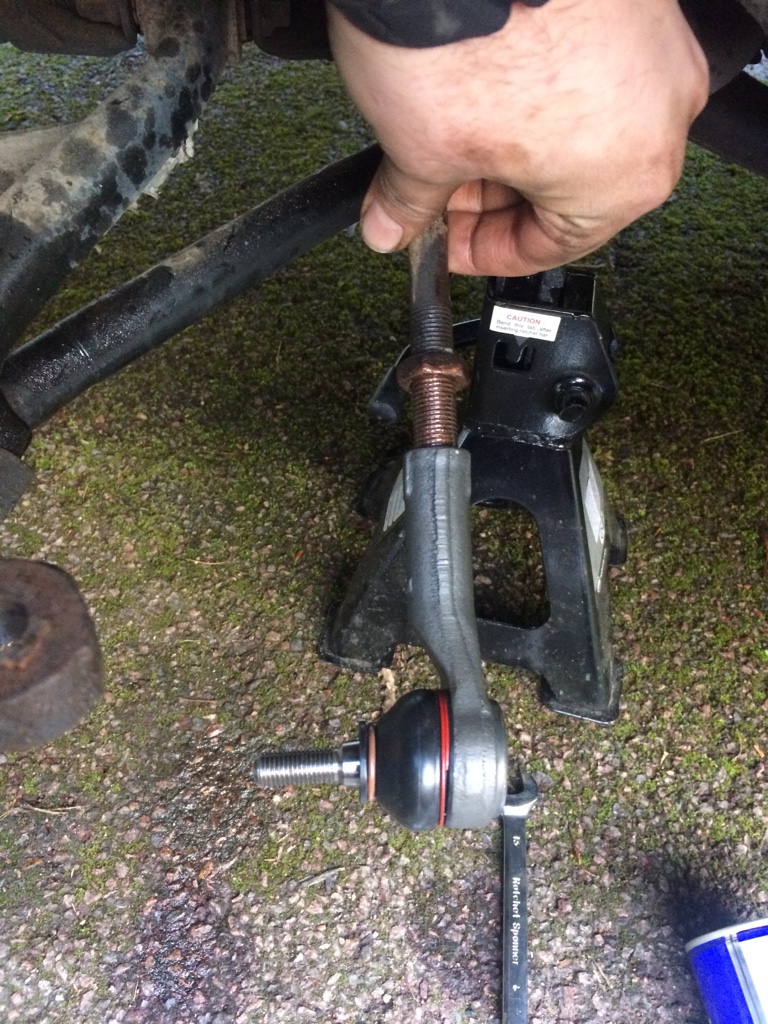

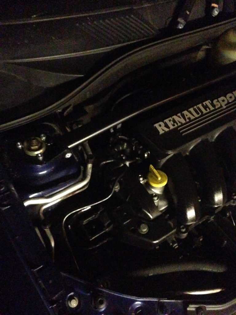

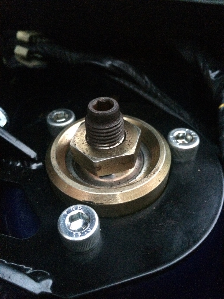

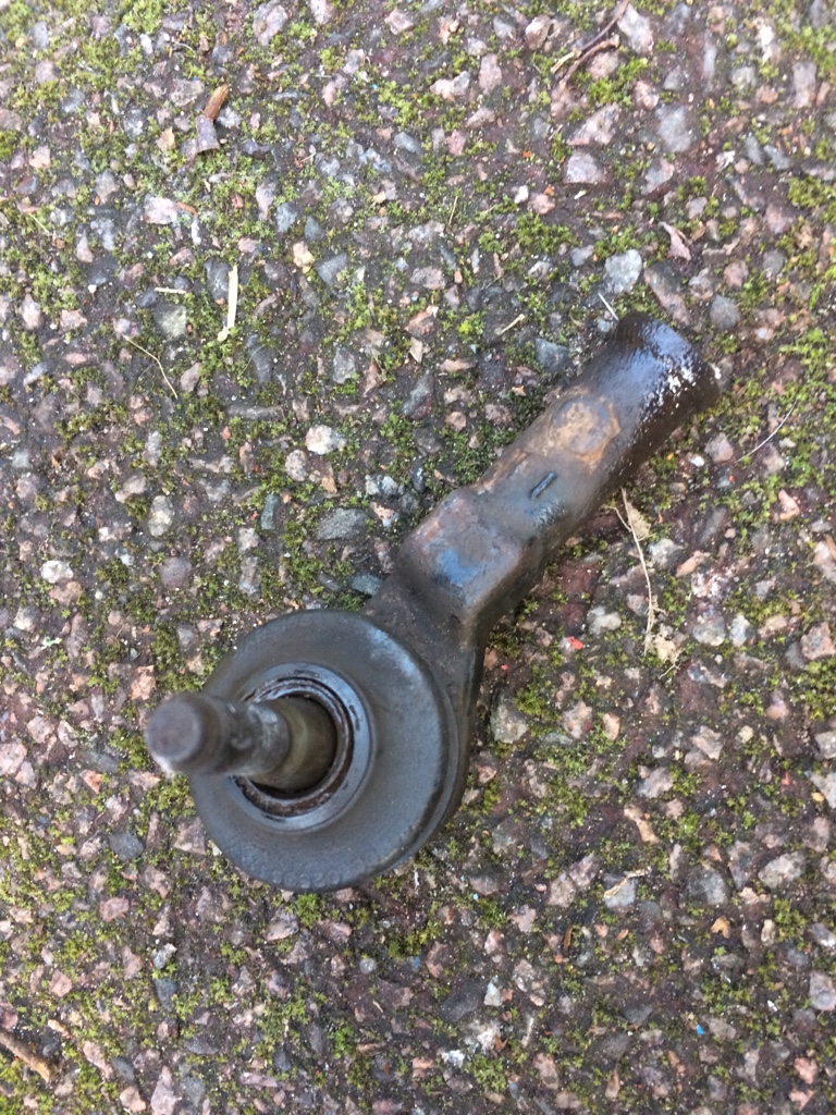

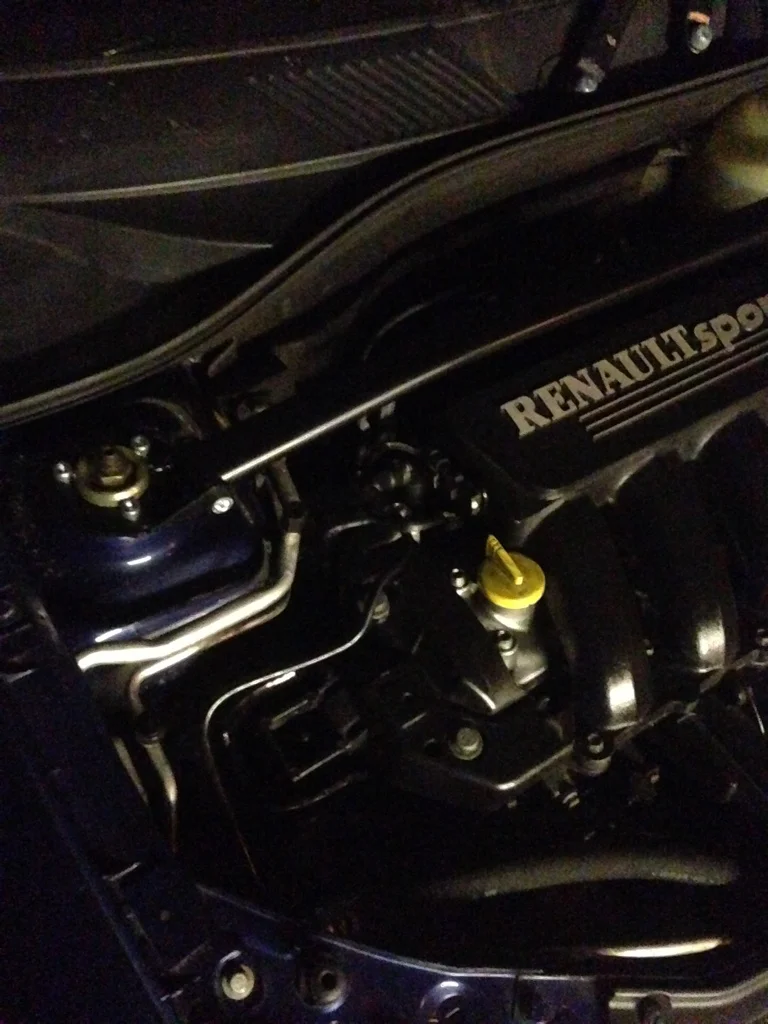

Steering was feeling a little vague so I have replaced track rods (MOT Advisory) and top mounts.. Top mounts were really fooked!
Off with the old
And in with the new..
Moog track rods - I was told by carspares they were the premium brand and tbf seem a good quality item.. We will see how they stand up!
New PMS Solid Top Mounts on.. So far I am VERY impressed.. Great feel, no real adverse effect but car feels worlds apart :) really happy! Shocks weren't in great condition either so will be changing them soon and it should then handle exceptionally well

Looks really nice pal, great job cleaning the underside and the engine bay is sweet.

If I can give you one word of advice as I have the same top mounts, is use a locking nut on them as they will come loose! Happened to me before last month so I put the original top mount nut on top of the sleeve nut provided acting as a lock nut and touch wood it's been perfect since.
If you don't want to and intend on throwing those nuts away please send one of them to me though as I lost one and had to make do with a chunky horrible nut instead :tongueout: haha
apologies if i'm teaching you to suck eggs btw, just thought i'd give you a heads up as to what happened to me.
  Stealth 438'd 182
Awesome update mate.
Nah not at all! Really appreciate the heads up and advice mate
I did put approximately 1 s**t load (technical term) of thread lock on there so should be okay as I did think that!

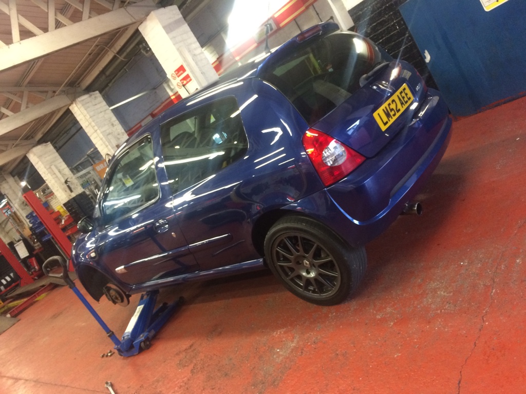

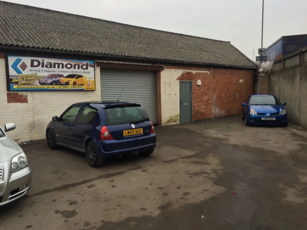

Dropped up to mick at diamond motors who did the belts and dephaser pulley..
Absolute legend.. Very happy with the service and the car feels amazing to drive now.. Dephaser was properly screwed! Cannot recommend him enough :)
Mick also reported that the engine mount was goosed so I will be fitting a new one along with some new front tyres as I've got a slow puncture :(

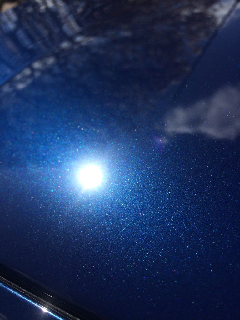

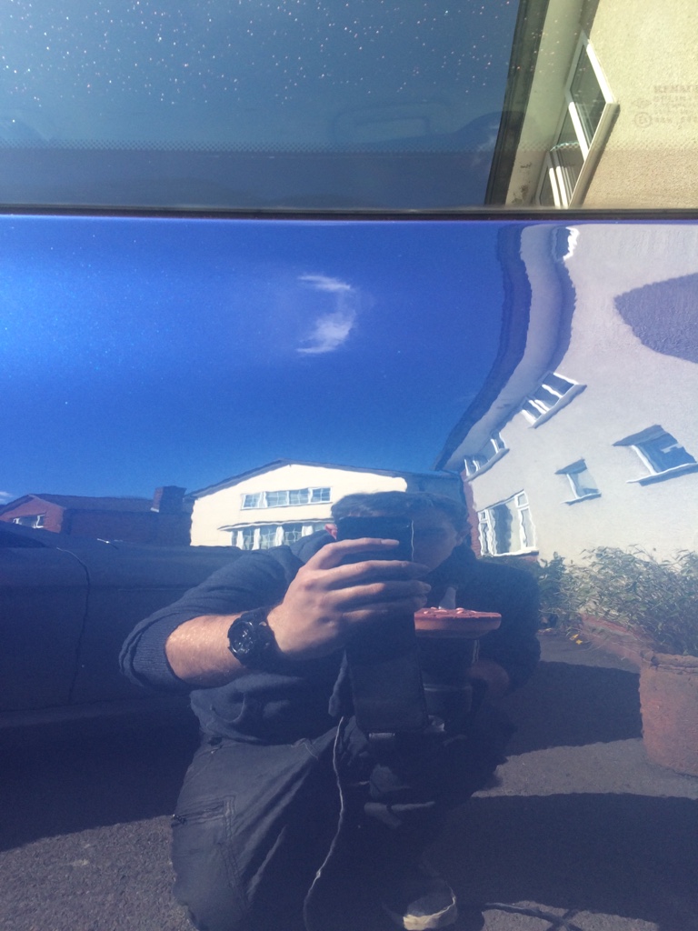

And yet another machine polish and finish.. This time the paint is pretty much perfect!
