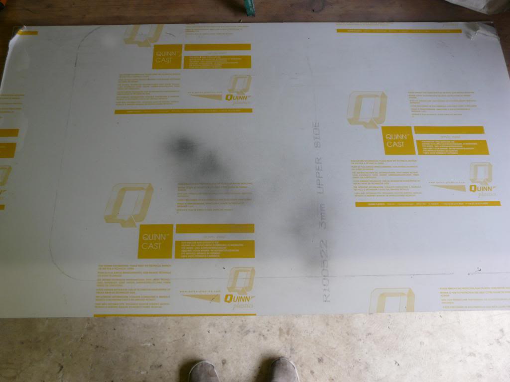

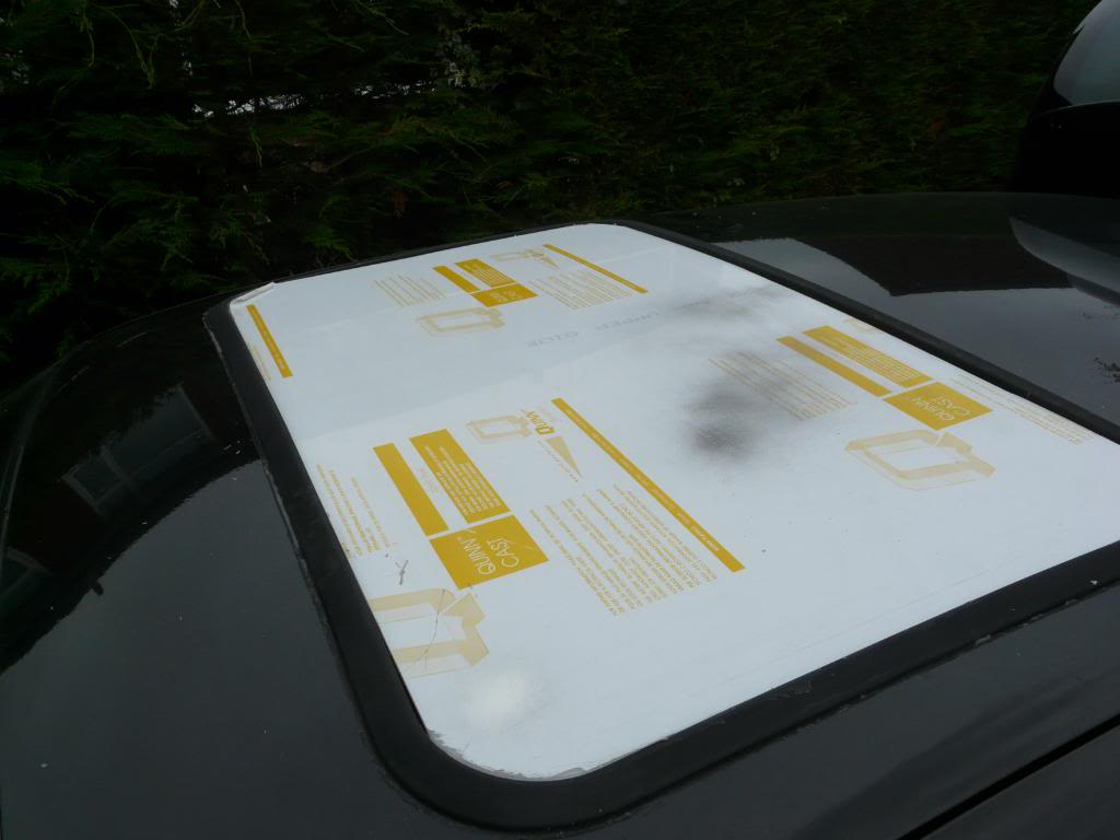

Well i have a busy couple of hours on the car this afternoon. As ive had the polycarb in the garage to replace the sunroof glass i decided to have a go at cutting it out and fitting it. Took about an hour and a half to do but fits like a glove. Well pleased with it.
A few pics....

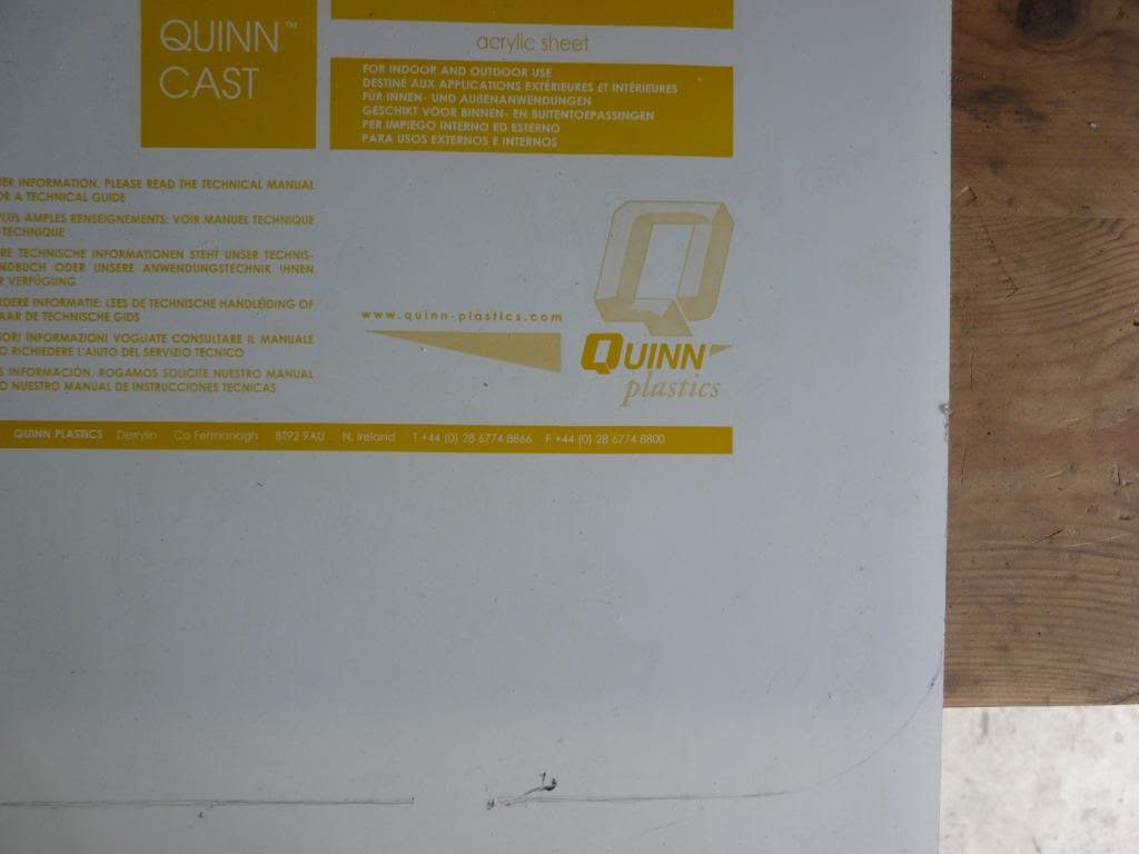

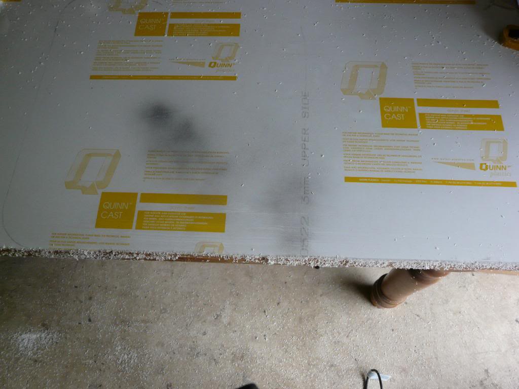

Started off as you would expect with a sheet of polycarb that needed cutting to shape. First i removed the sunroof glass and measeured that, then measured the sunroof frame.

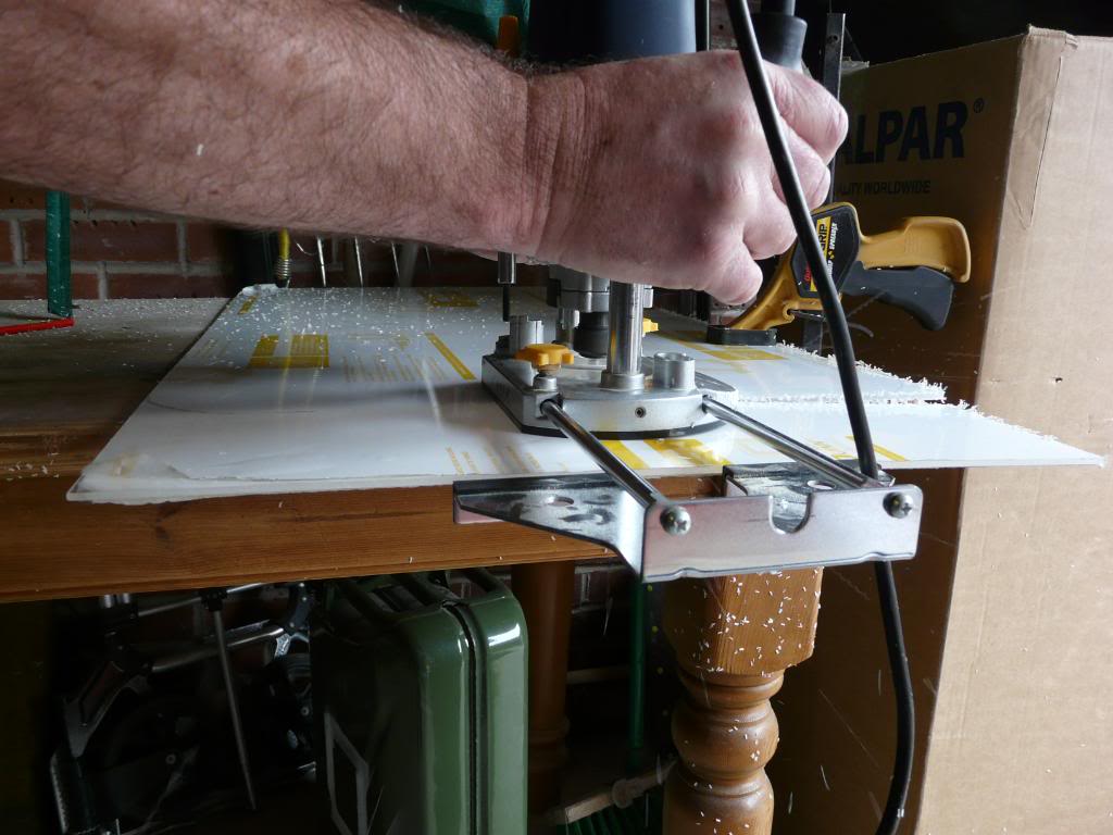

Then i used the sunroof glass as a template but drew round it so that the outline was slightly bigger. Once was all marked up gave my dad a shout to come and cut it out with the router...
After we finished cutting it out abit of filing and uit was in....
Perfect fit :cool:

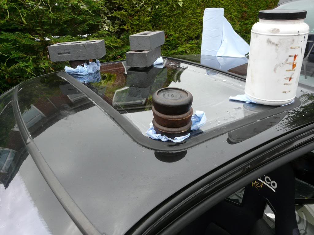

Then put a bead of tigerseal round the frame, placed the polycarb on then another bead round the top of the polycarb, the used some weighted objects to hold it in place whilst it all sets.
Another job done.

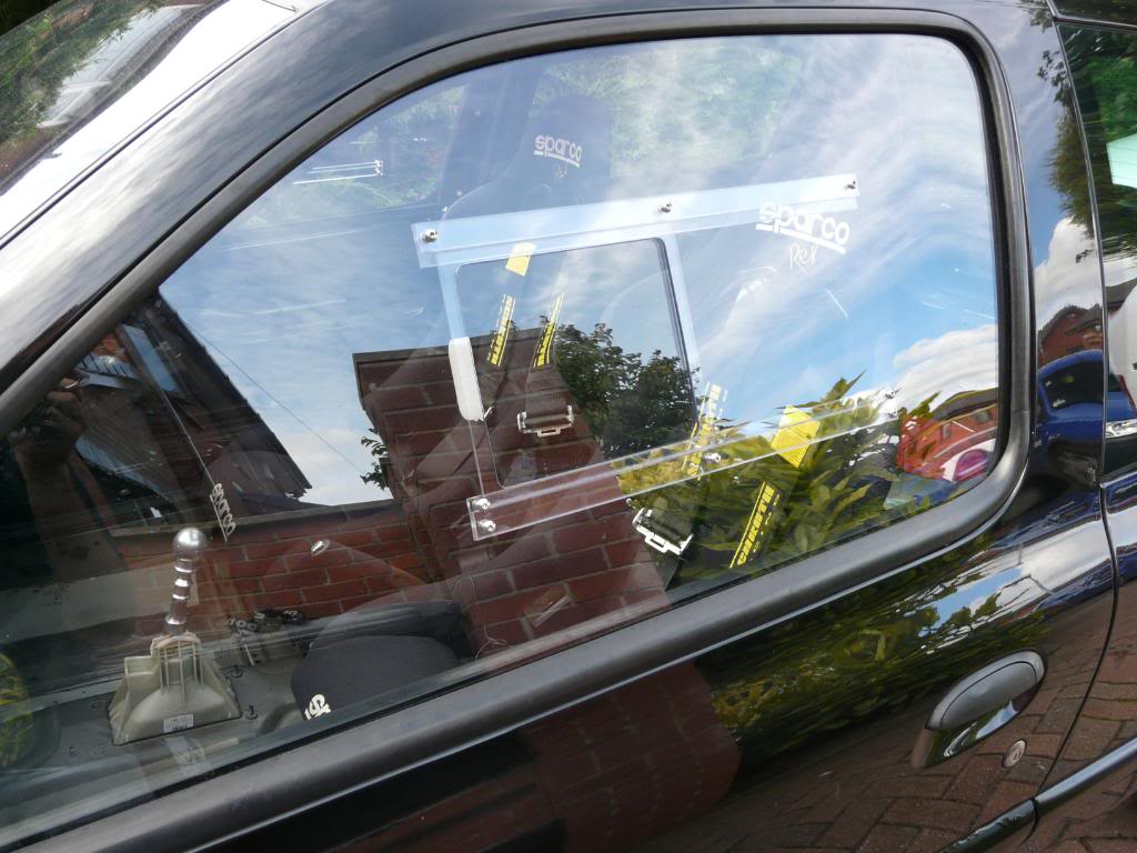

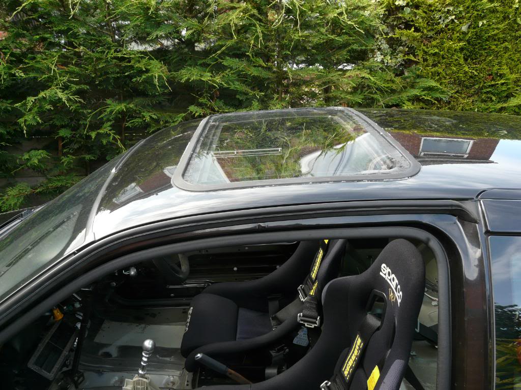

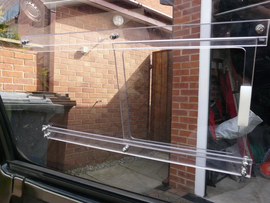

Trial fitted my drivers side polycarb window today. Was unsure about how to secure it into the car but after a quick chat to Chris (chrispy.clio) i will get them both sorted tomorrow evening. Will update with pics then.

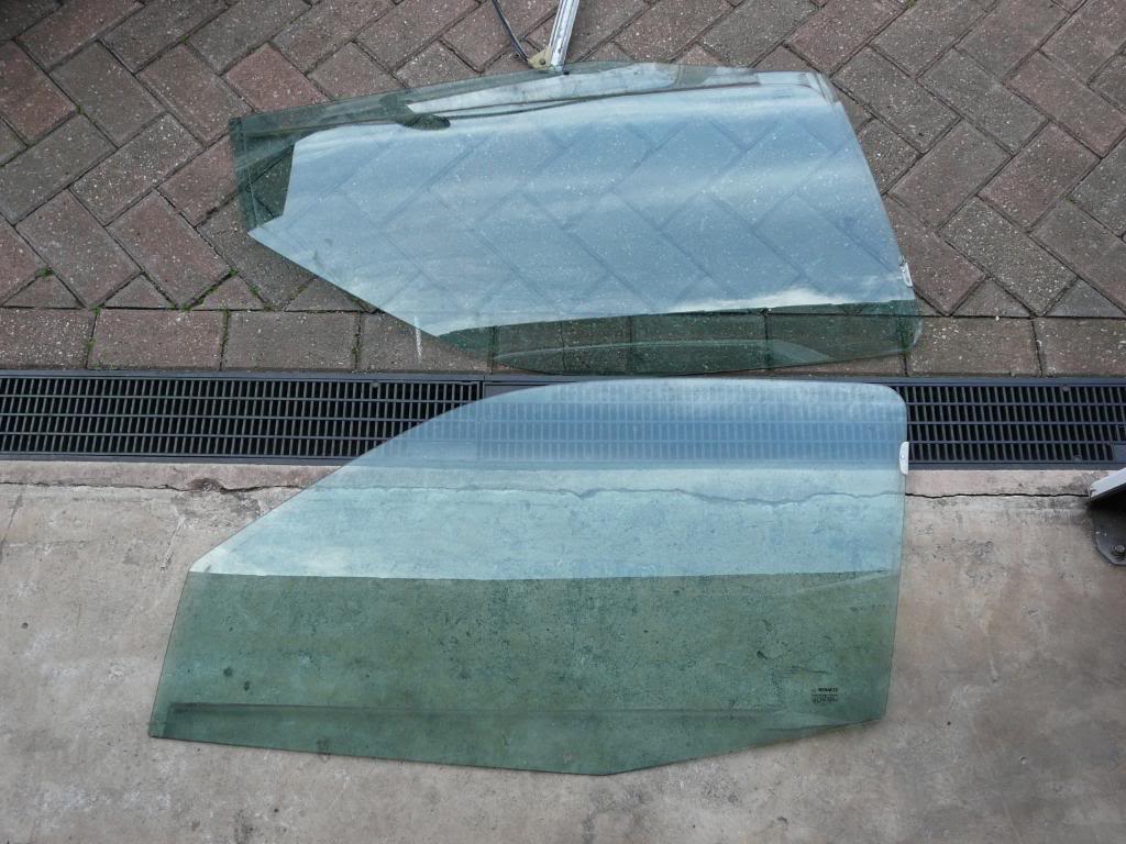

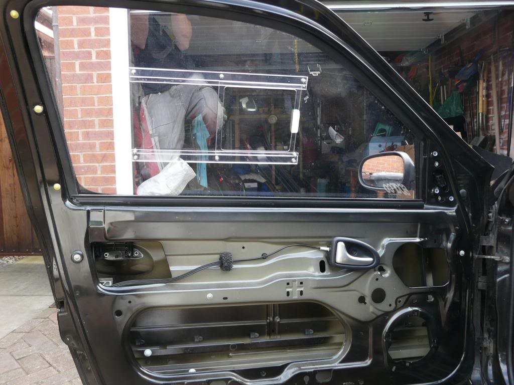

Got round to fitting the front polycarb windows in the week, Was really impressed with the quality of the windows when i unwrapped them. I didnt take many photos of putting them in so will just post what i did take.

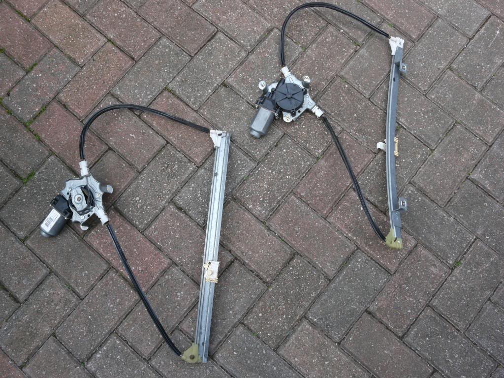

First i removed the old glass, and electric window mecs....
Then got the polycarb windows in.....
And a quick pic of the polycarb sunroof.....

No i dont really use the car every day tbh as i have a van that i use for work. As for the polyycarb windows they are great, still very hot inside the car when the suns out

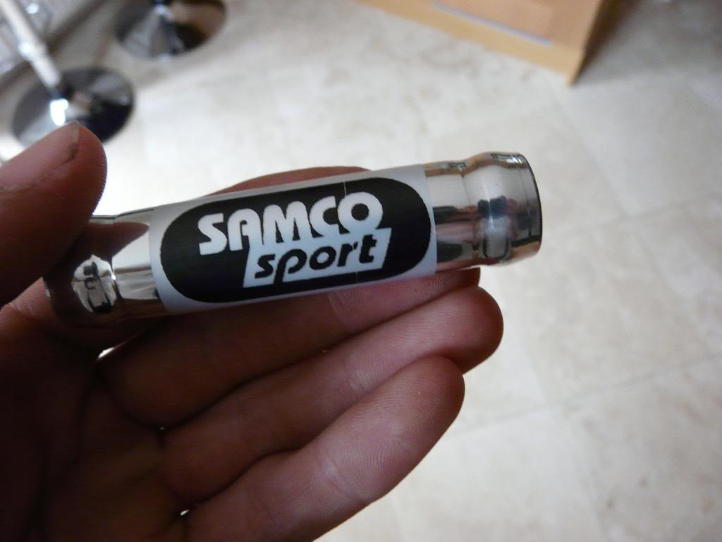

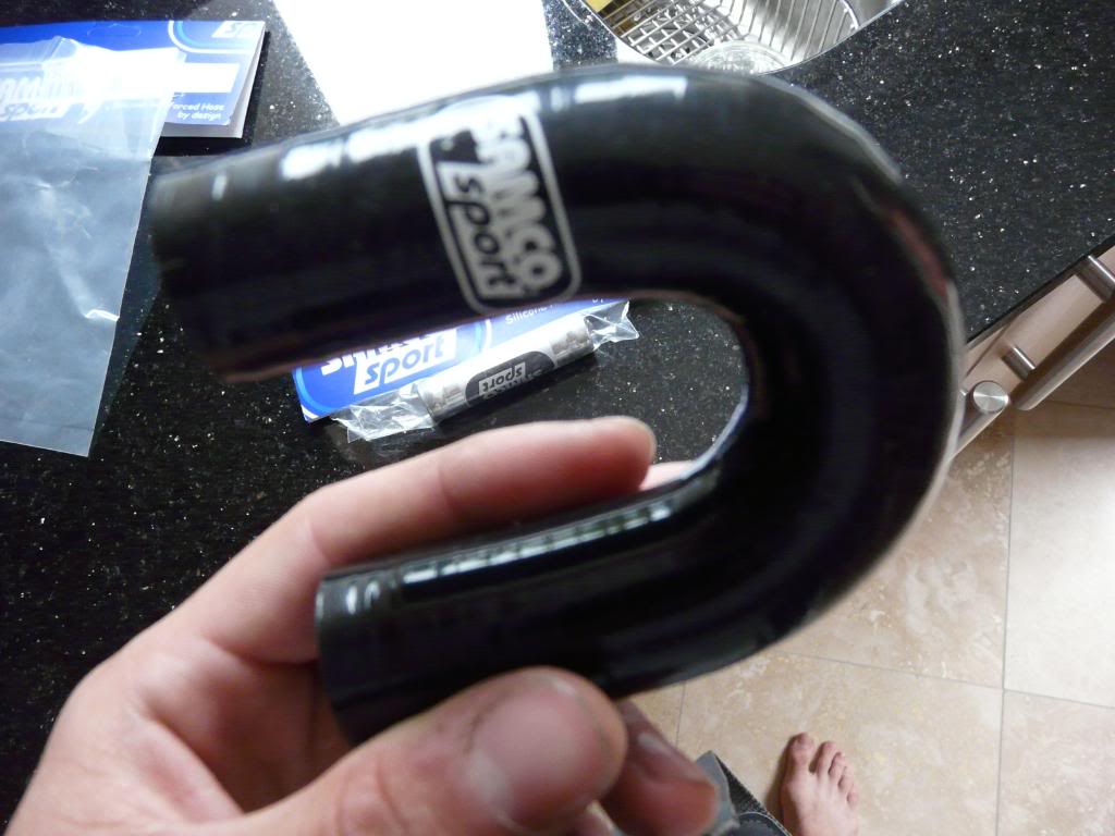

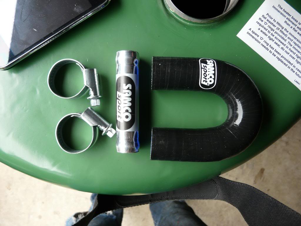

Well yet another update. My 180 degree samco bend and connector turned up today from Demon Tweeks, took quite a while to come comapred to toher ting that i have ordered from there. Anyway on with the update......
The bits that turned up.......
x1 180 degree samco bend.......
And a hose joiner aswel.....
Seeing as i had those i decided to nip down to Renault and pick uo a bottle of coolant as i had to drain it all off.

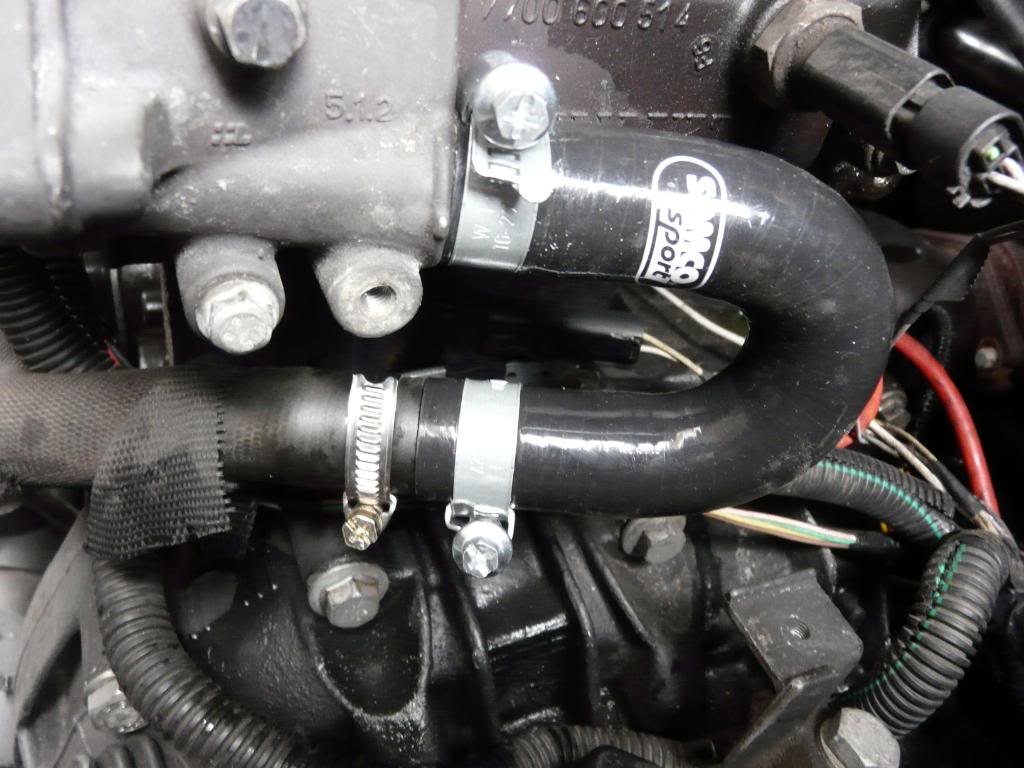

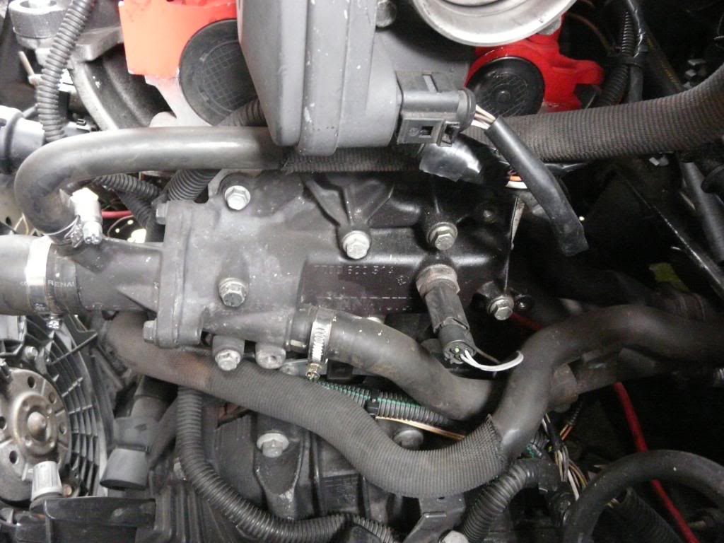

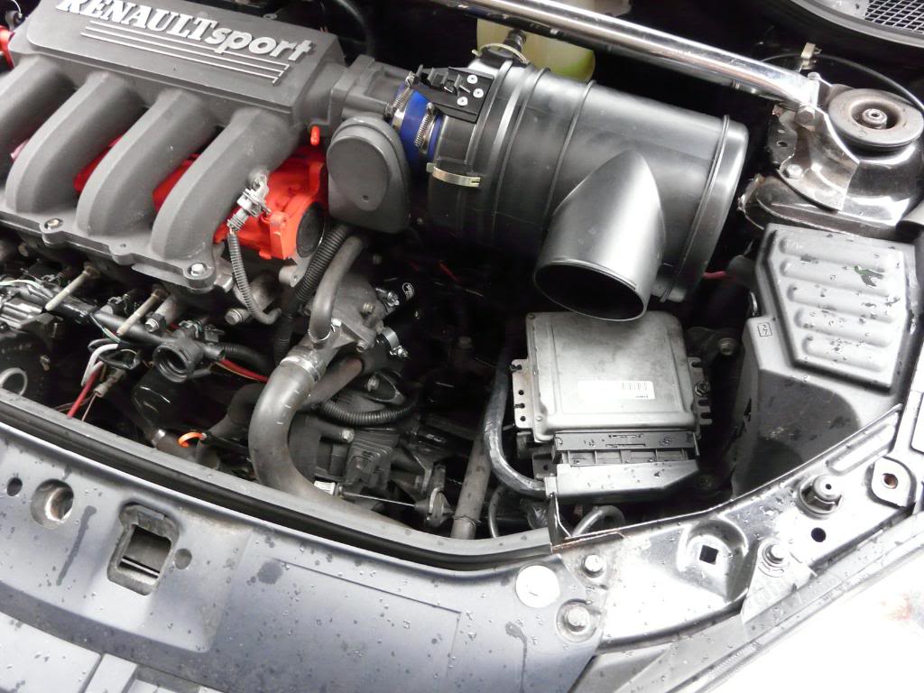

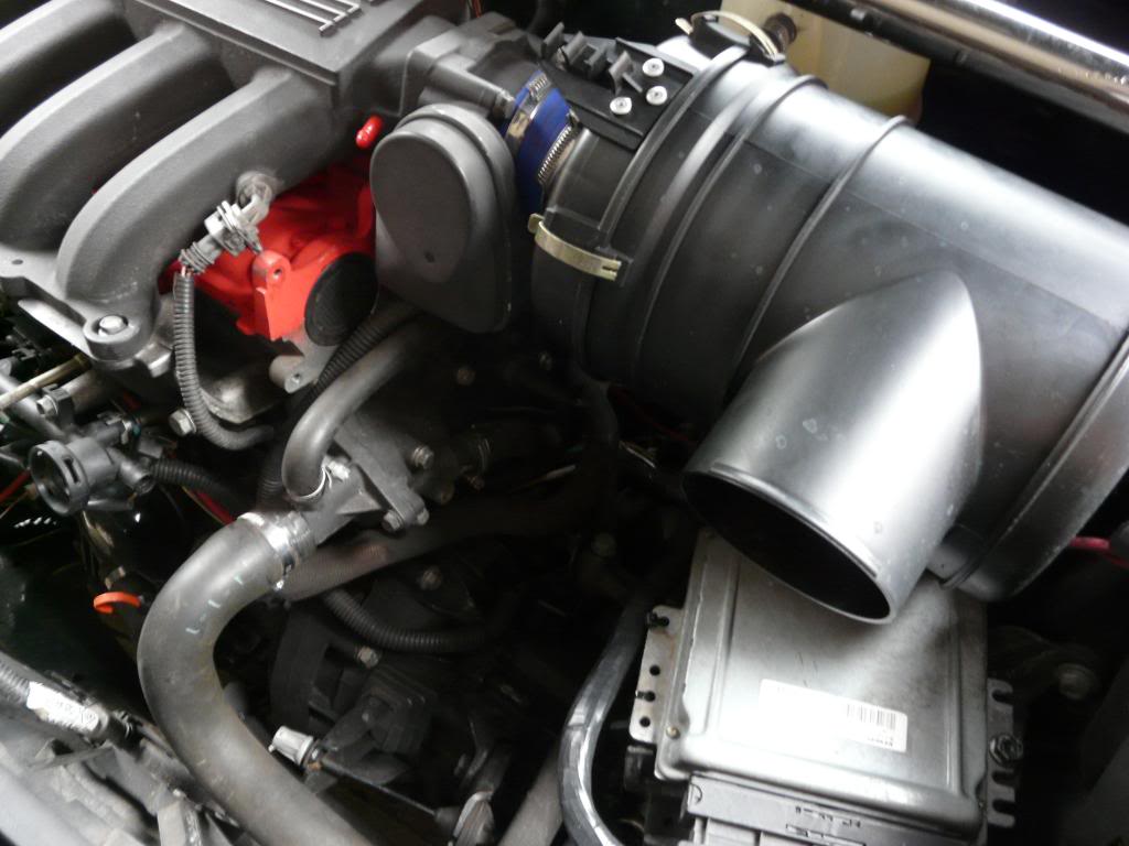

First i had to remove the airbox so that i could gainn access to the thermostat housing, and the pipes for the heater matrix.

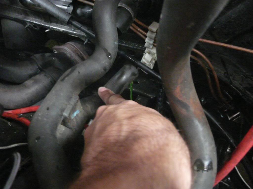

The 180 degree bend is replacing the two pipes that go to the heater matrix for the blowers. 1 pipe comes off the bottom rad hose that i cut half way up and the other pipe is removed off the thermostat housing.

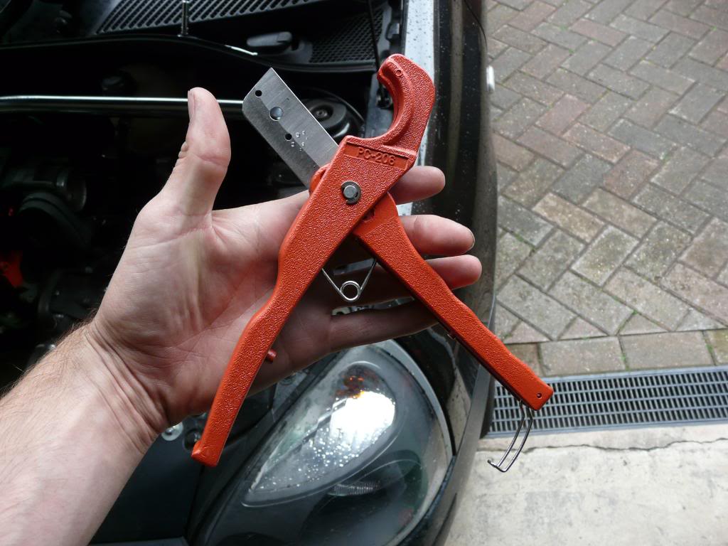

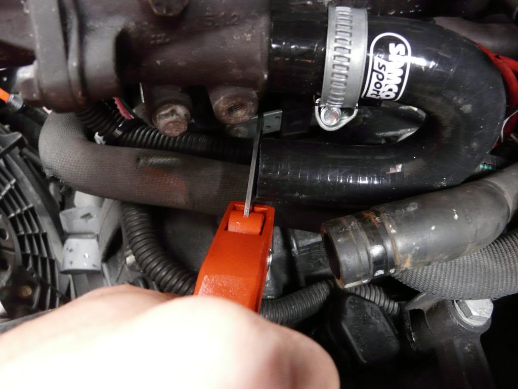

Got my trusty plastic pipe cutters off the van which mad it really easy to cut through the hoses in the engine bay.

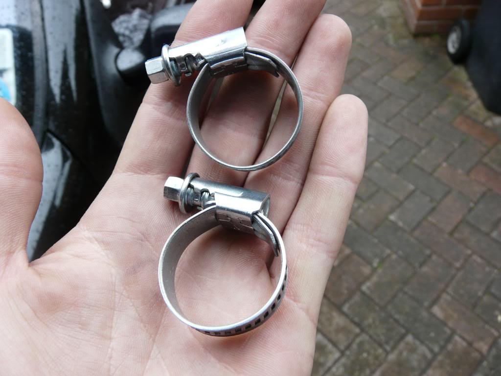

Picked up two hose clips for the new bend aswel....
Instead of removing the bottom rad hose and draining all of the coolant off i decided to just cut throught one of the pipes i was going to be getting rid of and drain part of the coolant via that.

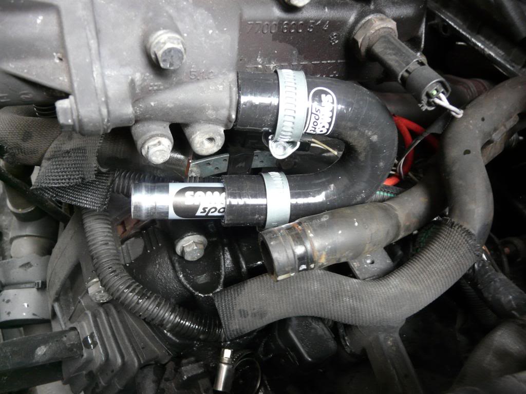

All the new bits ready to go on.....
Then i cut the pipe that comes off the lower rad hose at the right length.......
inserted the hose joiner and added the two hose clips.......
Then put it all togeather, filled up the coolant and blead the system. One job done.
I then removed the heater box from inside the car. Bit fiddley to do but got it out in the end.
And the finished result in the bay aswel.....

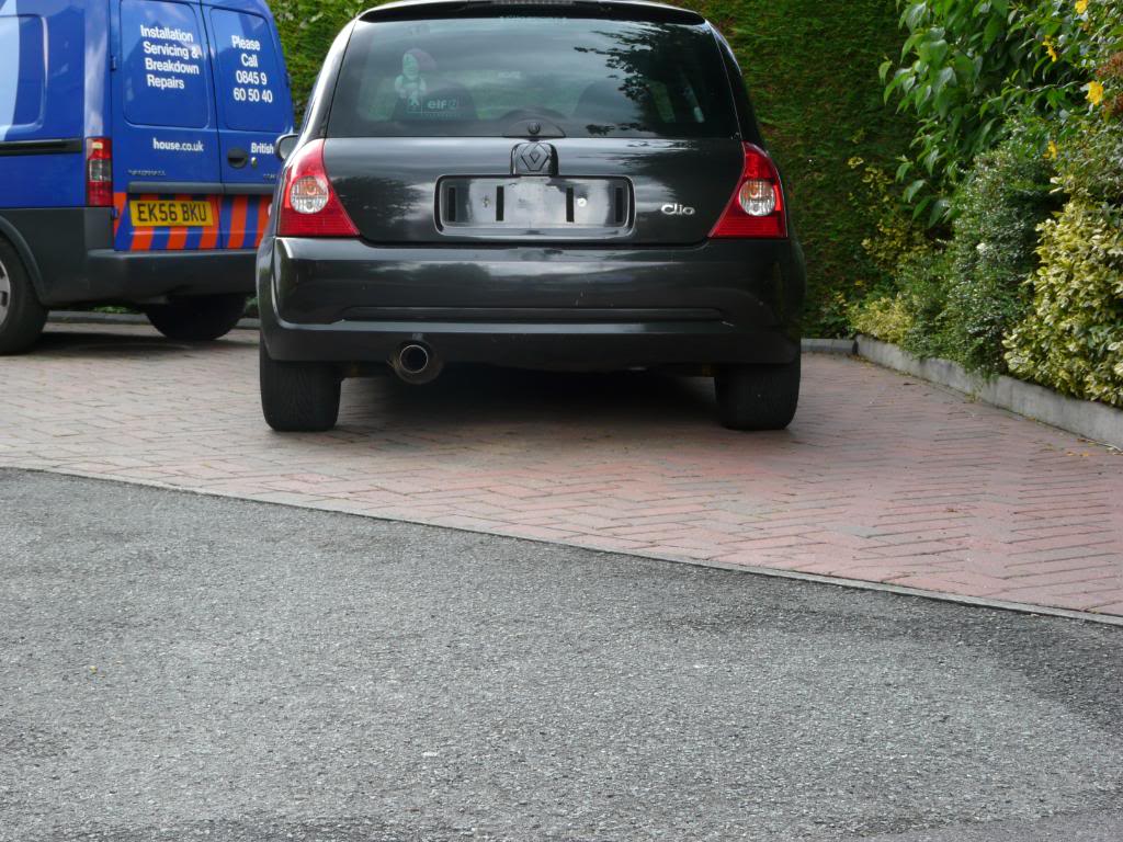

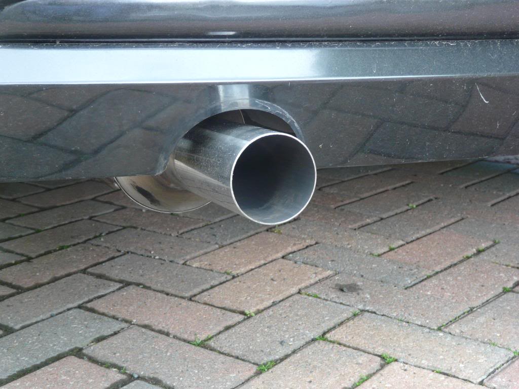

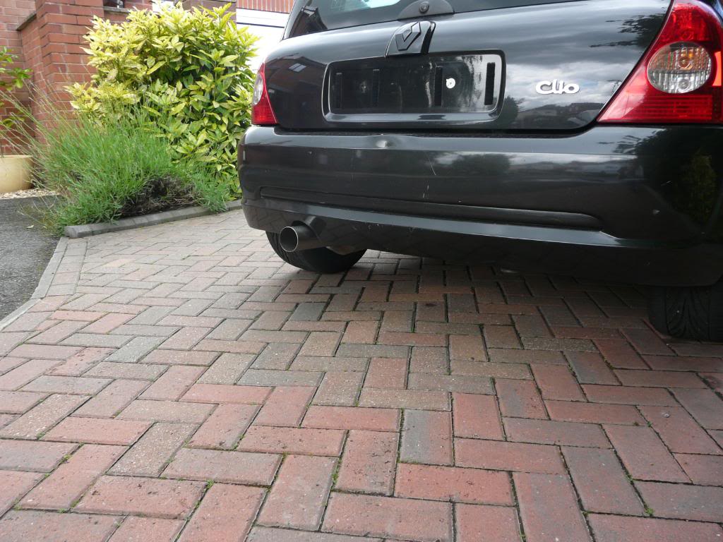

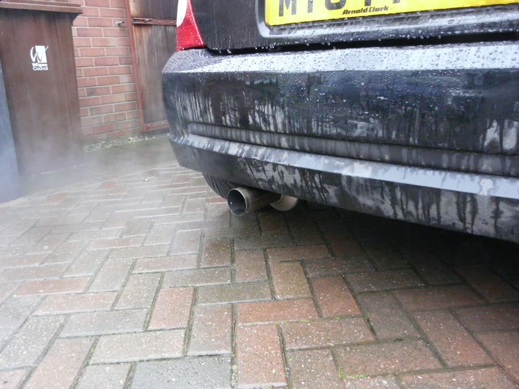

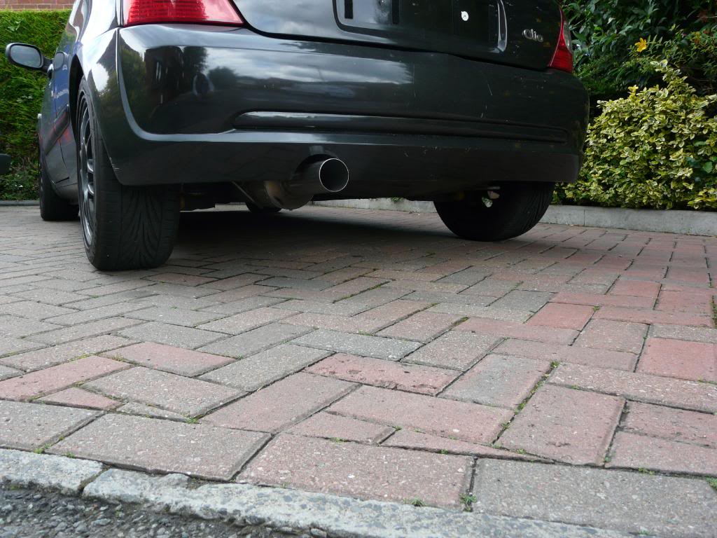

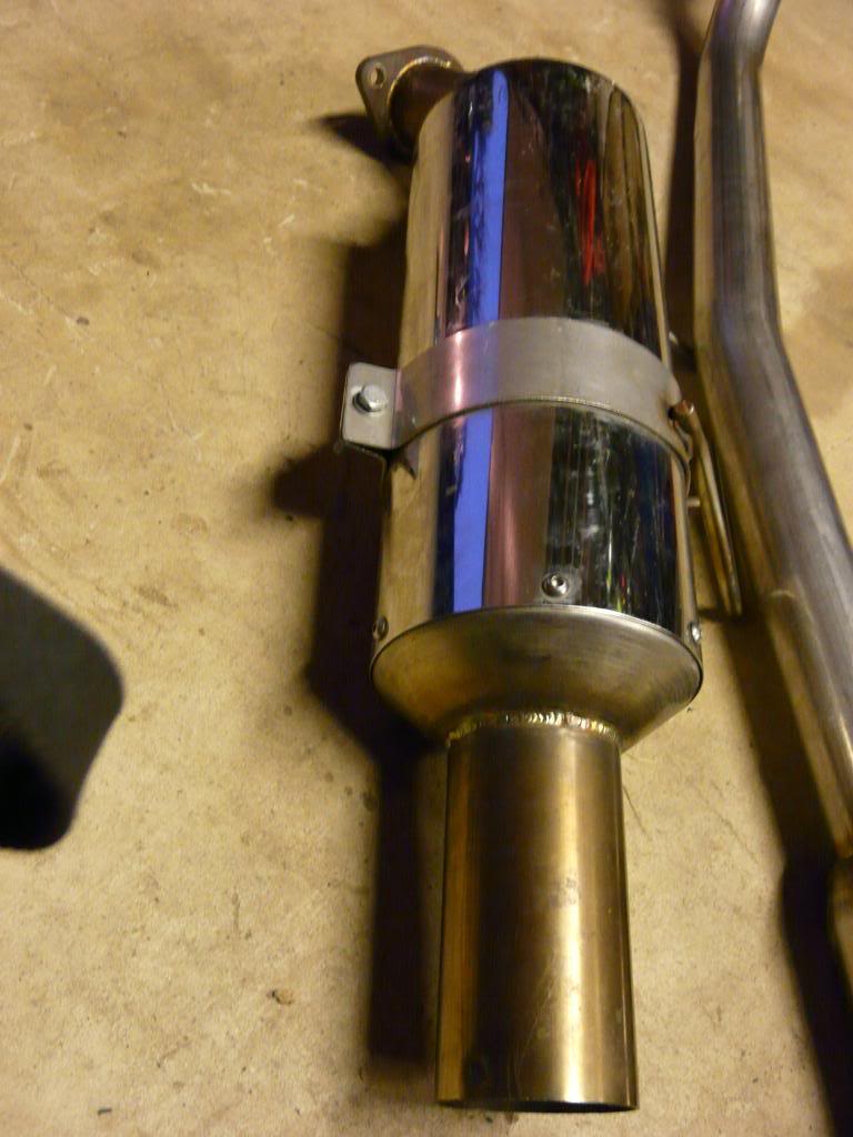

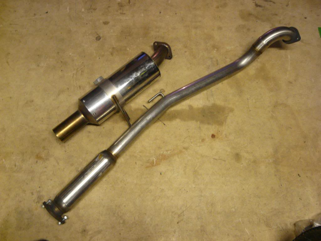

Went to JP Exhausts in macclesfield y'day to get the exhaust sorted out, went to JP as they are the people that made the YozzaSport exhaust in the first place and i wanted the same quality work doing now as it was when it came from them in the first place. So anyway after a 4 week wait i finally was able to take the car down to get it sorted out. I want the exhaust modifying as i want the exhaust to sit in the cutout of the bumper, i managed to bodge it up for a few weeks but where the center section goes over the rear beam it was catching the chassis of the car and the tip wasnt long enough as it sat behind the bumper......... So anyway onto the pics.
Started like this when i bought it.
Then i managed to raise it a little more but it wasnt perfect, cant find the pics atm......
And now after letting JP exhausts sort it out it looks like this..........
Really pleased with how it has turned out. Ive booked the car in to have the silenced removed and a custom silenced de-cat made by Jp exhausts cant wait.........

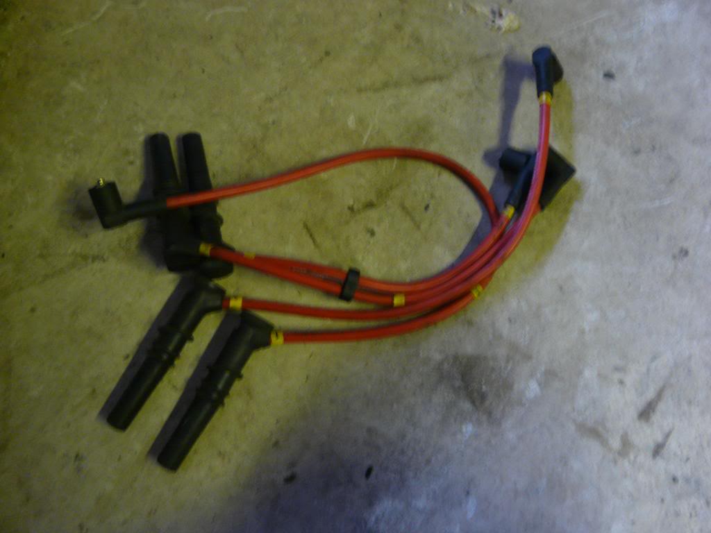

First up are the magnecore ignition leads that i got.............

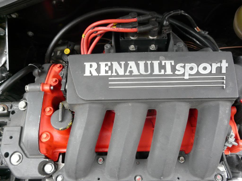

I know they wont do much but they finish everything off and go well with my red rokkor cover haha.

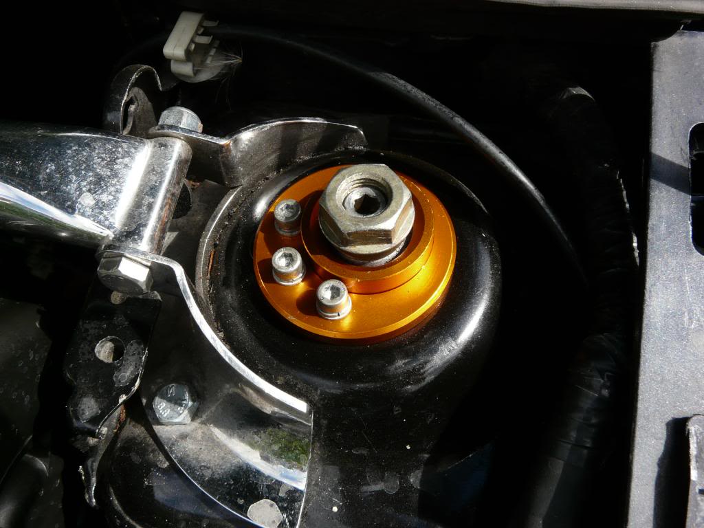

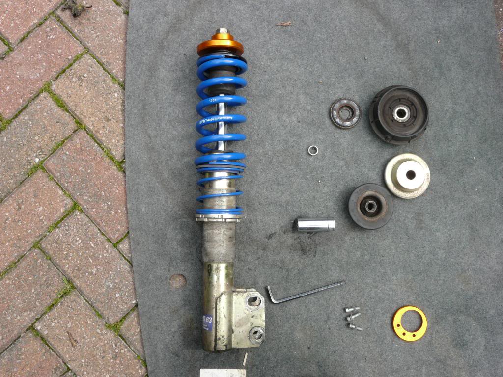

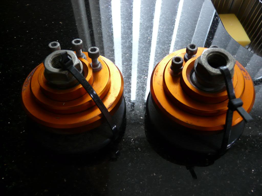

Next were the AST solid topmounts. Been after a set for quite a wile now. Tried a set of topmounts for a trackday last year and was really impressed with them. Just seem to make the steering more direct and responsive, not to mention stiffening up the front of the car a little more aswel.

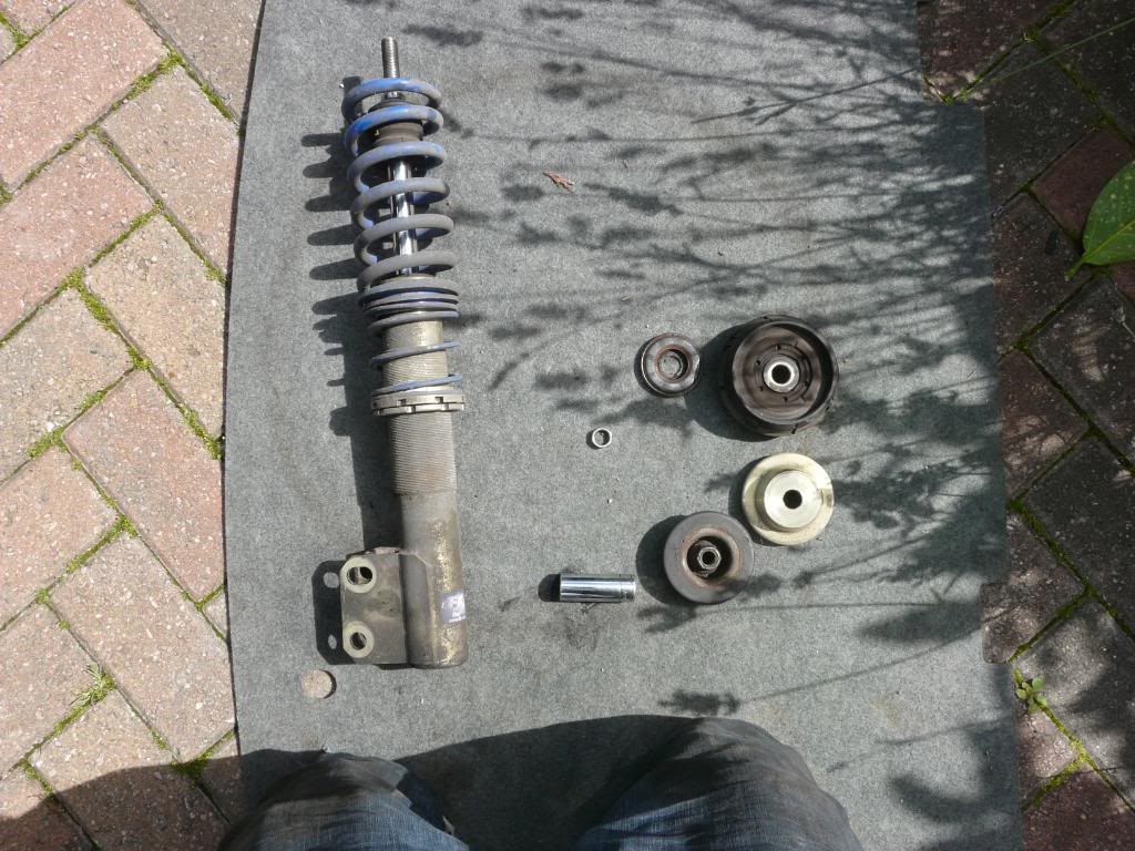

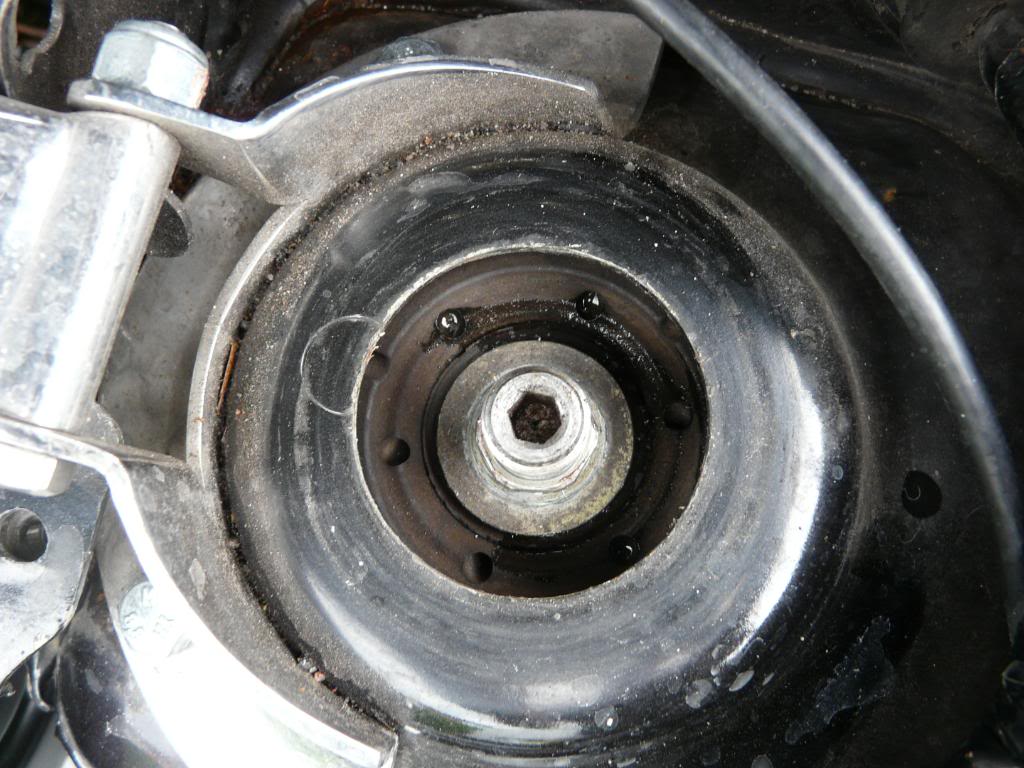

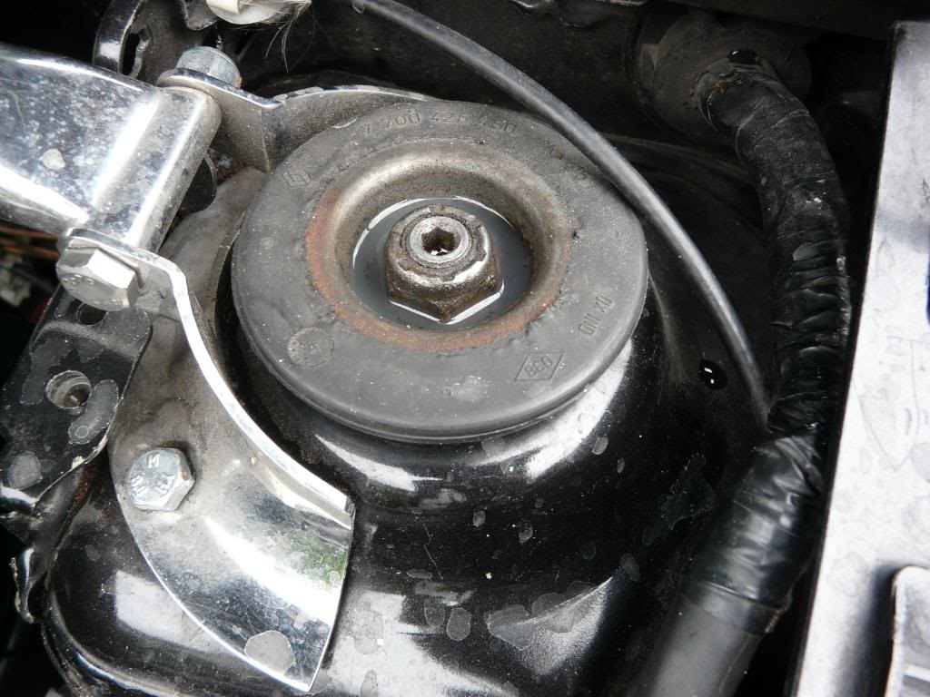

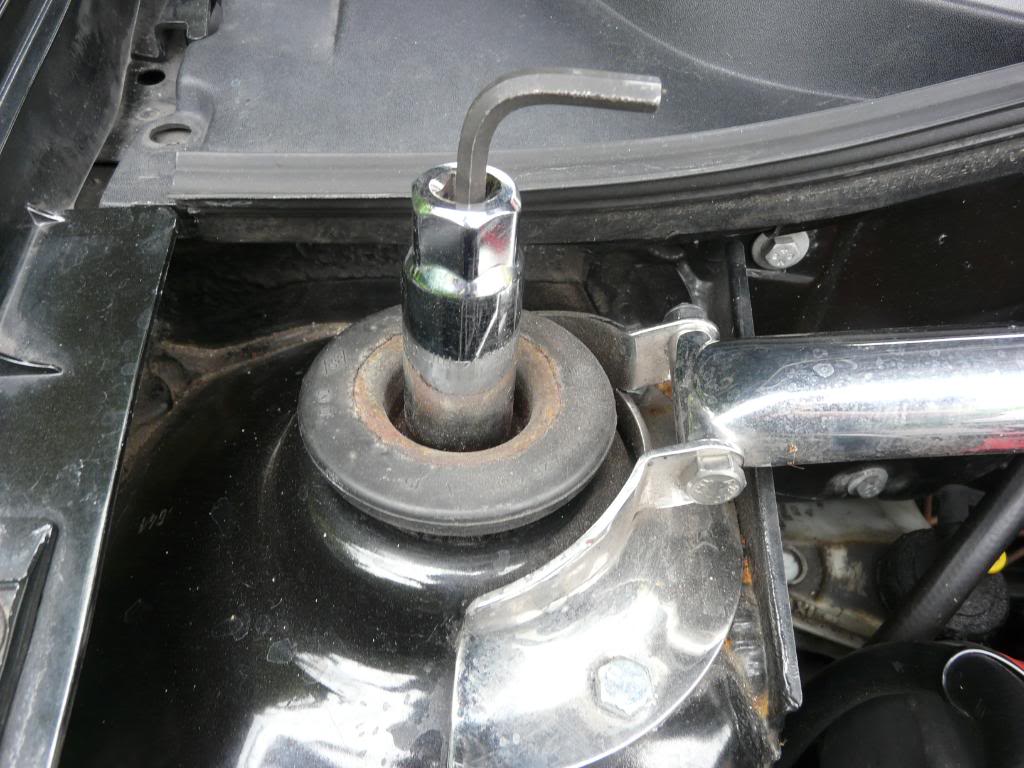

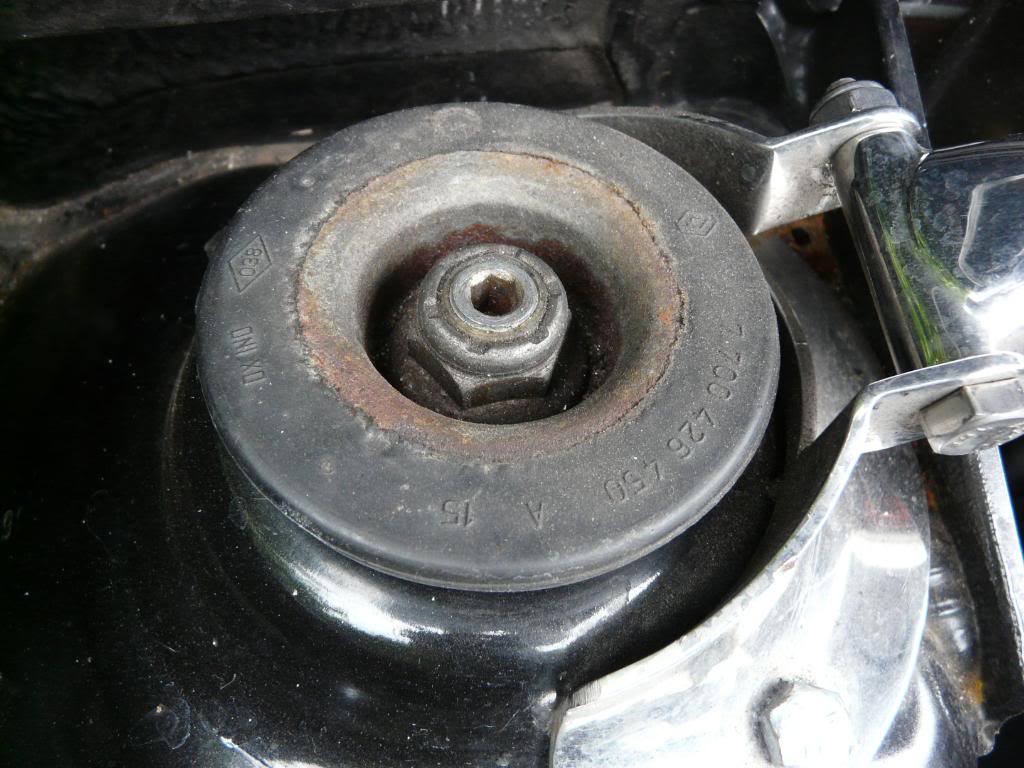

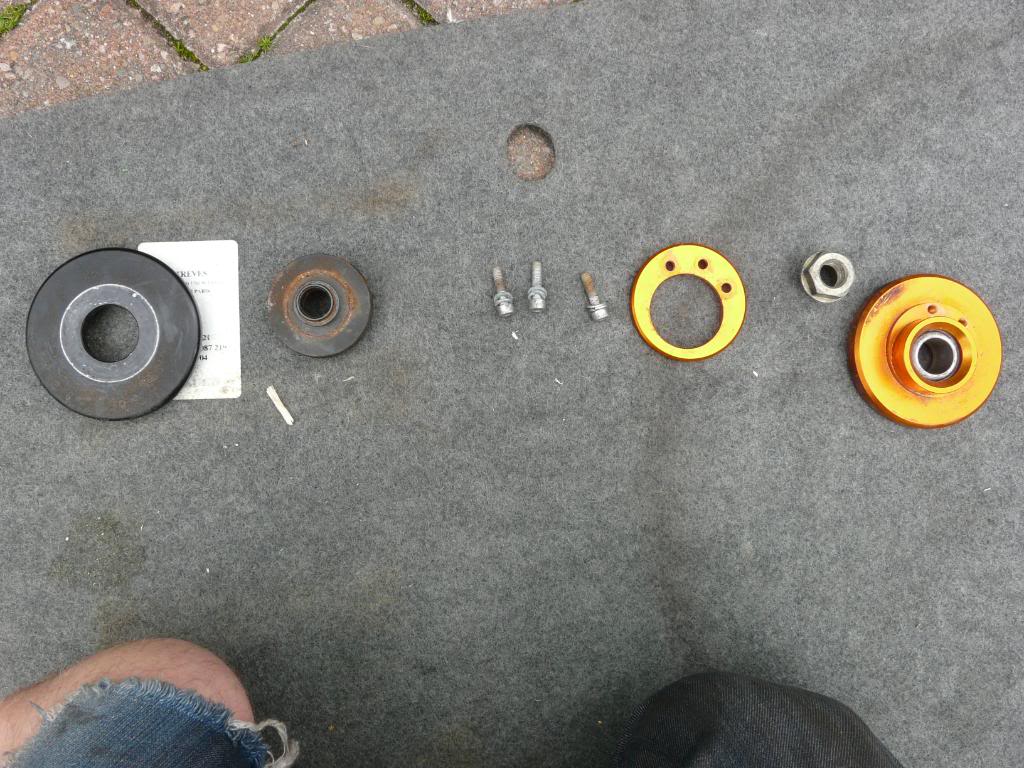

So i set about fitting the topmounts this weekend. Not too big a job to do as everyting is new so came apart pretty easy. Took a few pics along the way aswel. First i started by loosening the standard top cups.
Then i removed the two bolts that hold the shock to the hub and then removed the shock from the car. Everything has got quite dirty in the few months that everything has been on.

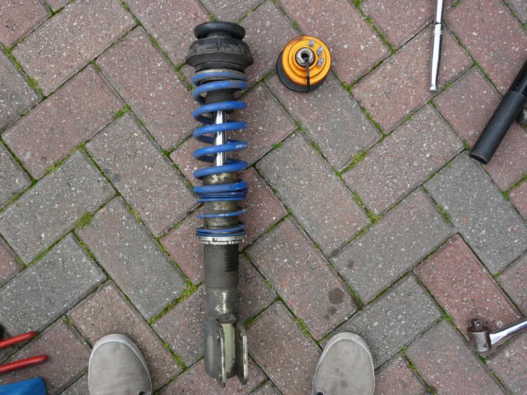

Big difference in the standard topmounts to the AST topmounts. Look miles better aswel. As the topmounts werent new i got the off f0xy they needed abit of a clean before they went on. So abit of WD 40 and some elbow grease and they looked as good as new.
Gave the shocks a quick clean up aswel whilst they were off haha....
Old topmounts removed and the AST topmouns fitted.
Then put everything back on the car. Look so much neater on the car compared to standard.
I decided to use the AST topmounts as they offer great adjustability compared to all the other brands of a similar price. Last but not least i got hold of some Carbon Lorraine brake pads. Not put these on yet as im just going to use them for trackdays.

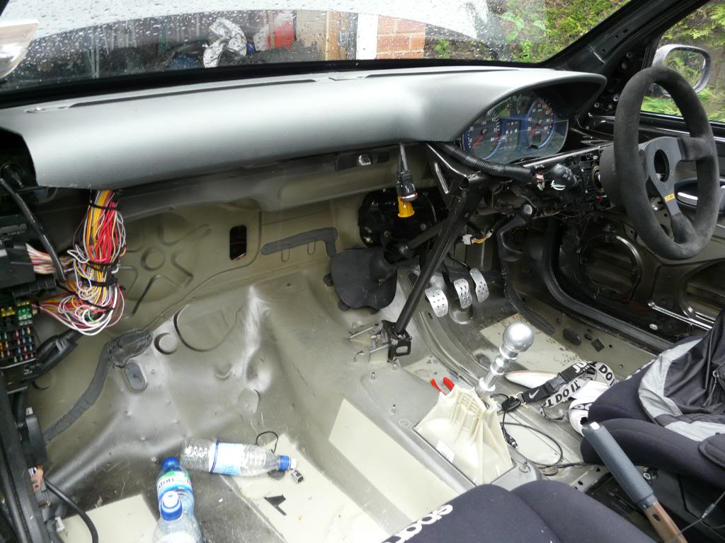

Stripped throughout.

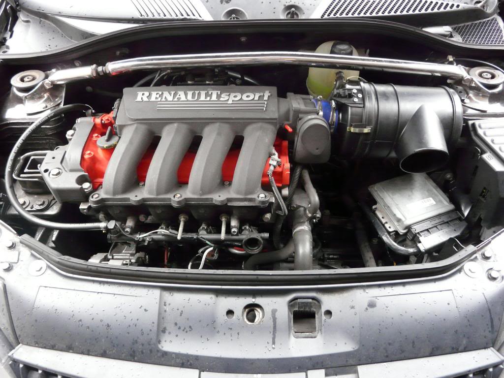

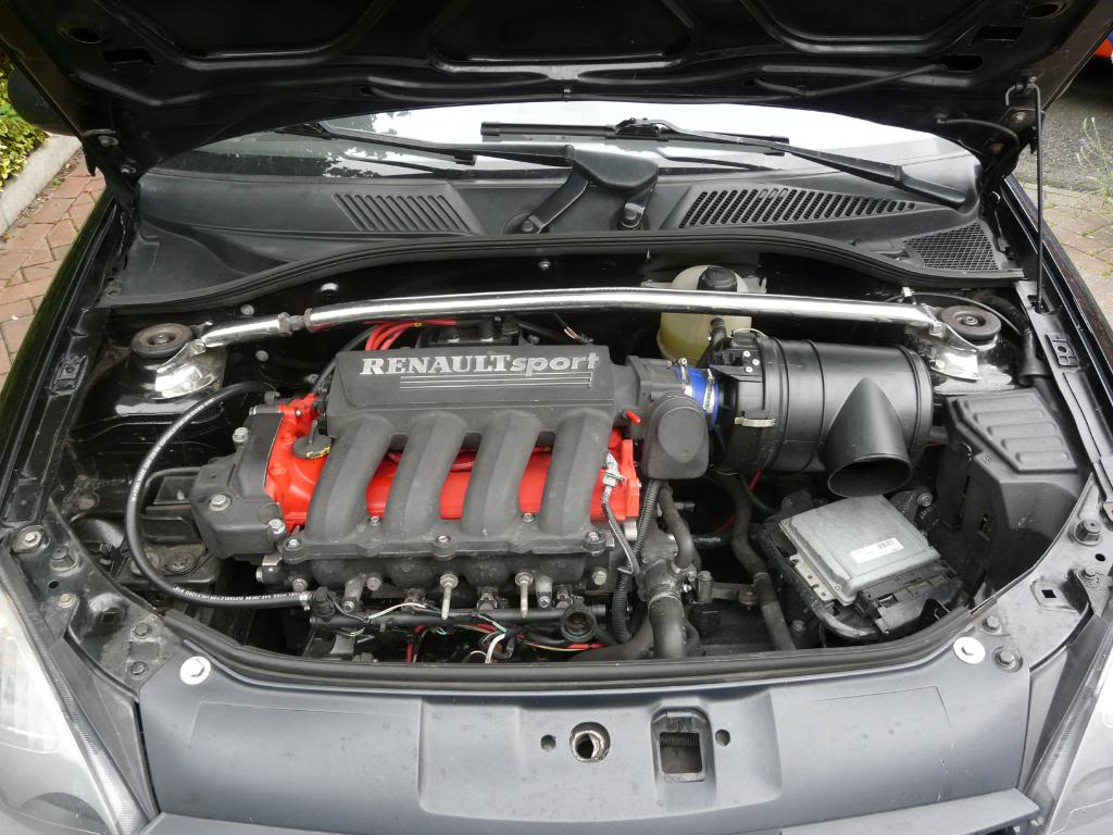

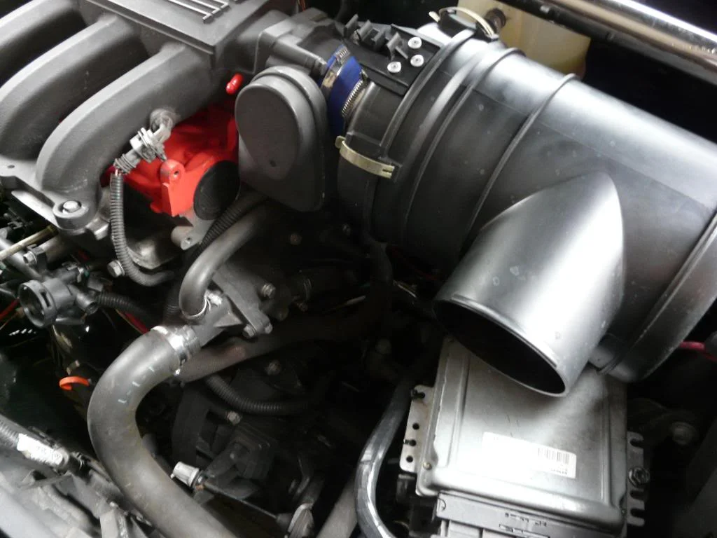

From looking at your engine pay I really want to relocate my battery so I can have my airbox sat straight... although I think there would still be a few things in the way. looks so much tidier.
