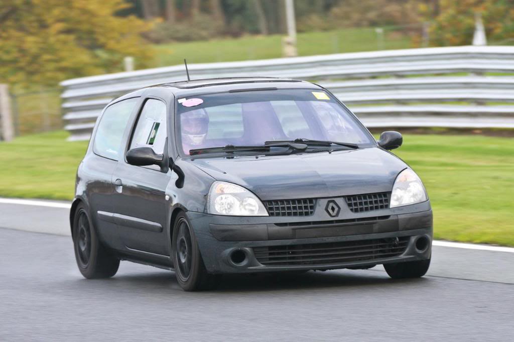

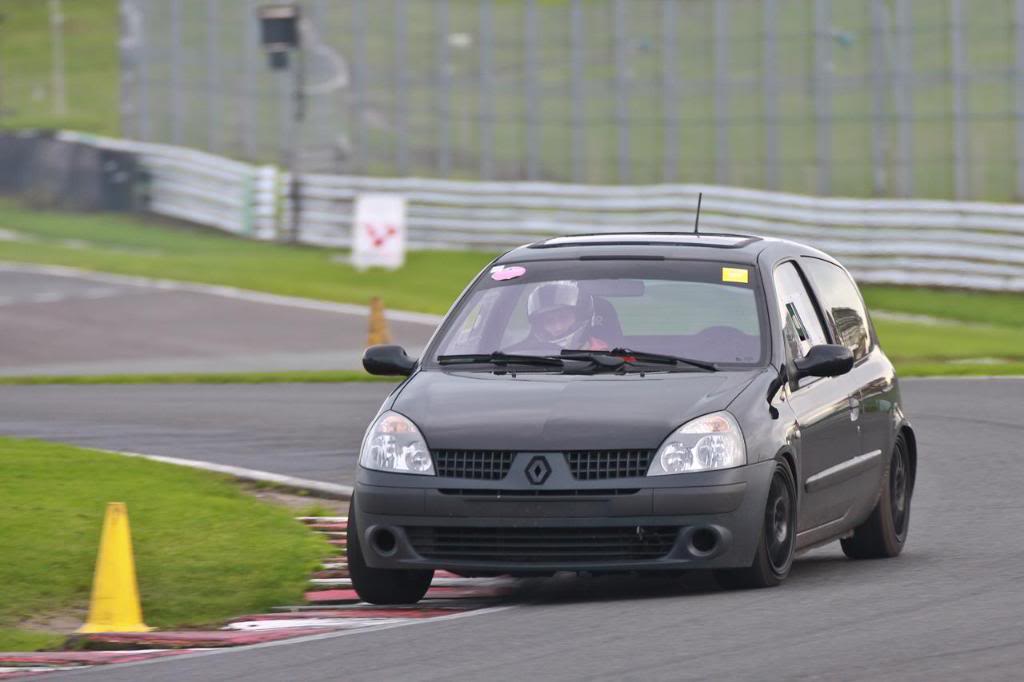

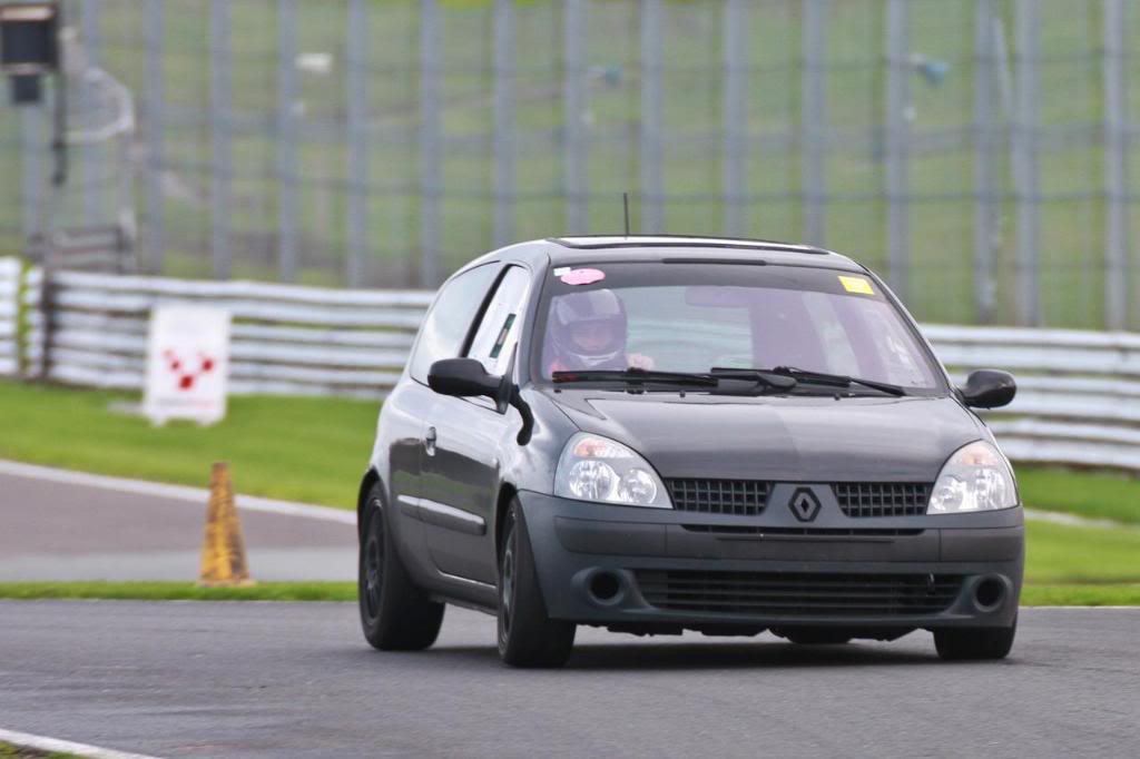

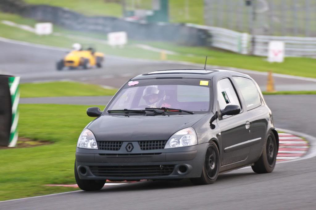

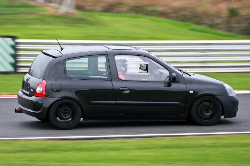

Cheers for posting that up bren. Here are some pics f0xy took from Oulton aswel.
Was a really good day, a bit wet in the morning but by 11am the track soon dried out. The car was faultless throughout the day. Will update more over the next few days.......

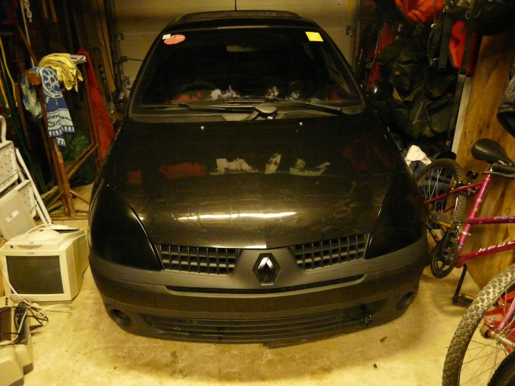

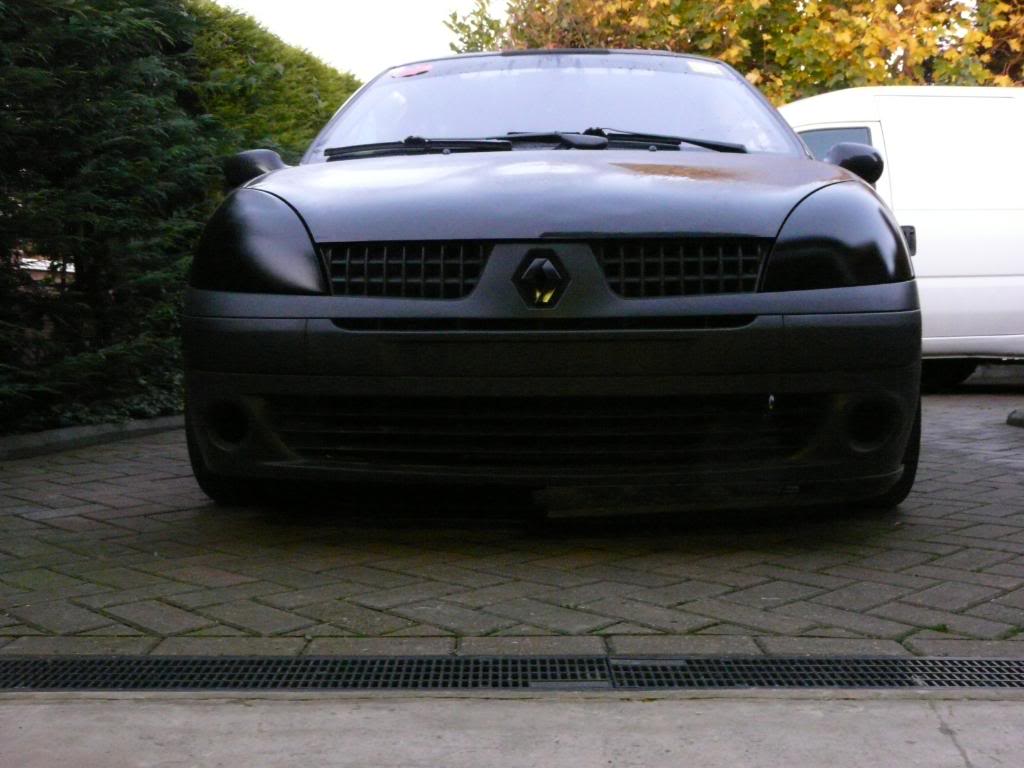

Ive decided to take the car off the road now, mainly because its getting horrible to drive and too cold now, and purchased myself a PH2 172 as a run about (will upload some pics this week). So over winter i can get on with a few jobs that ive been meaning to do. First up was to paint the headlights as i wont be needing those again..........
Cheers jay, i really like the look of it with the black lights.
Surprised at how good that looks. is it a matte finish like the bumper (lol)

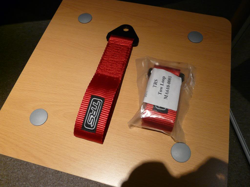

Had some TRS Tow straps lying about for a couple of weeks aswel, will get these fitted at some point in the near future

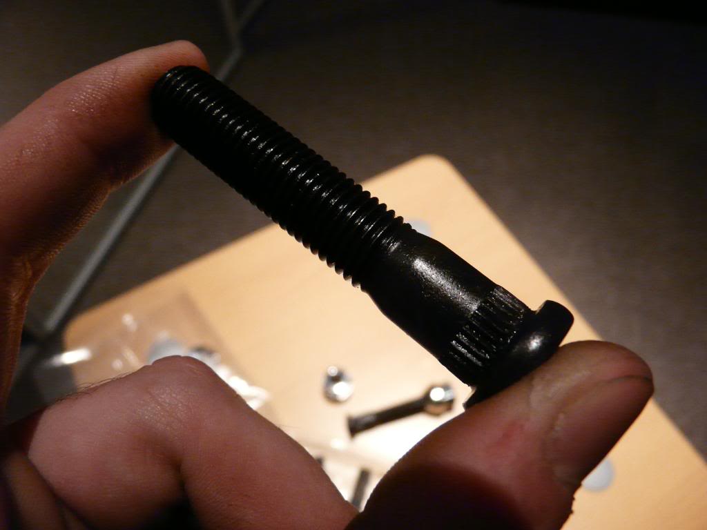

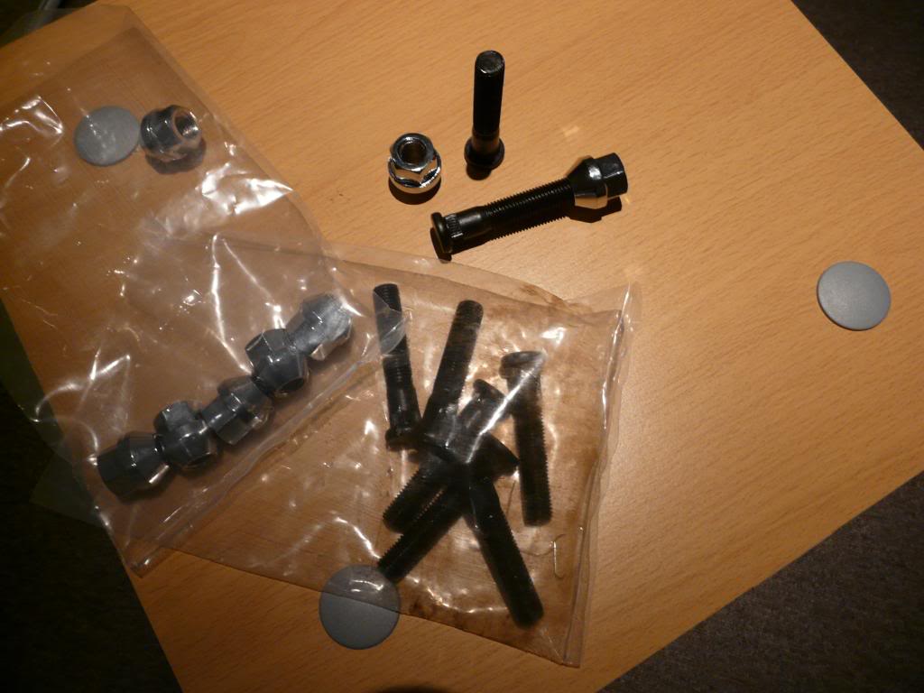

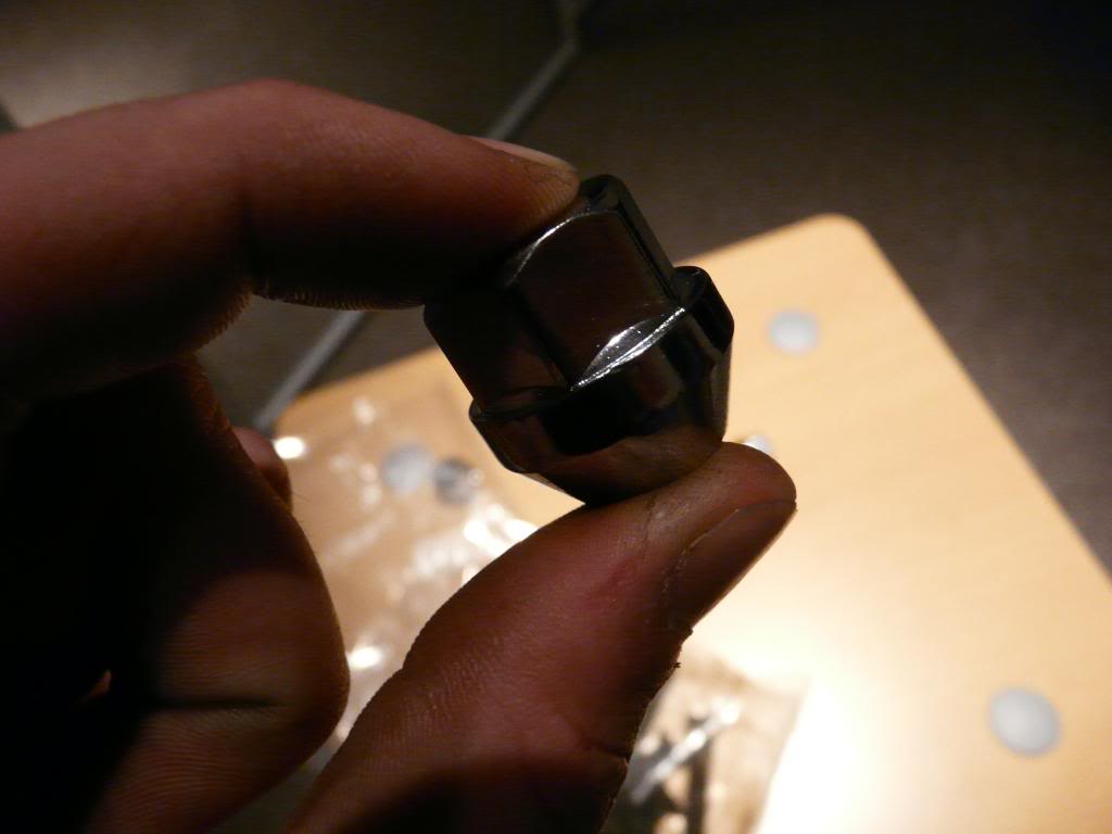

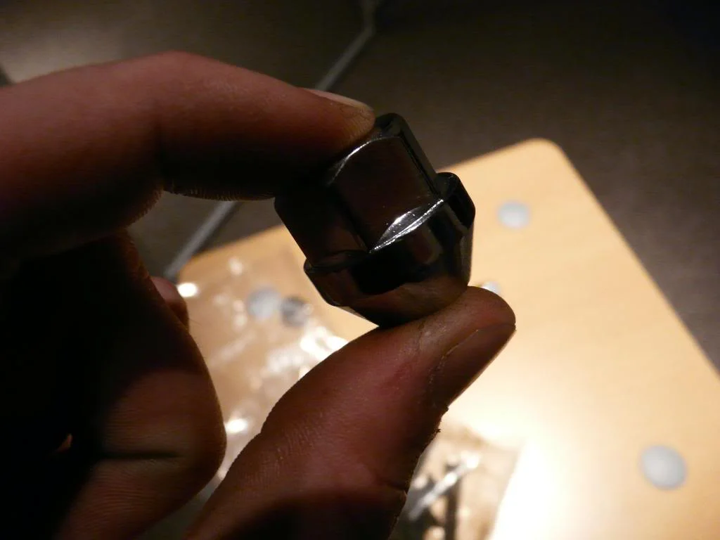

Few more bits turned up for the car y'day. Ive decided to convert the front hubs to studs for next year. Ordered the parts late last week and they turned up yday....
Just need to order two new bearings, get abit of machine work done and then i can get them in :D
Nice! What do you need to do to fit studs like that?
Search for either of my project threads. Machine back face down a few MM so the heads don't catch anything, drill the threads out to 1/2" to accept the spines as a tight fit. Press in with a press. Plus bearing then press the stub back into the hub.
No stronger, just easier to swap wheels and less chance of a wheel falling off (on track especially) if the nuts come loose, unlike bolts where the wheel actually will fall off (been there, done that).
Which wind out when you want to swap wheels after half a day on track with the nut still attached.........yes. Threadlock or no threadlock they are unreliable IMO, they might be fine for a while, but at the end of the day a fixed pressed fitting will never compare to a wind in stud. On the road, perfectly acceptable.........the strain, heat and wear/tear on track is a different story.
Fair enough if someone spends £100s on decent studs that are properly made, they might stay in properly, but all the cheap eBay and budget kits (i.e under £100) for sale are not even worth entertaining. I've been there and done it, hence why I changed to a pressed version. Plus its doable for under £50 if you know what you're doing...
