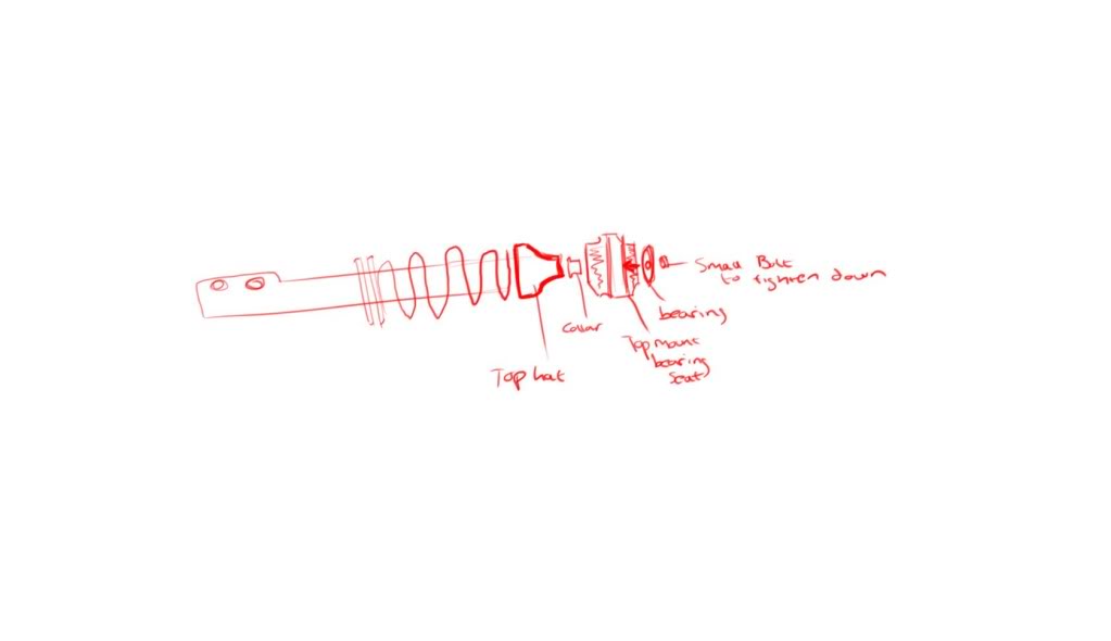

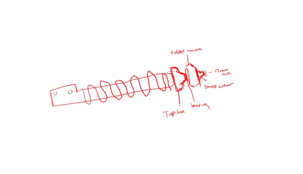

heres a quick diagram
Bearing should be ontop of the strut, not ontop of the rubber mount.
From the pic I would say the entire rubber mount is upside down.
Fred fitted bigger washers to the top of mine underneath the top hat and removed the helper springs. No more twanging and I was a happy man!
removed the helper spring completely?? would that not make it really low? n extra bouncy?? n also i was trying to show the bearing separate, ussually sits in rubber mount but bearing nearest top right?
