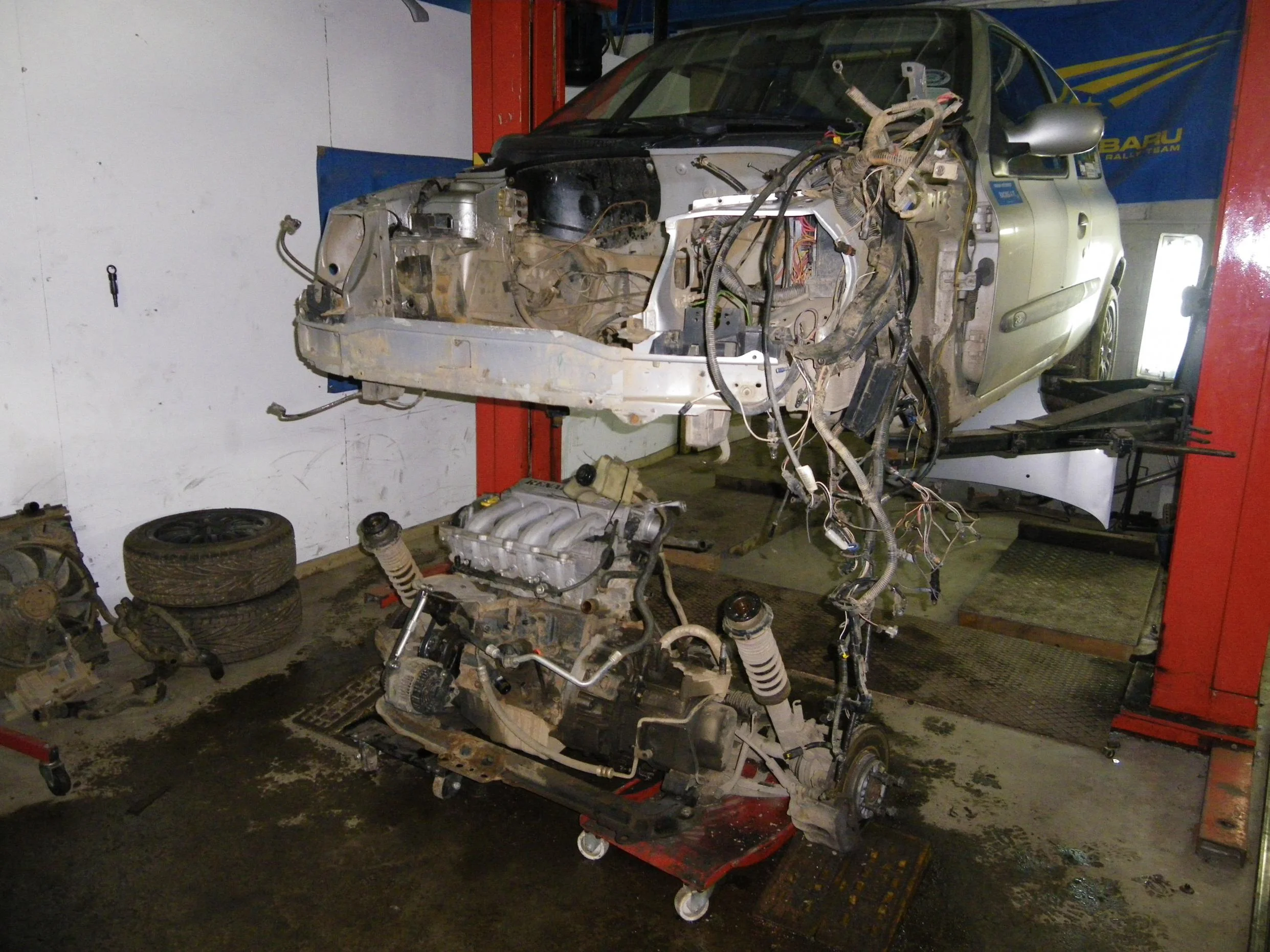

Any way, here is the first photo, of my donor scooby being stripped.

Then had a dummy run to see how the Scooby lump would fit. Although I couldn't lower the shell right down, due to the fact that there is no transmission tunnel in the Clio yet, I am really delighted at just how well it all fits. Looks like a straightforward job to fabricate the front end, using most of the Scooby chassis rails, leaving the Clio inner arches, with the Scooby turret tops grafted onto them.
