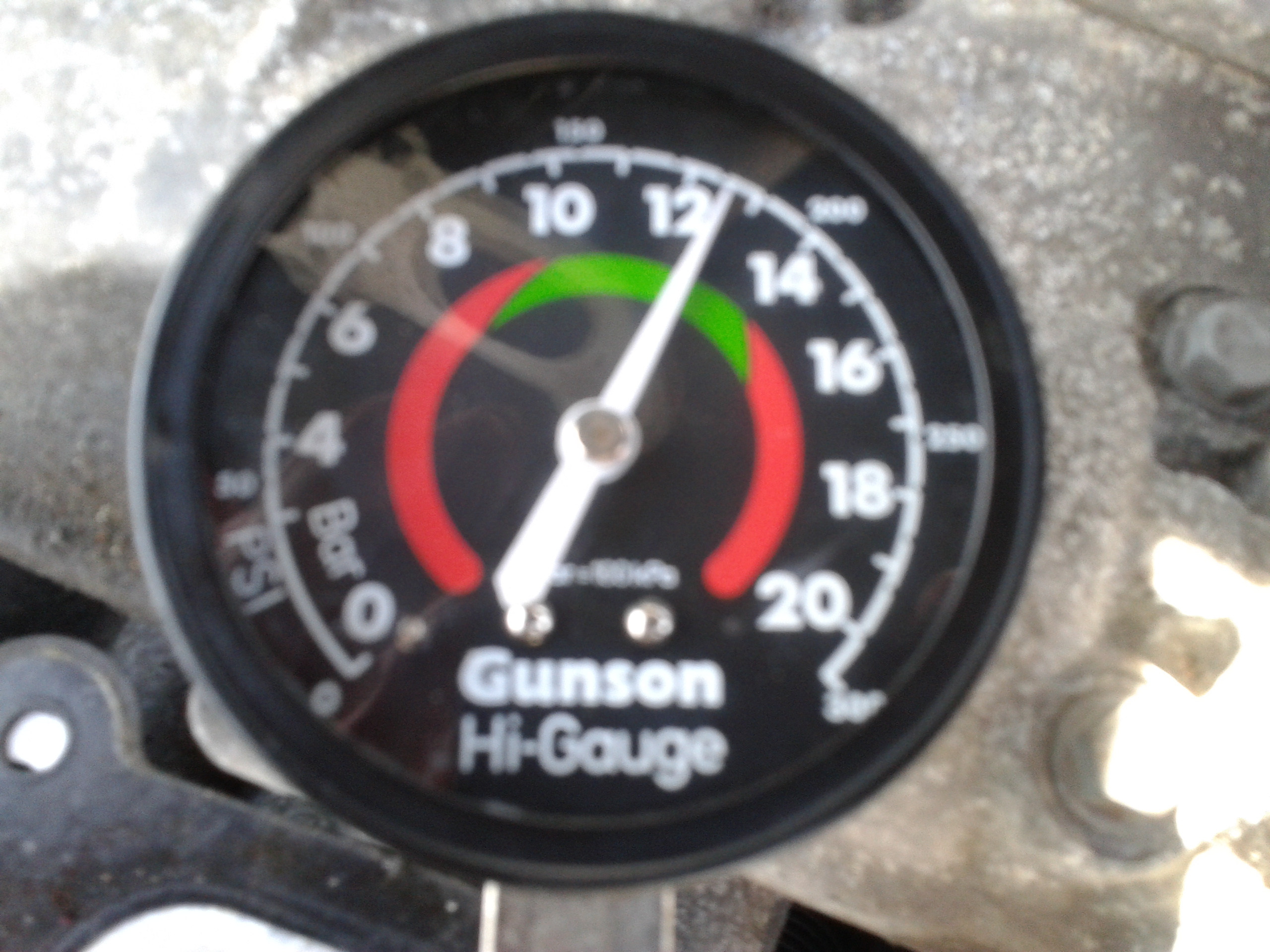

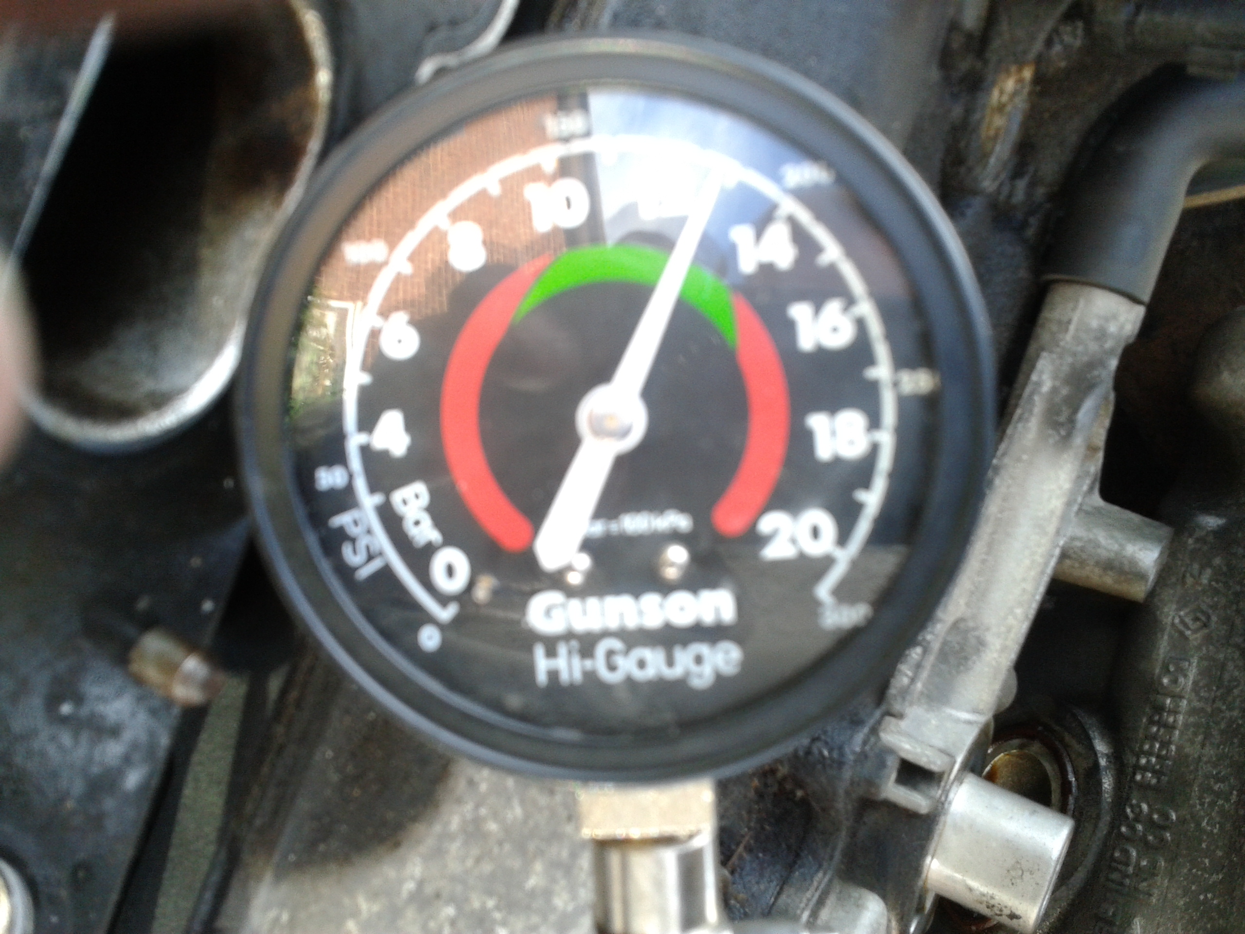

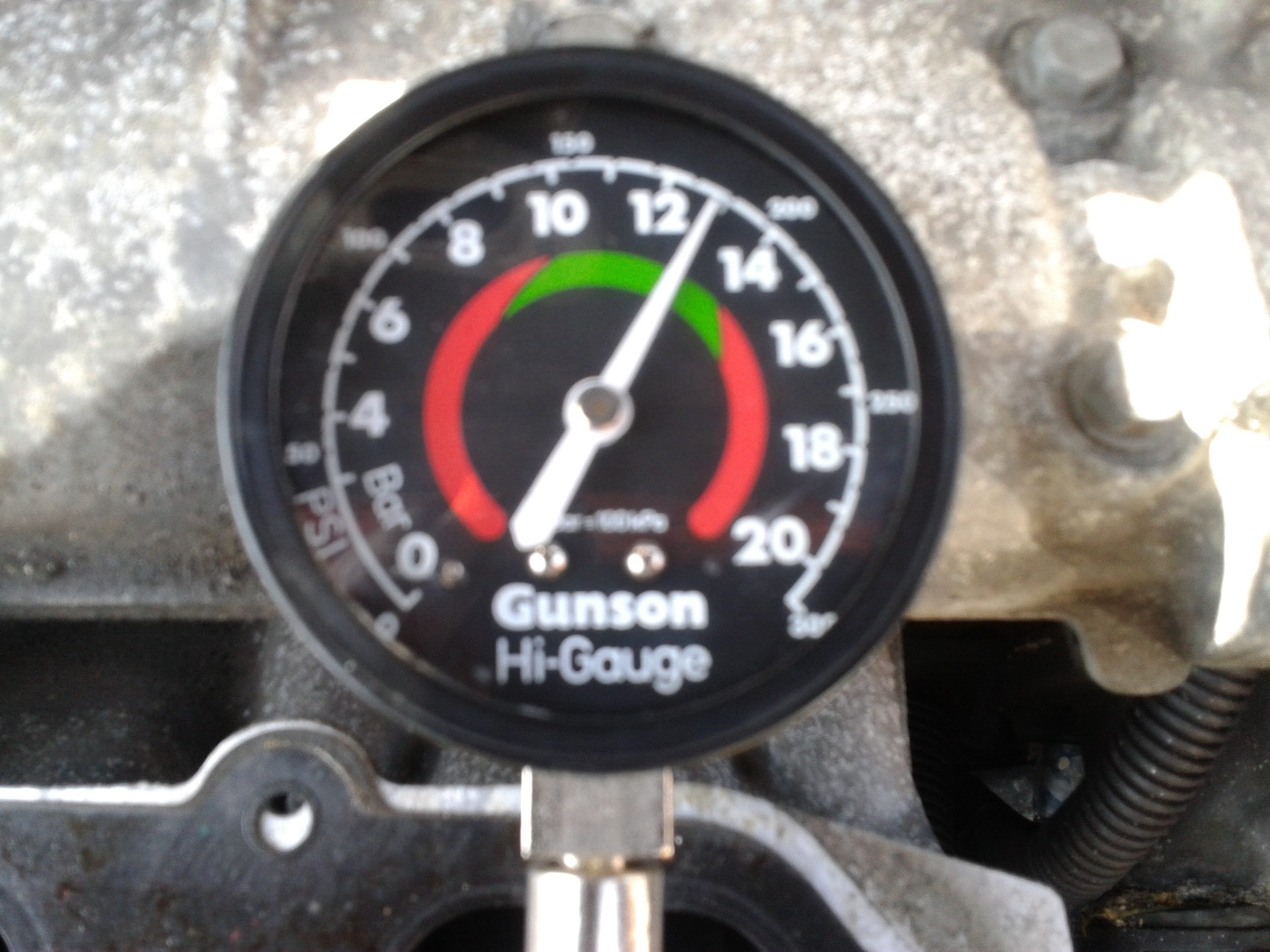

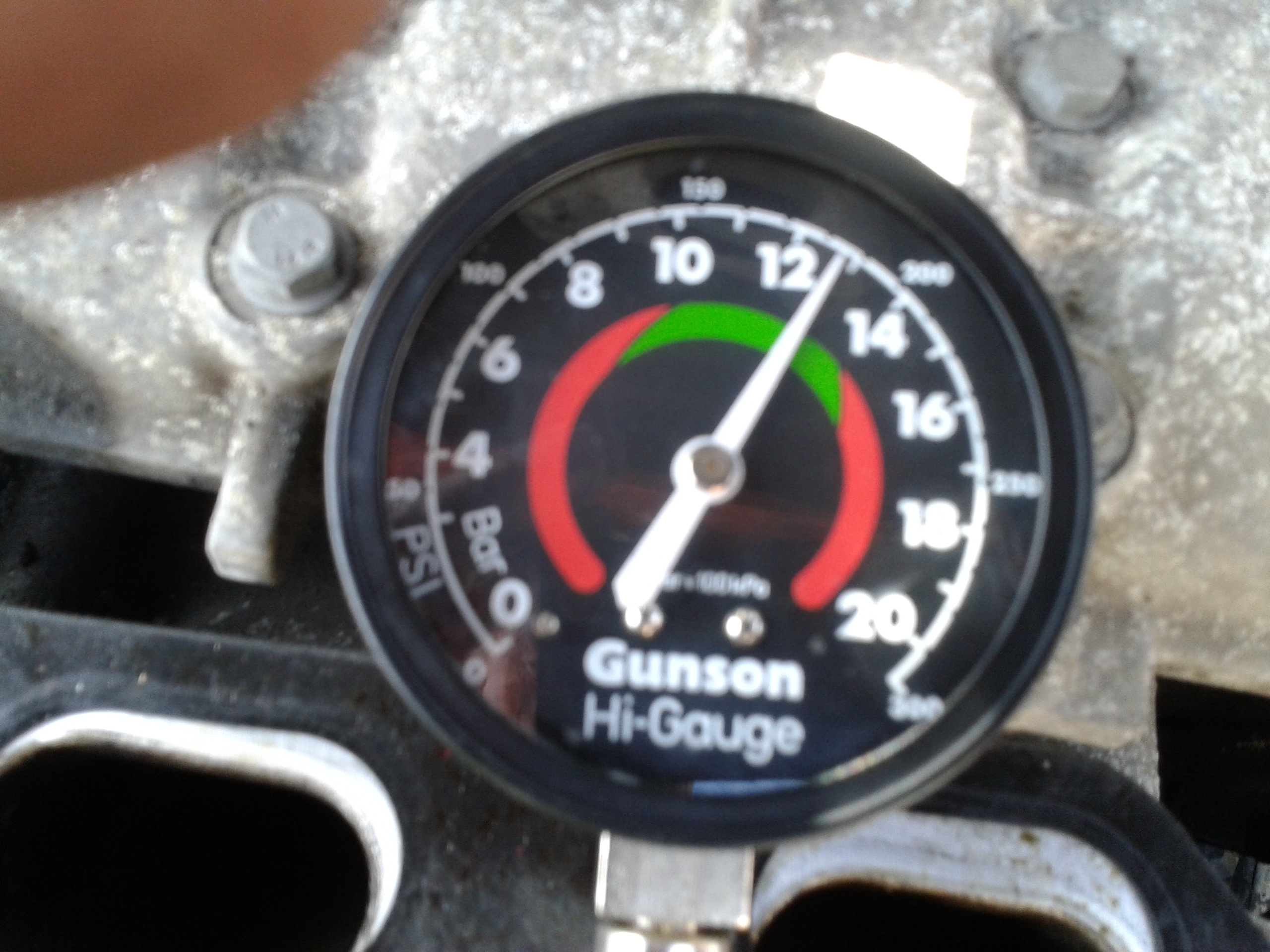

I would not speculate on any possible causes until I had conducted a compression test.
I was very happy with these readings at approaching 130k miles.
18-09-09 CYL 1 compression.jpg18-09-09 CYL 2 compression.jpg18-09-09 CYL 3 compression.jpg18-09-09 CYL 4 compression.jpg
  Land Rover
That’s pretty much perfect.
