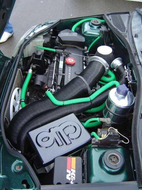

Its a bit messy but not too difficult, remove the rocker cover, strip the paint using nitromorse which you can get from any DIY Shop, make sure that you wash the header cover in hot soapy water & dry it thoroughly before you replace it and then machiene polish till you get a great shine, although i havnt done mine yet it is on the list this year, heres a pic of my engine bay as it stands at the moment, if you need any more help just shout.
