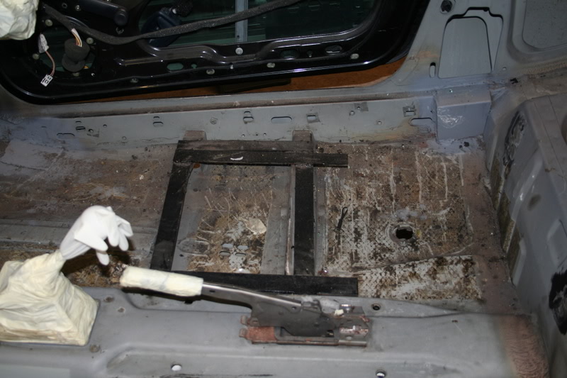

So started with removing all the lugs fixings etc, these were quite a b**ch as I didn’t want to scratch the fook out of the paint and if you just rip them out then the bloody cheese steel pulls and bends! So basically I hooked up the air drill and took the centre out of each lug and then with care... took the rest out with pliers etc. Put all the lugs to one side and then removed all the old bolts & fixings from the seat belts etc, then came off the plastic blanking blocks and then using the grinder removed any stray bolts, mountings etc.... put it all in a bag.. 2.6 kgs! It all helps J

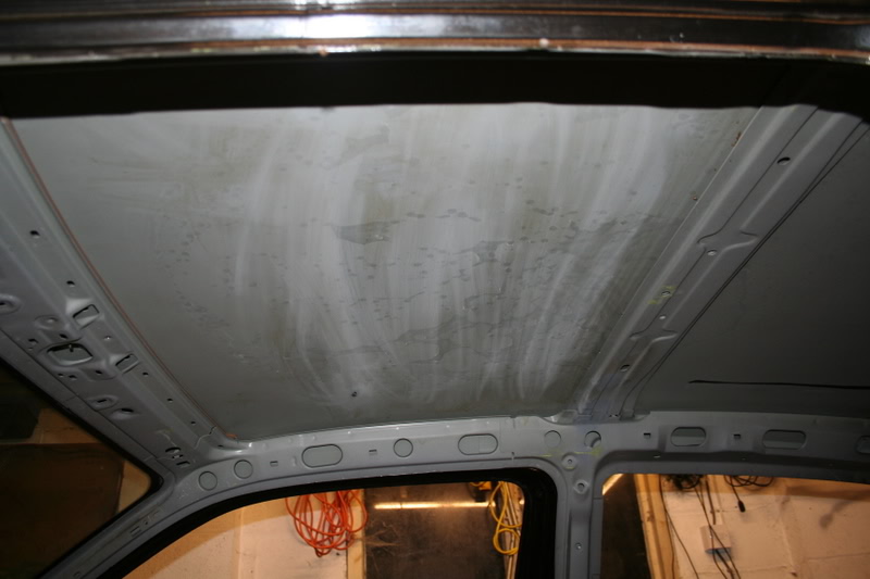

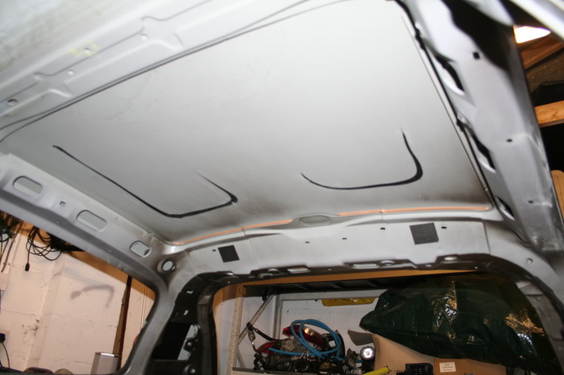

Then next on the list was to tackle the huge tar pad on the roof...after trying many methods I had to resort to the heat gun and scraper but I had to be extra careful as if the roof skin got too hot the paint would burn and I didn’t want to mark or put rises in the skin with the scraper... so removing this took forever as it was so thick it needed loads of heat to get to the glue! So I basically had to just warm the whole pad up slowly then pick it off! Once I had removed all this I waked it all back in a bag and weighed it all in....2.1kgs! it was huge tbf!

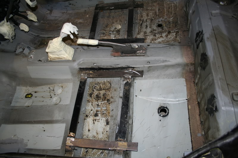

On the Wednesday I had picked up some more 5mm by 40mm steel, 0.8mm wire and co2/argon mix gas to finish off the seat frames... as the passenger seat was GT width for fat b*****ds I took to the bench and extended the jig and then cleaned off the paint on the base frame, tacked the supports in place and tested the seat to check fitment! Spot on! So finished the full welds... trimmed off the ends....job done!

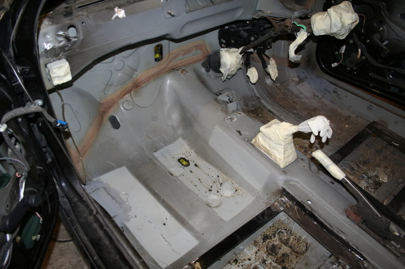

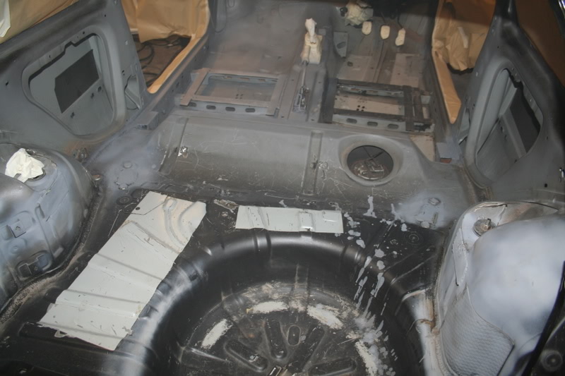

Filled the gun and gave all the old glue and tar patches a good soaking with panel wipe... left it for around 1 hour and returned with Tesco value tea towels and after a good hour or so I managed to remove all but most of the glue and remaining tar from the panels, roof panel, boot floor etc!
from this...
to this
Quick hover and air gun again......
Then with the panel wipe and blue roll and wiped down all the interior panels twice!

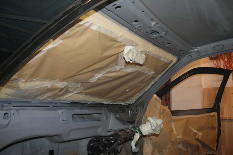

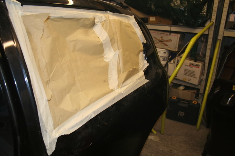

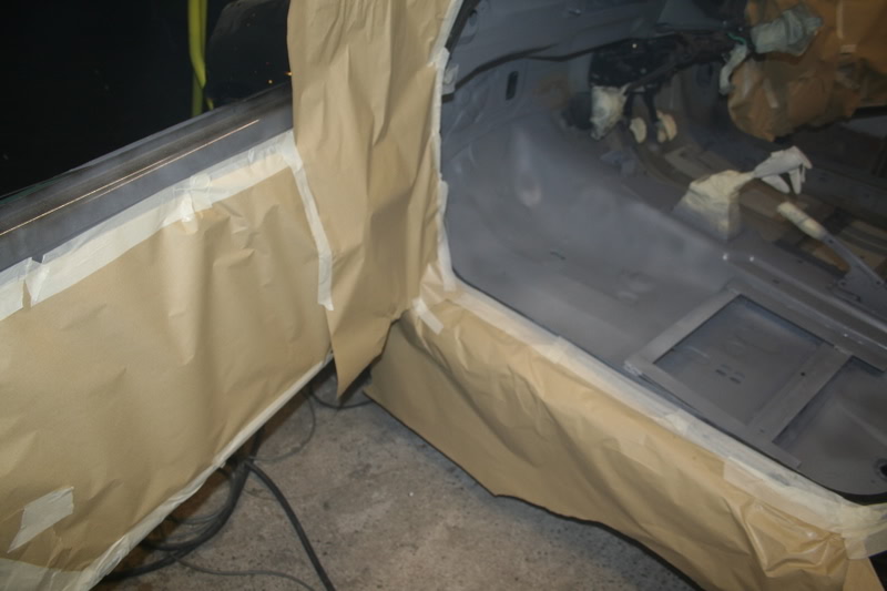

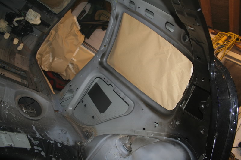

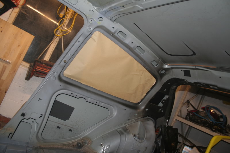

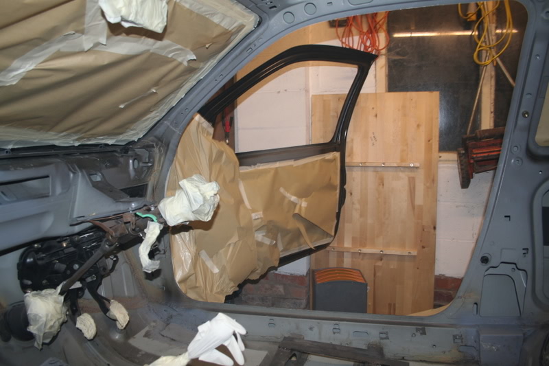

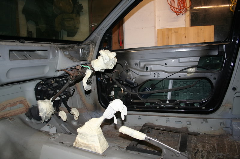

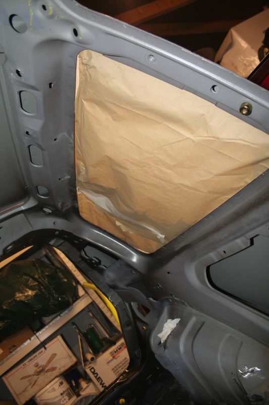

Then I had picked up 70 meters of brown paper and 4 rolls of thick masking tape, so I masked up the.....
Door jams
Door Panels
Windscreen
Side Windows
Boot opening
Sides of the doors
Gear knob
Handbrake
Rear view mirror

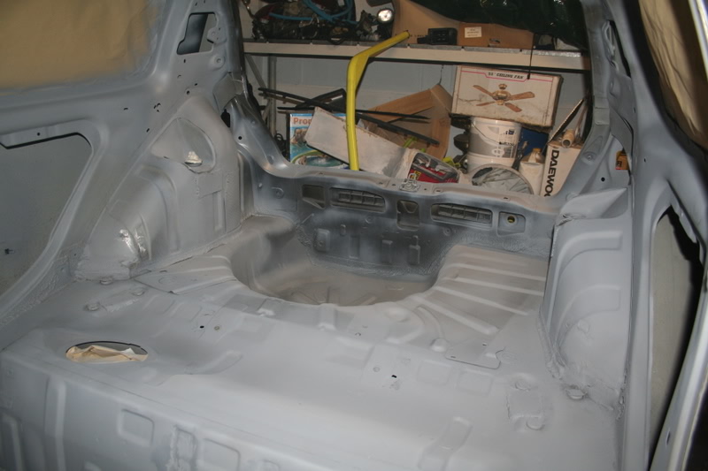

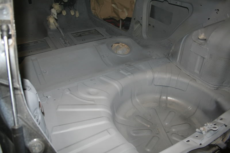

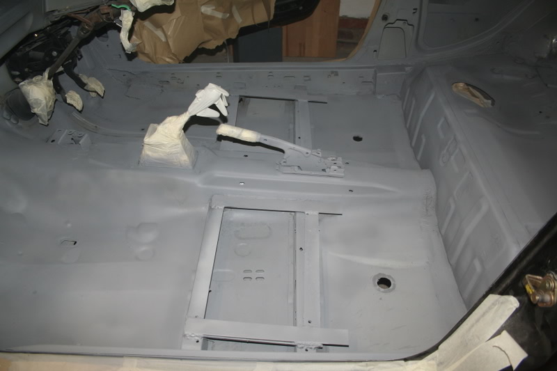

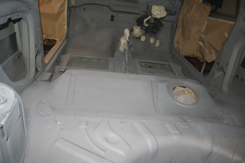

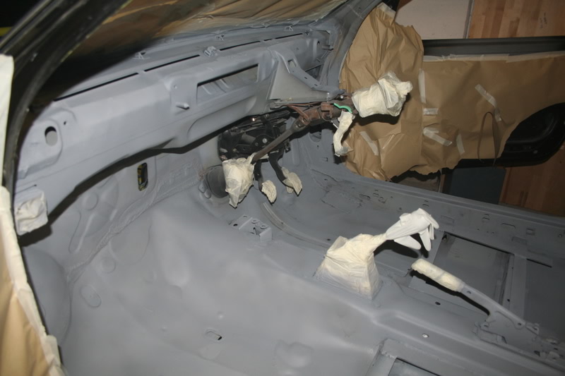

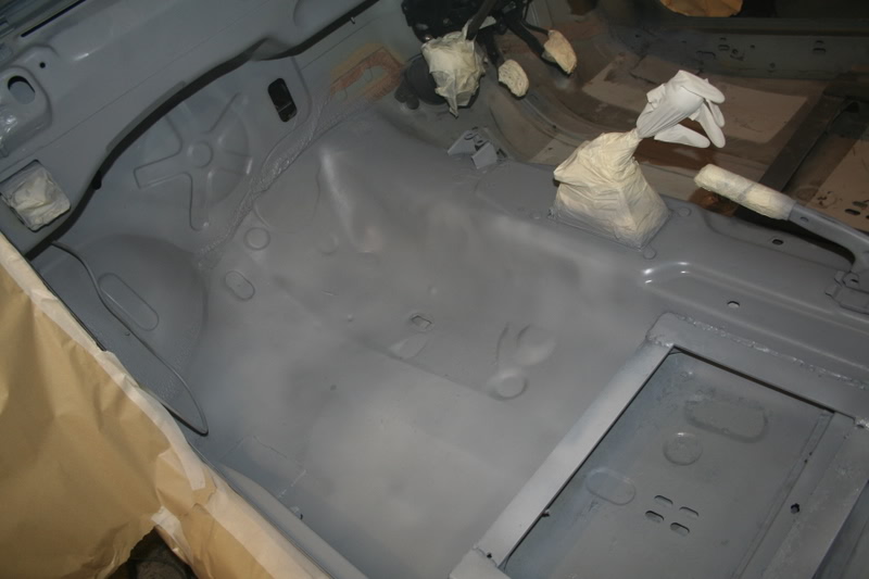

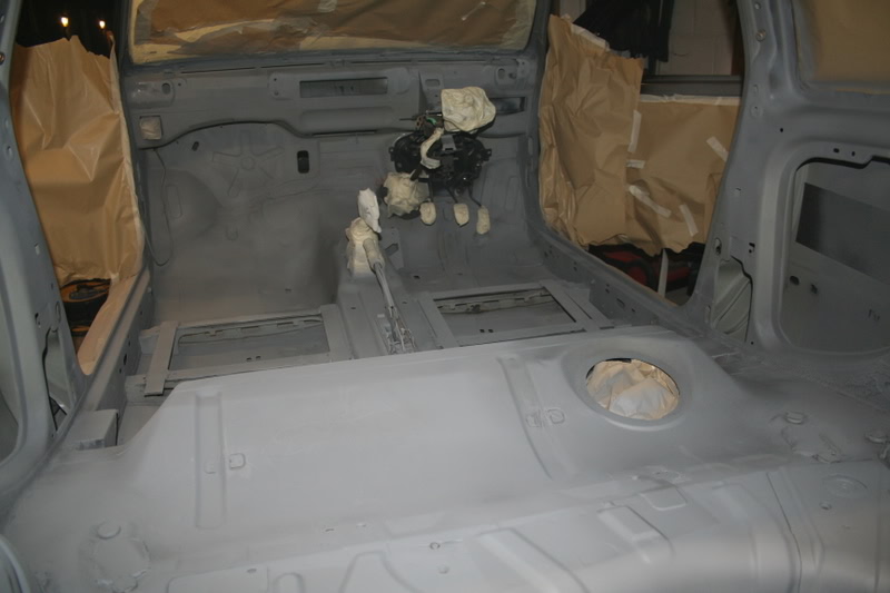

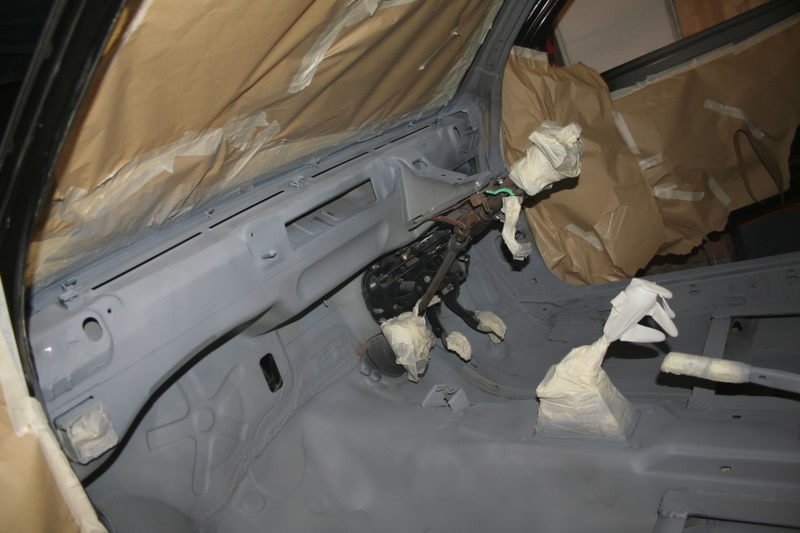

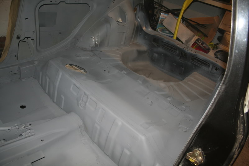

So the car was now fully prepped and ready for the two coats of prime!
I had bough 1.5 litres of prime and mixed this down 50/50 with thinners.... hooked up the gun and gave the car two good thick coats left to dry over night

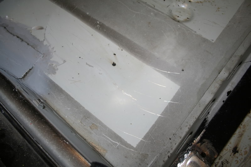

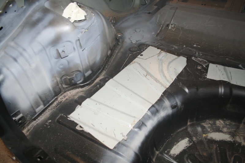

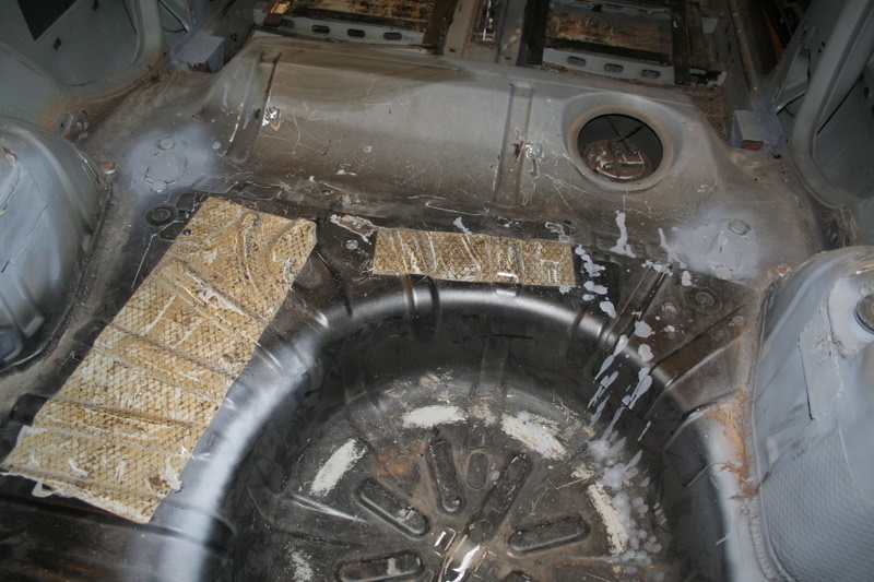

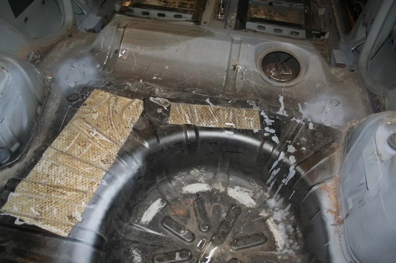

did you miss a patch -
well the start of fuel tank sits against the back of that steel shell. so if i got the heathunt on the tar to get it hot enough to scrap it off.... i didnt want to damage the tank feed LOL
LOL got ya! I saw a stripped out cup the other week and it didnt have any of those patches... renault are so annoying!
i know, i found a stash of the stuff between the bulkhead on thursday.. heatgun and scraper... 3.7kgs lighter :cool:
it was a huge patch and you cant see it when the scuttle pannel is fitted! so didnt have to clean the glue off.
it was a differnt colour too which was strange..
